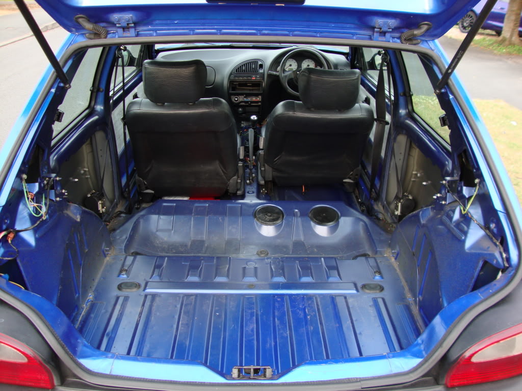

UPDATEEEEE! :D

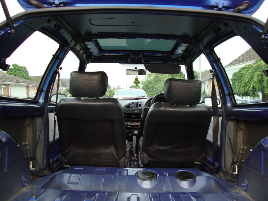

Over this weekend ive managed to nearly strip the whole car. Iv'e shed 52kg's and 330grams. I'm very happy with the results. Iv'e still got abit of the sound deadening under the dash which i carn't get at until i take the dash out. Theres also some stuck down sound deadening on the drivers and passenger footwells aswell as the rear quater panels which will hopefully be heatgunned off tomorow and weighed. The spare wheel and carrier were already removed when i got the car so that saved me a job.
Heres the list of bits ive stripped out today....
Fusion front door speakers = 1.060kg x2
Front doorcard = 2.490kg x2
Parcel shelf = 2.500kg
A-pillar = 170grams x2
B-pillar = 96grams x2
Air vent on the rear quarter where the rear light plugs are = 56grams x2
Boot plastic panel = 1.050kg
Boot carpet and sound deadening = 3.030kg
Show cage = 4.327kg
Rear seat belt buckles = 646grams
Rear gti leather/alacantra seats = 15.548kg
Rear quarter plastic with sound deadening and speaker = 1.940kg x2
Rear quarter panel (light grey) joins with the roof lining = 230grams x2
Main carpet = 7.270kg
Gear stick/window switch surround plastic = 519grams
Sound deadening (Fluffy) below main carpet = 1.363kg
Amp wiring = 1.328kg
Sound deadening under the dash = 2.969kg (still 2kg to get as ive got to strip the dash off.
Rear plastic cover were the parcel shelf rests on = 322grams x2
Release mech for the rear seats = 200 x2
Rear seatbelt = 777grams x2

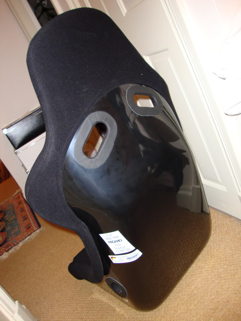

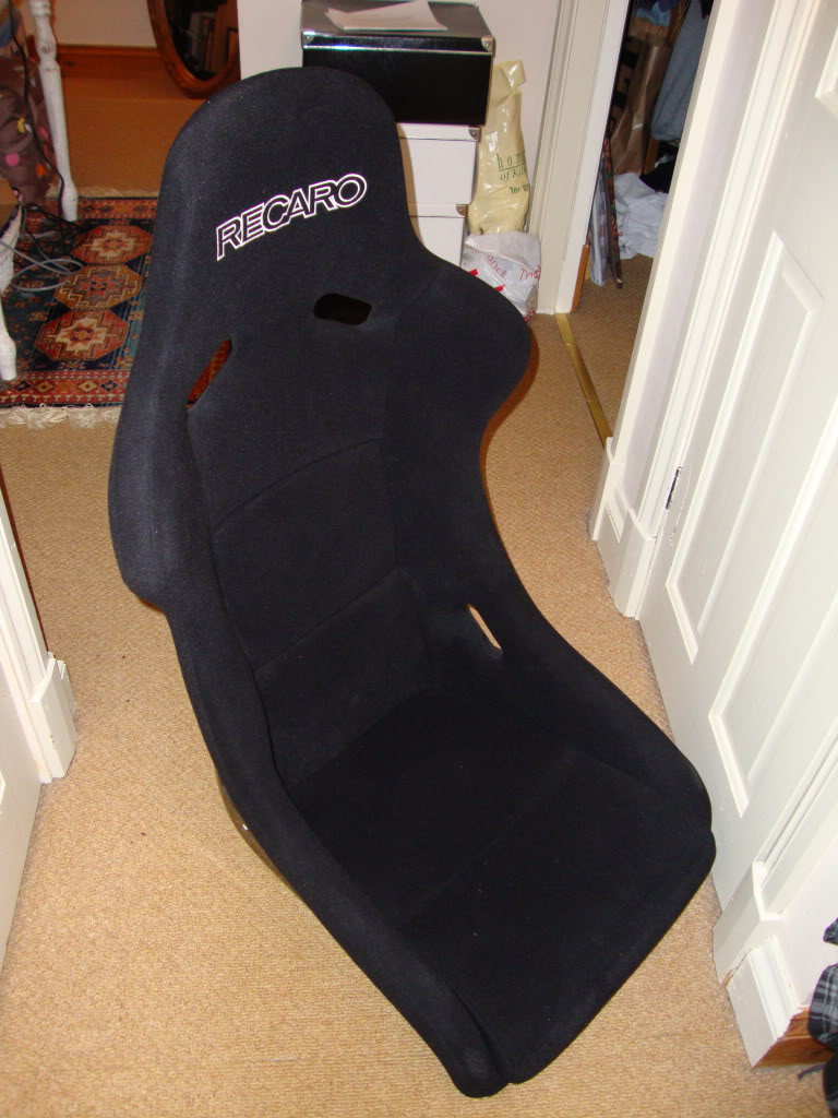

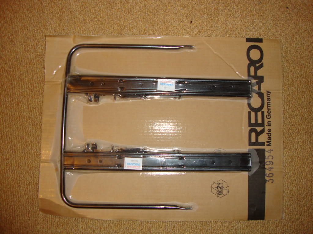

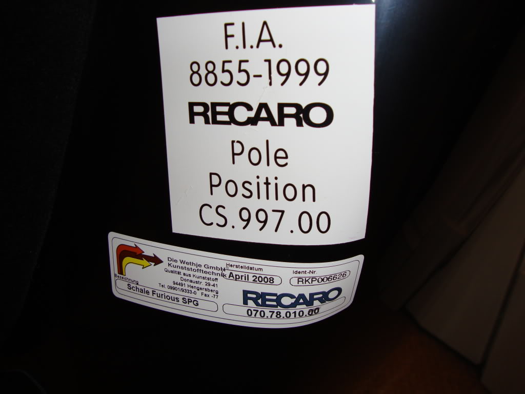

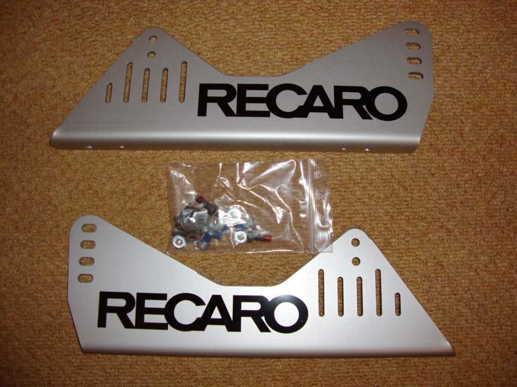

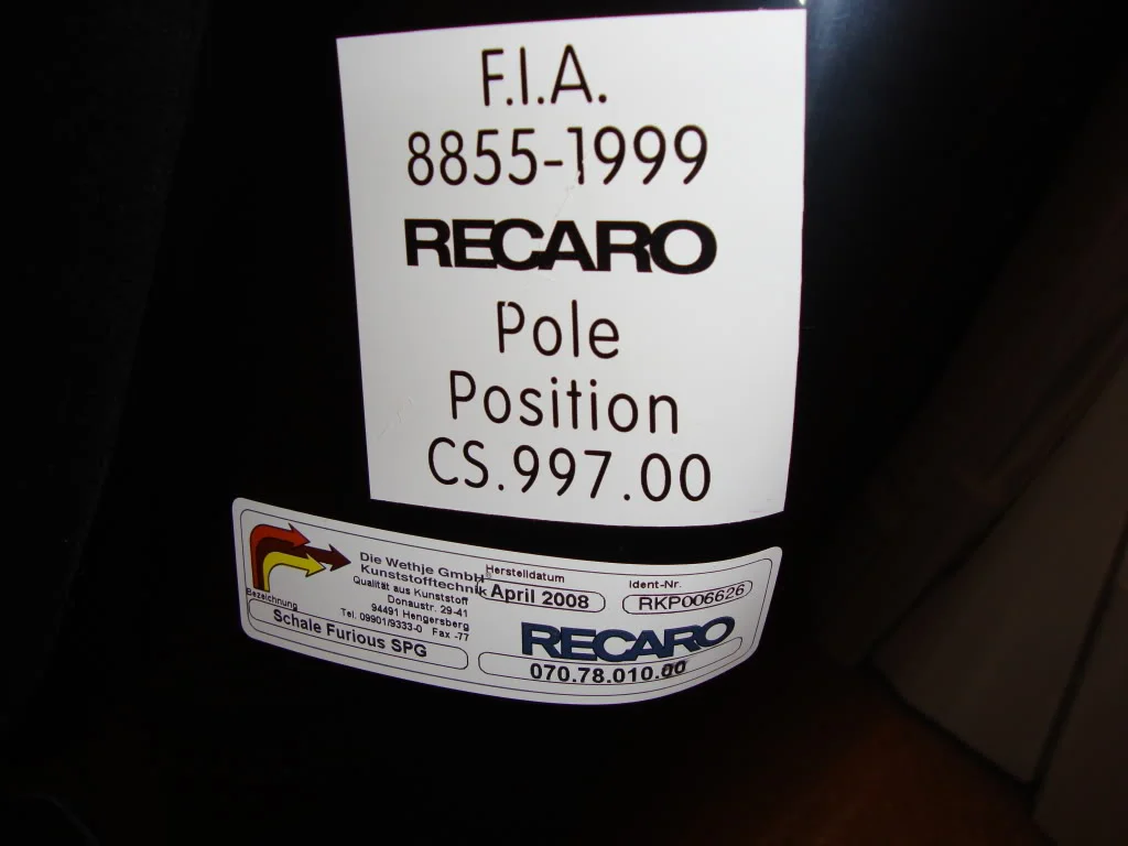

2 Brand new Recaro pole positions with alloy side mounts and sliders. These retail at £1200 inc V.a.t. They will hopefully be fitted tomorow when i get some harnesses for them. The literally weigh f all. Im sooo happy with them :D I will weigh my front gti leathers and these for comparison. So hopefully ill have an update for you tomorow.

I weighed the recaro's today with the alloy side mounts and each seat setup weighs 7.612kg's. Im going to be saving alot of weight when i get rid of the gti front seats :D Not much left to strip now. Ill get it weighed at a weighbridge. I will also be getting a fiberglass bonnet and boot. Polycarb windows will also be coming very soon. My aims for the mid 800's mark. Then it will be evil!
As soon as ive sourced a pair of harnesses i will update with fitted pics of the recaro's.

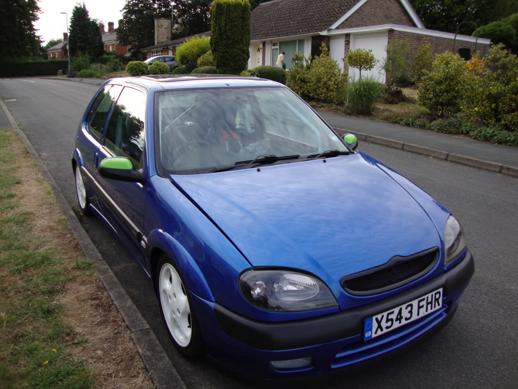

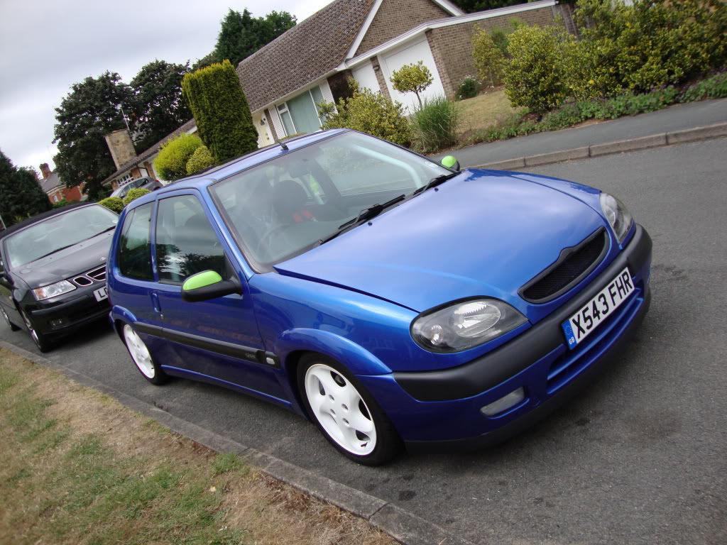

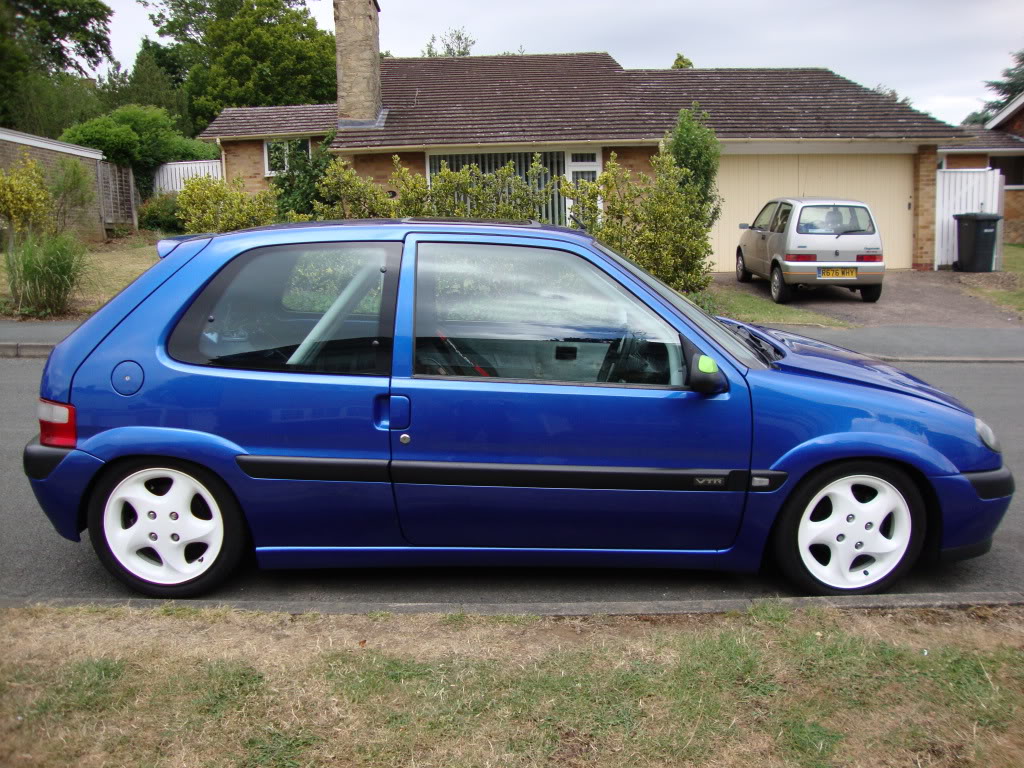

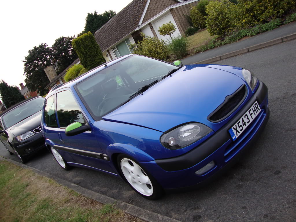

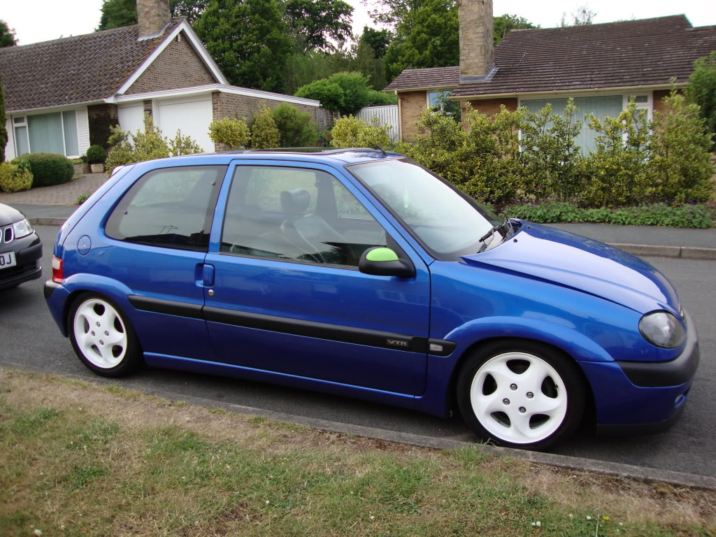

Got some pics with the new vts wheels i p/x'd with and a couple of the stripness, excuse the dirtyness it will be cleaned on the weekend :eek:
Debating wether or not to spray the wheels a different colour yet?

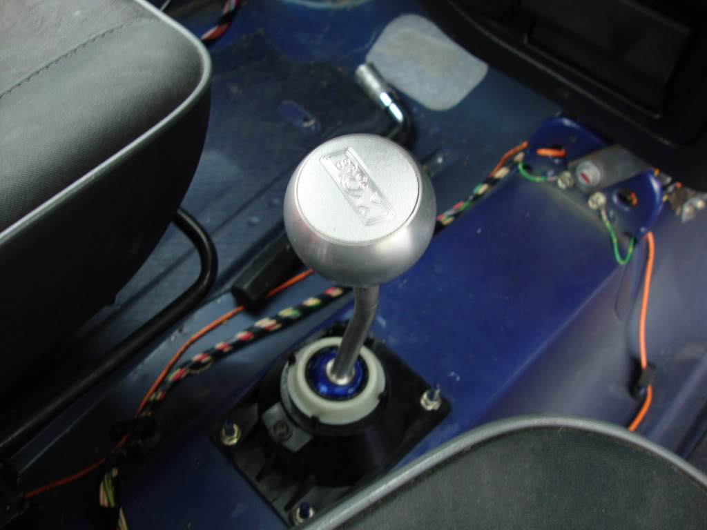

Iv'e just literally got back in and i now have a b&m! The guy was literally 5mins down the road so was very handy and it was an offer i couldnt refuse. Heres a quick pic of her...
Il hopefully have an update for this weekend with the seats in. I will also be ordering the saxsport on the weekend. Carnt wait.

much prefered it with the other wheels on im affraid. but still like your new look, each to thier own.
  182 Cup/Mk5 Gti
Re: My saxo vtr - Recaro pole positions/b8's/stripped!
cheers sean, its more purpose full now and the tyres are so much more grippyer. The lenso would get battered on track and look tatty.

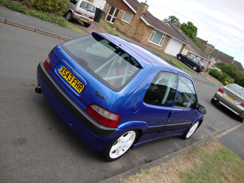

UPDATEEE!

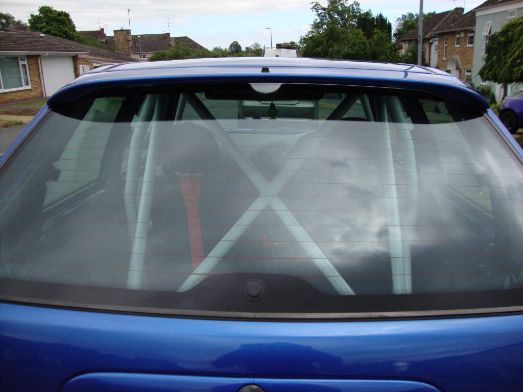

I have the cage in. its just bolted atm but its having box section welded for the mounting points and additional bars welded on. I also have the b&m on :D The buckets will hopefully be in sometime this week. I just need harnesses and the side mount bars welding in. Heres the pics. Unfortunatly the sun decided to go away so the pics dont look as good as before :(....

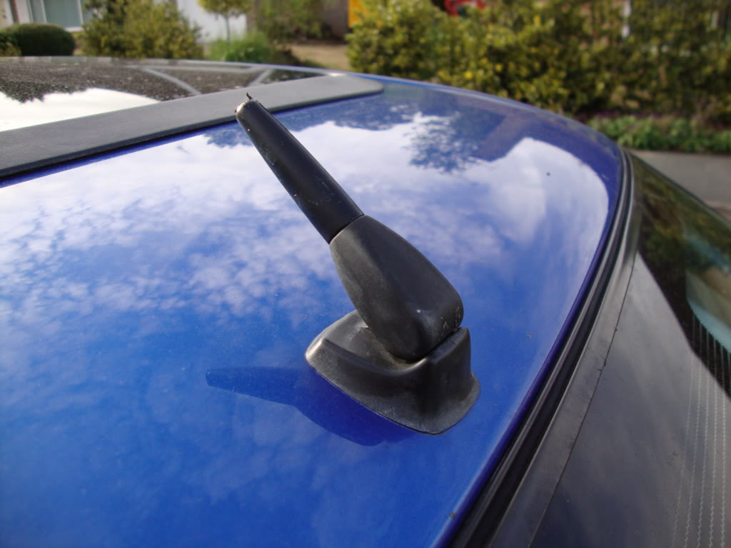

Not much really but managed to fit my brand new ax ariel blank.
Before...
And after...

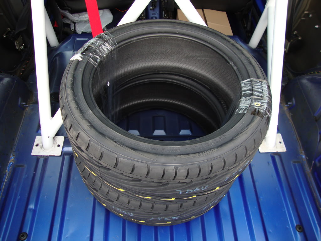

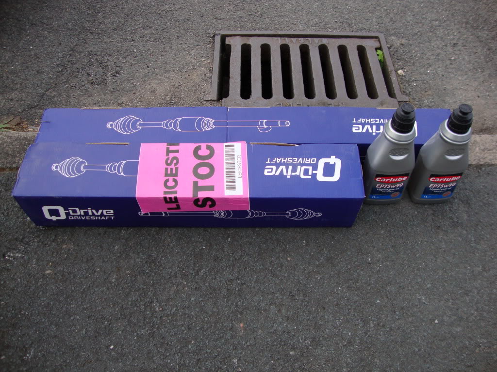

Also got 2 brand new driveshafts with new gear oil and my T1R's..

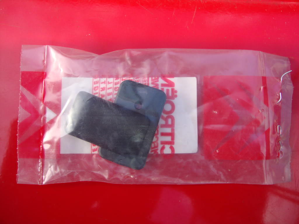

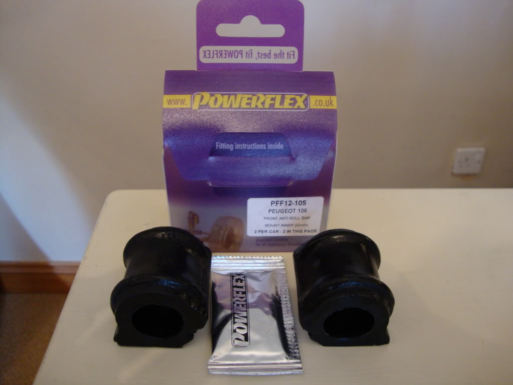

Got my powerflex black shore 95 anti-roll bar bushes finally. There stiff as fook :approve:..

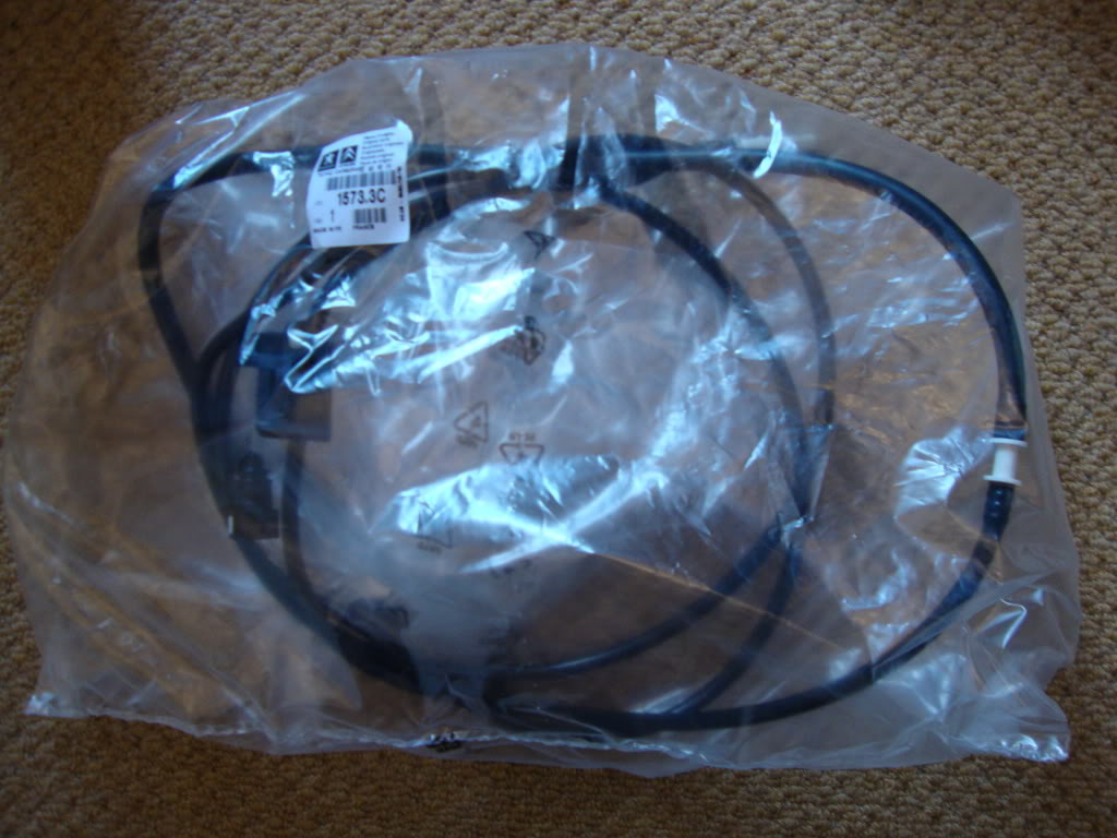

And my new fuel line to replace the split one :eek:..
