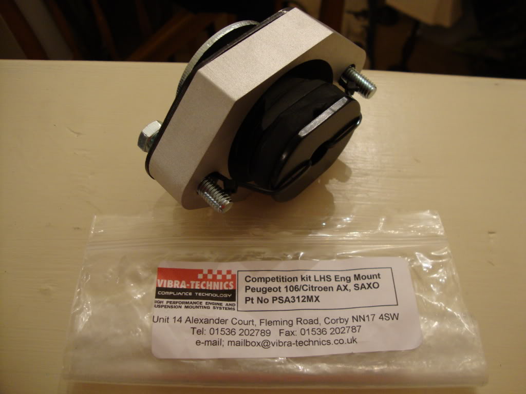

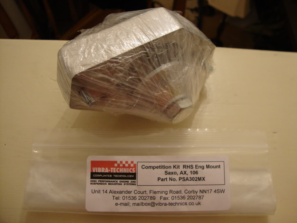

I have also just recieved today from ggr my vibra tech competion mounts. I got the n/s engine mount (psa312mx) & o/s engine mount (psa302mx) for £125 inc vat. I shall hopefully be fitting them this weekend :A:

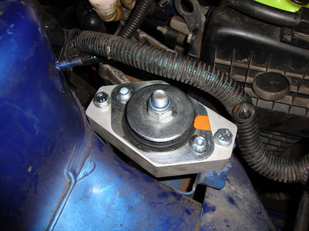

UPDATEEE!

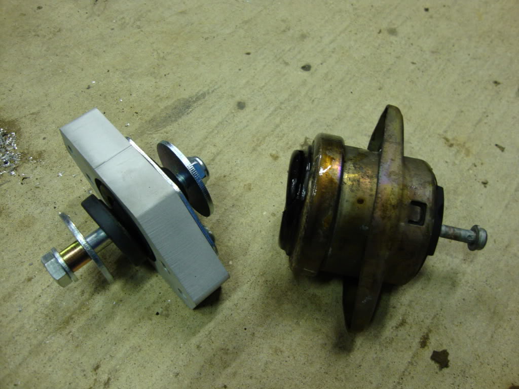

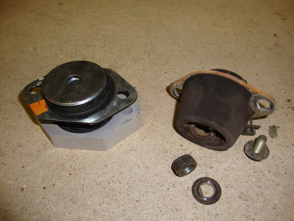

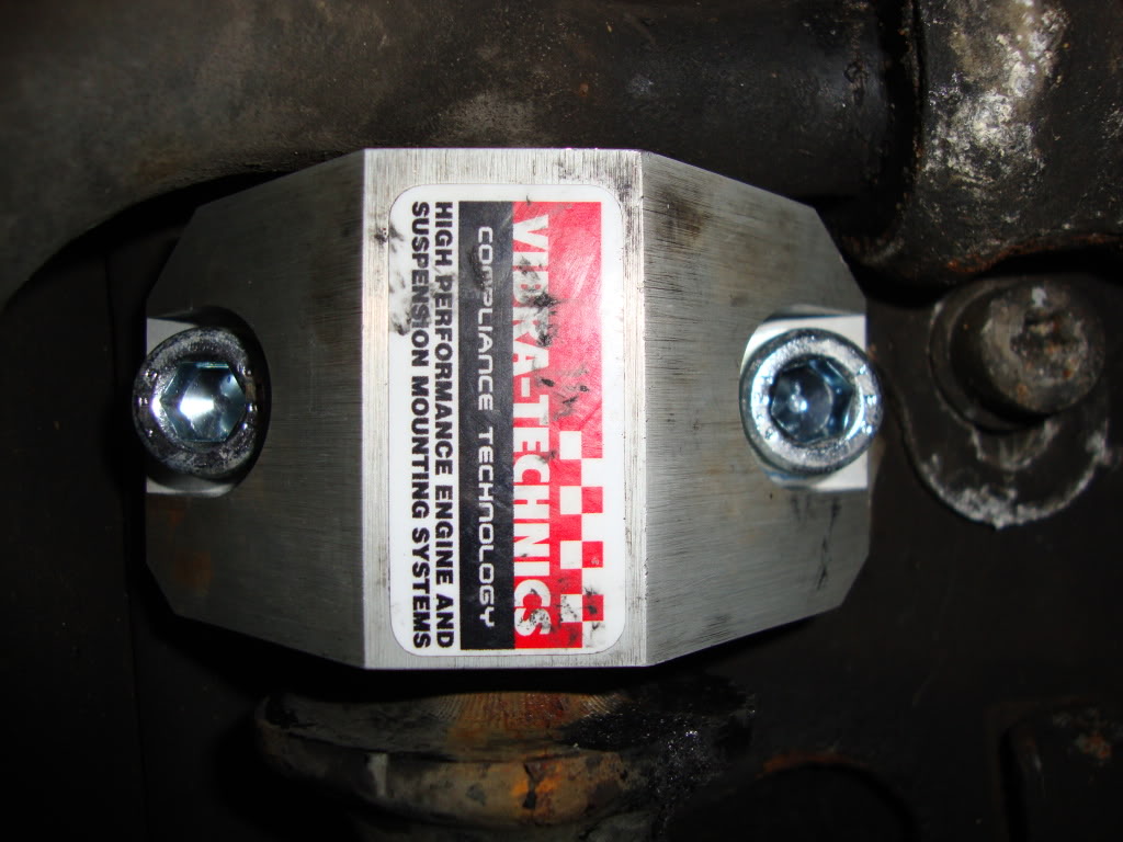

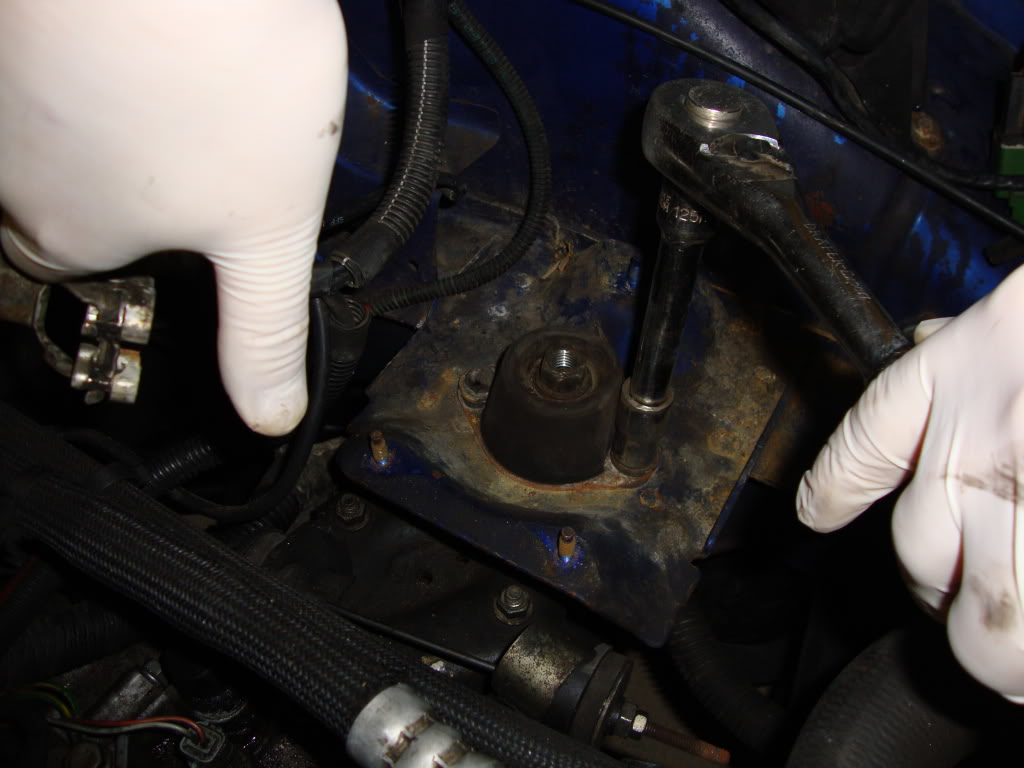

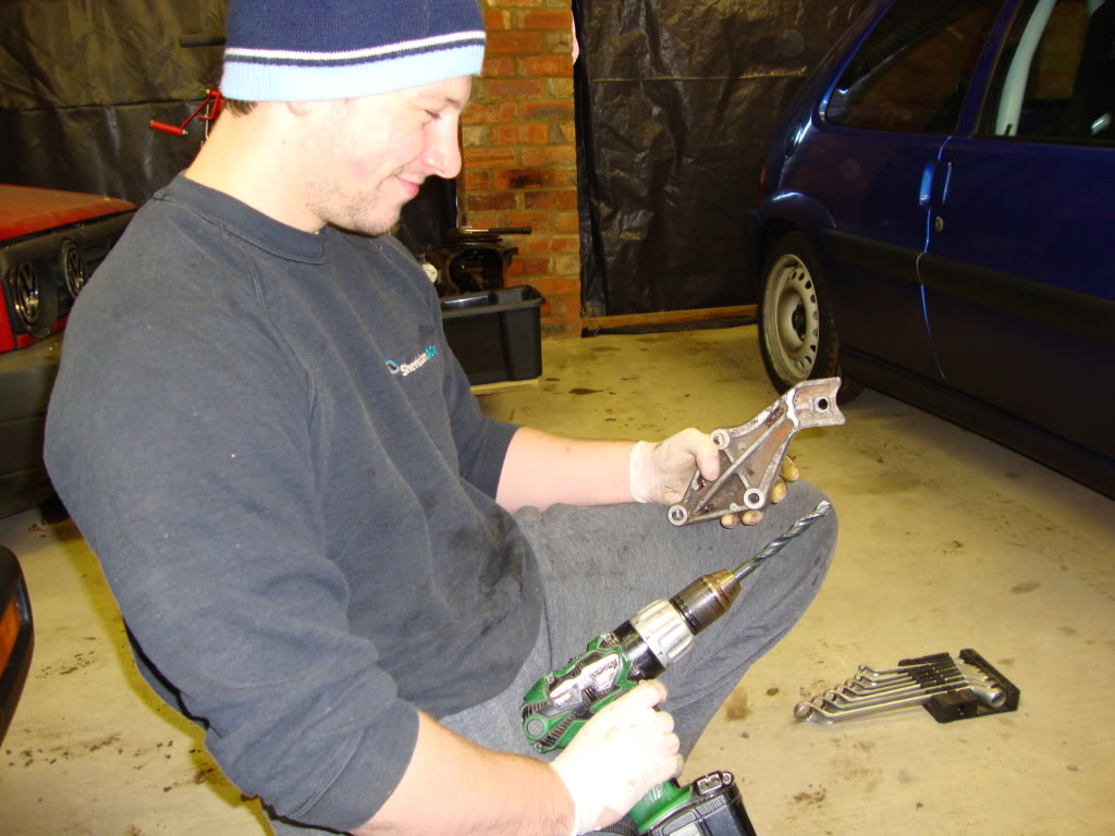

My vibra mounts are on! :A: very happy with how solid it feels now. There is no engine movement atal.
We did the gearbox one first...
The the engine/ecu mount...
We had to drill out the 8mm hole too 12mm..
And no engine movement :y:...

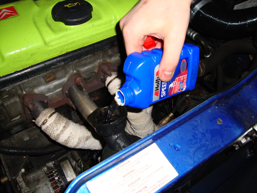

I also got round to coolant flushing the system...
I replaced the coolant with longlife antifreeze and water 50/50. Hopefully ill have some more progress towards christmas when i have some money to play with ;)

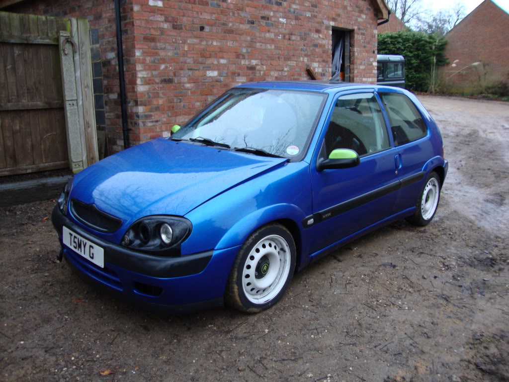

Had a chance too clean the car as ive not done it for 2 weeks :wall: it was pretty s**t up....
And after :)....

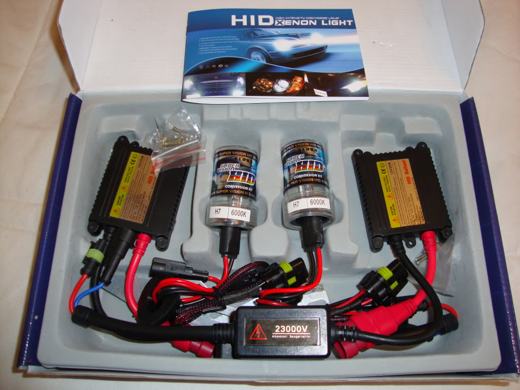

Iv'e also just got my h.i.d's from saxo_67 (saxp) today. I got the h7 6k's to go into the outer optics on the morettes....
Should hopefully get them fitted this weekend and ill be able to see were im going at night lol.

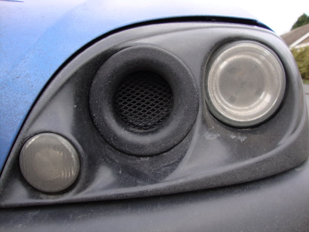

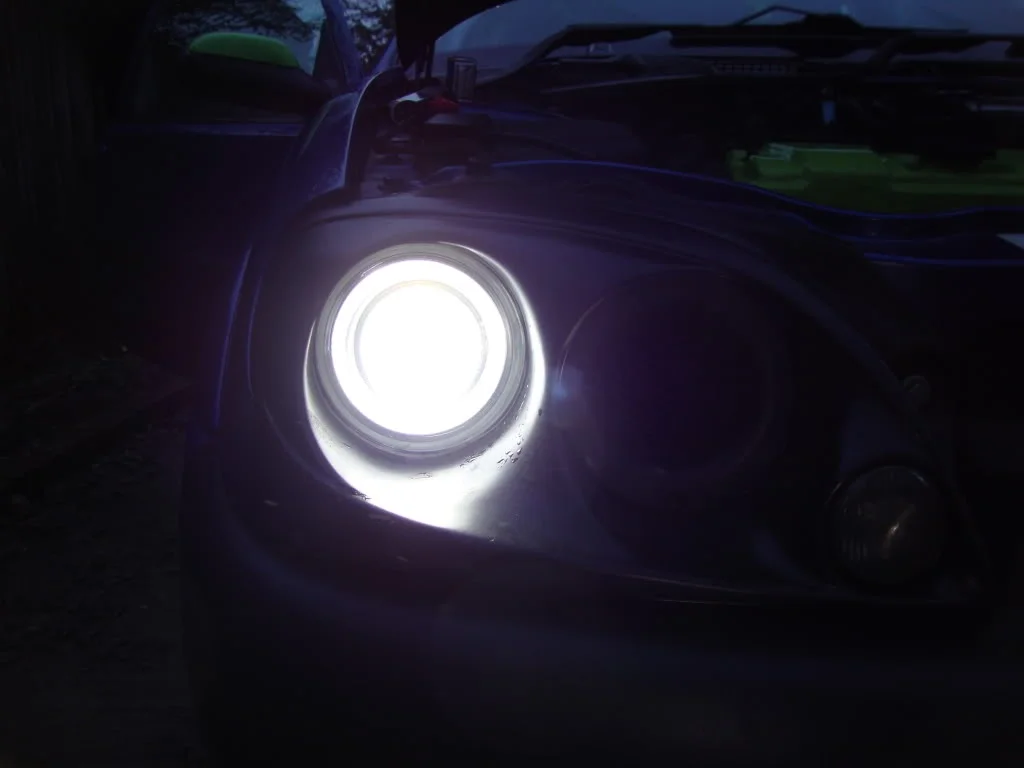

I've fitted my hid's. They've made such a difference.
Before....
After...
Left bulb/Right hid...

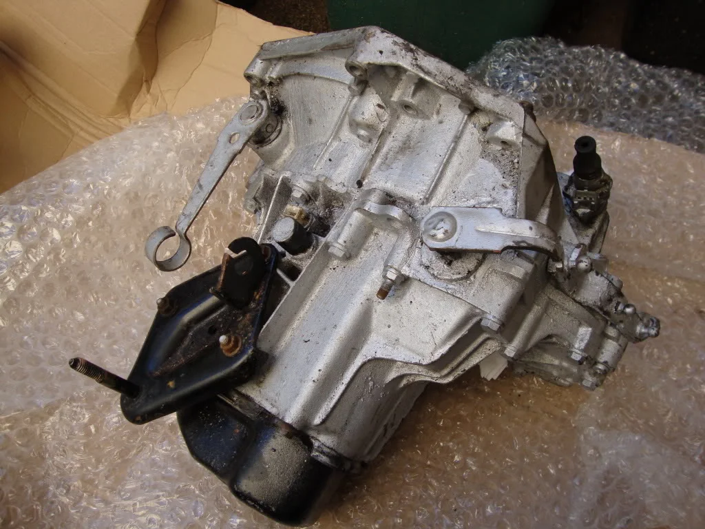

The rallye box i got turned out not to be a rallye box so the chap is refunding my money. :y:

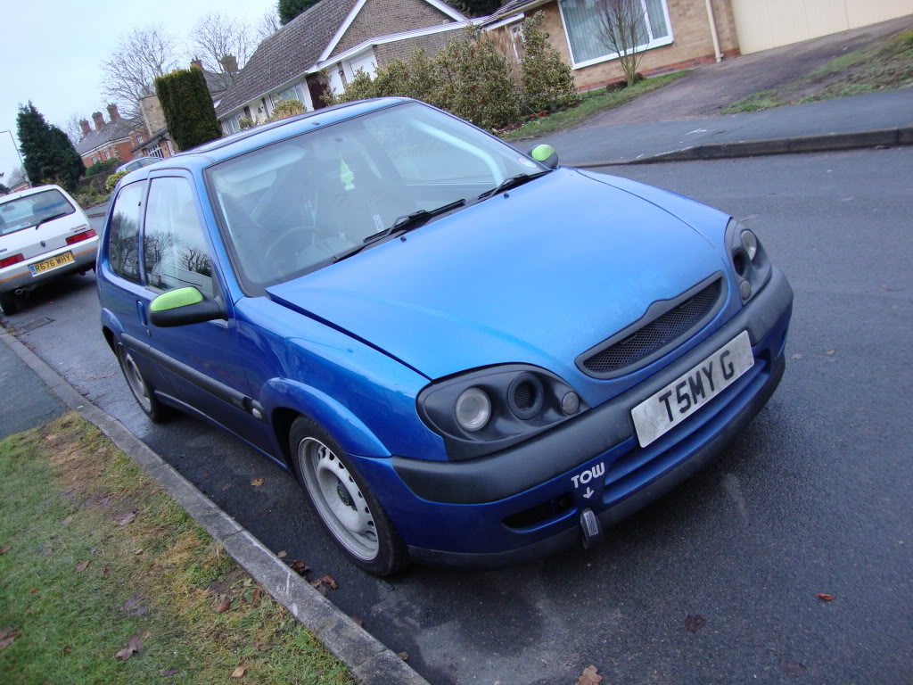

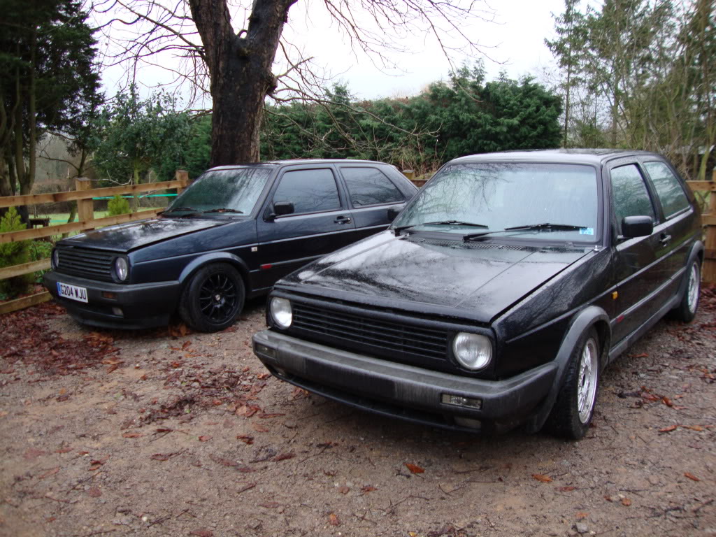

UPDATEEEEEEE!

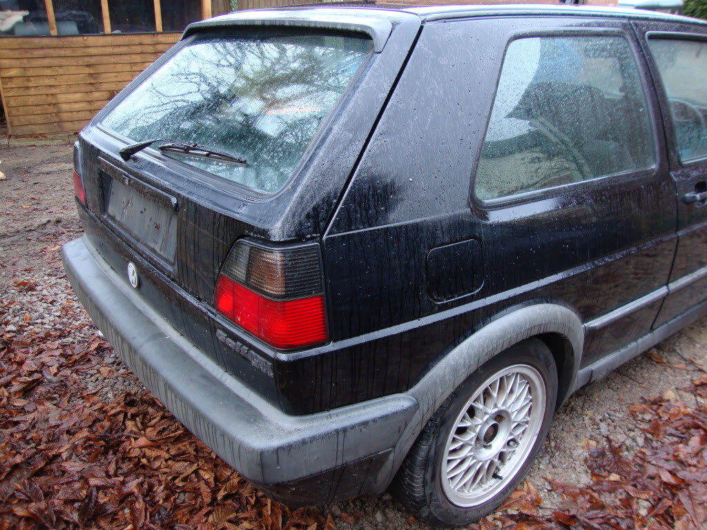

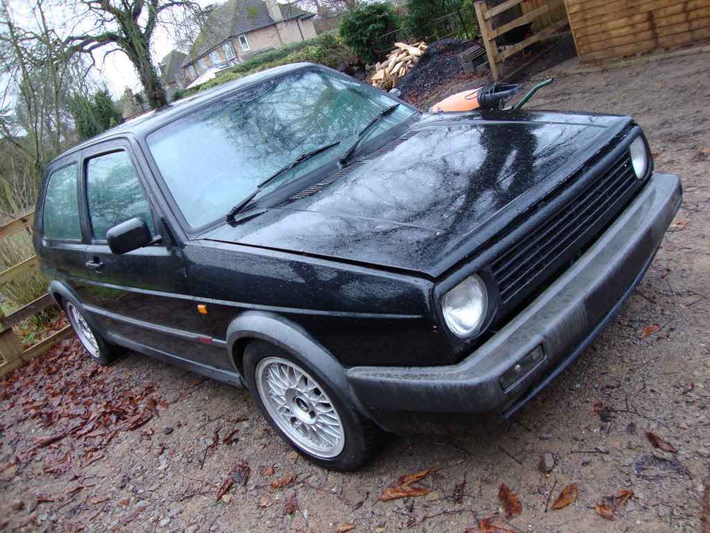

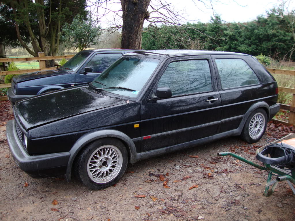

I managed to get some quick pics of the new golf in the rain and looking sorry for its self. The bonnets not shut and the front bumpers not fixed properley....
Shes a 91 8v gti. The shell is mint for its age but the paintwork needs a good detail too bring up the black again. I got the car with a blown head so im going to pick up another 8v lump tomorow. The engines going too have the headgasket replaced and have the cambelt/waterpump etc etc done. Ive got everything ready to go to get the engine mint. Iv'e also got a new clutch for it. The plans are basicilly oem+ but this will be my daily so it has to stay reliable for the time being. I will start a new progress thread for the golf tomorow when i take pics of all the parts ive just got for her as well as the work.
I also got a quick pic of the sax ;)...

i hated my old rallye box the ratios were mega small and would be at like 5k at 70mph it was daft if my 16v wasnt a daily id stick one in would be immense but to live with day to day feck that lol

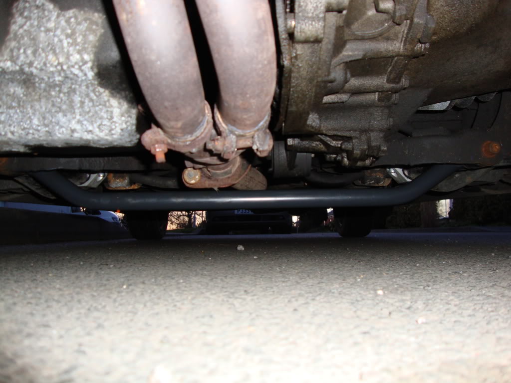

Iv'e had a Spoox 25.4mm rear antiroll bar fitted. The difference is immense, well worth the money and has tightend the rear end. Unfortunatly i didnt have my cam on me so no pics of the bar :( I also recived my limited edition omp upper & lower strut braces in antracite. I've only fitted the front but its made the front end alittle stiffer...

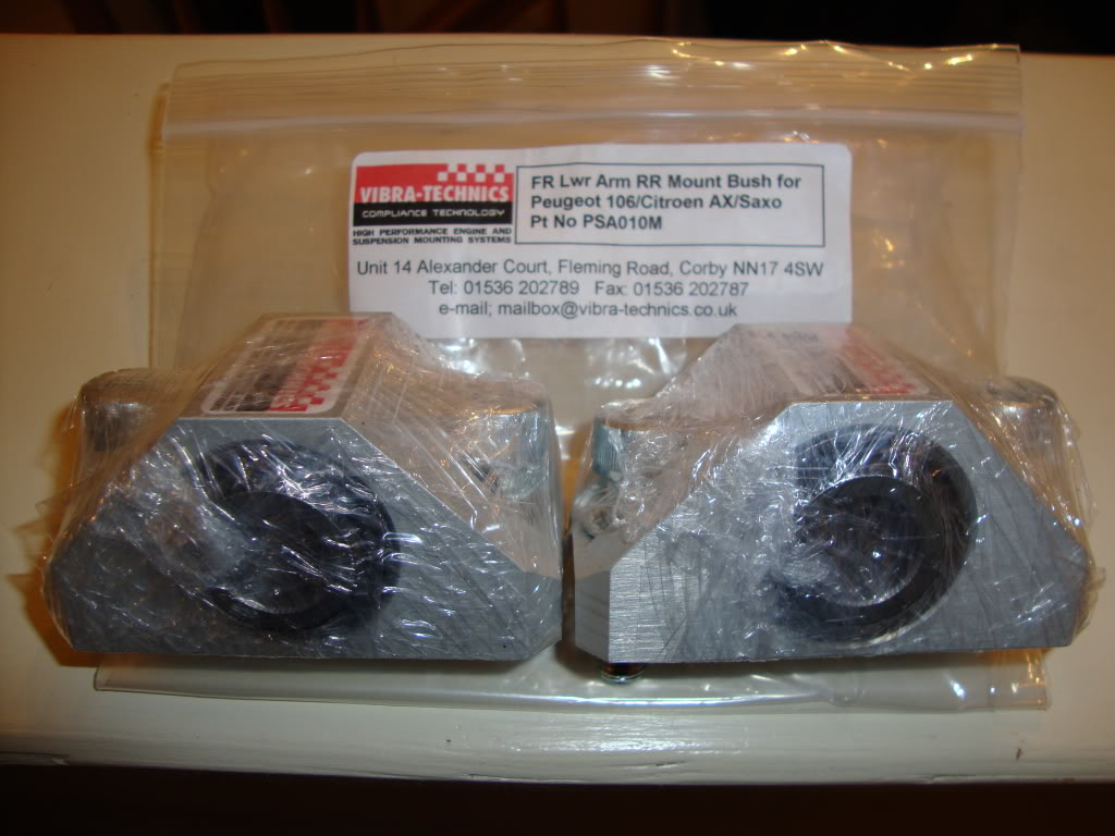

I also recived my vibra wishbone mounts...

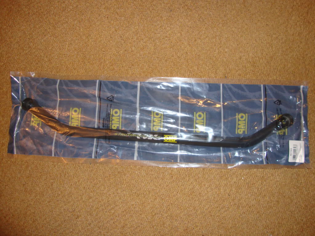

UPDATEEE!

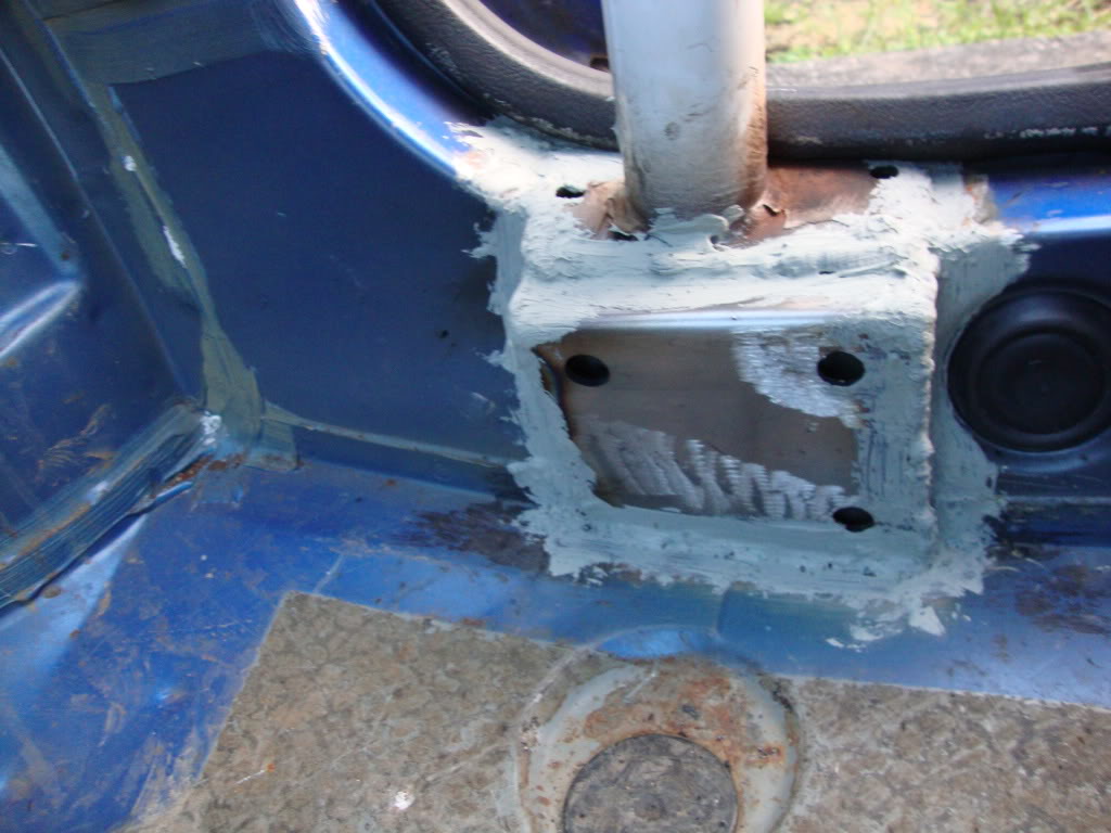

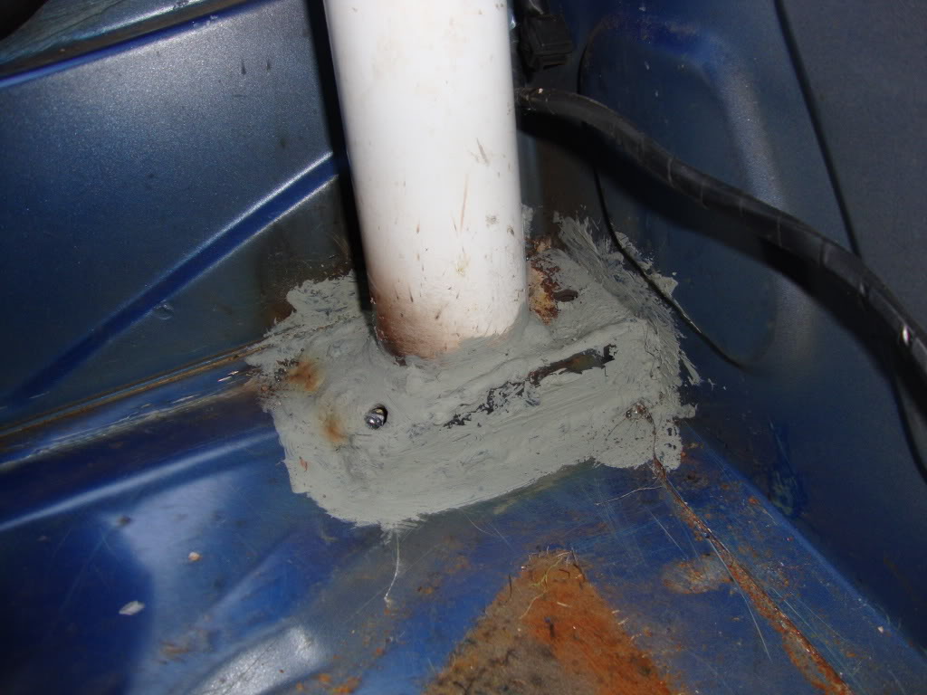

Just got back from Spoox. Iv'e had some welding done on the cage. They have box sectioned the front legs and the b pillar legs as the b pillar legs were shocking before. They look alot better now Daz has sorted them out. He also Welded strenthening plates underneath, for the b pillar legs. The vibrations in the car has increased so the cage is obviously stifer. While i was there i got them to fit the vibra wishbone mounts and the lower strut brace. I havn't had a chance to test them out yet but hopefully they will of made a difference.
Front leg box section (grey stuff is seam sealant to prevent rust obviously it needs sanding over & painting over)..
B pillar leg..

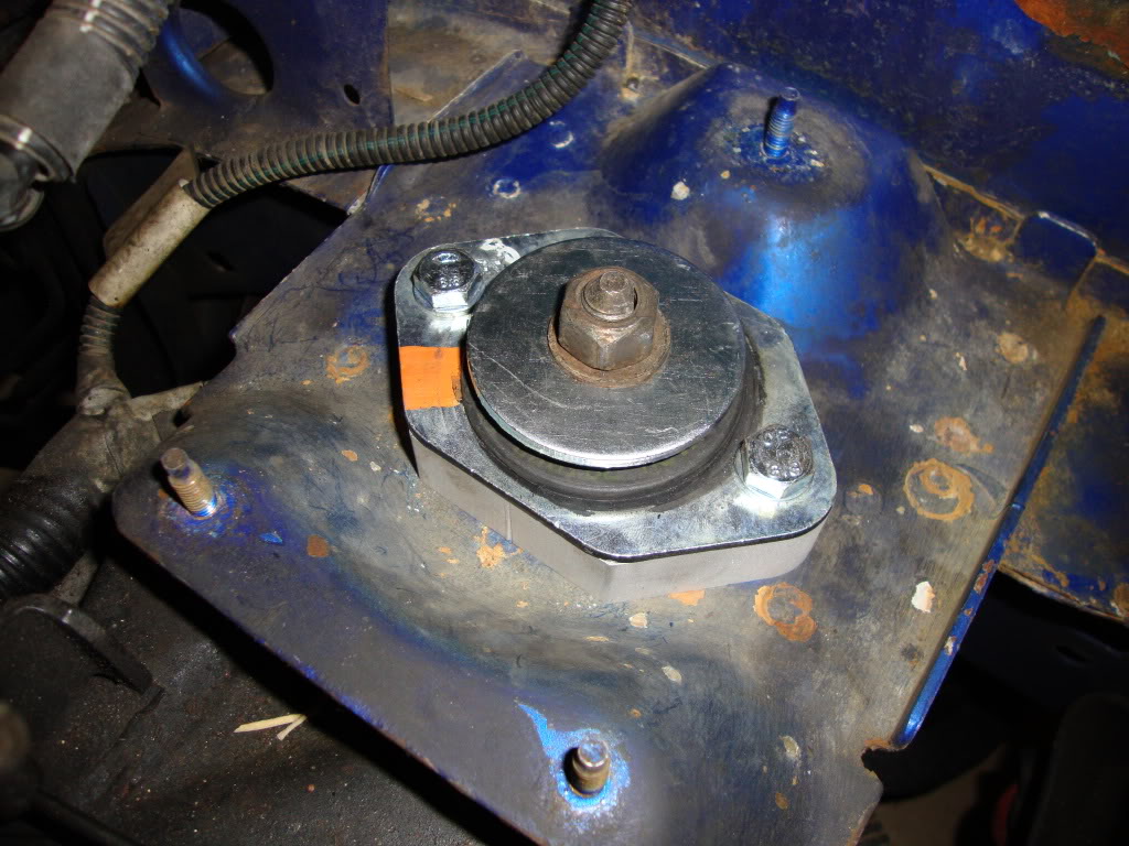

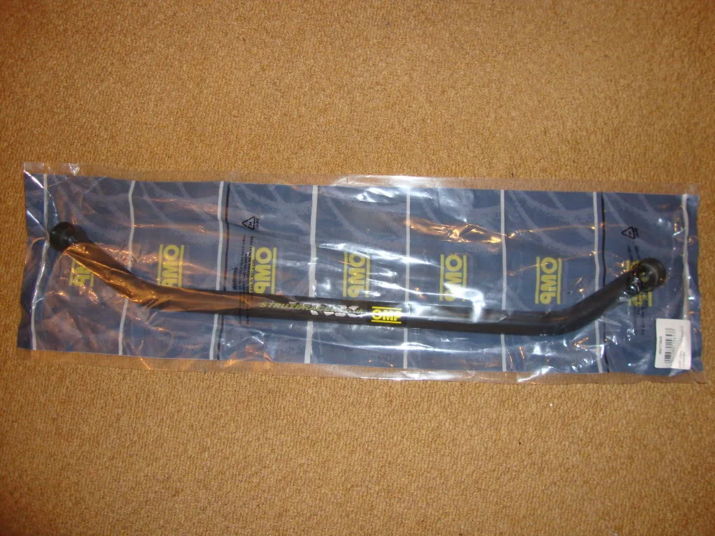

The omp lower strut brace fitted & vibra wishbone mount..

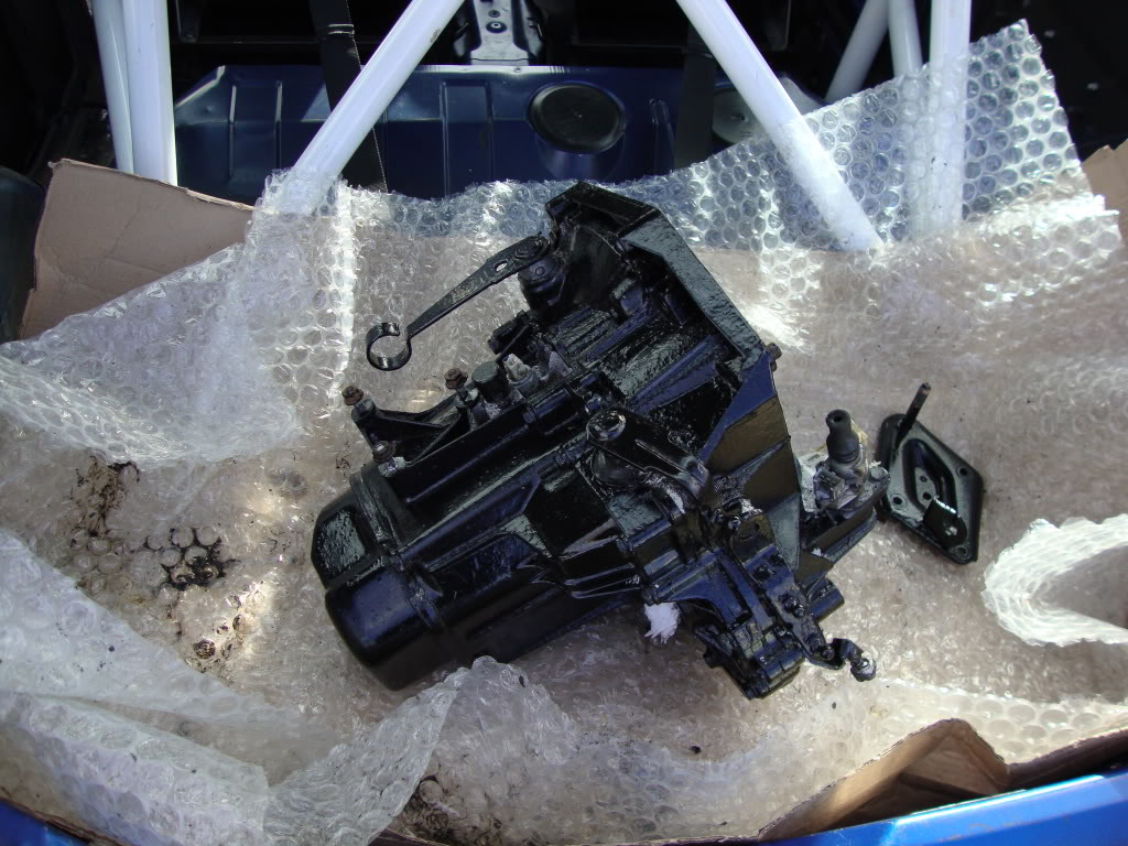

I also managed to tidy up the cb99 box. The box is now at Spoox so they can strip it down and inspect it.
Before....
After....
I only gave it a quick coat (brushed on) but it looks alittle better than before. I got a valeo clutch kit aswell for when the box gets fitted...
There wont be any progress really until i get the front polycarbs from Spoox hopefully friday time.

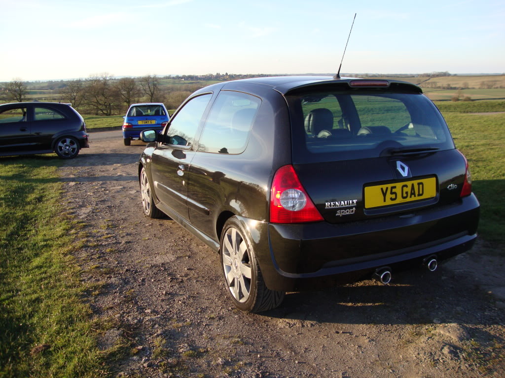

Went to gumley road on the weekend for a few pics with a couple of mates. One had a clio 182 and the other a corsa sri 1.8. Awesome road for abit of fun and the scenery is amazing, you can see for miles.
And just to show how beautiful this place is we found this…
Safe sex ftw!
I have some video's which ill upload later aswell.

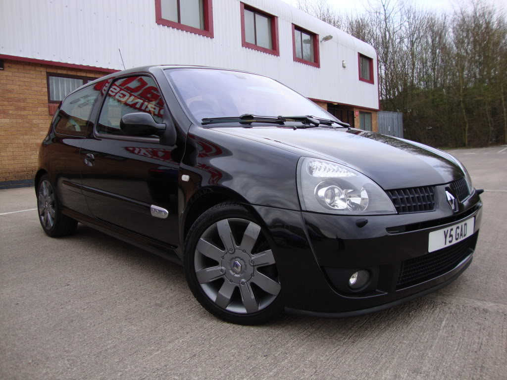

Is that Rich Treen's old 182?
Hixle
Hi Kiss Luke E****
  981 Cayman GTS
Re: GT Creations (T5MY G's) Poseidon Traxo Vtr - (Going Into Hibernation!!!)
Did the Corsa driver forget to wear trousers?
Saxo's looking great mate, bet it's a hoot to drive!
  182 Cup/Mk5 Gti
Im not too sure Gally, it recently got featured for a buying guide for the 182's at rockingham. He's put his private plate on thou so i dont know the original reg.

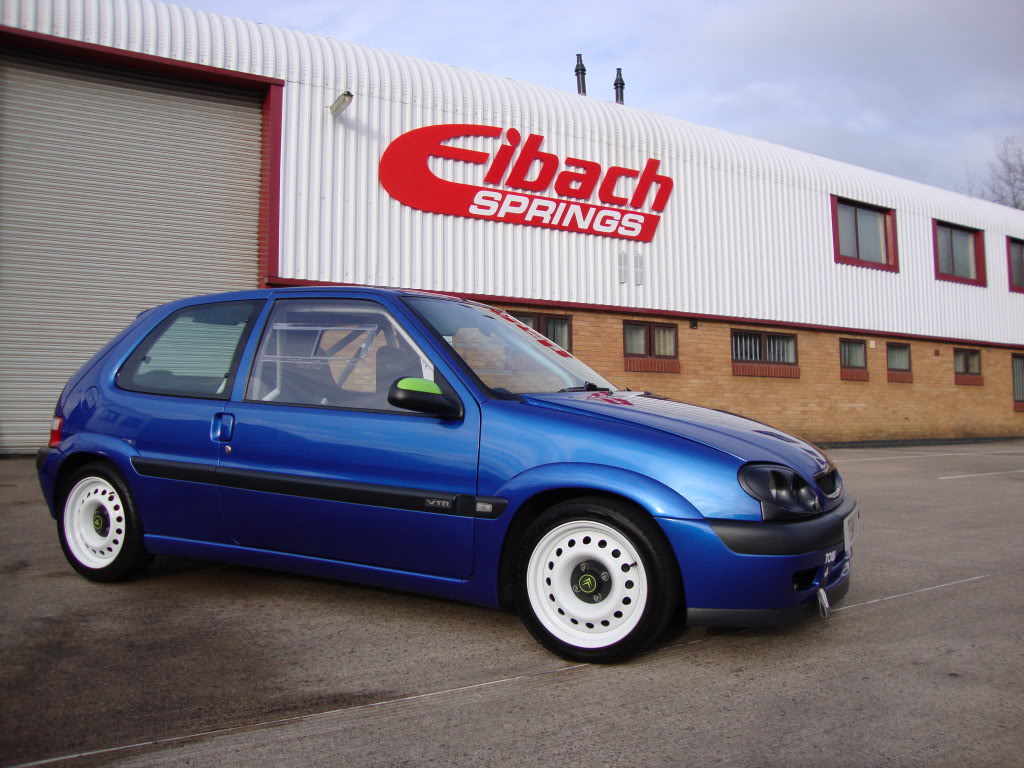

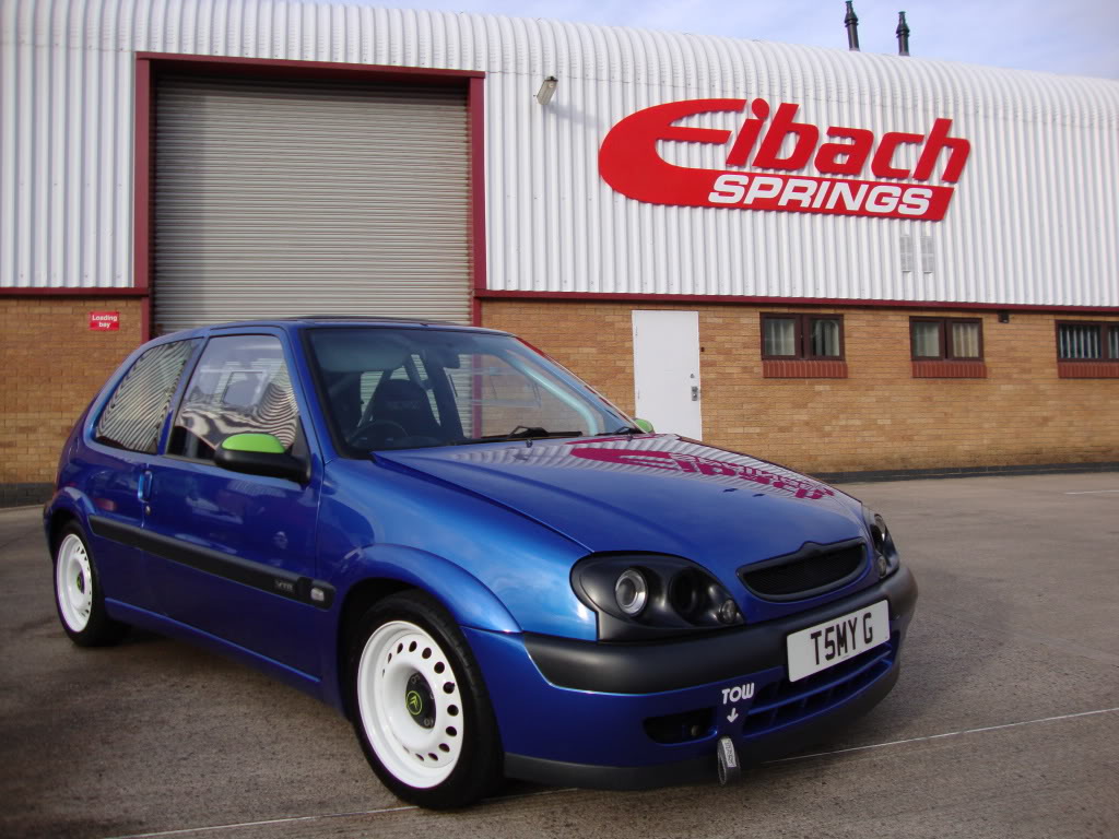

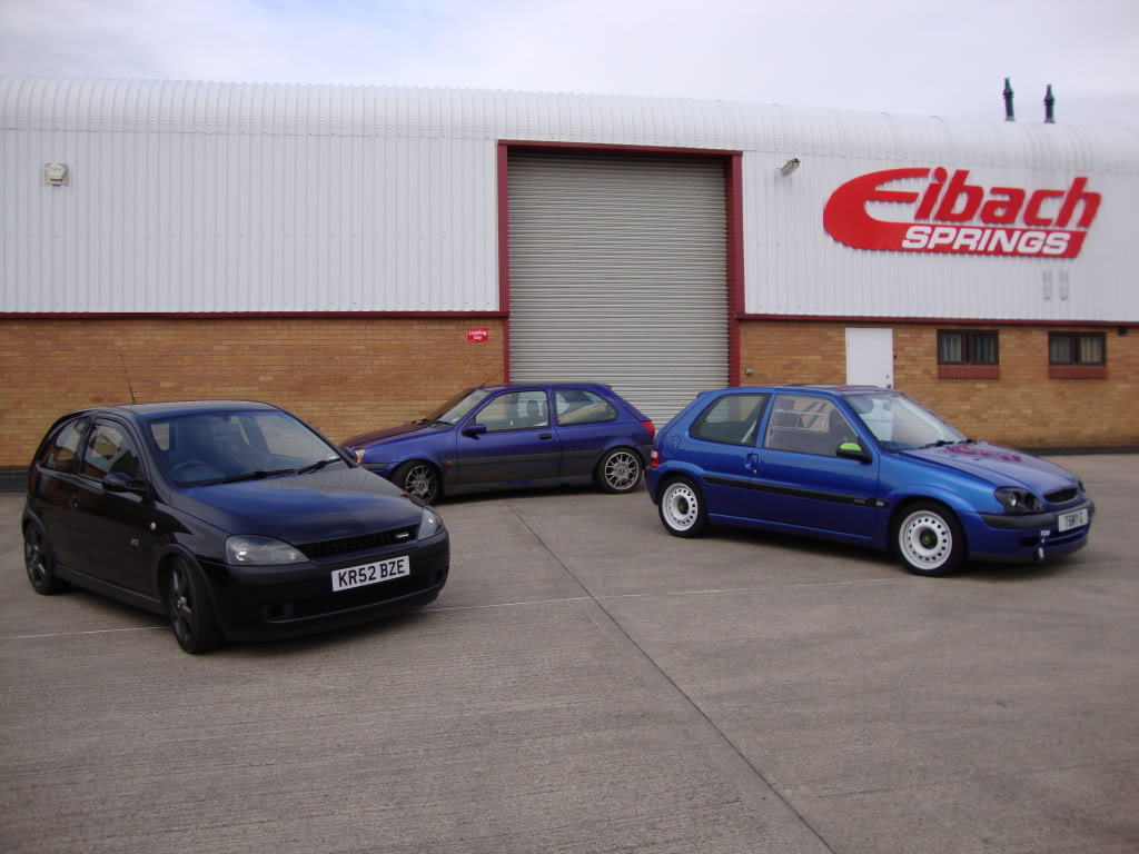

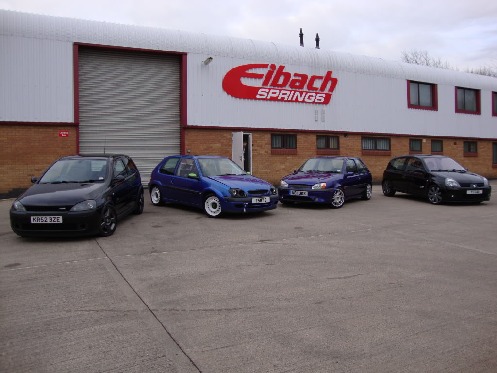

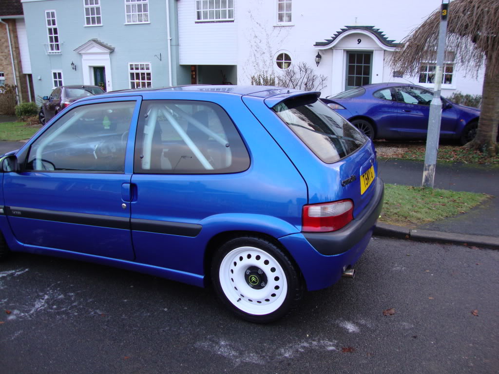

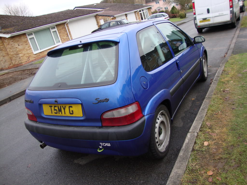

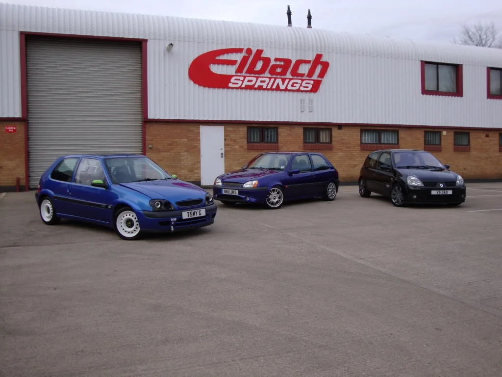

Went to Eibach on sunday for a car wash session with some mates. Took some pics...
Before the wash...
And after...

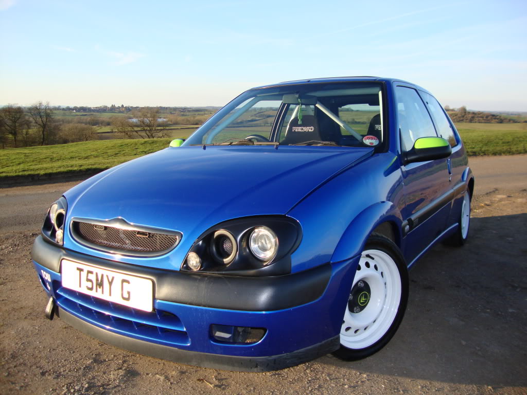

You will of noticed i have fitted my spoox polycarbs. I saved 4.450kg's by swapping the polycarbs for the standard glass and removing the reg and motor. I am taking the polycarbs back thou for a refund, all will be explained shortly. I had a nice conversation with chris at temple rally and im getting the polycarbs from him aswell as the rose jointed gear link kit. The box is hopefully going to get started by the start of next week. 1st and 2nd have worn and the syncro. Reverse also needs changing. I will also be changing the crown wheel and pinion to a cb90 s1 rallye. so the box will be exactly the same ratio as the cb90 which is what i wanted in the first place. I will update on the 28th (pay day) ;)
  2.2 bar shed.
Eurgh, having had experience with the gearbox thats in these I can safely say im glad to see the back of them. Syncro for 2nd shitting out on me resulted in some fantastic stuff.
  182 Cup/Mk5 Gti
I know what you mean Sam they are s**t.

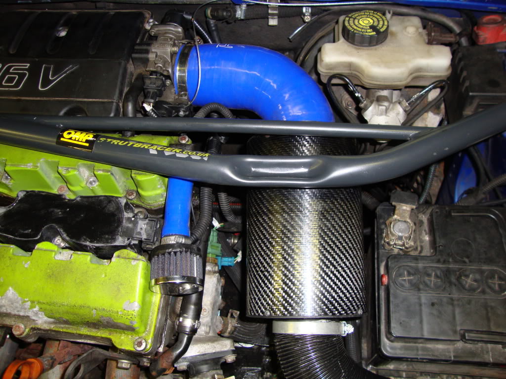

UPDATE!!!!!
Right ive finally managed to get some time to update the thread.

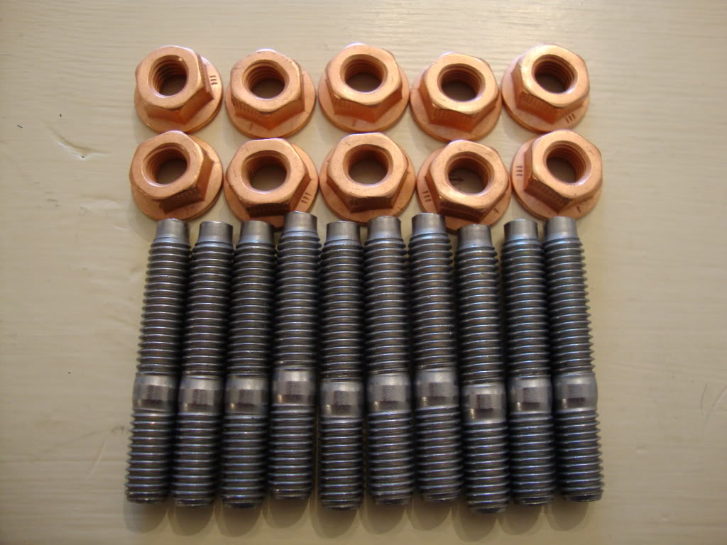

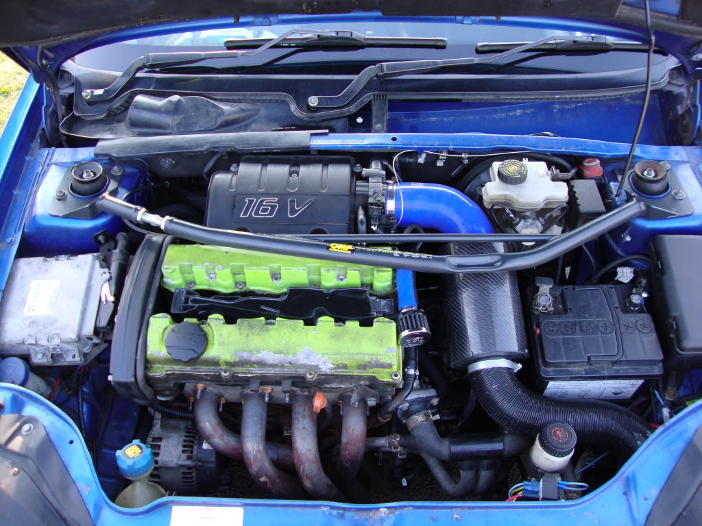

I had the car booked in to finally get a 16v conversion. Ilkestone autocare had a donor car so i had the engine out of that. The miliage on the donor car was 72,000 so a decent miliage engine. I also had the

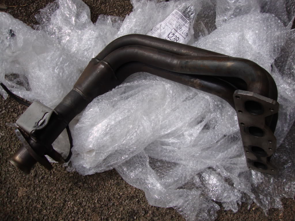

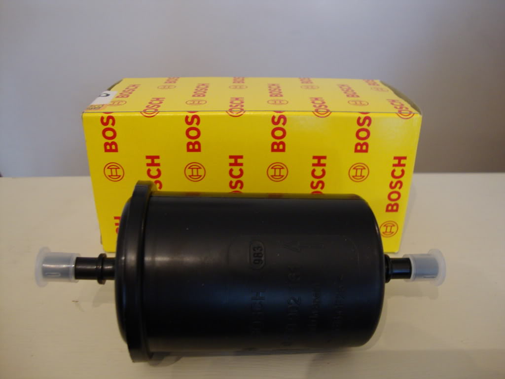

Heres the parts i gave to ilkestone autocare for the conversion...

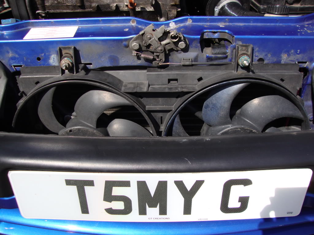

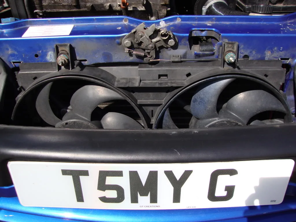

I gave him a piper 4-1 manifold, nissens radiator and twin fan setup which i got from Ali. I only have a picture of the manifold..

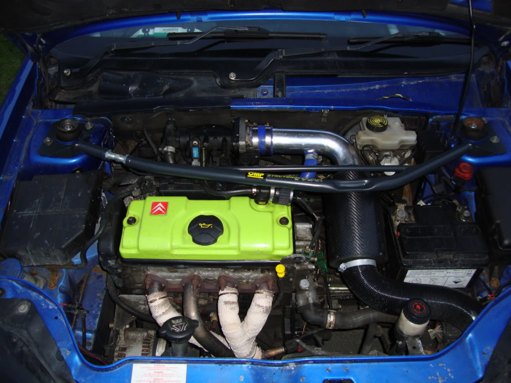

I've done about 500 miles on the engine now and its running spot on. The idle is alittle lumpy sounding so it may have a mild cam. I had a few litle hick ups with the car stalling and overfuelling and smelling rich. We had the coil pack changed, idle control valve and the ect sensor and it has sorted it:y:

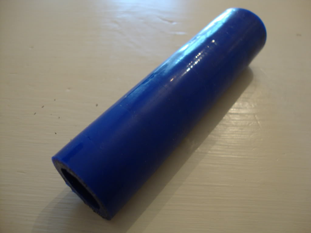

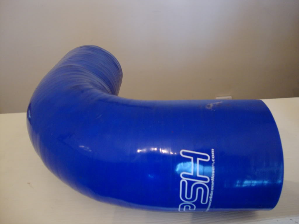

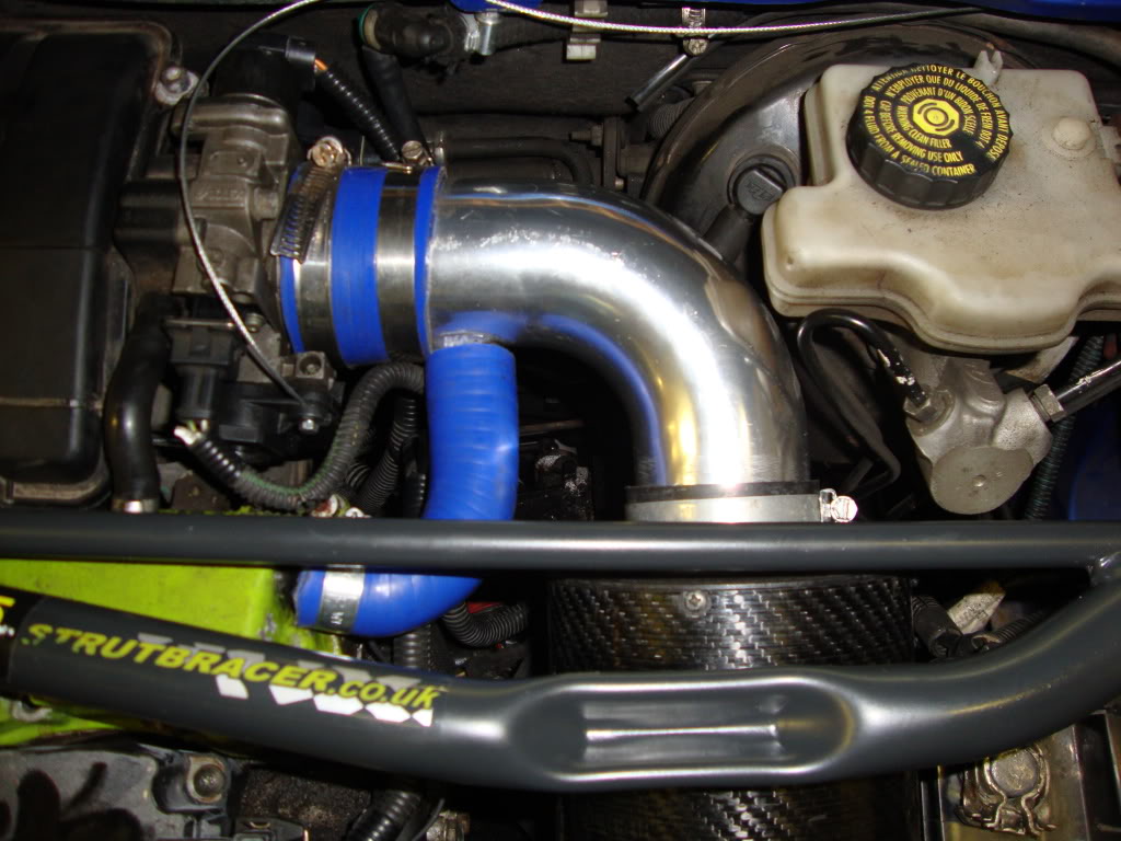

When i got back i fitted the silicon hose and the breather. It went from..
To this..
Picture of the twin fan setup (Cheers Ali)
It is much quicker now and im glad i chose to go 16v. The noise is now alot louder and it sounds gorgous.

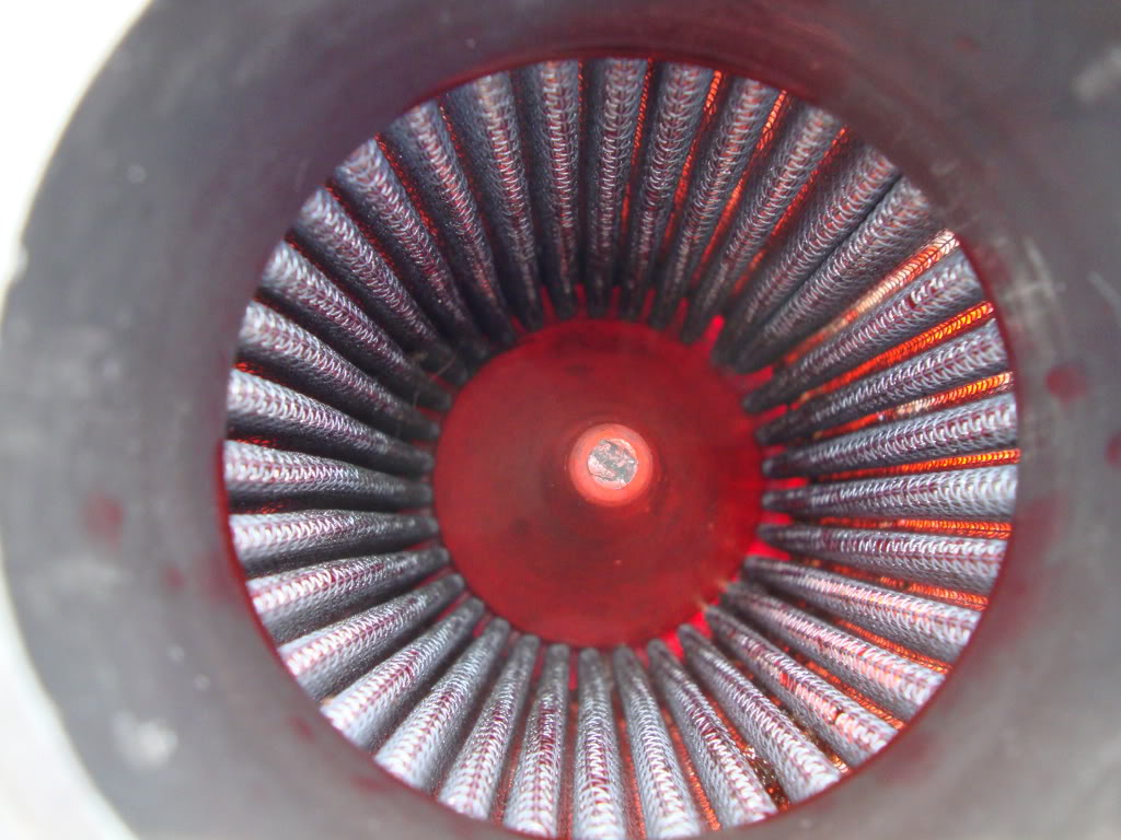

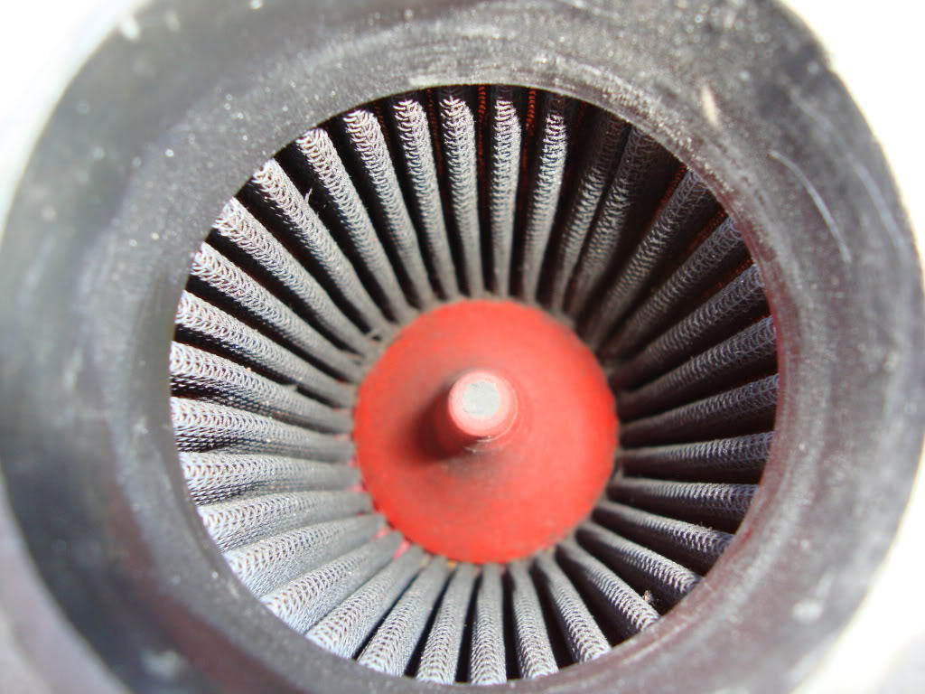

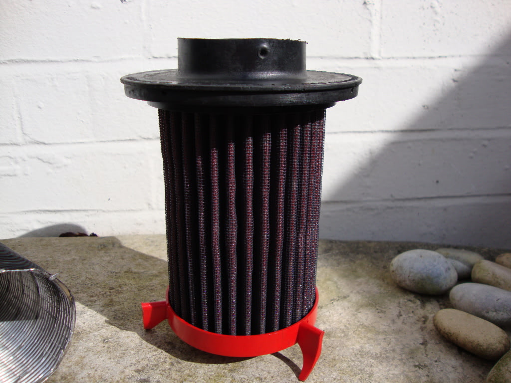

I cleaned the bmc filter out. Before..
After re-oiled..

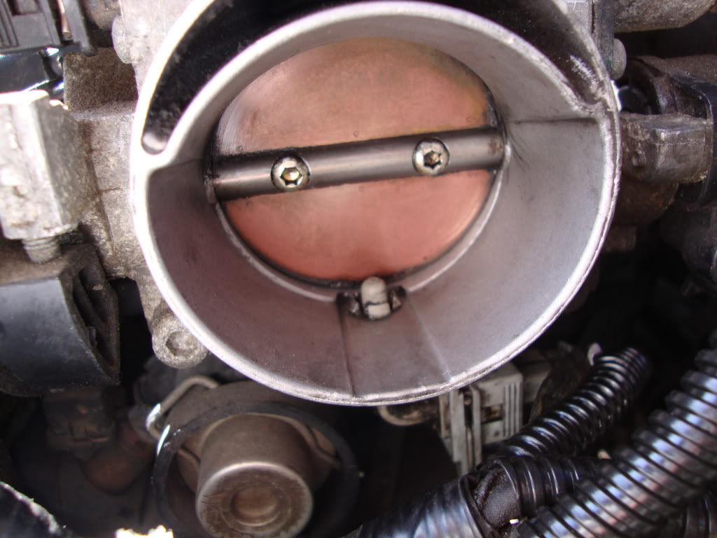

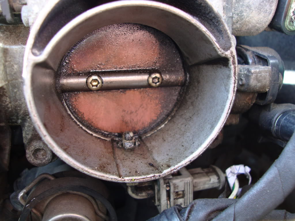

Whilst the filter was off i cleaned the throttle bodie. Before..
After..

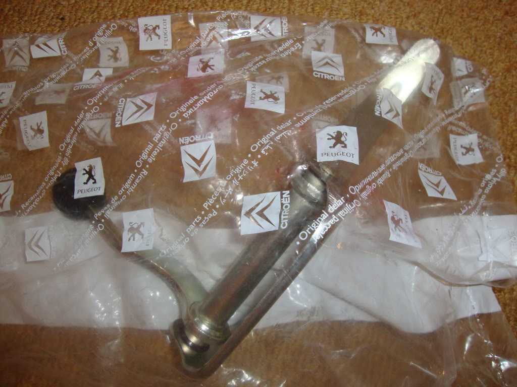

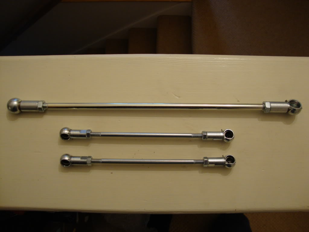

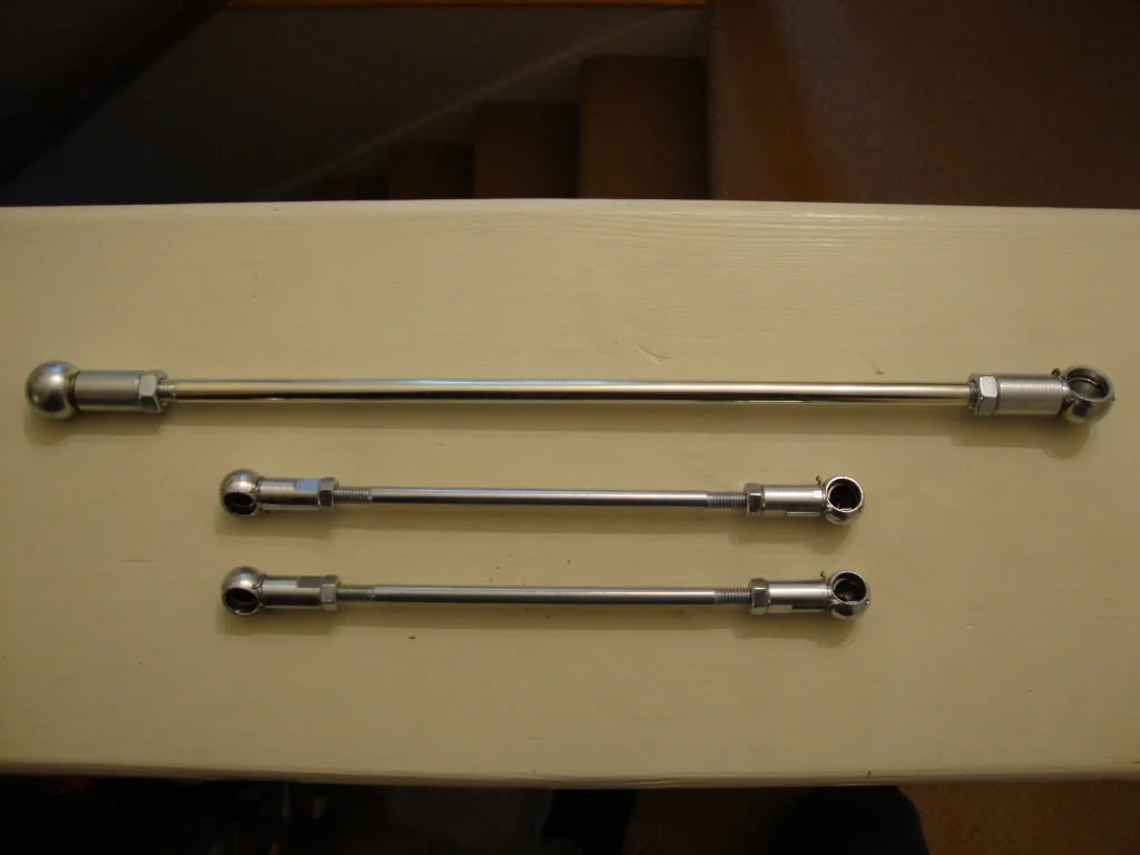

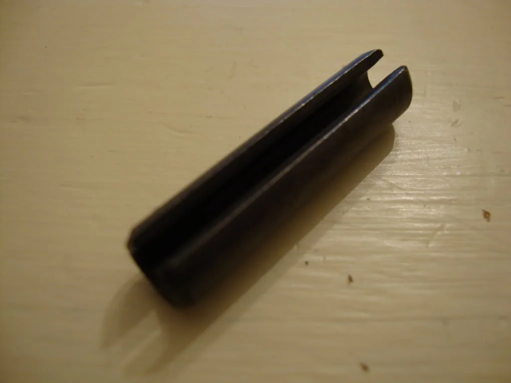

I also got some gear selector parts as i had movement left and right. I got a new roll pin from Citroen. I also got the long rod and lever from Citroen as mine have seen better days. I also got some Kamracing gear linkages so it should be alot stiffer...

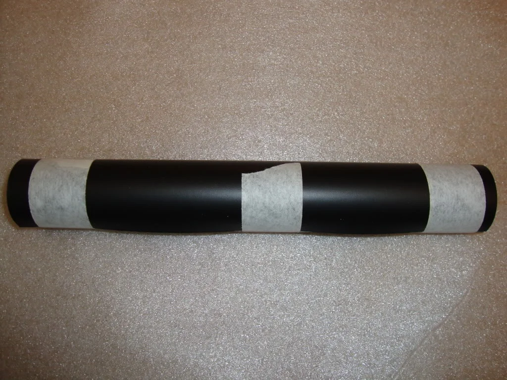

I also have a matt black sunstrip ready to go on..
