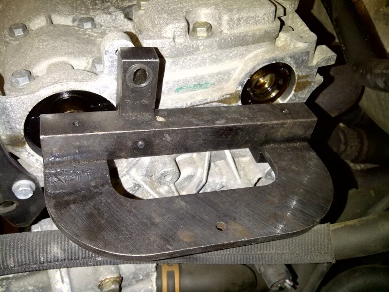

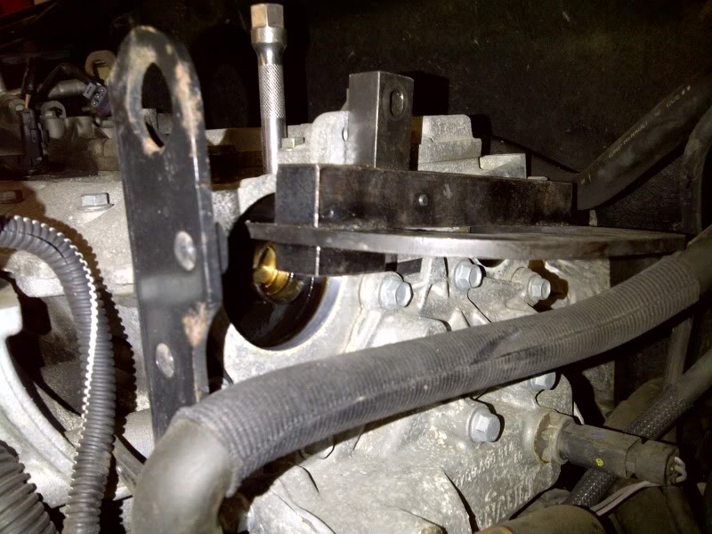

Cambelt changed by a "specialist" just over 12months ago
cambelt tensioner is so off that the belt has been flapping about and that's knackered too, also the aux belt was fitted 1 tooth too far out on the crank pulley and thats been shredded (lucily not snapped)

Man thats f**king miles out tbh, shocking.
  Clio172 / Focus Ti X
Nice one! thats out a fair bit
I dont get it, if people are using the correct tools and tensioning the belt correctly how can they get it wrong?
is this a case of not using the correct tools you think?

Thats miles out, surely the locking tools wernt even used when that belt was fitted.
  ITB'd MK1
looks like the amount it's be out by adjusting the tensioner after taking the tools out. shoddy.

i'm going to see if the grooves in the cams line up tomorrow morning, its as if whoever did it "forgot" to use the crank pin
They probebrly did use a crank pin Fred but if they didn't get it in the correct web it will do that to... seen it myself too many times. Even the manual warns you to check you have actual TDC on 1/4

I have read up how to do it time and time again and tbh it doesnt look right rocket science if you use the tools and follow the proper procedure.
I think where people go wrong on this is taking a shortcut. even by tightening a pulleys too early or not degreasing the shafts when fitting the pulleys. easy steps for a normal punter to not do just to get the car out quicker.
