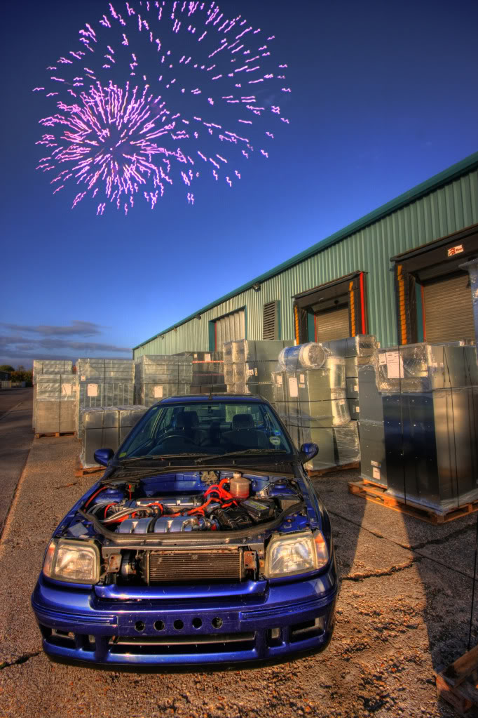

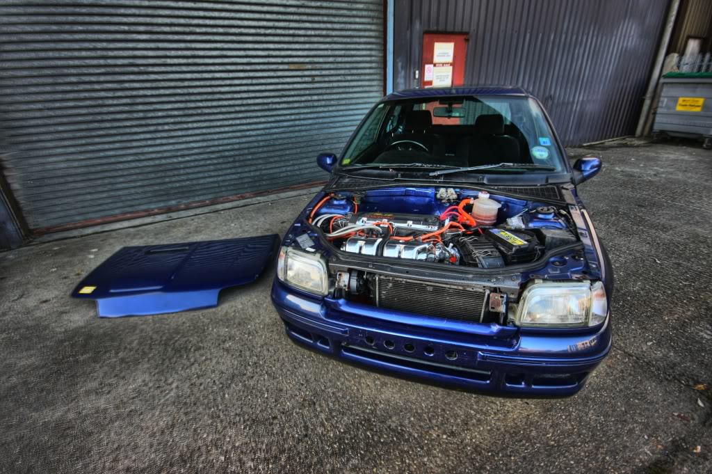

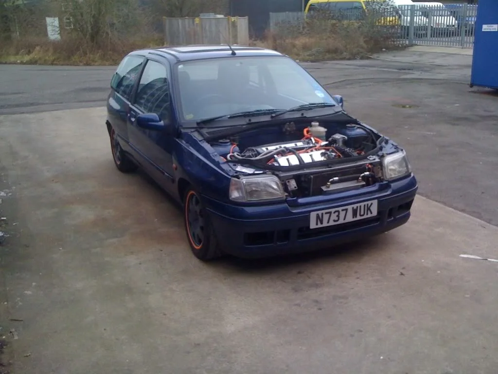

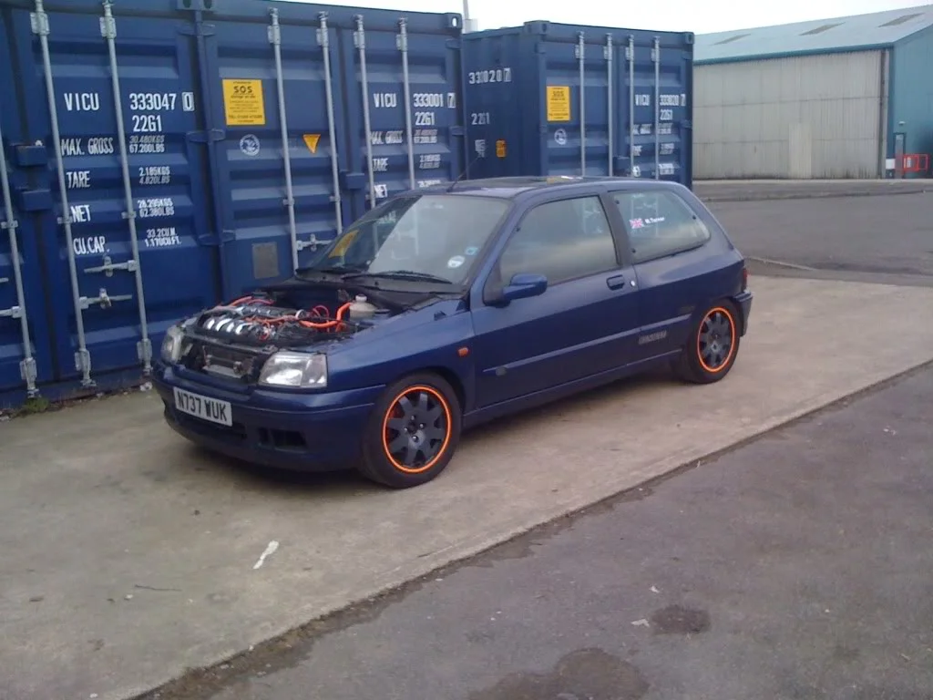

Heres my current mk1
The Wukbrid
Mk1 N reg 432 Monaco blue
2.0 F7d hybrid

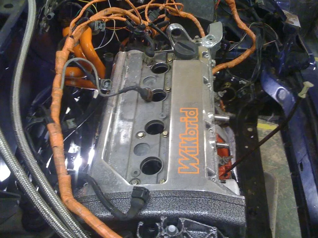

Megane bottom end
Valver Head
Manual steering

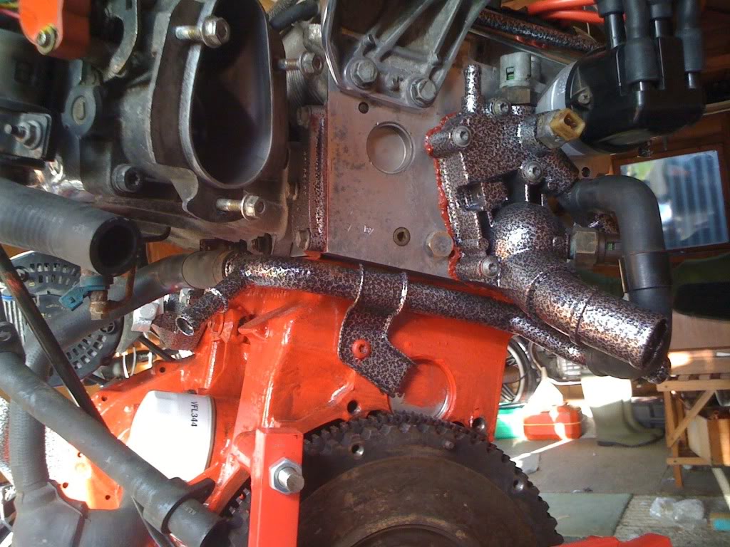

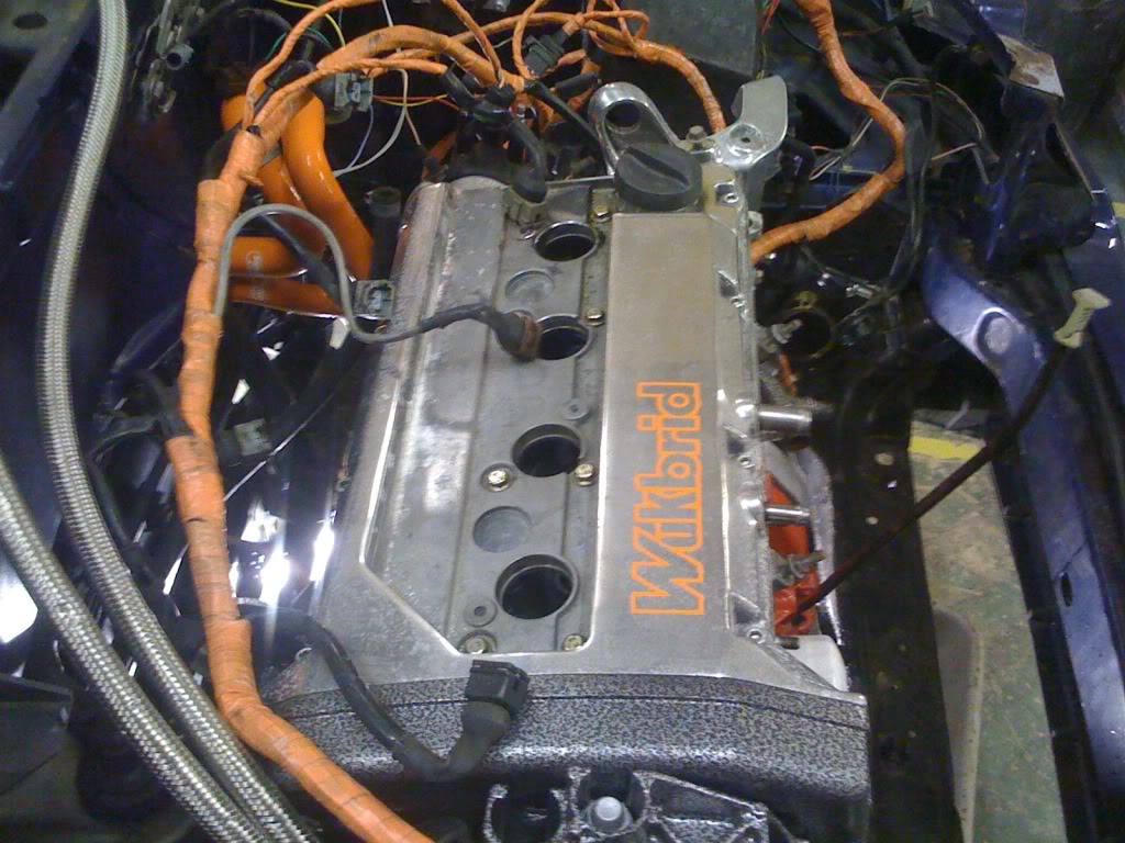

Every bracket or cover or indeed the inlet has been polished or powdercoated in my own colour
Williams wheels powdercoated an SDV-esq grey
Lowered 50mm on koni shocks and springs
Williams widetrack
Welded circlip in my box
Stripped interior
Samco hoses
GrpN carbon intake (to be fitted)
13 row oil cooler (to be fitted)
looks pretty and goes ok ish...... unfortunatly the B/e is actually knackered! just my luck!
on the look out for a willy lump replacement to go back in.
Long live the MK1!

wow engine looks cracking, but wtf are you doing putting your lovely painted bonnet on tarmac. Welcome back.

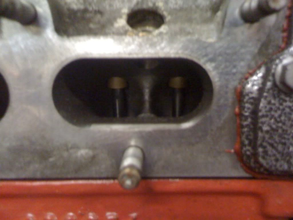

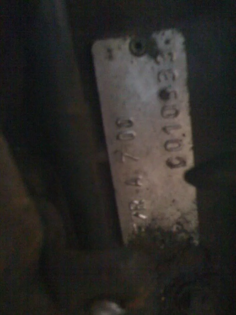

Right then! Update... most know, the engine i fitted was knocking like a b*****d. thought it was tappets to begin with. but alas...no

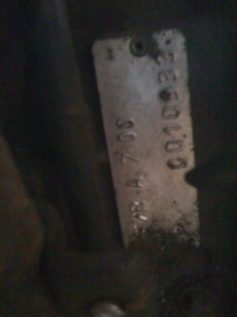

Sooo I decided to stop *****ing about and look for a propper F7R A 700 which i found in telford with a man called dan.

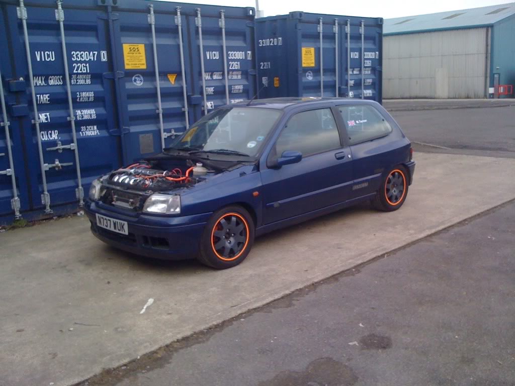

here she is.....filthy isnt she

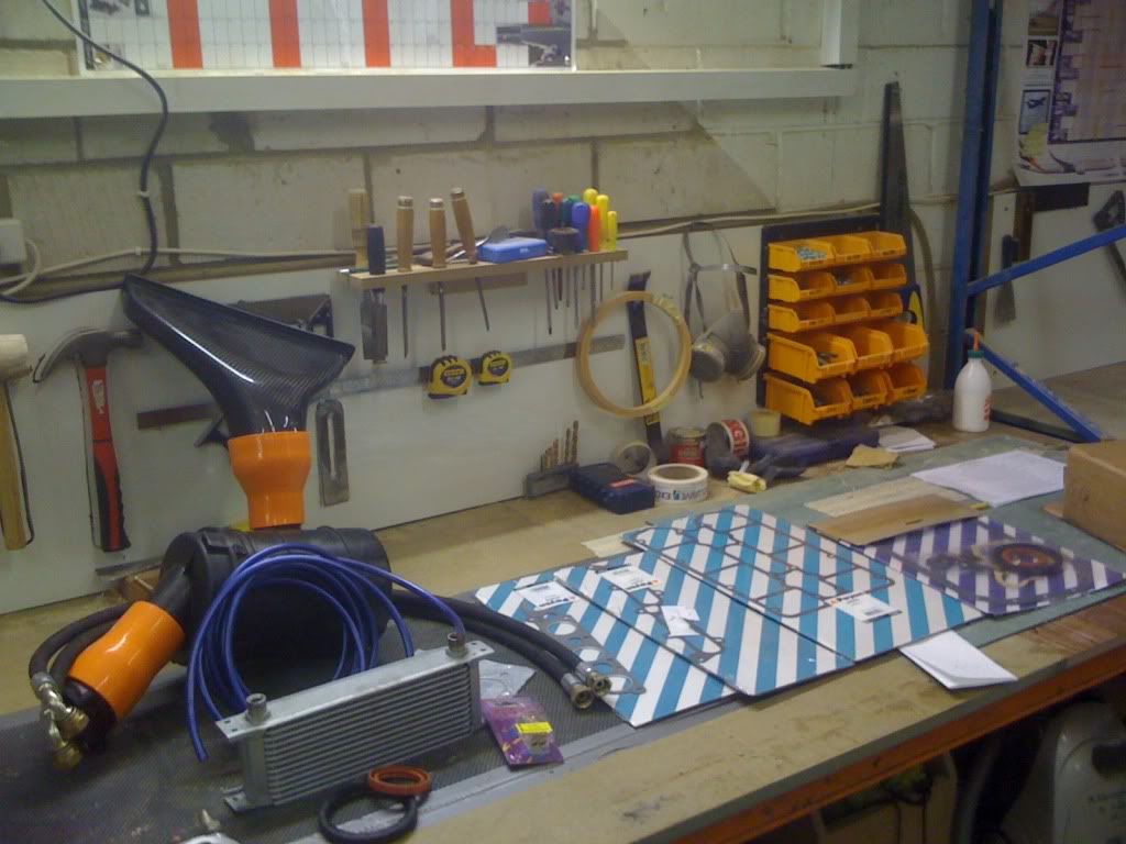

I ordered some parts

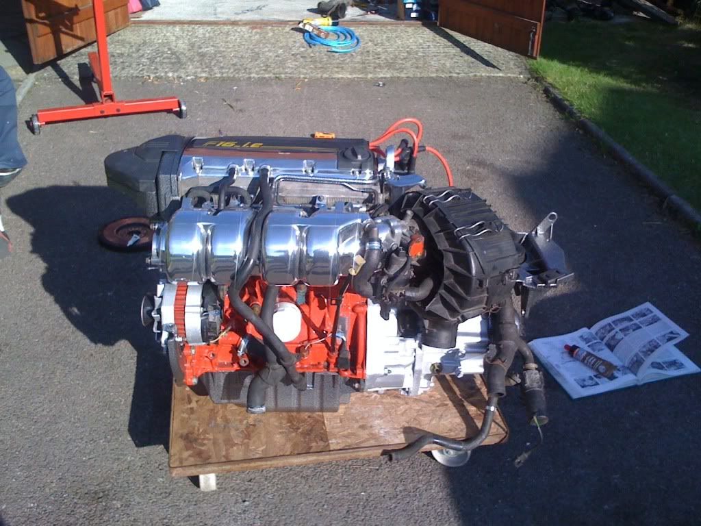

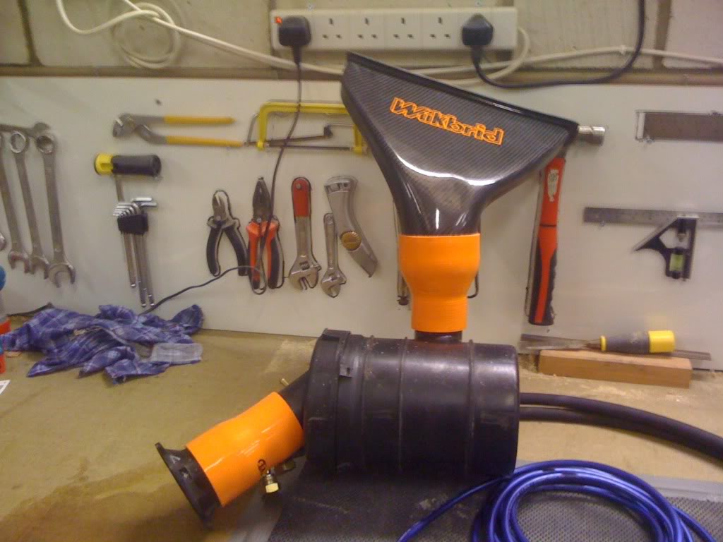

My Group N Skuttle Induction

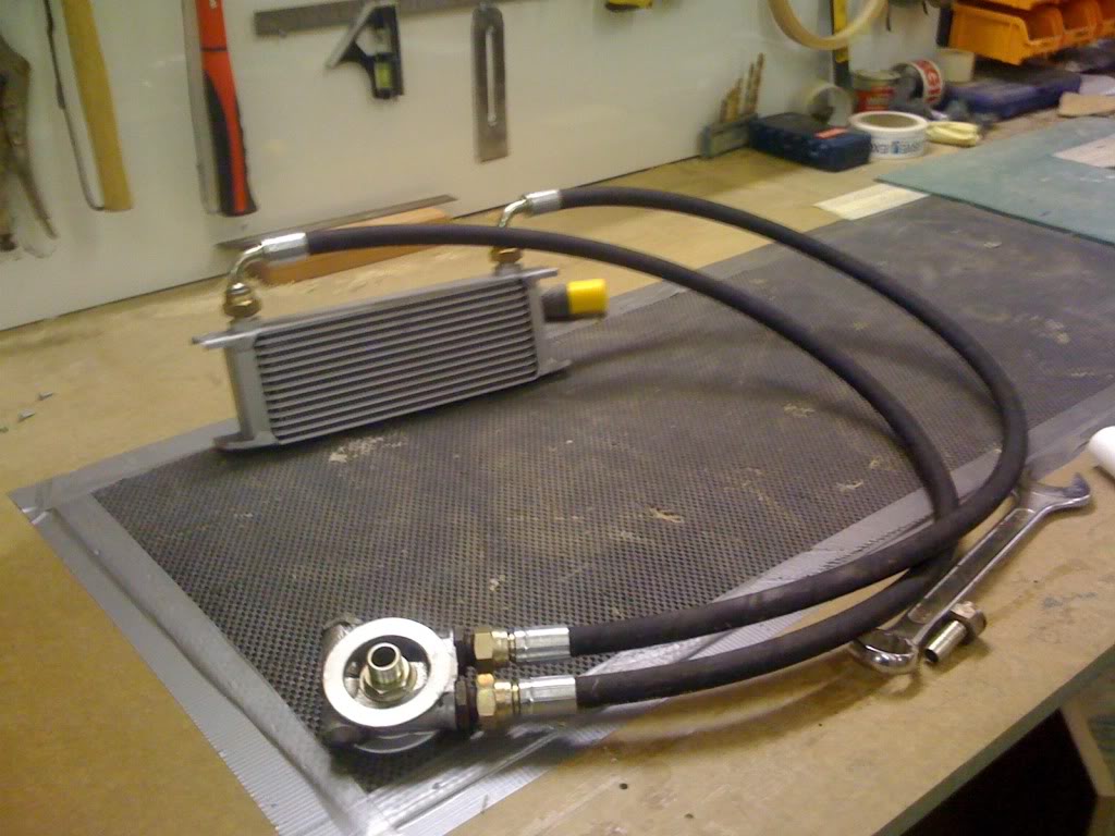

Oil Cooler and Mocal Sandwich plate with UPRATED oil lines.....330BAR or 4750psi

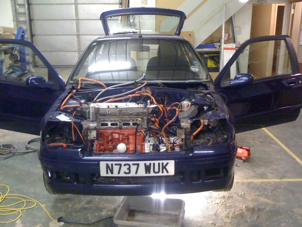

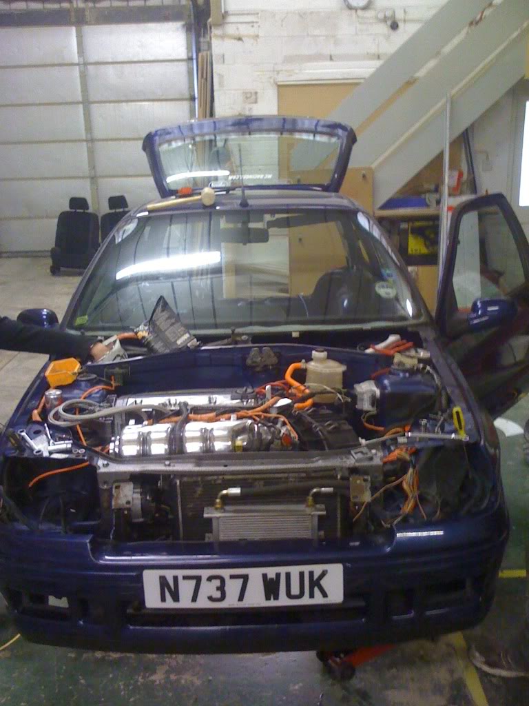

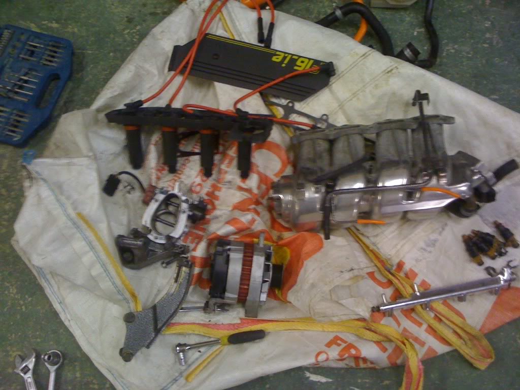

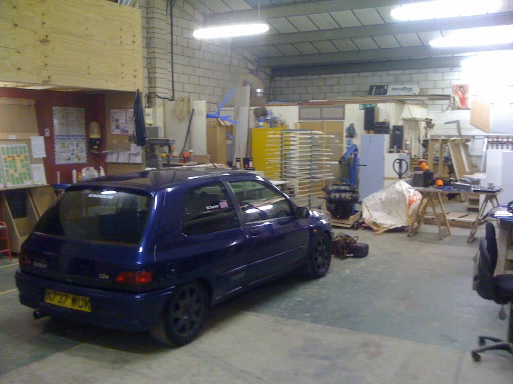

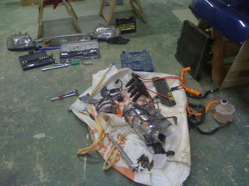

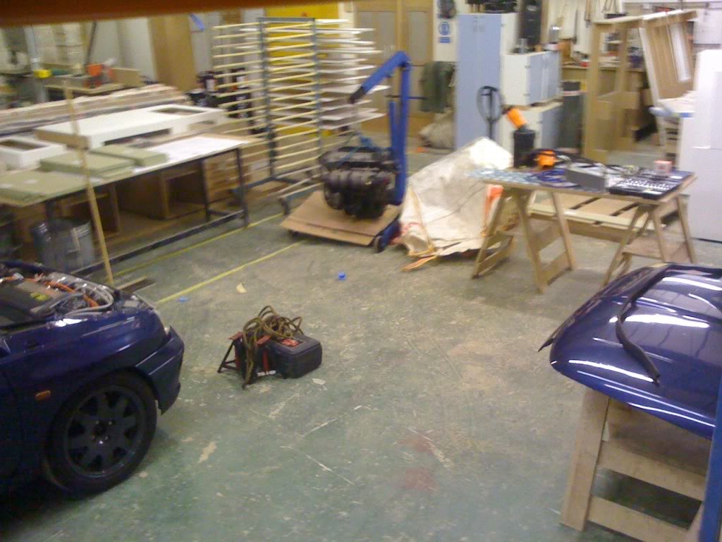

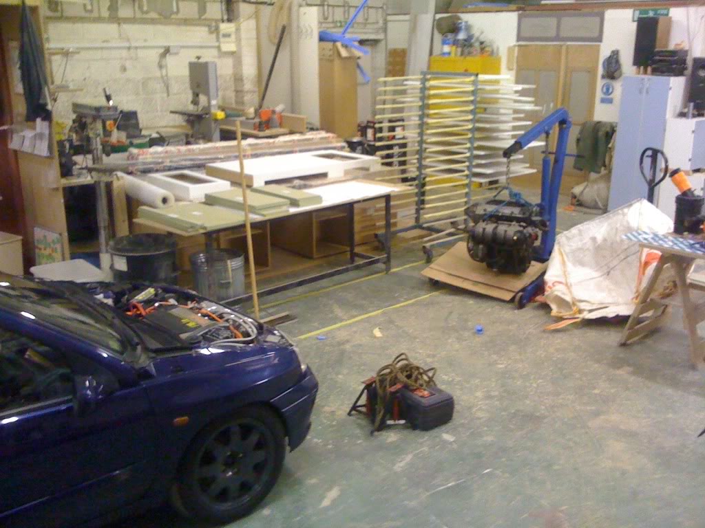

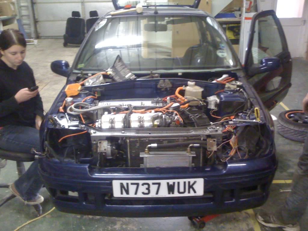

I moved the car into the workshop and started to remove things... lol
Moments later
mmm still clean

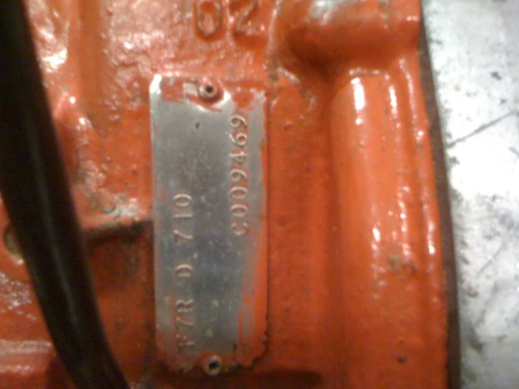

Inferior F7R D 710

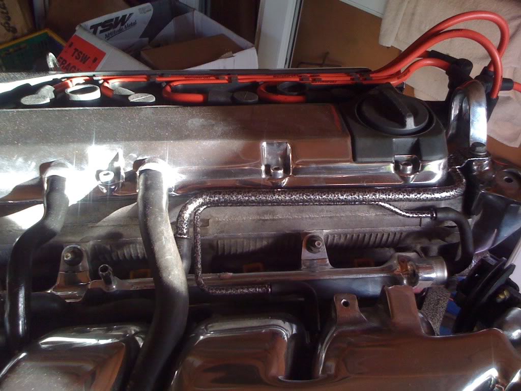

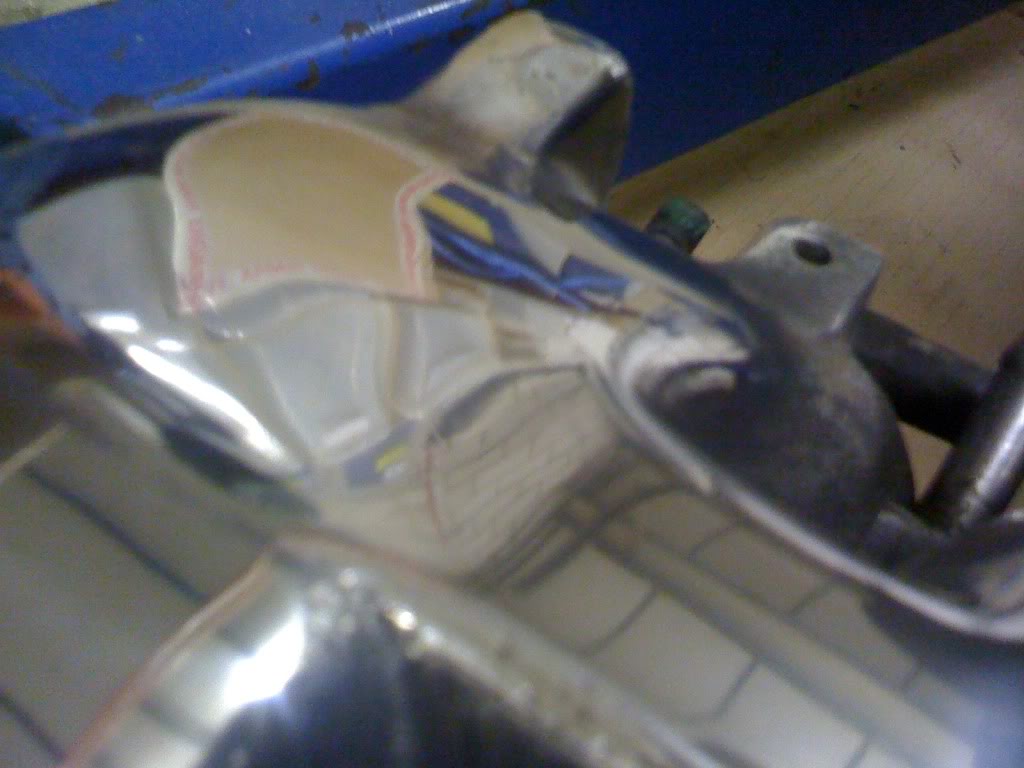

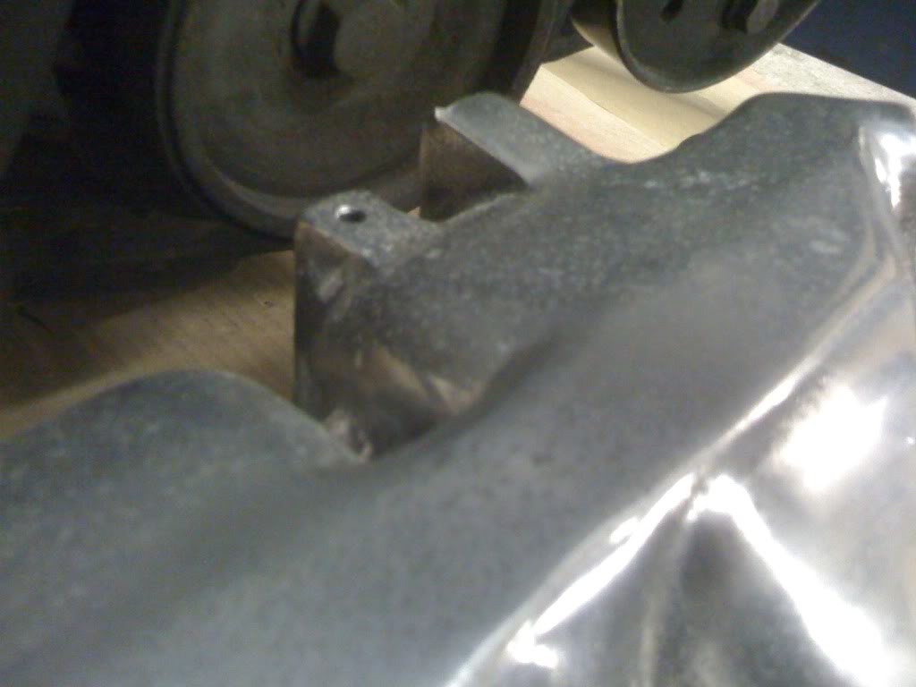

My polished stuff had started to dull
Soo a quick going over with my custom washing machine motor and polishing mop later
First inlet has been done other three remain dull.... hard to photo graph

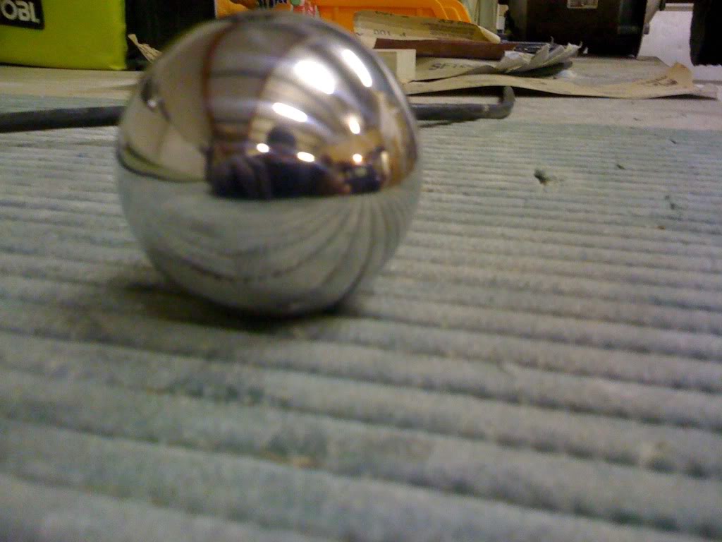

I even gave my knob a polish
at which point harvy and lesley turned up.... admittedly i was quite embarresed to of been caught poolishing my nob.... but this was quickly diffused.....
Harv works like a mad man..... In fact i feel useless in comparrisson.

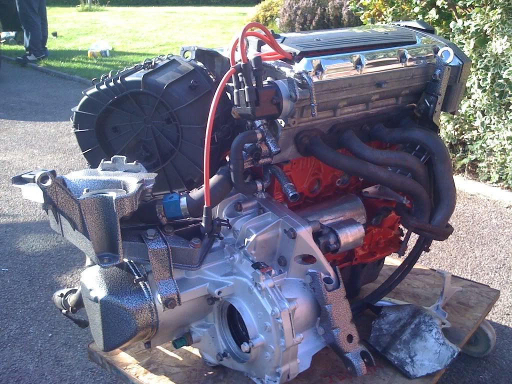

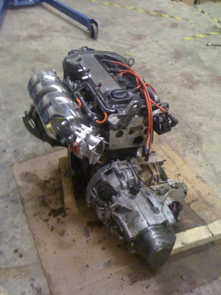

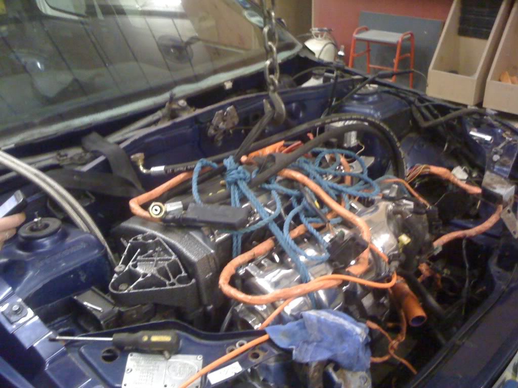

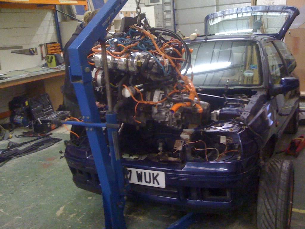

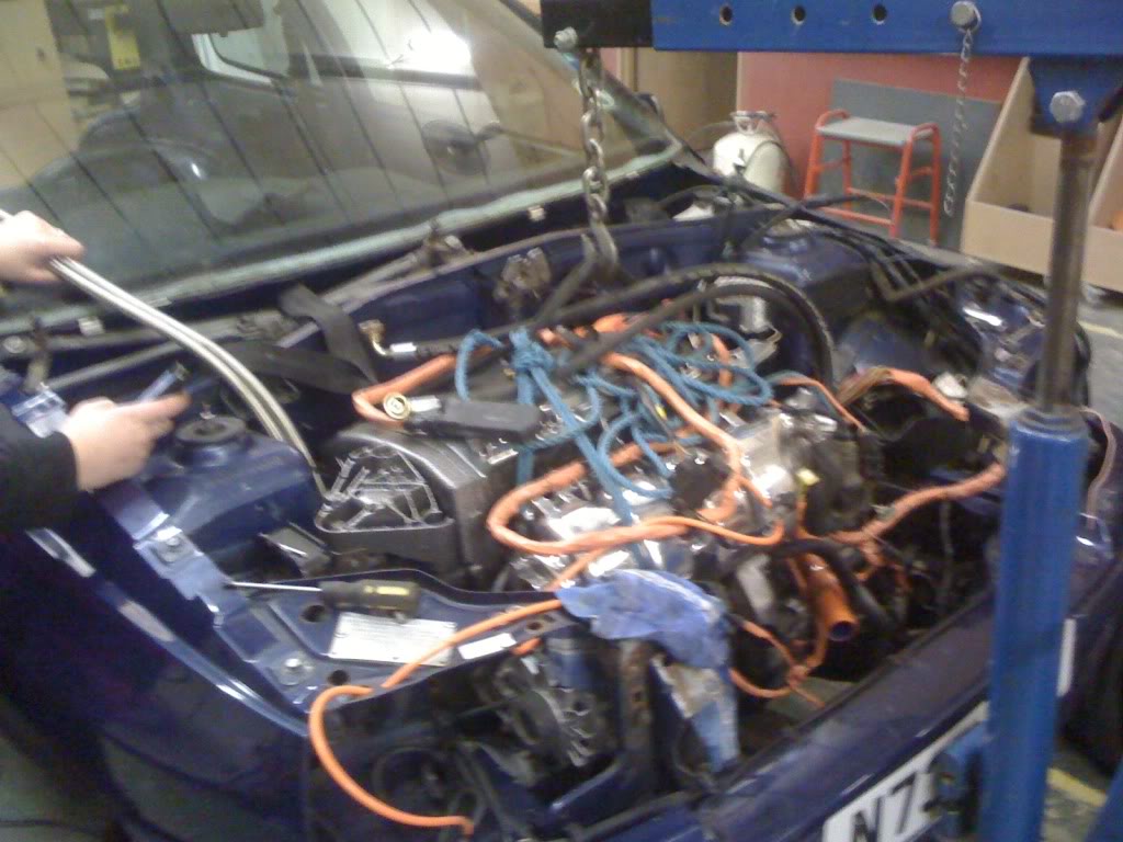

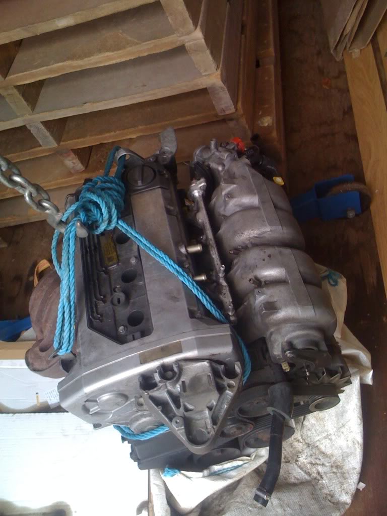

Hubs were removed and shafts out, then all unessesaty things dissconnected then crane in and hitched up with an old seatbelt and engine removed......

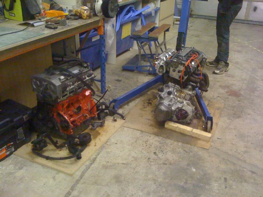

we then spent a few hours removing all bits off the old one and fitting to the new one.

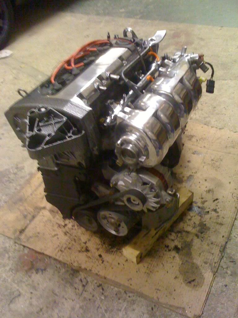

Old and New
New engine complete at which point we for the first time realised we should both stop and go to bed as it was 4AM!!
From this
To this

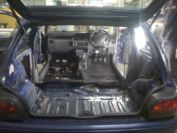

Removed the interior seats.......
had to change the clutch pedal and it was easier to hoover lol

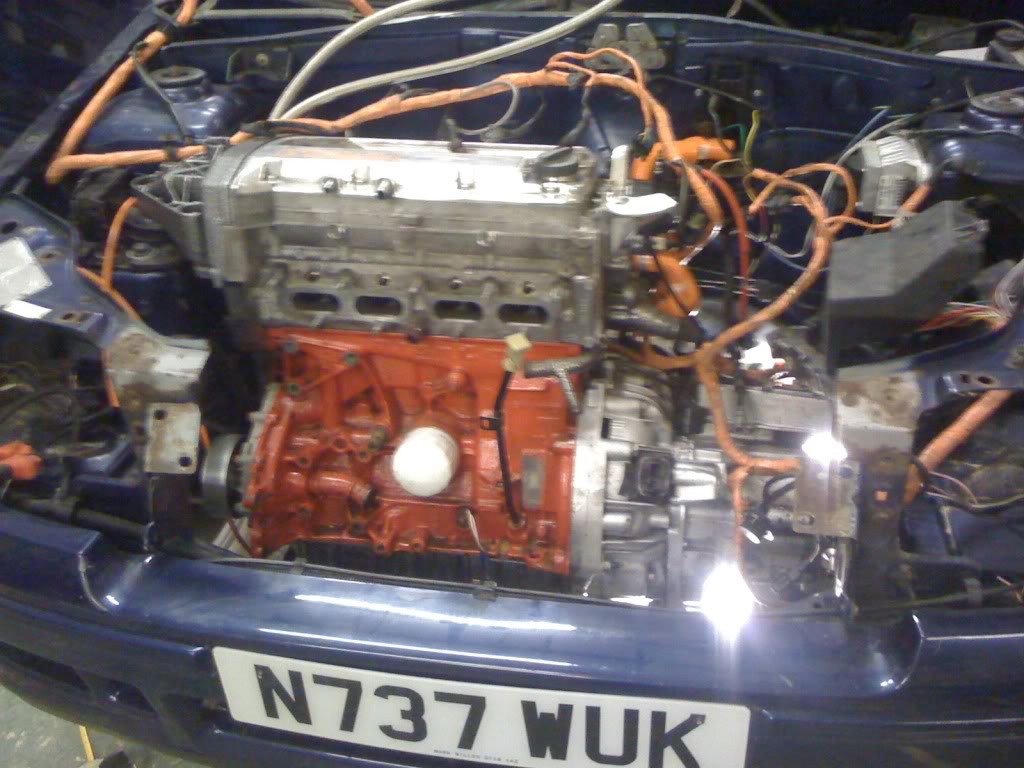

and now started to re-fit the engine.
with an added 4th mount.....
as you can see here.... lesly got very busy

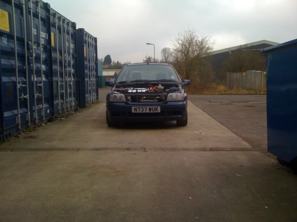

engine in
First start Video for Justin
http://www.youtube.com/watch?v=tvUU-_wOBfY

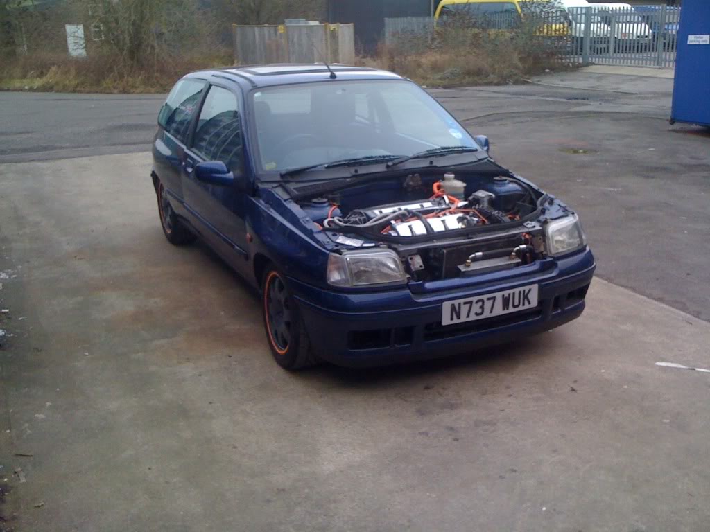

Few of her out side
More updates to come soon

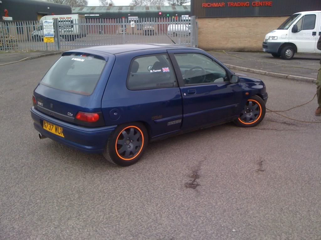

Went for MOT
Failed...no supprises
001 : offside front position lamps wrng colour? :S
002: offside front headlamp aim too high
003: nearside front headlight aim too low
004: nearside fron brake hose fouls wheel on full lock
005: nearside wheel is excessivly worn
how the frig do i sort out the lights?! no idea im gonna get them to do it and just fit a non blue bulb!
Ive had some willy shocks delivered to me now aswell..... wassnt going to fit new tyres with camber like that tbh! So some nice willy items will do.
Going to my mates next week for tyres and balencing, should my tyres arive in time.
Brake hose will be fixed with a cable tie or one of those round spacers i have on the other side hose?
Then its retest time and on to stage 2 :)
http://www.youtube.com/watch?v=VpKUu26Op_s
off for a retest now.......
MOT PASSED :D

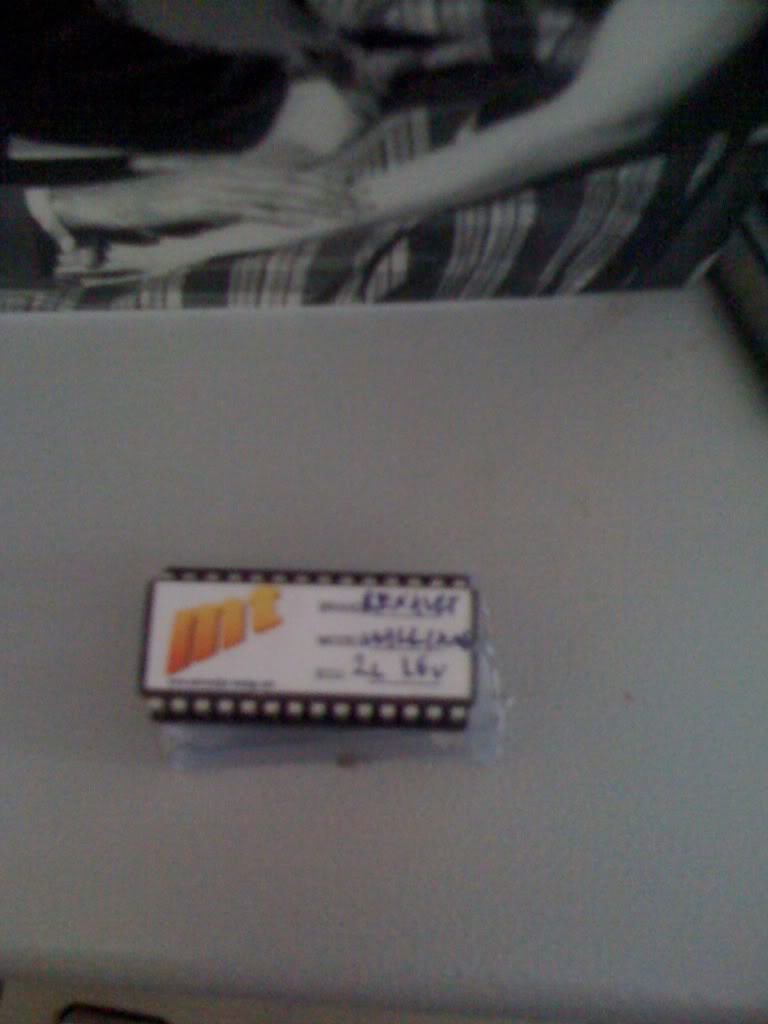

ok chip fitted! went for a quick spin cannot tell you how different the car is now its running a propper 2.0 chip, TORQUE!!! WOOW!
and a video for those that said i couldnt just have a go at doing my own ecu!
http://www.youtube.com/watch?v=RgcH6O0ZIKA

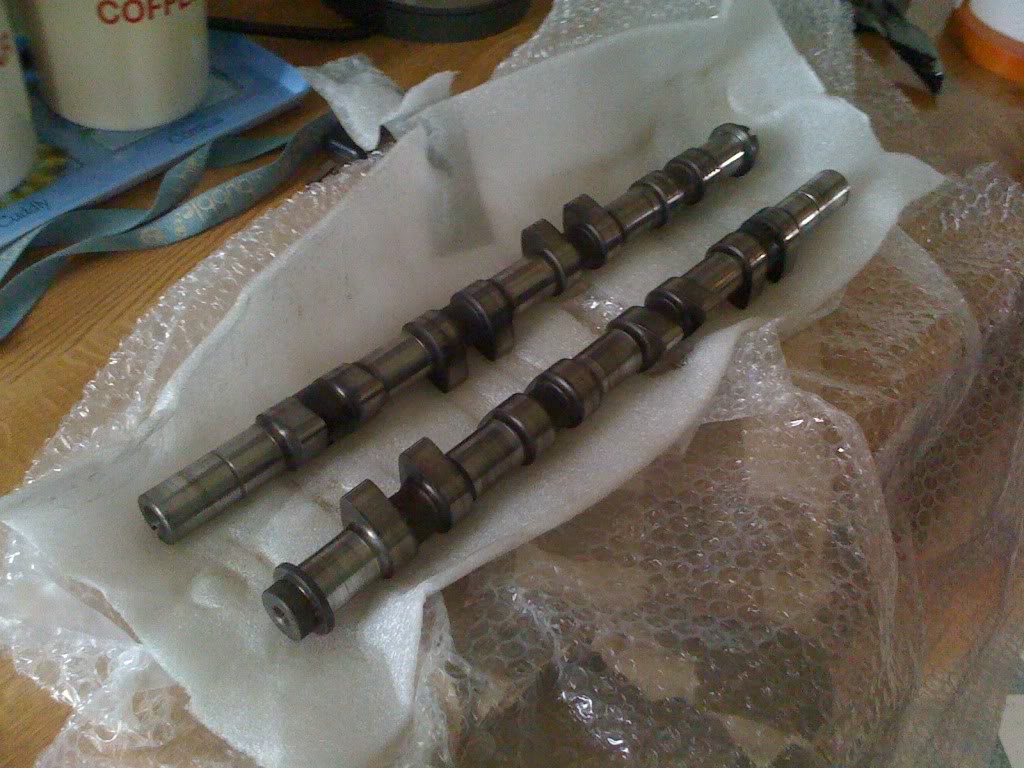

Kent RN2002 260 cams (to be fitted)

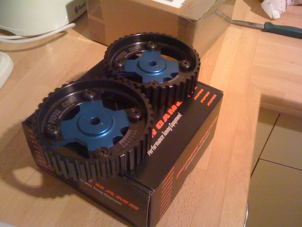

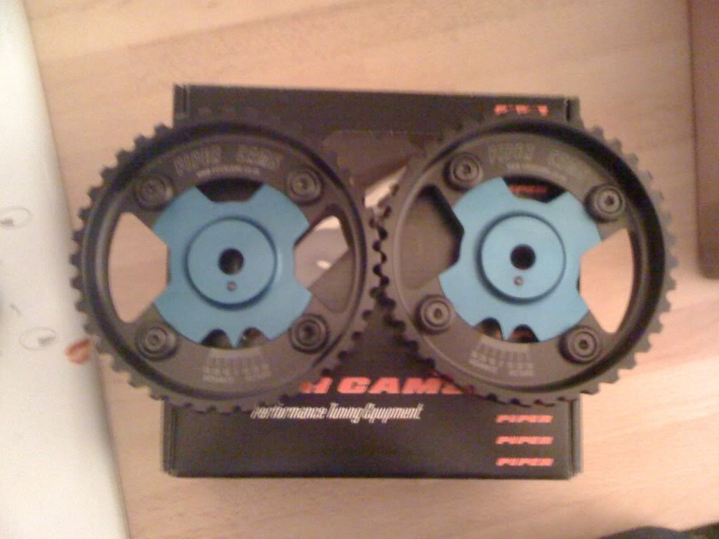

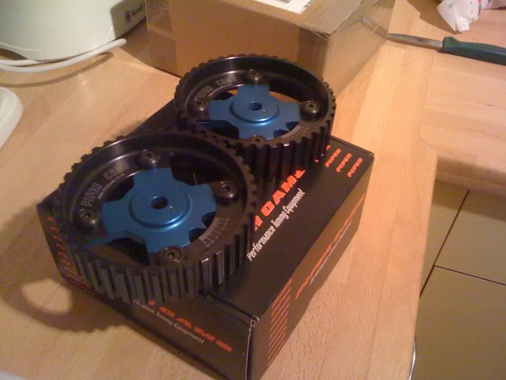

Piper Vernier pulleys (to be fitted)

Highly Polished “Rocker” cover
Highly Polished Inlet Manifold
Highly Polished Fuel Rail

Powder coated Top Mount in Antique Silver
Powder coated Cam cover in Antique Silver
Powder coated Vacuum Lines in Antique Silver
Powder coated Slam Panel in Antique Silver
Powder coated Battery Tray in Antique Silver

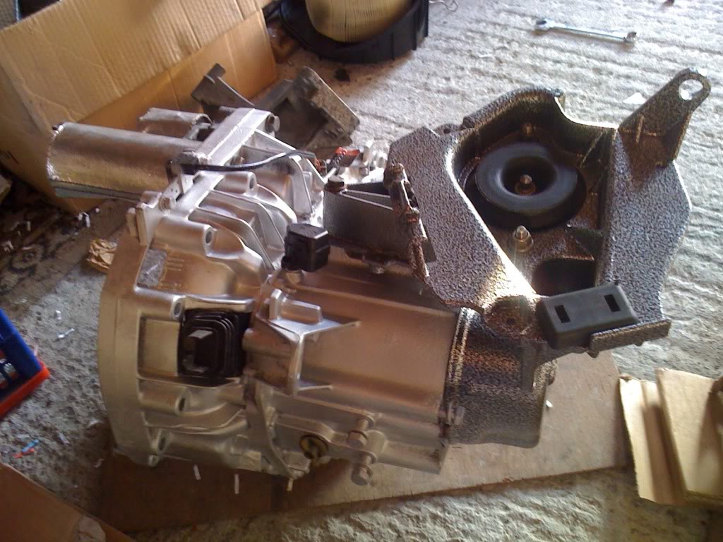

Powder coated Gear box mount and strap in Antique Silver
Powder coated Alternator brackets in Antique Silver
Transmission
JB3 Valver gearbox

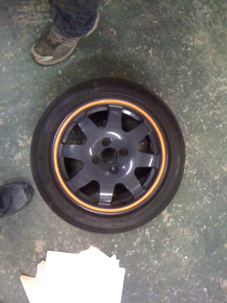

Williams Speedline 7x15-inch wheels (road)
Powdercoated in “sita bin” grey with orange Rim tape
