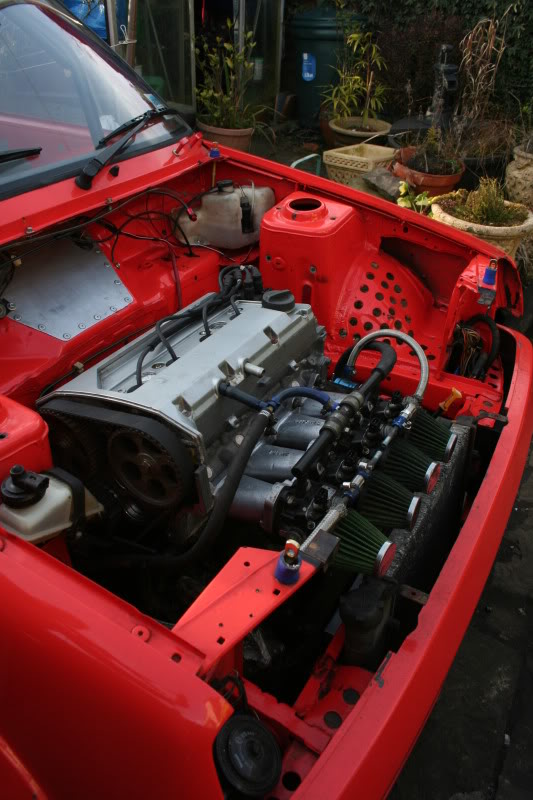

Holey Renault 5 16V... Williams F7R & Alpha ITBs

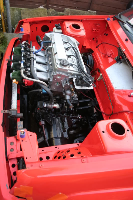

The ITB's won't be going anywhere... the carbs were just a fall back idea if i can't get it running... I will just have to save for the mapping
After some thought im not going to rush the project and get the car fully resprayed pre build... so it might not make FCS!!

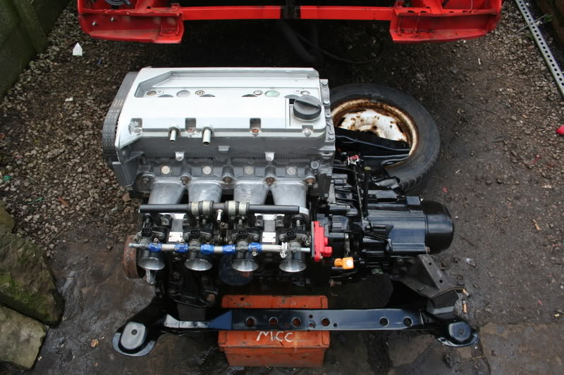

Todays fiddlings....

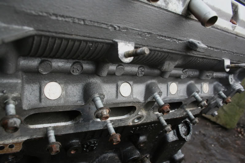

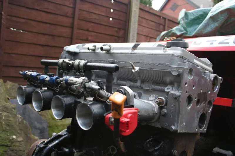

Ghetto injector blanks.... Can anyone guess what they are? Not sure how im going to seal them in yet... any suggestions?

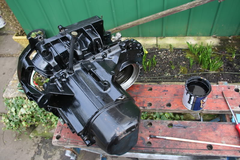

Gearbox painted with 2 coats of hammerite smooth... Needs a little touching up, but pretty much done. I need to get some locktight to fit the flywheel and then it can be matted up to the engine

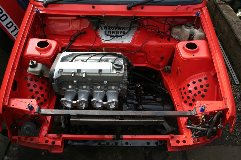

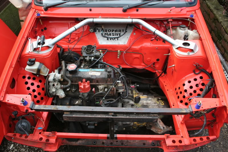

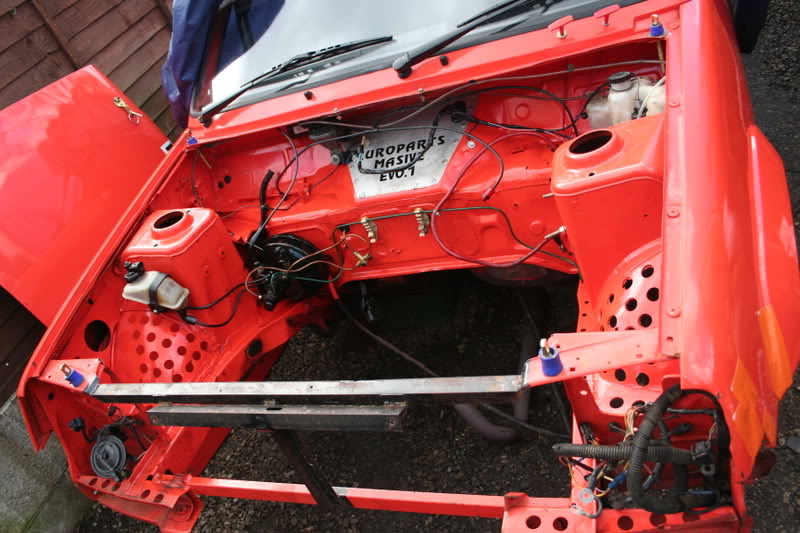

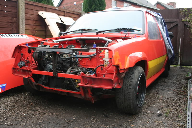

Front end and engine stripped down ready to come out... got holes? Im just waiting on getting my jack back from a friend then i can drop it out the bottom on the subframe

40p's worth of blanks lol

ahhh they are 5ps! lol

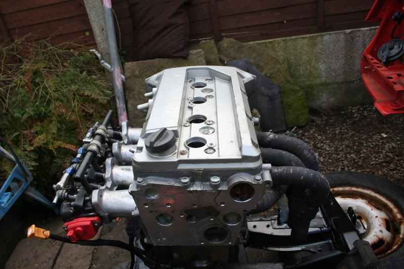

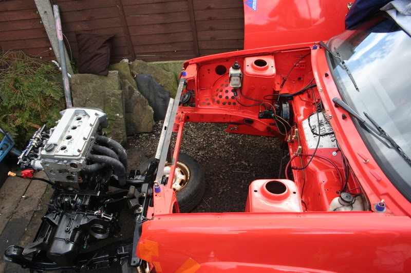

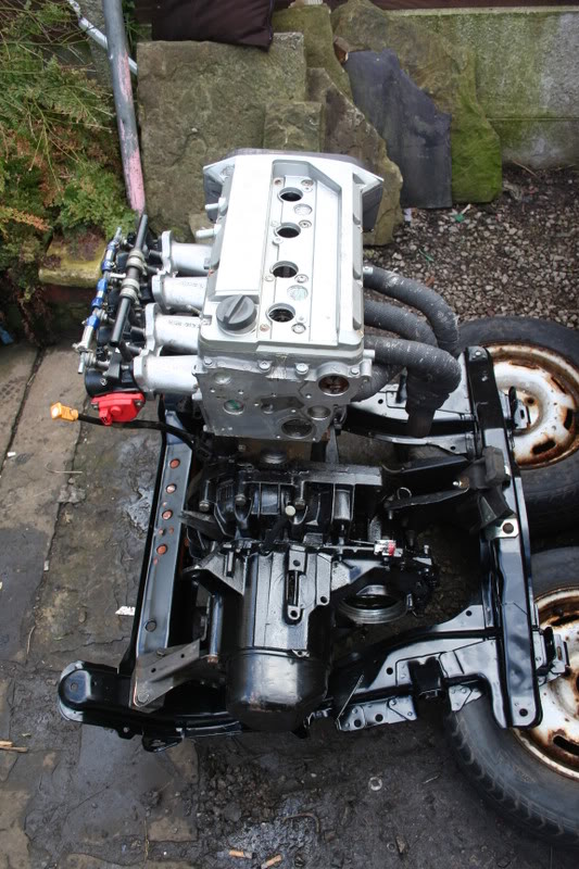

Weather & my new daily Mk2 Golf GTD daily had led me to neglet the 5 but the sun was out this morning so i got stuck in....
1st job was to fit Lighterned and balanced flywheel, Clutch and Gearbox... I had tryed fitting the flywheel on saturday but one of the bolts sheered off (I won't be using the impact gun in future to torque them up lol).. I managed to get it out and all went together as planned today... sorry no pics
2nd Job was to bolt the gearbox to the engine and mount them both on the subframe with Ktec uprated GT Turbo mounts.. I also fitted both manifolds

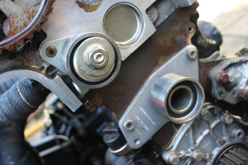

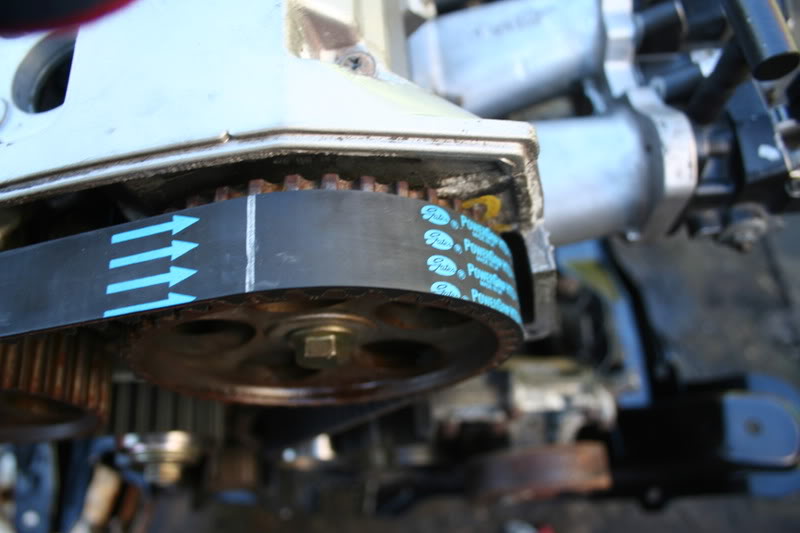

3rd job was to fit the Renault cambelt kit
Now all thats left is to get a few mates around and lift the car onto the subframe... then i can really start getting stuck in.

Loads of room.... dare i say more than a mk1 Clio

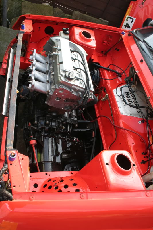

Theres a few parts i need holding me up and i need to get my angle grinder back from jord as the bodies foul the slam panel.

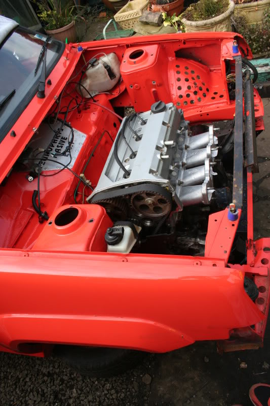

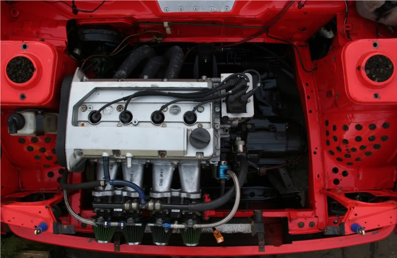

I got abit more done this afternoon/evening... bay is slowly starting to fill up :D
