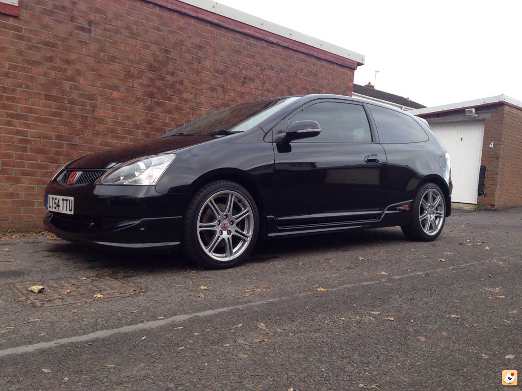

Few small updates with my ctr :)
Mainly been focusing on the paint work so gone over it a few times now with different products and to be fair its come out very well :)

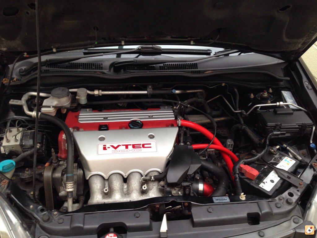

Also got rid of the aem v2 and got a aem cai long arm now much better than getting heat soak a bit weary of the hydro lock but should be alright . Got some red breather hoses with the kit too .

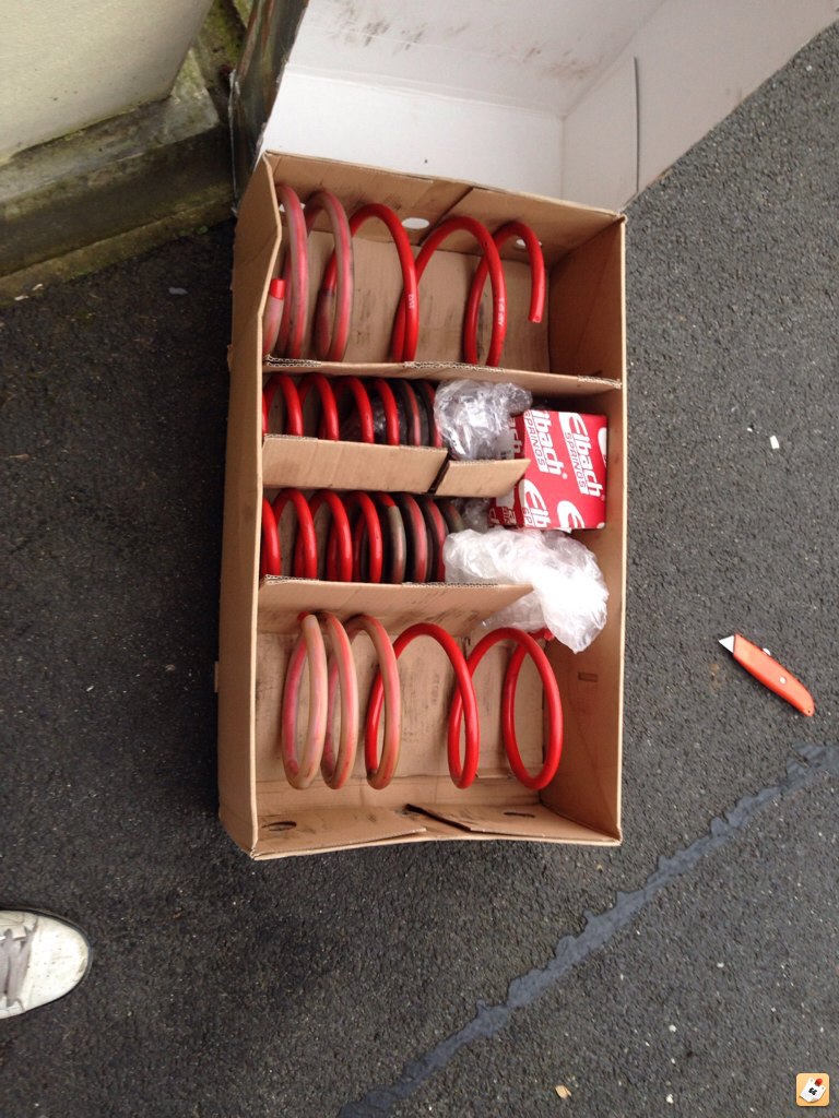

I was getting fed up with the monster truck arch gap so i bought some abp eibach springs along with eibach camber bolts
On the look out for some rear camber arms also a jdm arb for the rear .

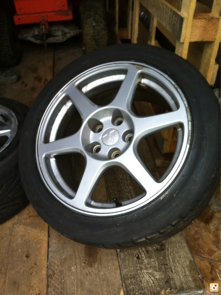

Also managed to find some evo 8 wheels cheap
So there getting refurbed in a bmw sparkling anthracite and a fresh set of rubber .
For xmas im going to purchasing an exhaust system probs going to be the hks hi power system or the dc sports .
Will be replacing all my engine mounts with energy inserts and powerflex gearbox insert to tighten the engine up .
Also gave my gearknob a polish up as it was scratched to bits
Overall very happy with the civic but part of me wants an evo so im going to see what happens in the new year .

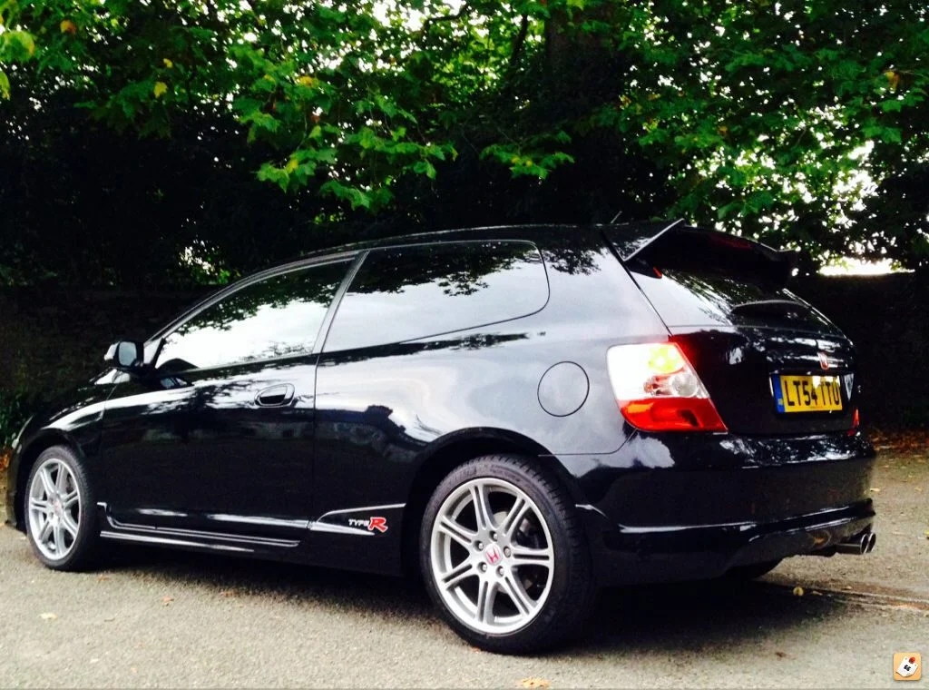

Heres a few random shots :)
Cheers for looking

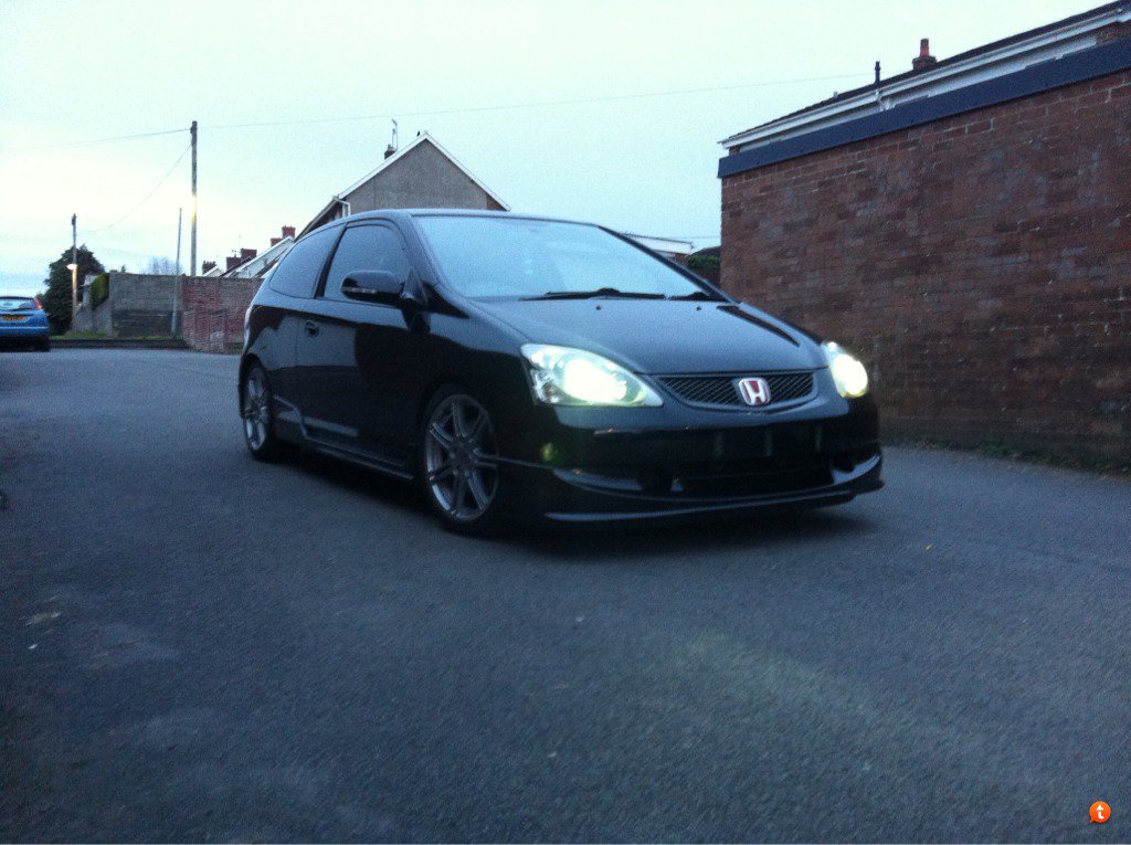

Been a while since I've updated this thread so here's what's going on with my ep3 at the minute .
It's been of the road for about 3-4 months now I've basically replaced all the tired bushes ,ball joints and anything else that could do with changing , whilst also adding some mods too , but nothing over the top just to tidy up the car.

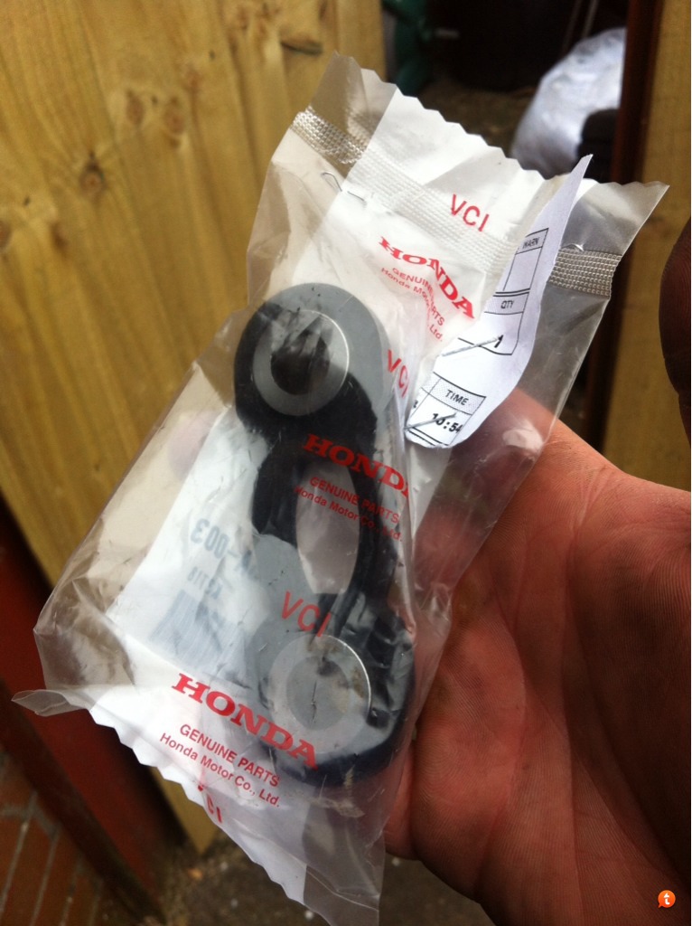

First job was to replace the steering rack slider if anyone knows the ep3 this is common problem with the steering rack , the part is made of plastic and as it runs in a channel it's wears down on the sides causing the "vague" steering and lack of feel . Replaced it miles better now greased up the rack too as that was bone dry .

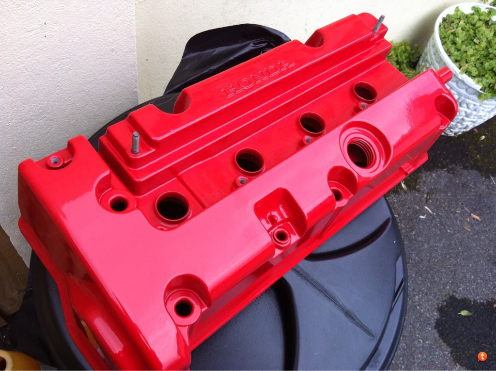

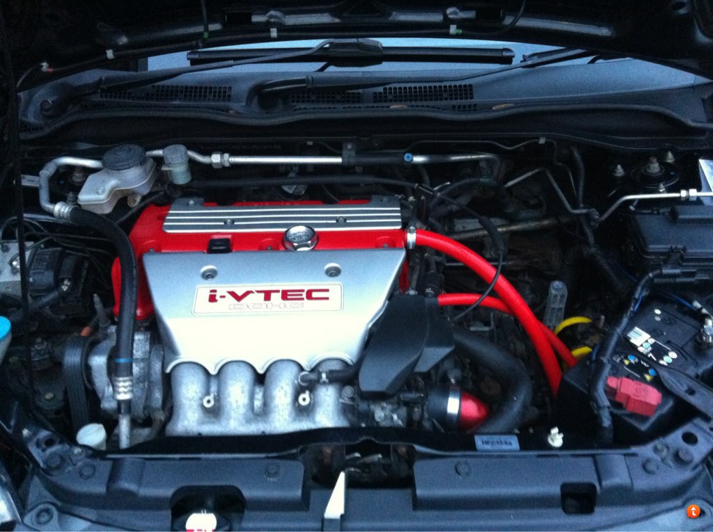

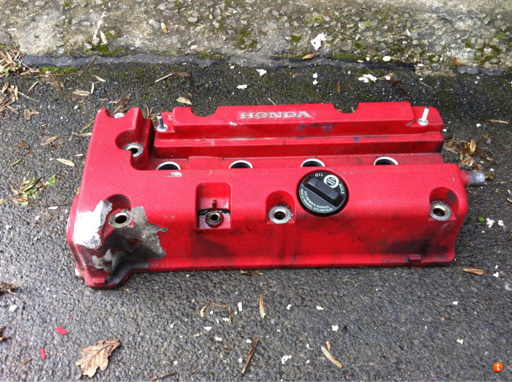

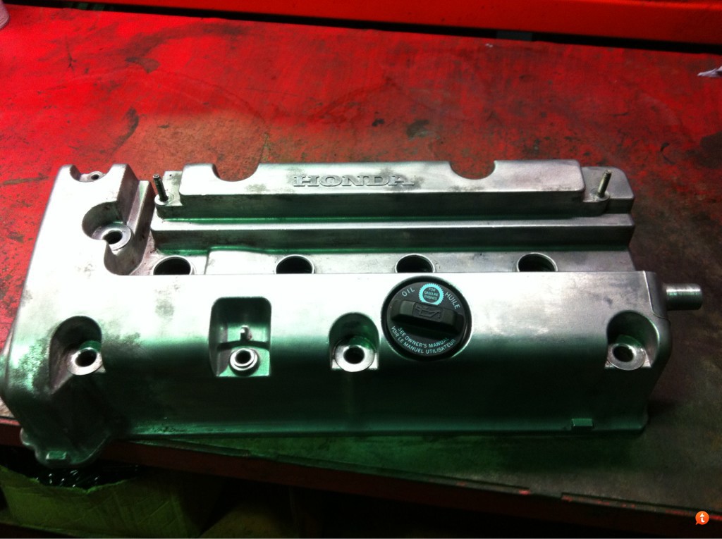

Next job was to refurb my tired looking rocker cover once again another common problem the crinkle red paint starts to crumble and makes the bay look tatty so after stripping it down with nitro morse and assorted sanding tools it's was sent of the powdercoaters , got it back and it looks awesome . Well worth the £20 also replace the gasket and the spark plug o ring gaskets .
Also added a Mugen rep oil cap

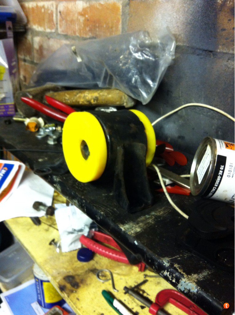

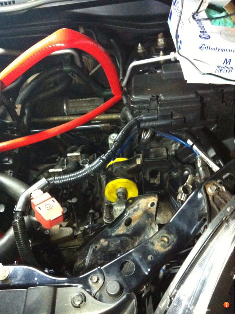

Then I replaced my gearbox engine mount for a powerflex item as mine was very worn giving me a sloppy gear change with this now replaced miles better changing gear

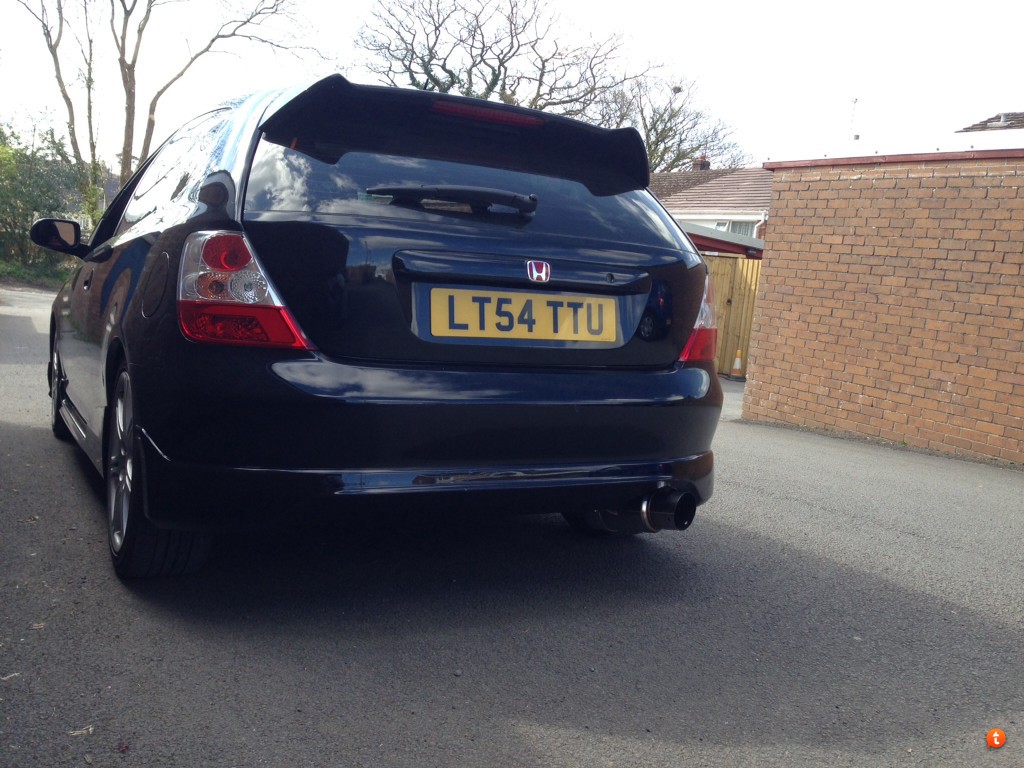

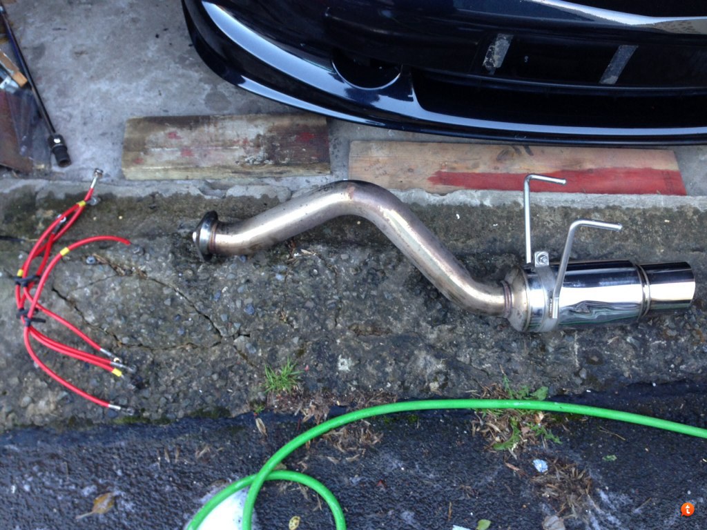

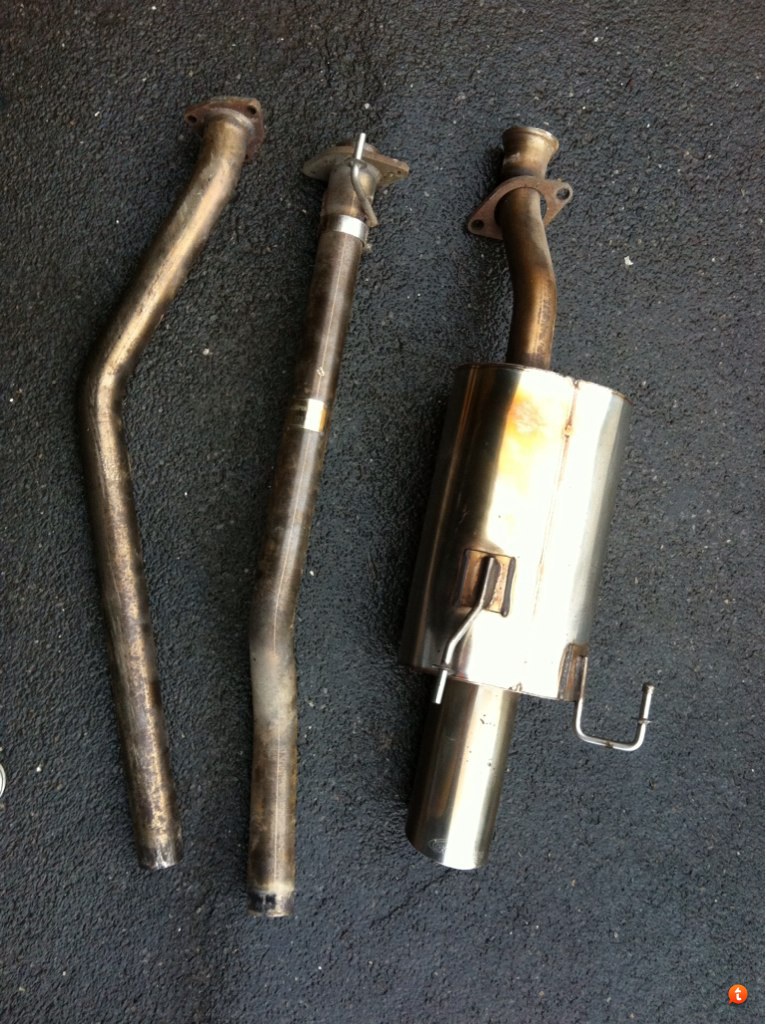

I then bought an exhaust system , I went for a scorpion catback system that came up locally got it for £100 which was a bargain , but wanted somthing with a 2,5 inch bpipe , so sold that on for £200 so made money , an m2 racing backbox came up for sale on ctro very cheap so bought that for now mated to the oem bpipe Intil my area Motorsport silenced bpipe is made ,
Here's a pic of the scorpion system and the m2

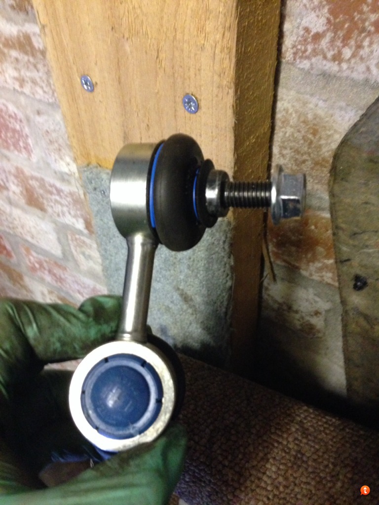

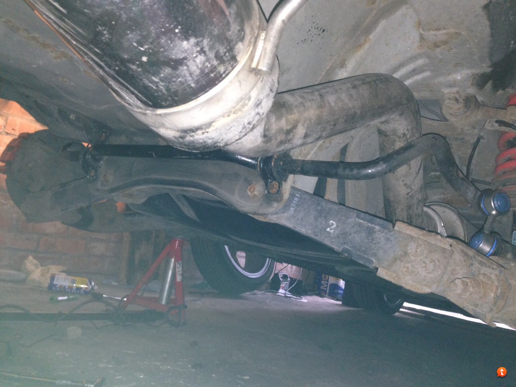

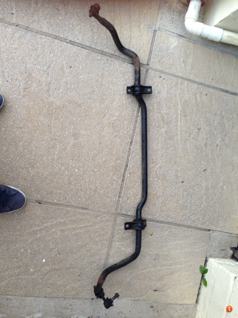

Wanted to tighten up the rear end so bought myself a Jdm arb for a steal of £40 these usually god for 60-90 so happy with that much thicker than oem , 18mm oem , 22mm Jdm replaced the drop links for heavy duty Meyle items again a lot more heavy duty with a 4 year guarantee too so good deal for £35 for the four .

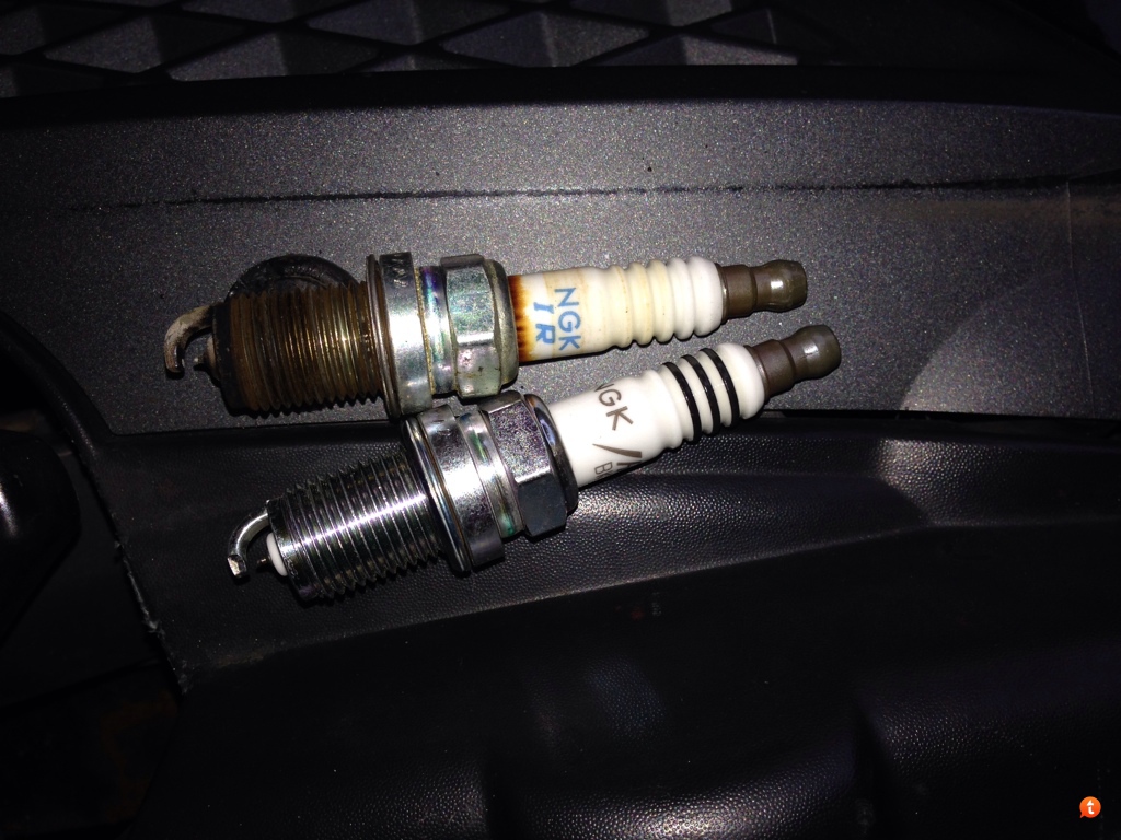

Just added some new spark plugs to the k20 looking at service history these have not been changed , so bought some ngk iridum plugs :)
Some boring pics

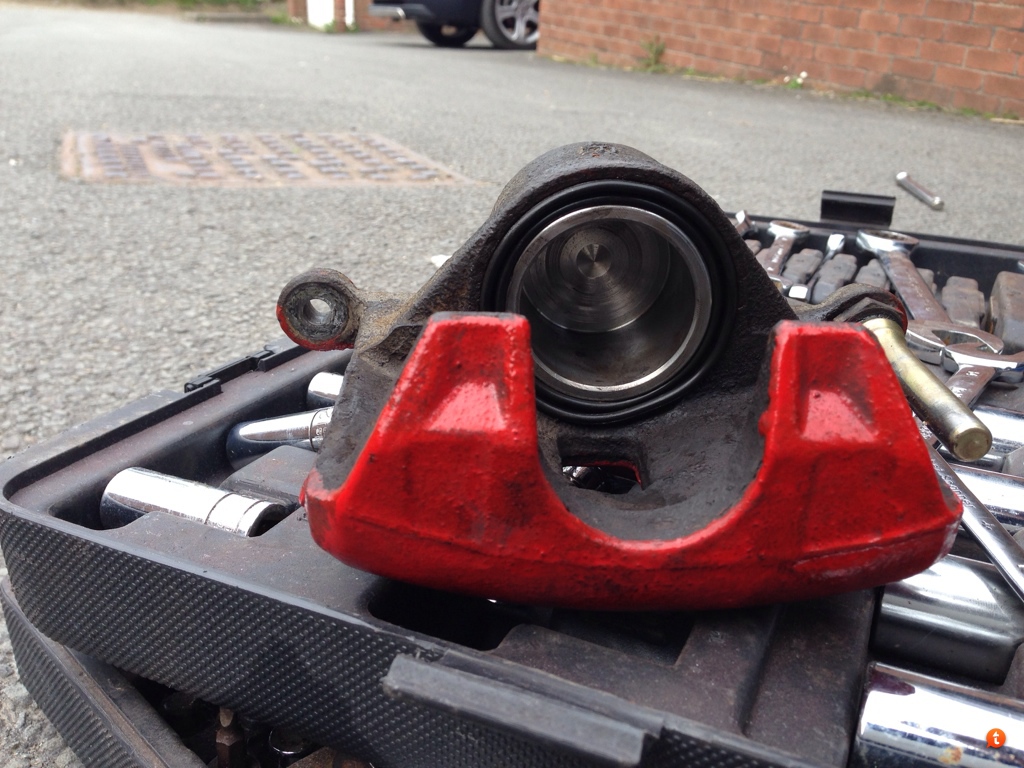

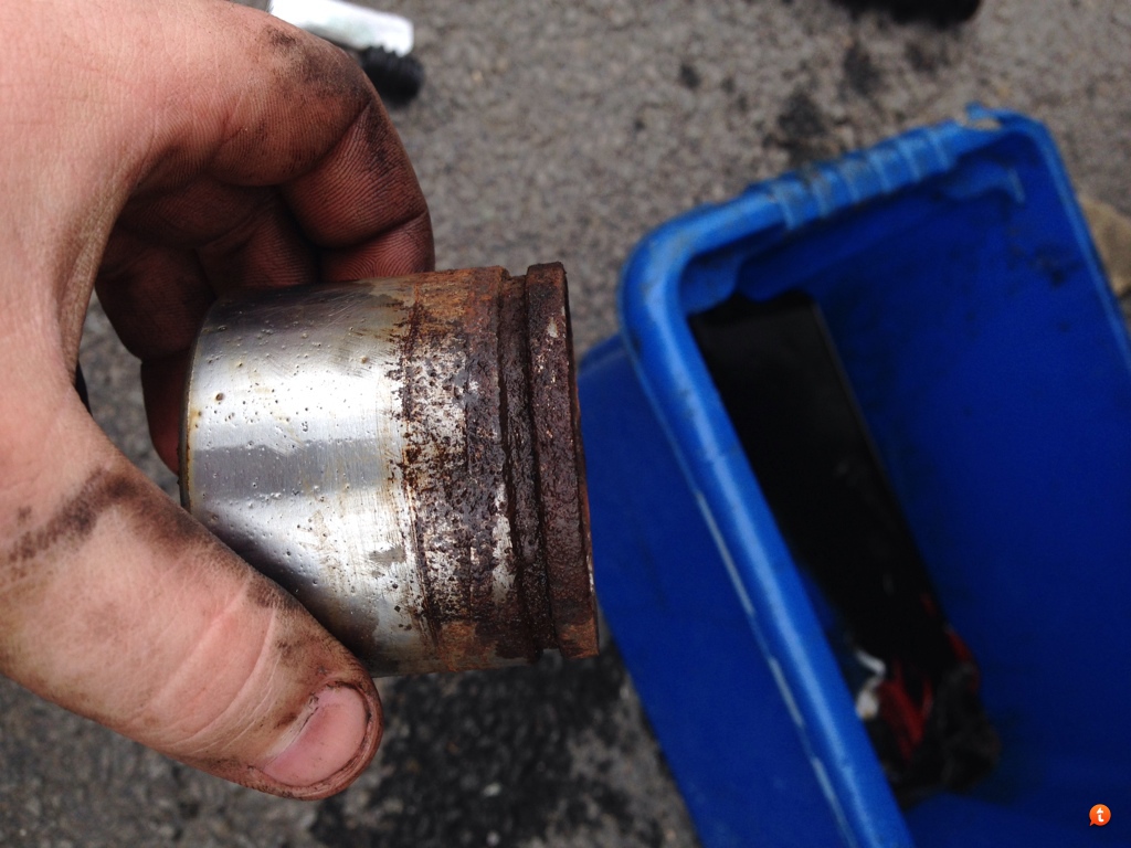

Few problems with the brakes my nsf caliper seemed to have partially seized this was the culprit
So i bought myself a caliper rebuild kit for £20 odd quid and rebuilt it myself which was an absolute doddle :) heres how it looks now

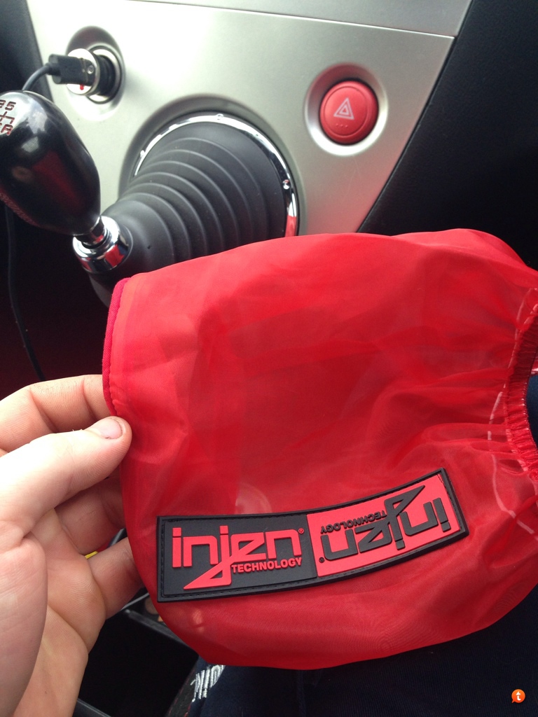

Also got my injen hydro shield to fit to
My aem cai induction kit just to protect it from water as its in a vulnerable place for hydro lock being in the front bumper .

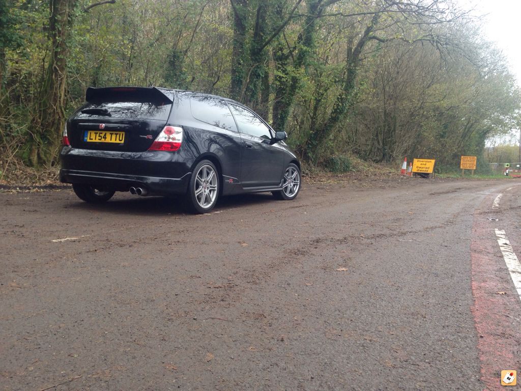

Went for a spin up the black mountain this afternoon to test the cars handling the jdm anti roll bar has made a good difference alot more solid in the corners , overall the car performed amazing just need to bleed the brakes a little more they are a bit spongy ,
Took two quick pics
