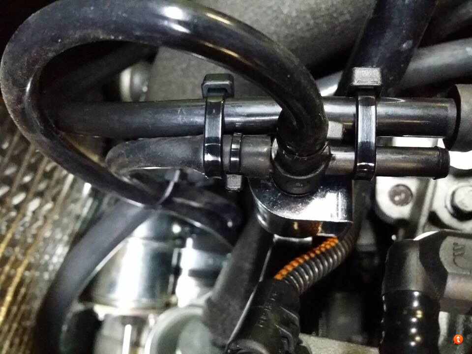

Now I have boost control!! :)
This has stopped my boost issue where is was tailing off, now it hold 8.7psi (0.6bar) all the way from the get go to the limiter, it's awesome just keeps pulling and it is a lot kinder to the engine without the massive spike!

It's actually a VAG solenoid which are around £50 you can get MAC 3port valves etc too. The main thing is if your ECU supports it. It's made a huge difference on mine, not only the ECU electronically keeping an eye on boost levels but maintaining good usable boost. Beats relying on a spring to do everything!
Sorry mate forgot who is mapping yours, check with them first. You will need the latest firmware to run the control.. Mine is a genuine solenoid from VW
Ste at SC autos will be doing the mapping. I'll speak to him next week as I have time until it goes back for the remap and boost turned up. If you bought it online please could you pm me the link. For £50 though seems like a very worth while addition.

You must be the only other person ive seen who has GEN90 controlled boost, did Chris@EFI set it all up / wire it for you?
Do you have it? no wasn't Chris in the end, when we tried at EFI the firmware was to old so that needed updating.
Yeah i have a MAC valve wired straight into the GEN90, and as you mentioned, i had to have my firmware updated to do this. Reacts quite fast in closed loop mode and holds rock solid boost so worth it. I want to have mine setup for boost by gear on the next build :)
