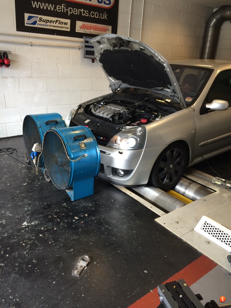

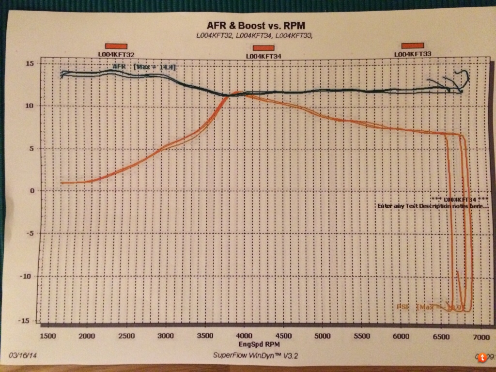

Just got home!! Bit of an up and down day... Arrived at EFI at 11 this morn, got straight to work with off boost mapping all went really well, got to mapping with boost and we were getting some nice numbers climbing closer and closer towards 200bhp, Chris said more boost was needed so set about winding the actuator in, gave it a few more runs and it became clear there was a issue! :( we were getting great boost up to 4250rpm then started to drop quite badly,
We then thought adding a boost control solenoid would keep the boost more steady but after a lot of head scratching turns out my Gen90 didn't have the latest firmware to control the solenoid!!!

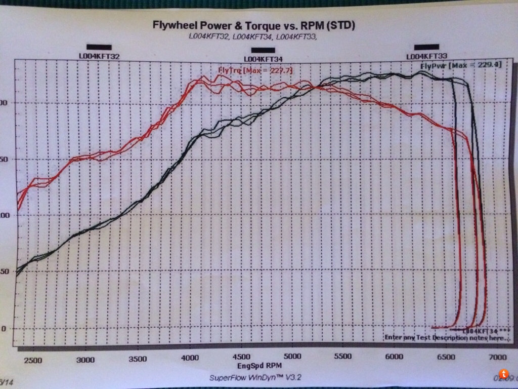

Ah well back to the shoddy actuator then, we decided to run a tad more boost but map it back to a safe level at the peak of boost keep it like that for now, it made 229.4bhp and an impressive 227.7 ftlb of torque. Chris said with a decent actuator it would of easily made more so I'm going to get a forge one to smooth out the boost soon.
TBH I'm more than happy with it as it is, I flys that mid range torque is amazing, both me and my mate were laughing all the way home!! :)
Mega thanks to Chris for not giving up on it and an awesome job!
Yeah thinking the same, was more concerned about the boost spike to be honest, would of liked a more linear curve but I'm more than happy with that power!
