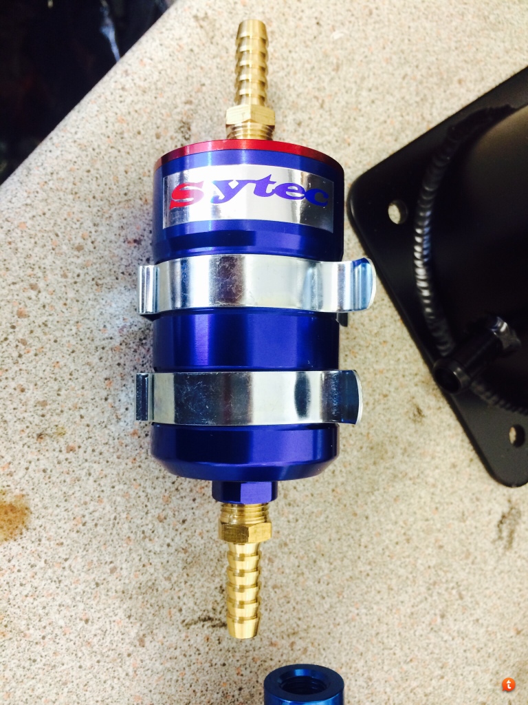

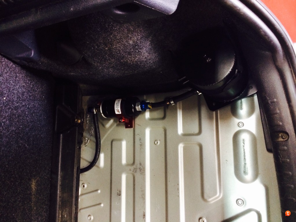

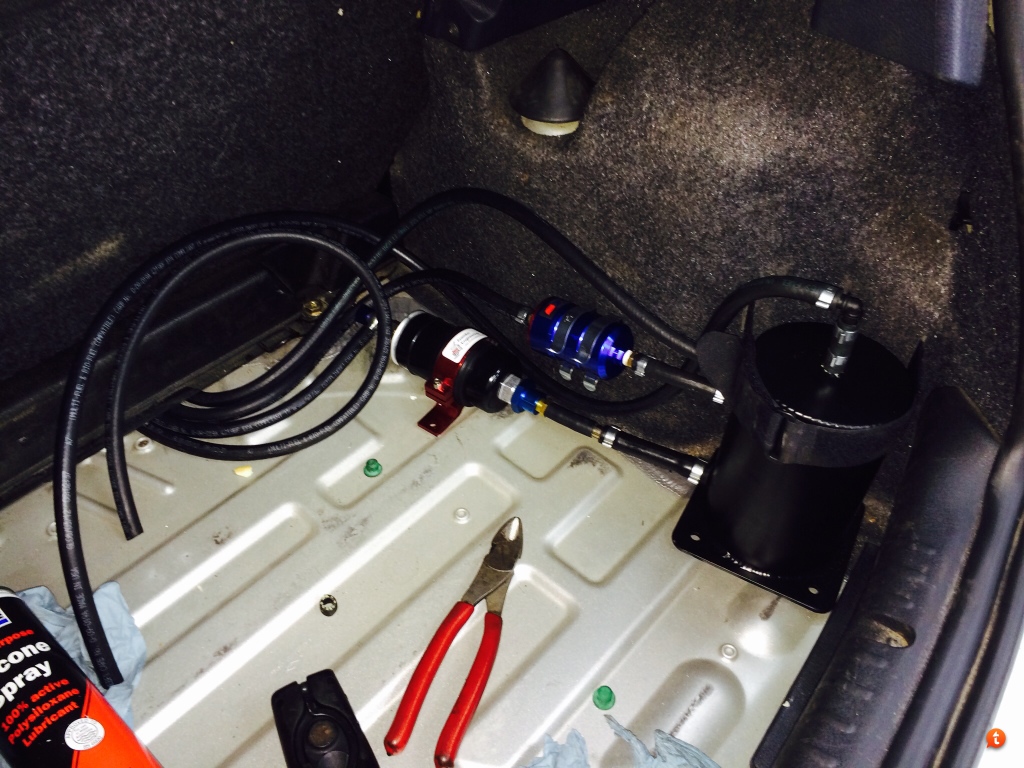

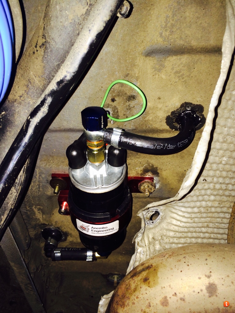

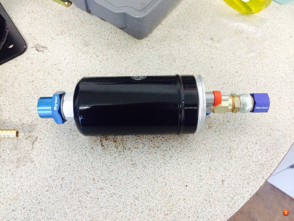

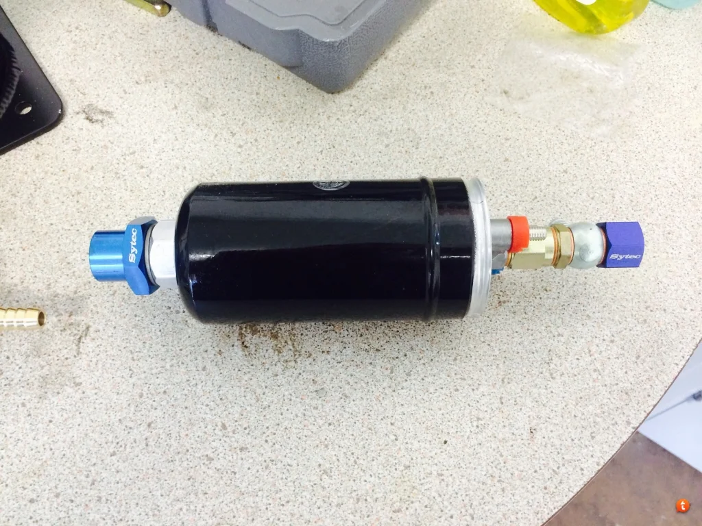

Nothing wrong with the brand new Renault FPR, also that is what it was mapped with, the 017 pump I have works so nice now no need to upgrade the FPR to allow stupid flowing pumps! It's only £49 for the 044 so will sell it back on. Anyone want a used once sytec 044 with all the fittings £30? Free postage

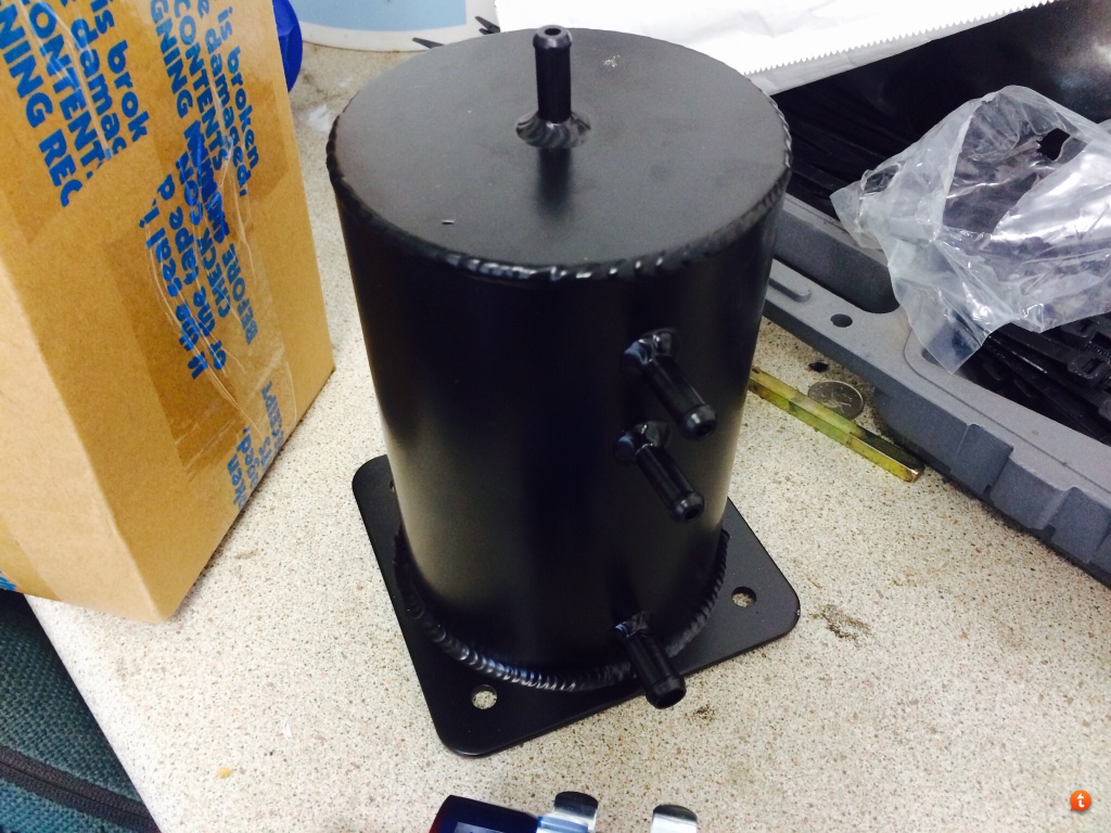

Want a 044 and 1.5ltr swirl pot?!? It's all on jic fittings as well.Chris savage appears to be churning the full flow of the syvec equivalent of a 044 through the stock rail and pressure regulator (well from the pics he has posted), and managing 500 odd bhp, as well as maintaining the original hard line feed (gotta be less than 8mm I/D?)
The bosch 044 seem to excel in keeping flow rights high at higher fuel pressures (which is so very important), where other pumps do not cope so well. Swirl pot is one of the things at the top of my list to sort.
