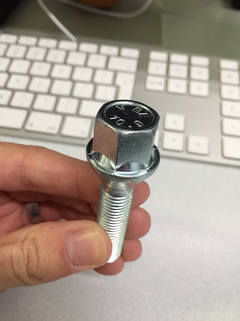

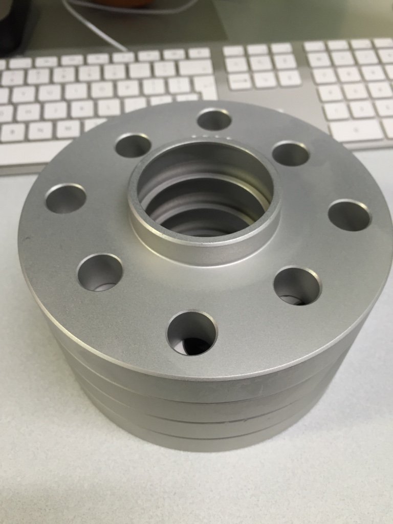

So it will be the Clios turbo b'day soon, treated it to some spacers, not for any real point apart from looks! Thinking I can't go fast in the winter so I'll make it look fat! Looks really good, 15mm on the rear and 20mm up front, they are BIMECC hubcentric ones so very good quality. Thinking I'm going to swap the 15mm to the front though and get some 10mm stub axle spacers as its a bit scrubby and I don't fancy cutting my car about!

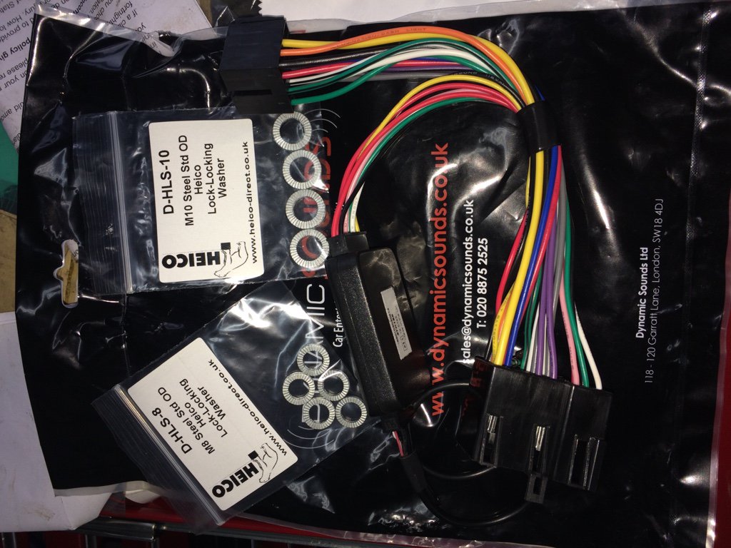

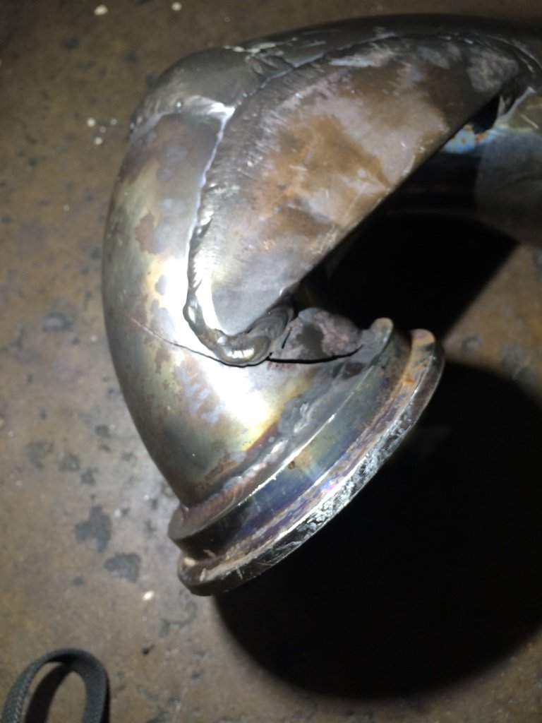

Car is currently sat on the ramp in my workshop without an exhaust on and turbo downpipe removed, drove it in yesterday to replace the studs and nuts that hold the downpipe connector on and turbo on to the manifold, have had to re tighten them twice now, once after the ring trip and again a few weeks ago. Was getting a slight blow occasionally so it was time.... Ordered Heico lock washers and new gaskets too, they won't be coming loose again!!

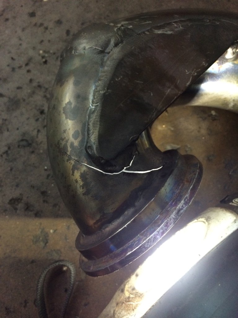

Anyway once I started removing everything I found a black sooty mark on my heat shield further down from where the flange that comes loose is so was a bit concerned, turns out the down pipe is cracked :( thought it sounded worse this time....
Spoke to engine dynamics and it's only covered for six months, they kindly offered to re weld it for me but I think it needs some re-enforcing, this surprised me because I have a brace to support the downpipe which takes all the pressure off of the downpipe/turbo, it must just be a poor design... ( new ED DOWNPIPES ARE THICKER MATERIAL ) Under too much tension at that point, ah well. In the fab shop tomorrow with tig welders and stainless steel!!
Also @DV8 has got us some 10mm rear stub axle spacers from PMS and I have a stalk adaptor after two years!

At least it didn't happen mid lap on the Nurburgring, is it a downpipe that's made by one and supplied to all companies?
Not sure on that one, I have seen it used a lot though, pretty sure ED get them made by a supplier they have heard of them cracking but put it down to solid engine mounts and no support bracket, when I said I had standard mounts (apart from dog bone) and a brace he was surprised too! Tbf it has taken some abuse :) it wouldn't of stopped me from driving the ring though although does affect AFR readings with a crack before the sensors!

Yes, attributable (imo) to the down pipe cracking and the rest of the exhaust dropping as a consequence.
Obviously that made things worse.
Looking at your picture yours is their 'updated' version - although I was told there wasn't a problem with them cracking.
Did you have yours braced from the back of the block to the downpipe as an OE vehicle would have? Mine dropped for the first week until I braced it and that made it perfect, well until this crack, still didn't move though :)
Ah okay so mine is an updated version of yours and was told yesterday the new ones again are of a thicker gauge s.steel. I will make it bomb proof!

Did you have yours braced from the back of the block to the downpipe as an OE vehicle would have? Mine dropped for the first week until I braced it and that made it perfect, well until this crack, still didn't move though :smile:
I wonder what grade material they're using to make these? I guess it's finding a new weak point after everything you're doing

Yep I'll have to have a good think about where and how to strengthen the downpipe, stainless is a sod for cracking at the best of times :(
