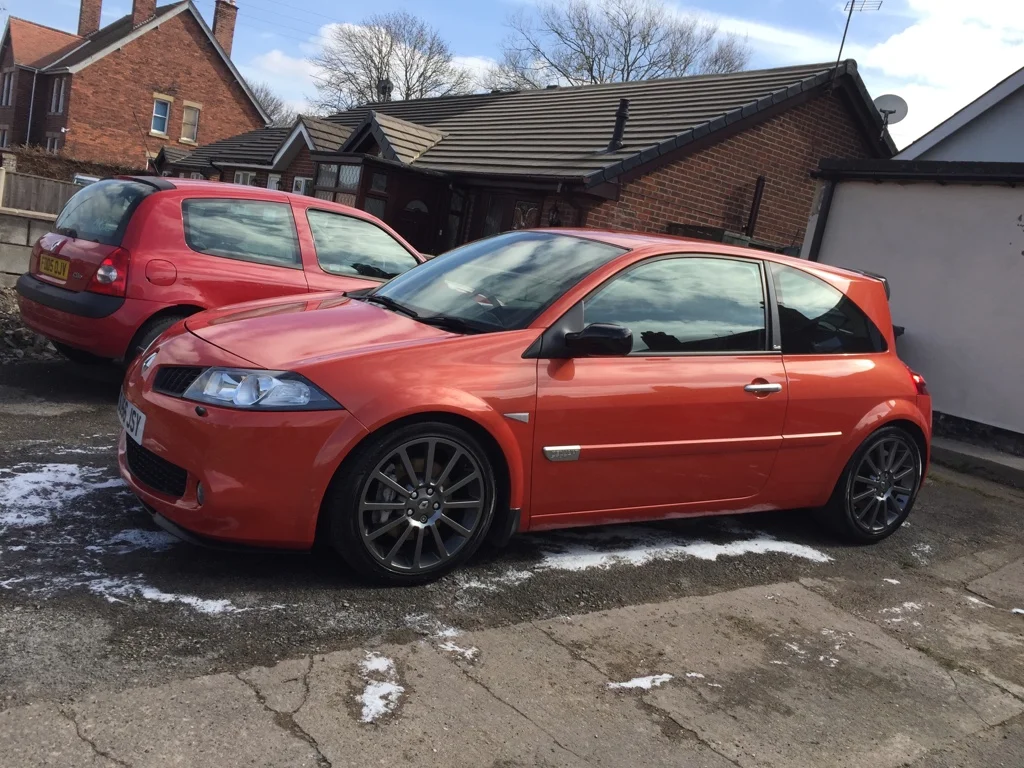

Jacob's Inferno 225 Cup

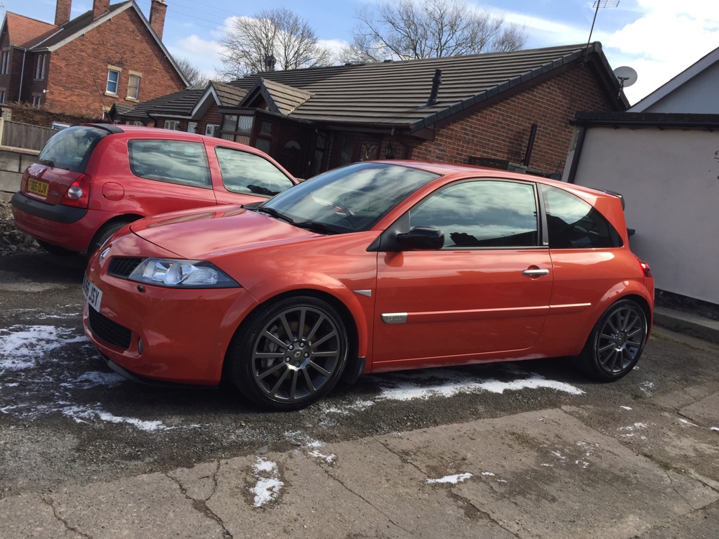

Not the best but the iPhone actually captured the colour.
2006 (56) Renaultsport Megane 225 cup.
Spec;
RS tuning stage 2 remap (270 bhp; 300 ftlbs
Manley forged con rods
ARP bolts.
Ktec FMIC
Ktec 2.75' cat back exhaust
Forge actuator & recirculating valve
Samco boost hoses (black)
ITG induction kit with enlarged cosworth filter.
Rstuning 3' decat
630cc injectors need fitting.
Lowered recaro subframe mounts, waiting for custom graphics for the sides.
New tre's.
New twist links and stabilisers.
New tfd steering rack bush.
Goodridge braided brake lines
R26.r headlights
R26 shocks & cooksports springs.
Carbon fibre R26.r spoiler
55w 6000k HID kit
Things todo; replace carbon spoiler for inferno spoiler.
Return mirror caps to inferno.
Full brake setup and refurb of callipers and new disc & pads.
The car now drives effortlessly smooth after changing the twist links and rack bush, everything feels tight and perfect.
The lowered subframes have change the drive of the car, instead of feeling like I'm on the car, I now feel in the car and planted nicely. with the cooksports and new tyres fitted the car feels perfect, the drive is fantastic and back to being fun.

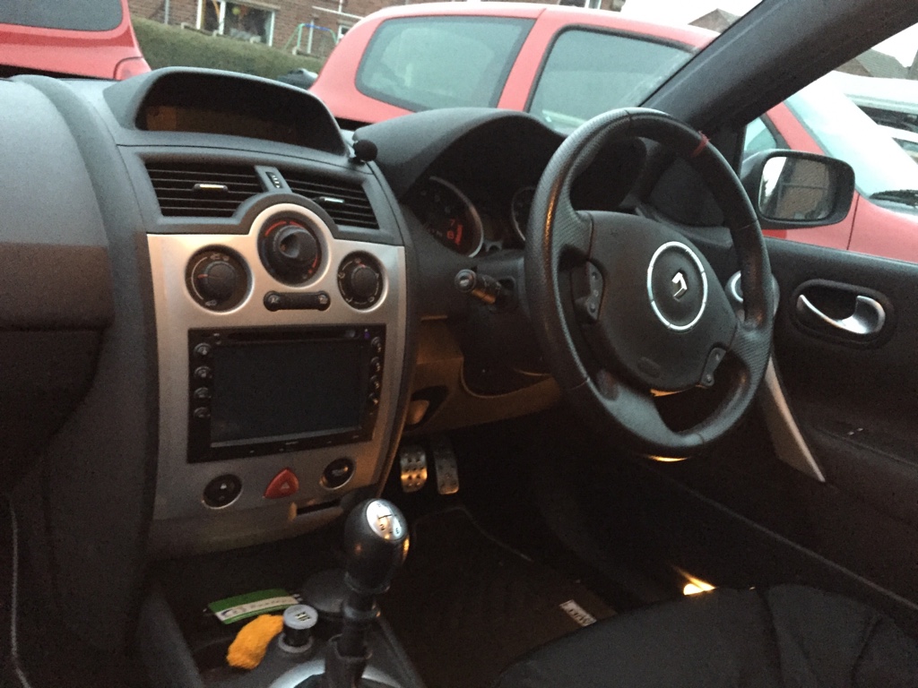

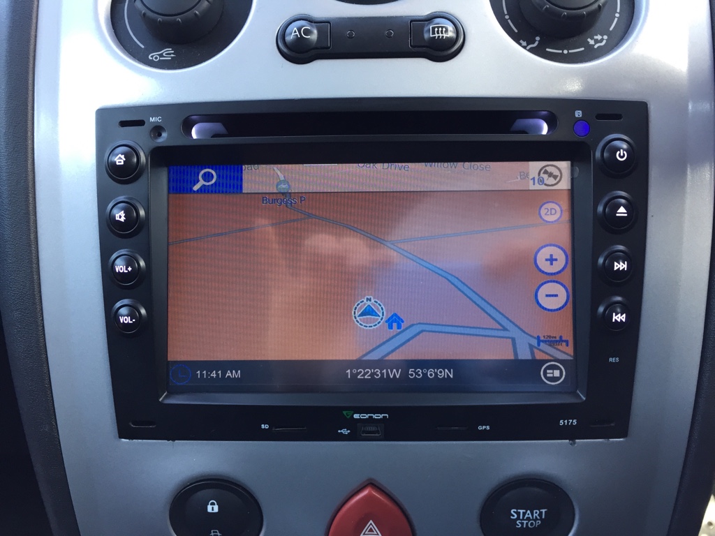

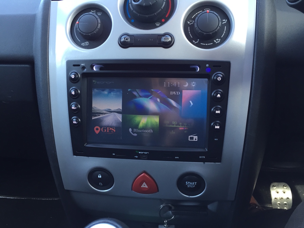

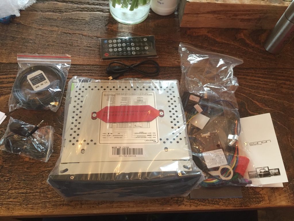

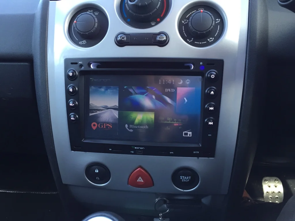

Stereo. I've gone for this one as its made for the Megane in mind and keeps all functions plus a lot more that can be wired in, also has satnav and gps.

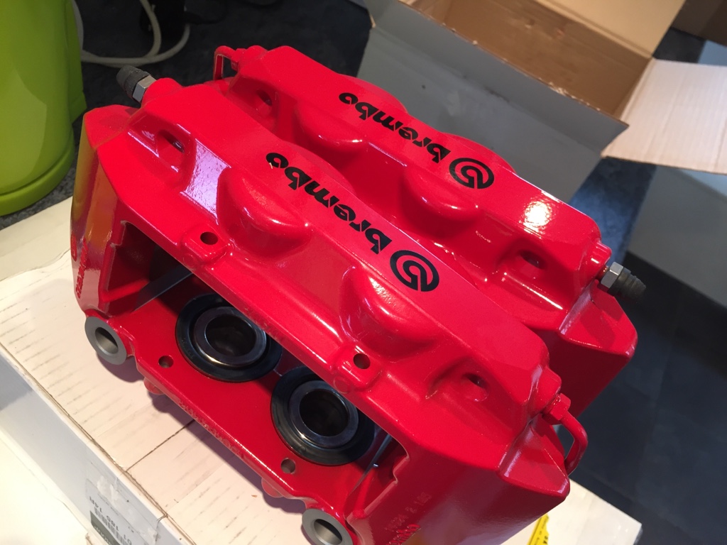

Not the ones, I've ordered brand new ones from ads and got myself a second set of rears to be rebuilt and sprayed red.
Also new disc and pass to be fitted along with brake fluid change.

Stereo. I've gone for this one as its made for the Megane in mind and keeps all functions plus a lot more that can be wired in, also has satnav and gps. View attachment 123960

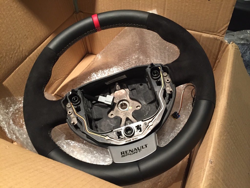

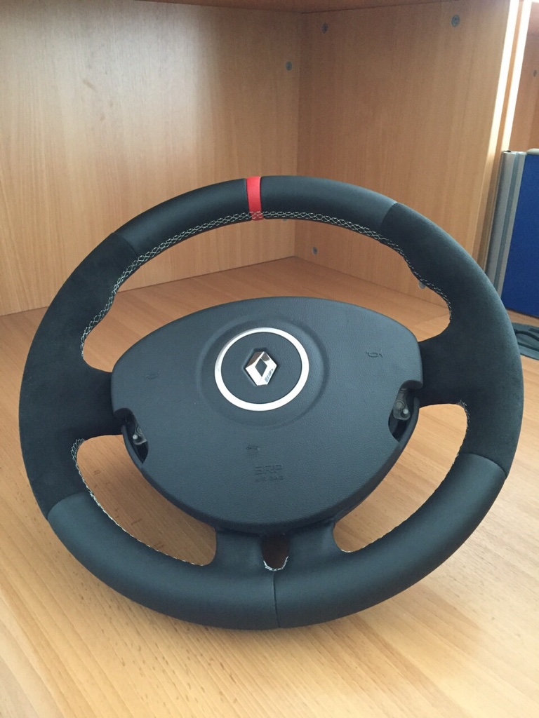

Collected the steering wheel.
That will be fitted when I tackle everything else.

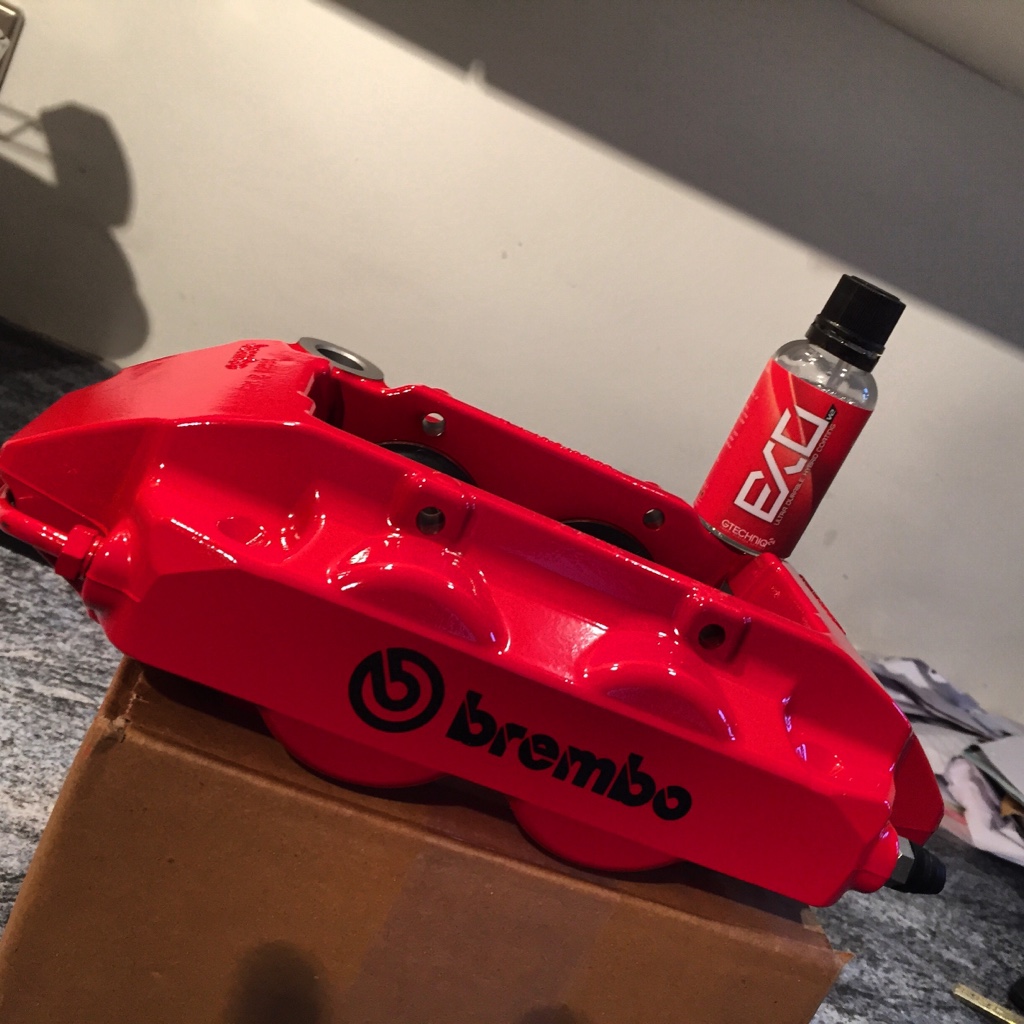

Also can any of you guys recommend a good sealant for the calipers? Good durability to keep them protected?
Been taking to a lad feirny introduced me to, about a qauiffe and a custom exhaust; his work is second to none so hopefully and a better system on.:)
G-Techniq C5 would leave them well protected.

I'm not sure what I'd go for. Itheyre going to get f**king hot, so most coatings won't last terribly long.
My first point of call would be car pro DLux, which is mainly a wheel sealant anyhoo and copes very well with those kind of temps.

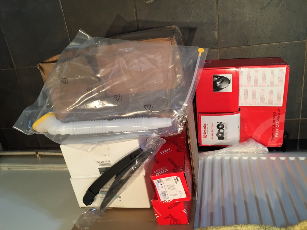

Another new addition.

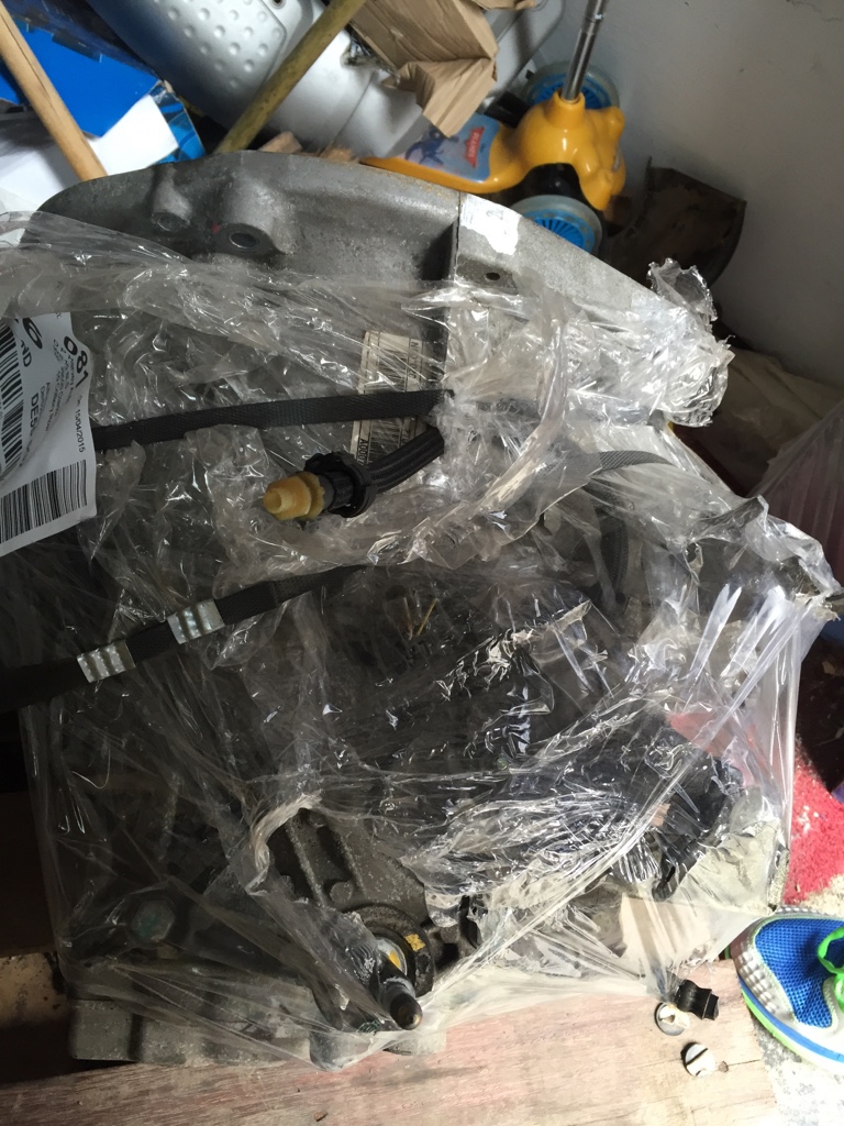

R26 box
Going for a check over just to be on the safe side, if anything needs replacing I've told the guy to do so.

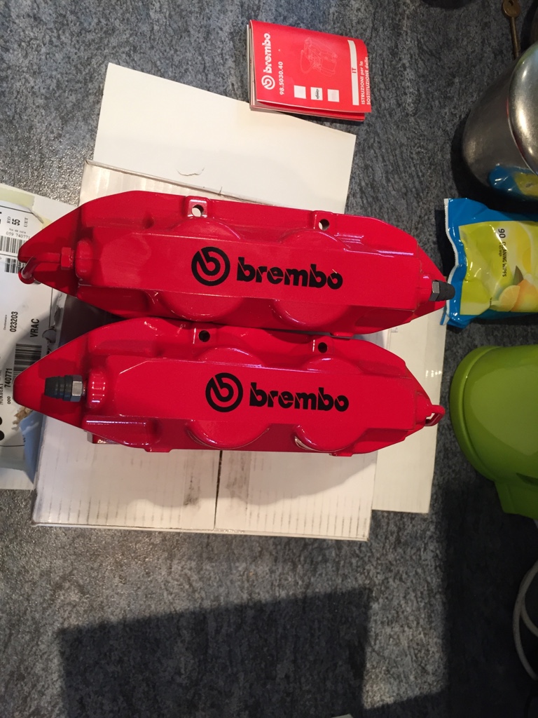

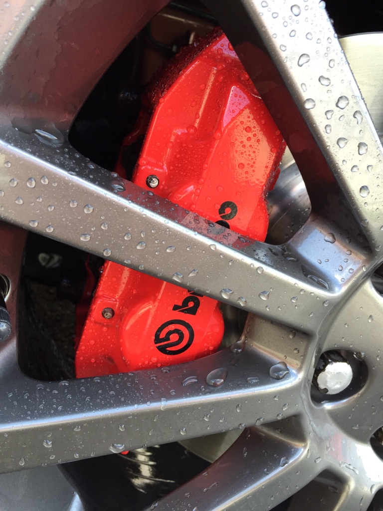

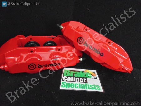

Brembo's are being protected with exov2, 2 layers should do it.

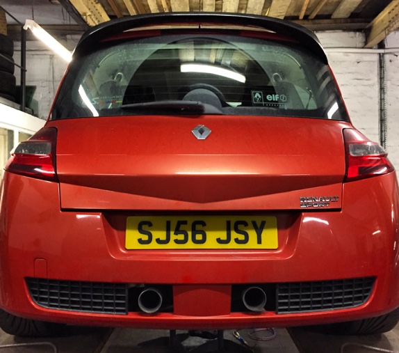

Exhaust, K-tec exhaust is going and I'm having a custom 3' system with tips that angle up like samimi's

Rebuilt r26 gearbox and lsd fluid.
New brembo's calipers with rbf600 fluid along with new brembo's disc and ds1.11 pads.

New steering wheel.

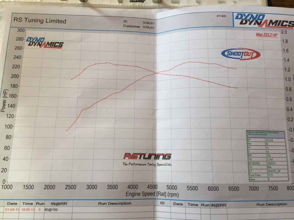

Like a muppets I missed off about my trip to rstuning last week.

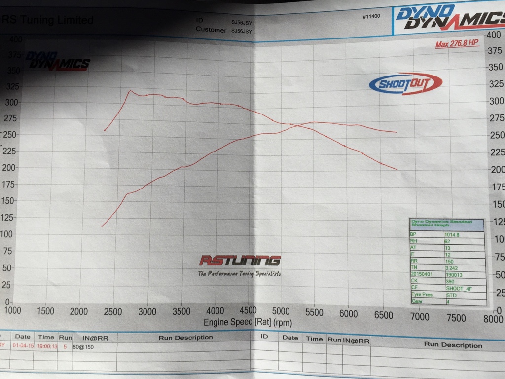

The car mapped 277bhp -325lbft, not that all impressed tbh wanted more so a 250 turbo will definitely let me see 320-350.
Any whose, sealed 1 calliper as I had s bit of time [emoji50] it took me 45 minutes to wipe down with isopropanol, then used applicator and cotton bud to apply exov2, going to give both 2 coats of it.

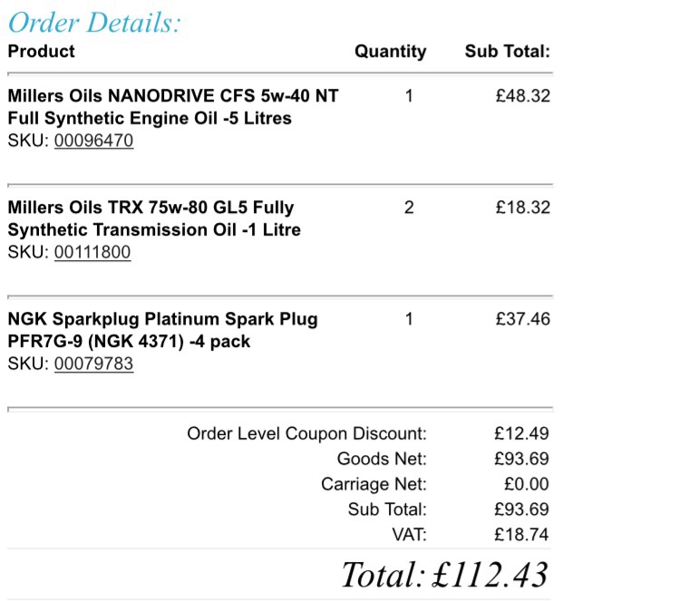

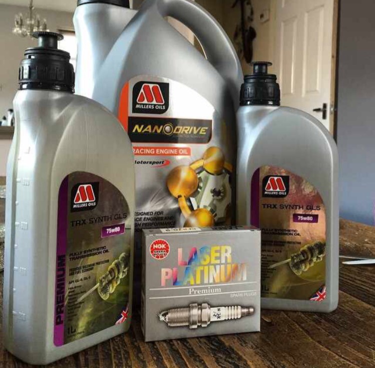

Treated to some new oils and plugs, think I need to give the spending a break @ .Stevo.c.
Mapping graph.

Service: change oil and plugs to millers nano drive and new ngk plugs.

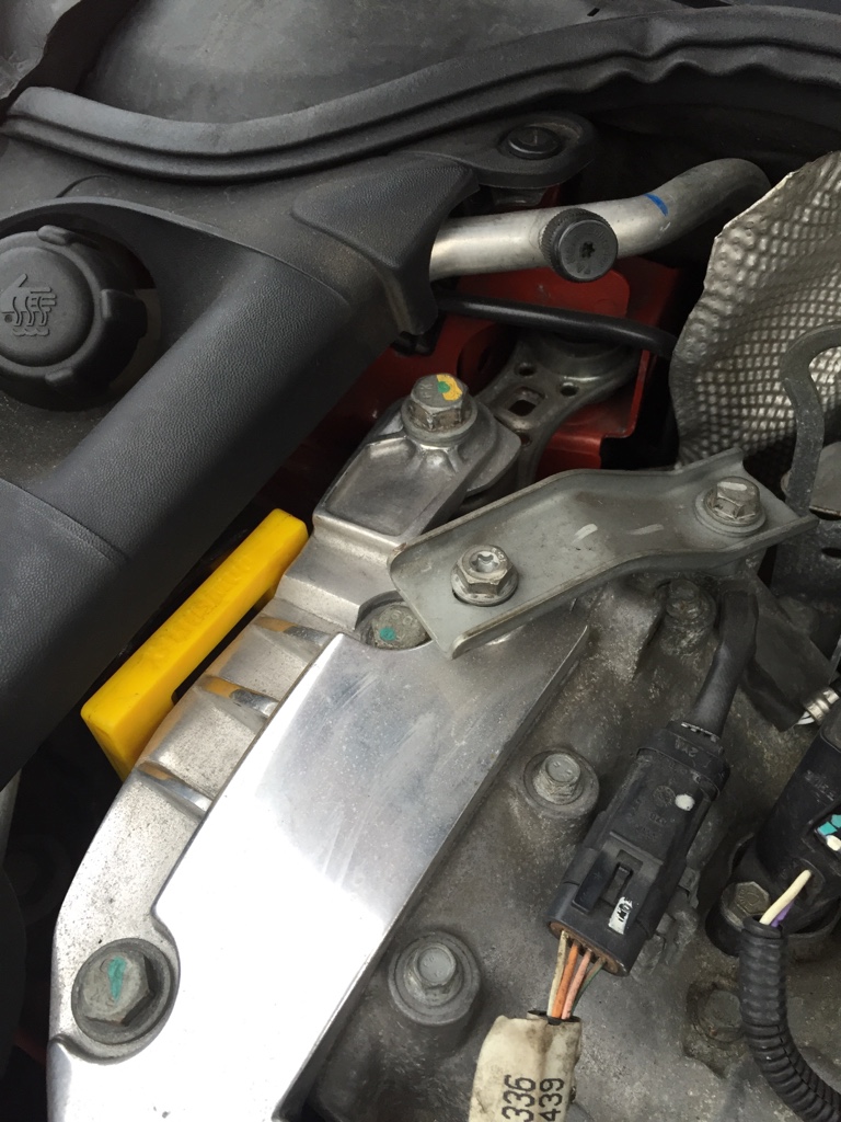

Fit all my powerflex engine mounts.
not a great pic.

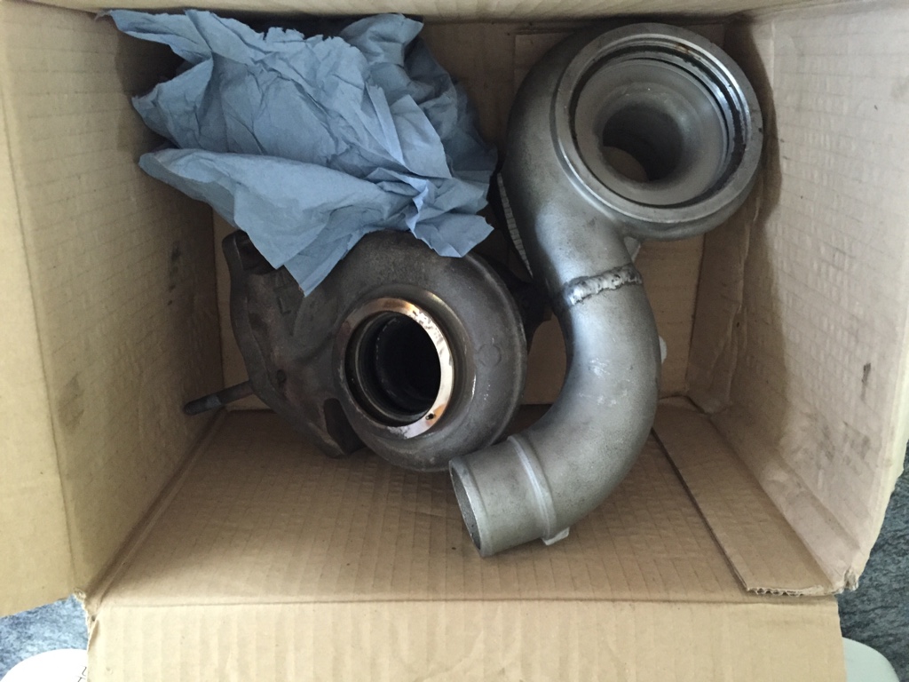

Been messaging MJ about his 16t hybrid, we agreed a price and he kindly dropped it off for me last night.
As I''m a little ocd about parts and not knowing much about turbos, just for ease of mind I dropped it off at midland turbos in Notringham, such a great service, rang them at 2 and told me to pop it in to them and have a nose over it and talk about what needs doing.
The oil inlet/outlets had been helicoiled and looked pretty weak so they're sourcing me a new or refurbished unit to replace it, not big deal rather it be 100% and guaranteed then fit it blind and find problems.
They're also going to changes seals which don't really need doing but he's said they'd that and the bearings for free, along with machines the blades a little for less back pressure which I think increases the flow through the turbine for less back pressure. Everything else is spot on and the machining on the turbo was perfect and smooth.
