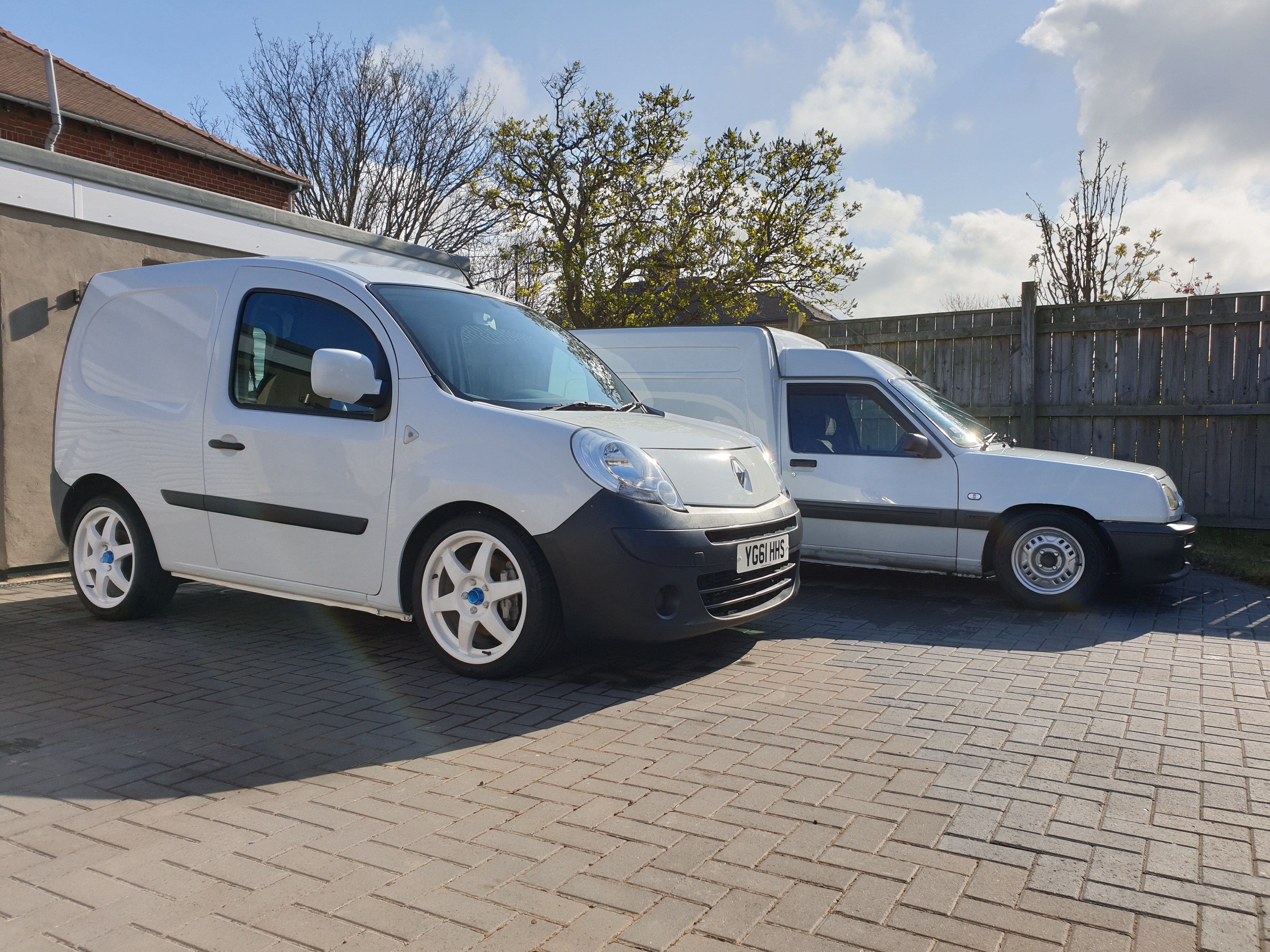

Kangoo Compact (aka Racevan3)
Brigsy
  T.Turbo

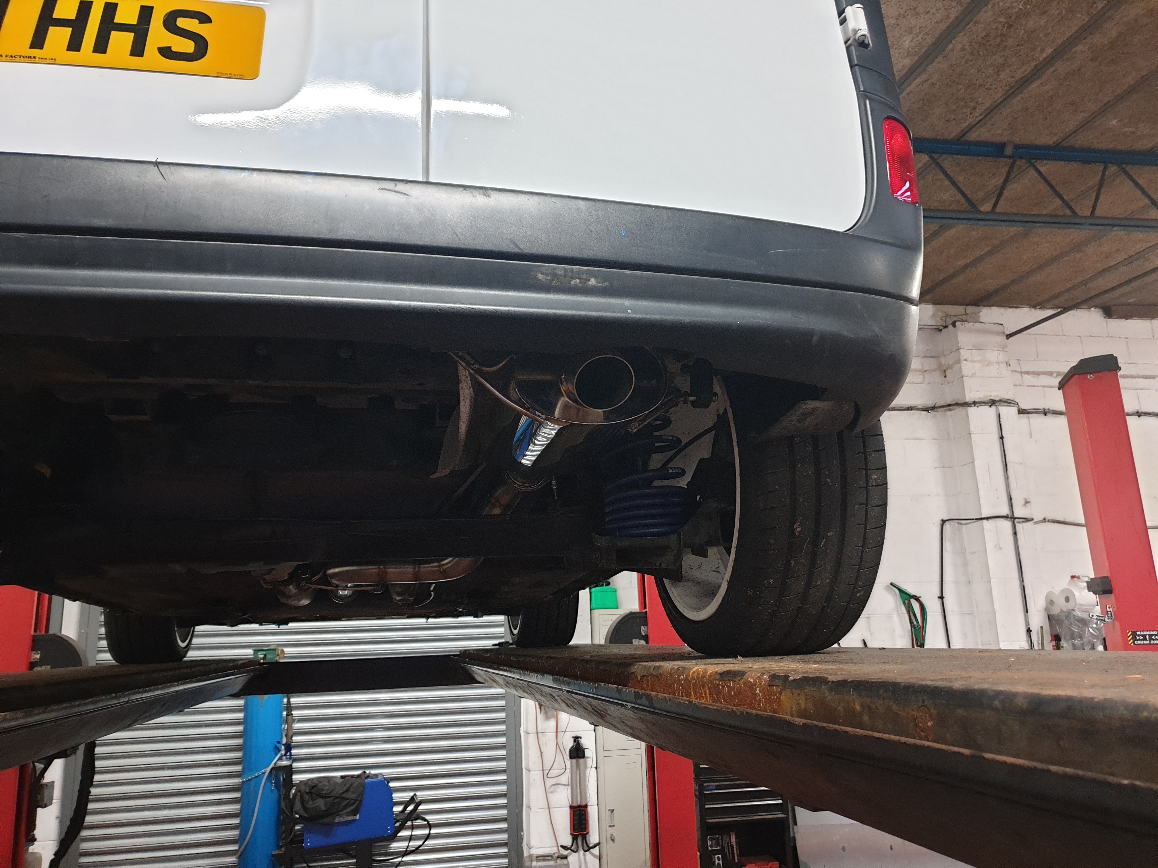

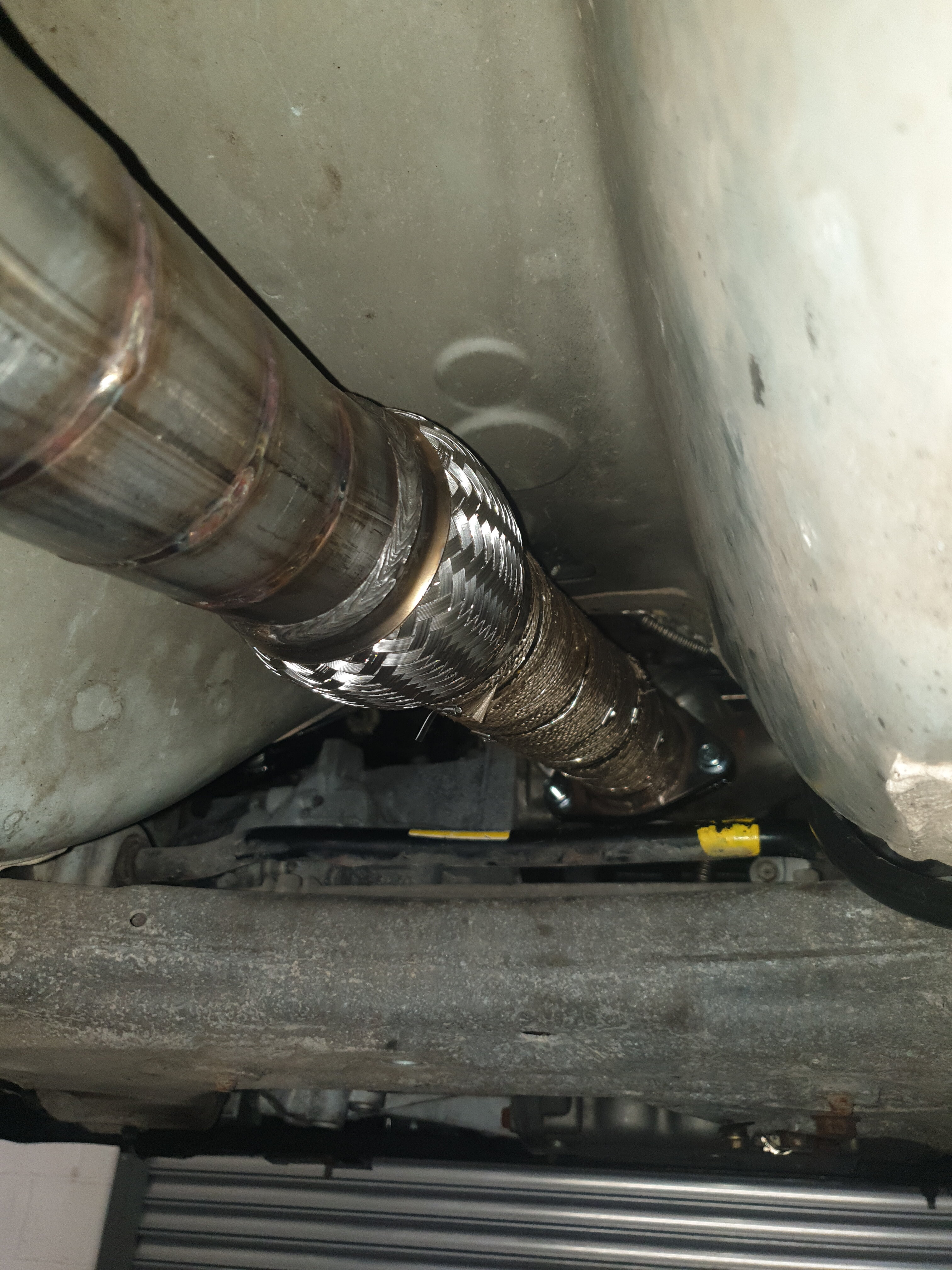

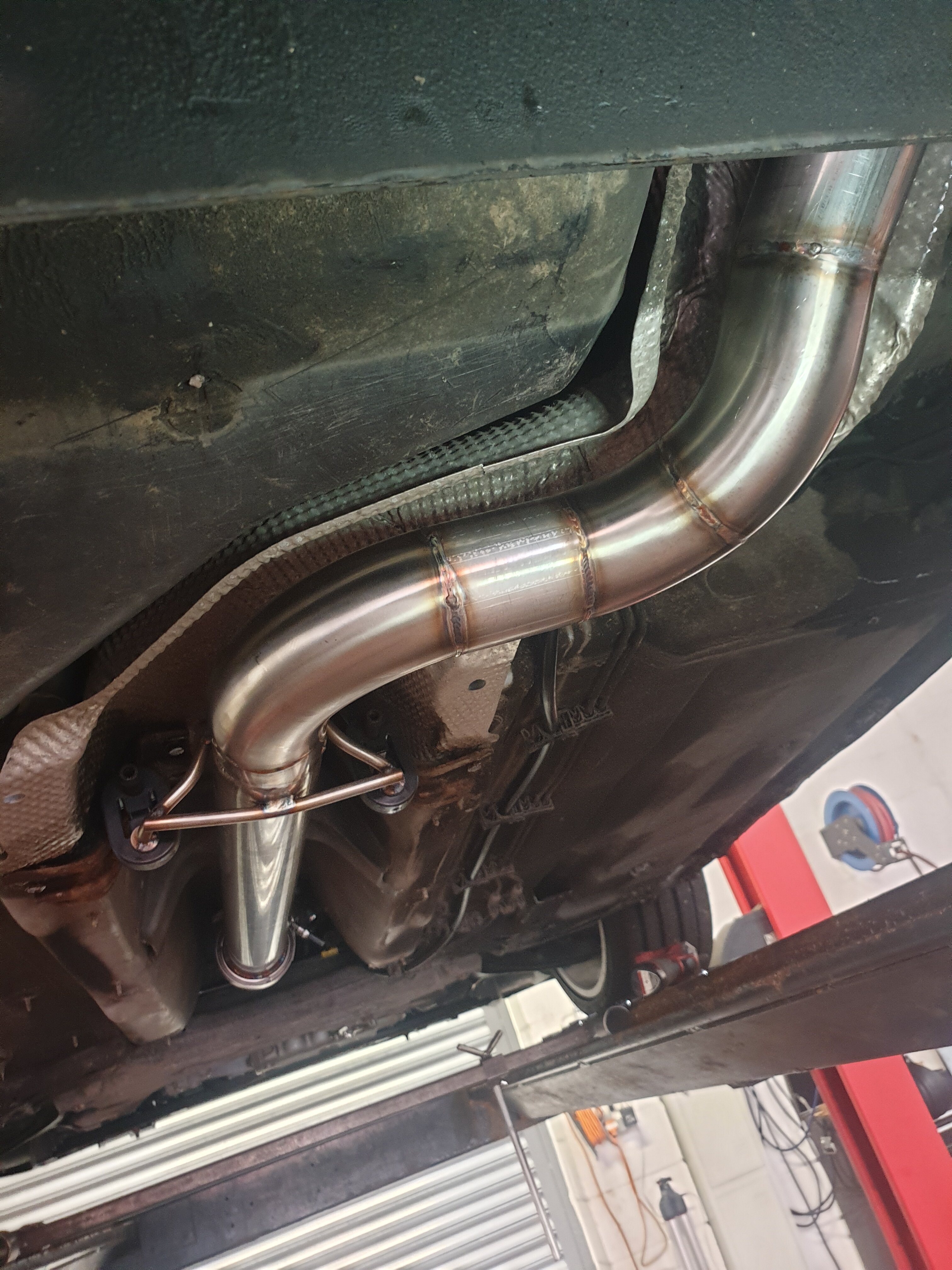

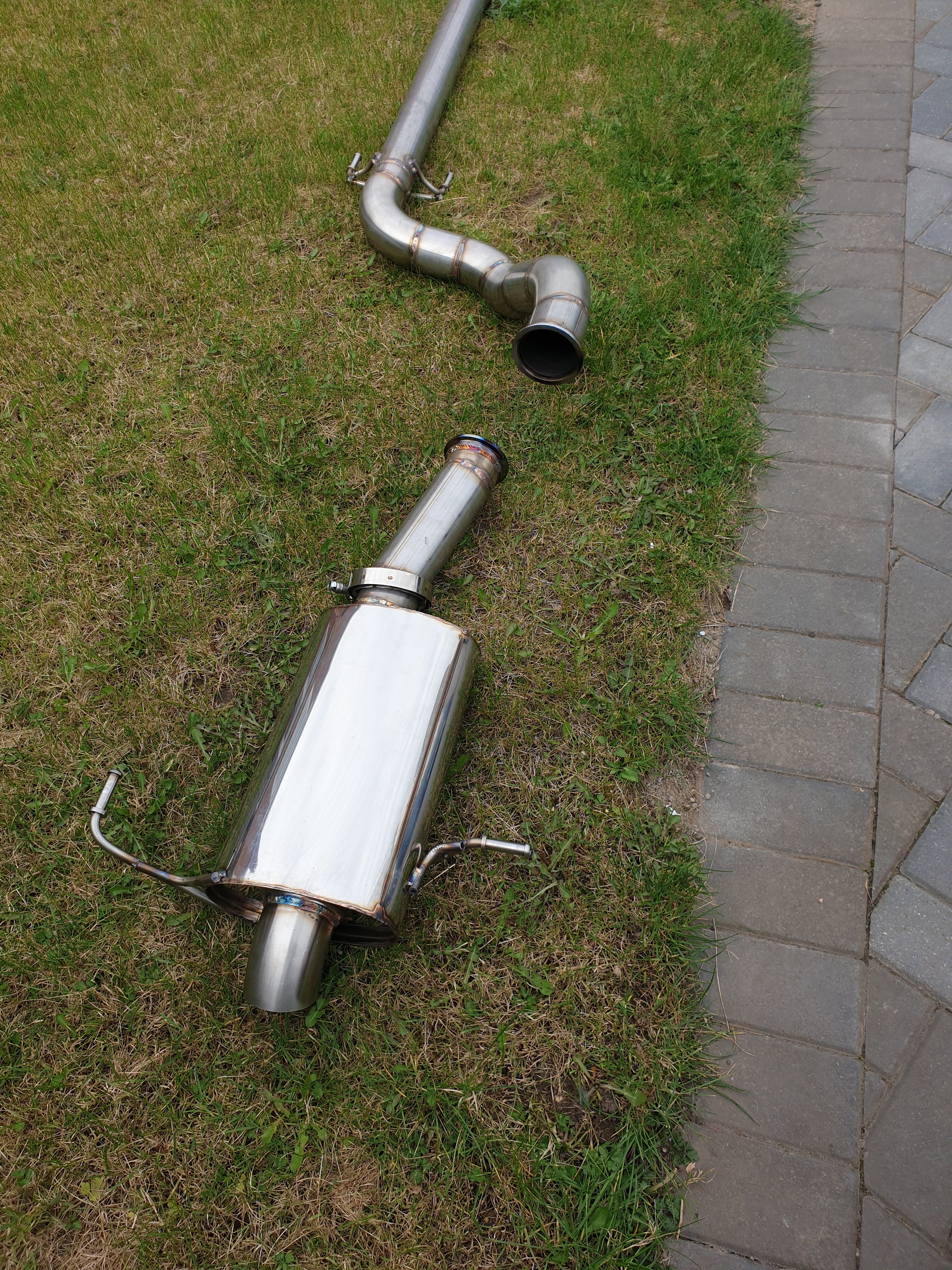

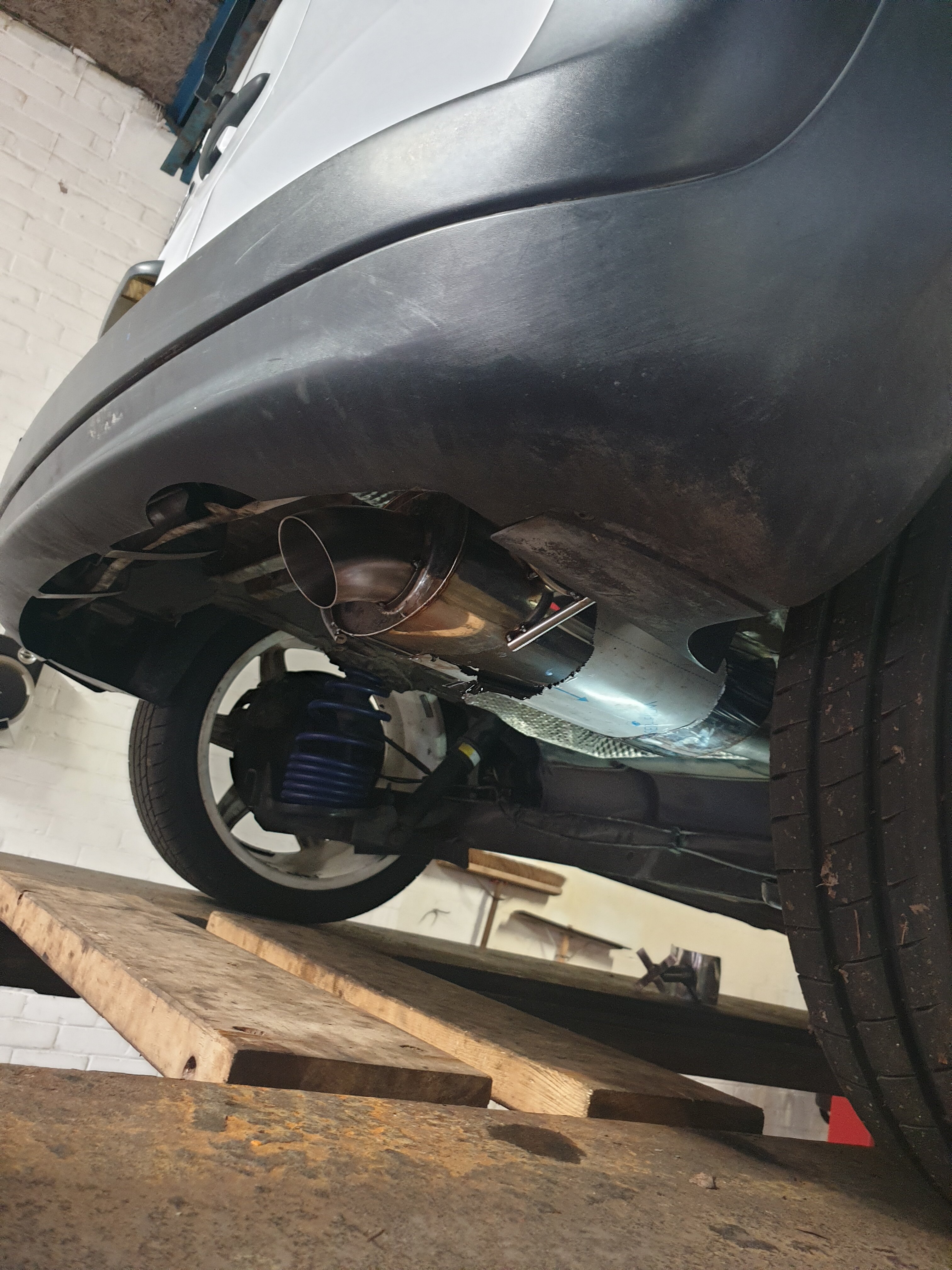

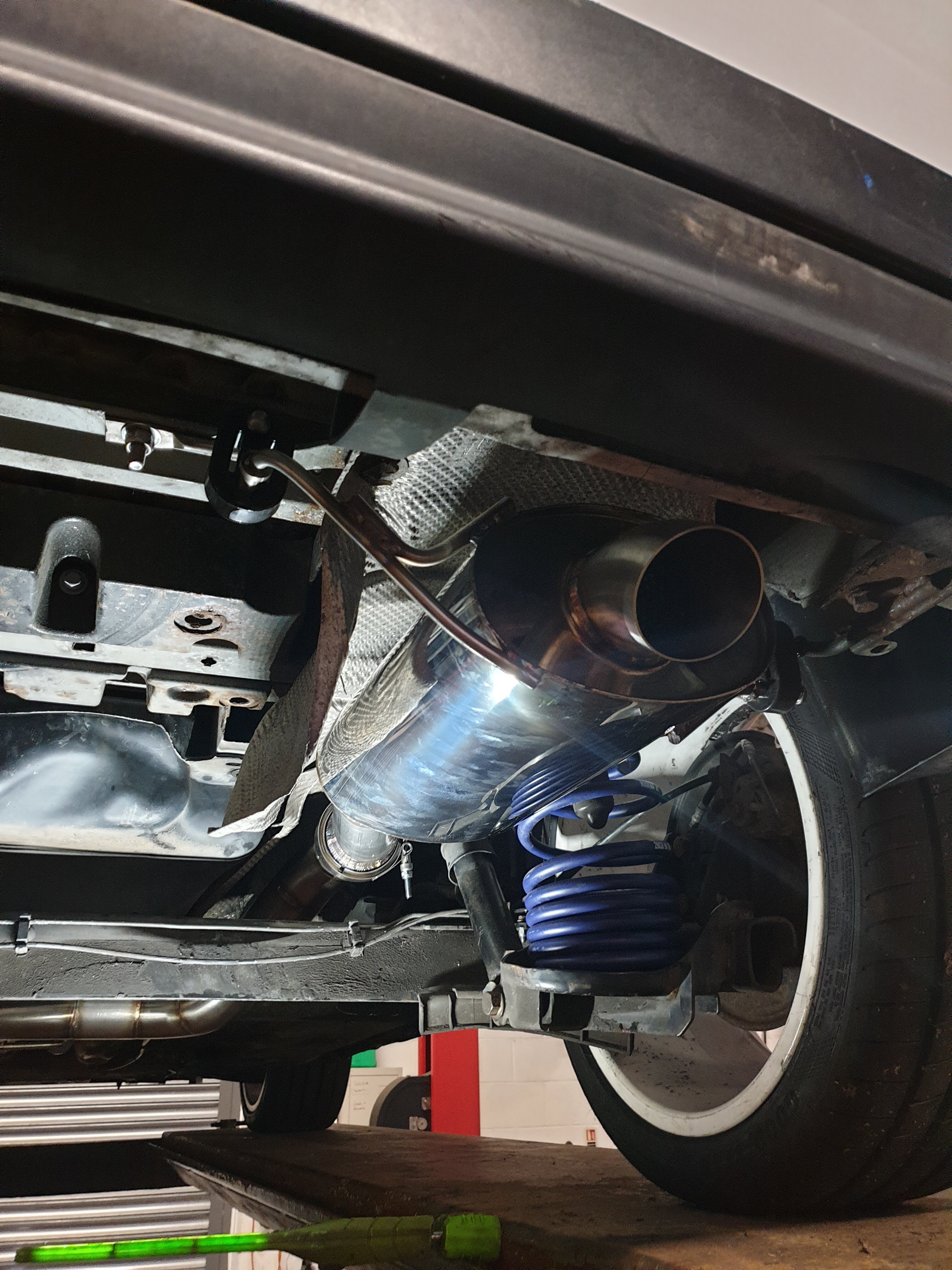

Had the Kangoo in for exhaust yesterday. As it only had a decat on, i had a recovery truck booked to take it down. Sods law i got a text at the last min saying the truck had failed its mot badly (transit - rust), nobody else available and as id waited ages to get in and did not want to wait another month, ended up driving it down. 5 miles of noise, but on the plus side it drives absolutely bang on.

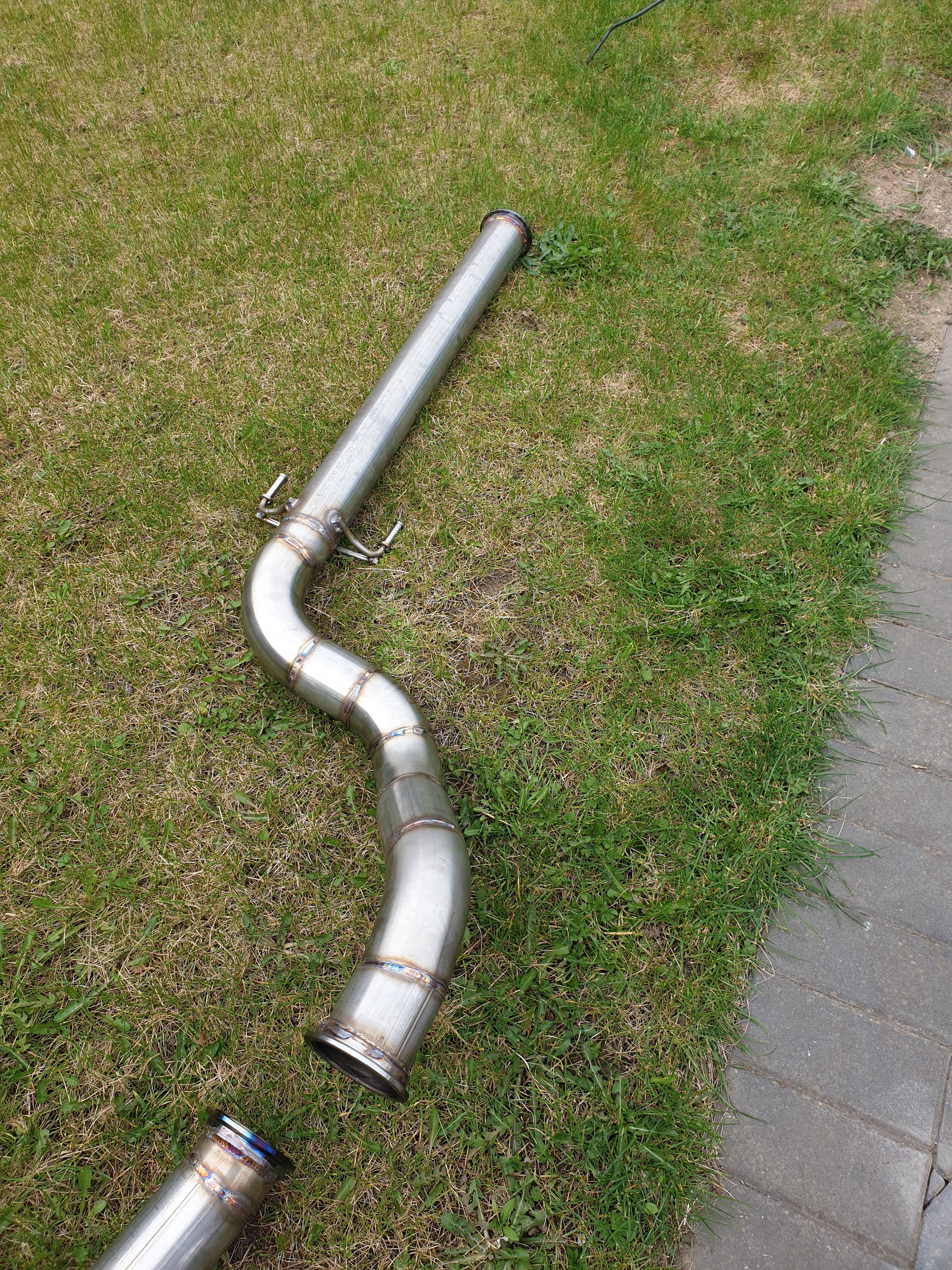

Arrived at Longlife Middlesbrough and straight on the lift. Asked for 3" stealth system with single silencer with v bands for ease of removal.

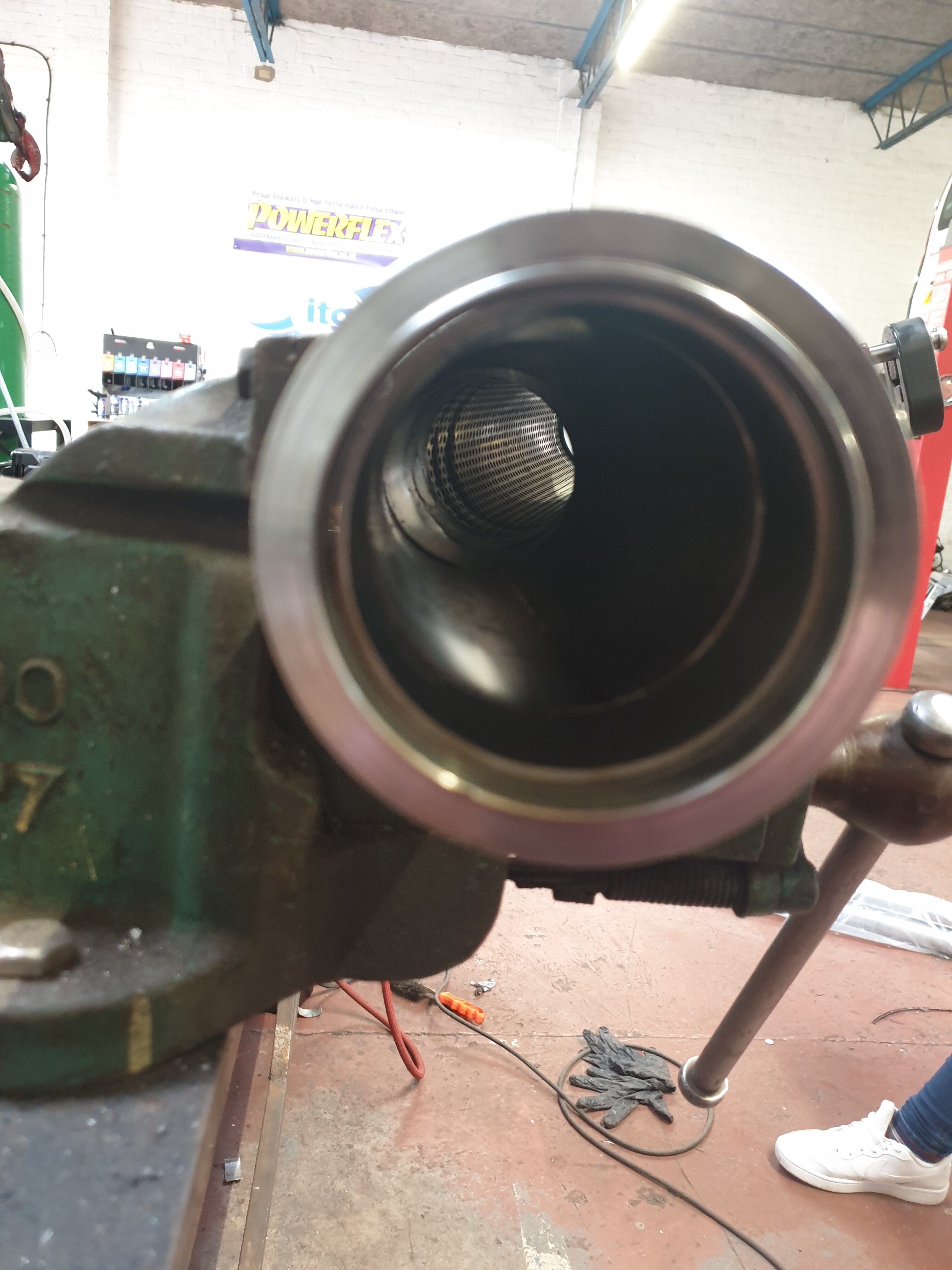

Megane Scorpion 3" front pipe needed a tweak as a bit close to the floor.

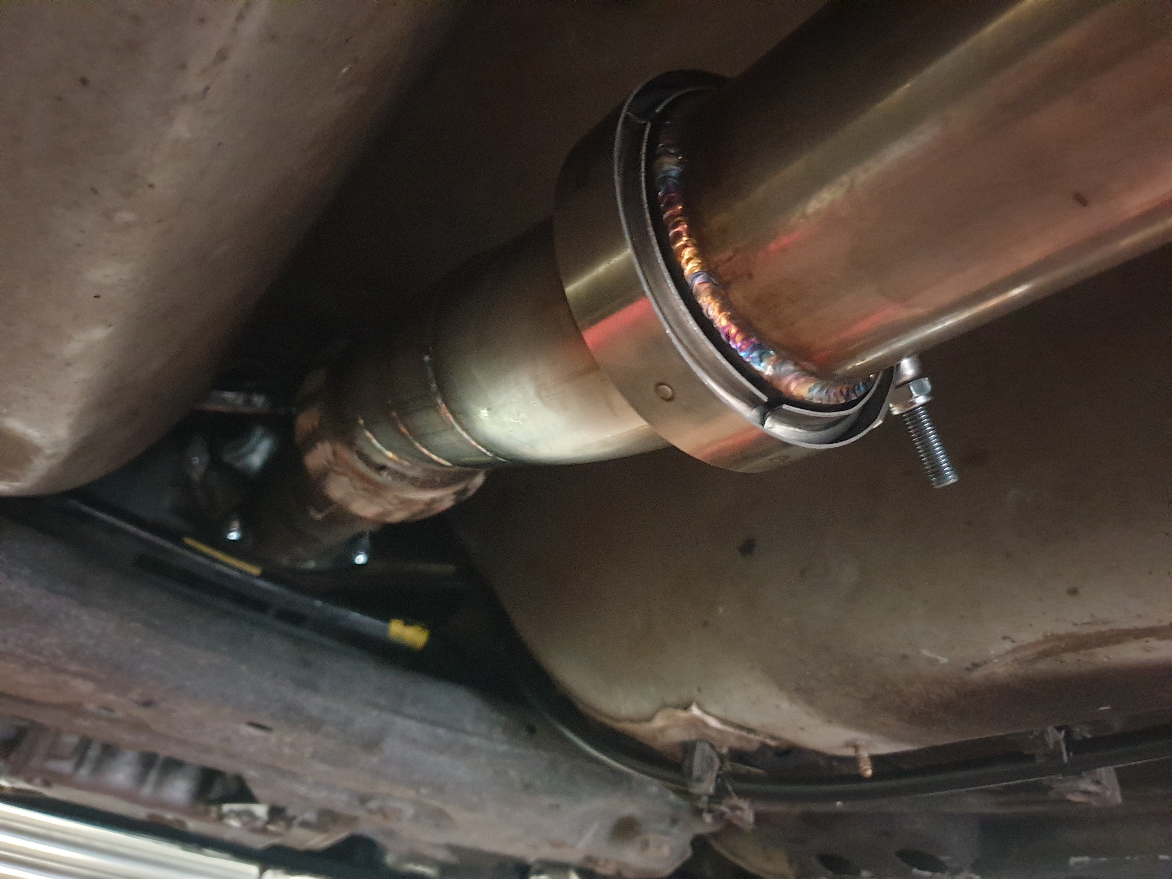

Vband and pretty tig welding

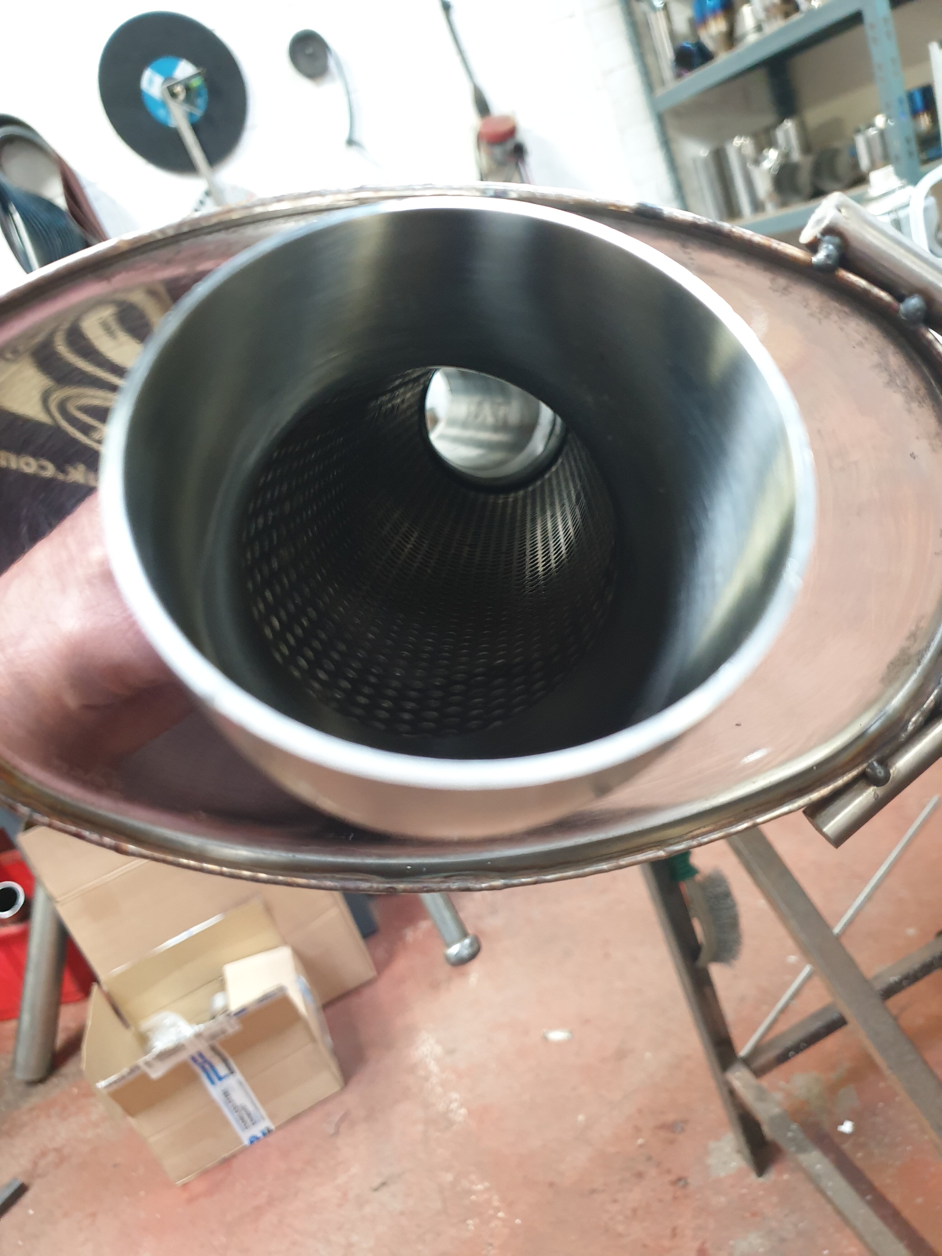

Mocking up backbox. Went for an offset baffle pipe to drop the noise a bit. Most megane systems use a small round straight through baffle piped silencer, which makes them loud as feck/bit washing machine sounding.
No restrictions here
Finished
Nice and discreet
Noise tested it and it should be ok for 90% of track static noise tests, i think it was 98db around 4500rpm.
Overall very pleased and great job/fitment.

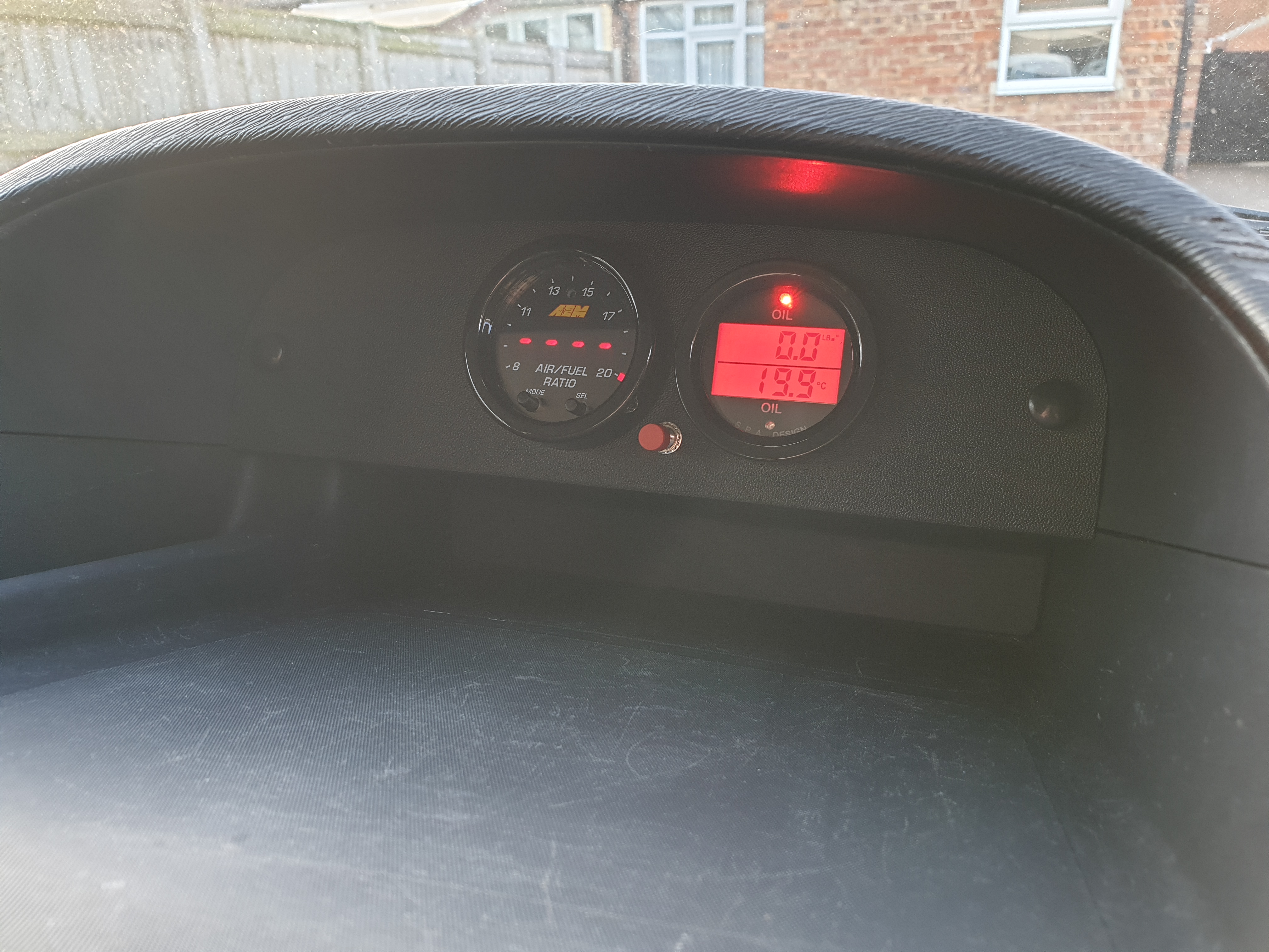

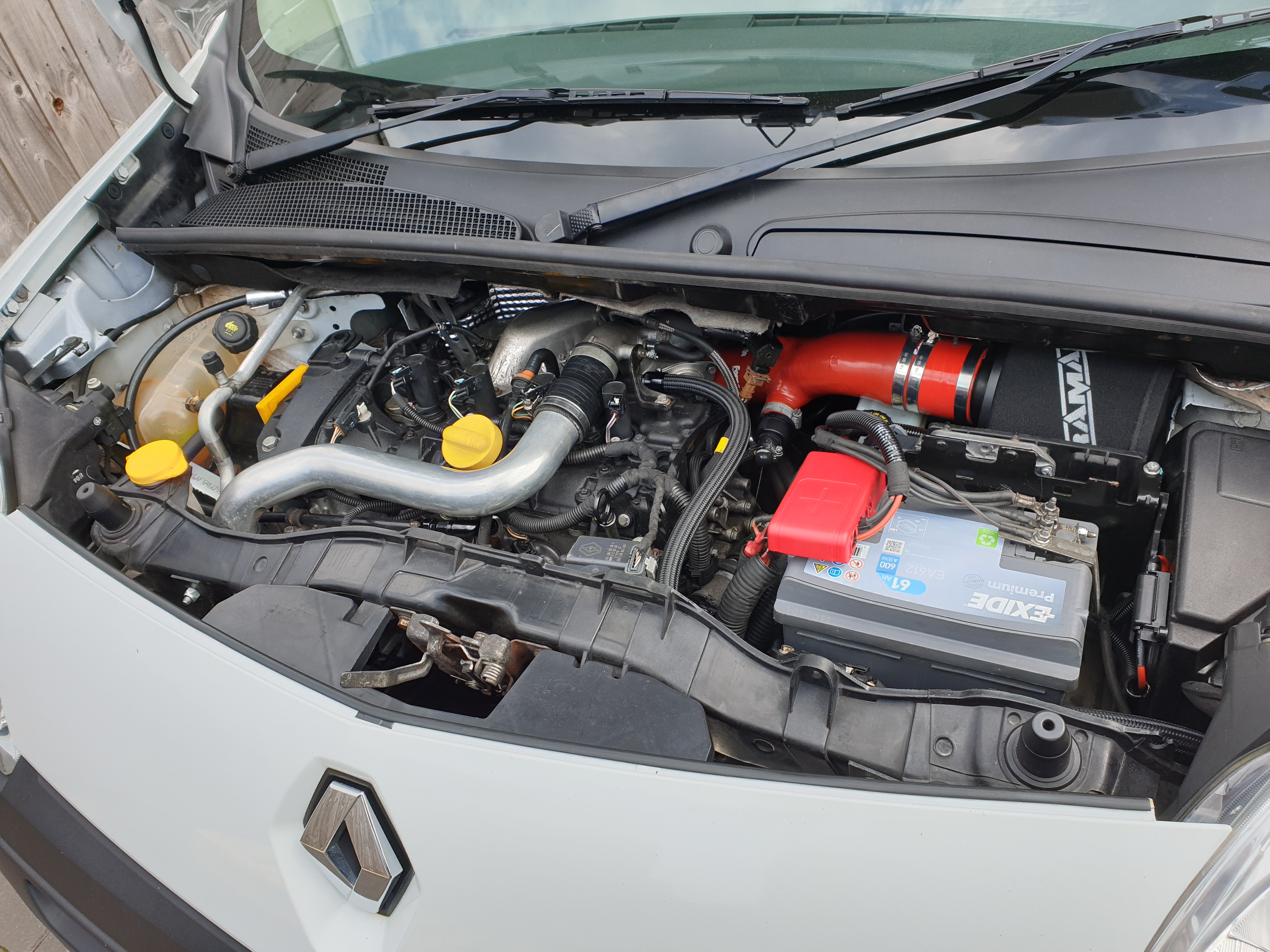

Weeks leave off work, so finally got my Aem afr and Spa dual oil pressure/temp gauge wired in.
Ive been putting this off as ballache to run wiring through to engine bay/up the dash. 8 hours later and done, had dash almost fully stripped to run wiring, as heater box is tight against the dash and almost no room to run wiring to the cubby hole. Front end off to get the sandwich plate plumbed in, and oil and filter changed for millers cfs motorsport 5/40.
Look good though, and work grand. Oil pressure seems good, ran it up to 75deg oil temp so not fully warmed up, its reporting 70lb pressure when revved to around 3k so cant be in too bad shape.

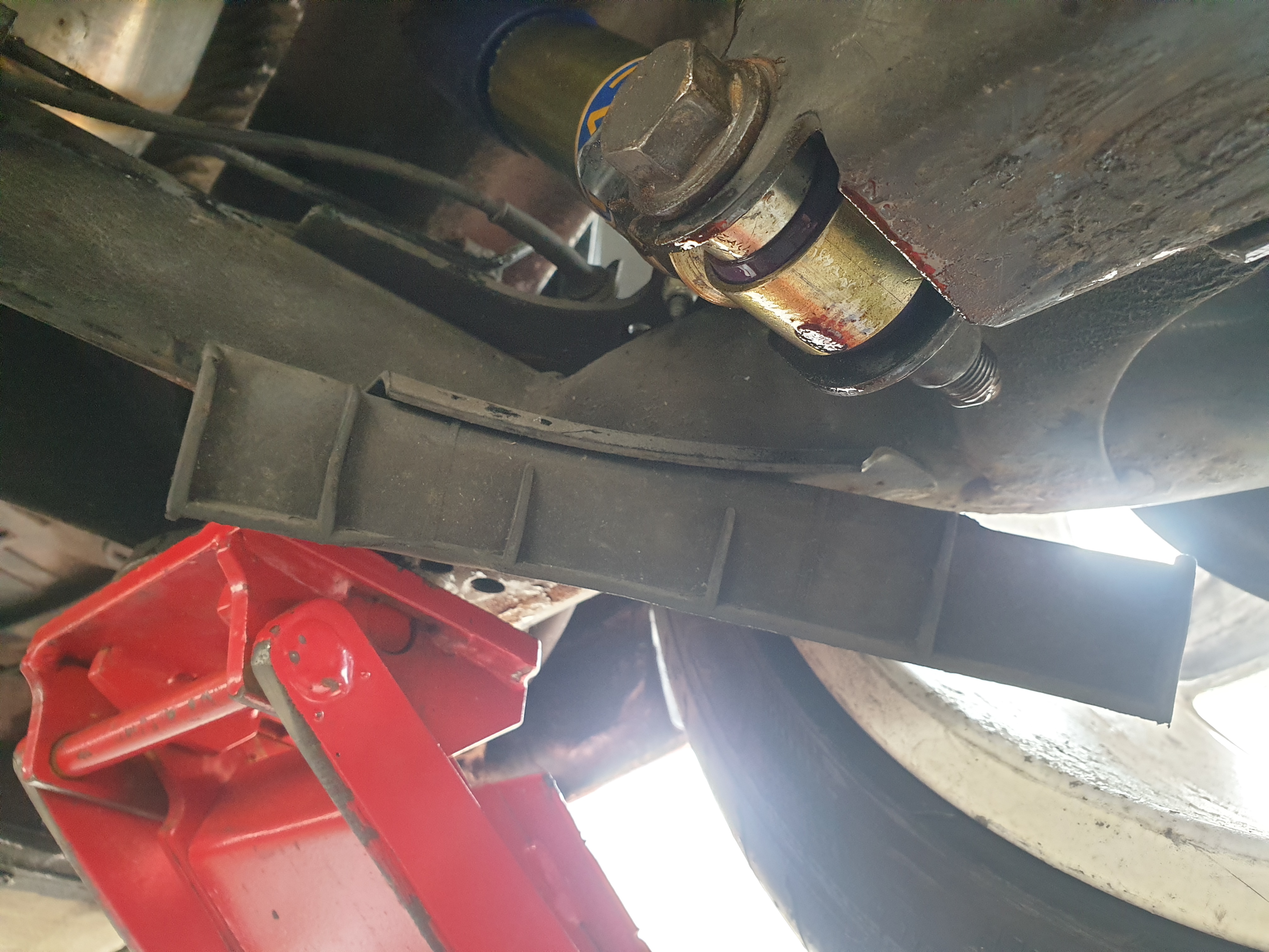

Straightened the front of the sills up yesterday from years of monkeys jacking it up incorrectly, cleaned up minor rust, zinc primer, epoxy mastic then painted white over the top.

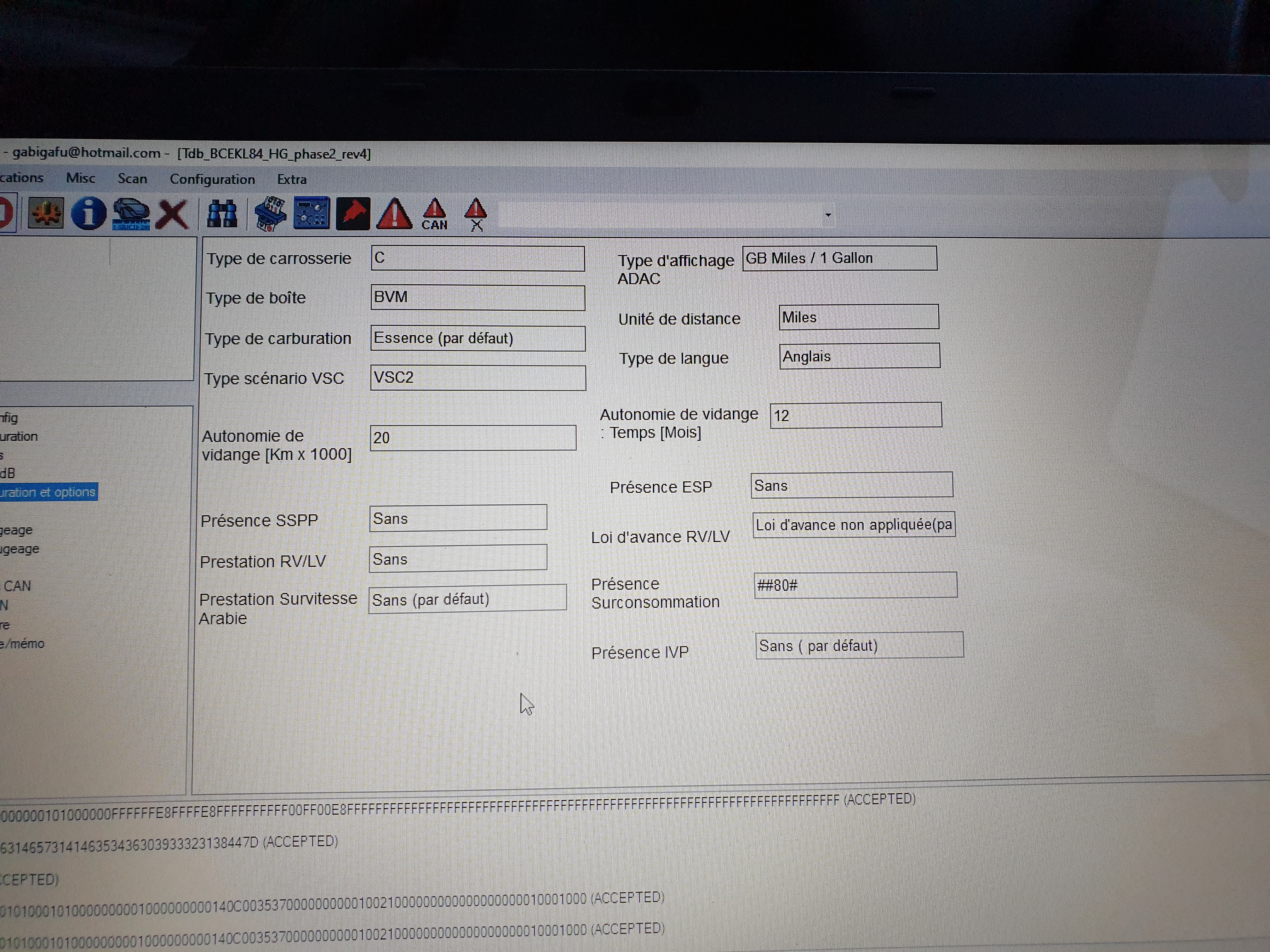

Logbook came back yesterday after a 3 week wait with 1998cc and petrol declared.
This is good news as i need the logbook to tax it, and last engine conversion i done with fuel class change took 3 months with Dvla losing the paperwork.

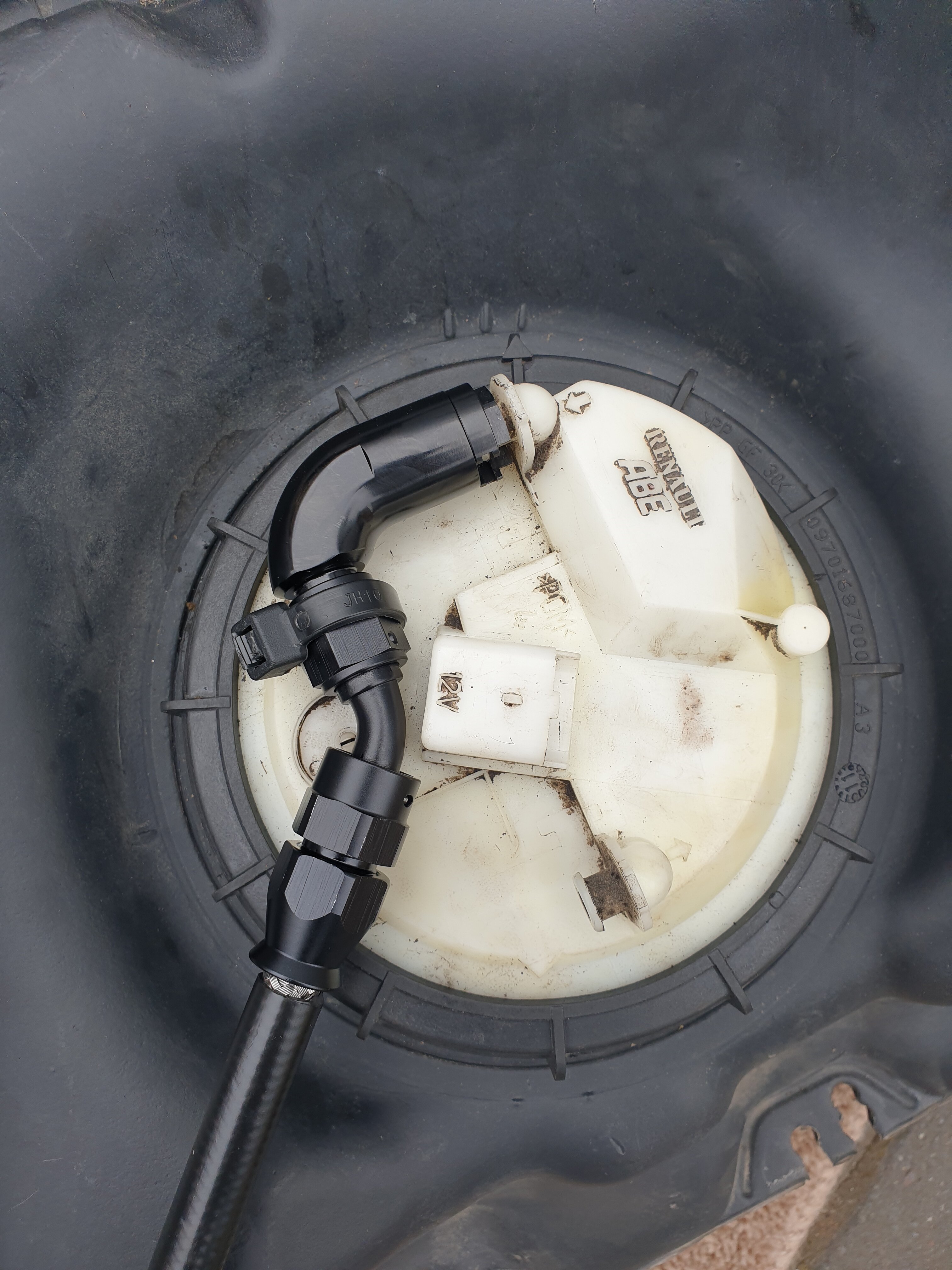

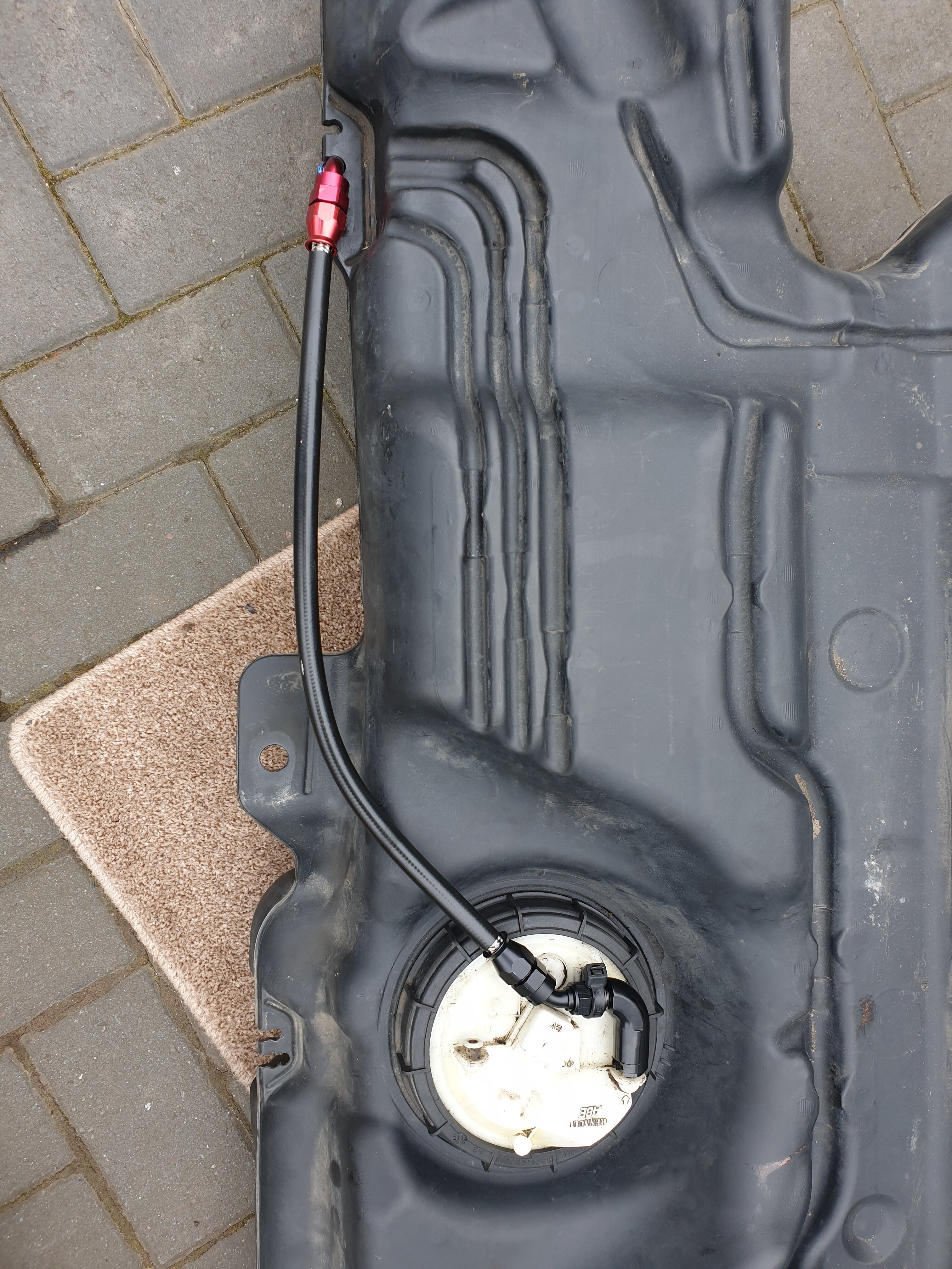

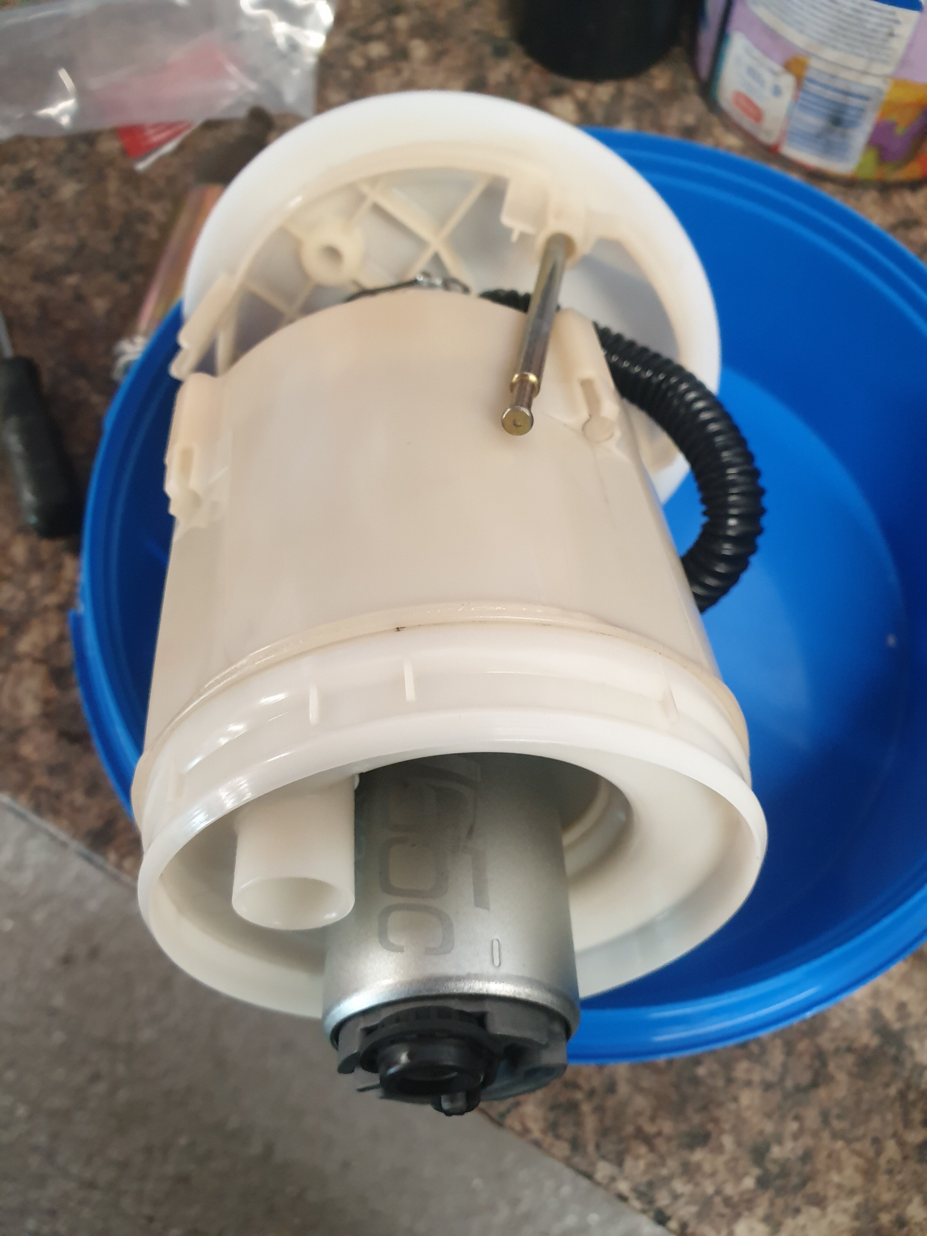

On Good Friday (fuel leak Friday!?) dropped the fuel tank to sort the leaking pipe.
Exhaust off in ten mins, so easy on vbands.

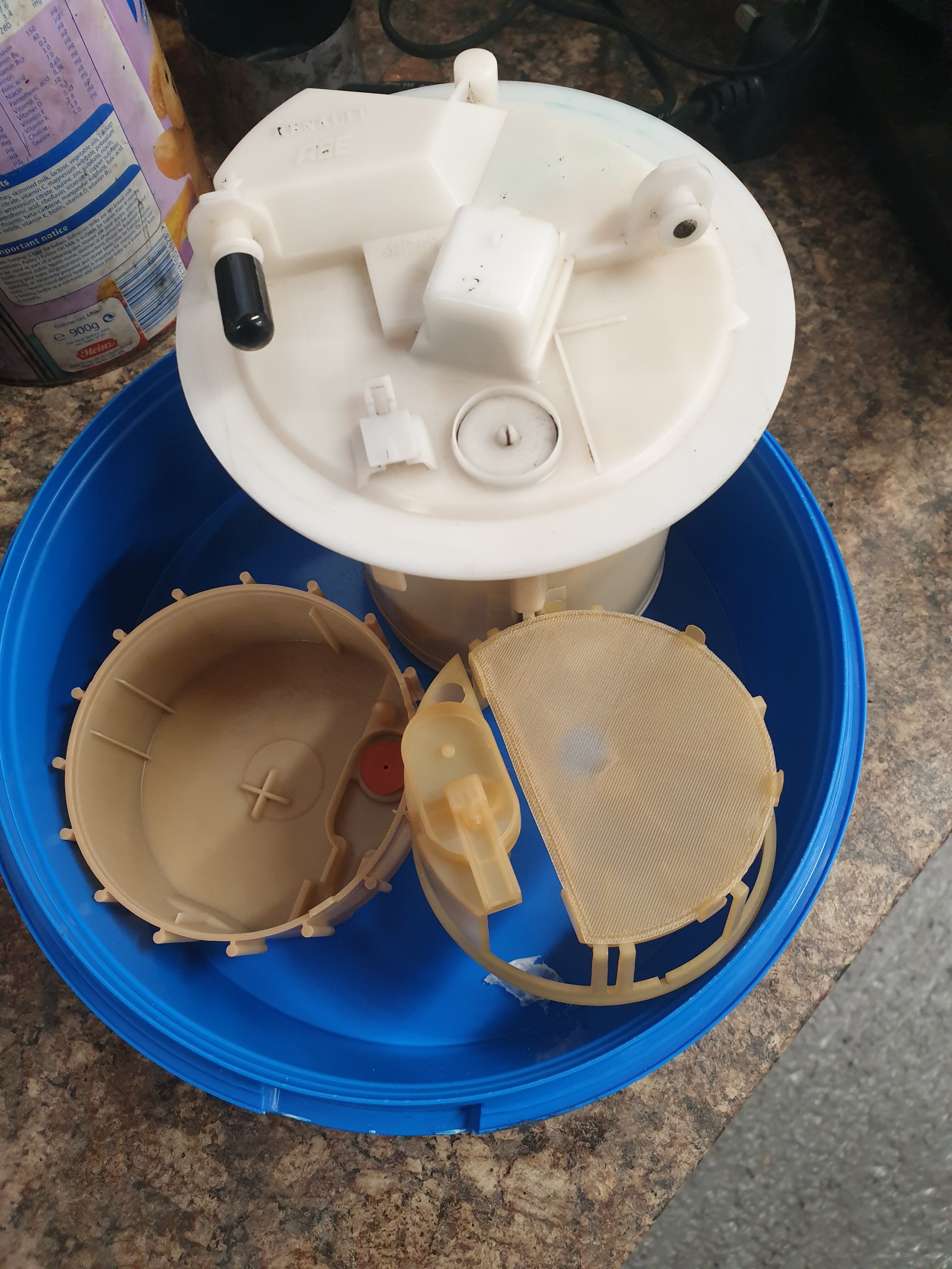

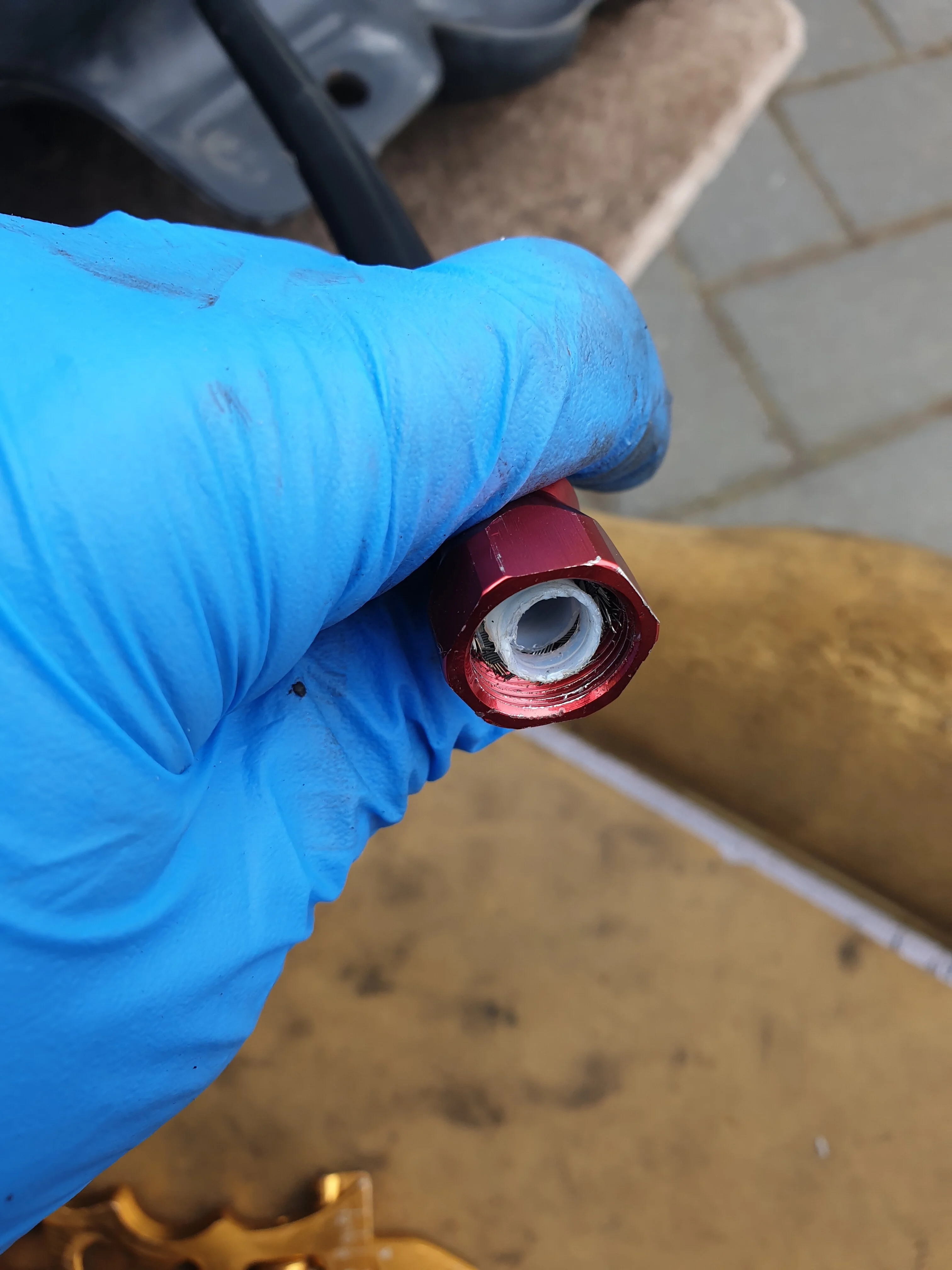

Tank off in 20 mins and could not immediately find a leak. I changed the tank sender fitting to a 90deg one and redone the sender connection, to make for minimum tension.
See the red/blue an fitting? That was an old ptfe fitting i used with a new insert.
Refitted tank/tested with pump on for leaks and the red 90deg fitting was leaking like feck.
Diagnosis, insert was incorrect and cut into the ptfe liner!? Ive made loads of an lines up over last 15 years and not had an issue.
Drop kicked the fitting, cut the hose and fitted a brand new 90deg fitting. Job jobbed, from now on will fit new fittings as not expensive.

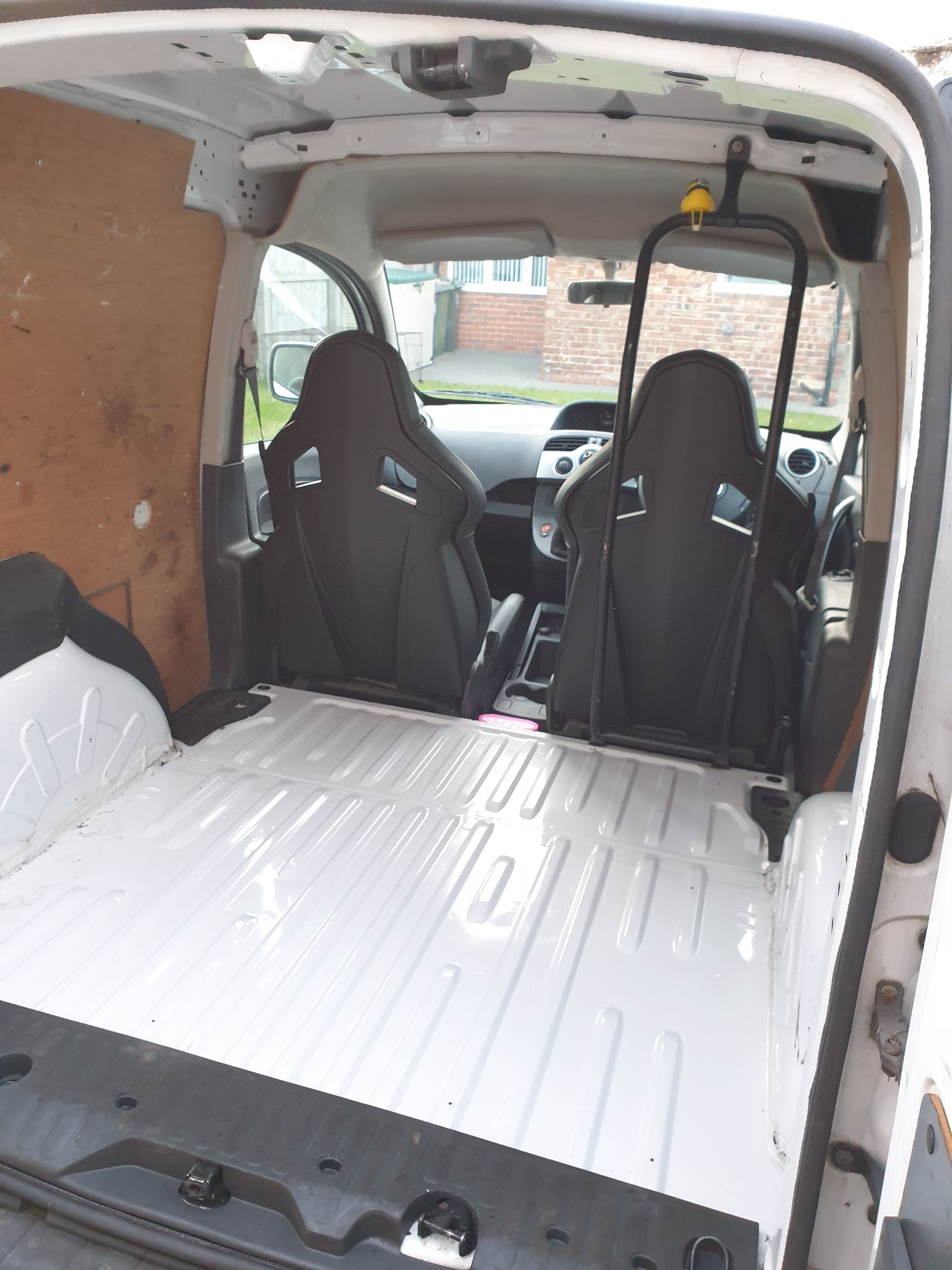

Fitted a new ply base to replace the knackered old one, and new ply on the rear doors

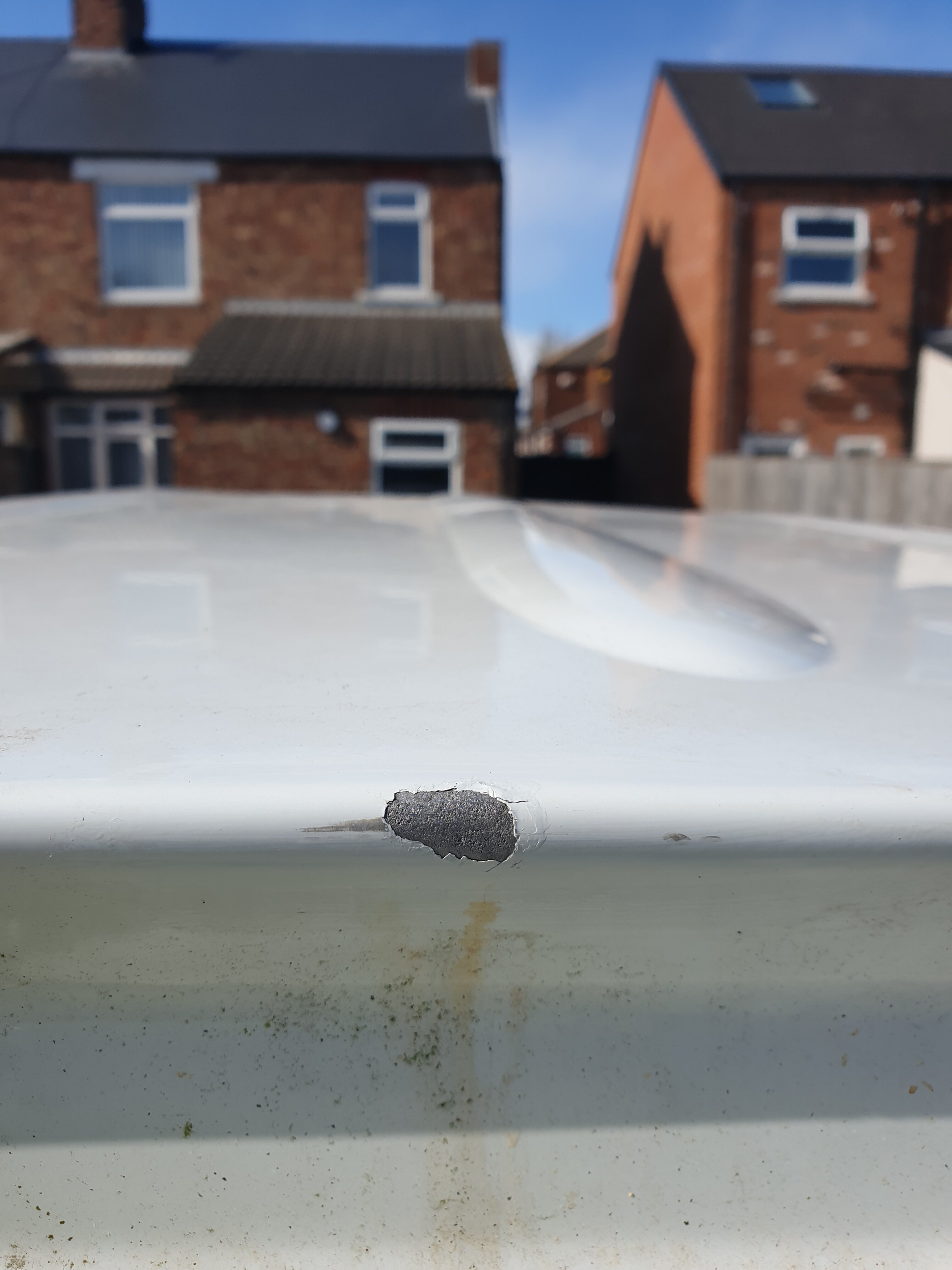

De rusted a small scab on the roof where paint must have been chipped off in the past. Applied Bilt Hamber deox c, cleaned up great. No finished pics but covered in hydrate 80, zinc primer then touched up with glacier white.

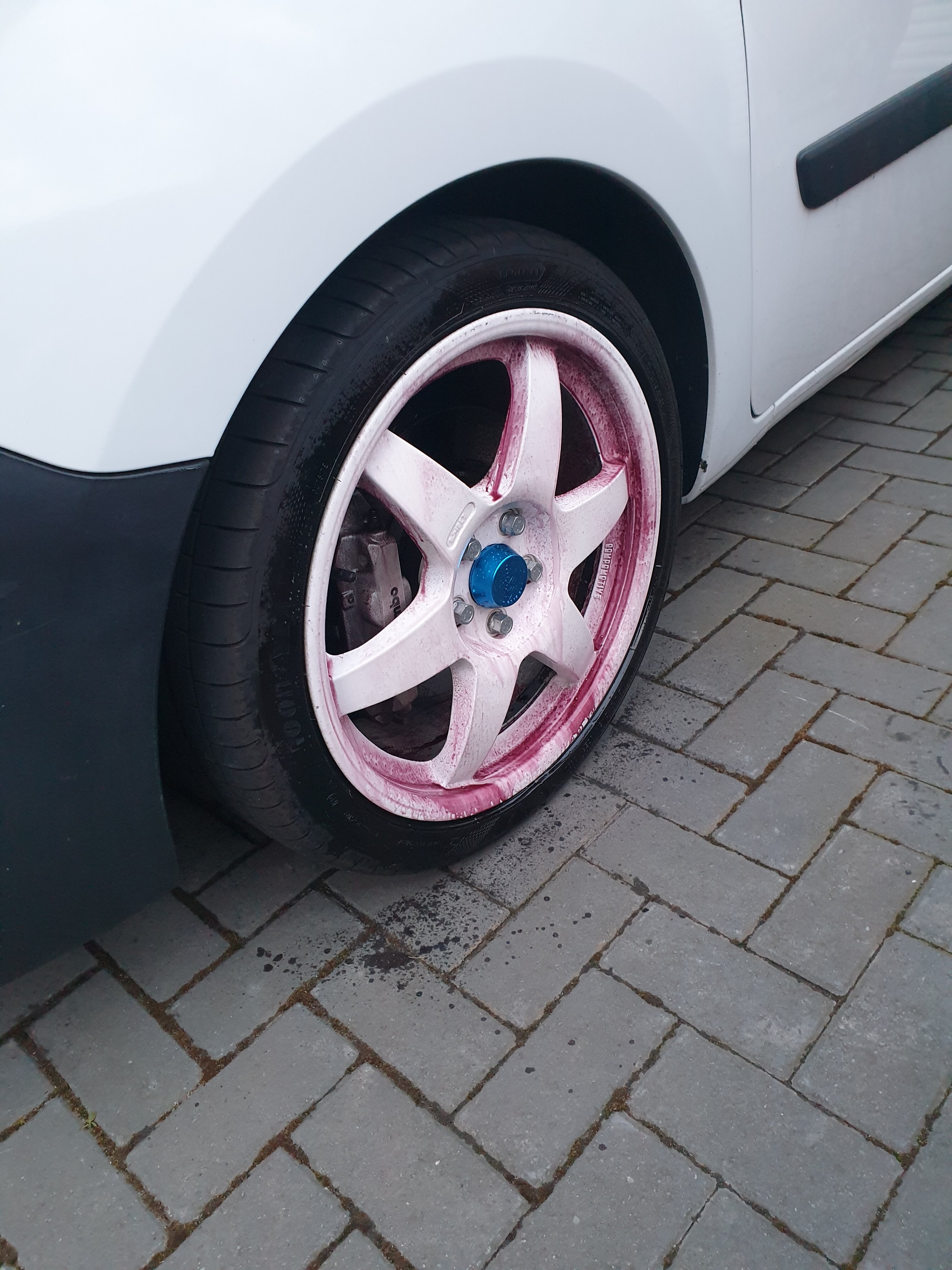

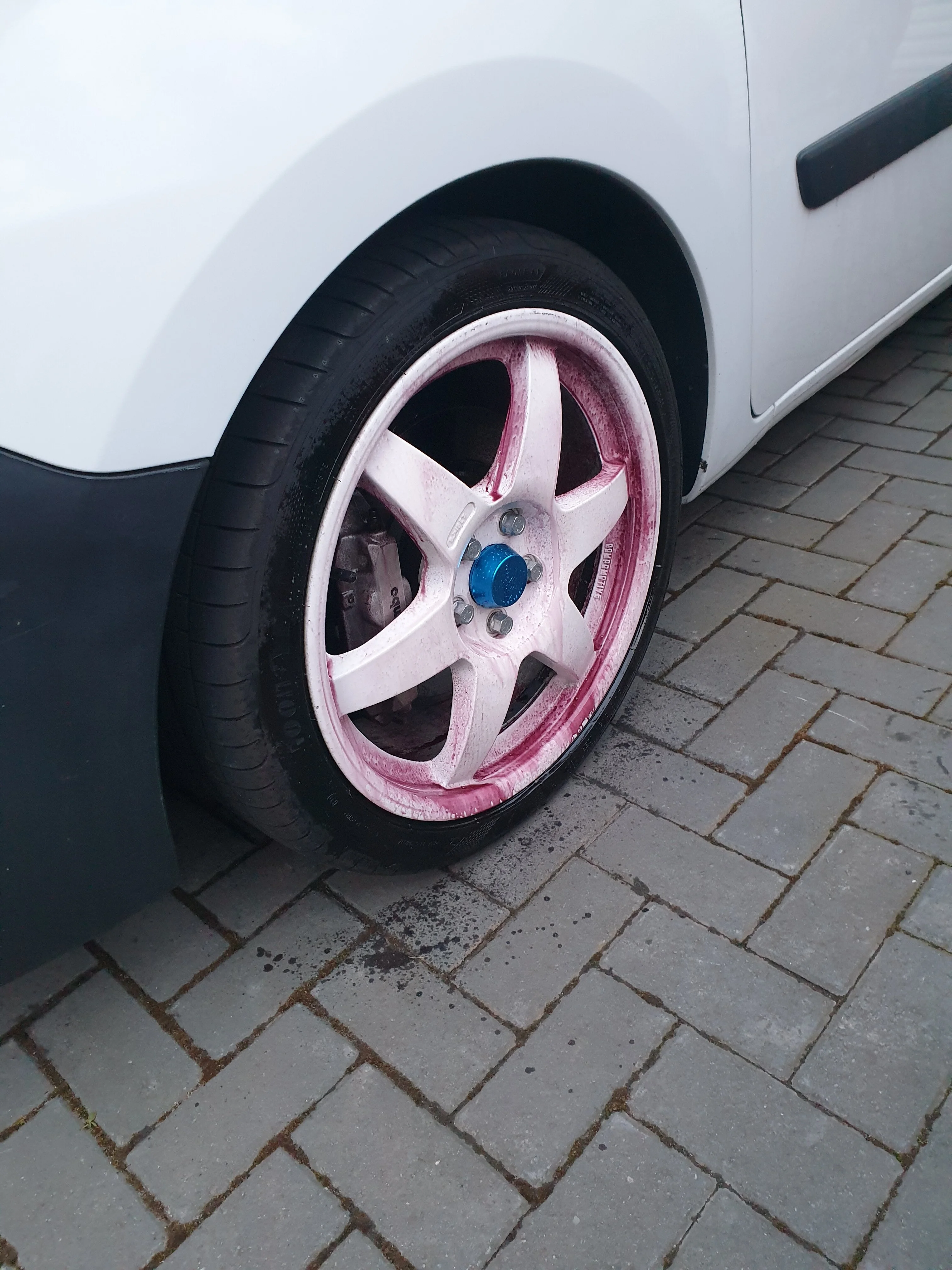

Wheels were covered in brake dust and rust flakes from initial braking cleaning the rust off the discs from standing. No problem for Bilt Hamber autowheel though, spray on, let it dwell and blast off.

Fitted a new ply base to replace the knackered old one, and new ply on the rear doorsView attachment 1532983

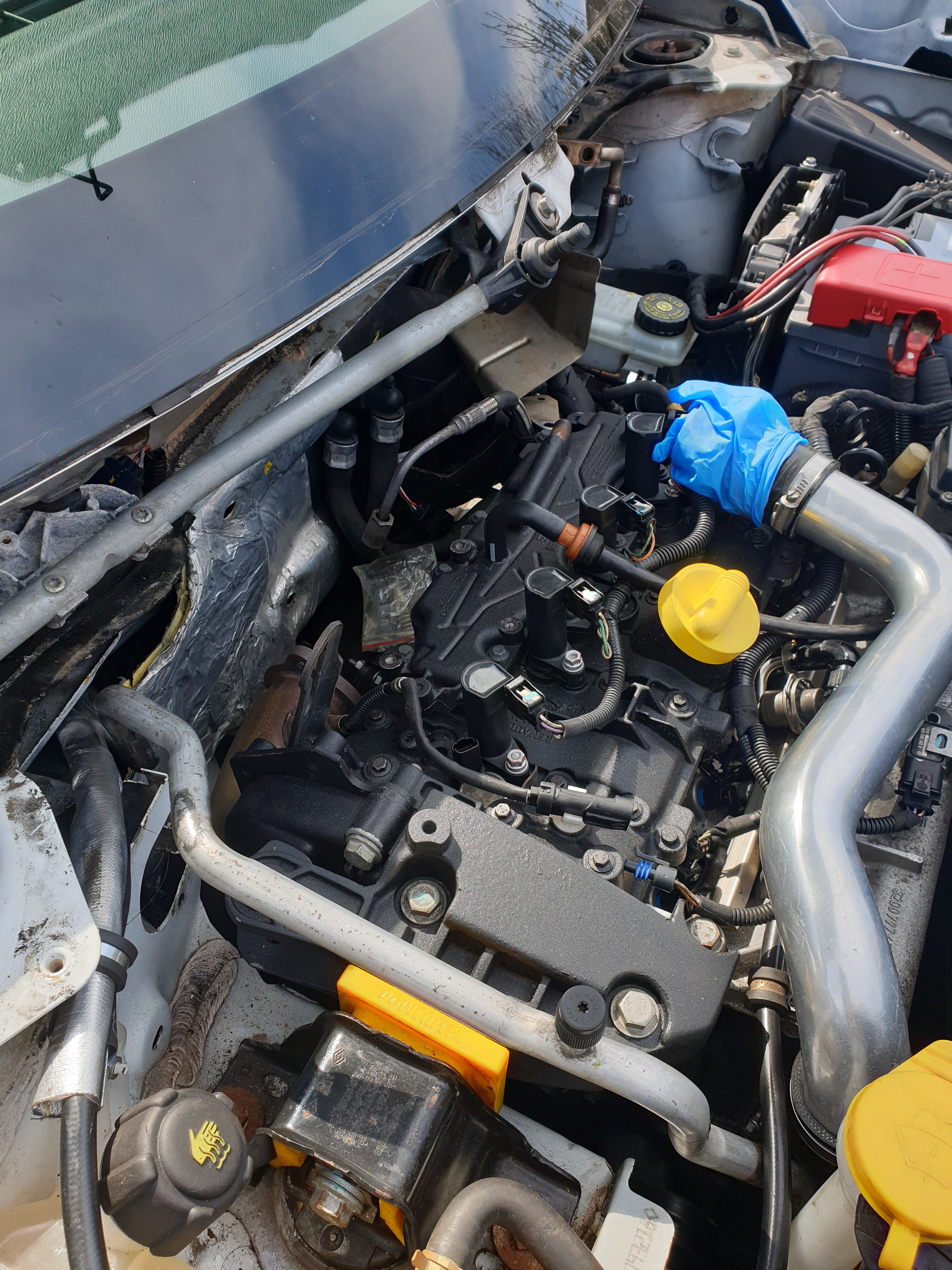

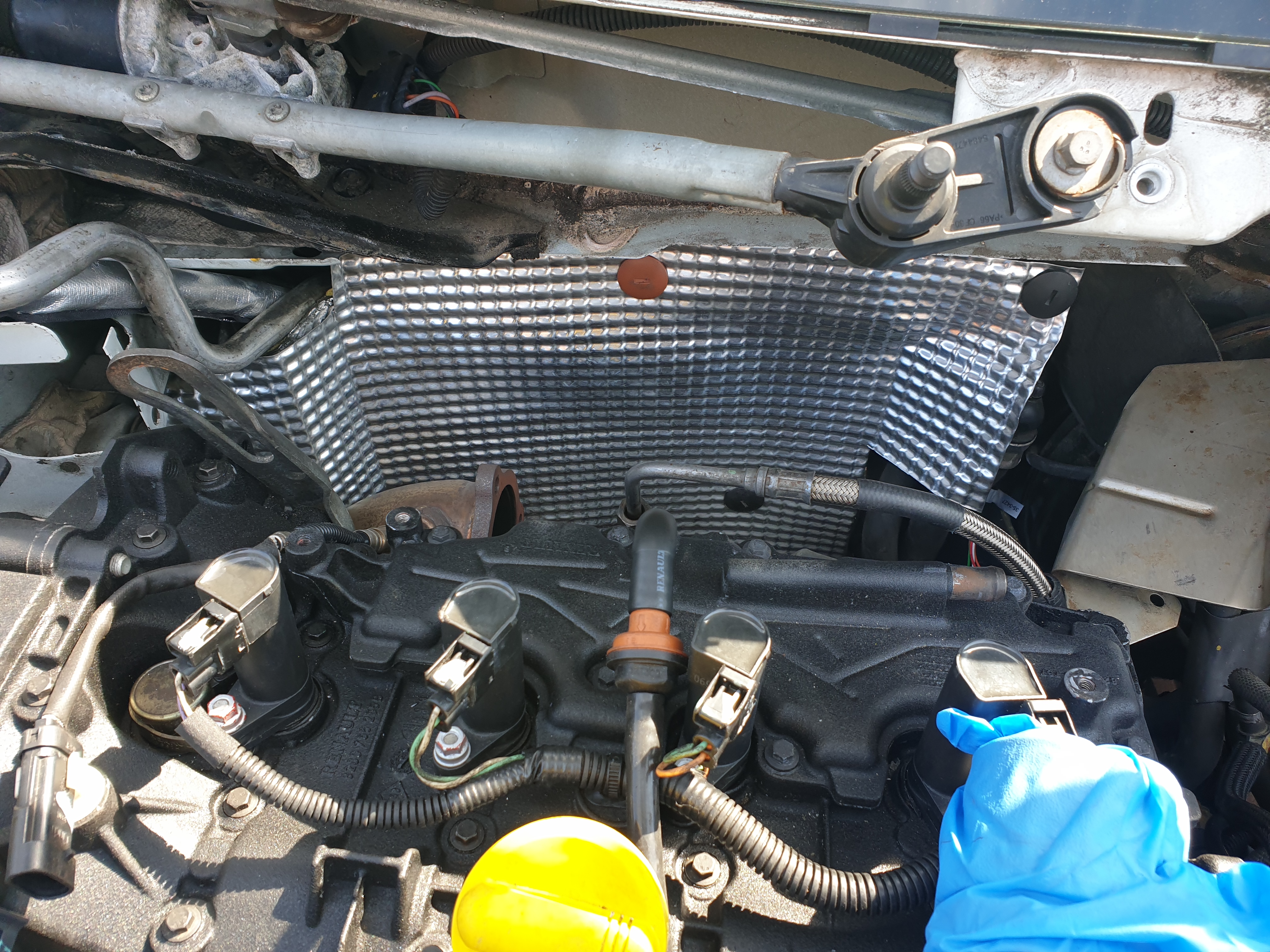

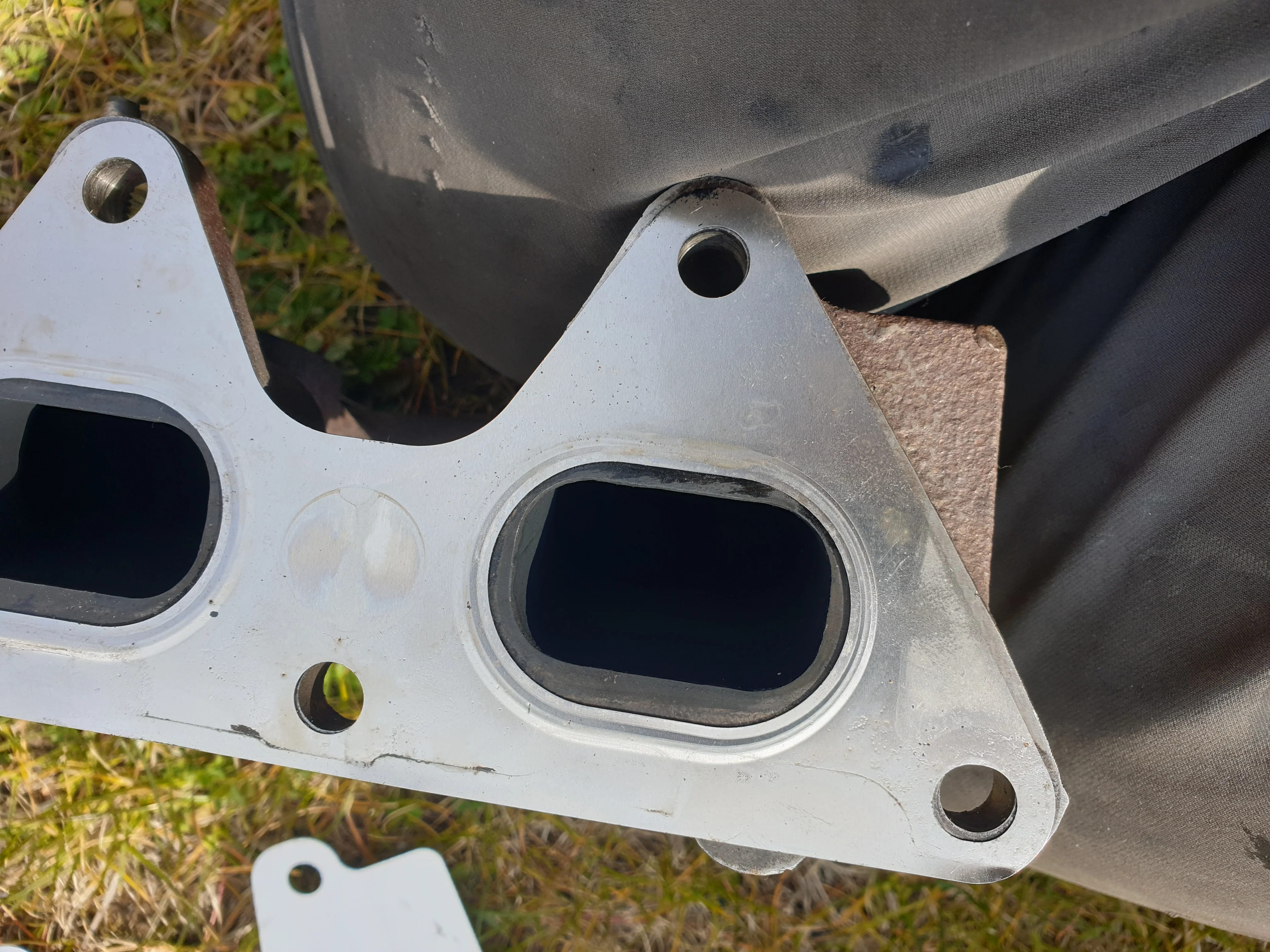

Changed exhaust manifold gasket as could hear it blowing when running. Have been dreading this as it looked tight and imagined the engine would need to come off the mounts and be a bit of a carry on.
However the kangoo scuttle fully unbolts so got that off, and that makes loads of room compared to megane, allowing the turbo to come straight up and off.
45 mins later its stripped

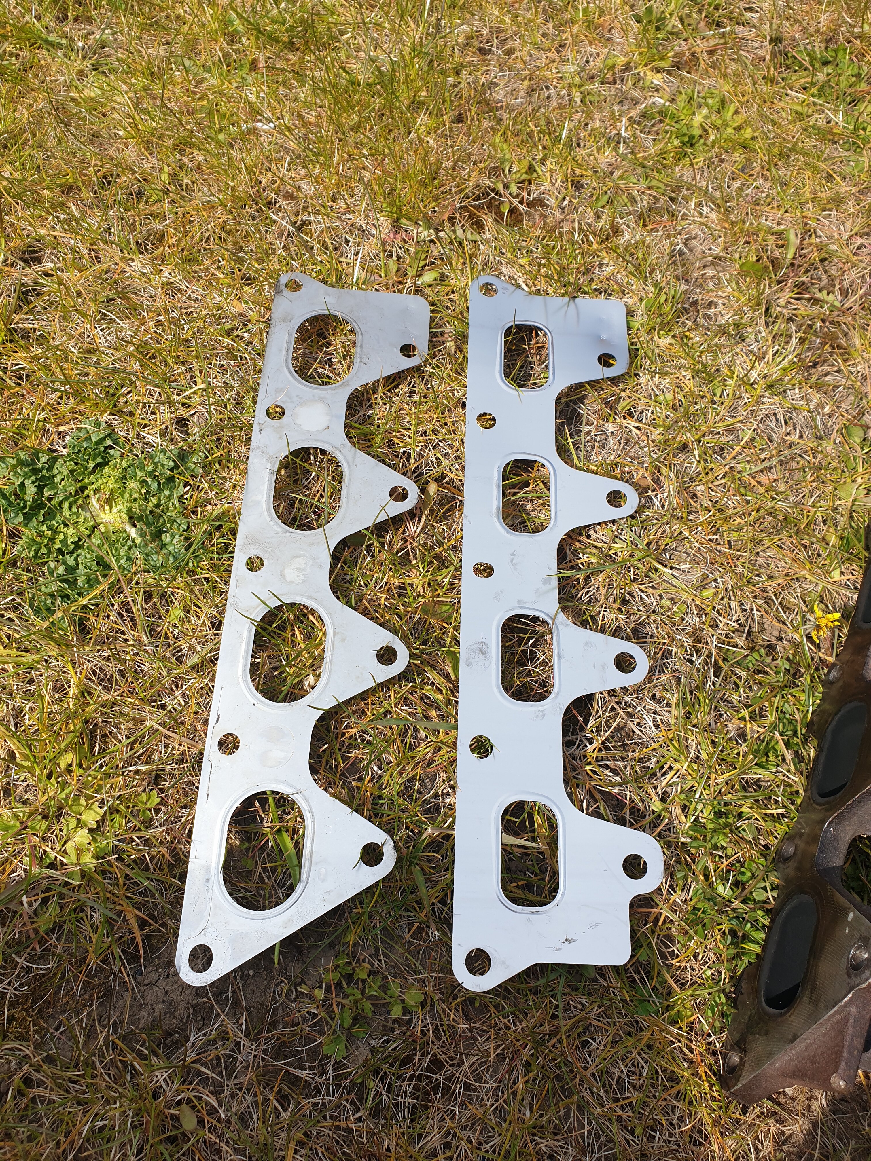

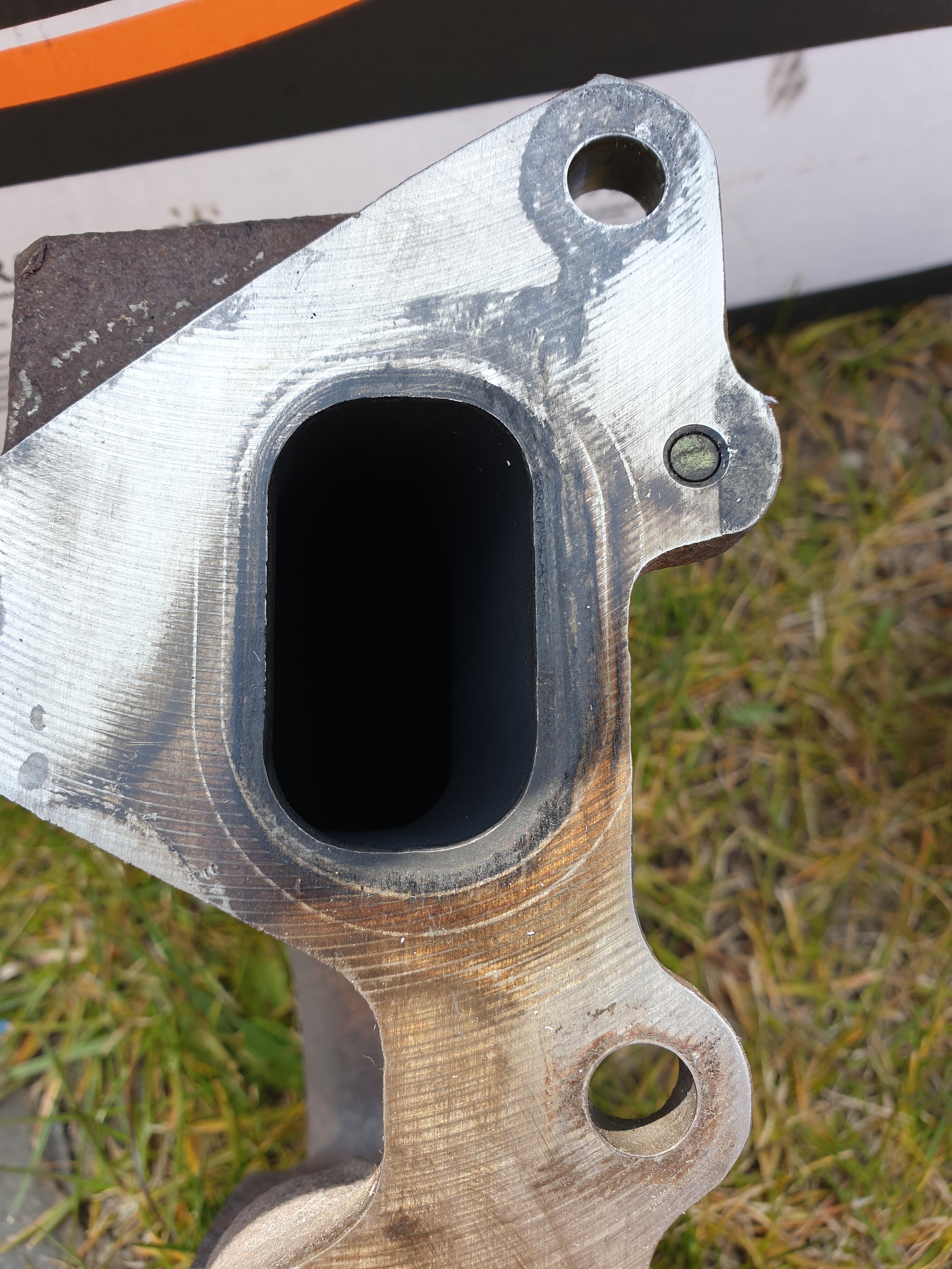

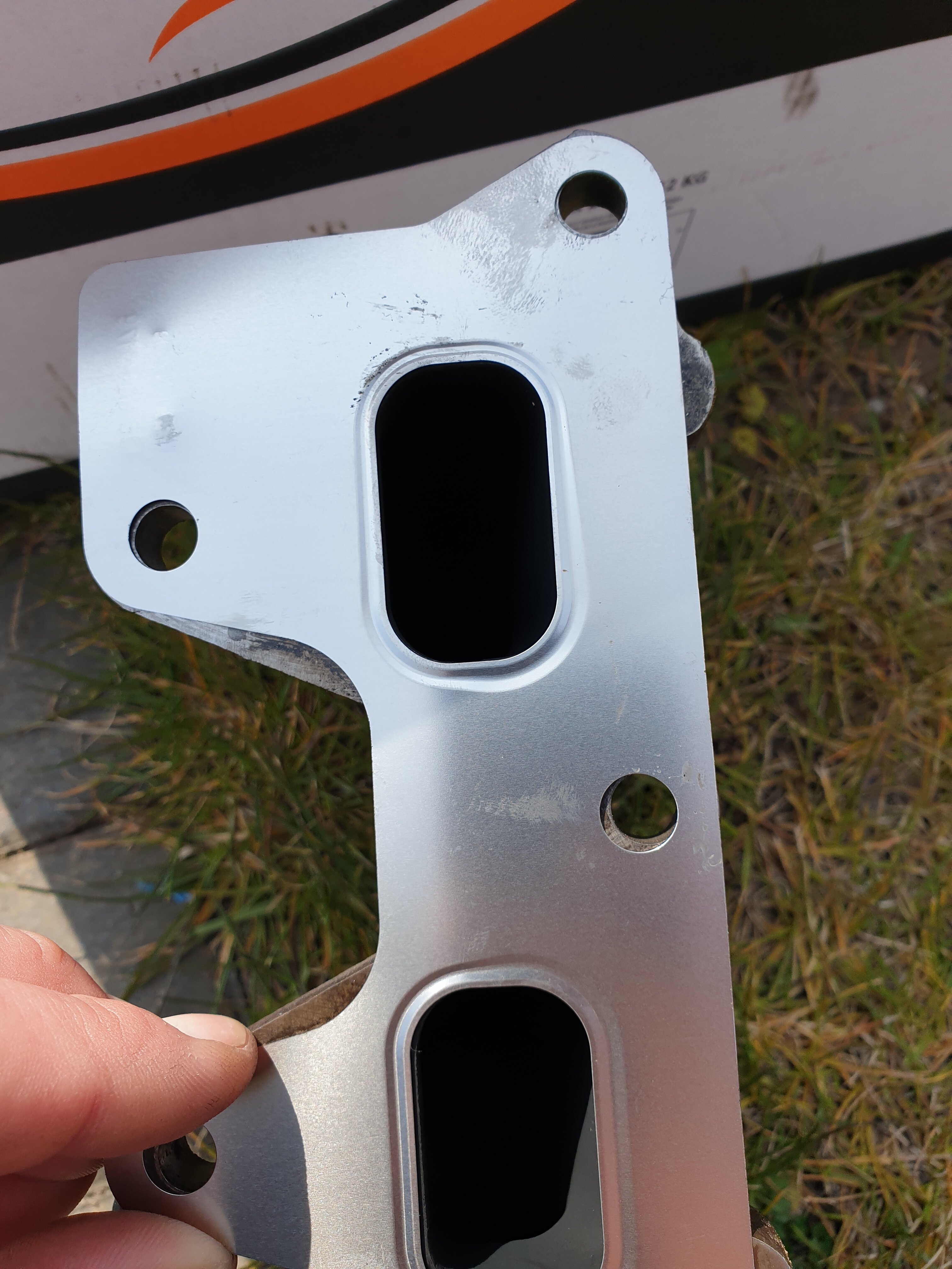

Found the issue straight away, wrong exhaust manifold gasket fitted. Also found a k nut had snapped in half that was holding the turbo to the manifold, bizarre.
Megane gasket on the right, assume the one on the left is 172?
Piss poor fit, barely covers the edge of the manifold.
Megane one fits much better.

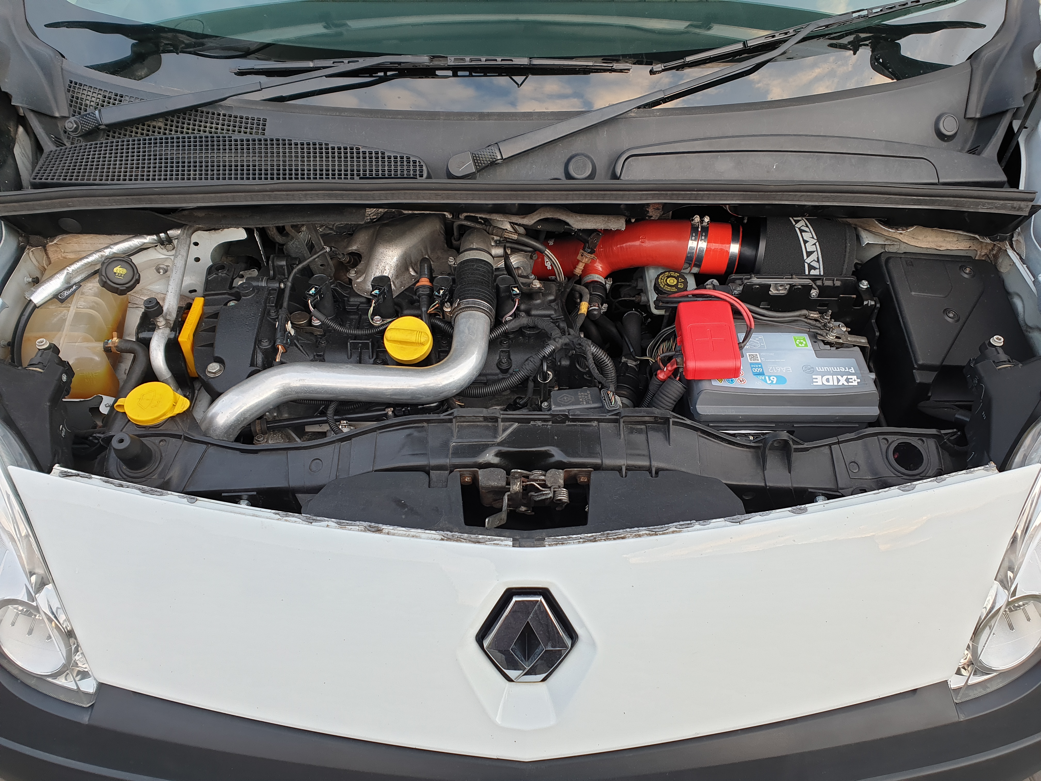

Whilst apart fitted a nimbus heatshield. Should have done this before fitting engine, as abs block was exposed. Will hopefully reflect a fait bit of heat.

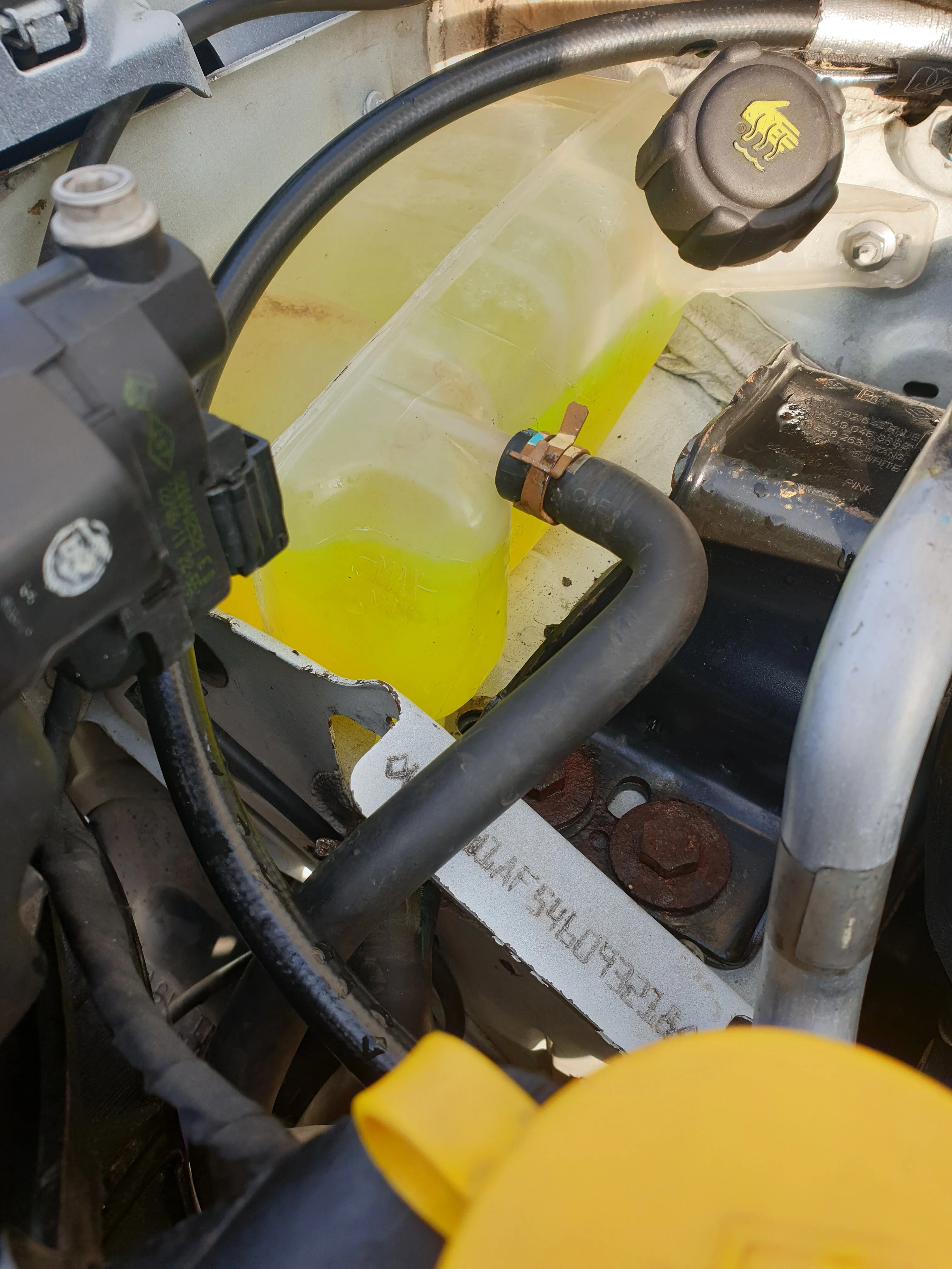

Fitted it all back together and then flushed the coolant out as it had gone a bit rusty from sediment in the block. Took a fair bit of flushing/backflushing to get the water to run clear. Fitted a genuine Renault thermostat whilst apart as noticed stat was weak and was not getting up to temp fully and lingering around 75/78deg on a run.
Fresh type d
Temp gauge goes up to 2nd mark and sits rock solid now. Oil temps better when cruising too, 80deg instead of low 70s.

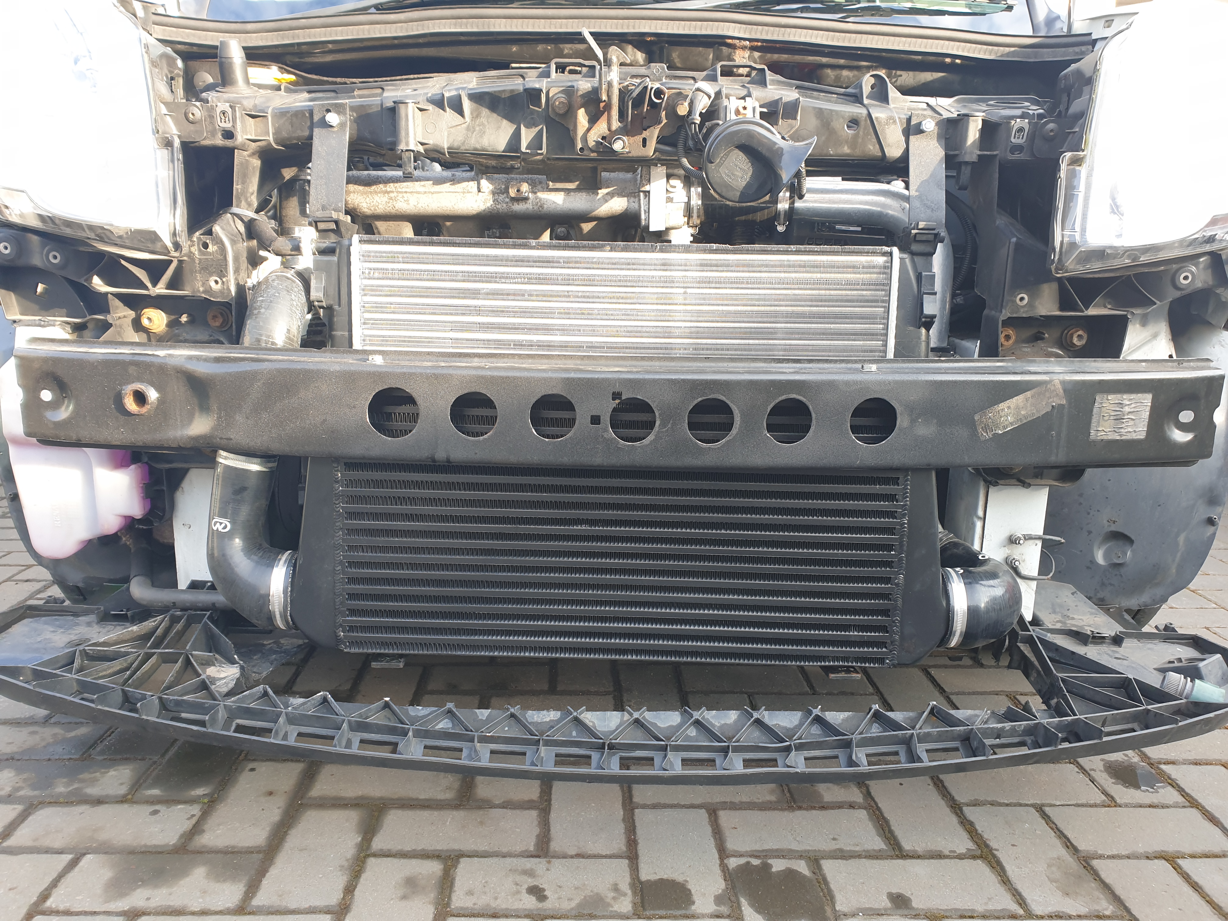

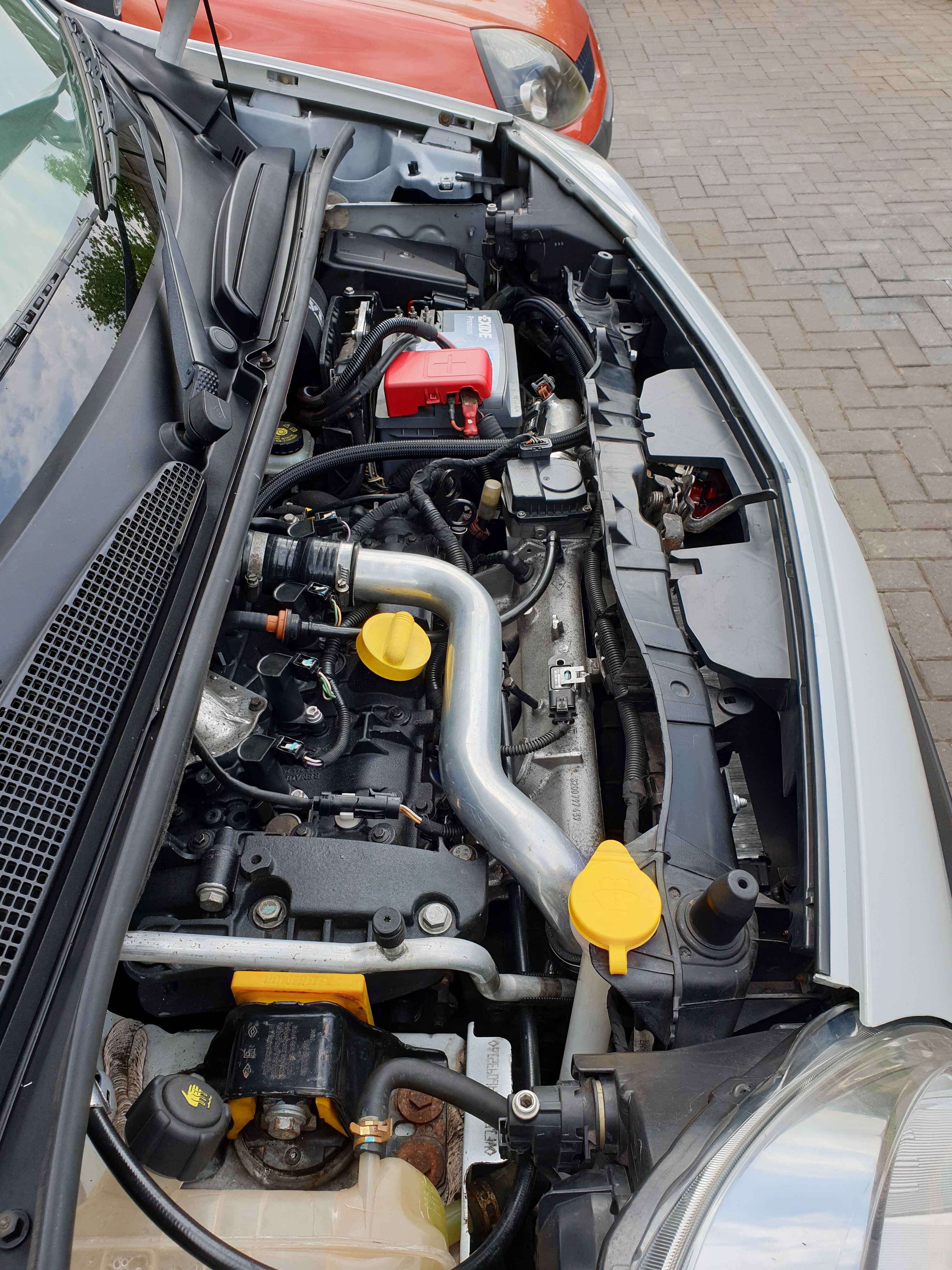

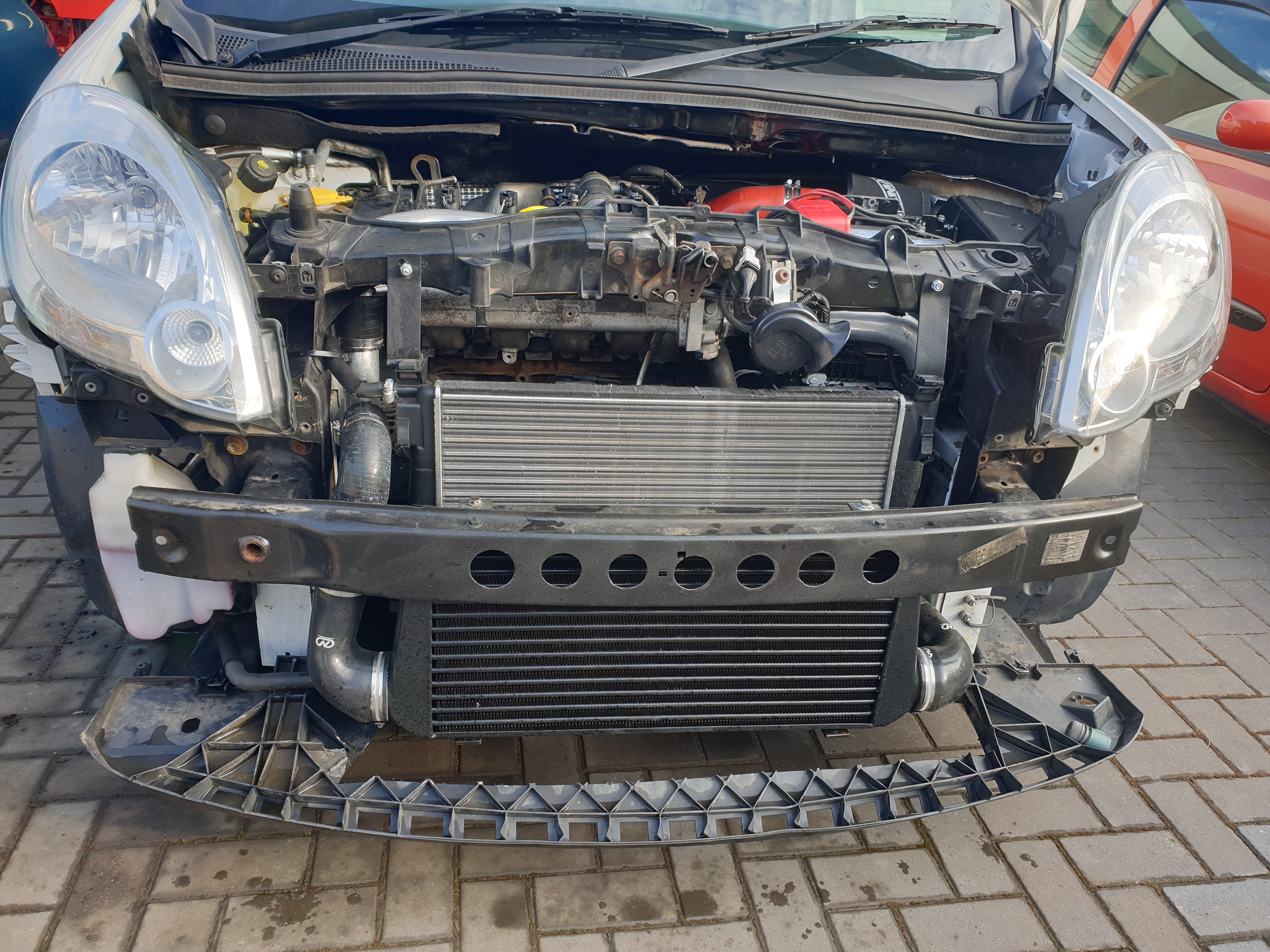

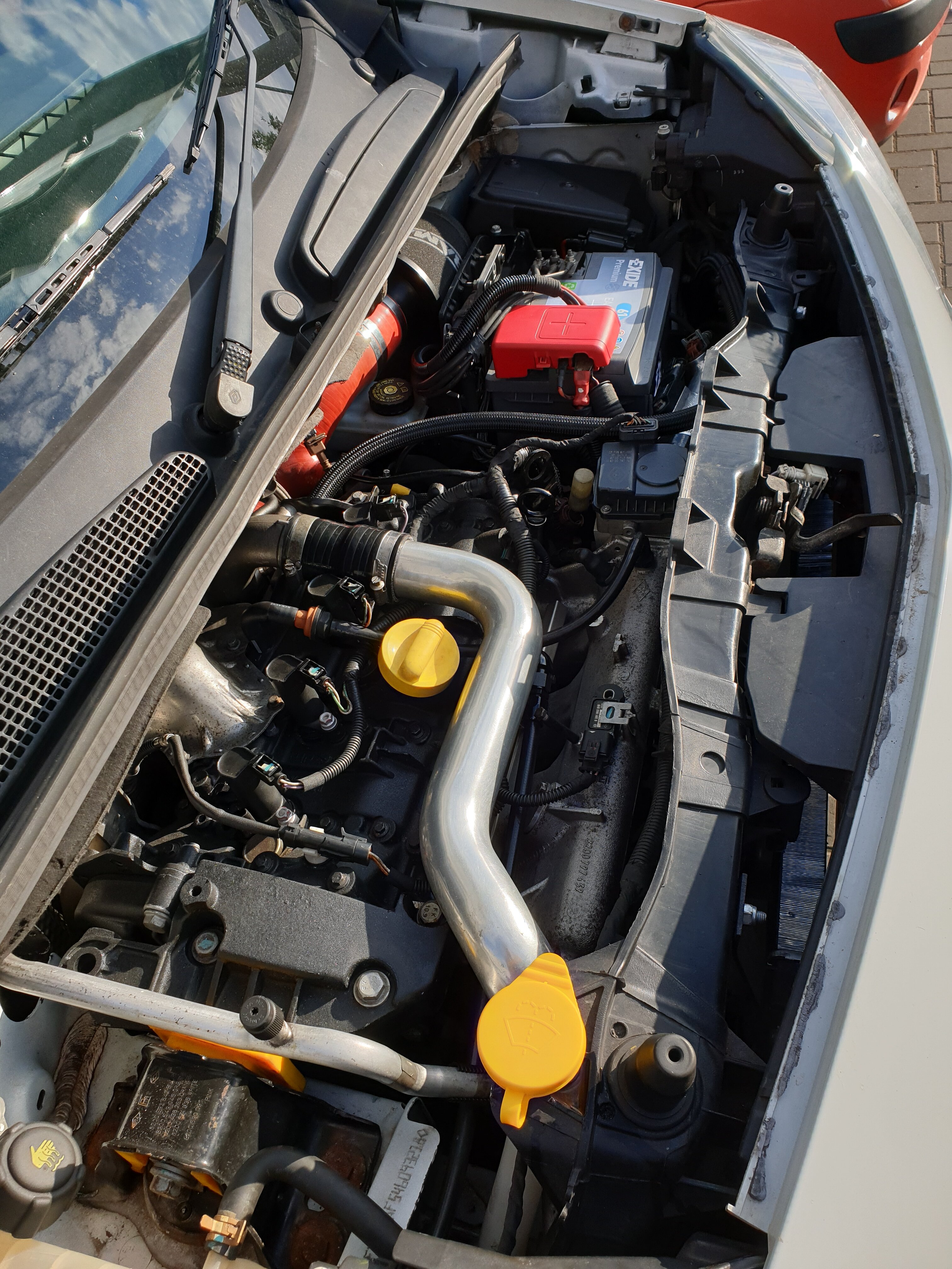

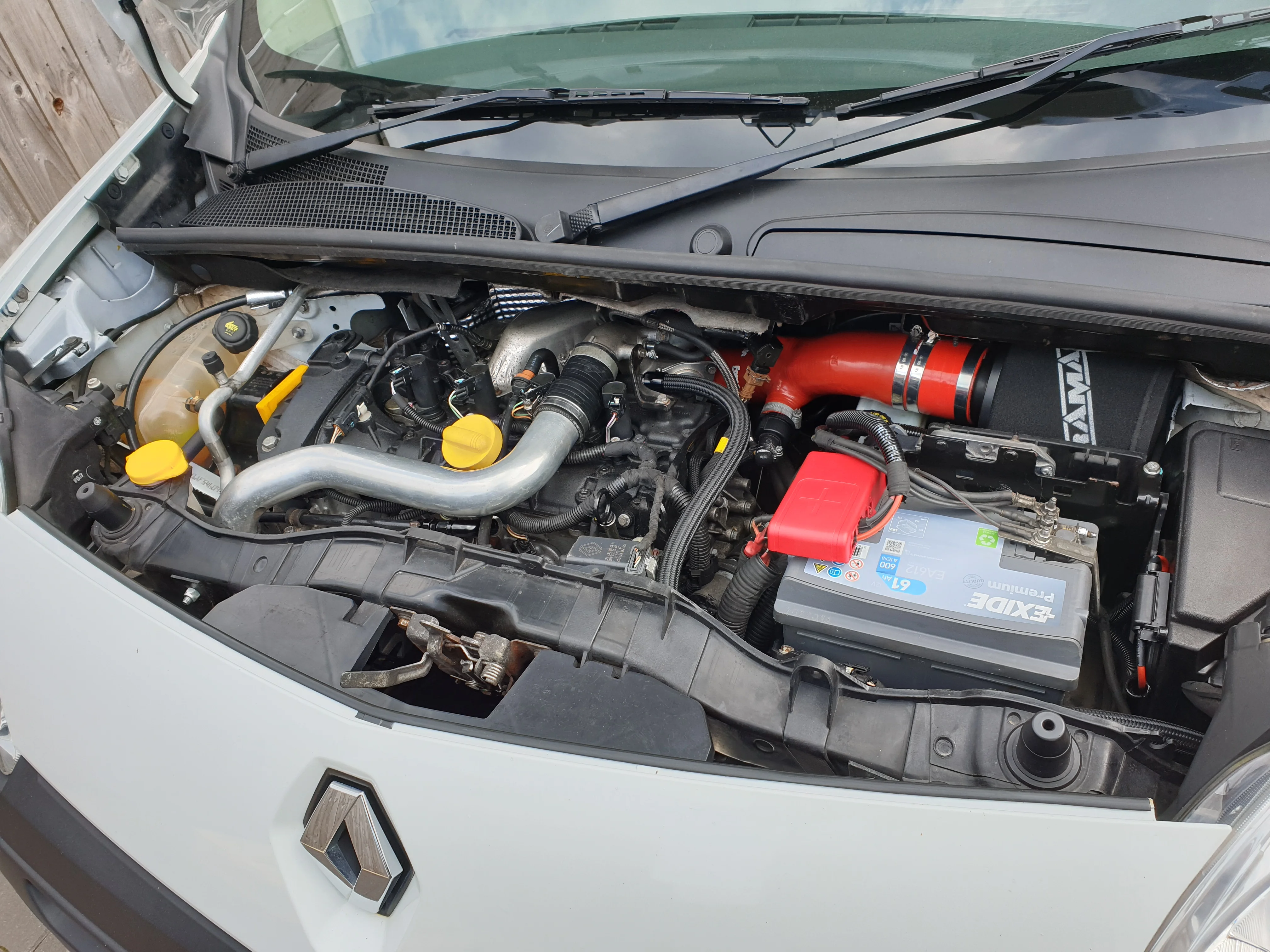

Next job was intercooler upgrade. I had previously got the tube and fin intercooler dirt cheap off a mate to mock it up. However it did not look great when driving - i noticed charge temps would shoot up 5deg or so higher than ambient temp straight away on low boost.
Tube and fin as fitted below, looks a bit shady cant imagine it being great on high boost.
As planning on running a fair bit of boost, i upgraded to a chinese bar and plate intercooler. Bar and plate always cools the charge really well compared to tube and fin. I run the same bar and plate intercooler on my Extra van, and 28lbs of boost the charge temps are always great, just above ambient.
Fitted straight on as basically the same, no mods required.
On road test had torque hooked up to the obd, and noted the charge temps did not move above ambient on a quick boost up to 18psi, so noticeable improvement, should work good when mapped.

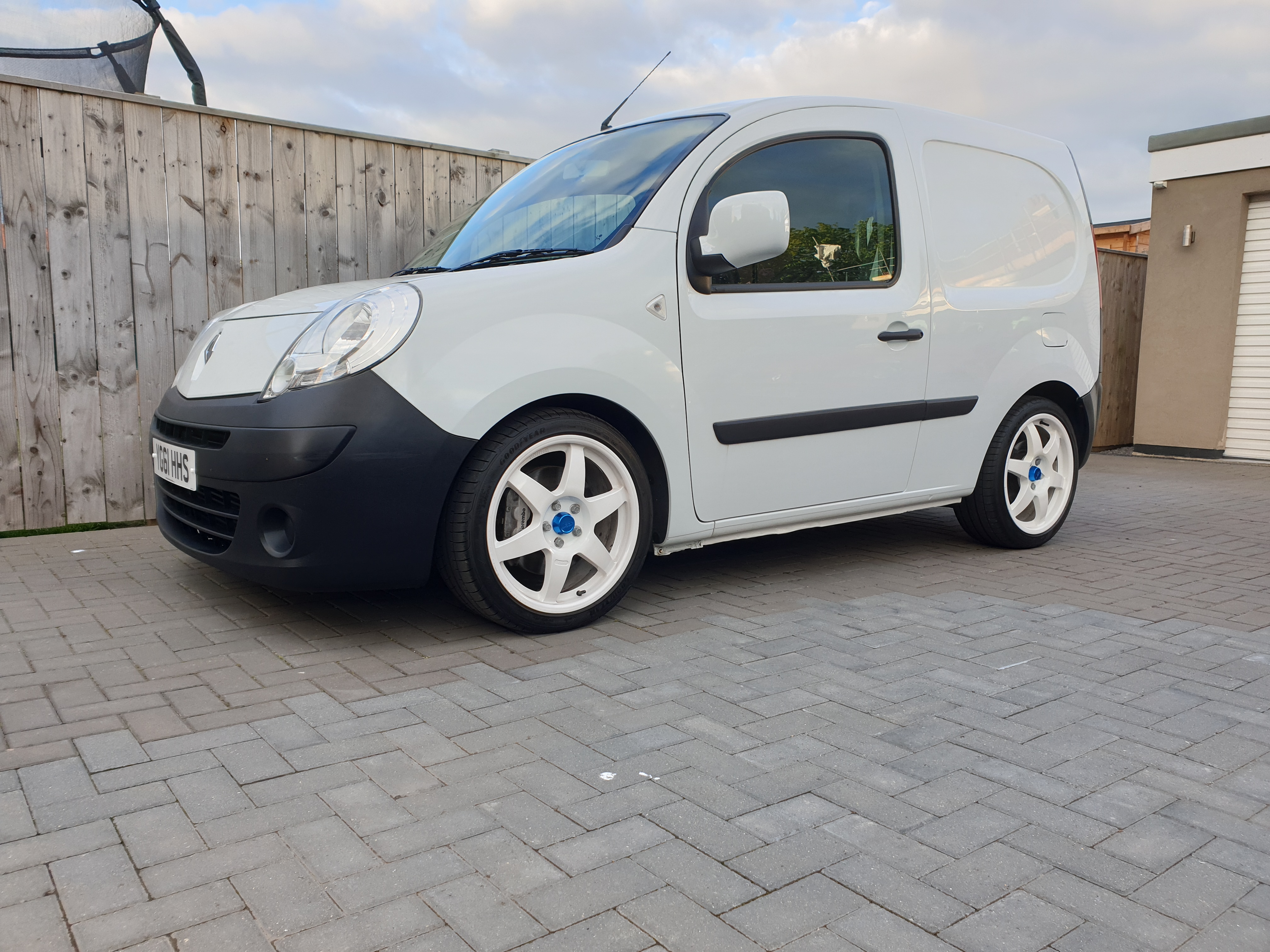

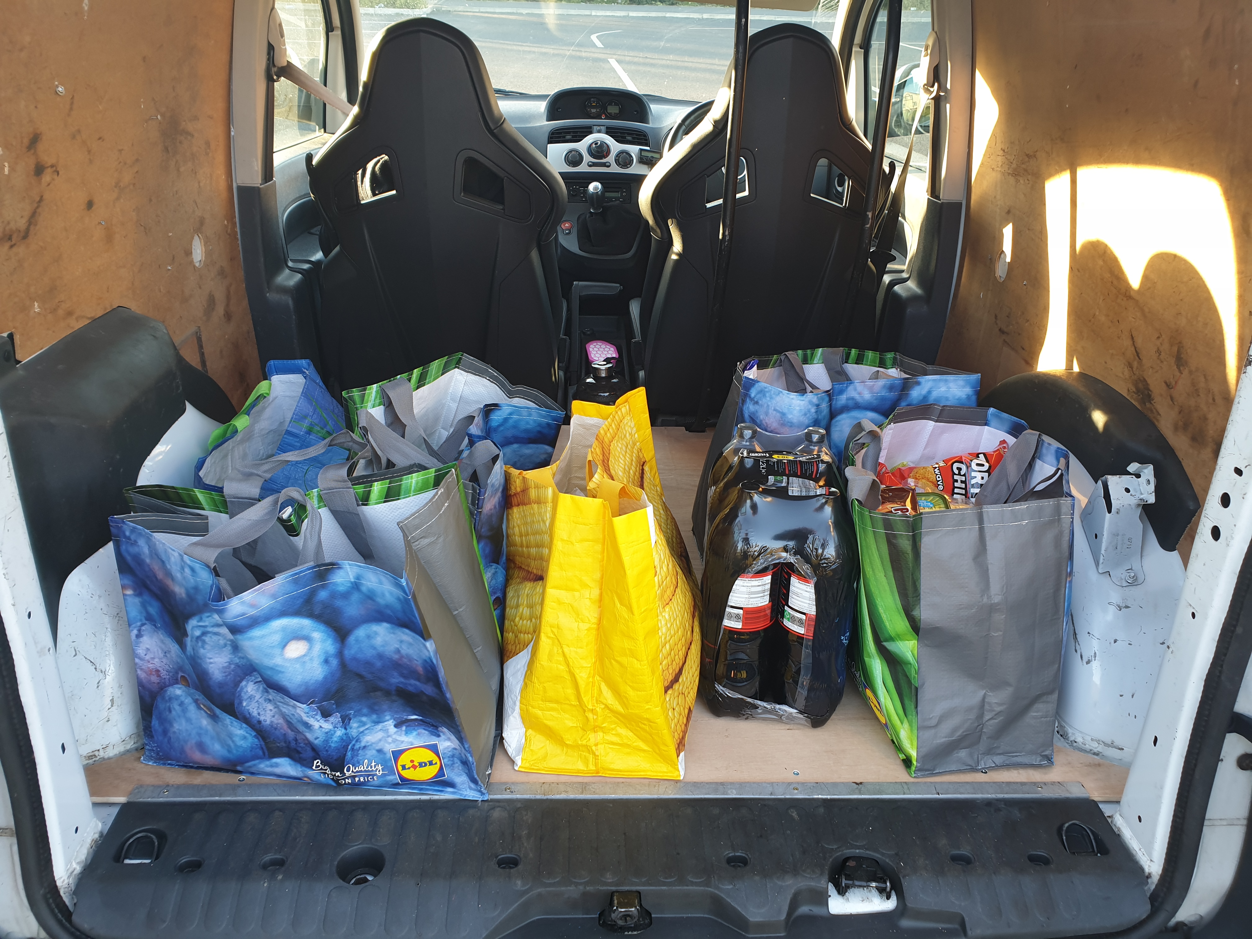

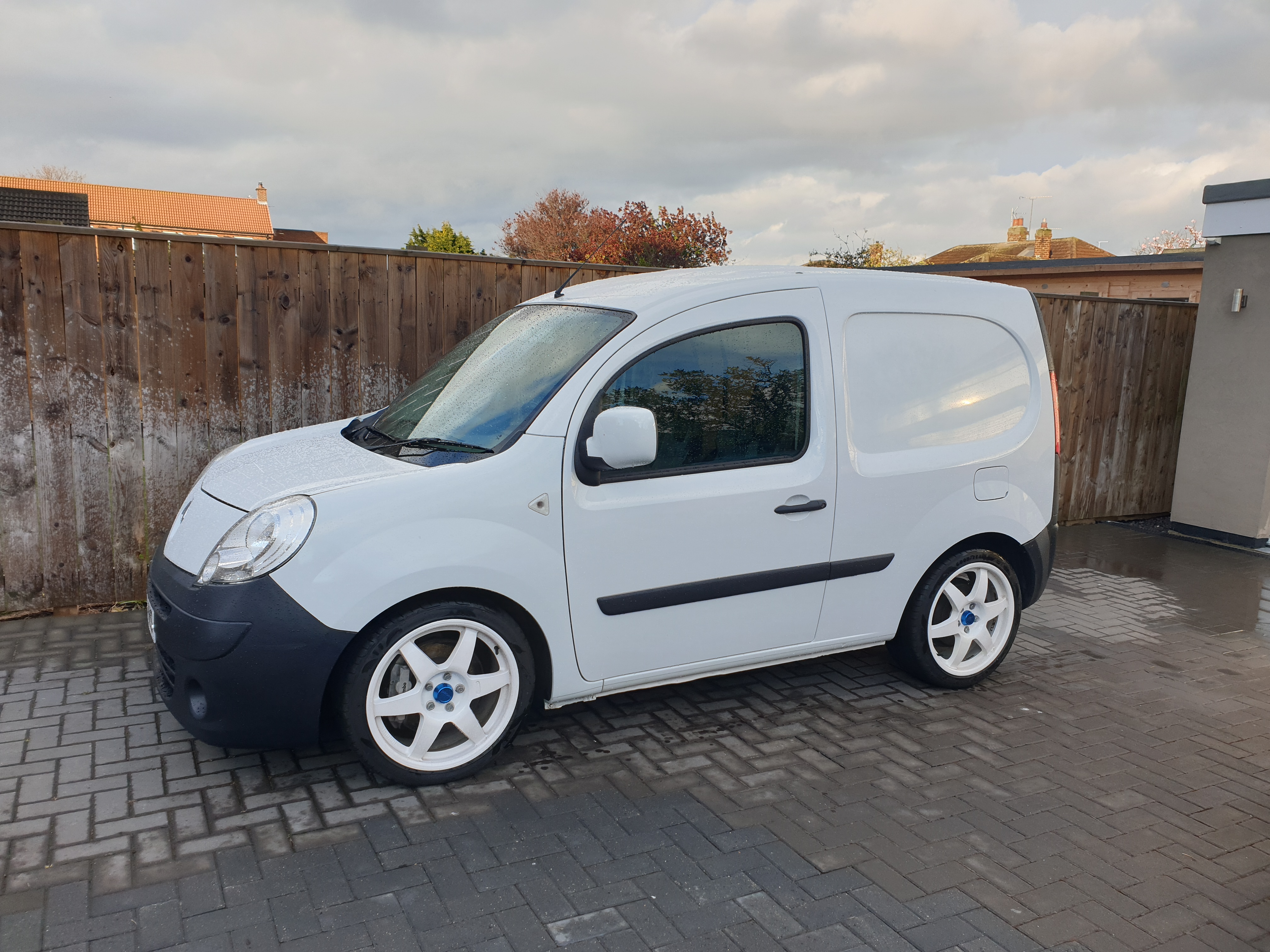

Have been using the Kangoo a fair bit over the last few days to see if any issues would arise. Done over 300 miles in total and nothing up to now touch wood. Even tested the cooling system in mcds drive through as got stuck in it for ages the other night, rad fan cuts in at 99deg and cools it down nicely to 92deg.
A few bags of shopping and the back is full

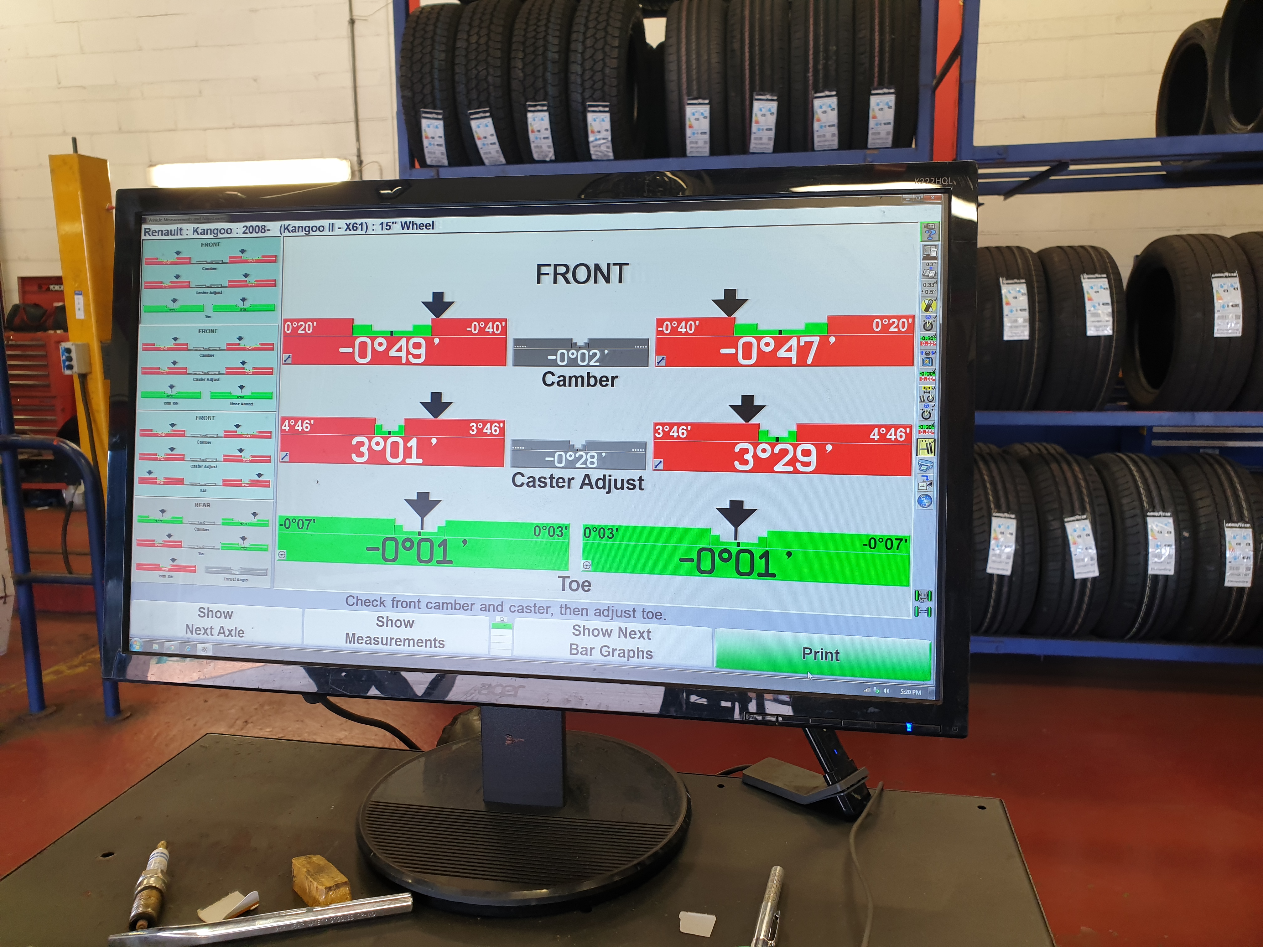

Had the toe set. I guessed it when fitting the megane rs tie rods and only passenger side was out by 3 mins or so. Set quite neutral for now.
Less castor than a megane as they are usually around 5 from memory, so might be a future job to add some with fancy top mounts.

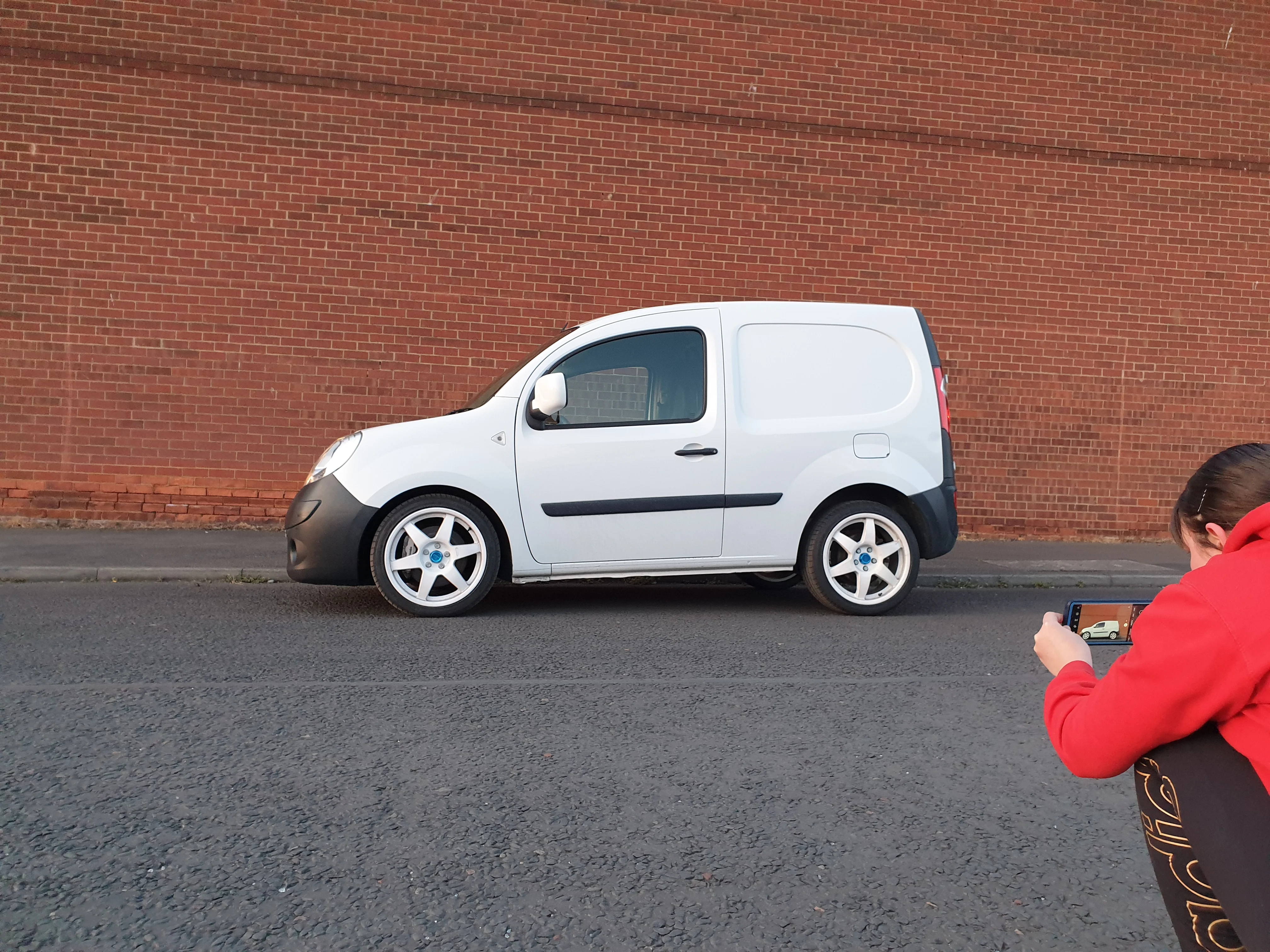

Had a good run out on Fri night and went all over, mostly B road blasting.
Had the OG out of the garage on Sat so took a pic.

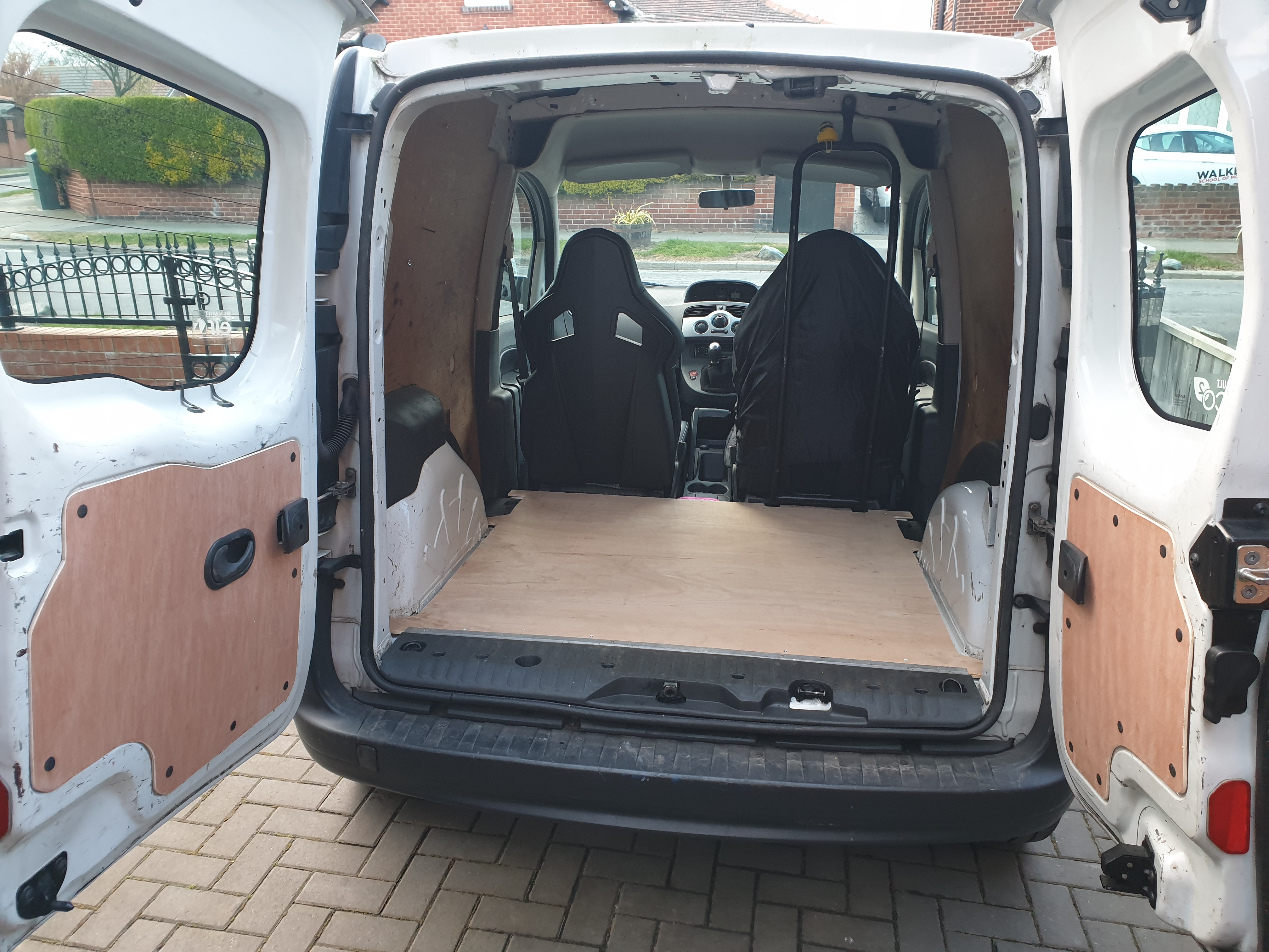

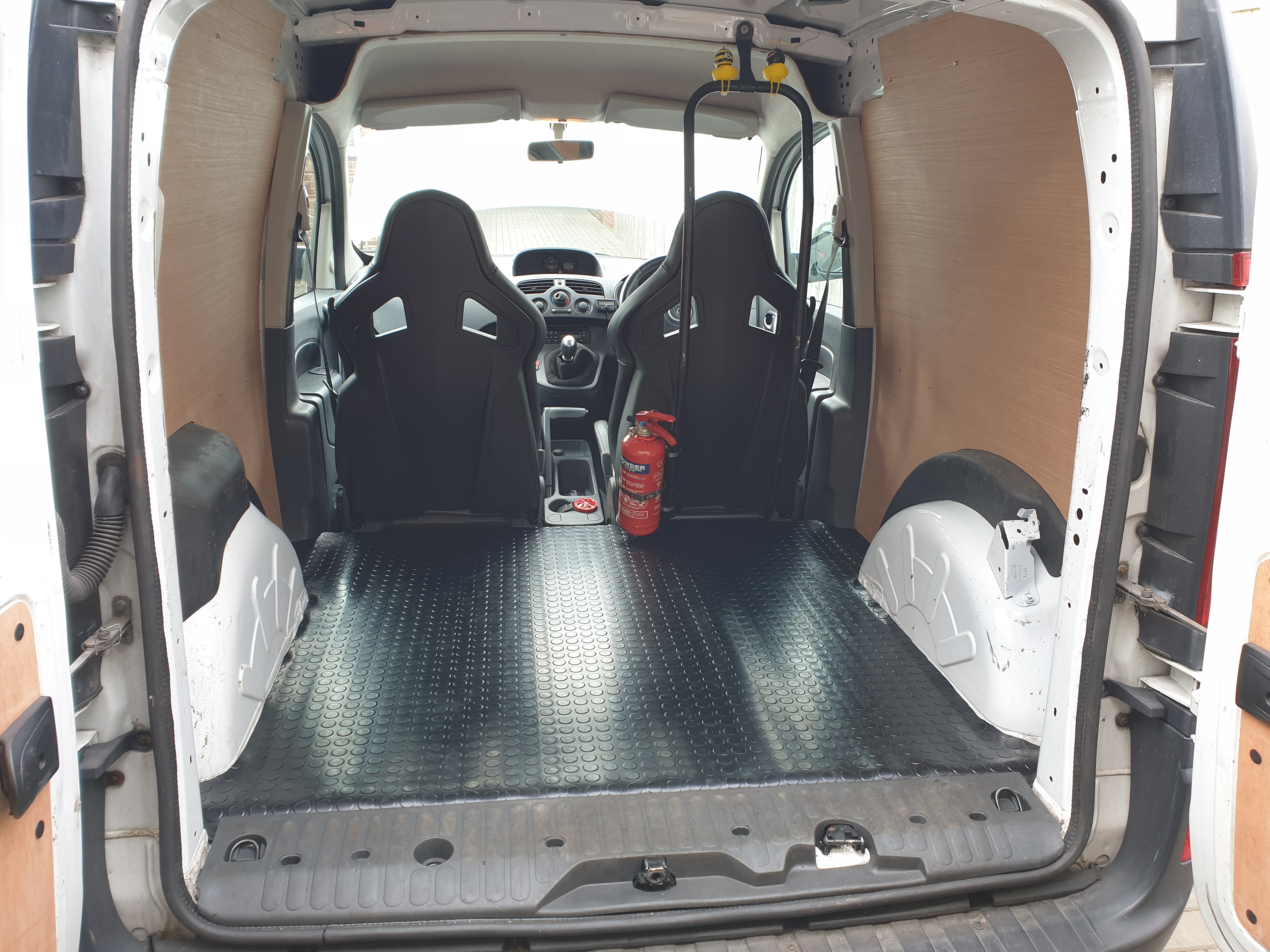

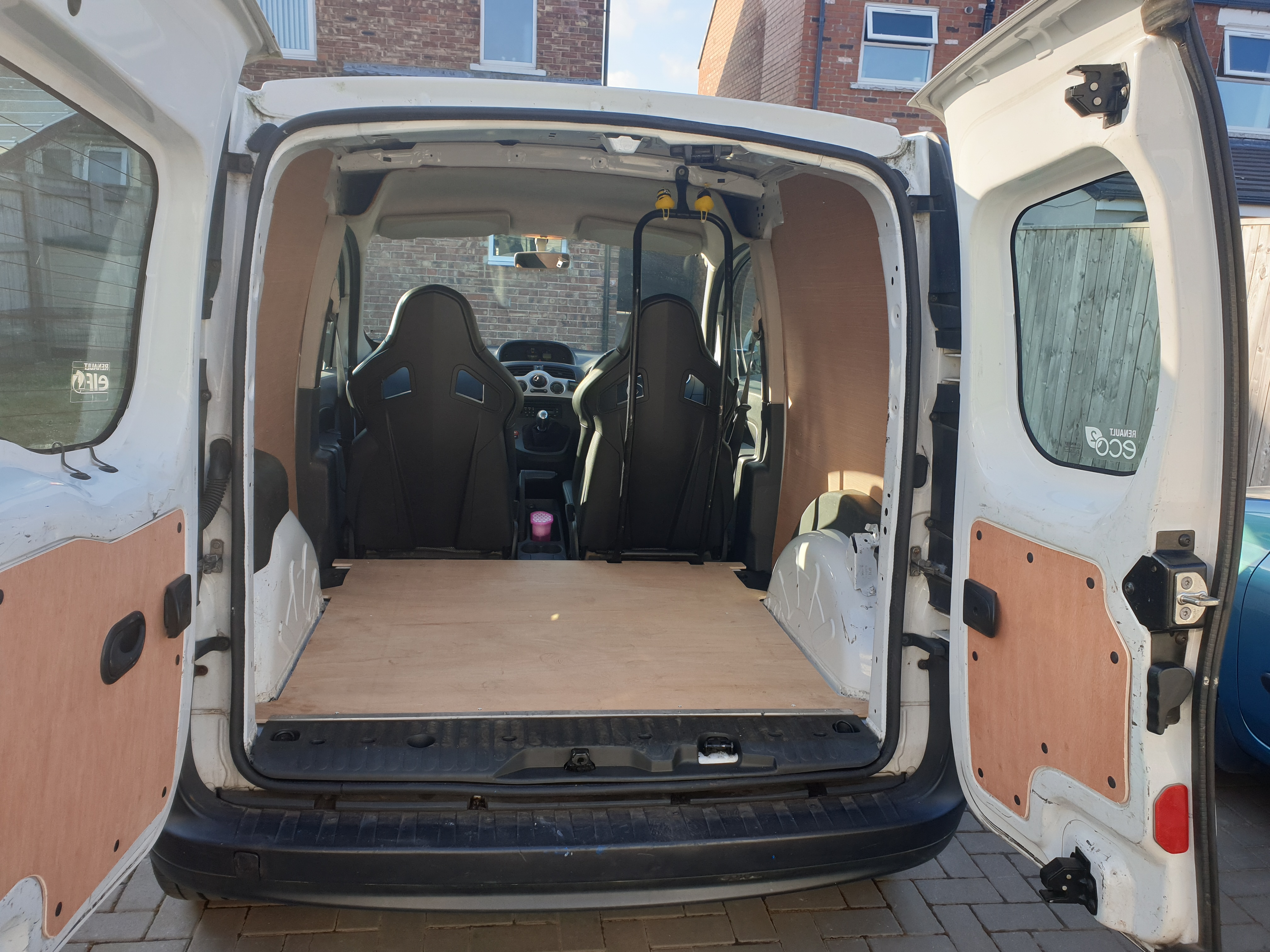

Cut some fresh plywood sides for the rear today, looks clean in the back now.

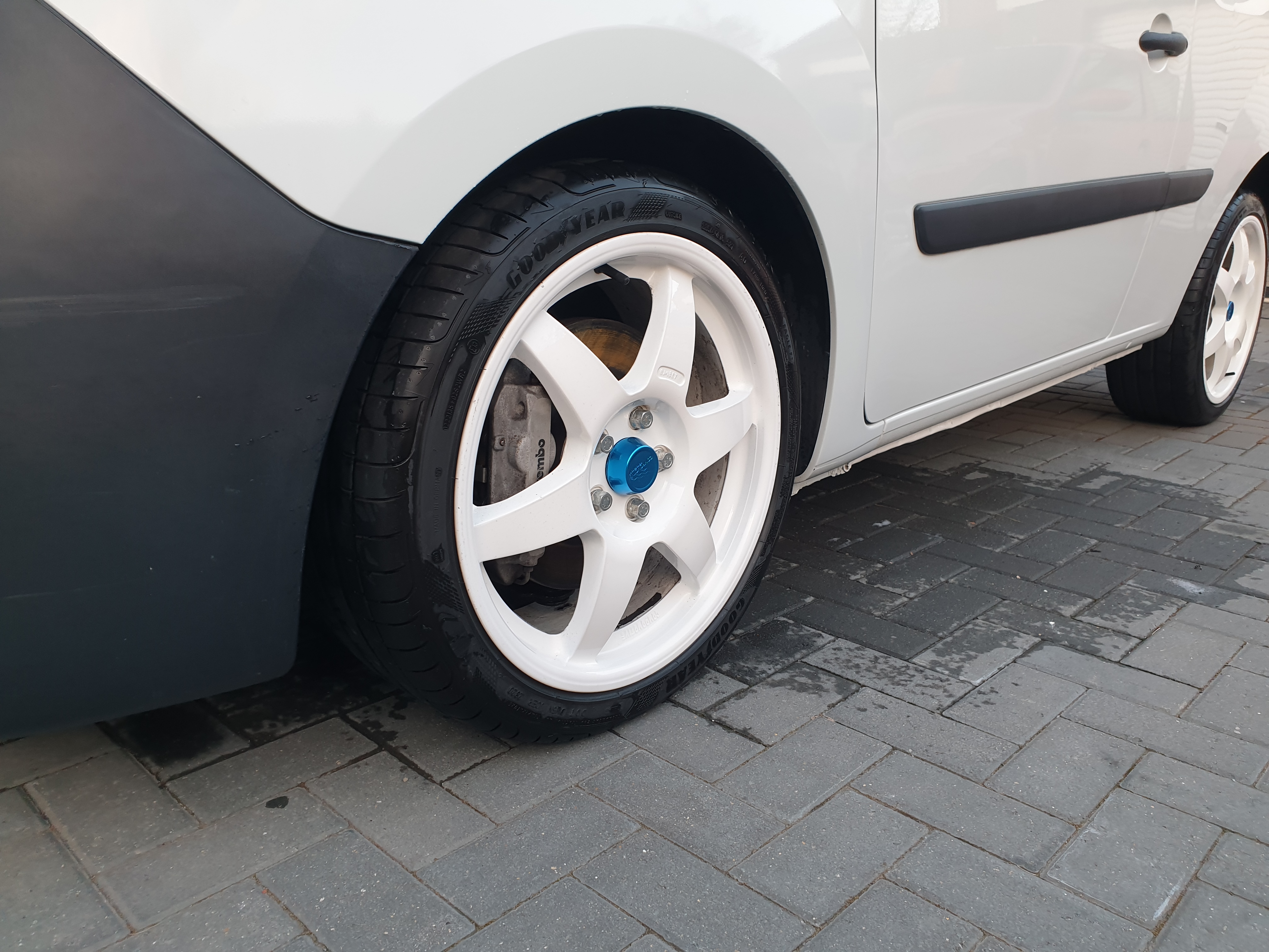

Give the comps some tlc too. They had heavy fallout/tar and some discolouring from track use by previous owner. Got most of it off and a mild cut by hand/wax, look decent enough.

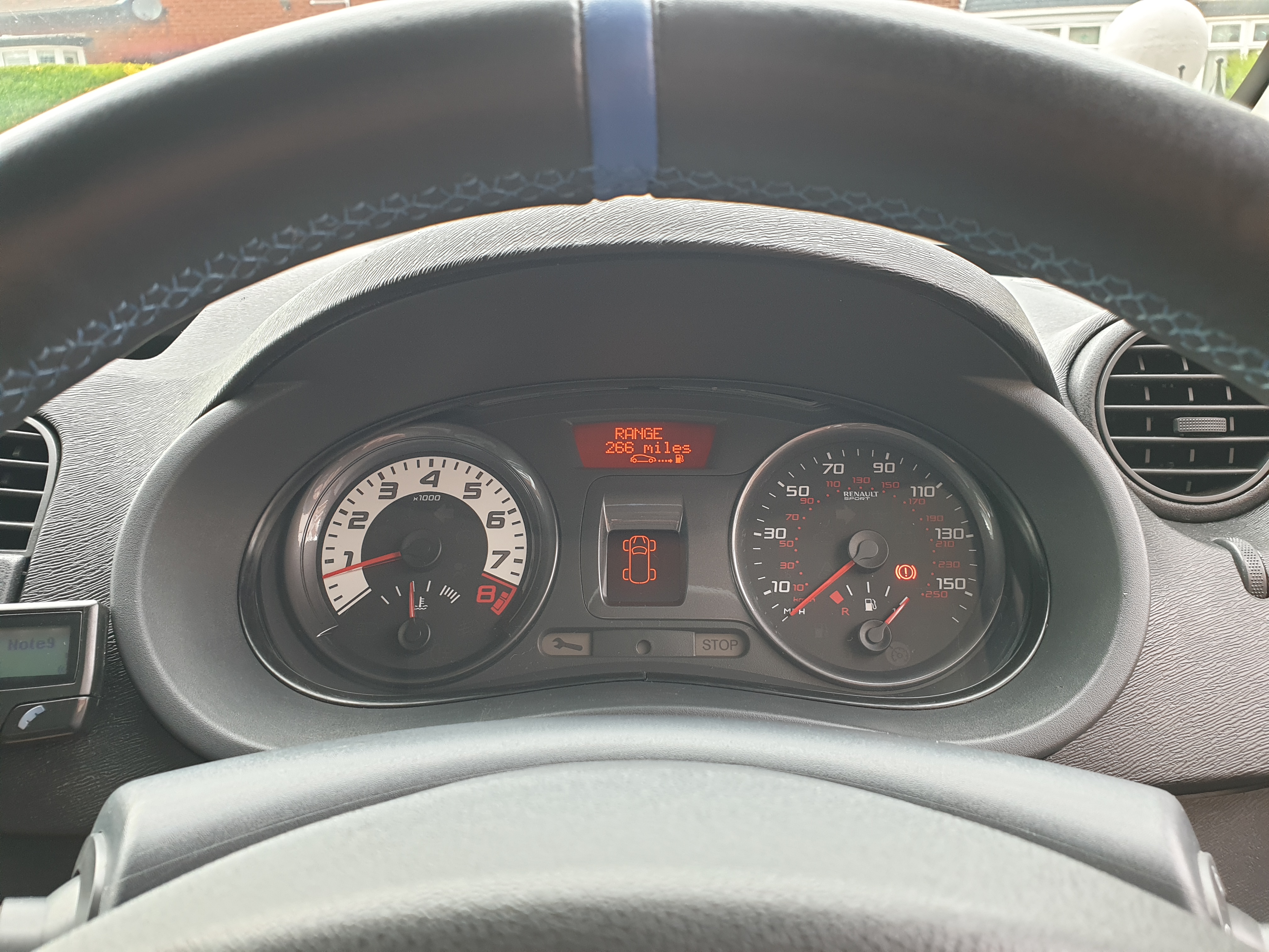

Mpg recorded on the cluster is 22mpg which is prob about right. Bit thirsty on this map but not the worst.

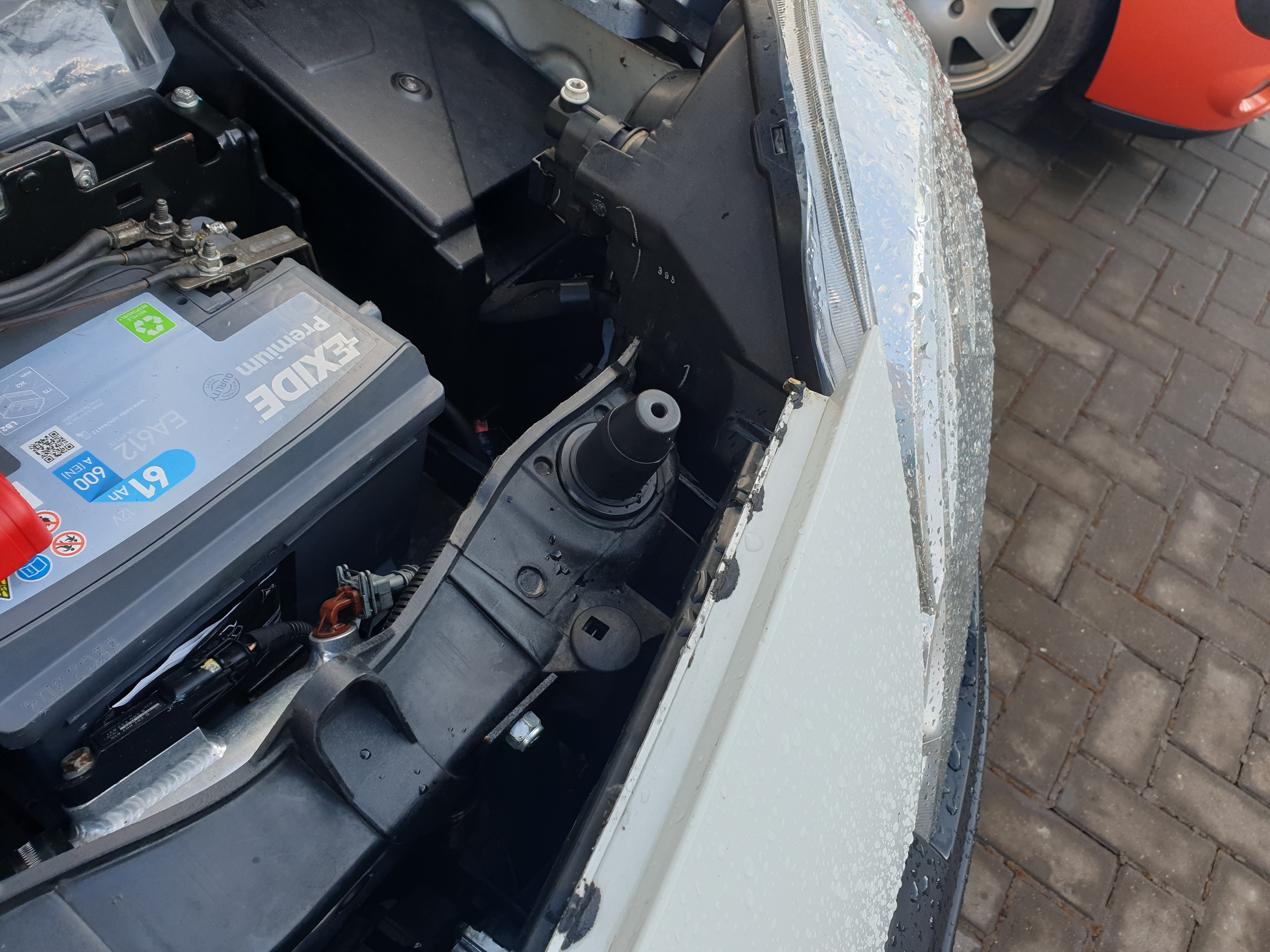

Bonnet gaps were on the piss as one of the bonnet rubber stops was missing. Dear from renault new considering what it is, so ordered on ebay from Germany, arrived in 3 days at less than half the price and oem part number on it.
Fitted, catch adjusted and loads better

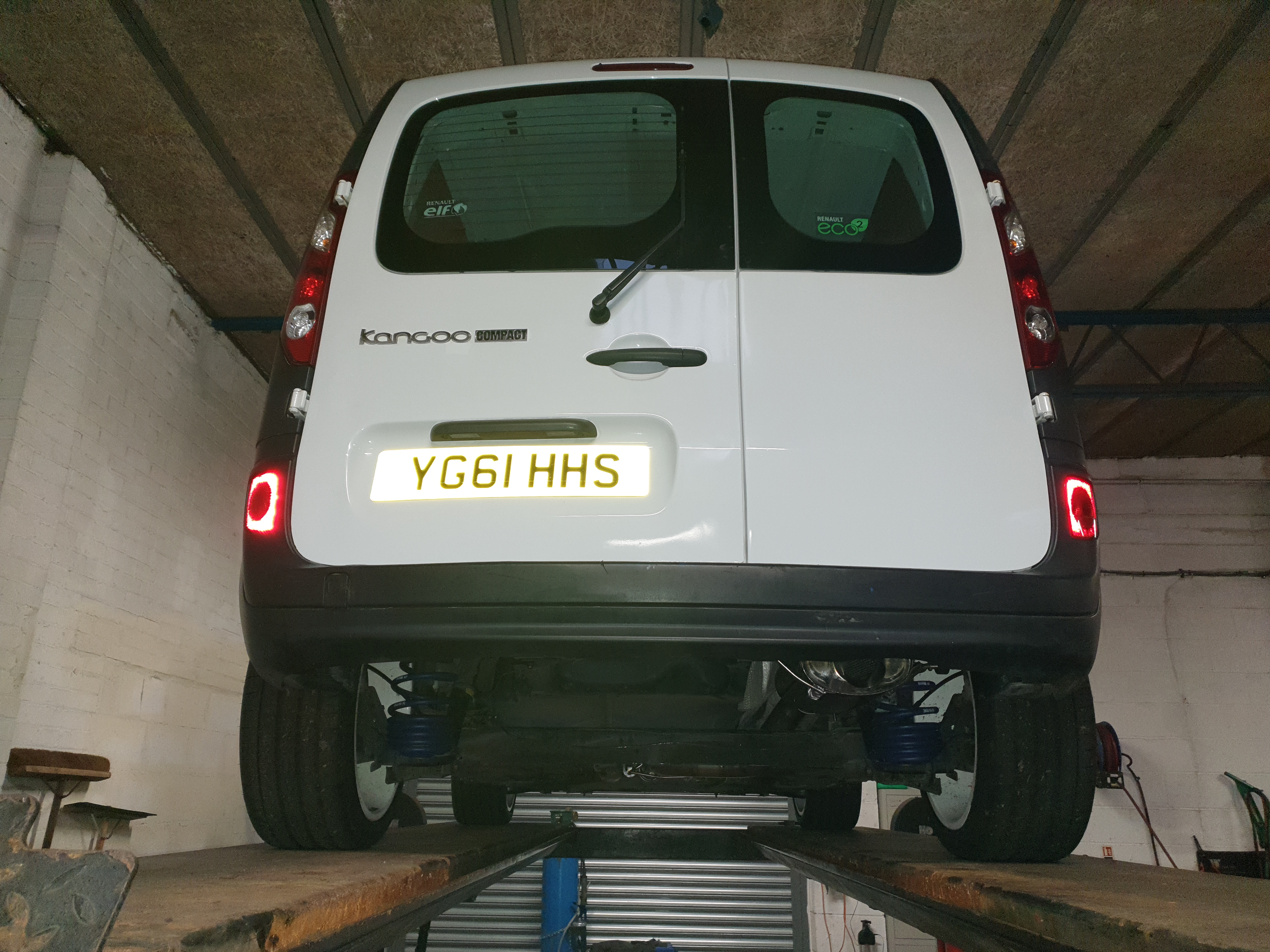

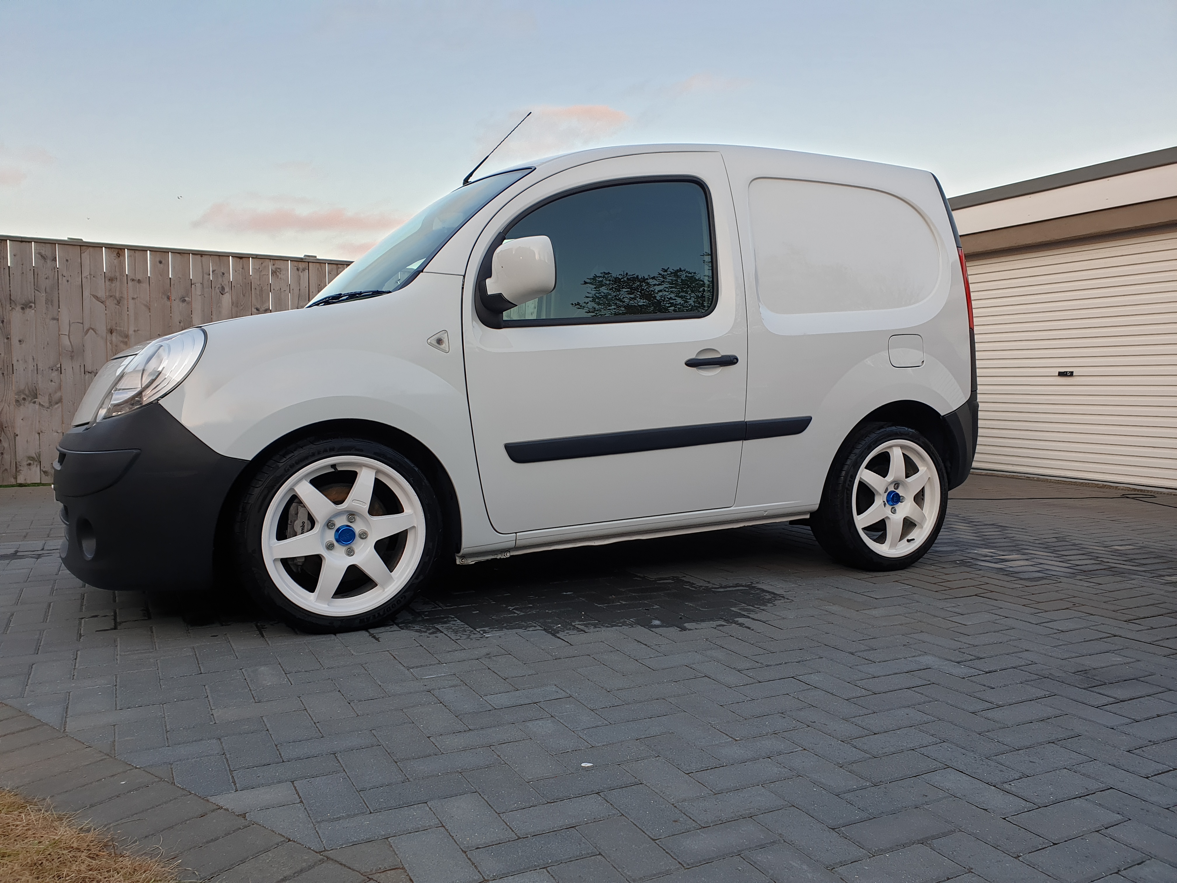

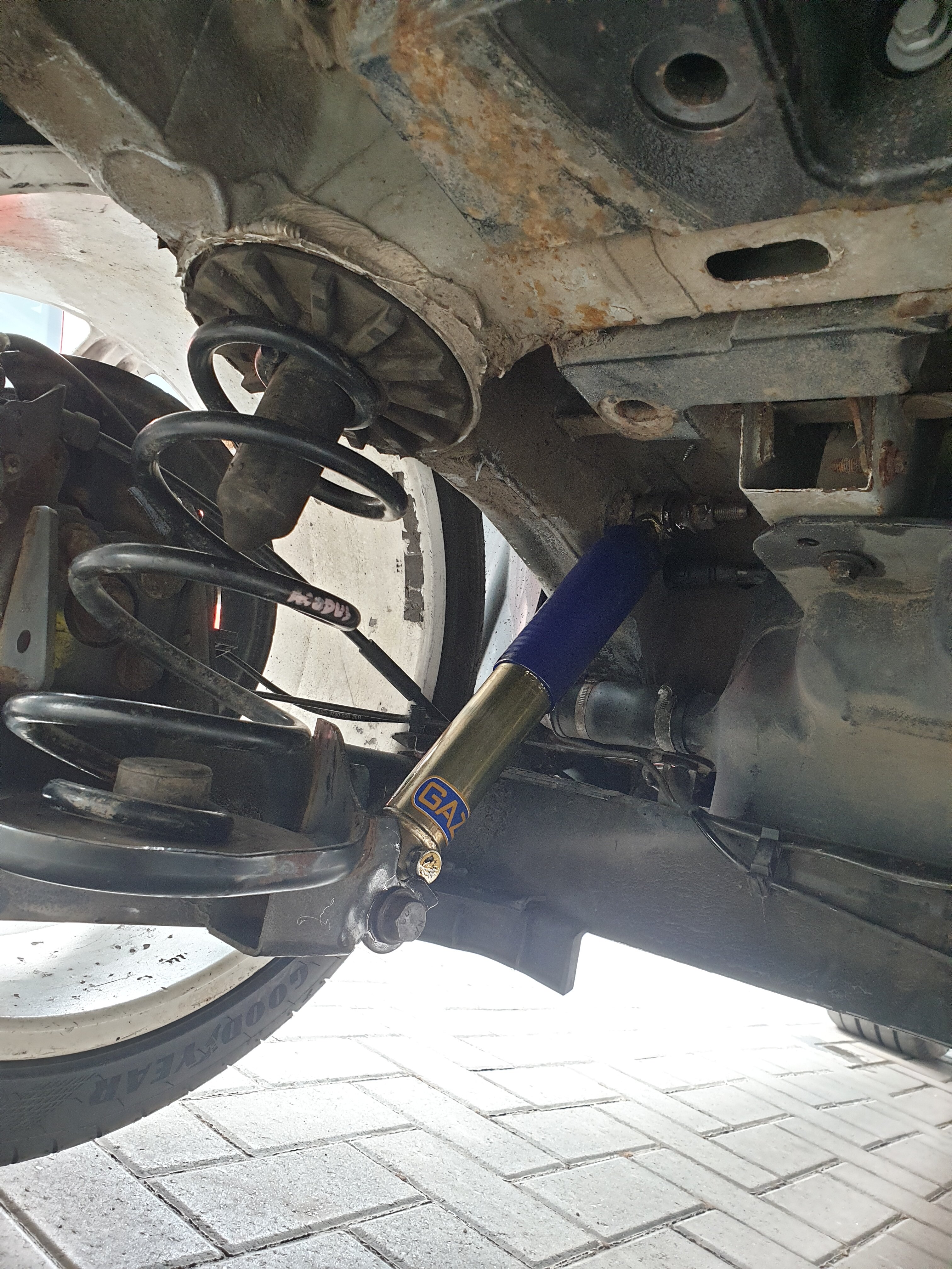

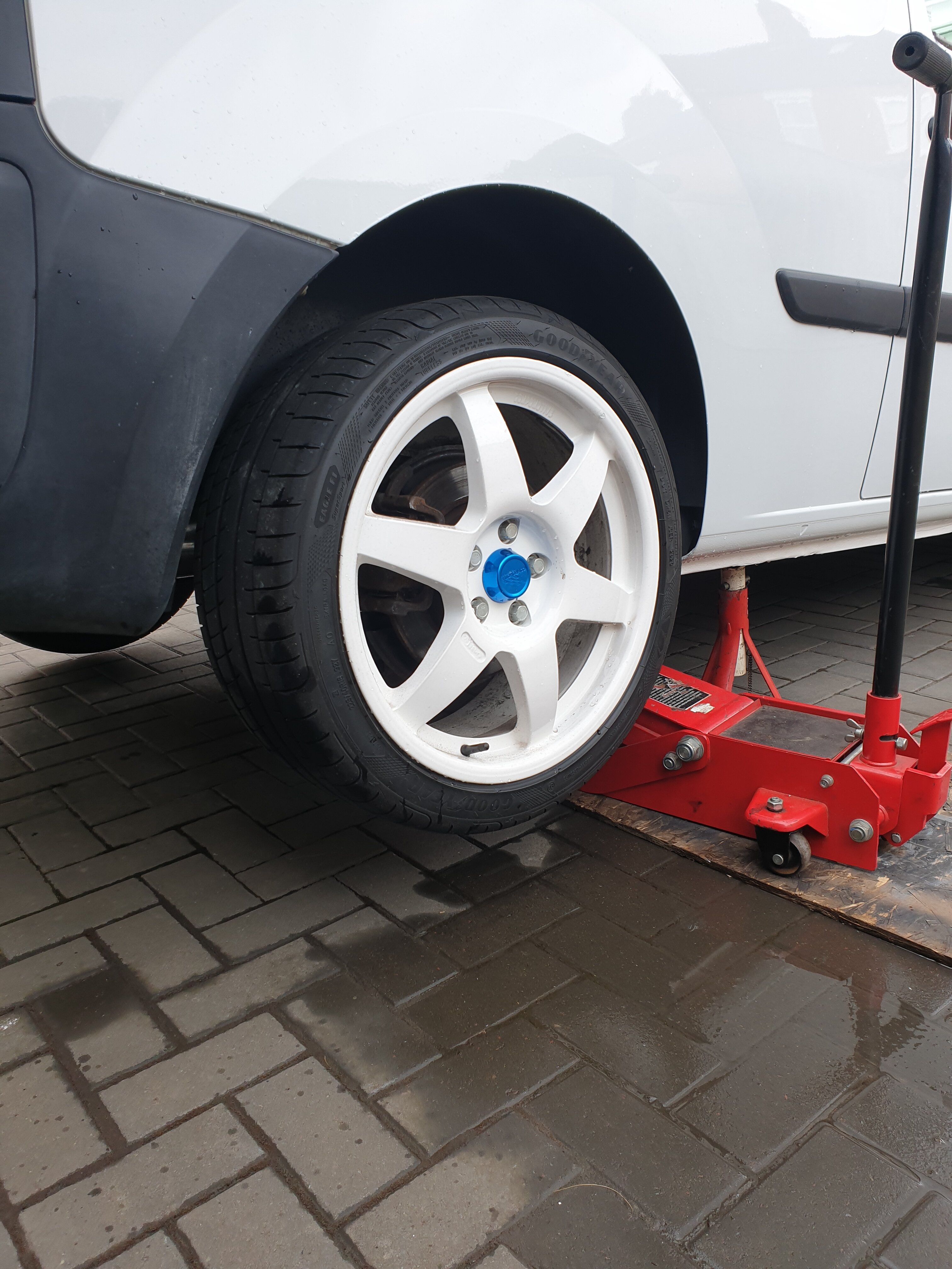

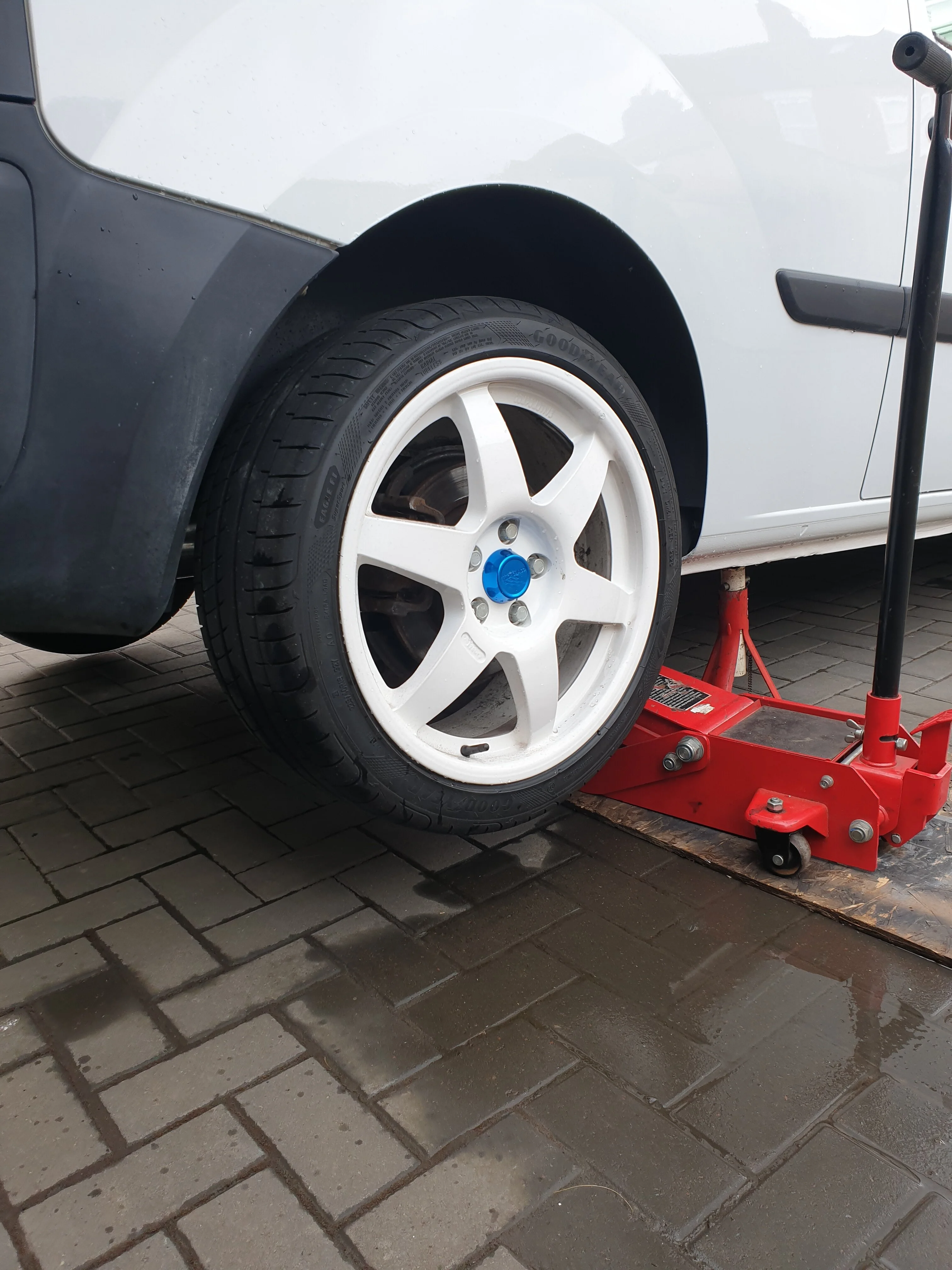

Next job was lowering on the rear. The height and ride on the back on stock shockers/H&R kangoo springs was pretty piss poor, and did not do the handling any favours.
Ive been sniffing around for rear springs and had 4x sets in stock, Clio 197 o.e, Clio 197 H&R, Clio mk4 200 cup and modus.
One of the lads on the kangoo/kubistar group on facebook has ran the modus springs for a few years and his sits good. The pigtails fit properly, its not silly low, its quite firm which suprised me.
As the springs are quite a bit shorter than original Kangoo had to use shorter shocks, Clio mk1 16v Gaz rears fit with minor mods, had to fit a spacer on the lower mounting point.
Spacer as fitted, its all torqued up solid. Ideally a custom set of shocks would be best but i reckon Gaz would supply similar with a larger insert in the polybush.
Less droop when jacked up
Sits quite decent now settled, low but not too low on the rear. Shocks are 4x clicks from fully soft to keep some comfort on the road. Handling improved instantly.
I also have the option of fitting the clio 197 oem rear as they are 25mm of so shorter than Modus, but are a little loose in the spring cups when jacked up, which is about the same as most lowered 172's so may be an option in the future. Will see, its a lot less offensive on the eyes now.

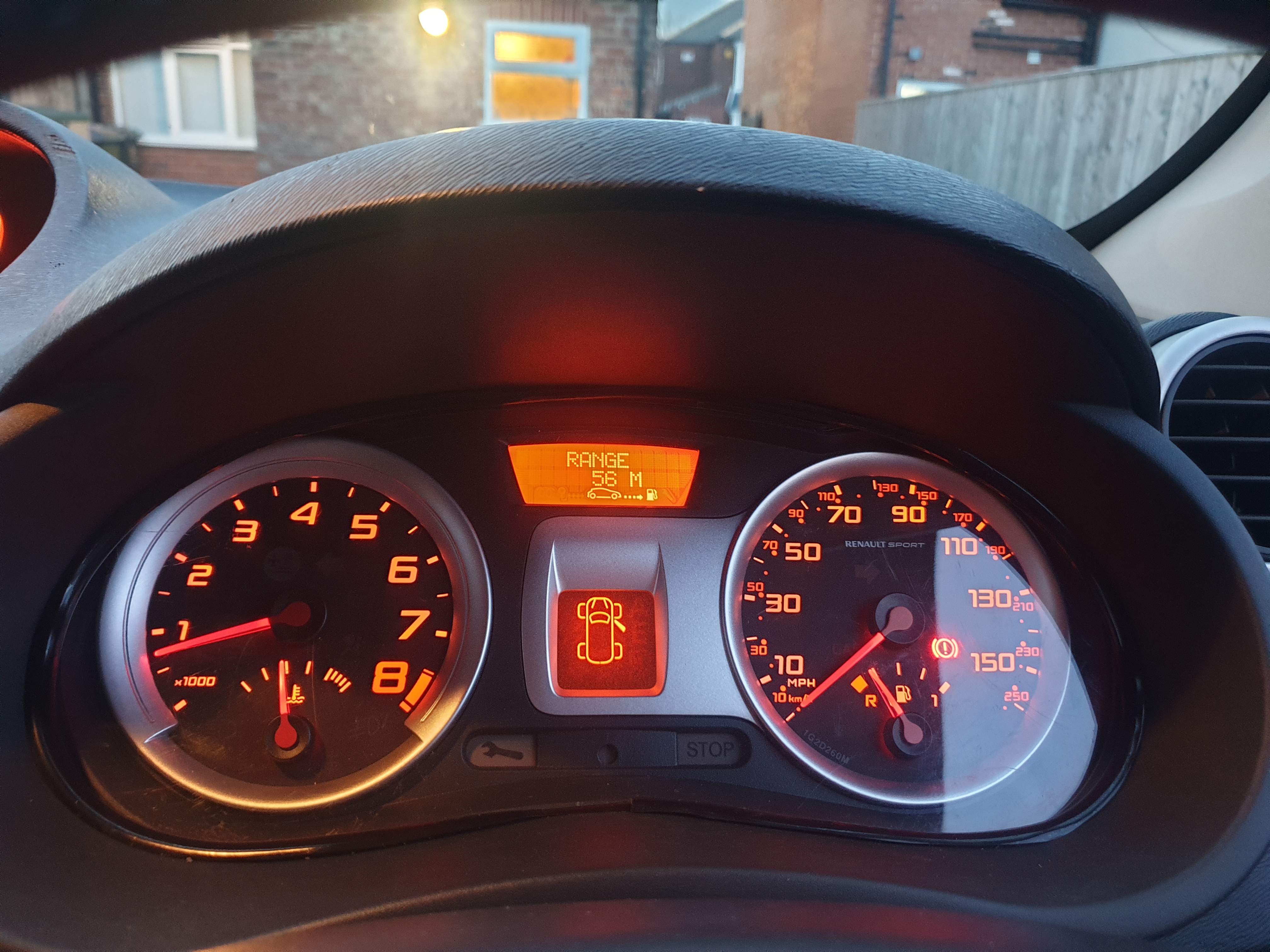

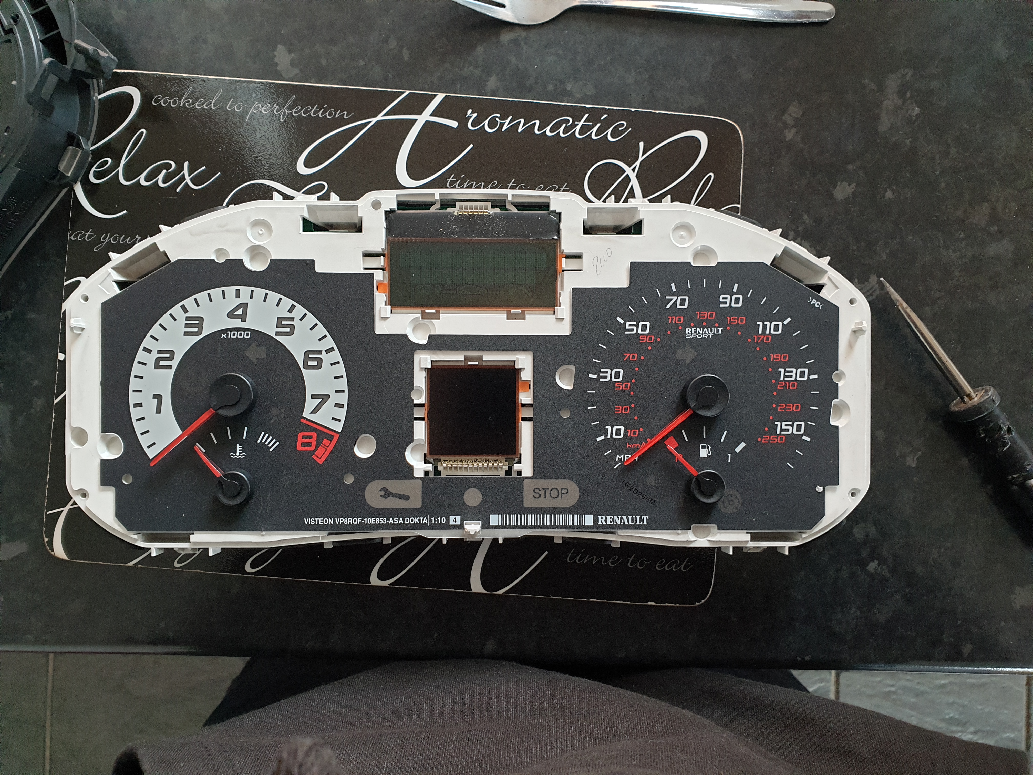

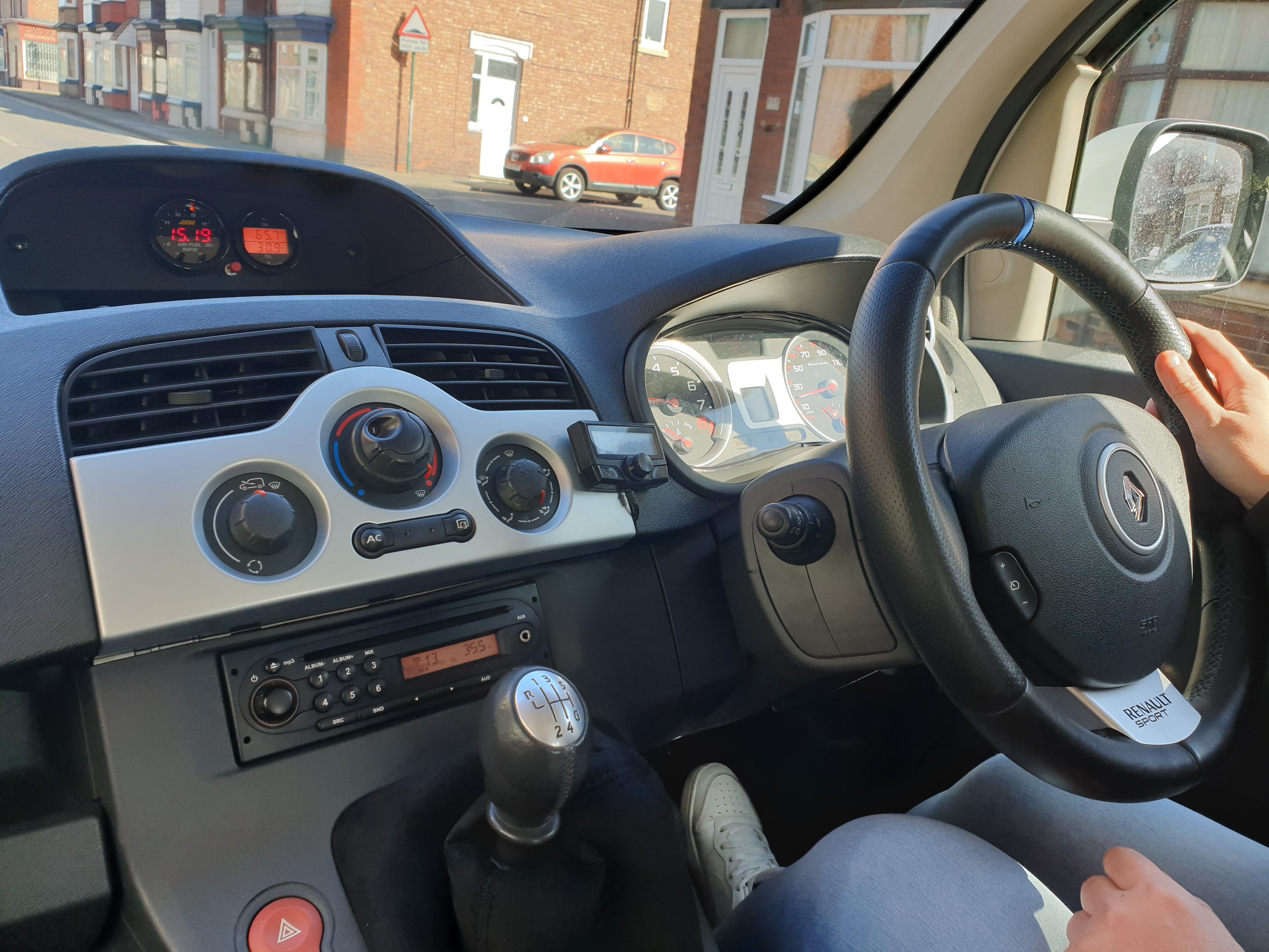

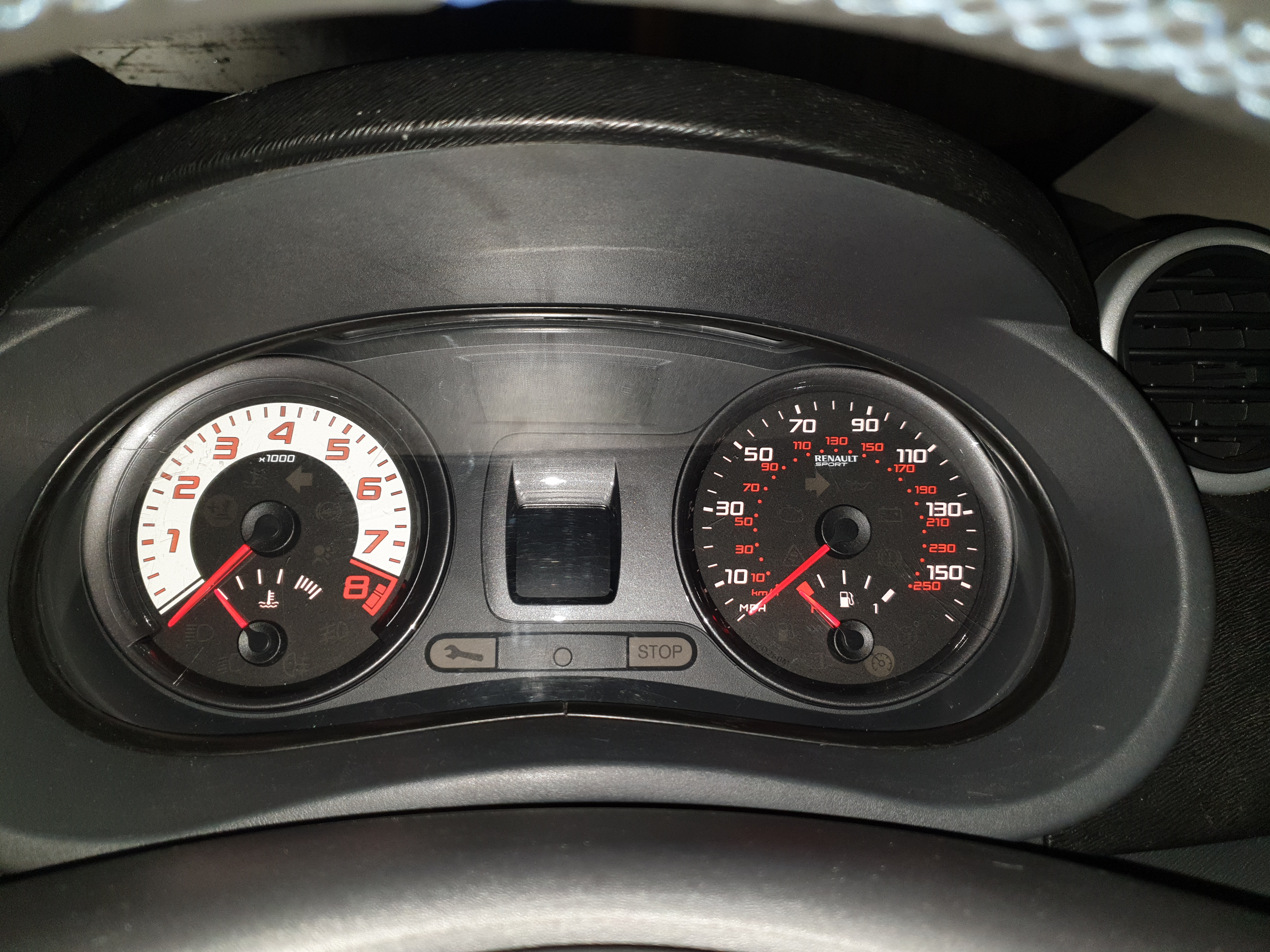

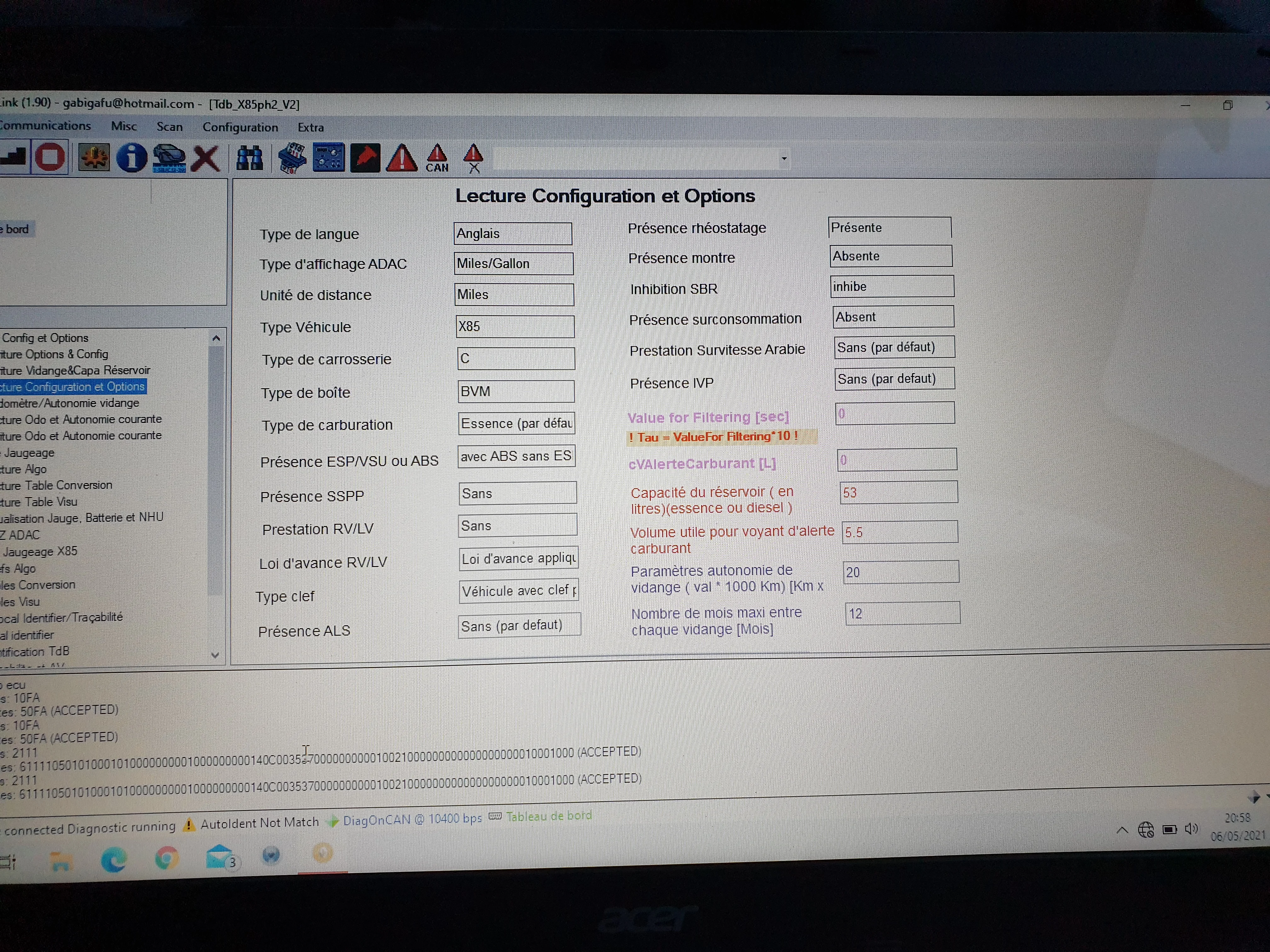

Had my eye on a late clio 200 cluster to replace the 197 cluster that i had fitted. The 197 dials did not offend me too much but not too keen on the silver insert.
197 cluster as fitted, not the worst.
Replaced with 200 cluster. I believe white rev counter was on the last year of production for the 200 as most were yellow.

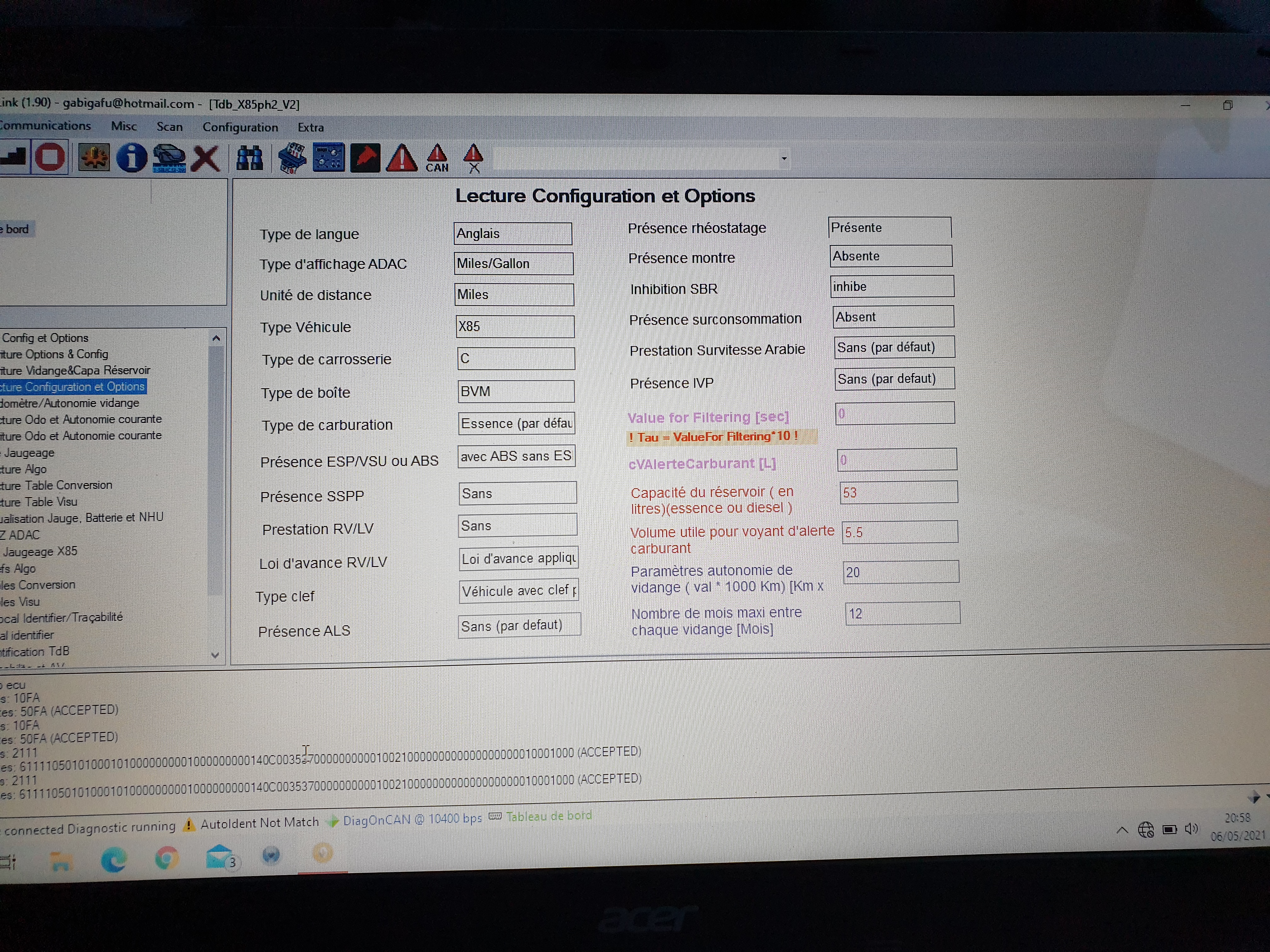

Plugged clip in and reprogrammed most of the stuff out. For some reason changing from keyless settings to normal key would not work right leaving the cluster lit up until uch shut down.
Took negative terminal off to try and force it into programming mode and save settings, give up eventually and fired up my other laptop with Ren0link on.
Changed the "type clef" and saved, job done in 30 secs. Can force most settings to save, but one slip and you might be in the s**t if your not careful :LOL:
Note rev counter needle low on the pic above, looked fine on pics so can only assume its slipped in the post. Checked against obd data when running and it was 300 rpm out.
Cluster out again and popped the needle off with a fork, reset and checked on obd data which reads ok, job done
Took this opportunity to use some light compound on the lense to remove some scratches, came out nice. Renewed the trim around the binnacle which was previously silicone hose.

Cleaned up a spare megane sender and fitted a deatschworks dw65c pump and modified 5 bar fuel pressure regulator. The 5 bar reg is needed so i can use the rising rate regulator on the 250 fuel rail.
Sender cleaned up and pump is drop in, no mods required.
No pics of dropping tank as ballache but done and dusted.
Ive seen a couple of reports of issues/ megane upc burning out with the aftermarket uprated pumps fitted, not sure if isolated or not though. The old walbro 255 had not melted it with stock 3.5bar regulator, but moving up to 5 bar reg and the amp draw is larger so may cause issues.
Was not taking any chances so hardwired the fuel pump to take the load off the upc. The original meg fuel pump wiring looks to be 14/16 gauge which is borderline at best and this is diesel loom so god knows what its like on the interior harness.
Ran a fat 10 gauge live wire fused from battery, to a 40amp relay that fits nicely on oem interior fuse box, and straight to the pump connector. Should be a decent voltage at the pump now and no worries about the upc burning out.
No pics of fitting but it was a solid 3 hours of graft running the cable in nicely, had to take the arch liner off the nearside rear to get to pump wiring, ply lining off the inside, strip glovebox out, battery and tray out. Right carry ono_O

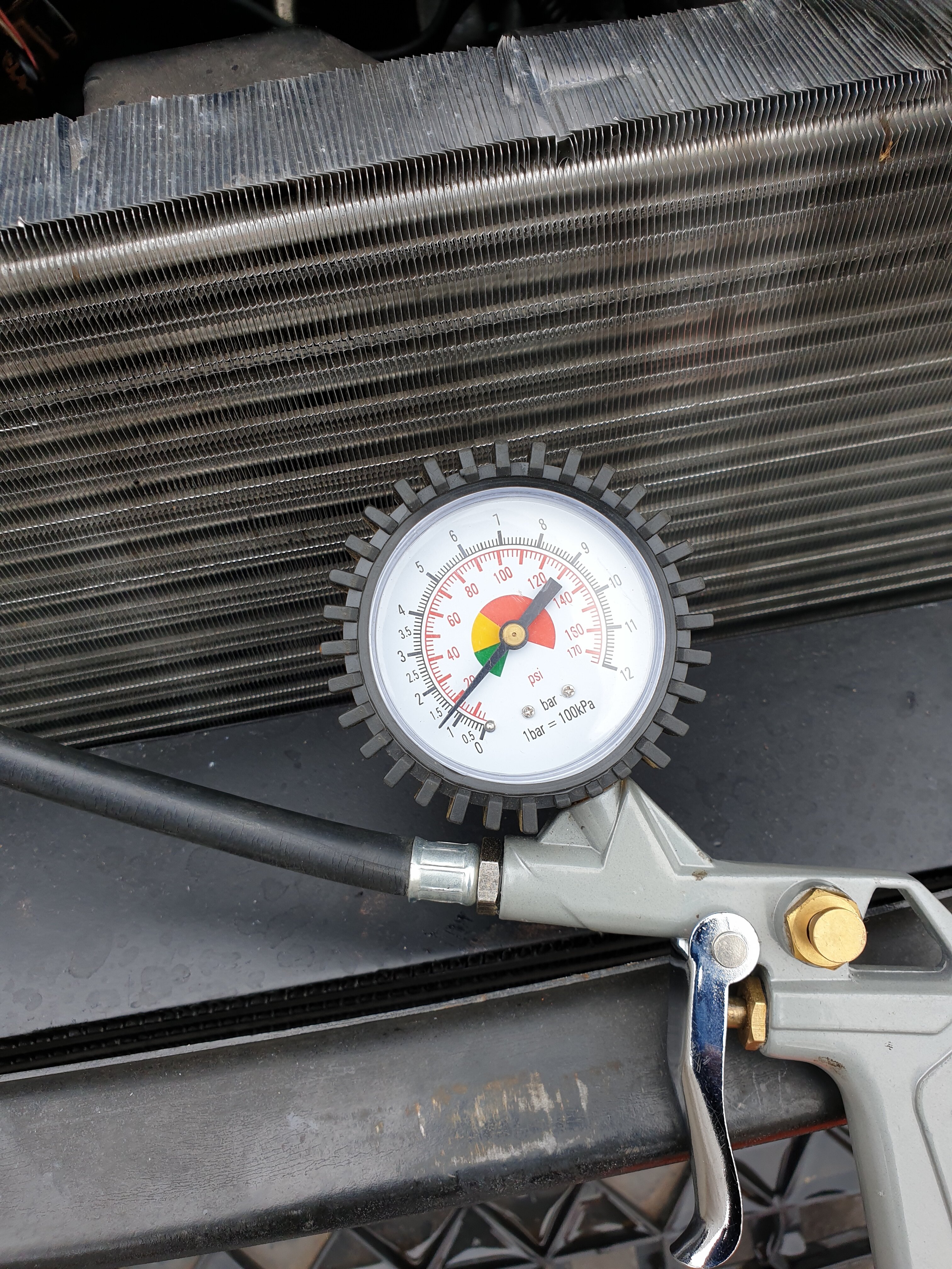

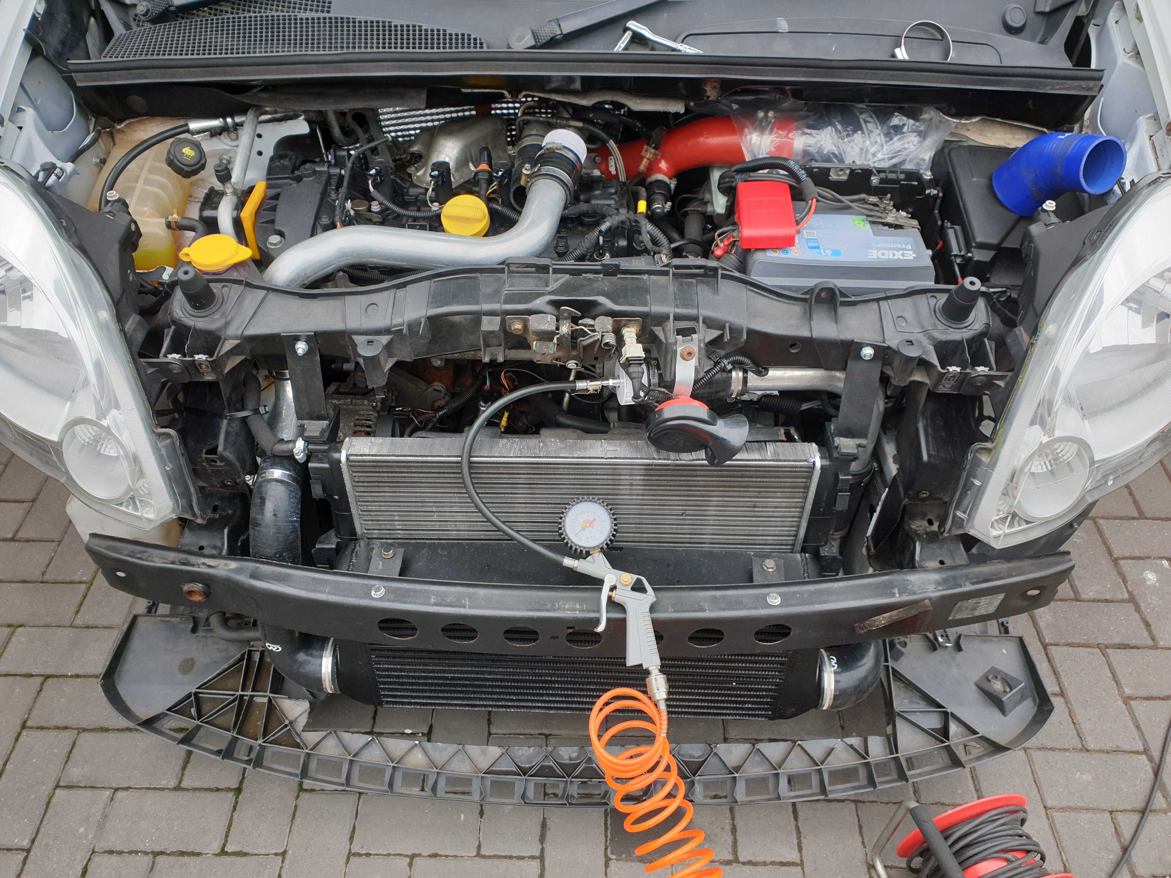

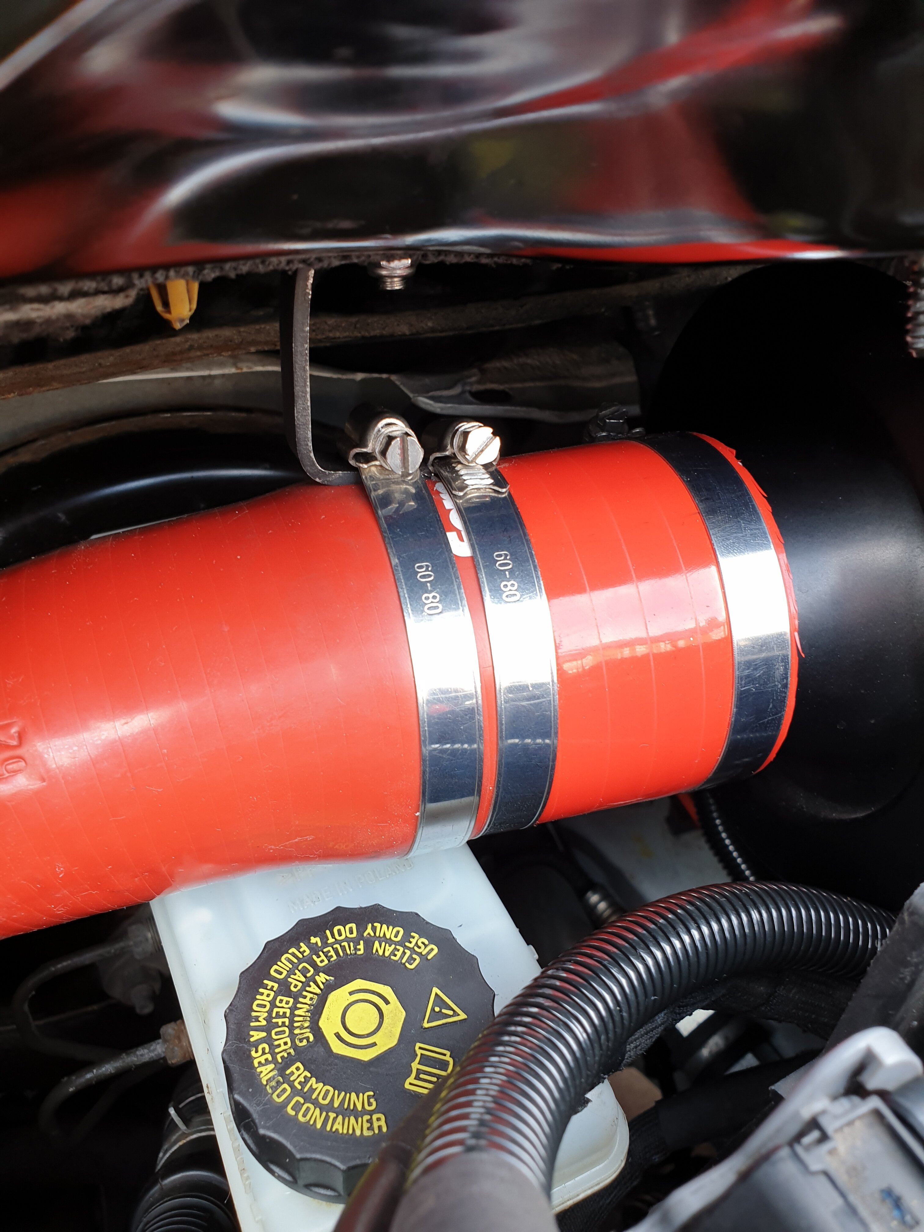

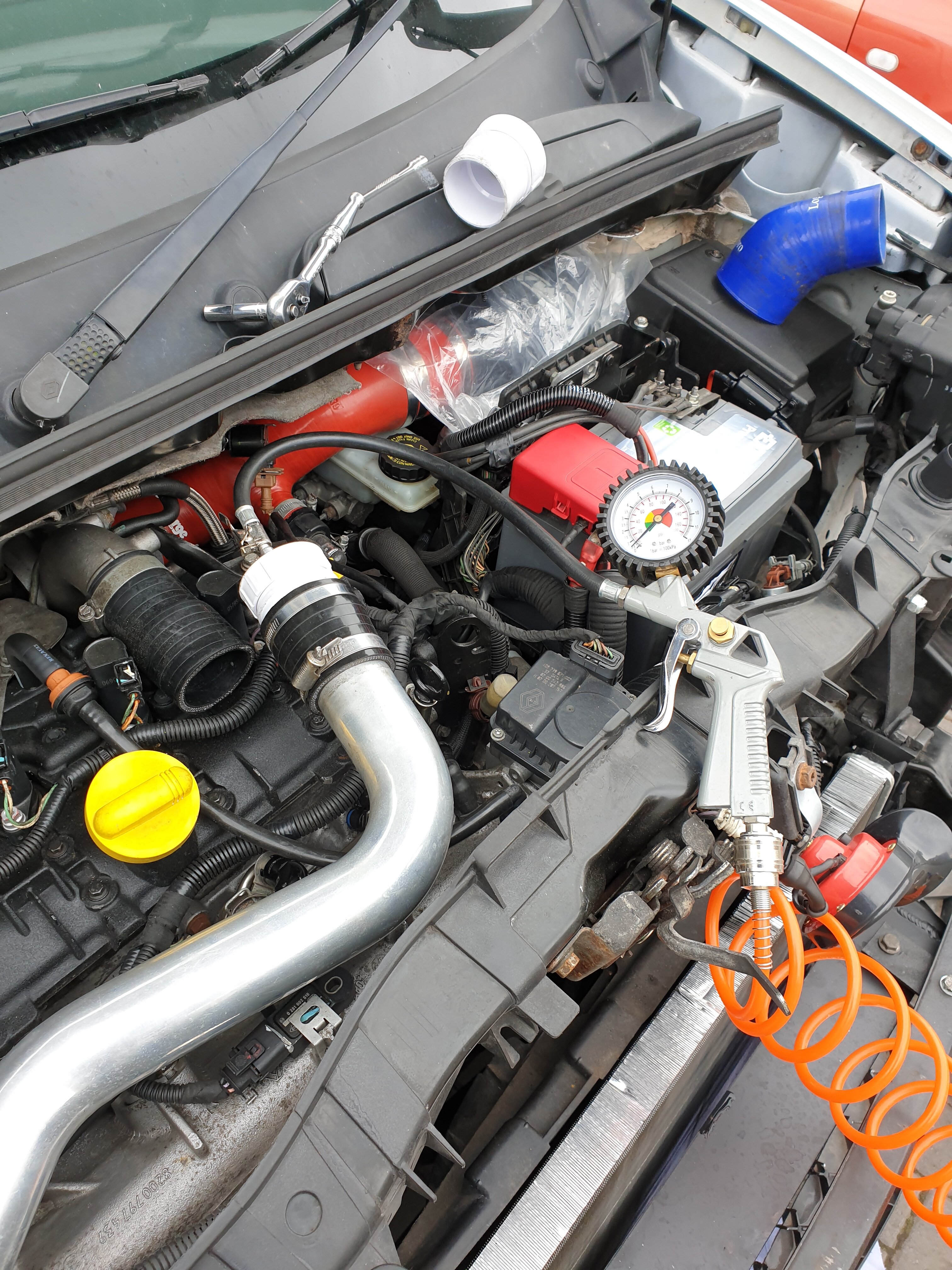

More prep for mapping today, boost circuit leak testing. Essential step as i want all the boost;)
Whipped front end off and bunged the pipes at the turbo/throttle body connections. Stuck 1.2bar in and it held it straight away, no leaks. I was expecting to have to nip a clip up but no need.
Next step was to stick the throttle body hose back on and pressure it up from the turbo to check the inlet for leaks.
Again no issues which is good. Leaks a little bit of pressure past the valves that are open as expected but throttle body adaptor is ok.
Stuck a fat 35mm2 earth cable on the engine block to inner wing whilst there as belt and braces.

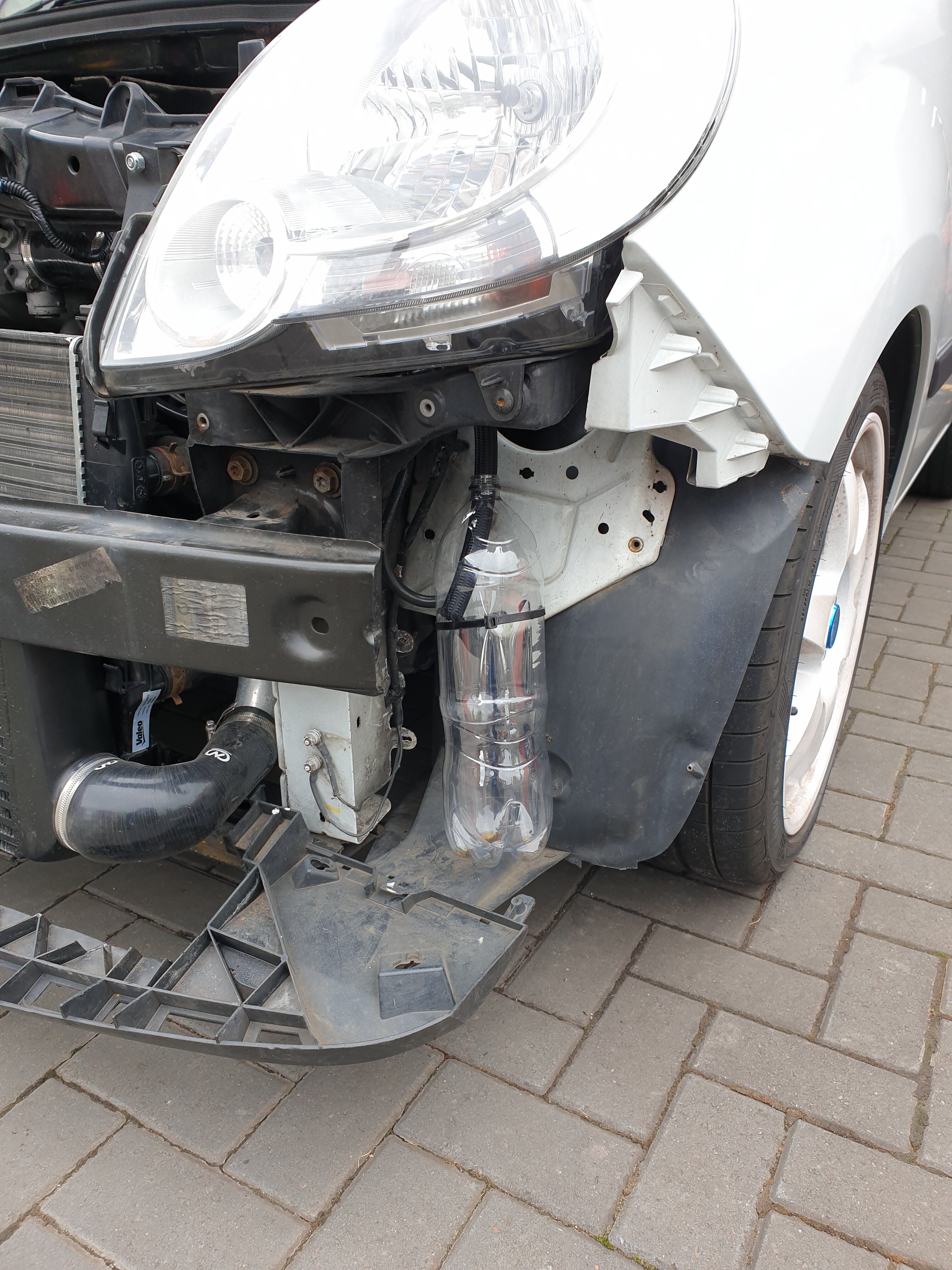

Needed a catch tank too as the rocker breather was just open to atmosphere. Room is very tight and the only real space left is down behind the bumper. Temp 2ltr pop bottle hooked up with holes in the top. This is a bit of a homage to my Extra van that ran a robinsons bottle catch tank for several years before fitting an alloy tank last year. Its not msa spec but it will do;)
All back together and road tested and running great.
Also fitted a 3mm rubber penny mat to the rear to stop stuff sliding all over on the ply. Shez cut it to fit and done a great job.
2kg powder fire extinguisher fitted which hopefully will never need to be used.

Last few jobs done
Stainless air filter bracket to stop it resting on the brake fluid reservior.

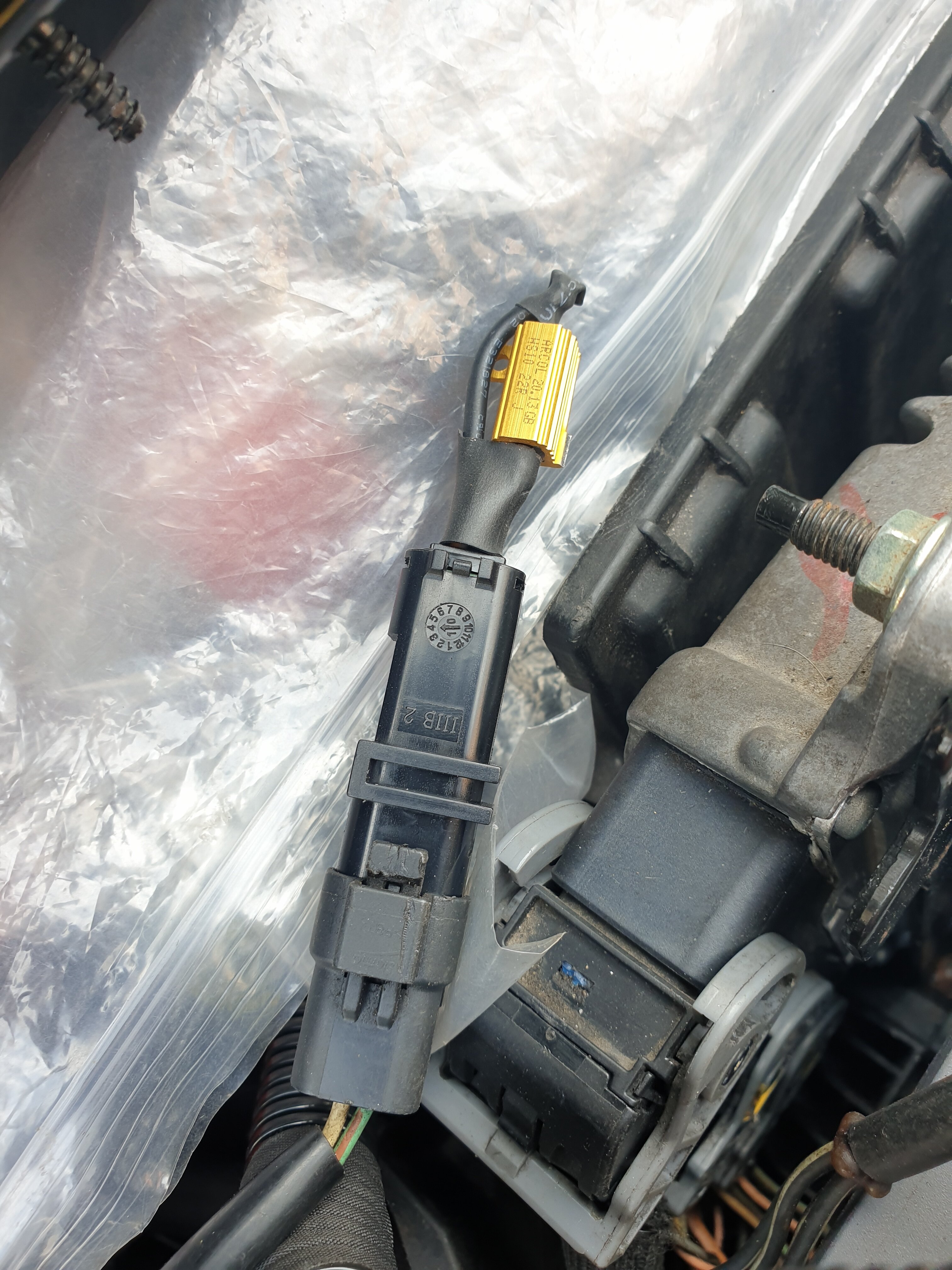

Purge valve emissions s**t delete with a resistor to keep the ecu happy and no lights on. Had the valve plugged in and no pipes so had to go.
Last job was a good clean up
