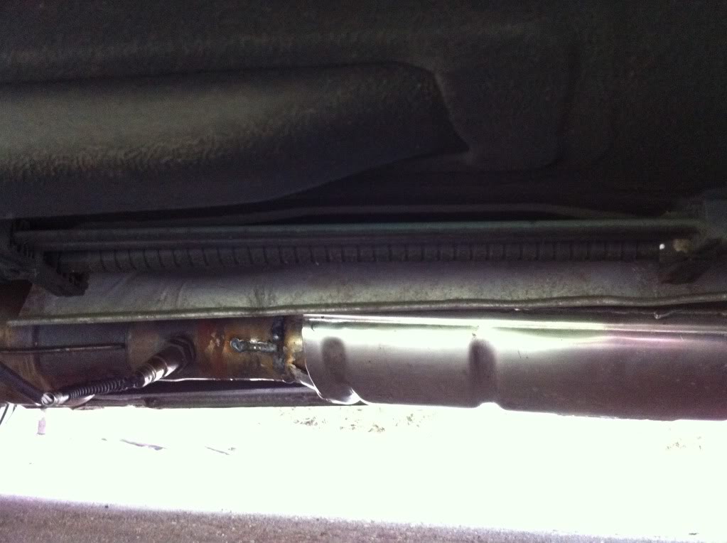

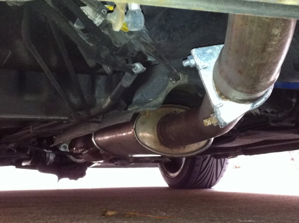

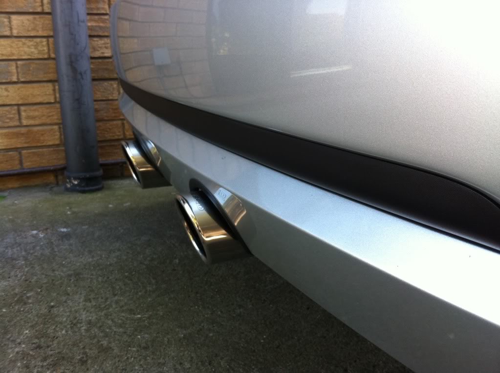

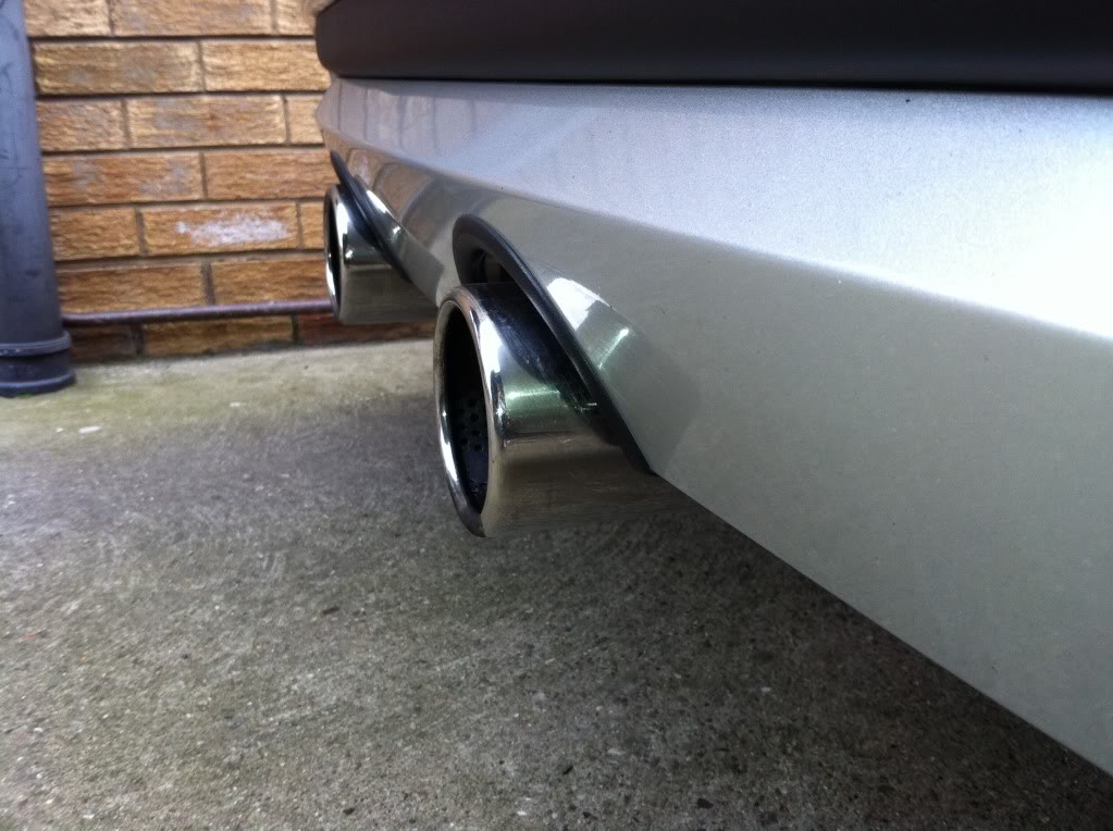

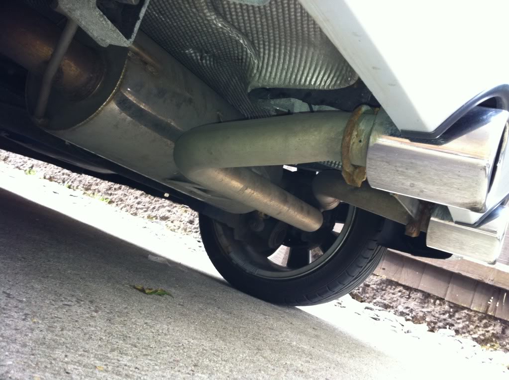

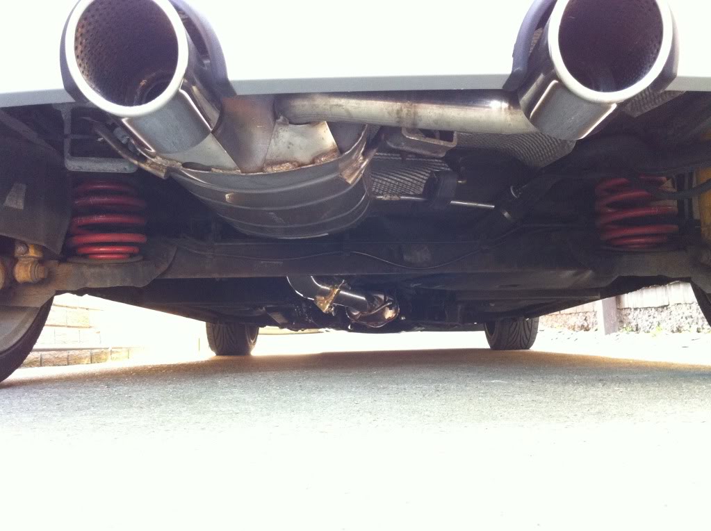

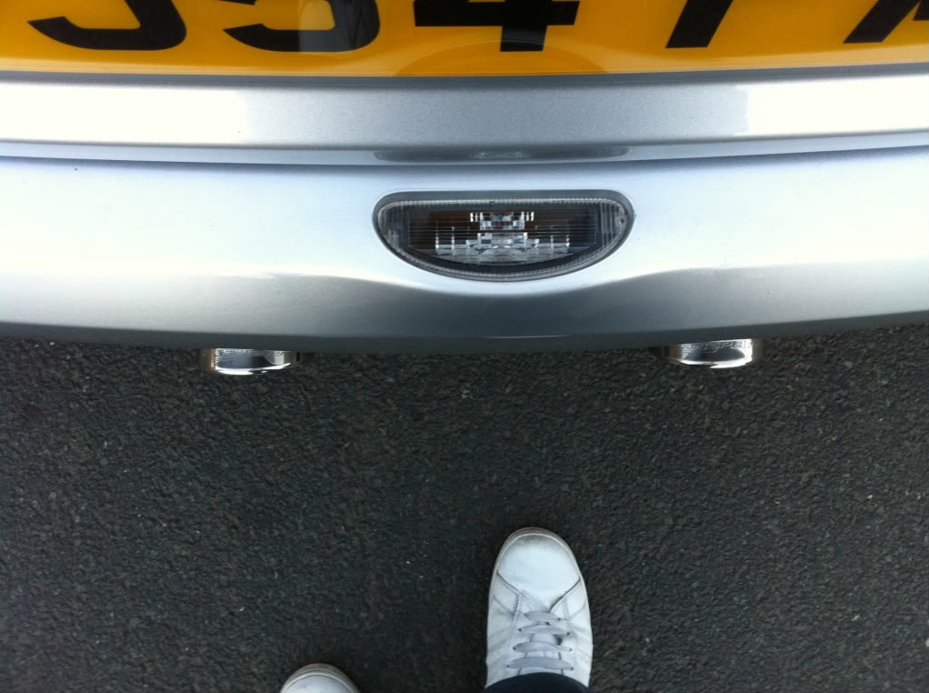

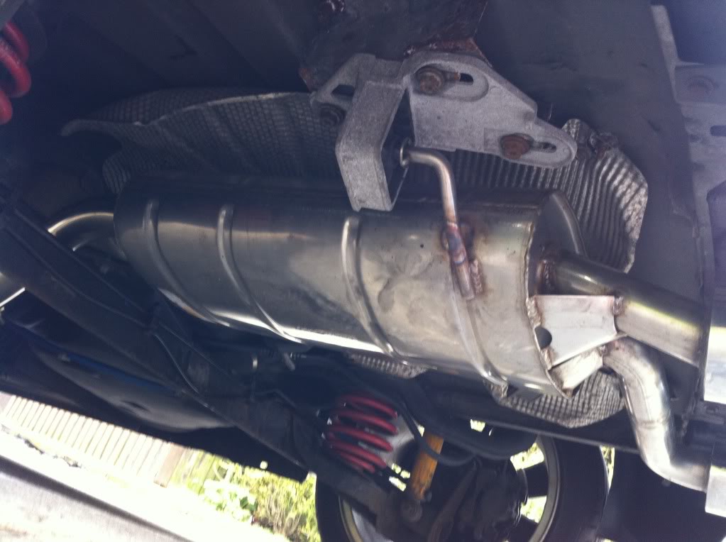

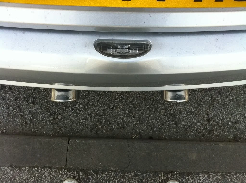

but wasnt happy with the fit, as it seems to stick out too much, also the "garage" that fitted it wouldnt and said it couldnt sit further in...(also later on in the day my exhaust started blowing badly) took it to another "proper" garage who specialise in performance parts and servicing etc. they said it could be done but on showing me under the car, they said the previous gagrage had f**ked it all up and made a right mess of fitting the exhaust to my cat. The previous garage had pushed in and bent the middle section pipe to fit into (inside) the cat join and just filled the gaps in with sealer which burnt off and left holes hense why i was blowing. and they also f**ked an exhaust mount so i need a new one. The "proper" garage had to weld the middle section to the cat
finished exhaust sitting how i want it, ideally wanted it in another 5mm nearer the bumper but hay hoe, am happy with it.

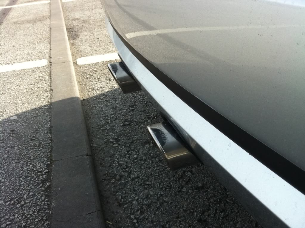

on the 3rd pic down i thought the car was white for a minute
exhaust looks good, i like how its sat out slightly

yeah i actually like the sound better than the ultra, a bit deeper but quieter and not raspy loud like the ultra

Looks great mate, just sorry that I couldn't justify buying the ultra off of you a few weeks back... Glad that it's all sold and your happy with the new one, slash cut pipes look really good!
