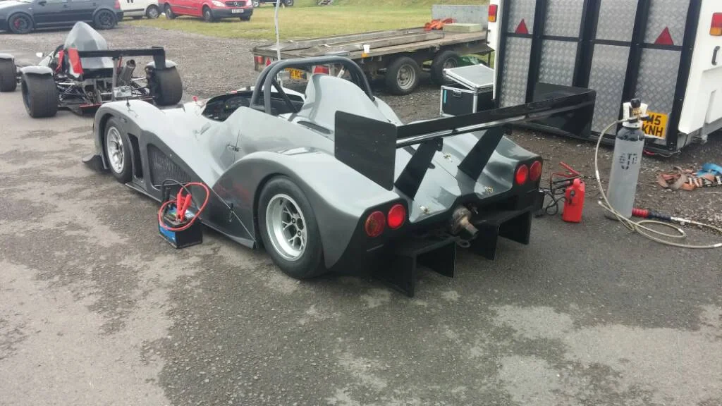

Here are the aforementioned machinery that turned up for the following days track time. Seriously varied and cool cars.

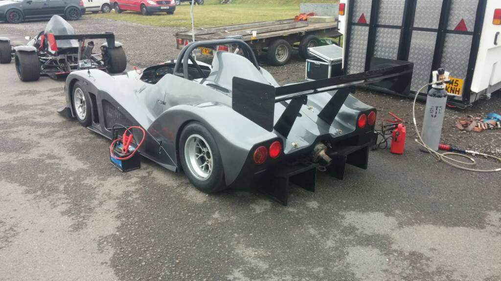

Radical was very cool, but terrible! Took corners slower than the track/race prepped Integra, actually most car a were cornering as fast as it! Clutch was slipping like mad and was just revving and going nowhere! Lol

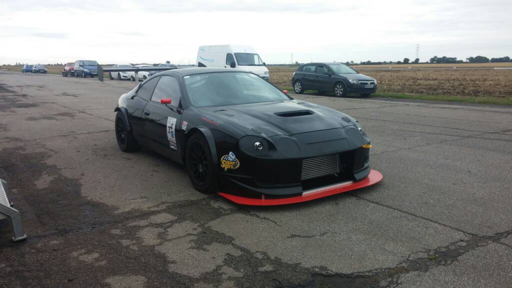

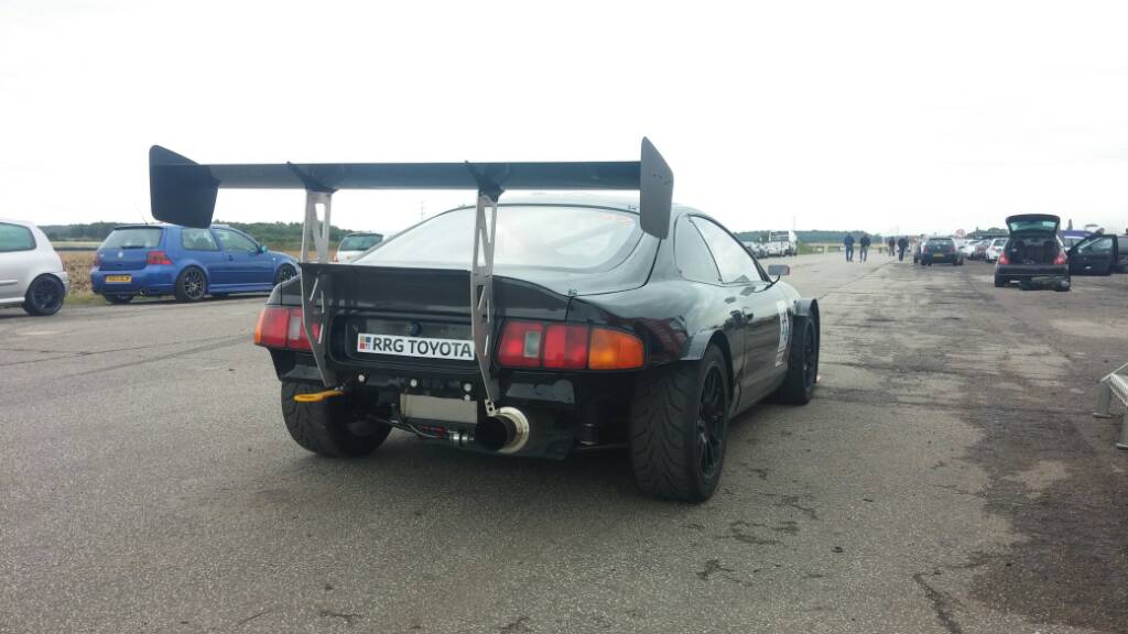

The 550hp celica

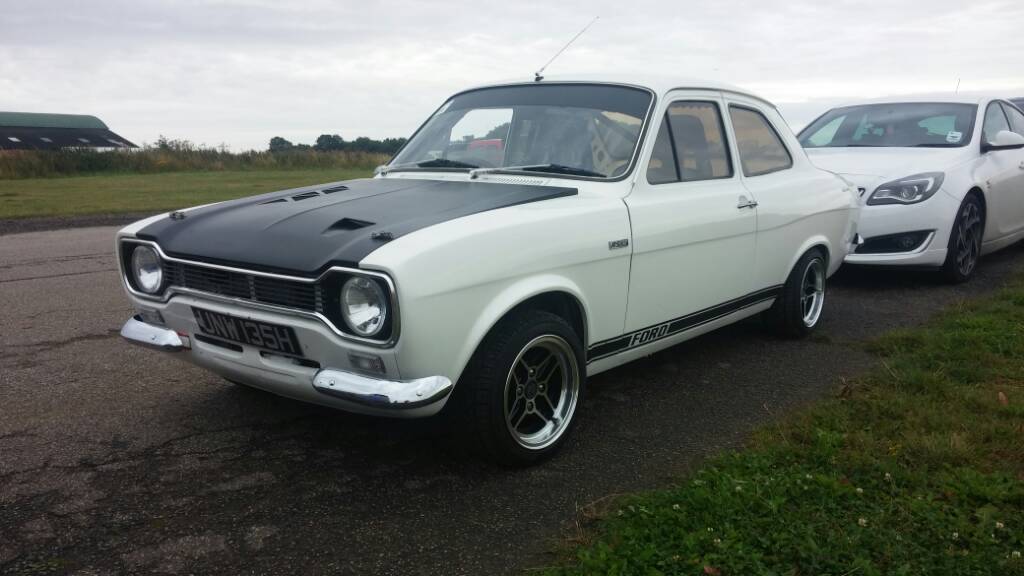

Gorgeous escort with "liable to go sideways at any time" sticker in back window.

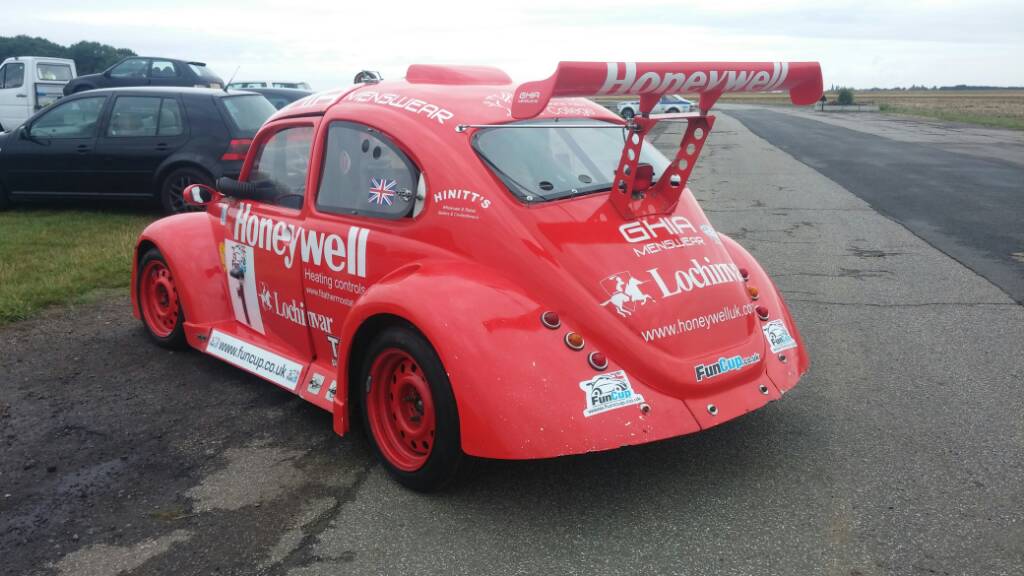

Beastly tdi powered bug

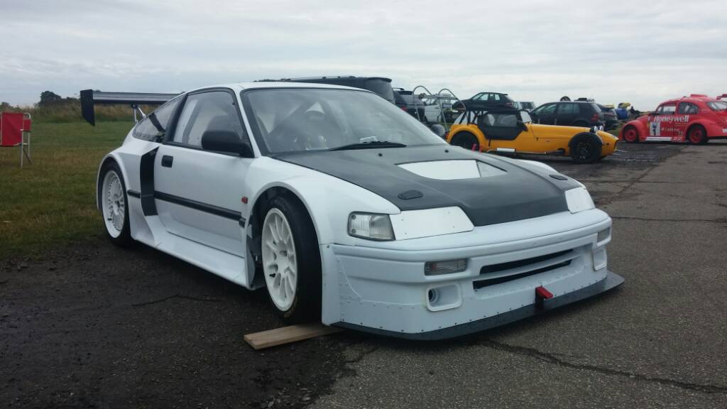

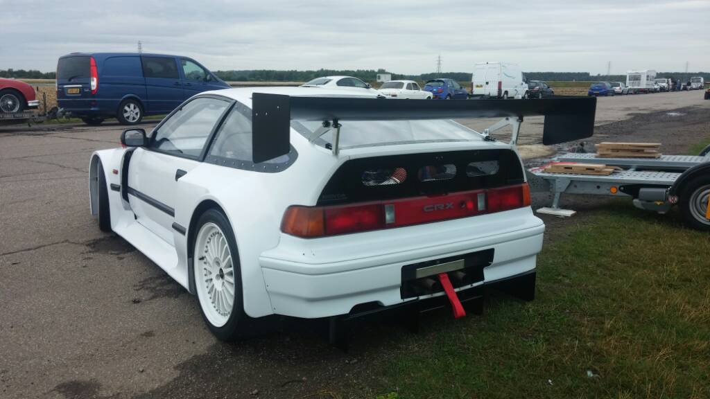

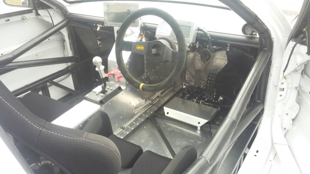

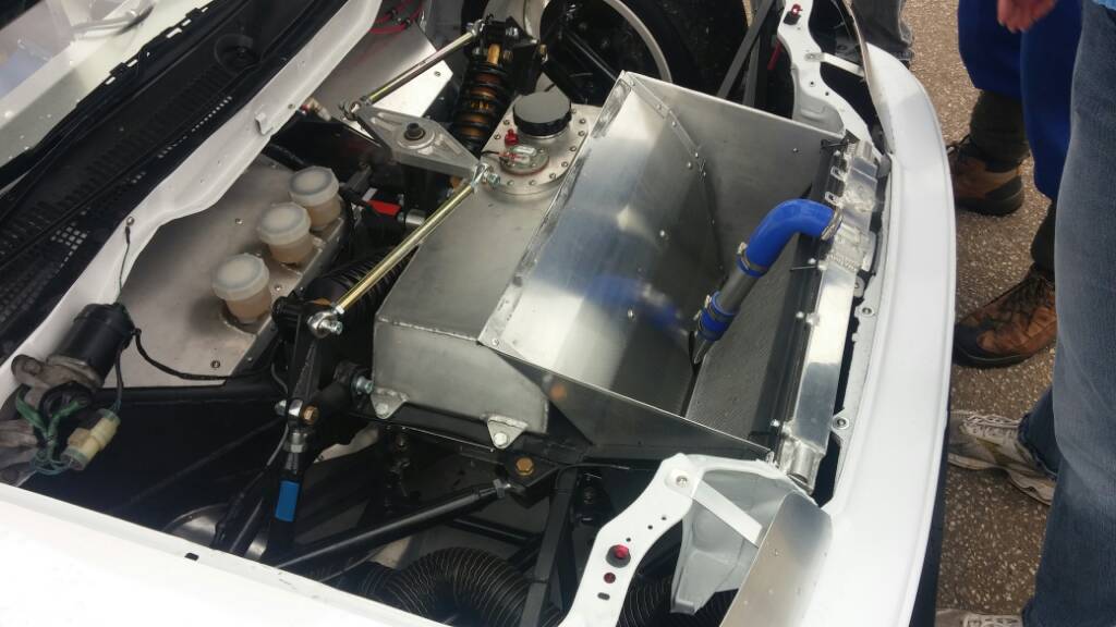

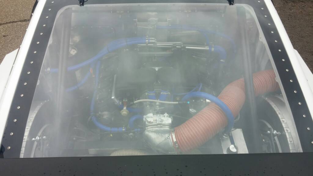

Best one IMO. Home build crx. 4 years in making. 420hp supercharged 4.2 v8 Audi engine in rear. All gorgeous, tidy, meticulous interior. Amazing suspension fabrication. Superb welding. Its some piece of.work!
Amazing work.

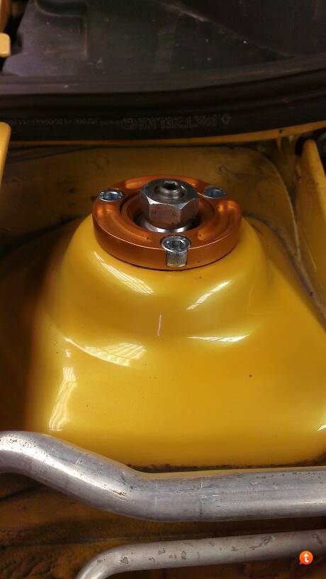

Top mount assembly
Discs, pads, shocks, lines, springs and spacers fitted.
One of the top mounts had begun to perish and the one rear wheel bearing was totally shot and grumbling. So a job worth doing.
Hi; Bit behind it on your thread but thinking about top mounts. What type are these? With eibach pro's and cup shocks? How do you find the set-up?
Cheers
Hi. Their comp brake top.mounts. circa 130.
I use cup shocks and cooksport springs.

Cheers Dan, I have just had eibach pros and cup shocks fitted after polybushing rear axle, top shock mount, front wishbone and arb so thinking of solid mounts next. See how the rest handles first then decide I guess. Certainly look a look better. Any reliability issues yet? or bad vibrations though I would expect it just to force the load onto the shock and spring better. 106 delivered on Kamracing just now!
How did you find the fitting? Anyway it can go wrong in terms of camber etc.?

Sounds good!
They do make it a tad crashy when hitting rough spots in road. As you can imagine, it's solid steel rather than rubber.
But worth it for the turn in and sharper feel I think.
As long as you centralize the mount when drilling (3 holes per turret) the castor should be fine. Had mine Hunter aligned and their spot on.
Had them fitted for 25~30 odd K miles now. No issues. Not sure what mileage their recommend though. I may need to check this out actually. I'll renew shocks and mounts together. [emoji106]

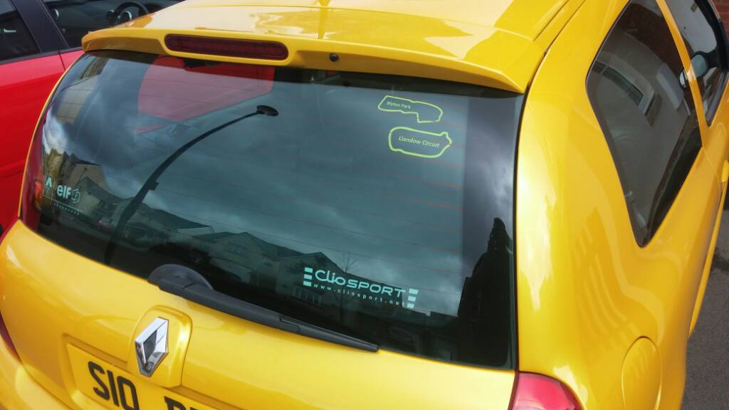

Never been fussed on the track stickers I fitted. They were large and ugly.
So went back to the guy and asked if we could 're do them. Wanted to try yellow too. So got a set of blyton and llandow in white and yellow.
Guys spot on and did lots of spares for me and another track which I didn't ask for this time. All for 13.50
Much happier with them now:

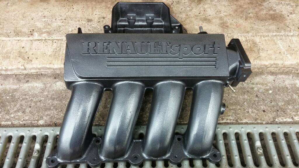

I don't know if someone's already said this as not read every comment, but you don't need to use high temp paint on your inlet. Any paint will be fine mate.

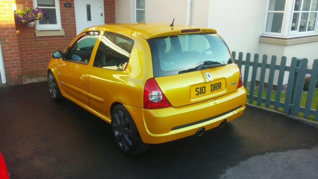

After giving the S3 a major going over with the DA polish session..... Can't leave the Clio out!
So today gave it a thorough clean, iron out, de tar (and emulsion paint spots [emoji20]) and a clay jobbie. Buffed off and parked in garage ready for a polishing tomorrow.
As I DA polished it about 12 months ago....., I'll probably only use the finishing stage polish. Just to give it a light buffing.... then few coats of glaze, tough coat and a wax. [emoji41] [emoji106]

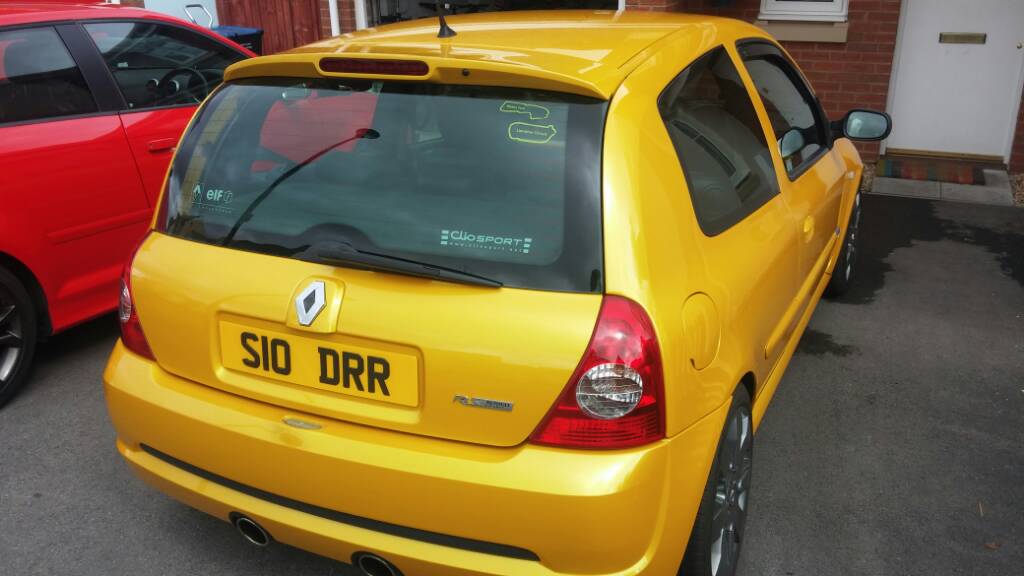

Finished the car today.
As the car had a major machine polish around a year ago, I only did 1 good going over with finishing polish, and white hex pad.
2 coats ultra glaze.
2 coats tough coat.
1 coat Pete's 53 wax.

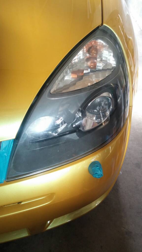

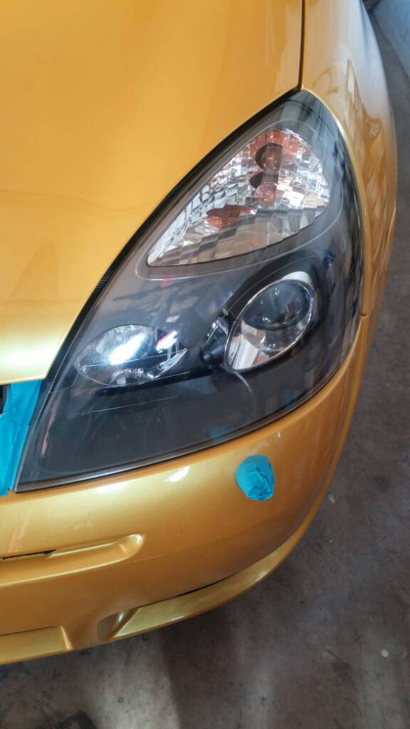

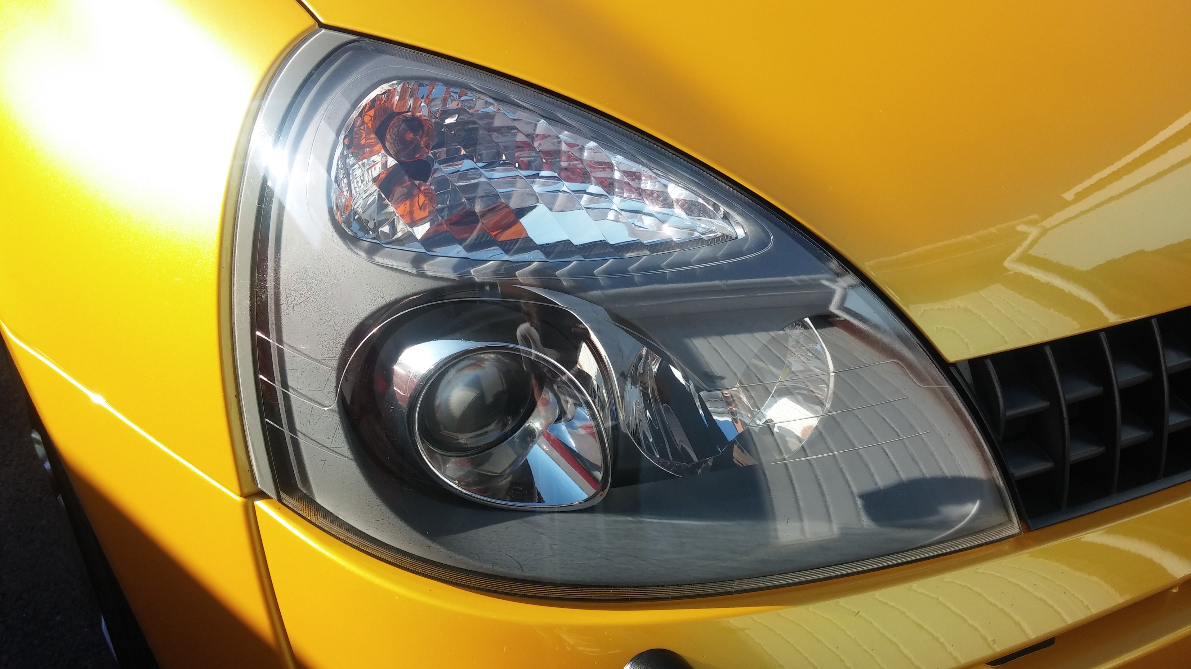

Headlights were starting to haze a bit again so did them with 3 passes of heavy grade polish, 2 passes of medium and 2 passes of fine polish. Really come up well again! [emoji41]
Before
After
No decent pics yet though. Will try and grab a few en route to work tomorrow.
Also used heavy cut polish on rear window, as the wiper blades scratched the glass. So did quite a few passes over that and it's massively improved it.
Treated tyres and plastics etc as usual too. Its looking rather lovely! Especially considering its 10 years old and 85k on clock. [emoji4]
