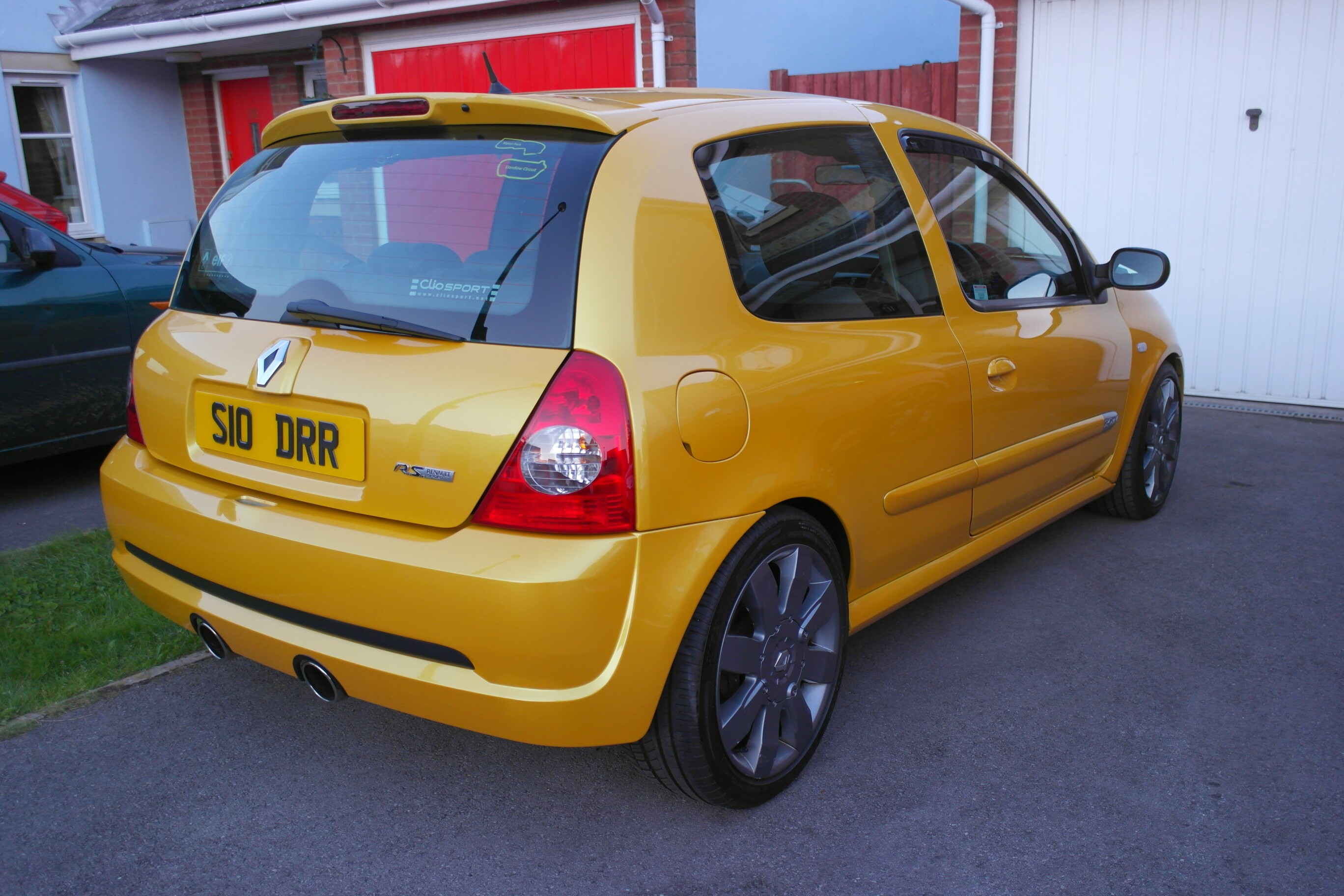

Anyway, didn't take pics on way to work... took some driveway pics after I finished the detail though so I'll share those instead.

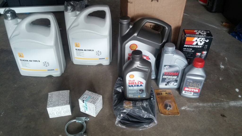

Ordered a nice service kit for the car
From Renault
2x 5lt type D coolant
New thermostat and seal (preventive measure)
Oil filter
Sump washer
70 quid
From Opie oils
Shell Helix ultra oil
Fuchs titan sintofluid gear oil
Moutl 660 brake fluid
Magnetic sump plug
K and N cleaning kit
73 quid
EBay
Coolant header tank
13 quid
Hopefully get it all fitted next weekend, mot then in next few weeks.

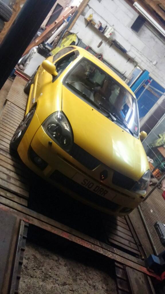

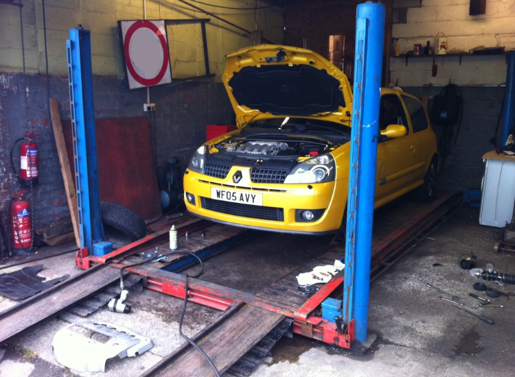

Had a good day yesterday.
@Hodgins kindly offered his help servicing the car. Has use of a 4 post lift at his dad's workshop too which is very handy!

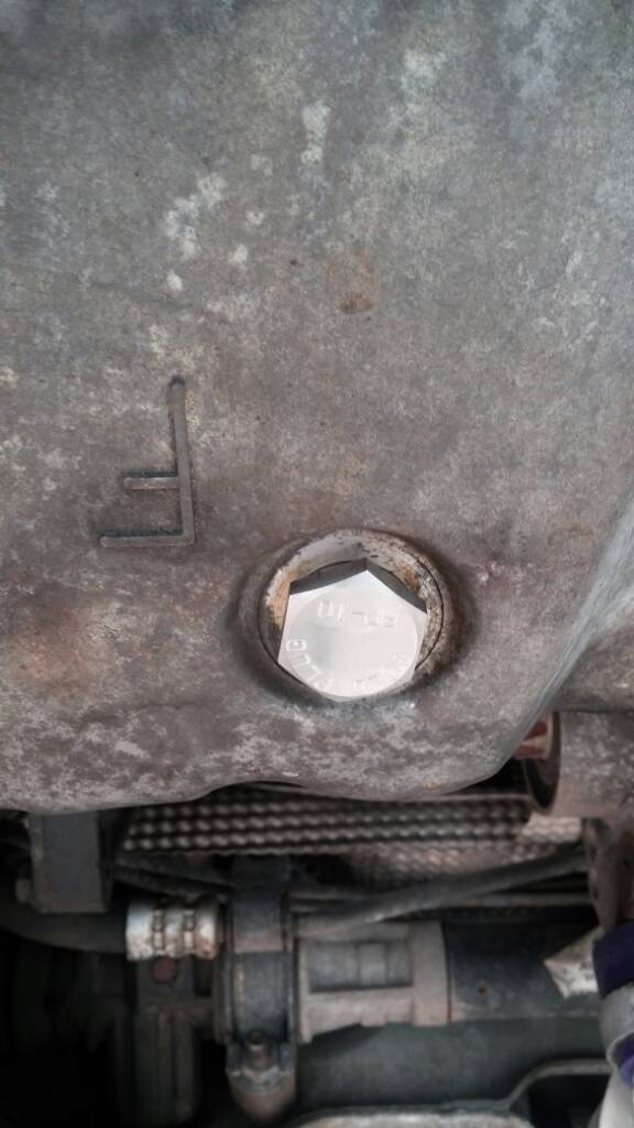

Oil filter was a b*****d to remove as it was beyond tight! New gold magnetic sump plug fitted, along with New genuine washer and filter

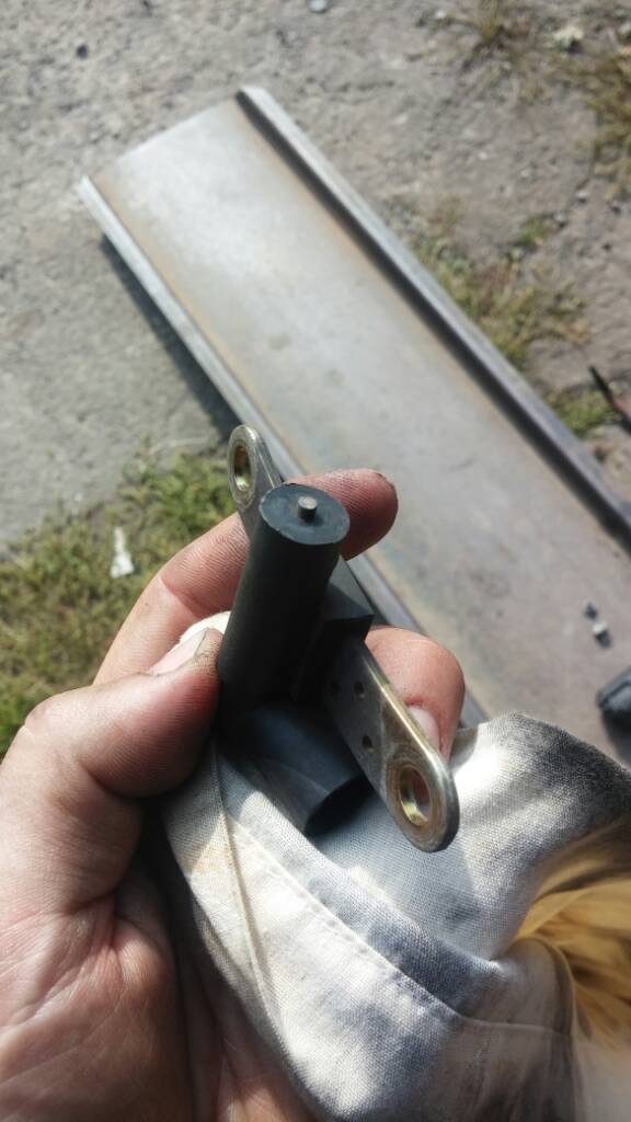

Cleaned the crank sensor too for peace of mind.

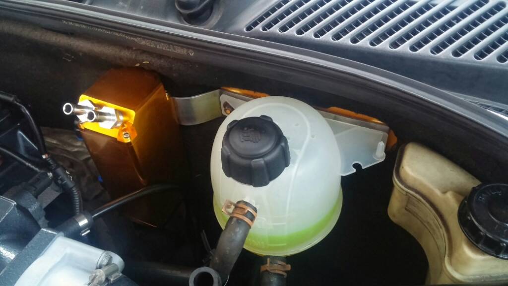

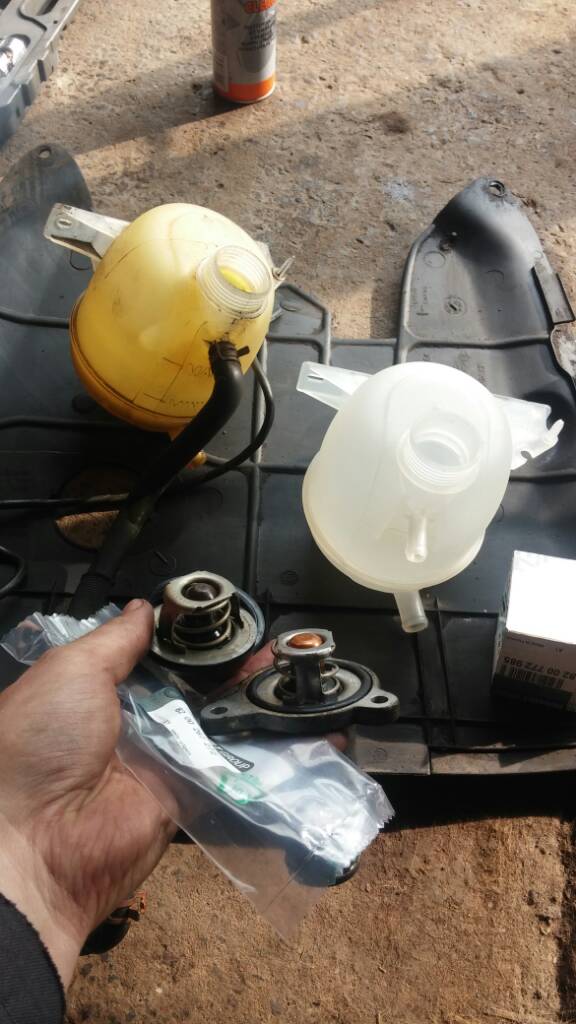

Next up was the coolant. This also proved to be stubborn!
Bottom rad hose removed, cap taken off and opened the bleed screw and it still would only release 2 liters of old coolant.
Pulled hoses off thermostat too and still wouldn't go.
Was only when the thermostat was removed it dropped the load of it!
A new coolant bottle, thermostat and new seal was fitted. Changed stat as a precaution.
Was a b*****d getting all the air out the system afterwards. Took a long time but got there in the end!
Thanks again to Hodgins, as he did almost all the work.... I just cleaned everything as it was getting removed. Lol

This car is stunning and a real credit to you
Thanks very much. [emoji4]
Its a nice example. Its let down by the standard 182 alloys, their slightly scruffy.
Tbf I much prefer it on the f1s, but they have track tyres fitted. No good in this weather now.
I may sell the 182 wheels and buy another set of f1s with road tyres instead of paying to refurb the 182 ones.

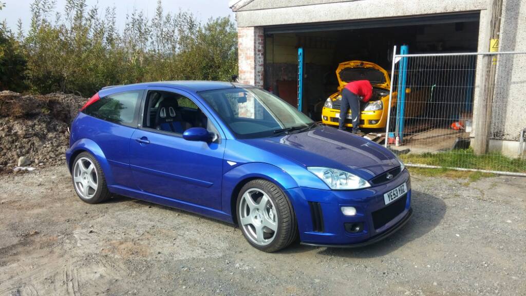

  Focus RS + S3
@LiquidYellDan Didnt realise you were taking pics lol, snapped me in action too!
Job well done in the end, have to go out properly in the focus soon.
Im always messing around with clios on the weekends but its been a while since a LY has been on the ramp, nawwww memories lol

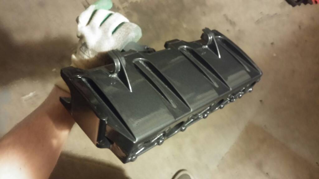

Paint strippers doing it's thing on the fuel guard as we speak. [emoji4] Will start spraying it up tomorrow night.

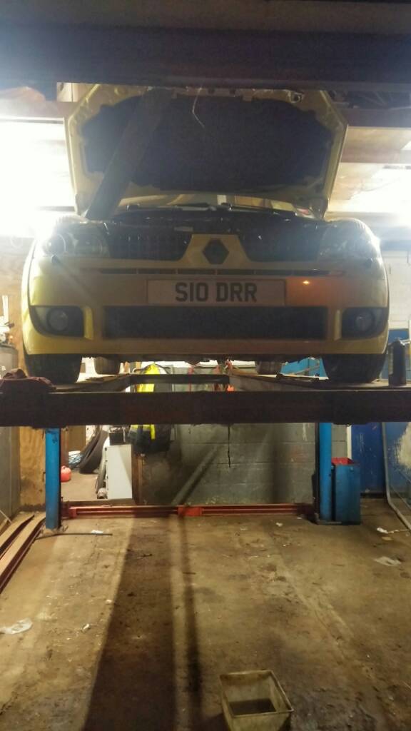

Thanks to @Hodgins again for giving up some of his time again to change the gear oil again. Put some quality Fuchs oil in it.
The halfords crap was in there for about 5 miles. Ha ha.
Was the cleanest gear oil drop I've ever seen! [emoji4]

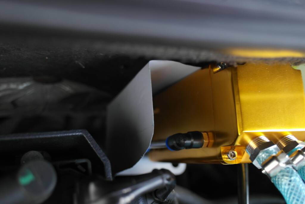

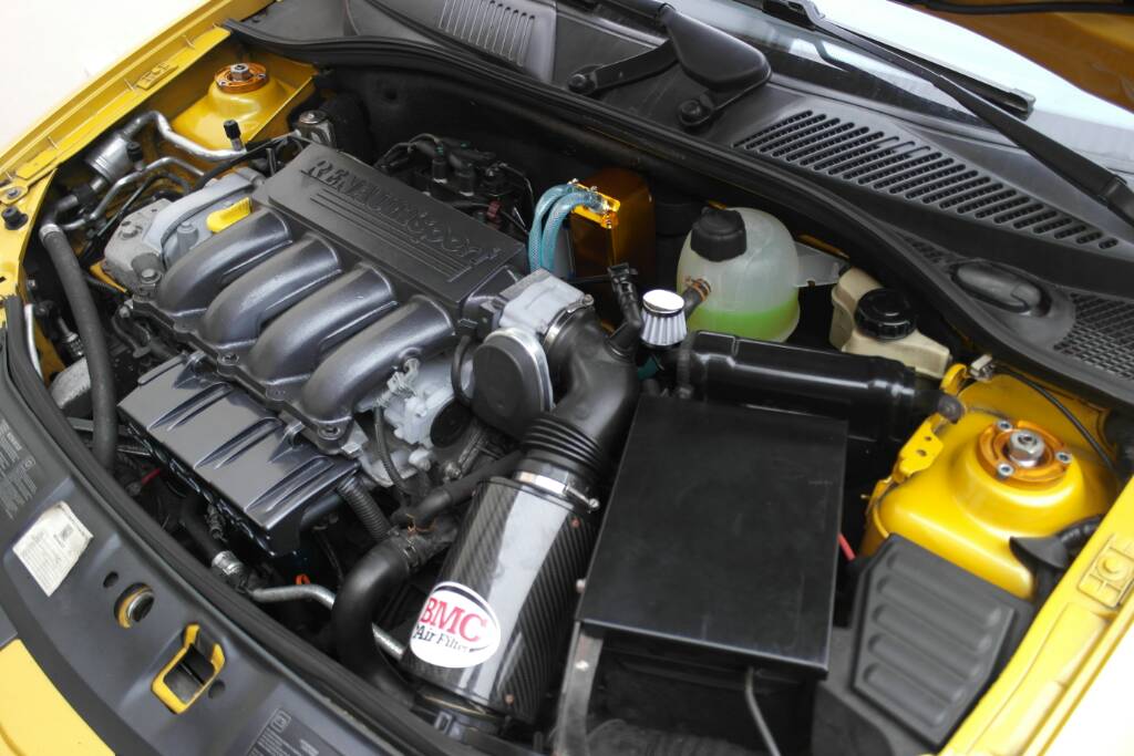

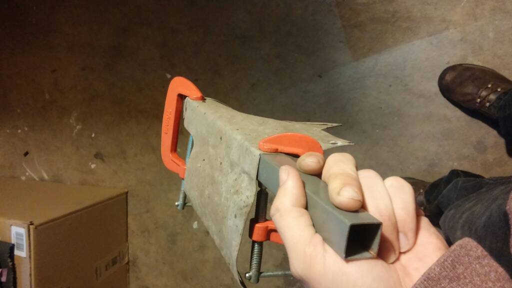

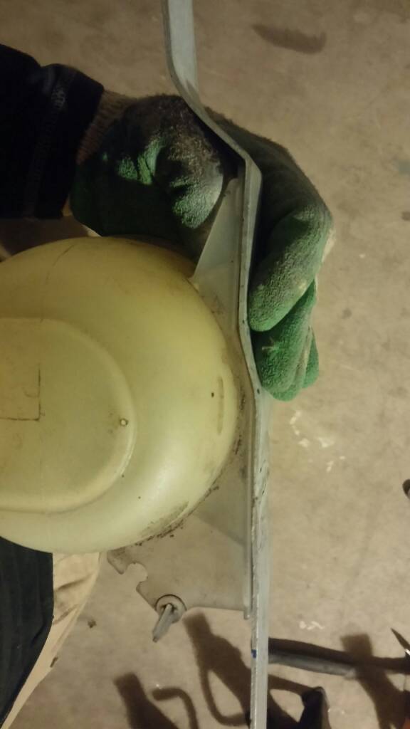

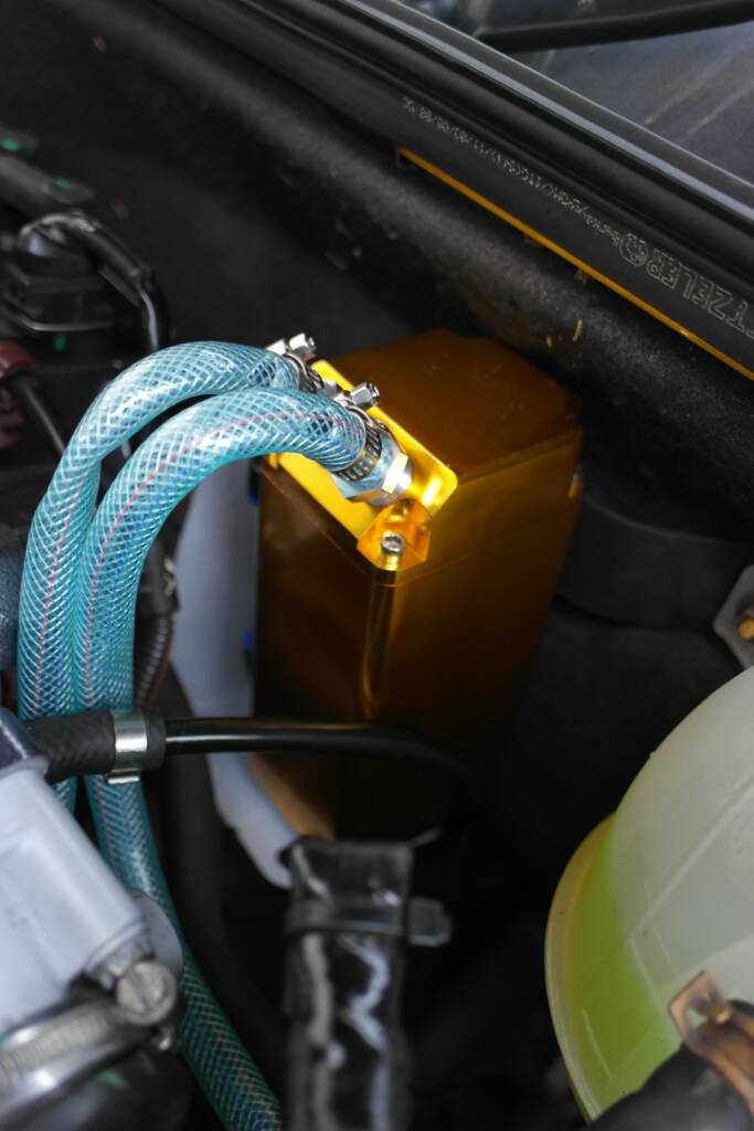

So I set about fitting a catch can I bought for the car. I had a temporary job fitted for a few k miles and it's caught nothing. Thought I'd get one anyway, for aesthetics mainly.
Had to come up with a solution for fitting it though. So had an idea for making a bracket.
Had a random steel bracket and 're shaped and cut it to suit behind the coolant tank.
Turned out to be galvanized so a quick Google told me how to remove it. Used a tool box [emoji4]
Trial fit
Primed and sprayed bracket satin black.
Had to make a custom bracket to fit the tank to the metal bracket too.

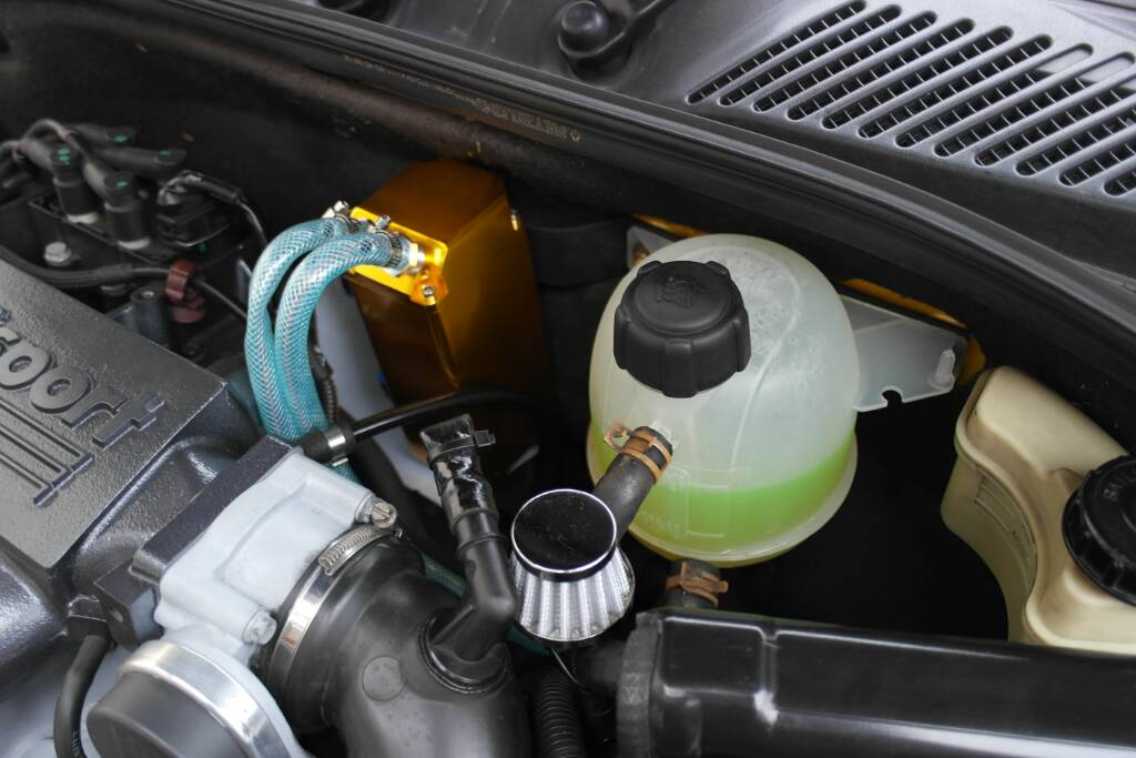

Decided it'd be best to fit a heat shield being so close to the manifold.
Few folds and cuts and soon had a heat shield shaped to suit. Sprayed high temp silver (which I don't like. Will do it darker in future)
Now need silicone hose instead of the awful transparent s**t supplied with the tank. Also need a permanent home for breather filter.
Quite a lot of work for something so pointless. Lol

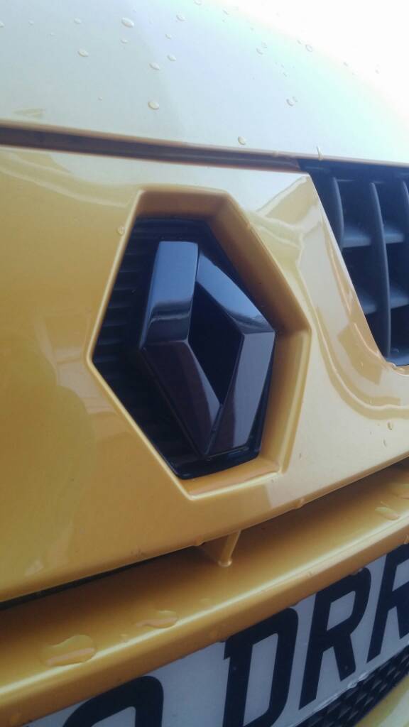

Cleaned number plate lens.
're sprayed my fuel guard.
