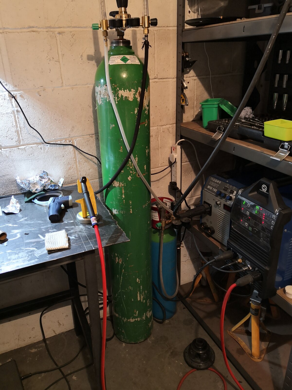

That's my tig on the left and the mig on the right. It absolutely dwarfs it 😂

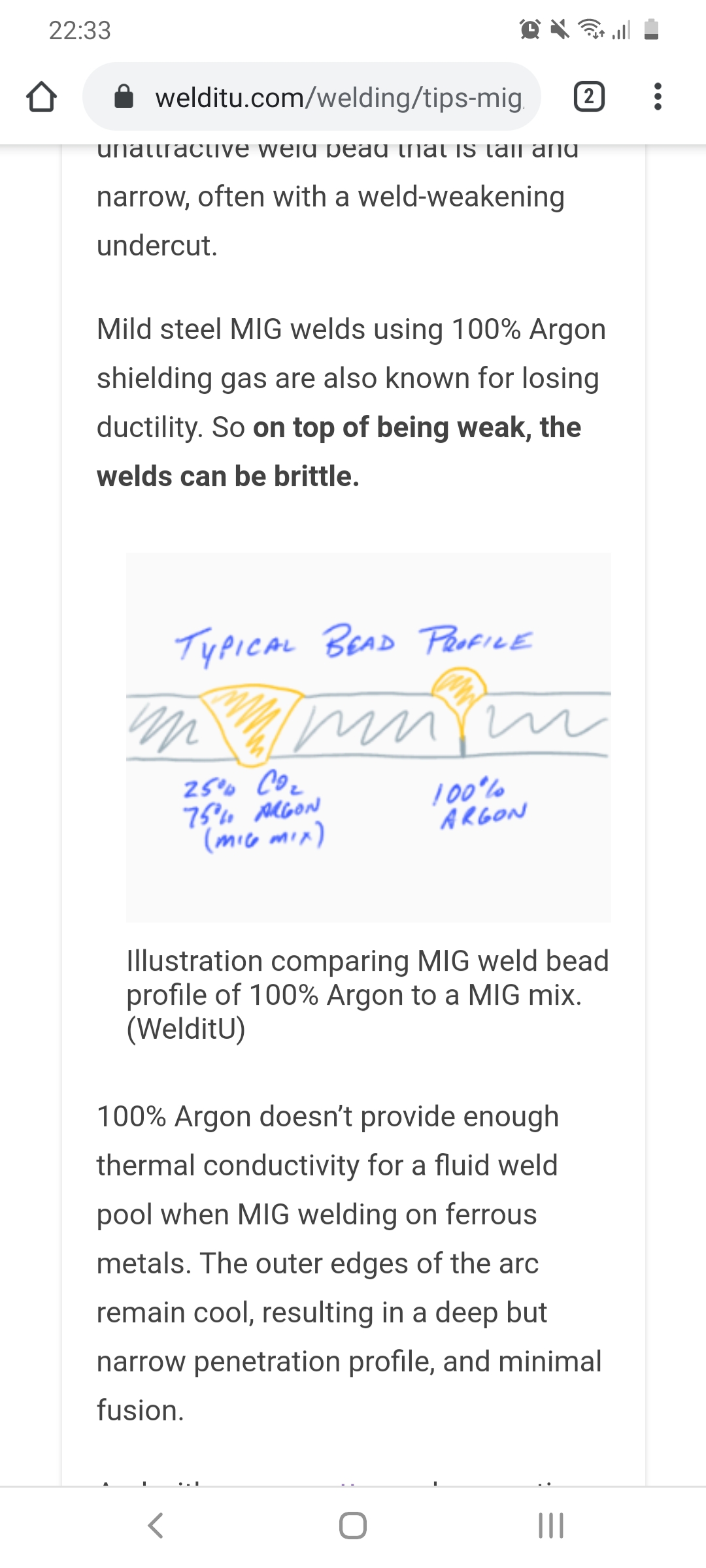

Tried with allllll the settings changed using pure argon and it would simply sit on top of the metal. Everything I read online too suggested that pure argon with a mig welder would do exactly that.
Pretty much exactly what's described here

I’m agreeing with you mate! Argon is an inert gas, and for the MAG process you need an active gas which is a mix of mainly argon and CO2. There’s a load of different compositions for a million applications but we use M12 & M14 for MAG, table in this link shows all of them and what’s in each one:
https://www.svets.se/download/18.27...4171296/Classification+of+Shielding+Gases.pdf
MIG is the process used for welding aluminium, it was specifically invented for that. When it was a success and then adapted for carbon and stainless steels it is actually a MAG process, but MIG stuck as the description for welding any material with the specific process of the filler rod as the electrode being delivered from a reel (ie different to MMA, stick welding, as this doesn’t use a shielding gas).
That’s why the weld sits on top of you use argon, you need an argon/CO2/ a little bit of oxygen possibly mix for carbon/stainless which effectively generates more power and enables a weld to penetrate into the parent material, hence active.
Of course I’m assuming that you are welding carbon or stainless and not ali?! Ali MIG is not really used as a hobby process as it’s very difficult to master!
