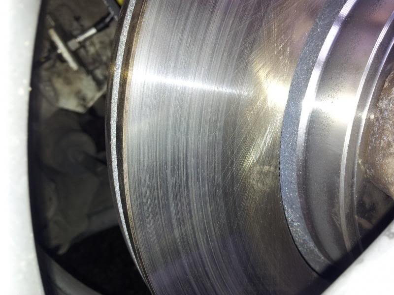

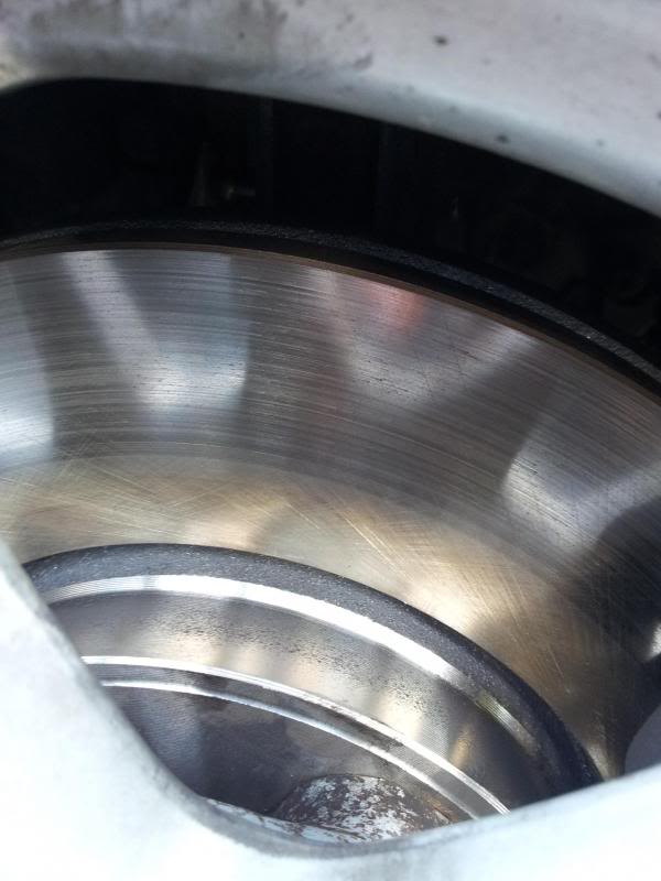

I had a performance brake package fitted to my Clio 182 this week by a reputable specialist. Consisted of New front Discs, M1155 pads, braided lines and ATE Super Blue. I've driven roughly 100 hundred miles on them, moderately braked to start with then a couple of 80-30mph to try and bed them in more. I checked them over briefly last night and noticed that the pads don't make full contact with the disc surface, is this normal with this pad??
The specialist got back to me and said he had compared a pad to a disc and this untouched area was normal, I just wanted ask other people that have been using this pad if they've noticed this?
yeah pretty normal until they bed, as long as the pins are free and the shims have been binned you'll be fine

I have the same brake setup as yours, probably from the same guy... Did a 100-200 miles normal driving and noticed the same contact area as shown in your pics. After a trackday though the contact was perfect.

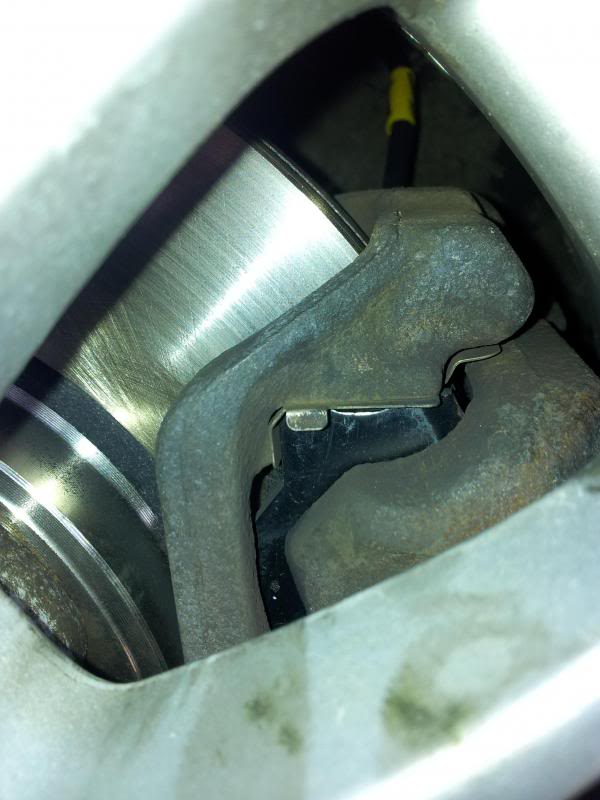

they shouldn't mae that much noise, got a pciture of the caliper?
It's on moderate/light braking 20mph or less, the area I'd expect some squeal but these seem excessively noise. I'll whip the wheel off when I'm back from work and get some better pics.
