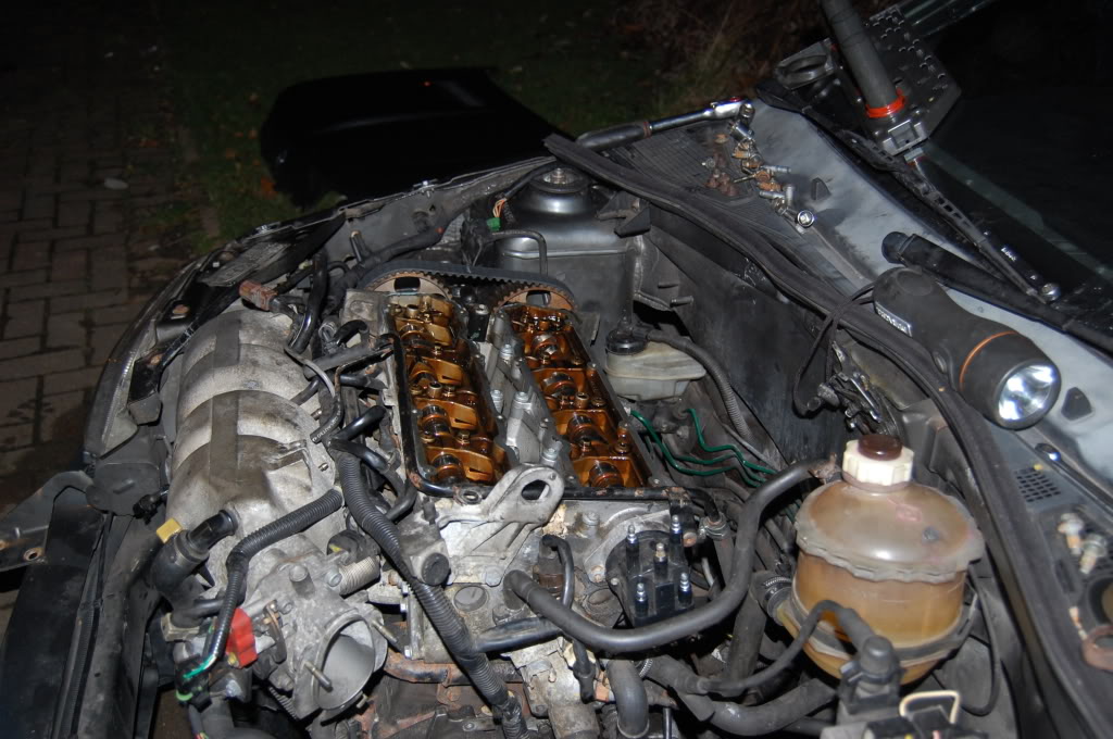

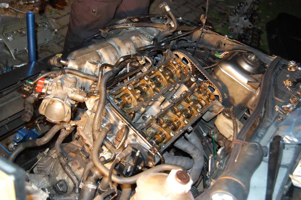

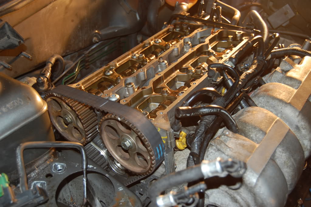

I've just looked at your photos on the previous page, and compared your valver head photo with your "timed" willy head. may be nothing but the lobe relationship between inlet and exhaust will be similar "by eye" on each cylinder and your's aren't.......
willy head, look at first cylinder, lobes are pointing away from each other
and valver head, lobes on second cylinder are much closer together
just another idea.................

better pic of williams:

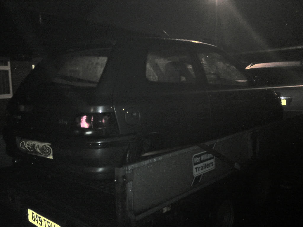

where you taking it on the trailer? or is that an old pic?
was bringing it home last night, lol
