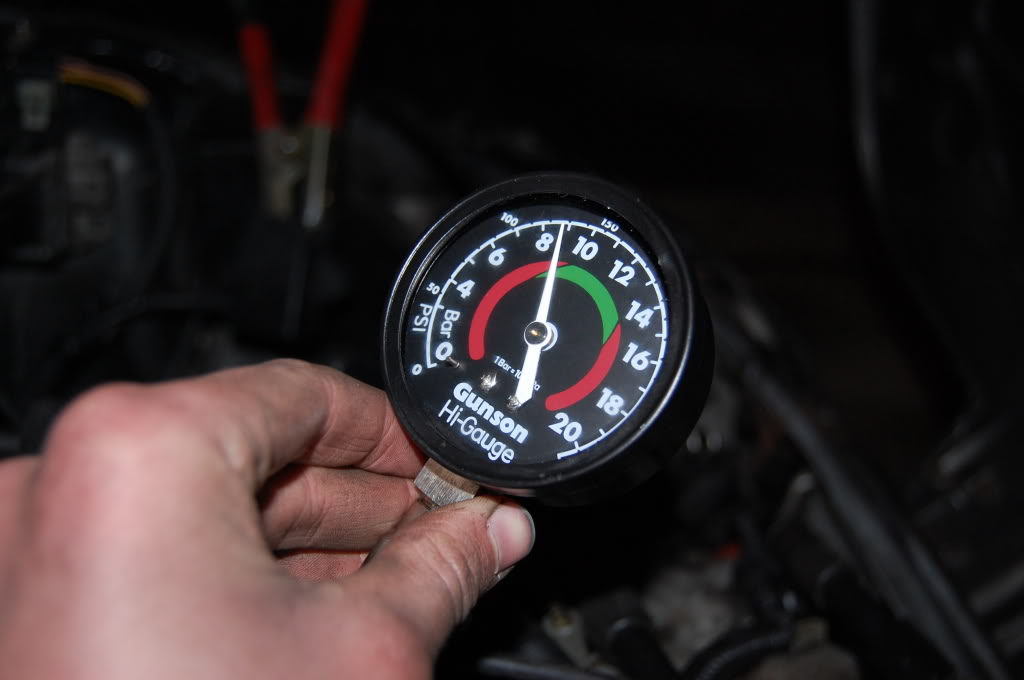

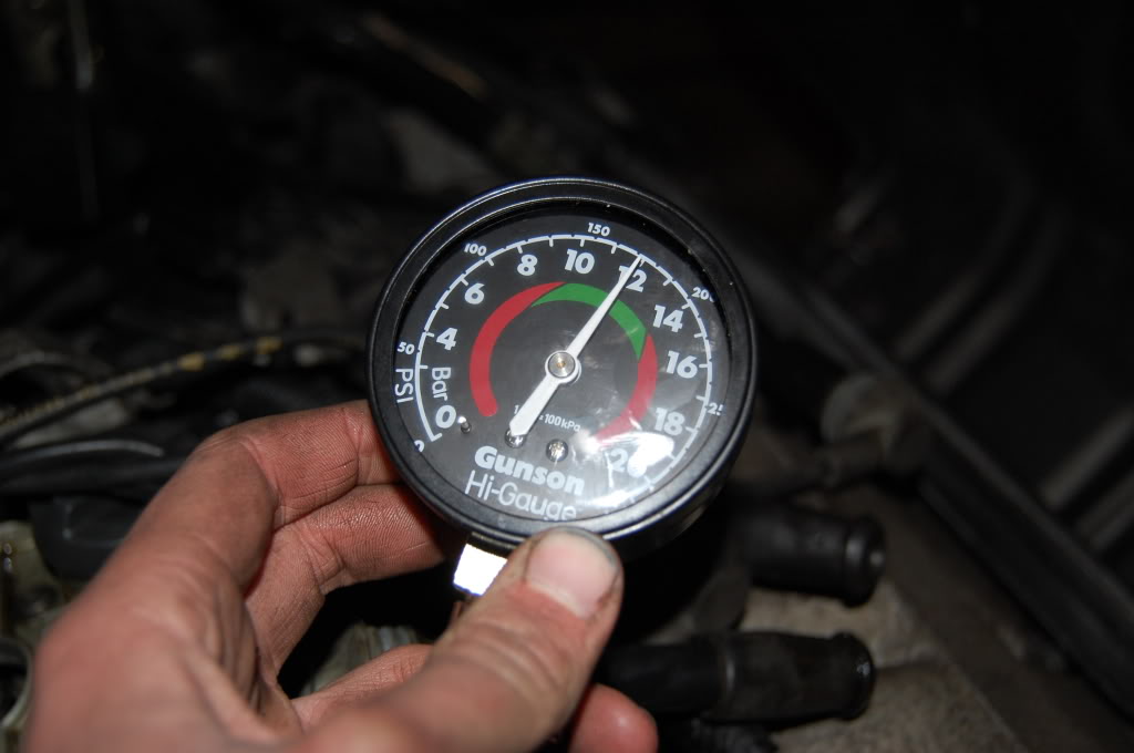

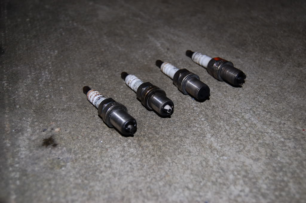

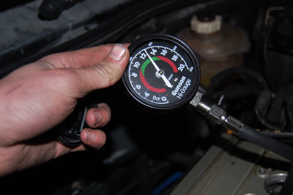

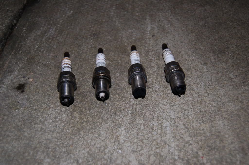

yeah mate, just about to put some pics up of compression test and spark plugs....some odd stuff going on

ok.....spark plugs are in order, left: cylinder 1, 2, 3, 4
Compression Cylinder 1
Compression Cylinder 2
Compression Cylinder 3
Then the starter motor started playing up when I got to cylinder 4, will have to try that in the morning....god knows about the spark plugs

Something's not right there :(
Still sounds out, even though you've got compression :S
