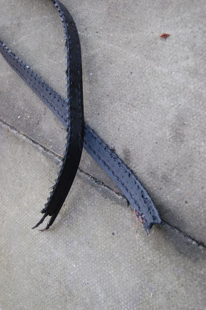

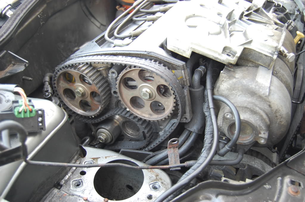

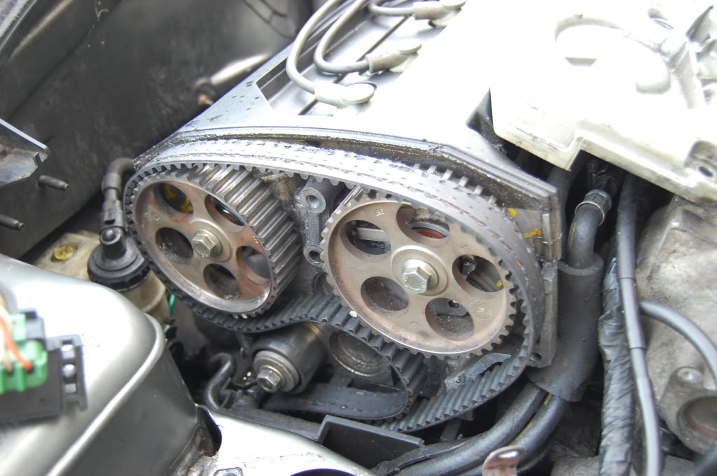

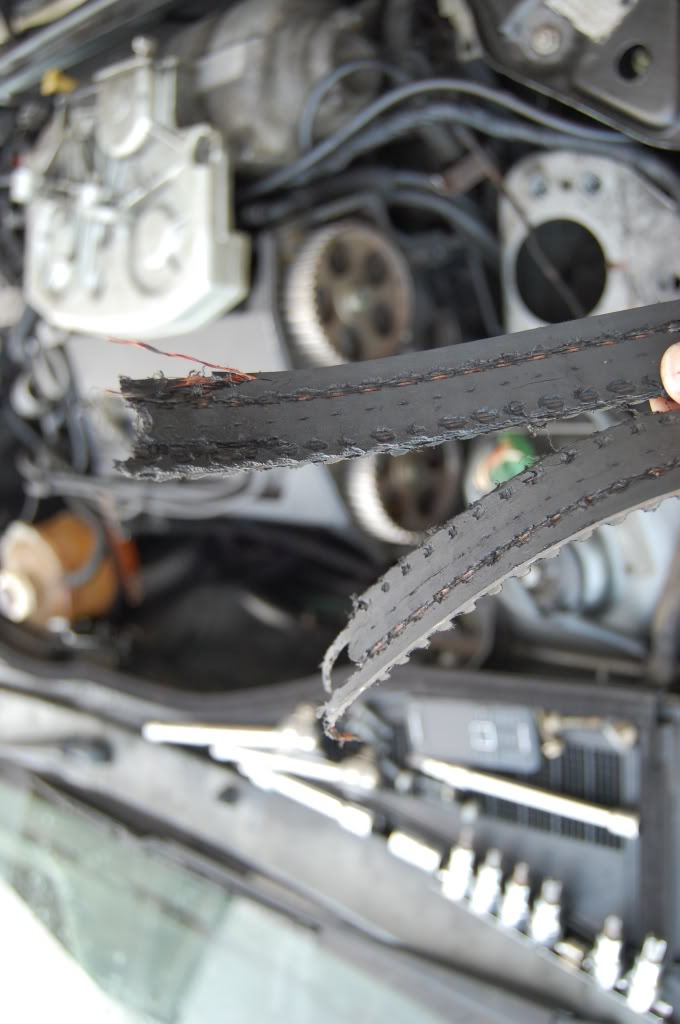

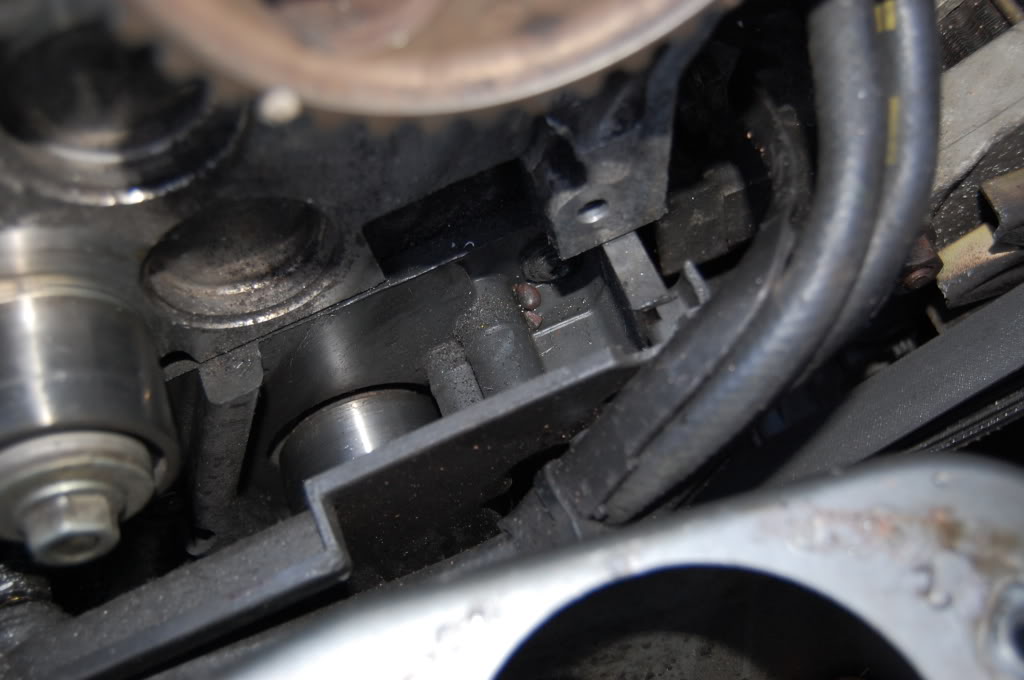

Bit of an update.....Got the cam cover off...
Nice chewed up belt....pulled it out...
Had a quick look....
Bit of gravel, im guessing there definitely must be more down the bottom for this to happen :(
