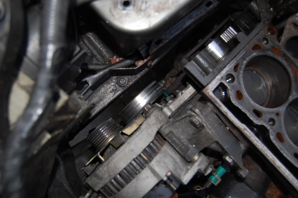

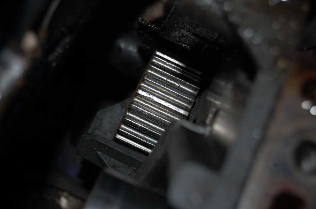

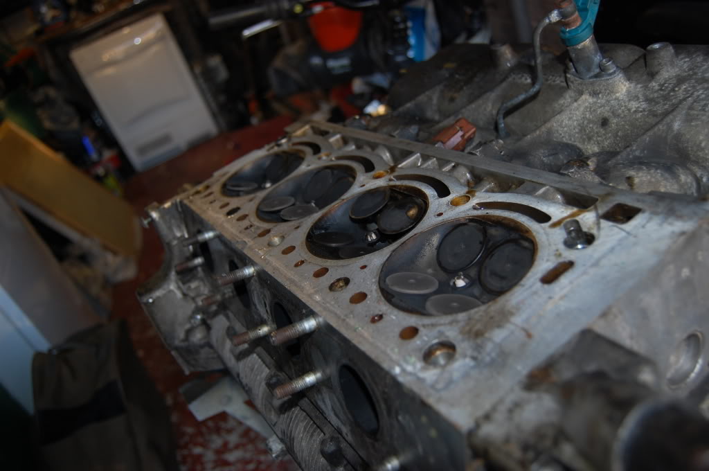

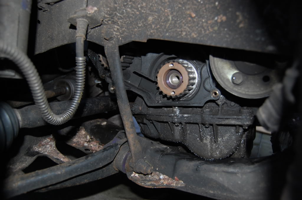

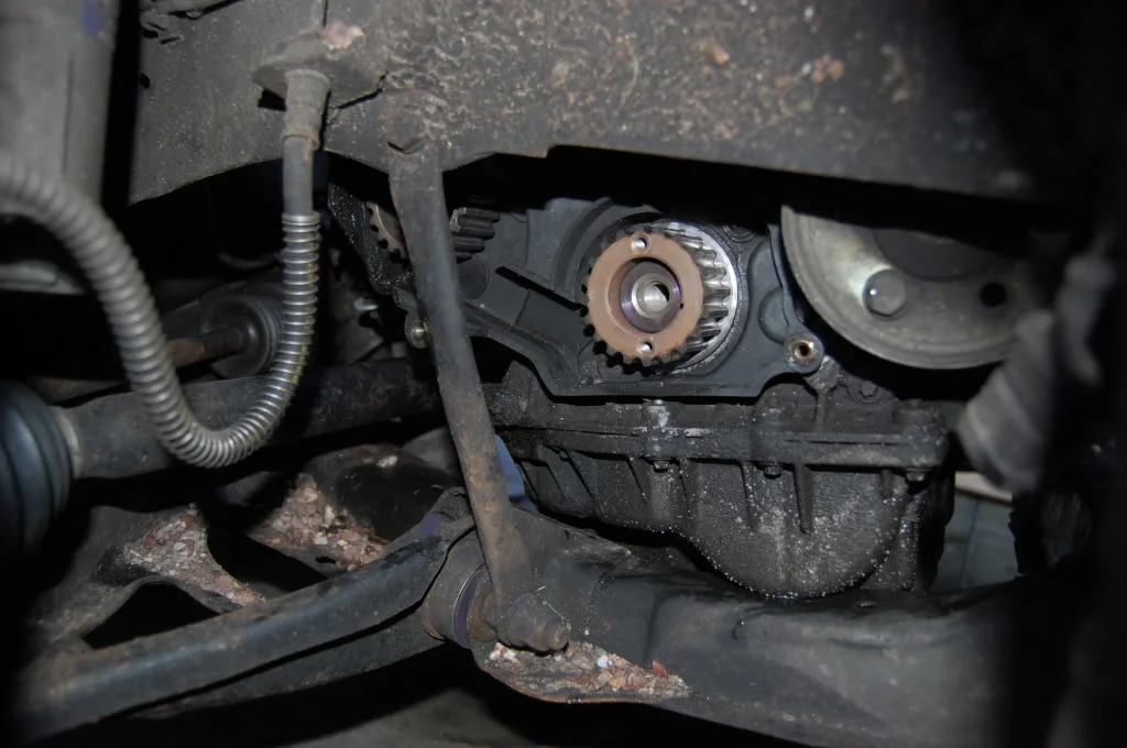

So is the general consensis (sp) that gravel caused this?
That engine has like a vodoo curse on it or something, just chuck it in the bin and look for a cheap F4R.

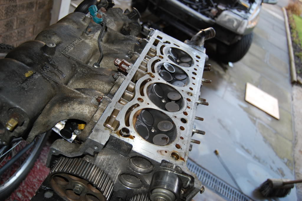

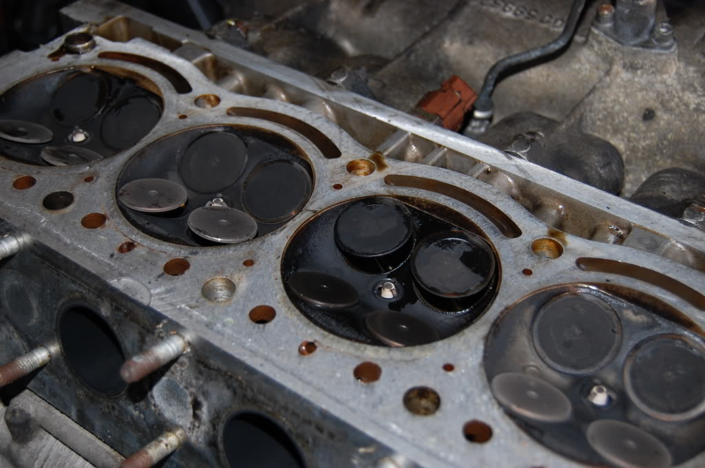

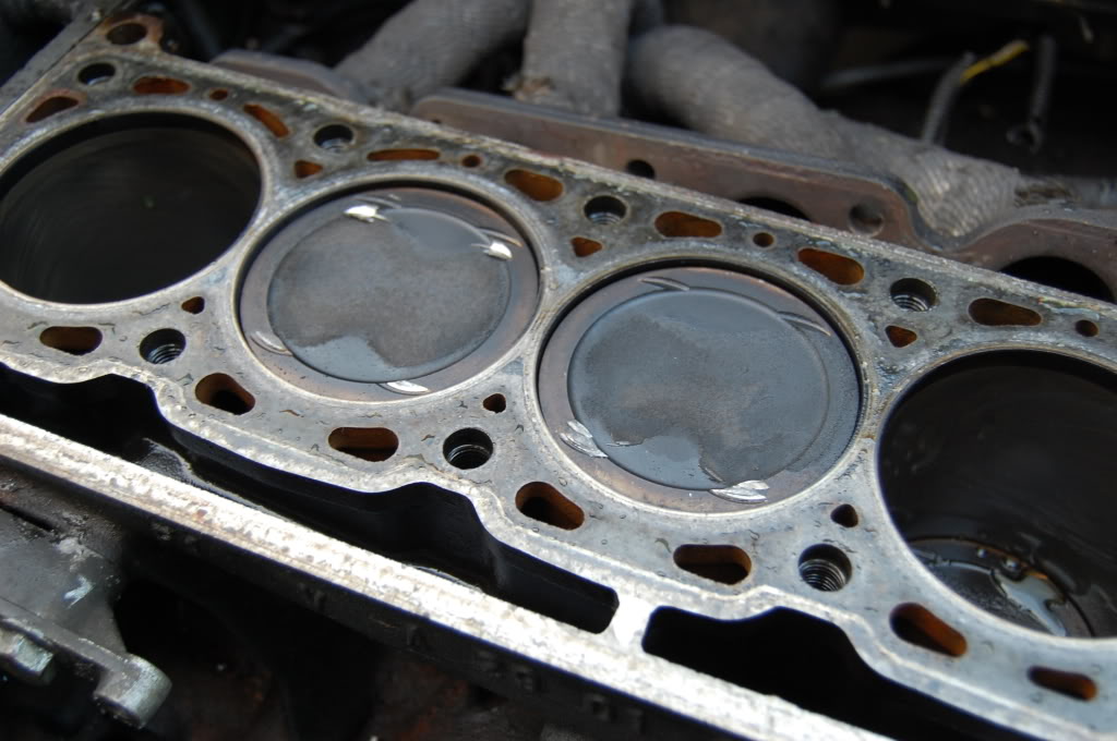

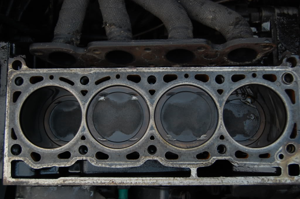

Looking at the pics those pistons look too damaged to risk using again, but im no expert.
The tensioner is chewed like that because its picked up stones in the belt, ran the stones round and chucked the belt off, which has snapped it. Leak test cylinder 1+4, if none of the valves are bent, order 4 inlet valves, use the old exhaust valves. Grind them in and get a new belt and headgasket. Back together in a day!
Pistons will be reet. Just make sure theres no edges that can come off. Wet and dry FTW.

they are 32mm IIRC, megane are 33mm (which i have 8 of)
not sure if the stem length is the same though?
