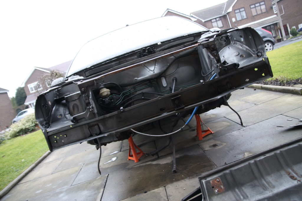

Current state of the car...

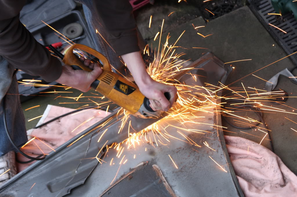

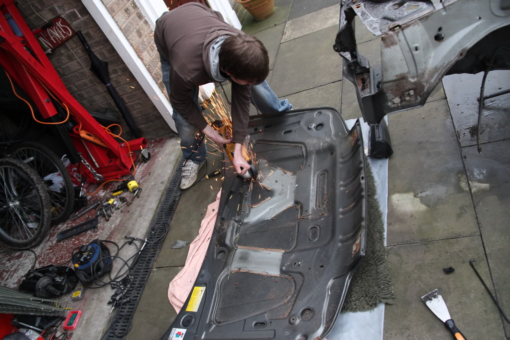

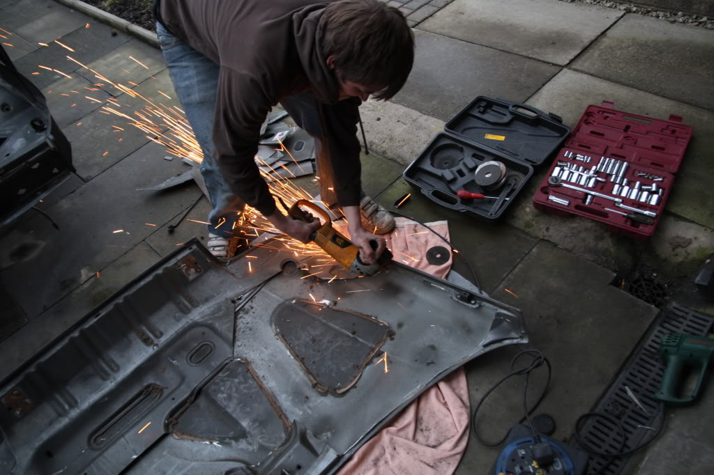

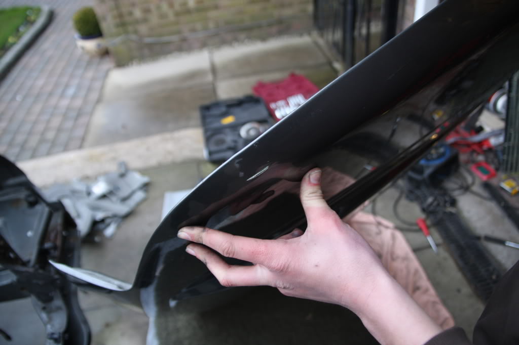

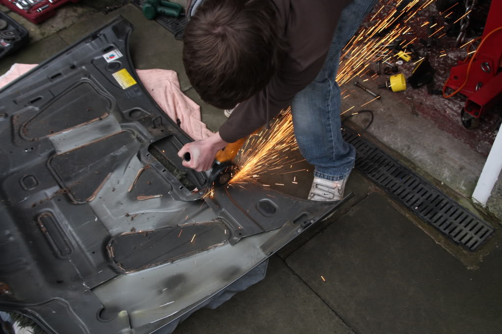

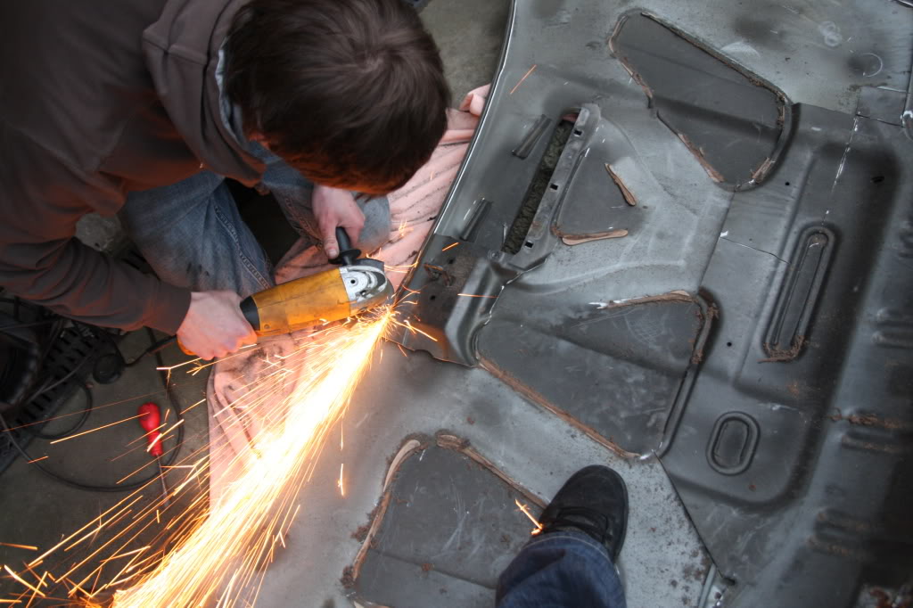

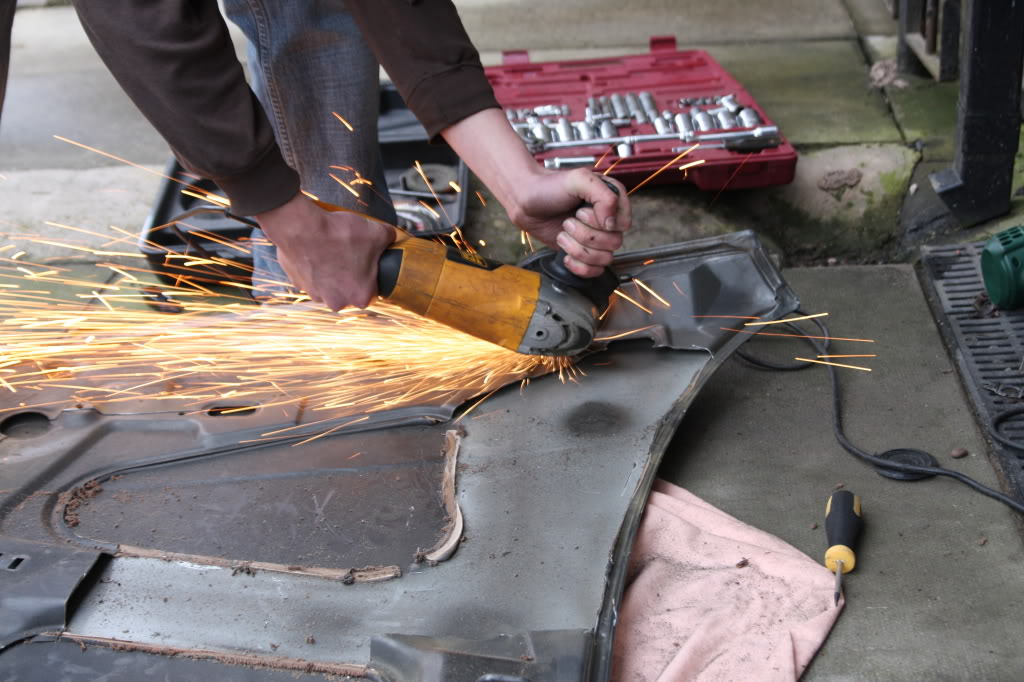

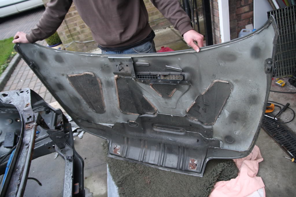

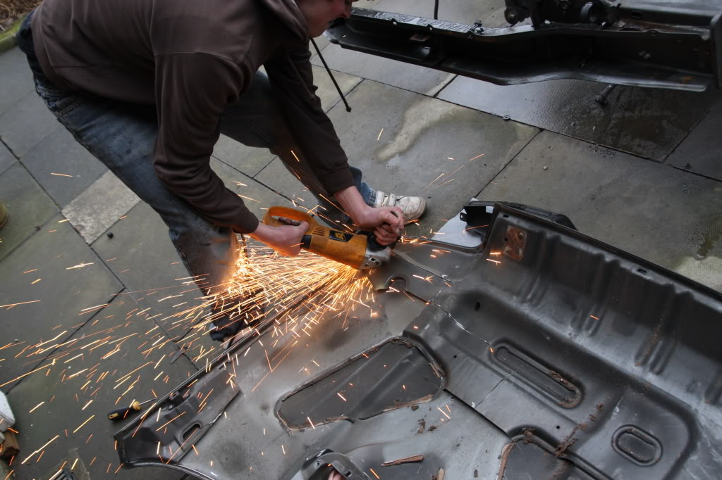

Decided to have a play with the angle grinder on the bonnet today, wanted to completely remove the second skin, just keeping the top layer. For one to save some weight, and two make it easier to fit the aerocatch pins Im going to use...

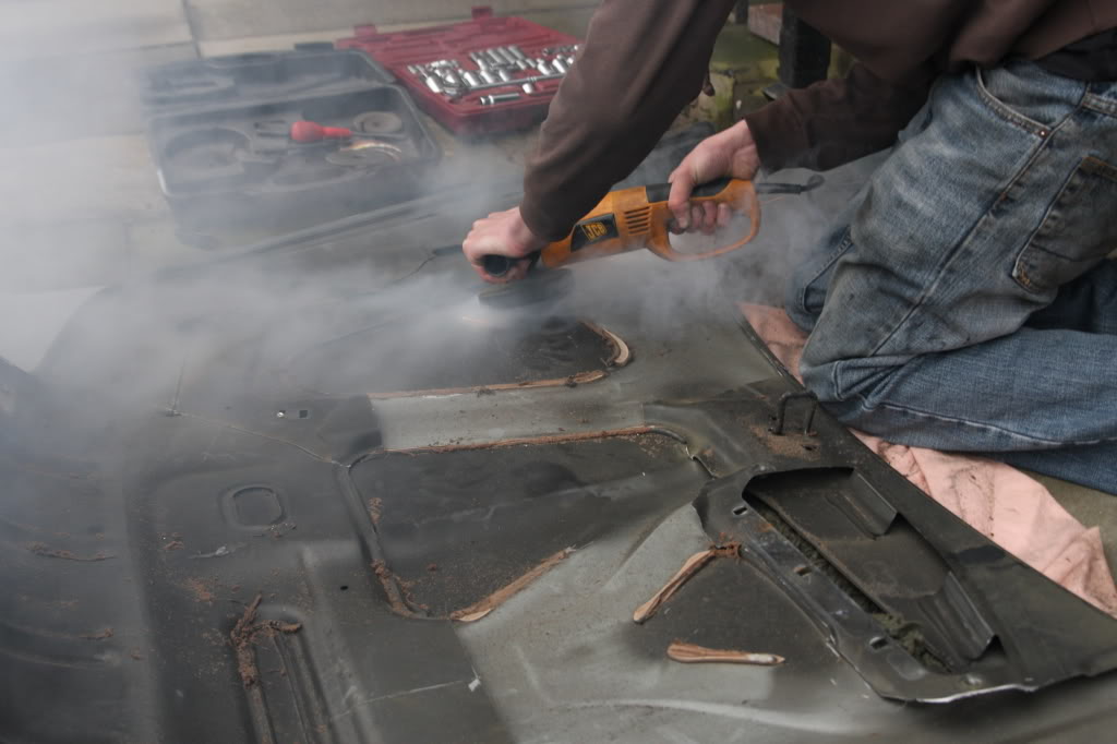

Glue on fire, lol...

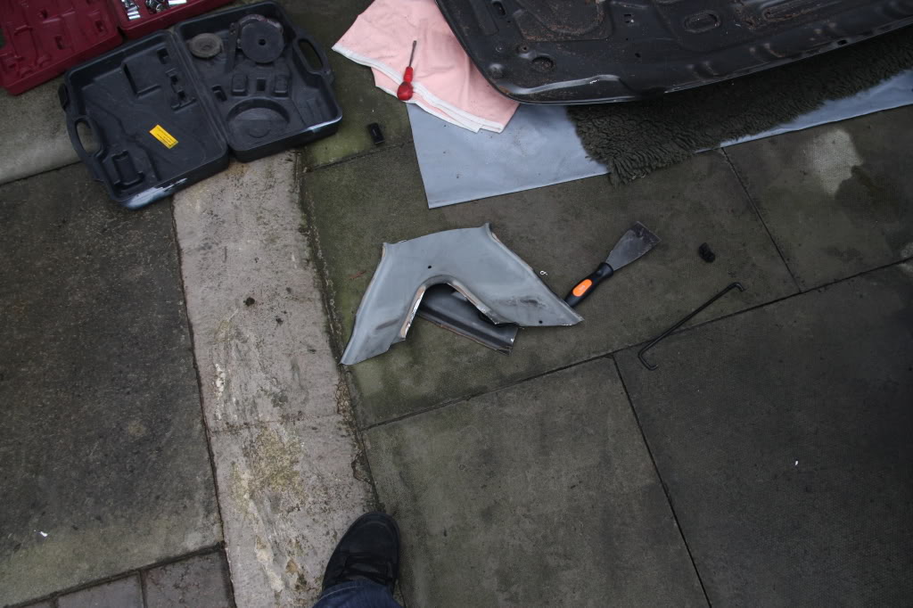

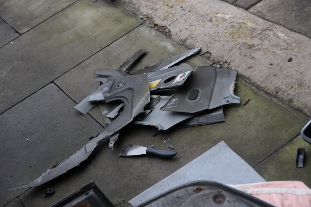

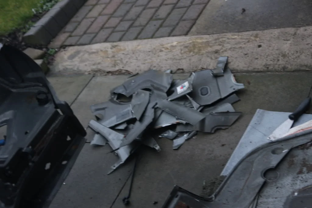

Growing pile...
Went a bit too far on the last cut...doh :(
And this is how far I got today...got the bottom bit to do another day, then cut the holes for aerocatch pins, and tidy it all up...

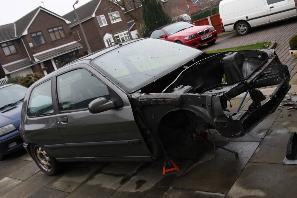

FAIL. Ahh well could have been worse. Car is looking a bit sorry for itself but it won't be soon hopefully :evil:

Get some glasses on you plonker! My oldboy lost in sight in one eye because of grinding!!!!

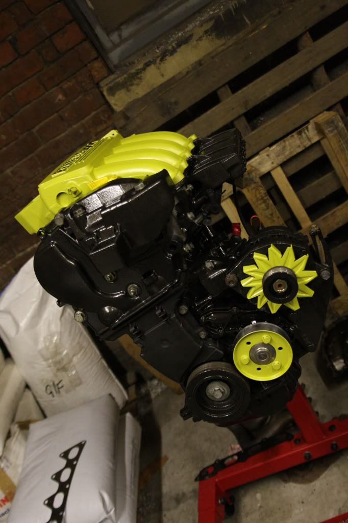

Day 161

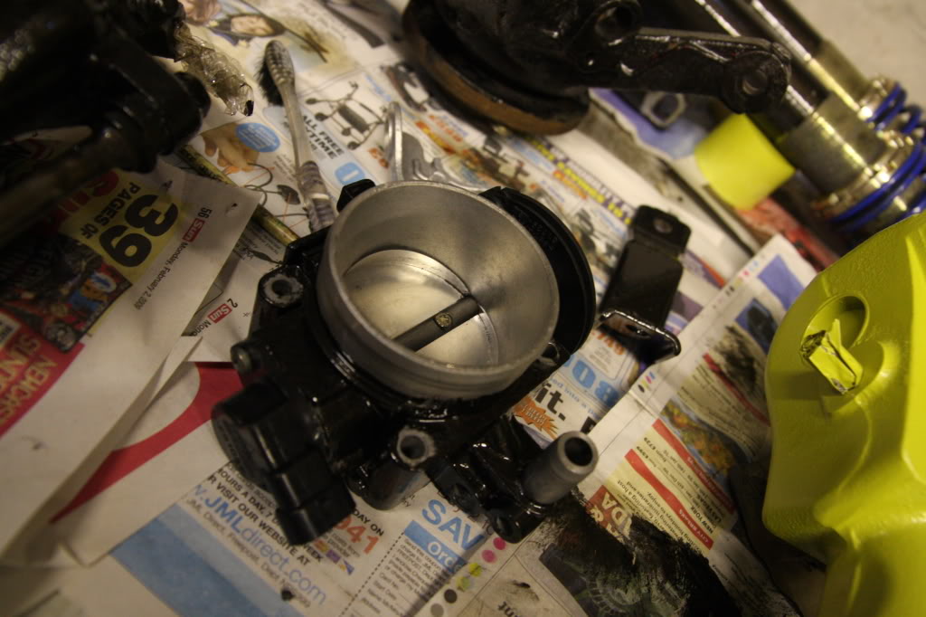

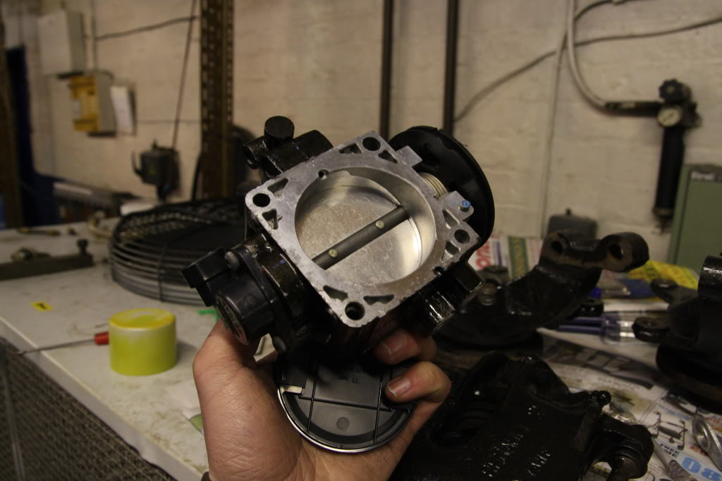

Cleaned up the throttle body earlier, as I pained it earlier in the week so it didnt look stupid on the fresh inlet manifold...

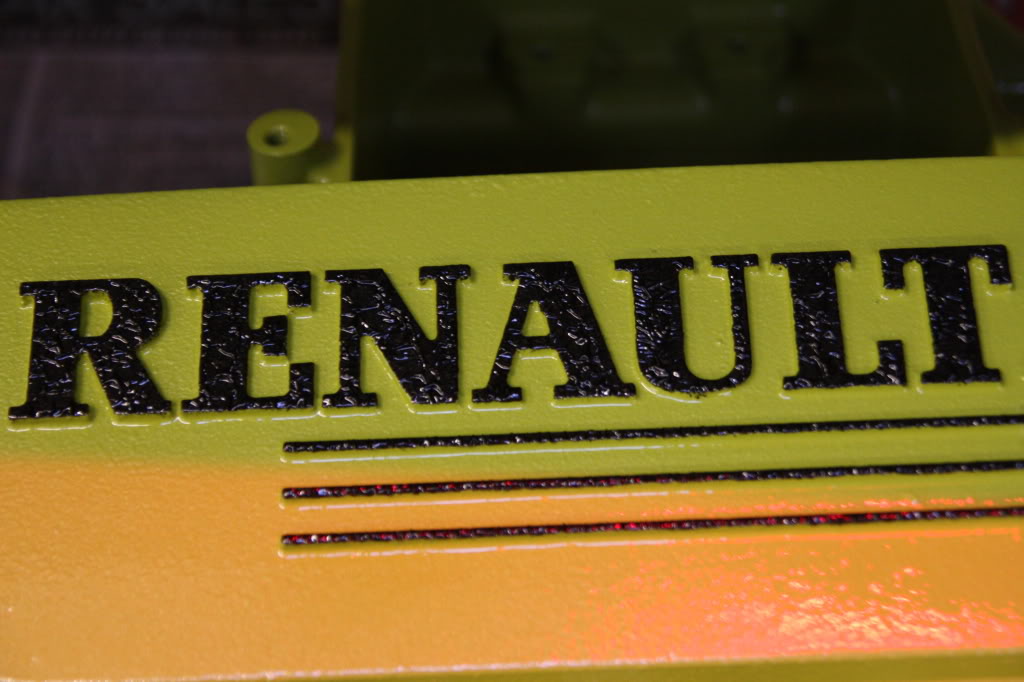

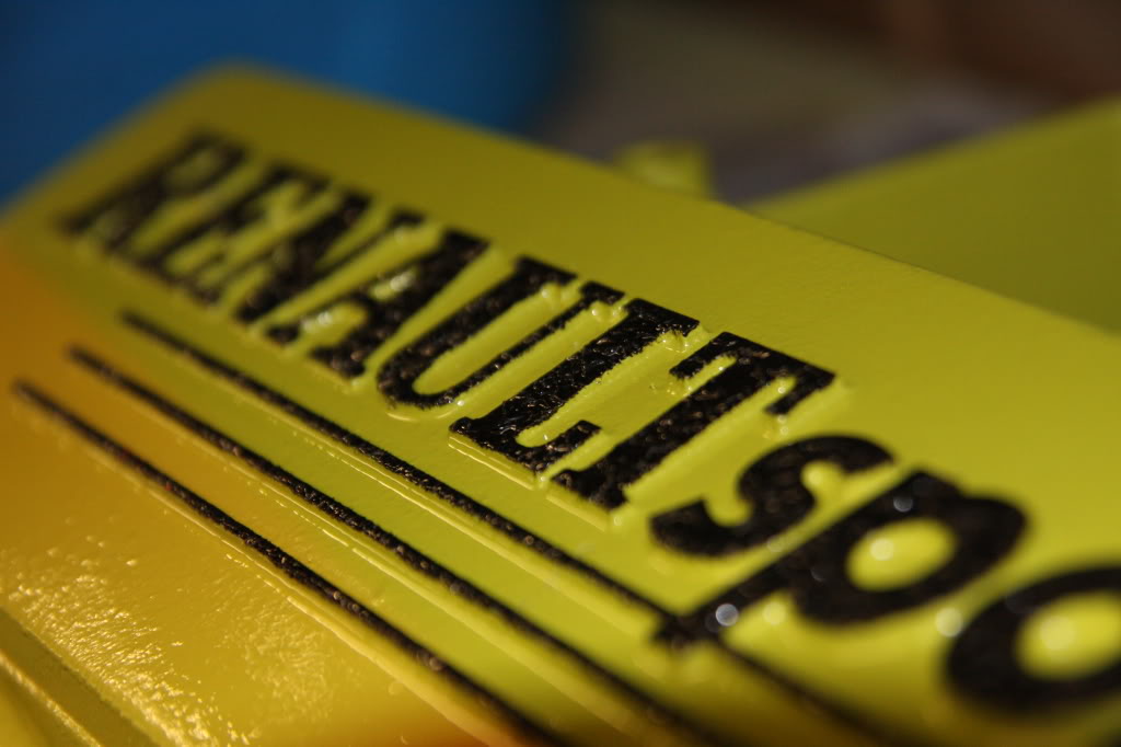

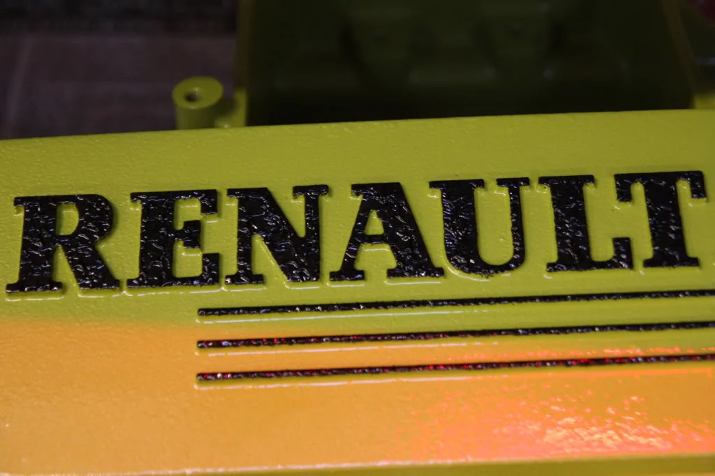

Then started to clear coat the inlet manifold, but the paint on the lettering reacted with the clear coat :(
It looks kind of ok, but im not sure if im going to re-do it yet...will have to see...

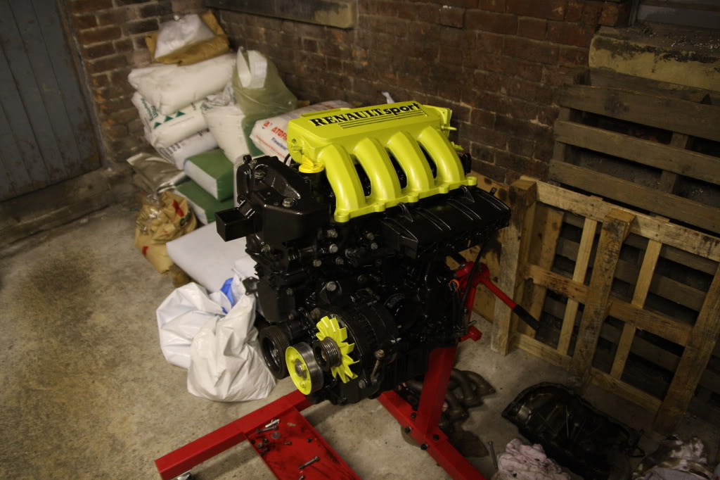

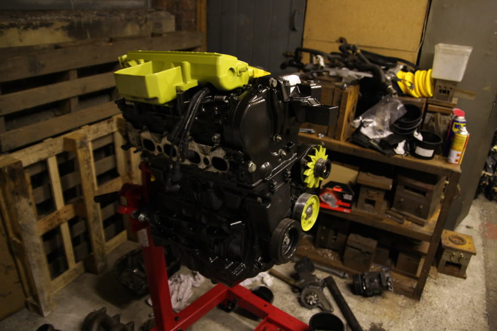

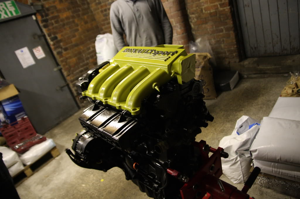

Fitted the other bits to the engine ;) May aswell make use of the paint if I paid for it lol!
Im also going to pick an Aux belt up from Winston shortly ;)
More soon...

The engine is looking ace mate, now get it in the car and all running. I can't wait for this to be done! Do you want me to come the factory sometime this week and give you that loom wrap because I want it out of my room lol.

Looks nice, crackle black on the lettering, what kind of paint on the plenum. Looking for ideas for my new ph1;)
Re: Mk1 Hybrid Project
The lot is Hammerite 'Hammered' Black...yellow is Acid Yellow renault color, just mixed paint....crackle happened when the hammerite got laquered :S
the engine looks great, that the paint u had left over from last year
acid yellow?
Acid yellow yeah, bought some more!
  Track valver + Ibiza FR
Hammerite is really funny stuff, you can't paint over it for a few weeks after you applied it because it doesn't stick. You can after a few mins but anything after it's started to dry it just f**ks up. That might have something to do with why it has reacted. I thought you were going to use normal black paint lol.

Good updates jord. The engine looks amazing, almost too good to put into the car and get dirty again.
