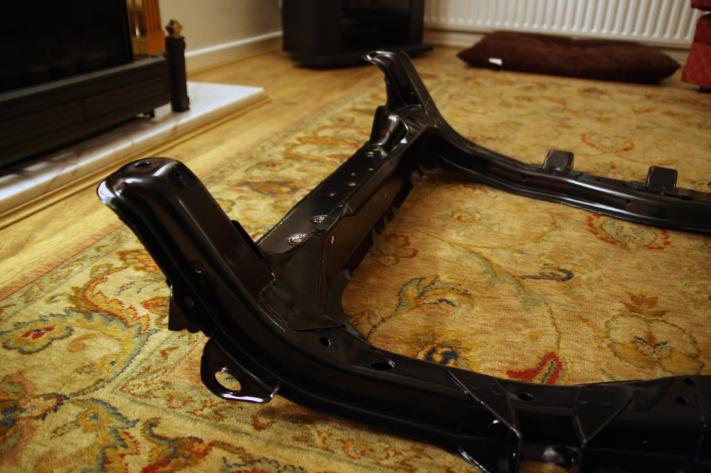

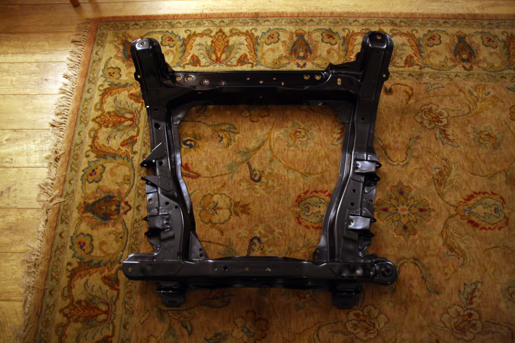

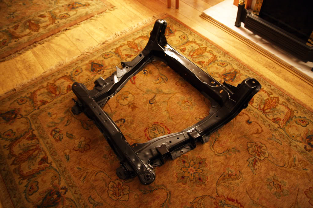

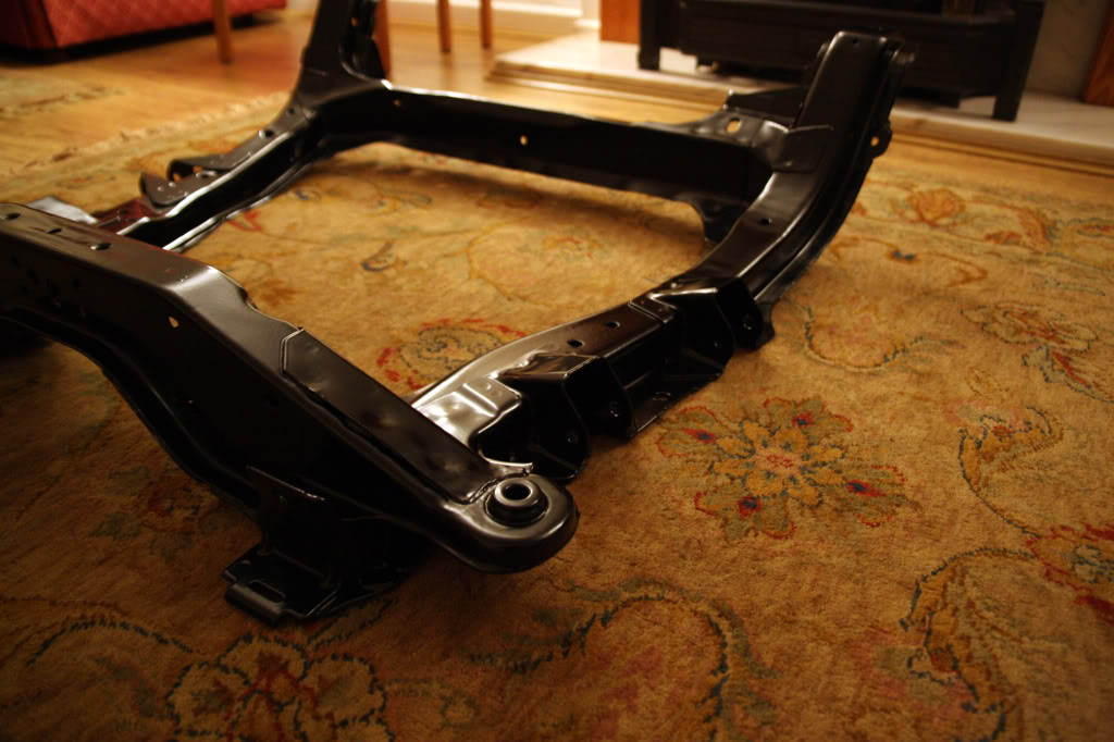

Any more pics of that subframe Jord?

lol! where abouts? as long as its straight I dont think it would matter too much to be honest...

Yeah i've led it down and its all straight and true. Its just annoying though. I'll bash it straight before I paint it.
Thanks a lot mate. Thats ANOTHER beer I owe you.

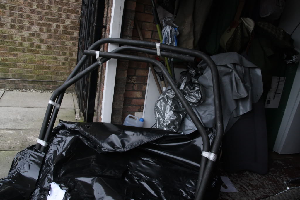

Looks like Itl' be fun to fit!

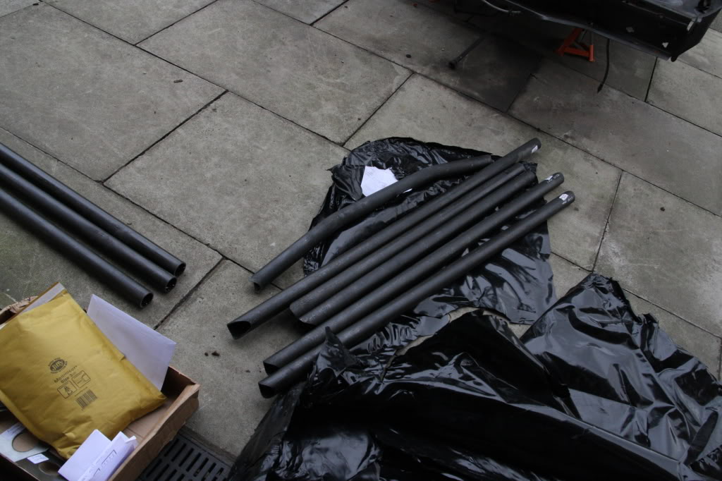

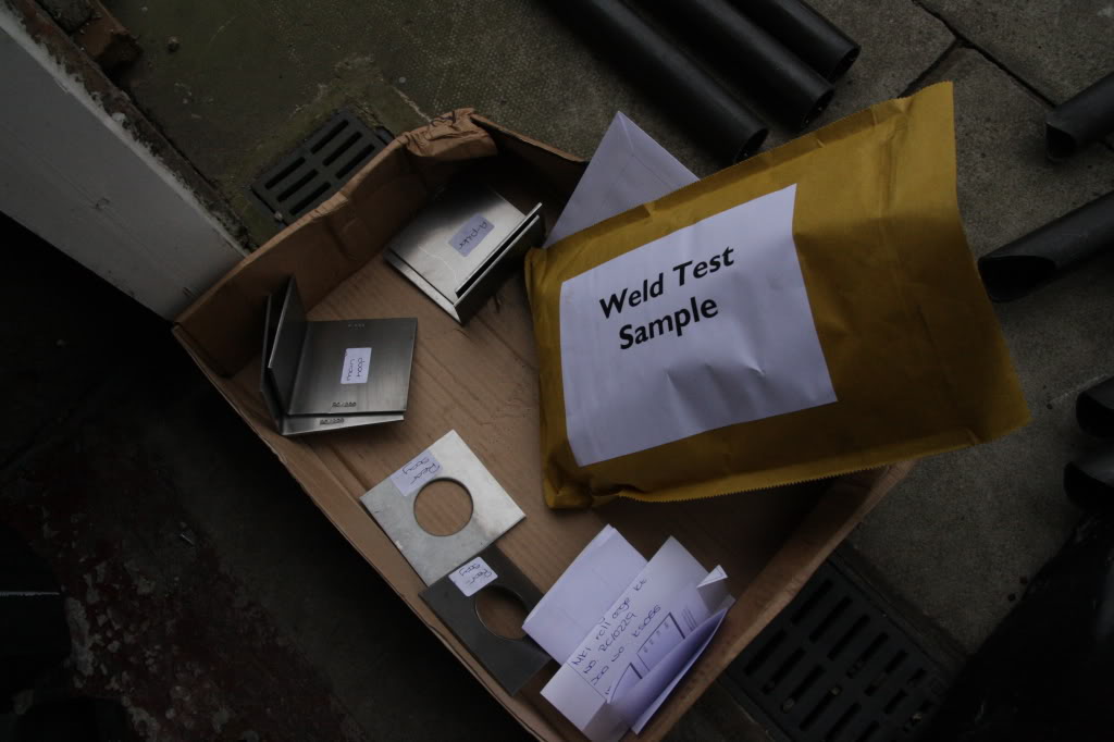

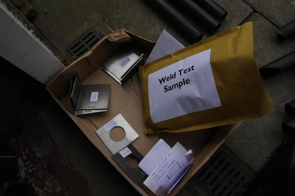

Turnaround was 10 days ish from ordering, impressed with the service of Custom Cages to be honest, even include a CD with instructions for people dont know how it goes together :rasp:
More later...

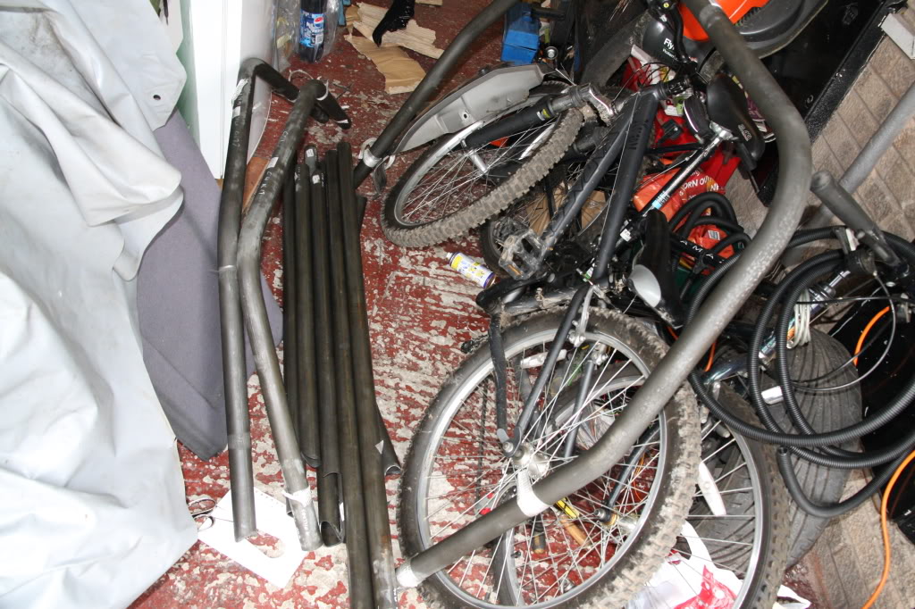

not to bad then that with all the fittings? think mine is 35kg not sure tho them tubes look skinnyer than mine.

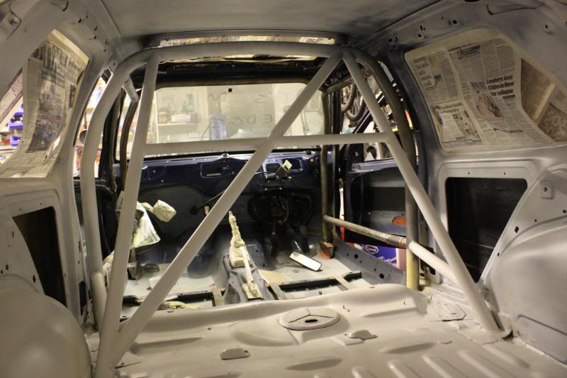

not sure yet, ideally going to get the holes in the bulkhead patched up this weekend, so I can paint the bay, and rebuild the front end and put engine in next week........once the holes are patched up the cage can be sorted....just gotta decide weather im going to paint it before it goes in, or not...

I tell you now that's going to be a right ball ache to get square and welded in!! Is the main hoop tube the same diameter as the rest or a bit thicker?
Going from how mines turned out, it'd be a very good idea to paint it before its in. Paint it, mask as much as poss off and then touch up whatever's required after welding.
And....be armed with a wet towel or something for the underseal, it's a little flammable! ha.
Then, after much heartache, it might look a little like mine! :D
Re: Mk1 Hybrid Project
The main hoop is the same diamater as the rest, but it looks like a slightly thicker wall...
Im sure il have fun figuring out how it all goes together, lol

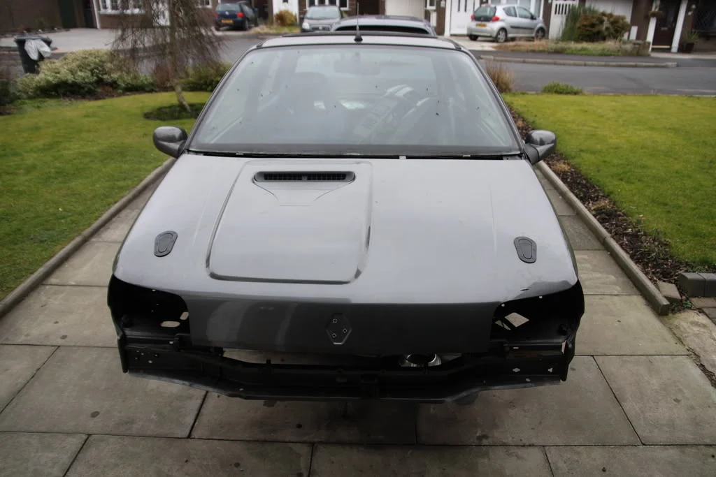

Day 165 - Continued...

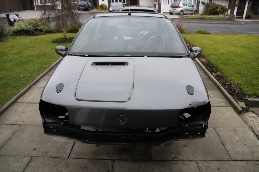

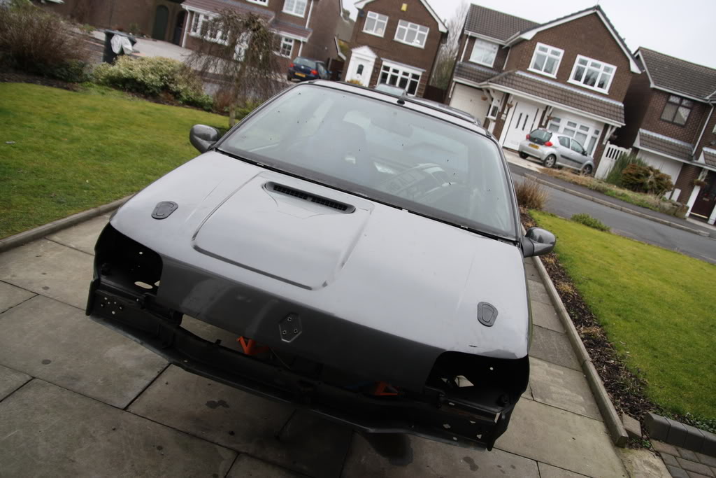

Fitted the pins for the bonnet to the bodywork before, dropped the bonnet on and to my suprise they lined up, and it fitted fine :)
Shock horror, something acctually went right first time!
car looks like its floating !
Least somethings gonig right this time round mate ! looking forward to seeing it running !!

i had such a f**king nightmare time painting the cage in the car ill never do it again never. after a few days painting it looked fine altho wasnt perfect and obviously the paint doesnt go onto bits its not perfectly aimed at so bits didnt have much on them fair enought you had to look hard for them but thats not the point if you want my advise make the cage up out the car if you can then paint outside, i got overspray everywhere and there wasnt much that wasnt coverd up.
im hoping to paint the cage pieces, apart from the ends and where the joints will be, then touch up when its in the car.....mainly because the interior is bare and is being sprayed body color shortly, before the cage goes in
so fingers crossed should all go good and work out
