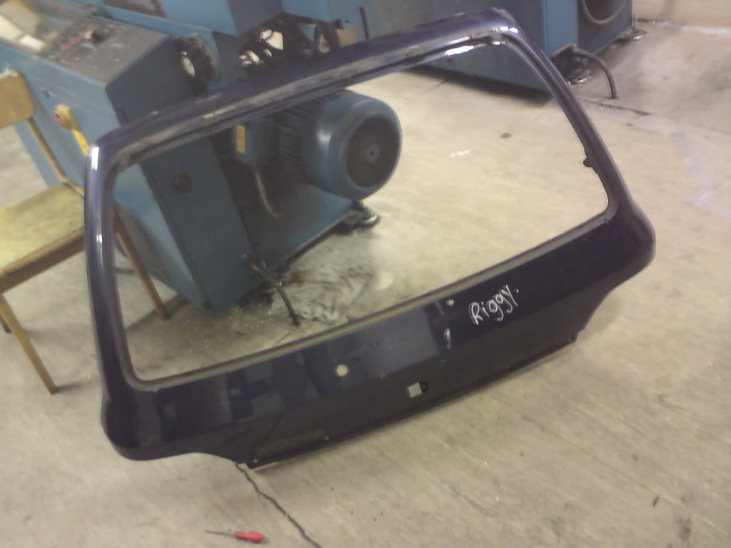

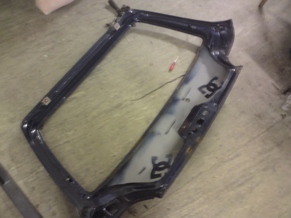

Picked up a Ph1 bootlid and a Door from one of Winstons mate yesterday, for the sum of £0. The boot is mostly rust free, no rot, and has already been partially cut to save some weight. Ive stripped it down and its getting painted to go on the hybrid (Ph1 = No badge holes).
No idea what Im going to do with the door, but for nothing im not complaining...

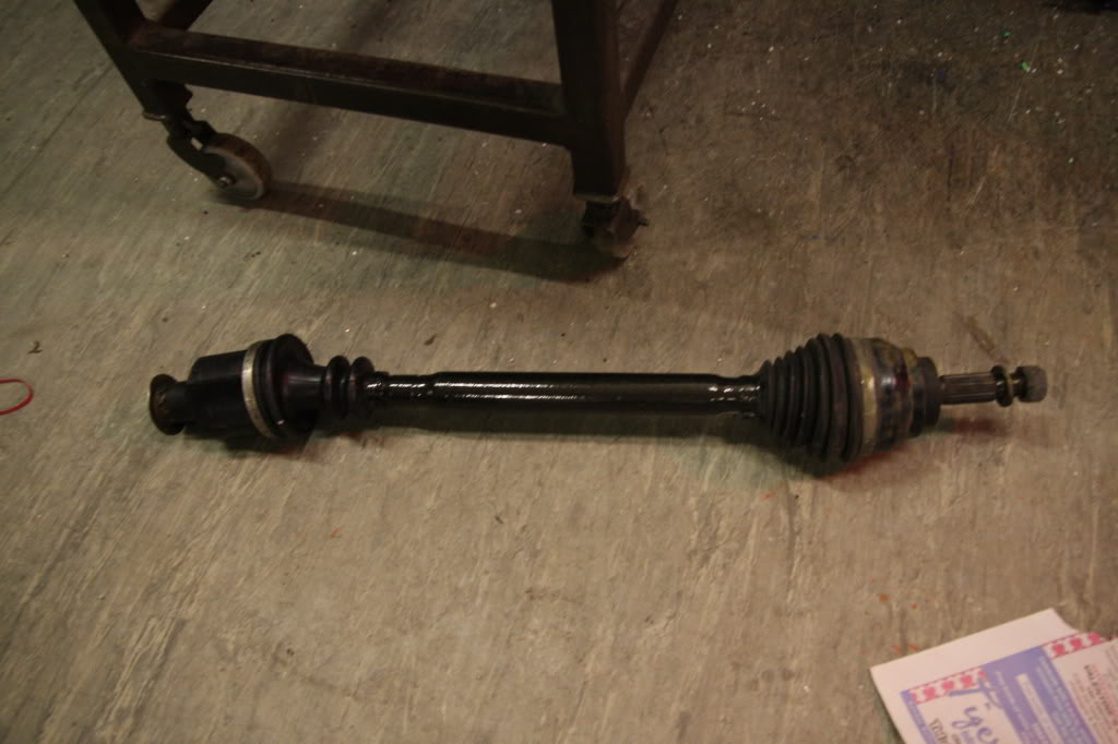

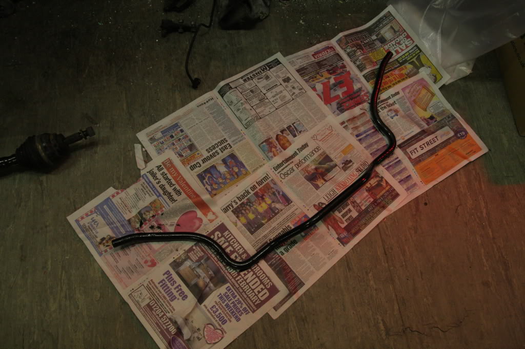

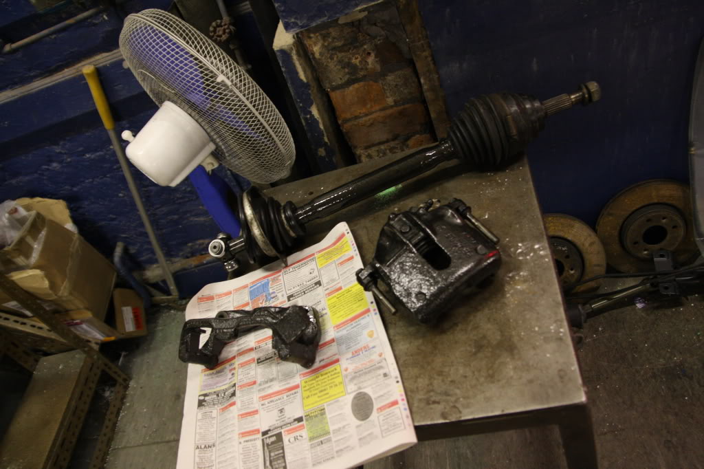

Few last bits painted...

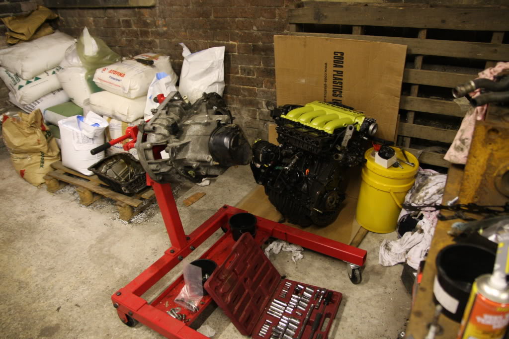

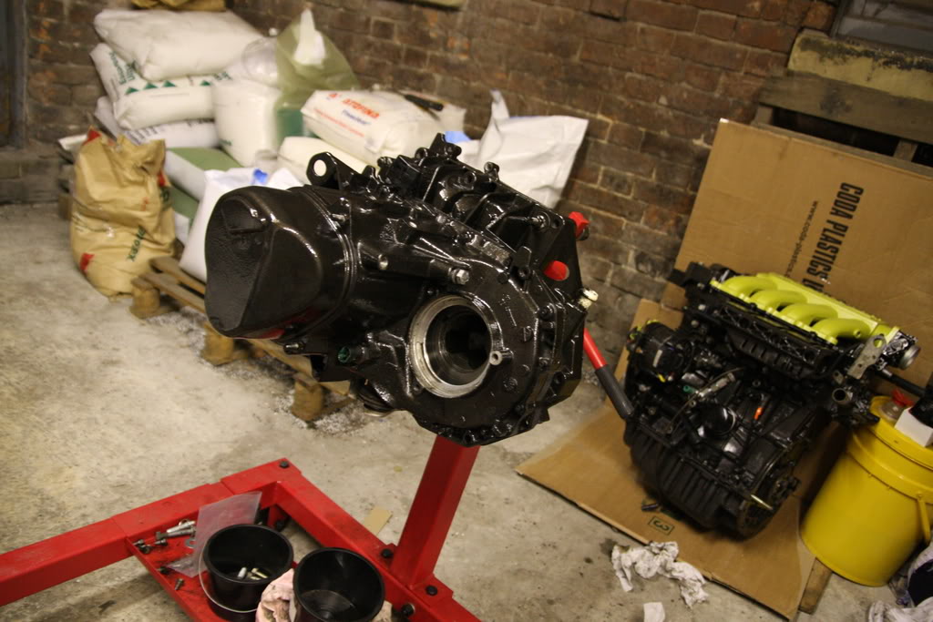

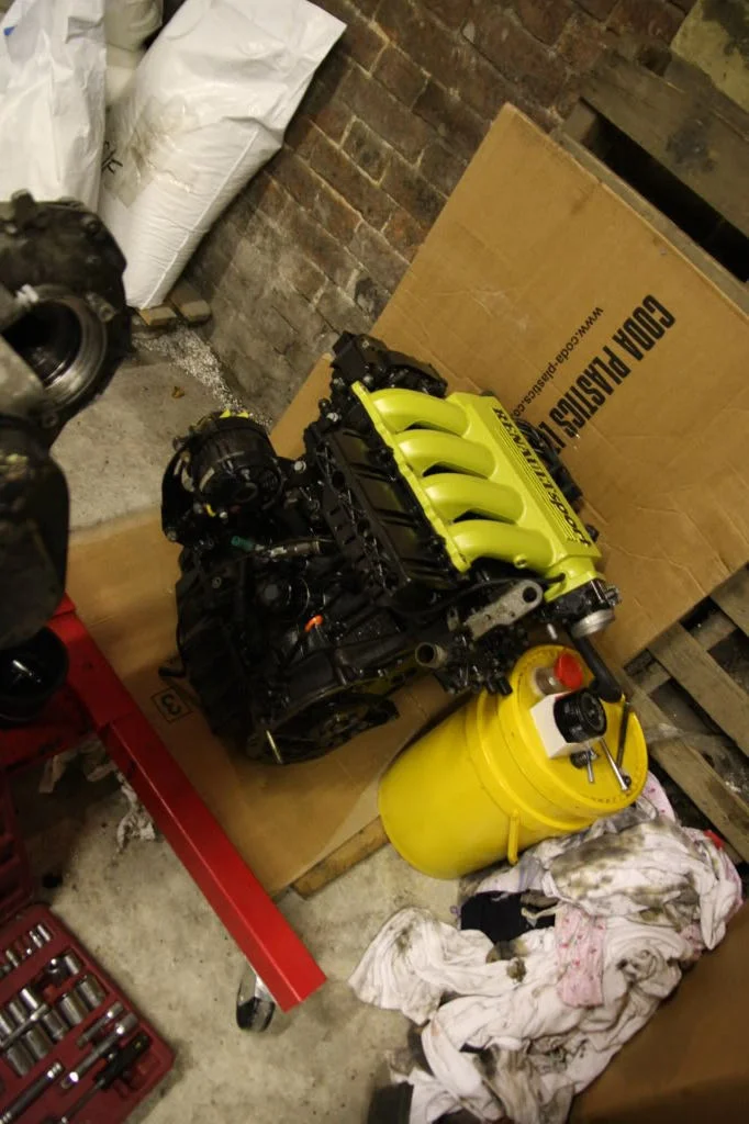

Checked all the bolts on the engine, new Oil filter on, everything tightened up...took it off the stand, and put the gearbox on for ease of painting...

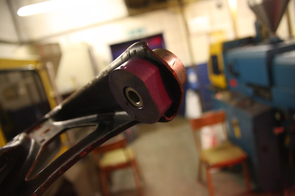

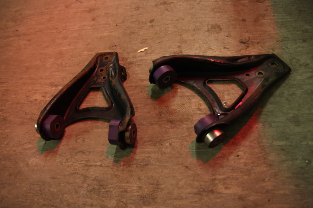

Was going to paint these quickly too, but then realised the polybushes have moved inside the sleeve, like rotated, the flat edge of the bush is no longer where it used to be?
God knows, Il paint them when I find out why...

speak to whiteley. He tacked his bushes in place with a little weld to avoid that happening.
Re: Mk1 Hybrid Project
its not the metal moving mate, its the rubber bush inside...I know the metals definately not moved because a stupid amount of force with the press was required just to get them in!

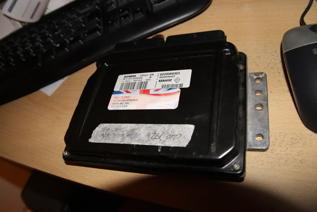

Day 167
Not much more done, been busy with other stuff today...Got woke up at 7am with a package...
ECU back from being decoded/unlocked/de-immobilised etc...hopefully should be plug and play :)
Gave the gearbox a quick go over with the paint...
And another coat on a few other parts. Got some other stuff going on tommorow with welding etc, More then...

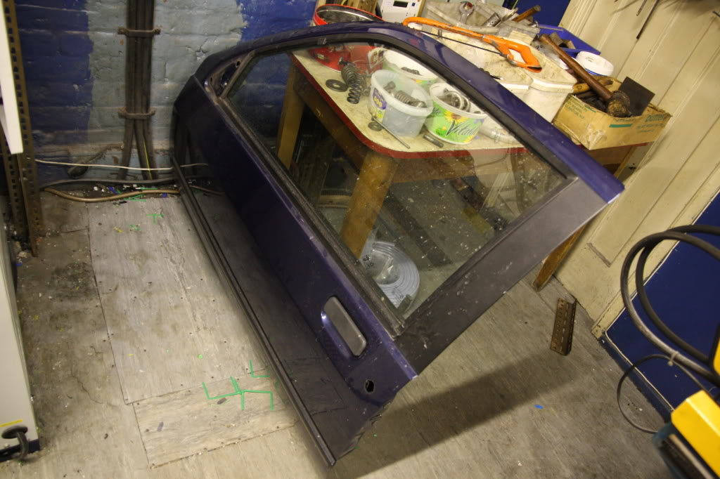

Whats the condition of the door in mate? my mate is after two doors, looks the same colour blue too!

its in pretty good condition, but im going to be cutting it up to use the bottom out of it to repair another door

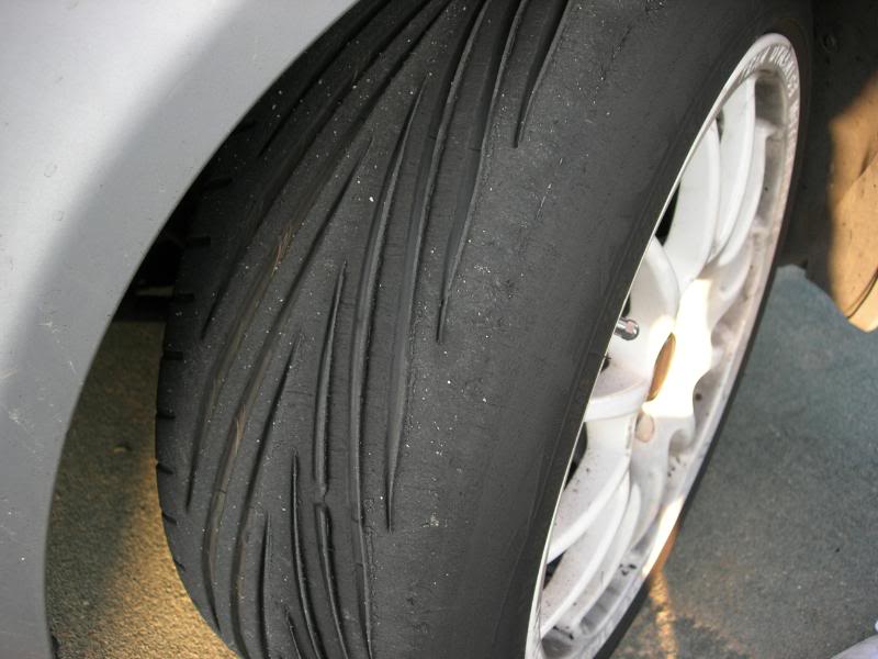

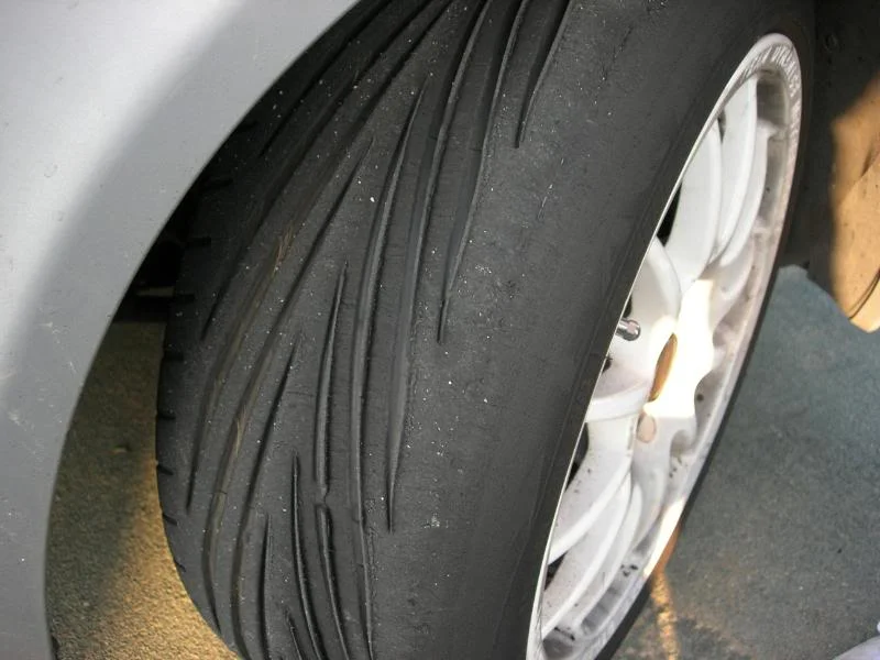

hmmm looks like badly setup suspension could be the cause of something that severe, or incorrect pressures?
T1-R's are softer/wear quicker than F1's too, last time i had them the f1's lasted longer overall
  BMW M5 & E36
Looking at the pic I'd say not enough pressure due to the massive roll/sidewall scrubbage. I had a nearly new set of T1r's on my 182 and they didnt come off as bad as that, I played about with pressures a fair amount though. That was on a standard 172.
