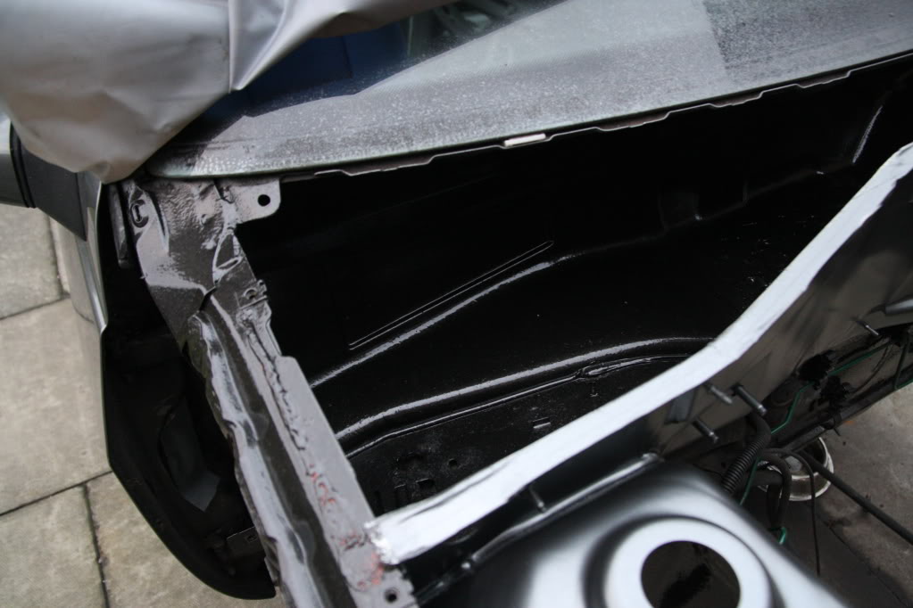

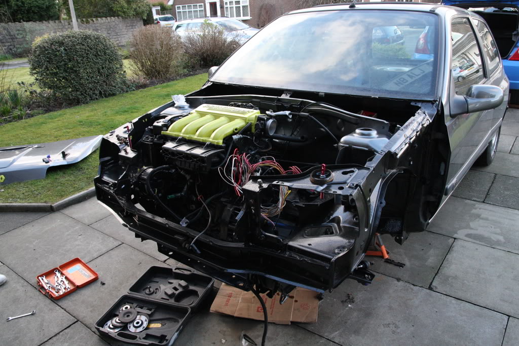

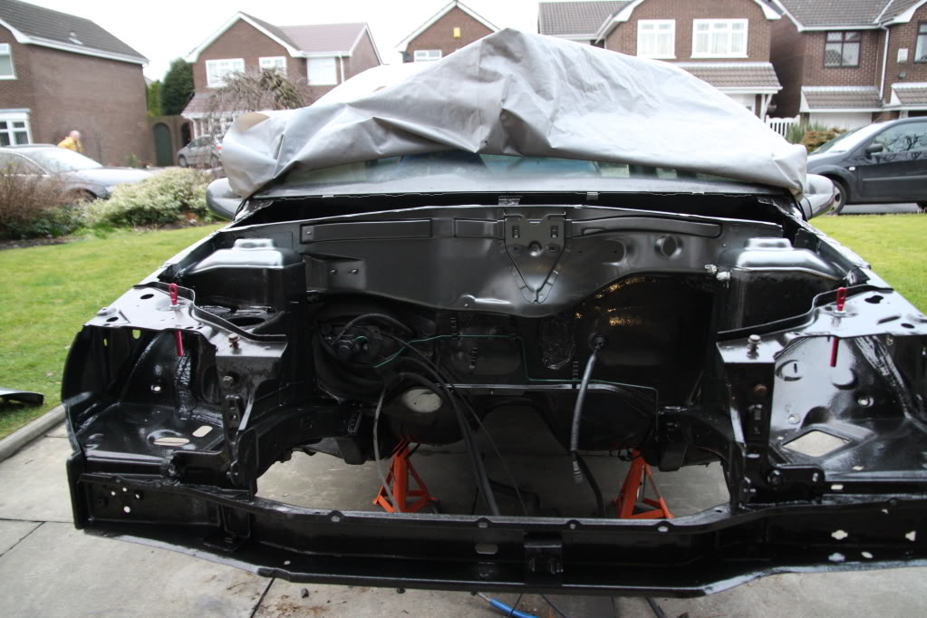

Quick update from the past two days....I re-painted the top part of the bulkhead yesterday, and the suspension turrets in body color. Sanded, primered, painted, clearcoated, looks alot better fresh. Everything else is hammerite again (Need to touch up round the turrets with a smaller brush), most of it isnt seen, hence why I did the top of the bulkhead nice, and not just slapped hammerite on...
Also removed the tar, cleaned, then painted under the scuttle panel...

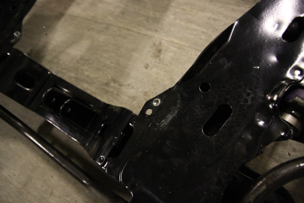

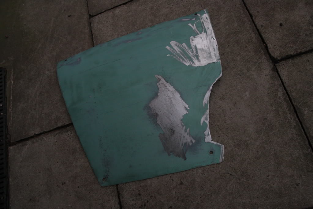

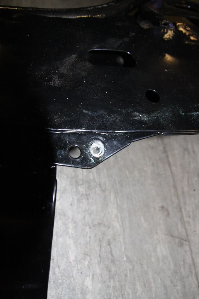

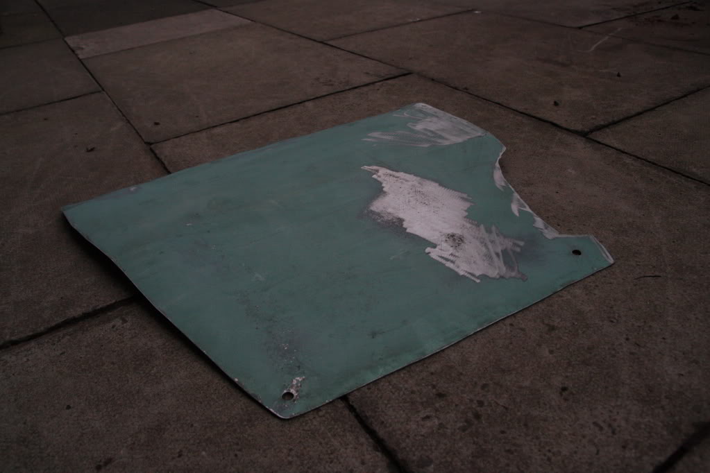

Also found some thicker steel (3mm) to make a sump guard out of, so the past few days consisted of using alot of disks on the grinder, and bending, and drilling...Got it to the right shape today, then put some nut/thread insterts into the holes on the subframe, so it can be easily bolted on and off...
Cut to shape...
Bent to Shape...
Nut/Thread inserted..
Then painted the guard, will post pics of it fitted next few days....

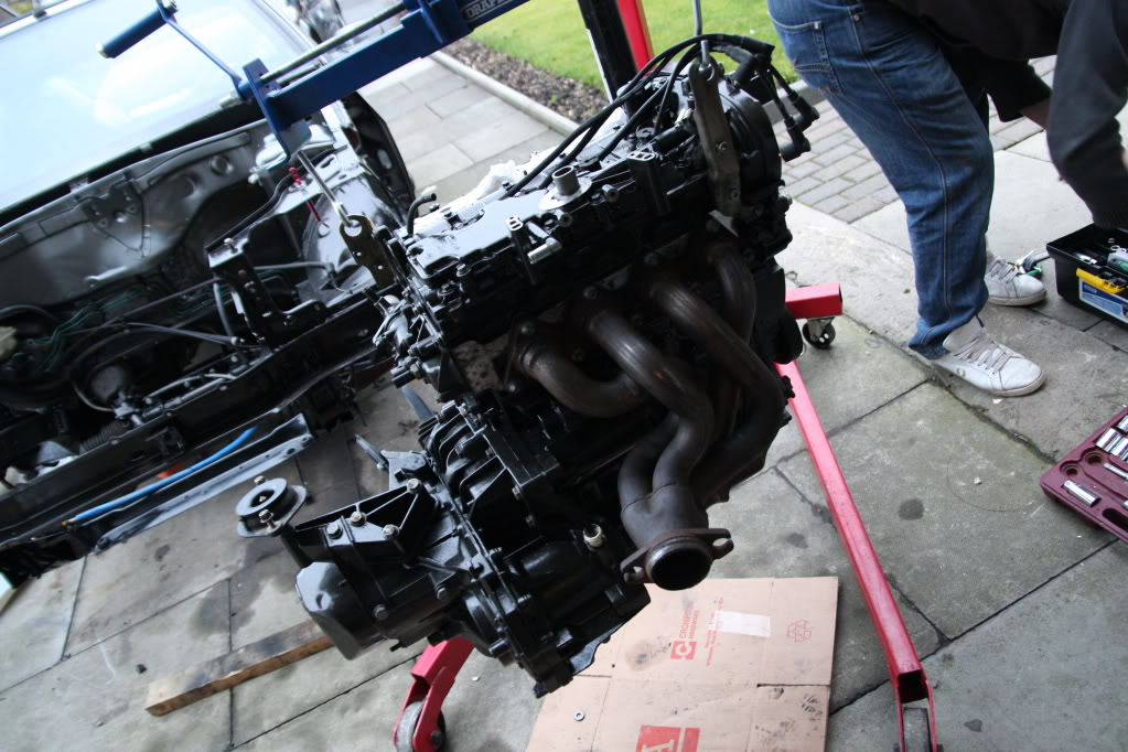

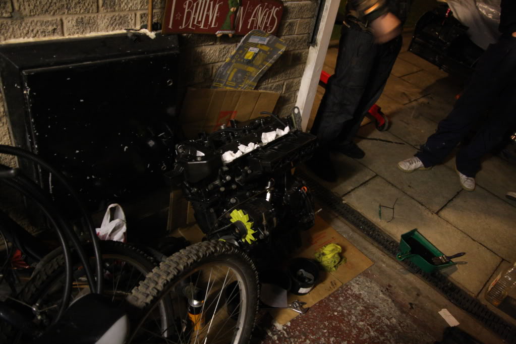

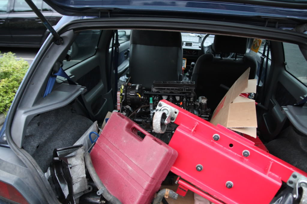

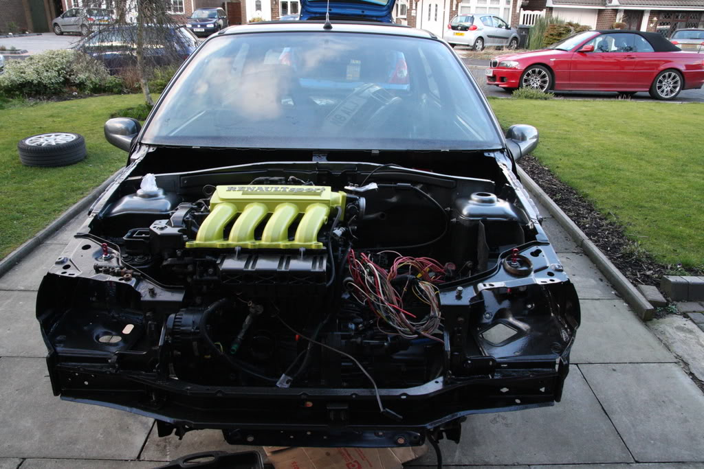

Last job this afternoon was to get the engine + gearbox home...easy...
Let the fun begin :evil:

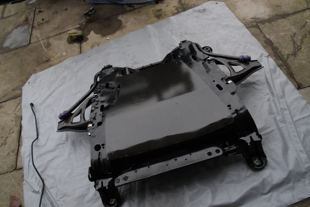

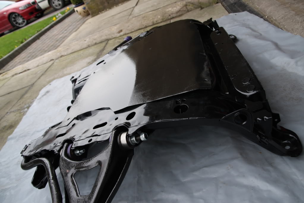

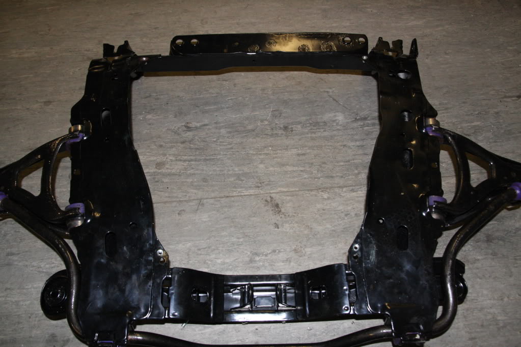

Few pictures of the sump guard laid on top of the subframe as requested..

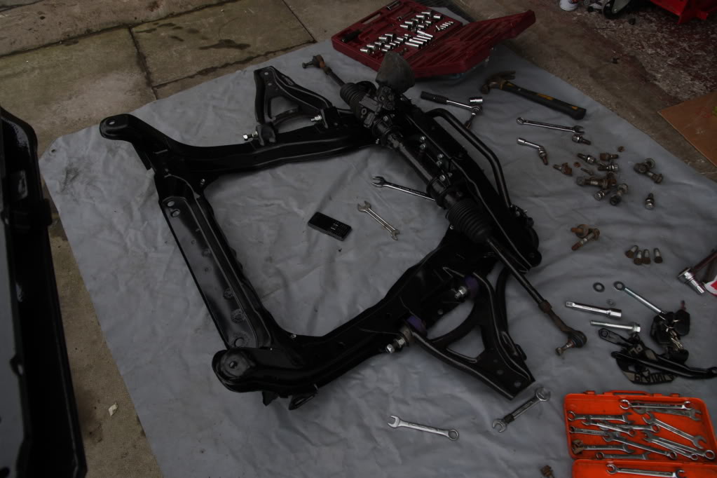

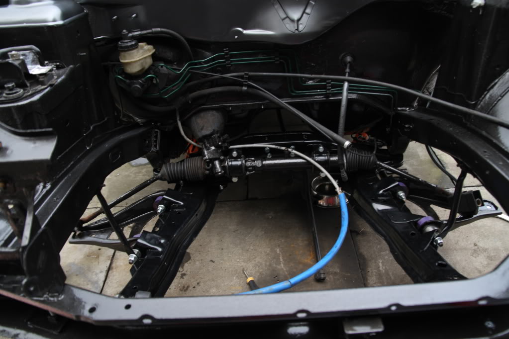

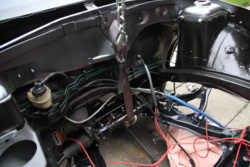

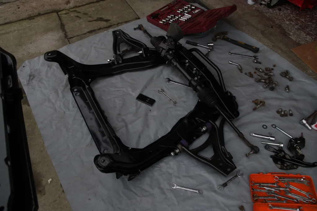

Anyway, todays jobs...Fit the steering rack..

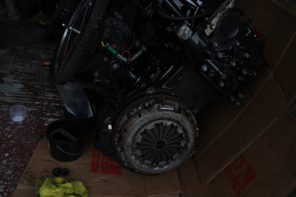

Fit the clutch...

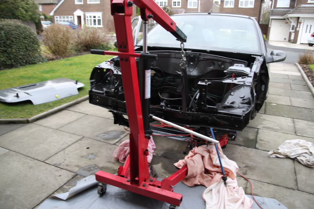

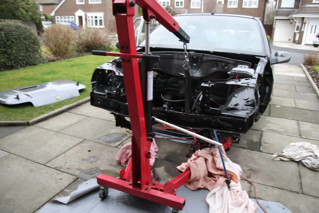

Then it was time for the subframe to go onto the car, but I was on my own...rig-up..
Sorted....Brake lines re-fitted...

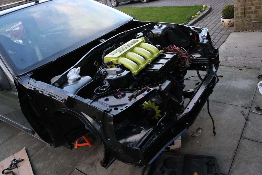

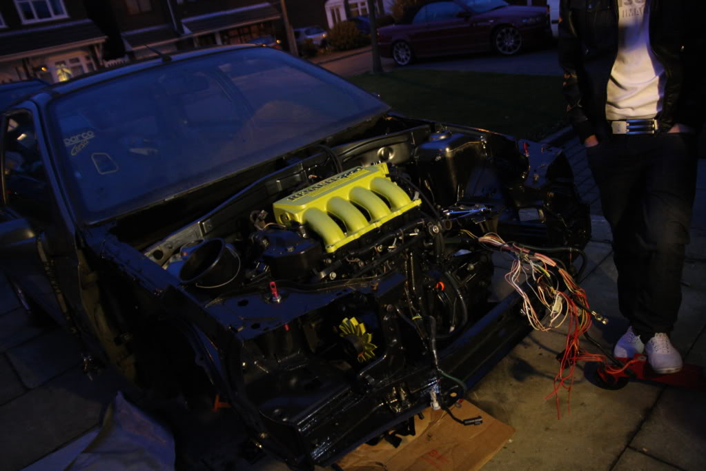

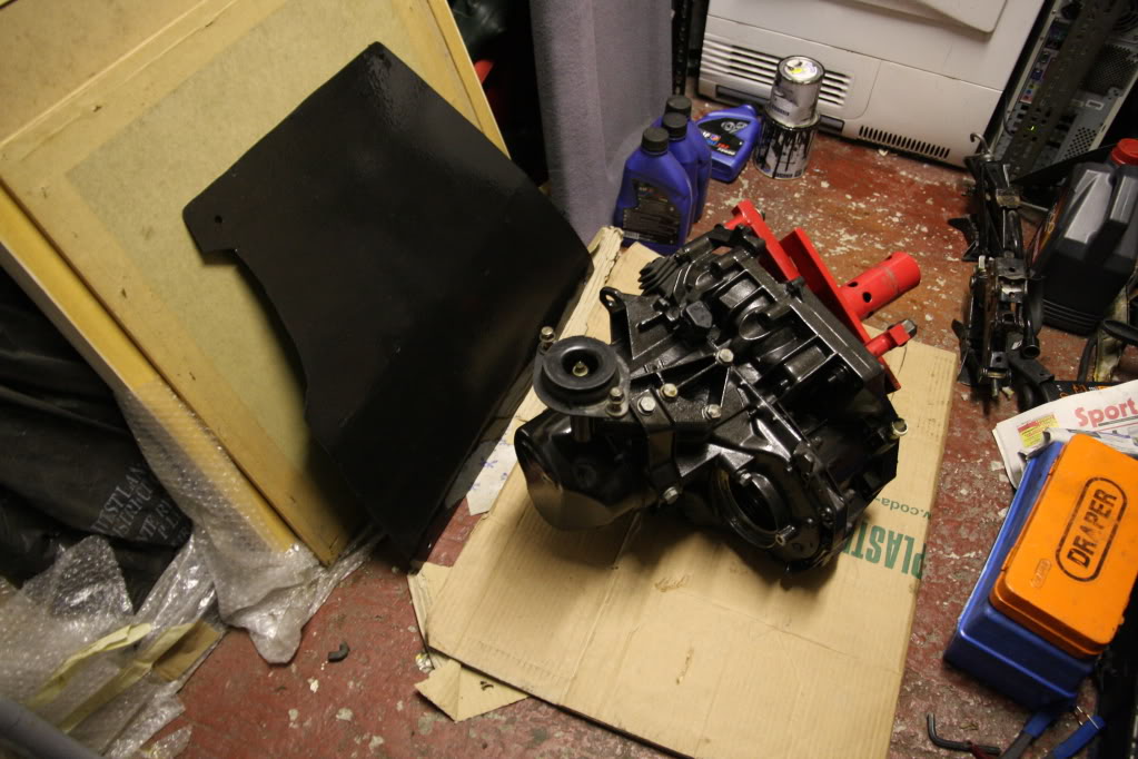

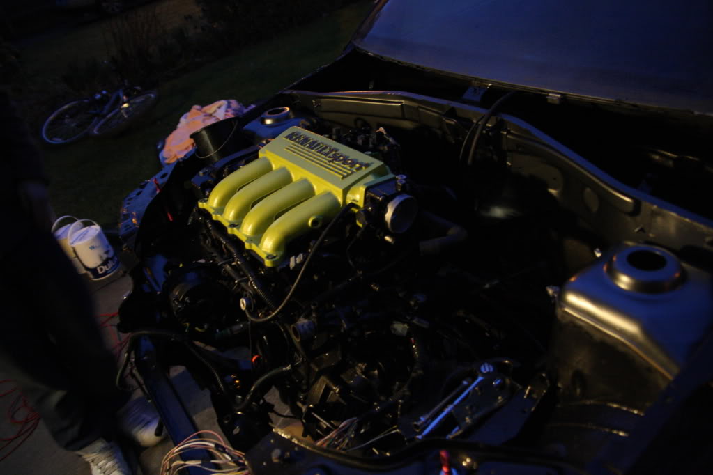

Then fitted the volvo clutch cable brackets/fork onto the box, and fitted it to the engine...along with the exhaust manifold, new gasket and nuts...
And not much longer later...
More soon...:evil:
Re: Mk1 Hybrid Project

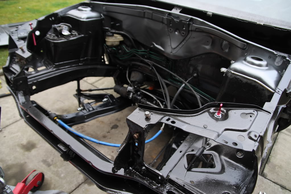

Not done much today, just tidied a few bits up...got a few daylight pics, all three mounts now bolted up...
