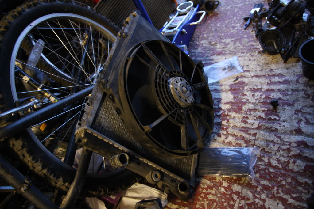

Drove over to ClioSpares today, to pick up the last part of the engine bay puzzle, a 172 Radiator + Fan...

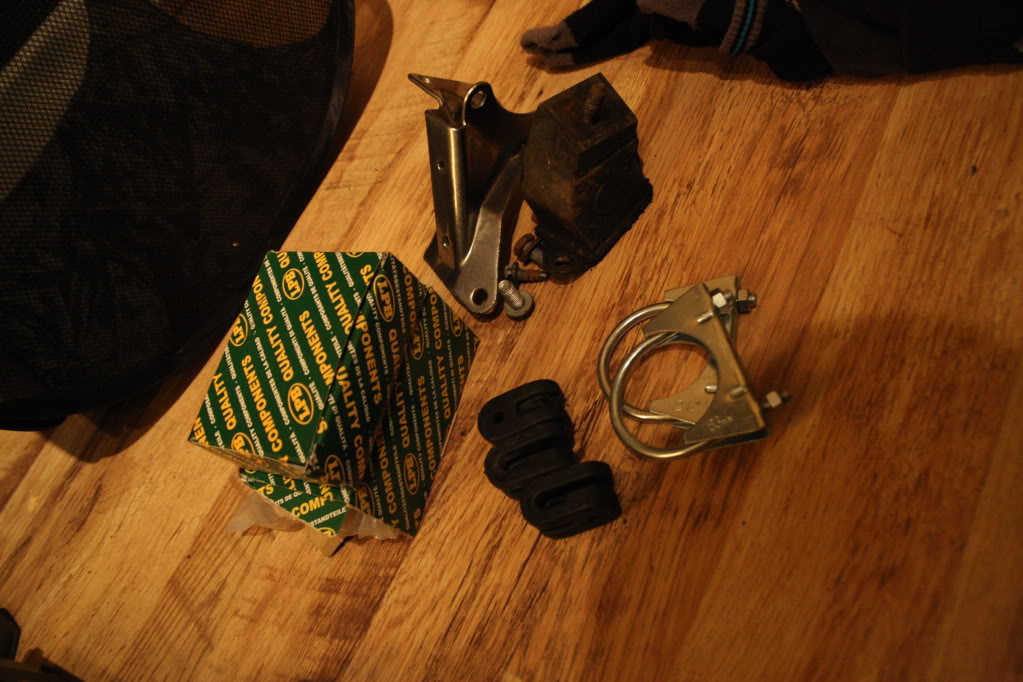

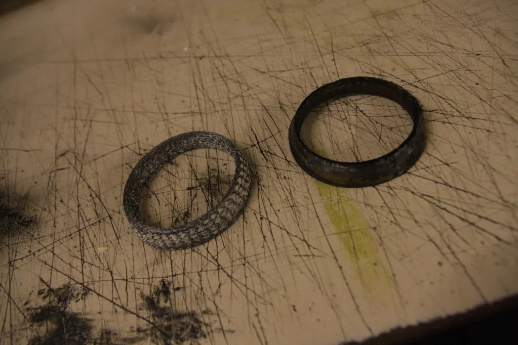

Then also picked up a few more parts...172 Exhaust manifold-to-downpipe gasket, a pair of balljoints, new exhaust clamps, new exhaust rubbers and a 4th/front gearbox mount off Winston :approve:

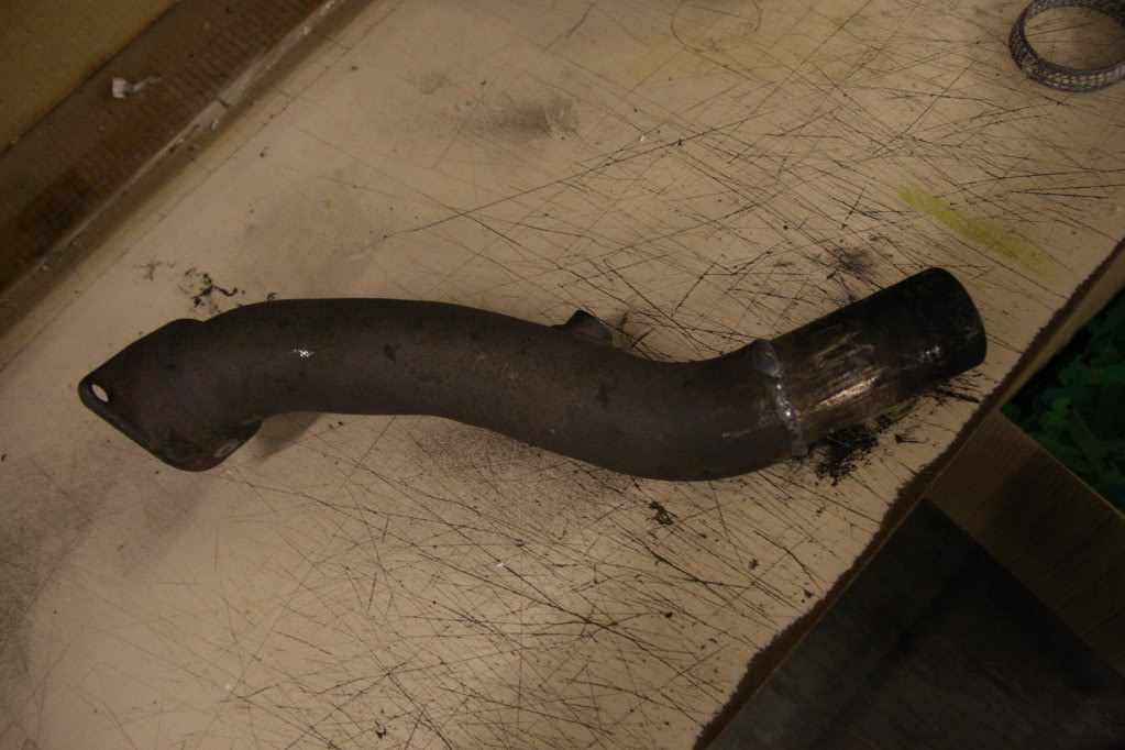

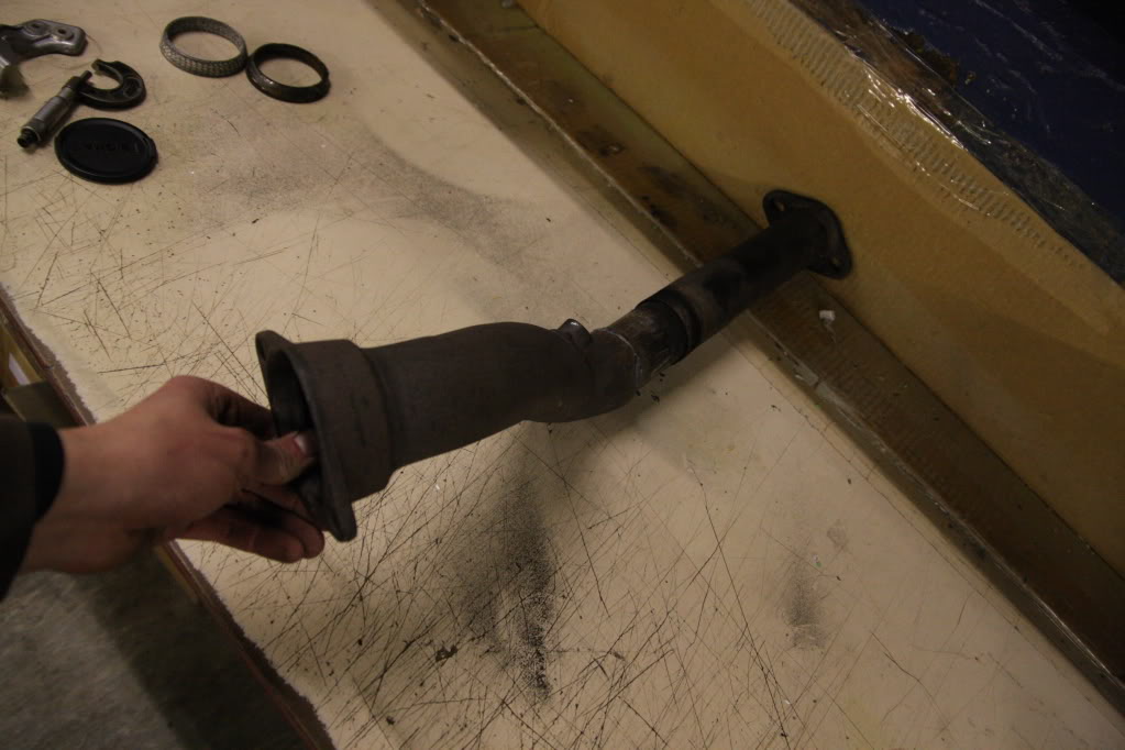

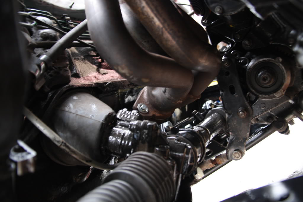

Ive been making a downpipe over the past few days, as you need a 'custom' one to go through the gap between the subframe and bulkhead, which is unlike a standard 16v/williams that goes under the subframe....

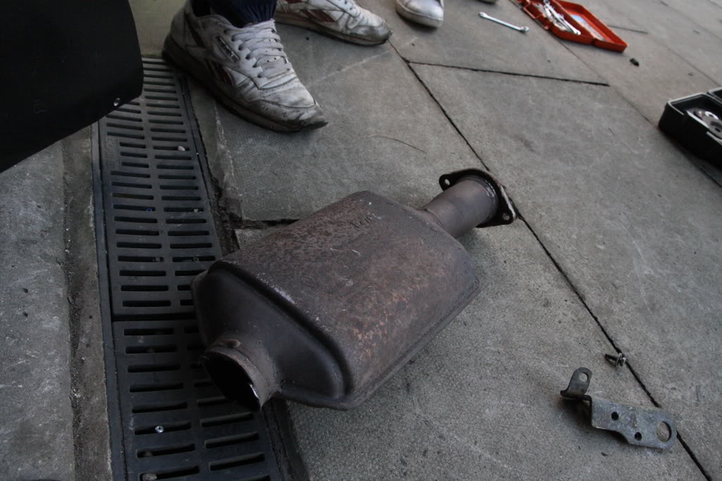

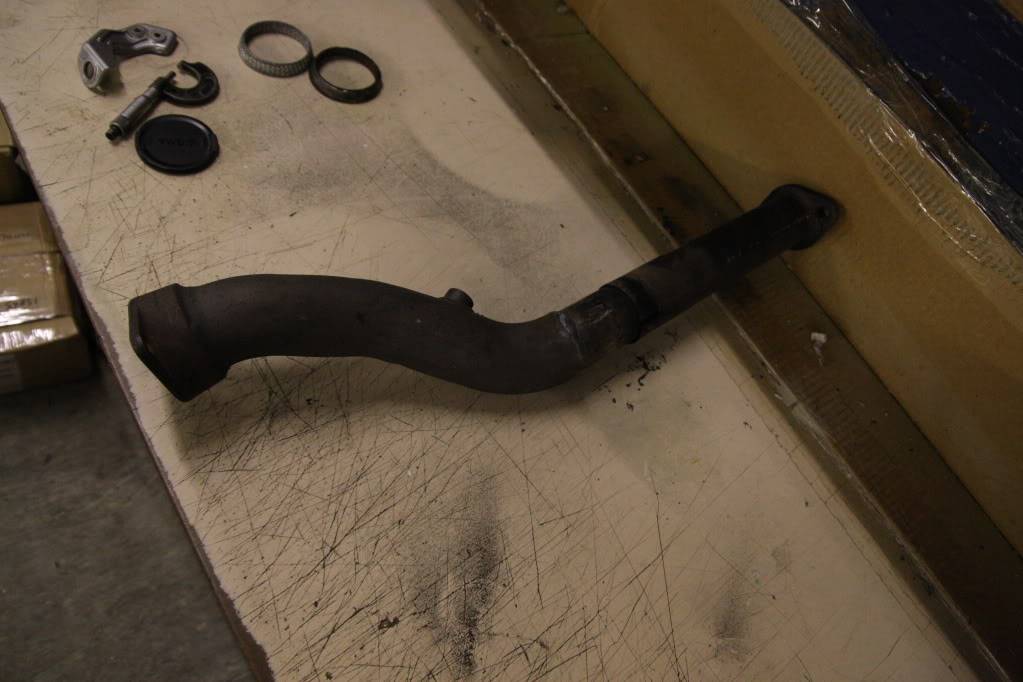

It started with cutting the 'down' part off a standard 172 Cat...

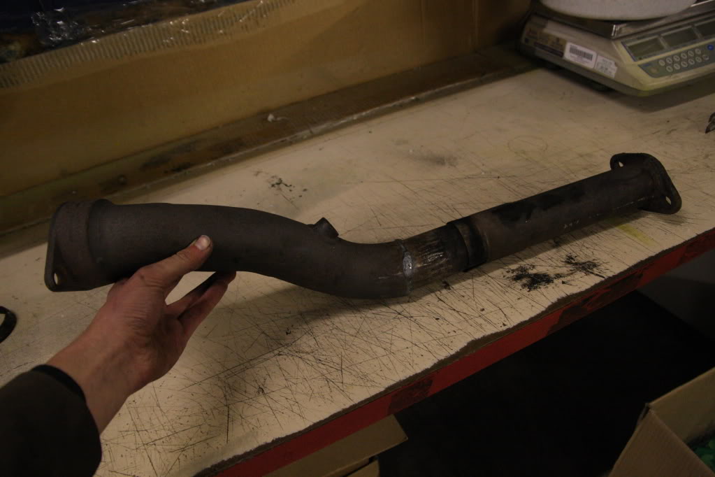

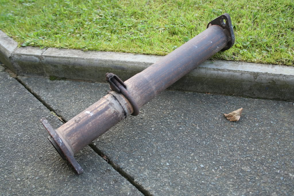

Then cutting one flange off an adjustable valver/williams BB Tuning decat...

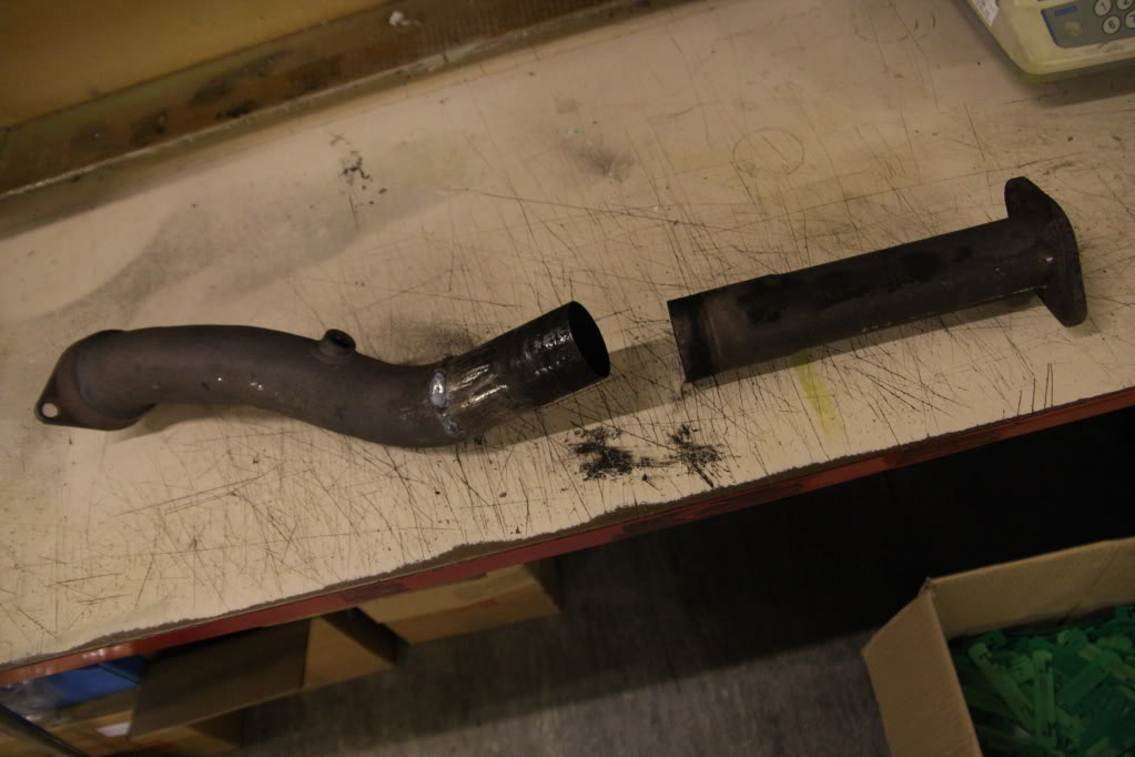

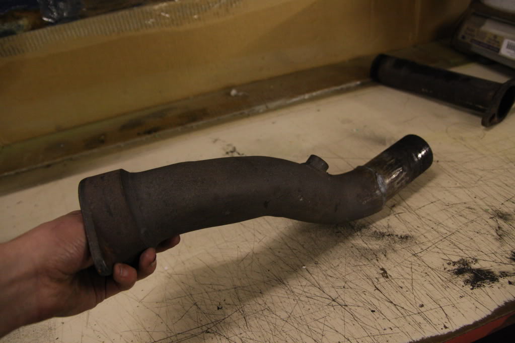

Next, i held the bit from the cat upto the manifold which is fitted to the engine, and worked out what angle I needed to get the pipe welded on at...After this I tacked it in place, and double checked...
I was happy with it, so had it properly welded...
Now, ive left the other part 'adjustable' for now, as I already know its sort of the right length to perfectly meet the standard Mk1 center section flange, which was the original idea. After I have fitted the exhaust tommorow, and triple checked the length is correct, il get the 'adjustable' bit welded up, so its a fixed downpipe :cool:

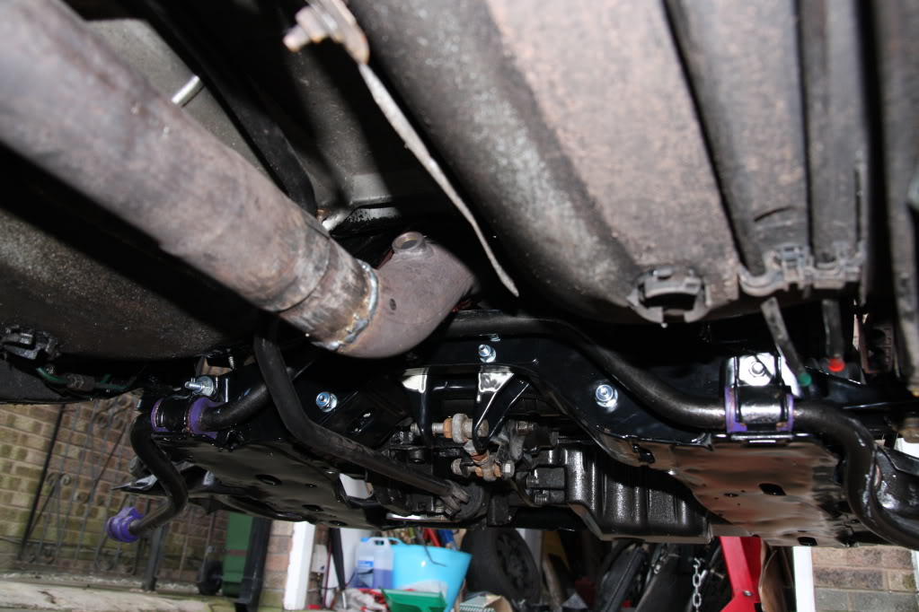

Day 177

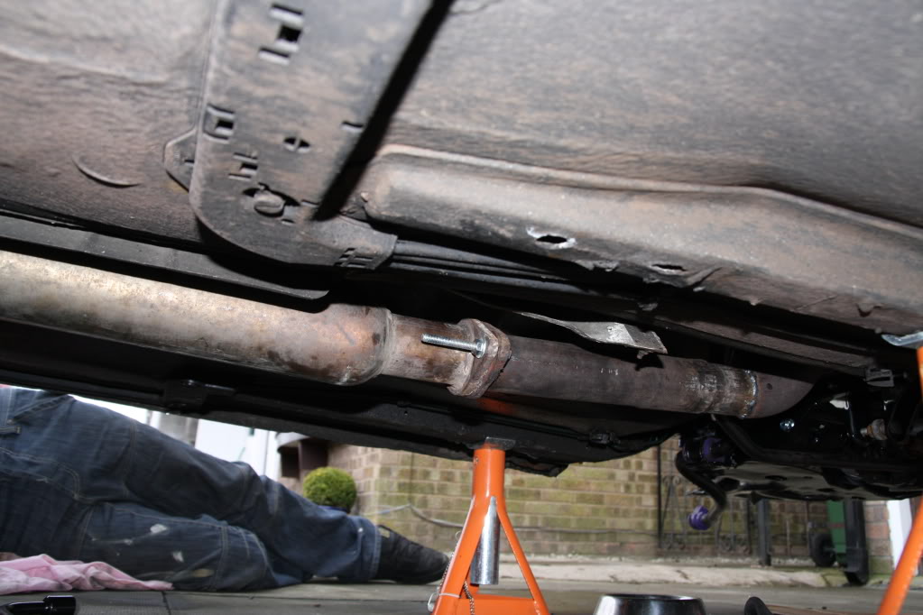

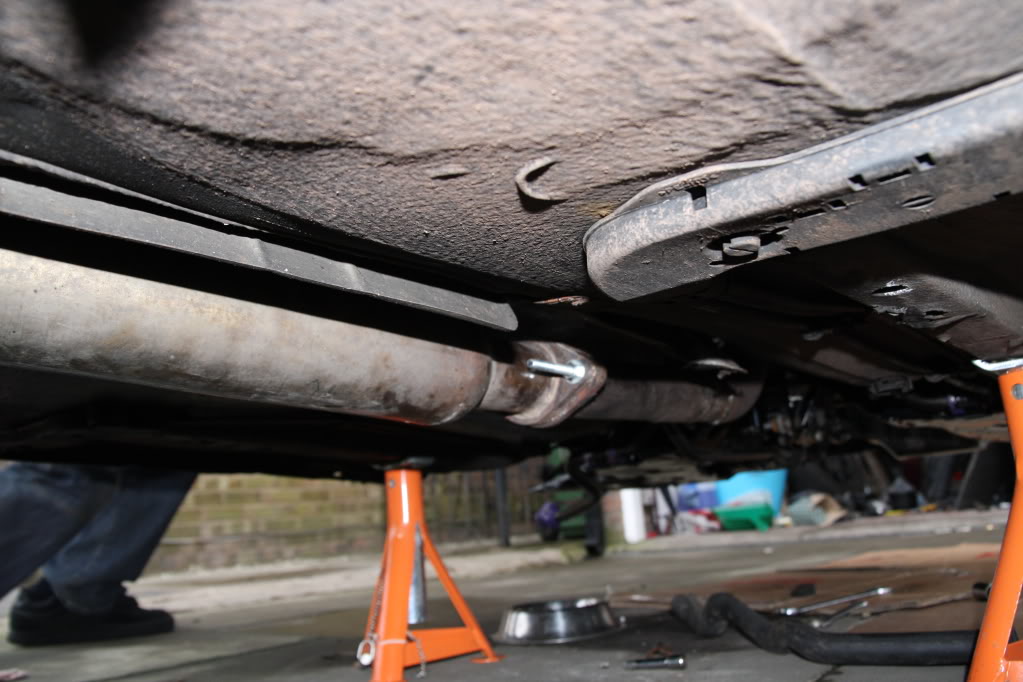

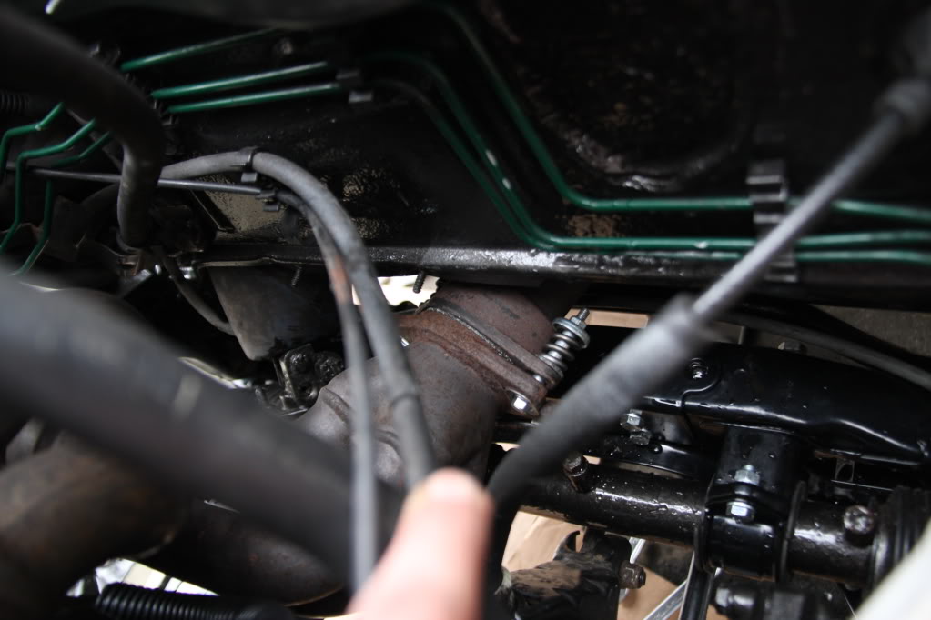

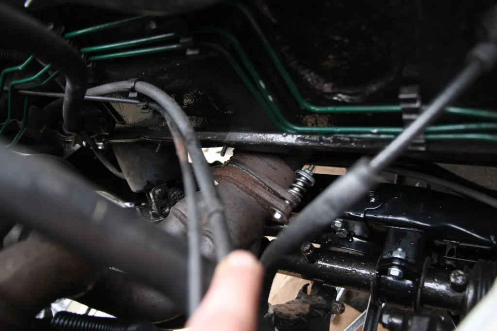

not much today, rain stopped play...downpipe + exhaust fully fitted. Adjusted the downpipe length so the exhaust fitted nicely, the downpipe fits through the subframe/bulkhead with room to spare both sides, and meets straight up with the exhaust.
All that needs doing is the downpipe removing, and the sleeved part welding up, so its a solid one piece downpipe...Engine bay side:
As it comes through...
Joint is in the standard Mk1 exhaust position, so any Mk1 exhaust would fit straight on..
That was it really, not much else done, might try tidy up the wiring tommorow and try and start it....I hope anyway!

Re: Mk1 Hybrid Project
172 manifold was left as standard, then i cut the downpipe off the standard 172 cat (ph2 cat though iirc, ph1 has two seperate cats or something?)
then got a 2.5" bore decat (same as downpipe bore) and cut one flange off....then welded a short piece on, in the correct direction...
fitted to the car, slid the other piece over, checked length with the exhaust fitted, then welded that up, so now its a solid downpipe :)
