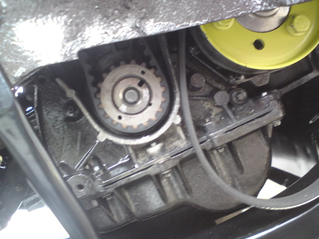

ok the starter has a good earth, continuity test confirms this. Had the starter off, sanded both faces (starter + box) and then refitted. Tried to crank again, solenoid just clicks, then nothing...
Went to try and turn the engine over by hand (bottom crank pulley) and i cant move it?!? So took spark plugs out, still cant turn it over....hmmm.

aye, sheared off.
ben, what did you do? stud extractor?
TBH i think the engine is siezed or something, i physically cant turn it over by hand, so no wonder the starter cant...
Re: Mk1 Hybrid Project
need to pull it out first...then you should drill the crank bolt and either stud extractor or weld a smaller bolt to it..and wind it out..

how does the cambelt bottom pulley go onto the bottom crank, similar to the F7R?
I mean if i take that thread out, is the bottom cambelt pulley going to remain in place or come off?
yeah just keyed in place and held on with the bottom pulley i think...iirc..not done a lot on F4R's..but its should stay in place anyway without the bolt..but you might need the head removing to check way it won't turn over by hand..
