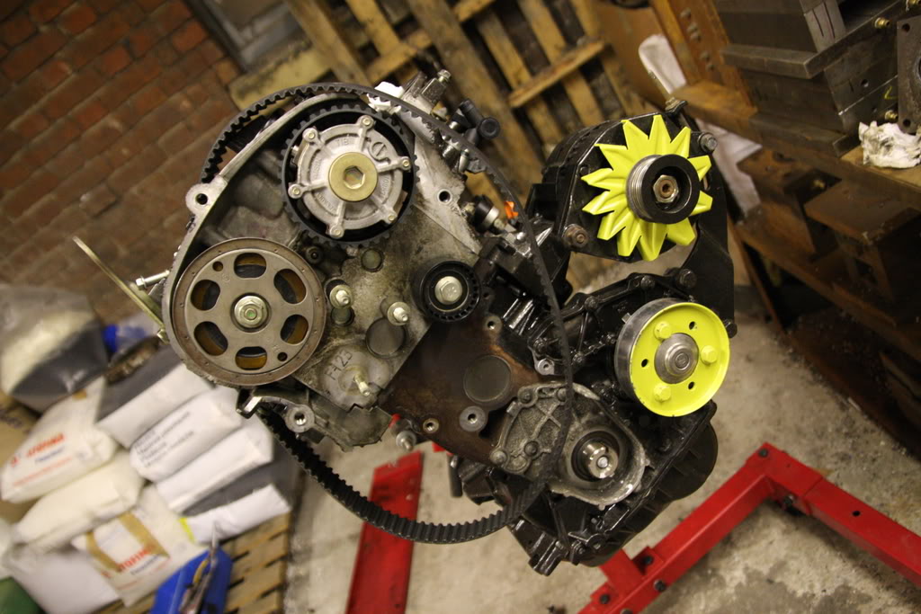

Right then, heres one for you all to have a think about...
Got the engine out, box off, clutch off, inlet off etc, and then into the back of the valver as said...down the factory, while later onto a pallet then onto the engine stand...
Cam covers removed, spark plugs out (still out from other day), took a spanner to the exhaust pulley, cambelt still on. Turned it over, was perfectly fine, pistons moving as they should, took it easy incase there was valve contact, nothing at all, turned it over like 10+ times....!
So...pretty pissed off after all the effort of taking it back out, then back onto the stand etc, but anyway, was thinking, why the hell is it turning over fine now?
First thing was like, gearbox maybe? Nope, could spin the shaft fine...
Then starter motor? Could turn the tooth with a screwdriver, so it wasnt 'jammed' so to speak...didnt test with a battery and solenoid engaged as I didnt have a battery to hand.........but surely this cant be the problem as the solenoid would not be engaged, meaning the starter tooth wouldnt be engaged on the flywheel (when the crank bolt snapped)
(Ignore the idiot doing commentry, lol)

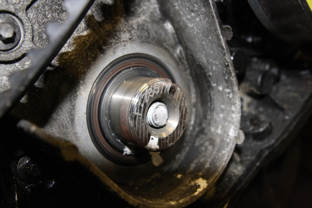

So...what else could it be? Ive removed the cambelt now, as im going to replace it considering i took the effort to remove the engine, etc...but im stuck for ideas!
This is the snapped bolt, too...
Re: Mk1 Hybrid Project
How much effort did the pulley bolt take to shear off? just wondering if it was weak anyway? could be a problem with the starter if the solenoid engaged but didn't turn the motor, it could have then locked the flywheel???

took quite a bit of force to snap it, all my weight on the breaker bar....could have been weak maybe

Replace the bolt, time it up with a new belt and get a new starter? Do 10 rotations by the crank on the new bolt.
Maybe the starter was stopping the engine from cranking.

the crank pulley bolts do stretch and must be measured to check they're within tolerance

Alll I can think is: If your starter engaged and then failed to retract off the flywheel, then your going to be turning engine and starter motor on the crank bolt. The gear ratio between fly and starter means it's going to be really really difficult....

its wierd news at the mo, dont know what was causing the engine not to turn over!
mark...ive not tried yet, going to have a go this afternoon....not sure about the solenoid making the gear be stuck in place, as when i removed it, it was in the position it is now, retracted...im taking the head off this afternoon (if i can get the cam pullies off) and turning the crank over without the head on....
