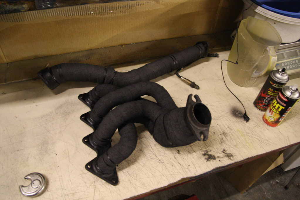

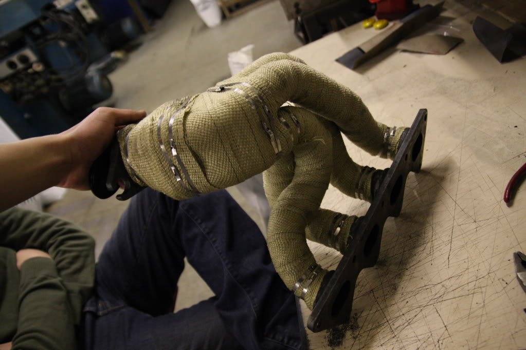

Few other bits done today also....Gearbox Circlip Welded...

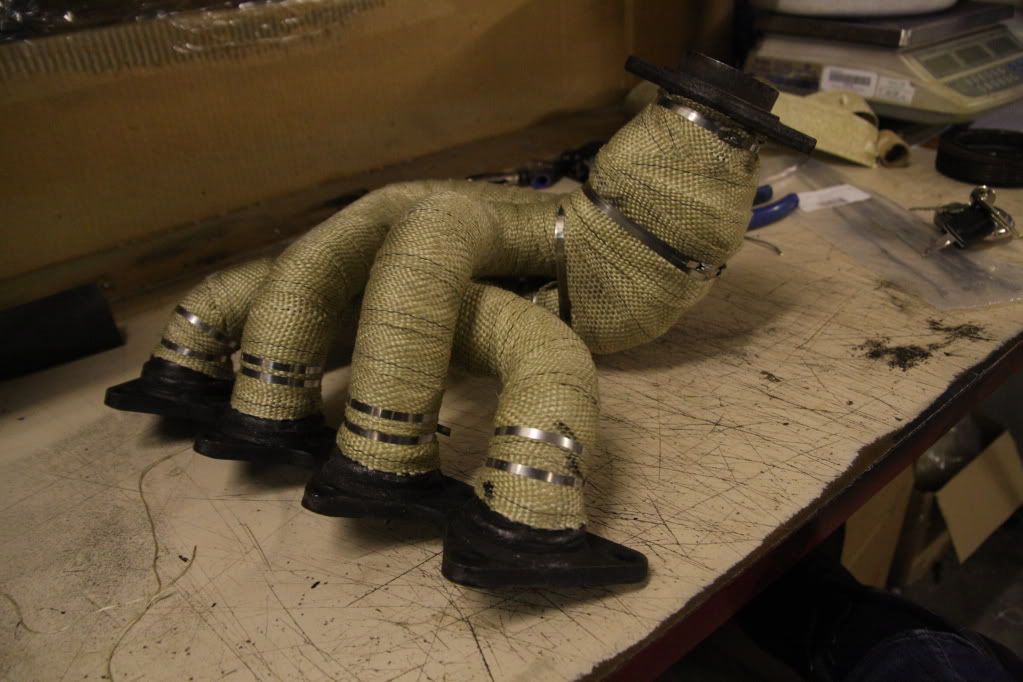

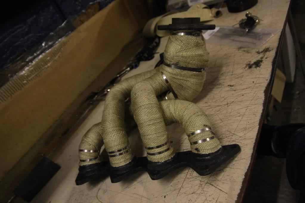

Mainfold Wrapped, along with other bit of downpipe....

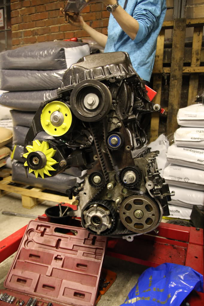

New headgasket, timing belt, built back up....as said above still wont turn over, so upside down and sump off...
More tommorow.

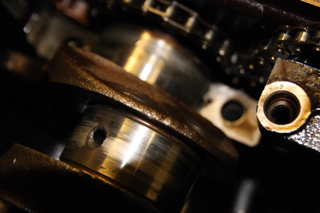

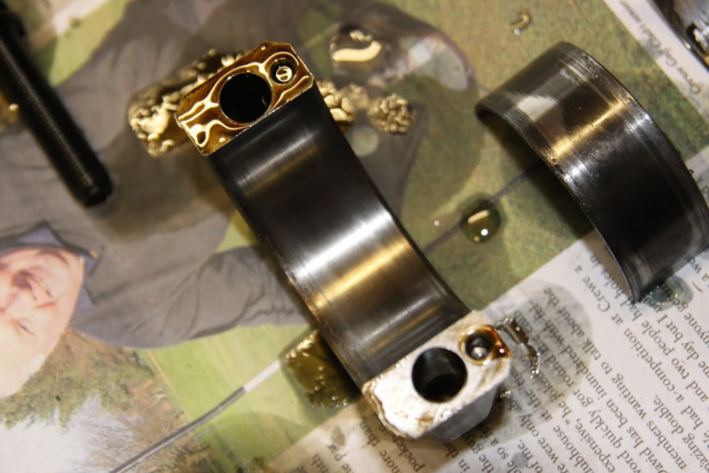

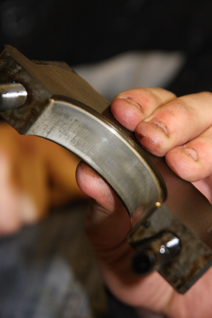

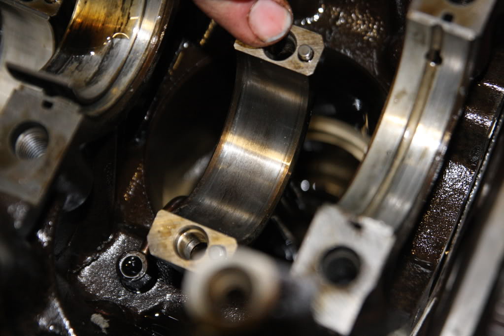

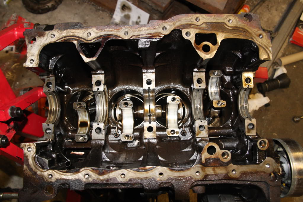

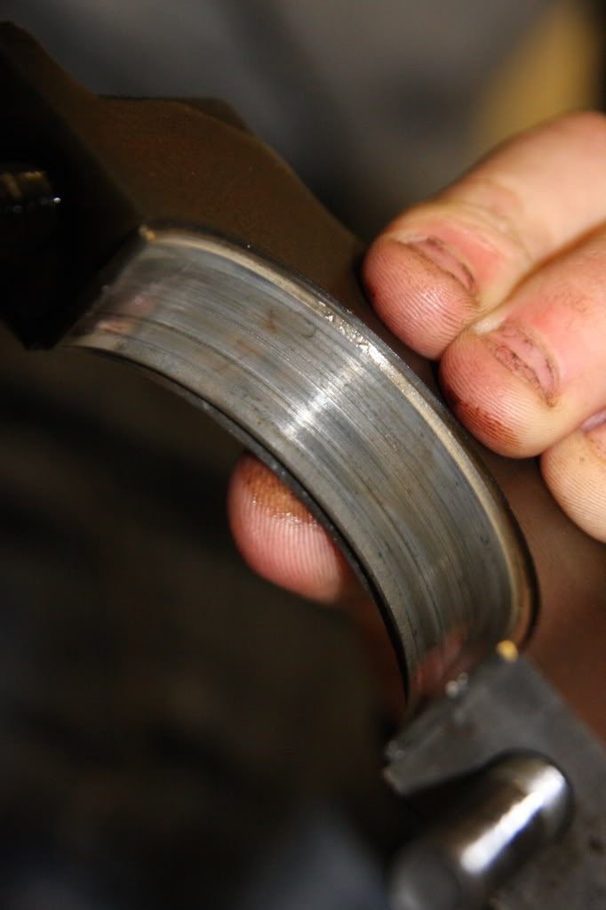

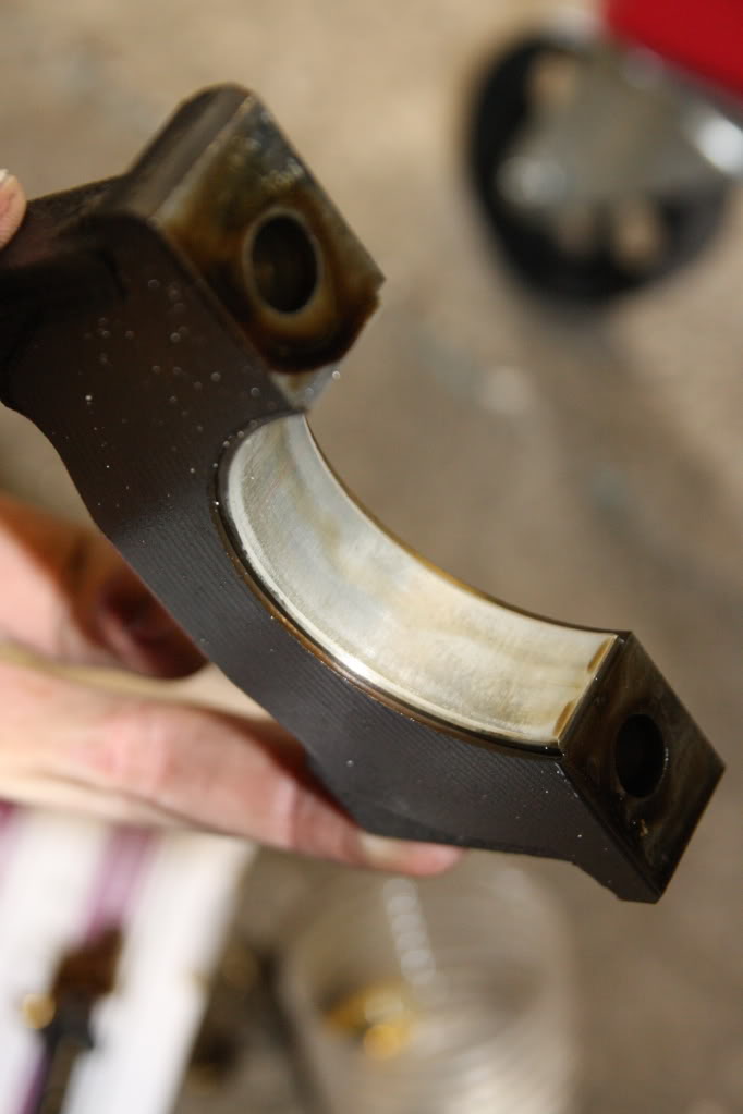

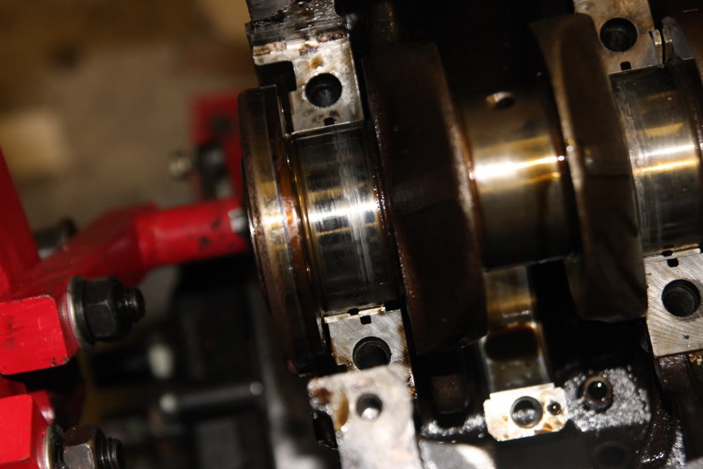

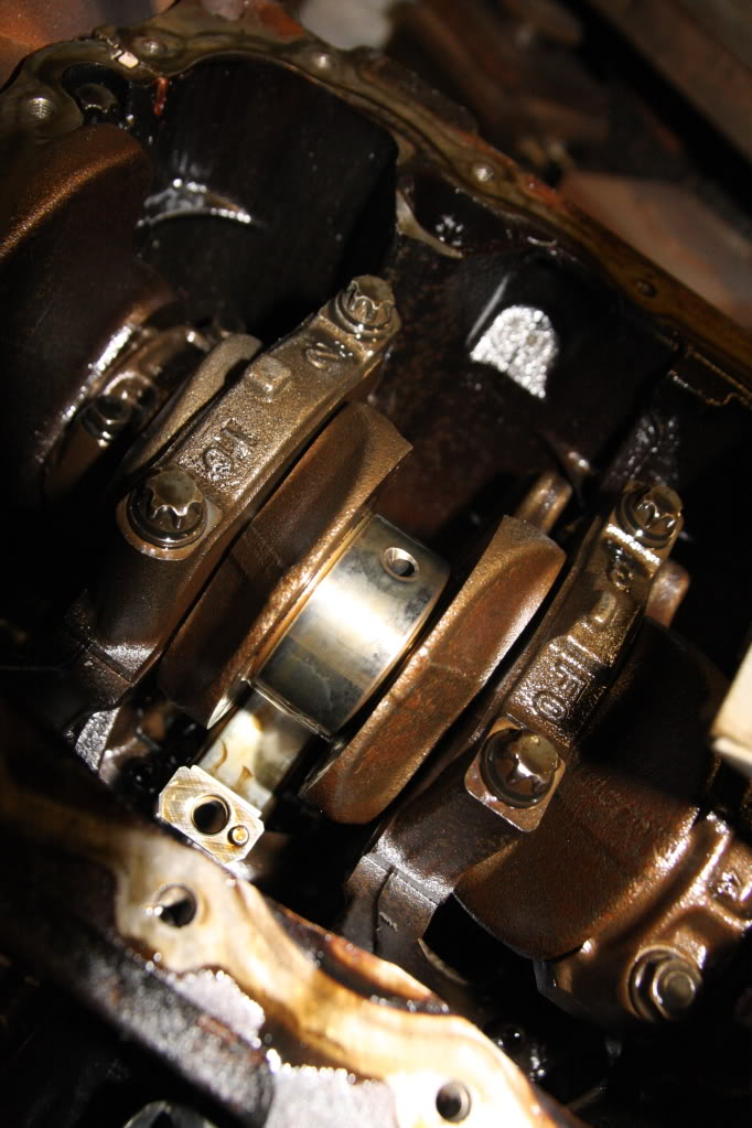

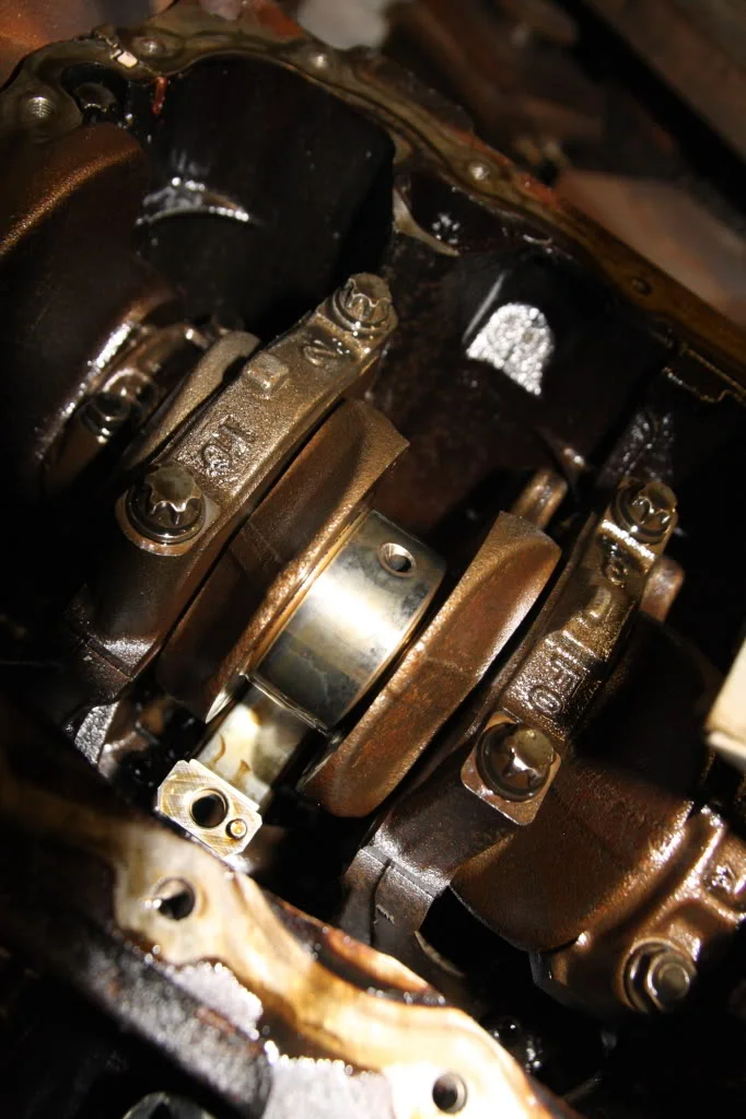

Had the piston rod caps off today, looked at both sides bearings, oiled them and refitted....dont know what im definately looking for, but dosent seem to be any weird marks or scoring....the insides of the bearing were still covered in oil already, as can be seen in the pics...
Going to leave the big end caps on 1+5, and check the bearings under the caps of 2/3/4 tommorow probably, so the crank can stay in place.....but if the piston ones havent got anything wrong with them why would the crank ones was my thinking....

does the bottom end turn over with out the head attached easily enough...do the cams turn easily enough with no belts on..etc..
does it only get stiff when assembled as one unit...
Re: Mk1 Hybrid Project
Bottom end turns over with the head off (had no crank bolt in due to it snapping, so was using screwdriver on flywheel. It turned over multiple times, but was pretty stiff....
Cams turn fine on their own in situ, just once the belt is on and timed up, its very very very stiff to turn over by the crank pulley...
When i had the rod caps off yesterday and pushed the pistons down slightly to see the other half of the bearing, the pistons moved pretty easily, same as what my F7R did....it just seems when its all together it gets stiff...

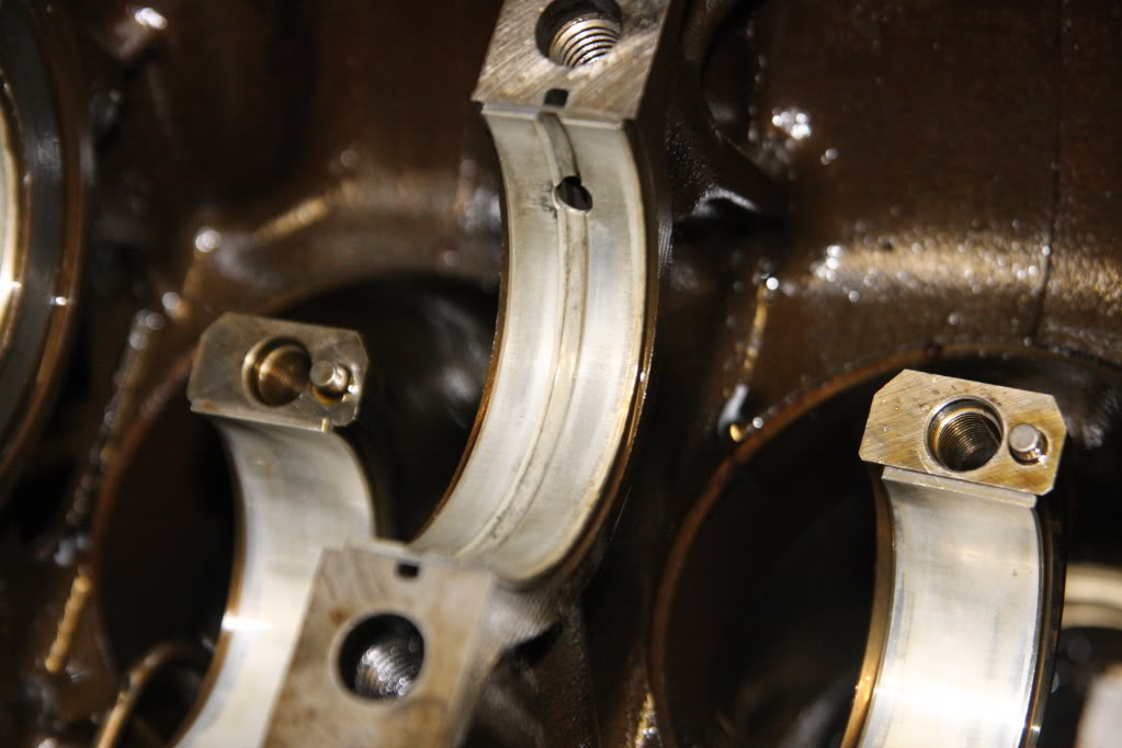

Going to take the main caps off (well the middle 3) shortly and check those out...
yeah sounds like you might have a main fault...can't remember the torque figures for the crank only to turn..will see if i can find some..
plus if the middle three show nothing have the five off..

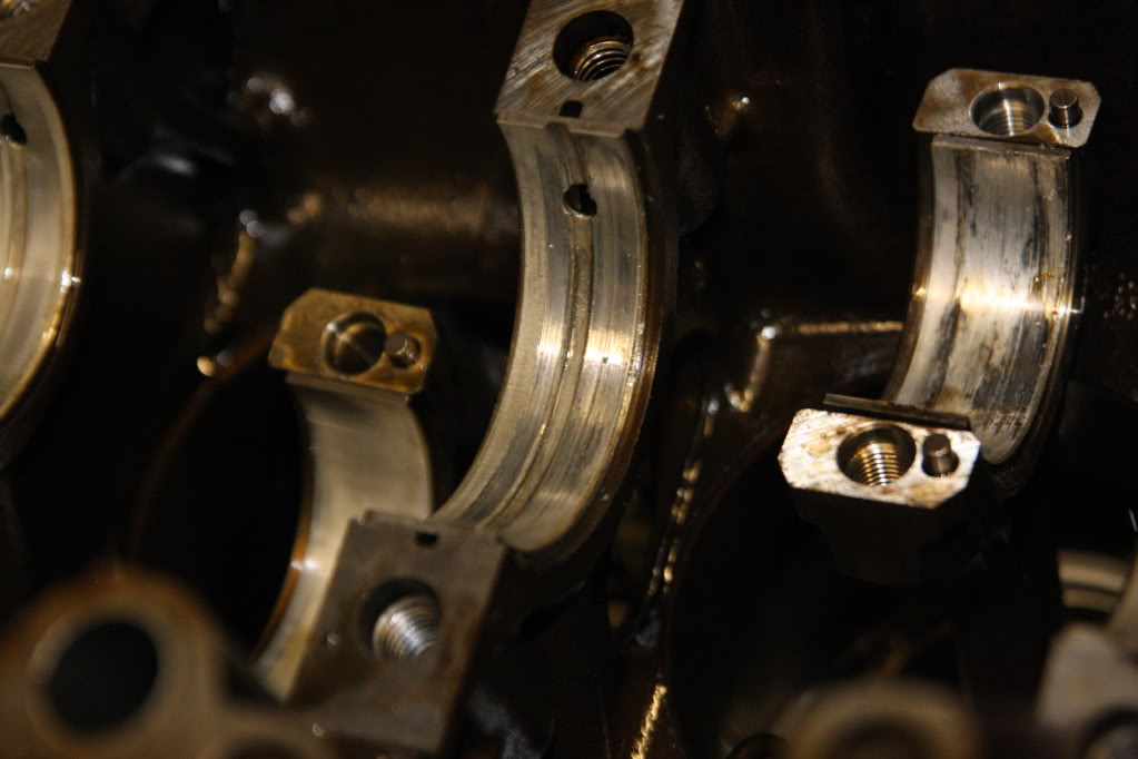

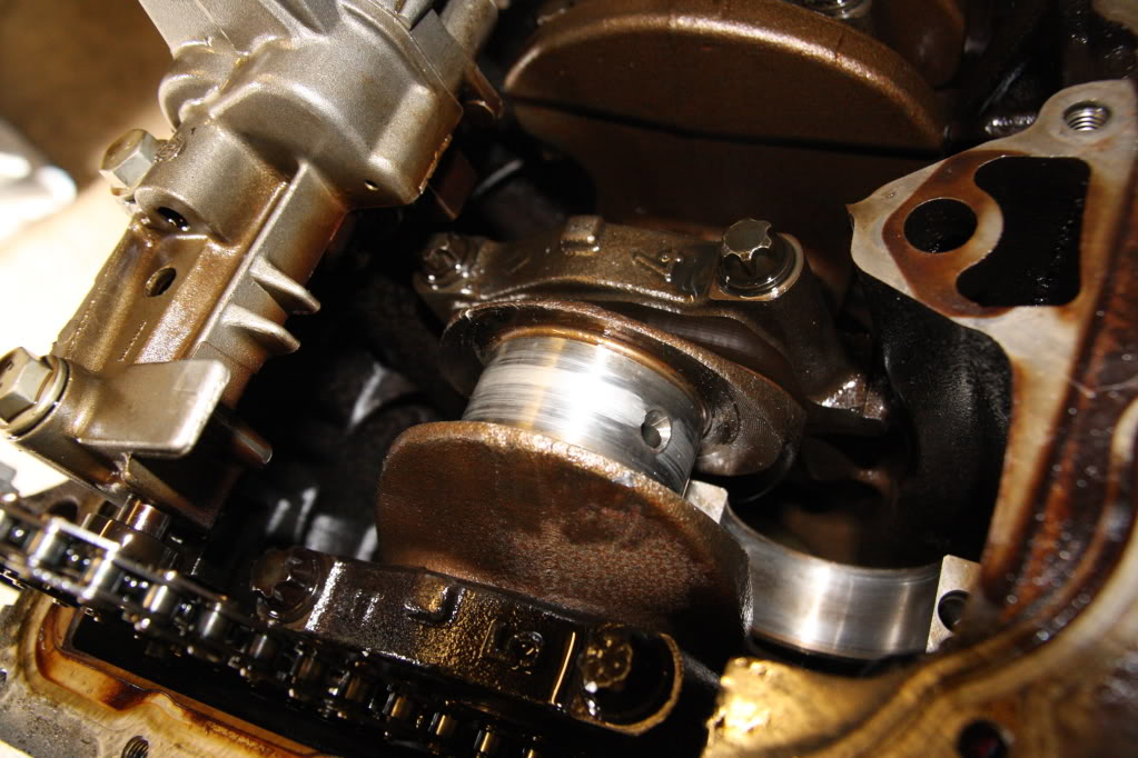

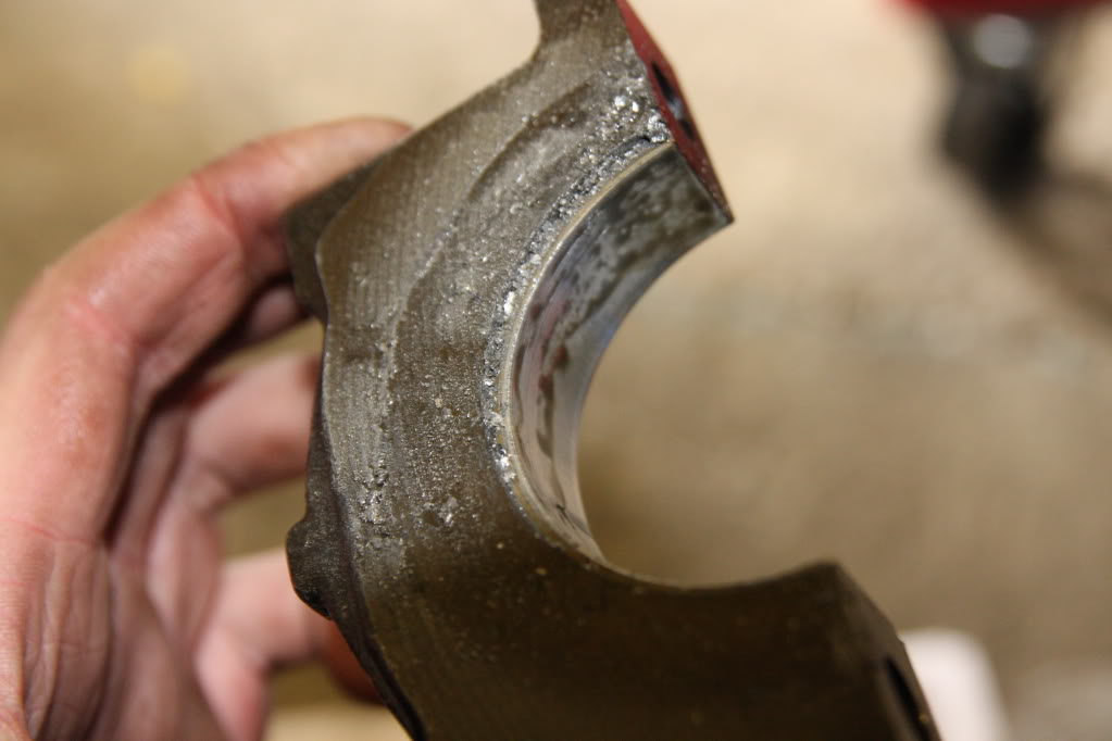

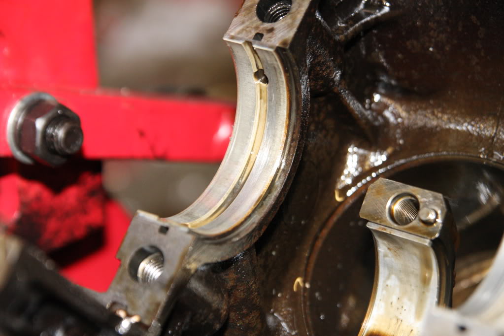

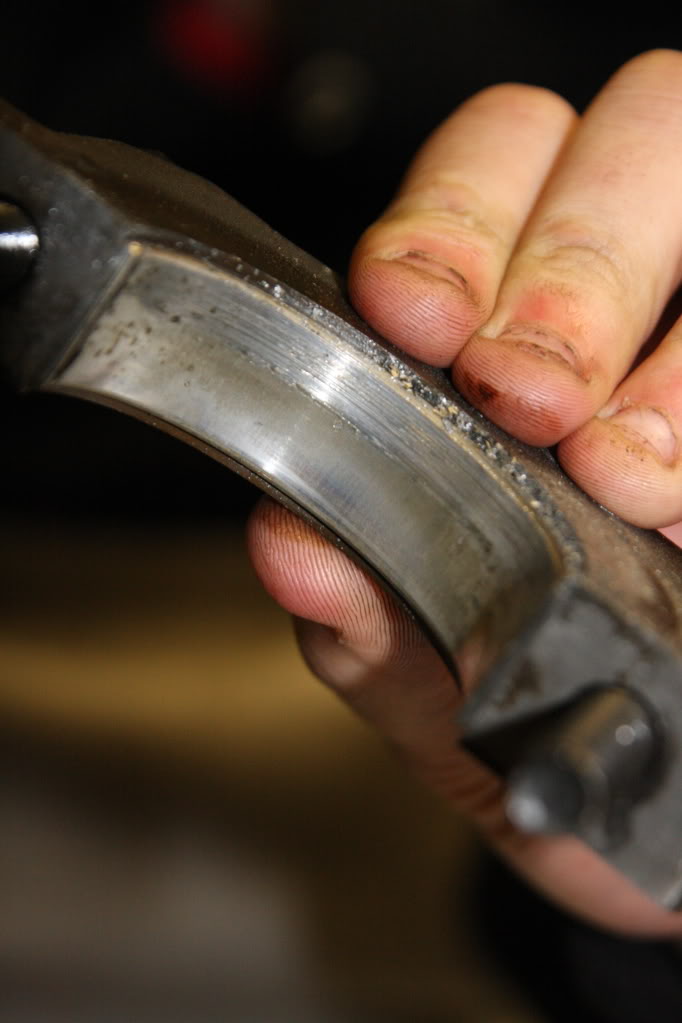

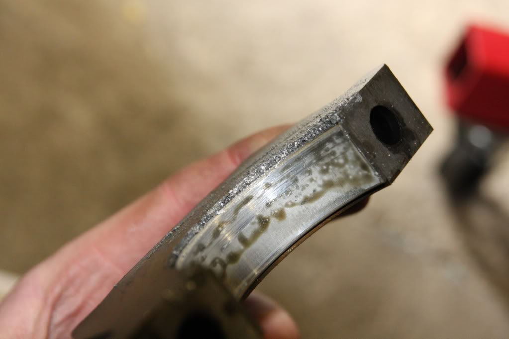

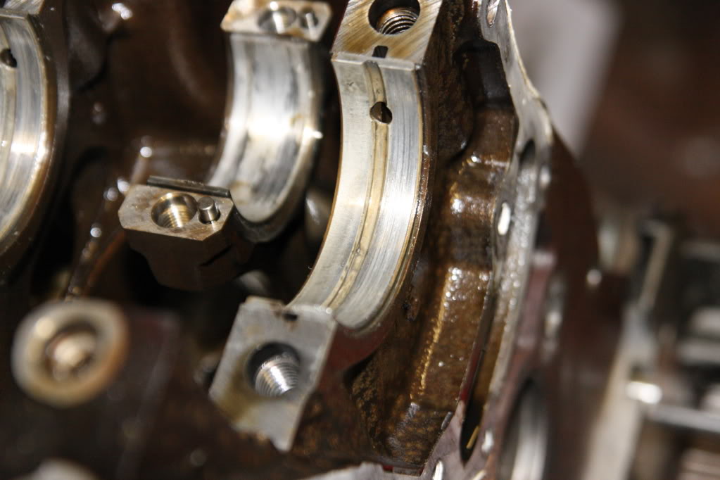

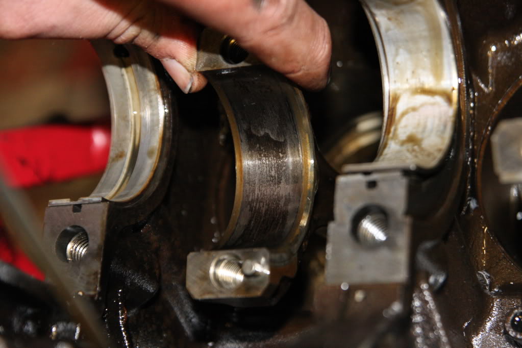

Cylinder 1-2-3 (from flywheel end) are all perfect, not a mark on them, re-oiled both sides of the bearings, refitted....didnt check cylinder 4 yesterday as i thought if 3 are ok the other would probably be the same....

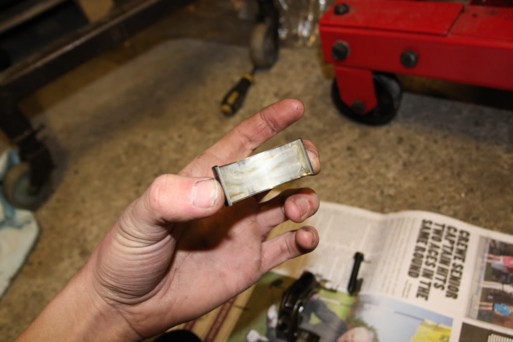

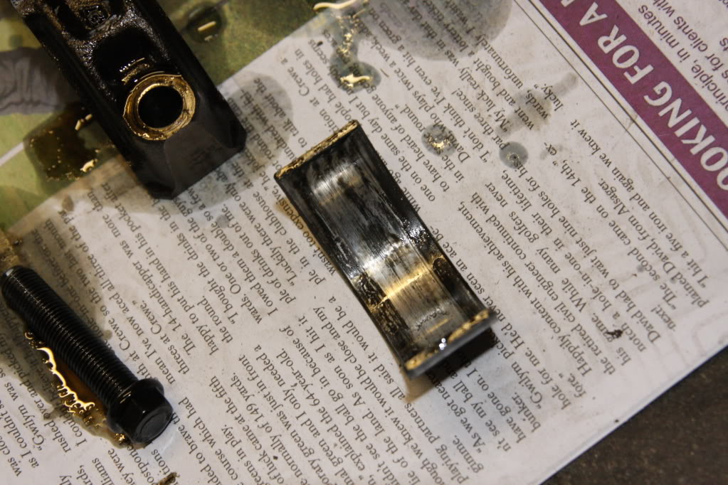

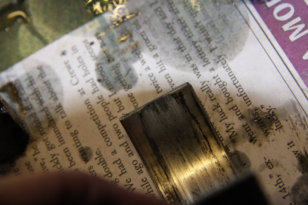

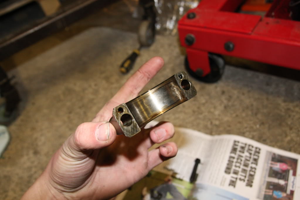

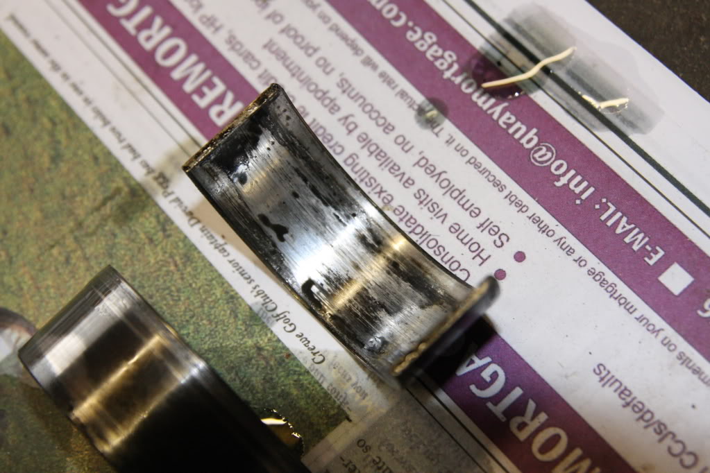

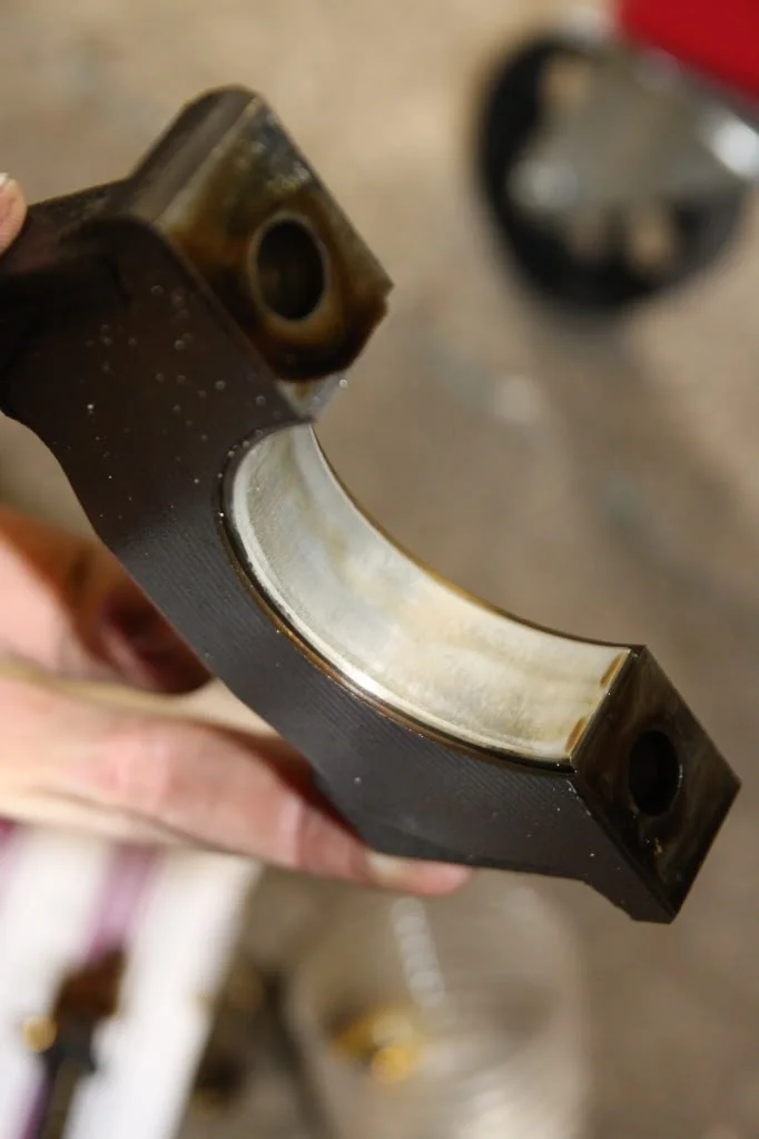

Took the cap off rod 4, to find the bearing had moved round slightly, when i removed the other caps the bearing came off with them, this did not as it had spun round...Got them off anyway...
And some wierd lip...
ive no idea, lol
going to take the big end caps off when I go back down there now....will see what they are like
  ValverInBits
oh dear mate. Its a bit hard to tell what im looking at as im on my phone. Is that a big end bearing thats spun? Either way its going to be a new crank at least. Good luck with it jord
  TVR Cerbera
oh f0xy that's exactly what happened to mine, spun bearing. rod looks ok, but you may need a new crank! you'll have to get it machined with bigger bearing to suit if the crank is ok. best start ringing round breakers to get a new secondhand crank.

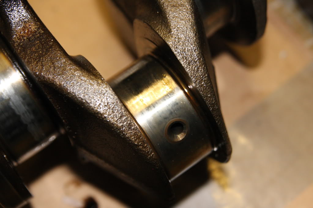

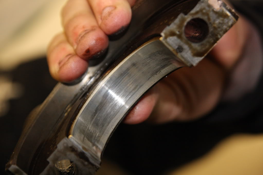

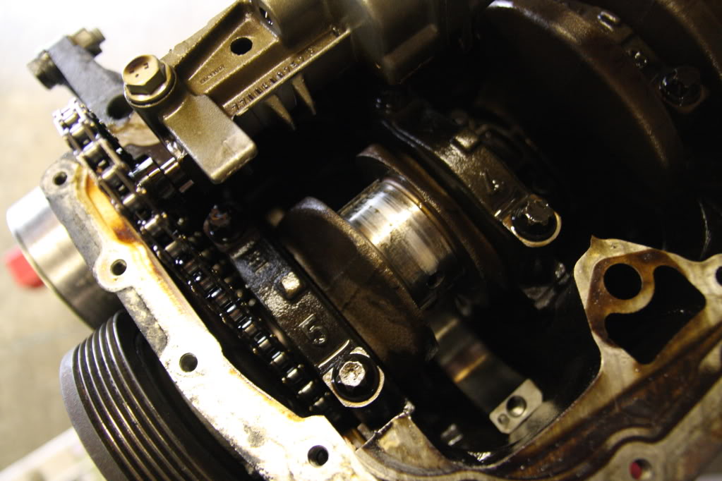

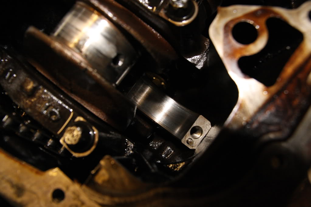

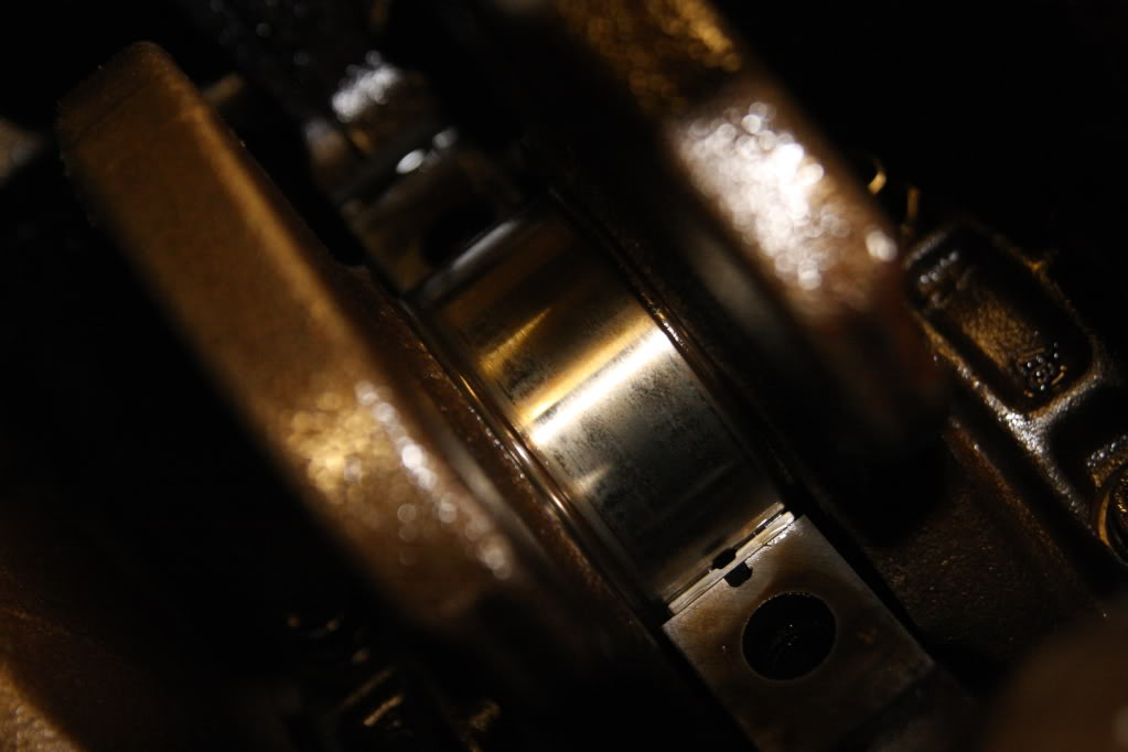

It was a piston bearing that had spun, i hadnt had any of the crank ones off at that point....

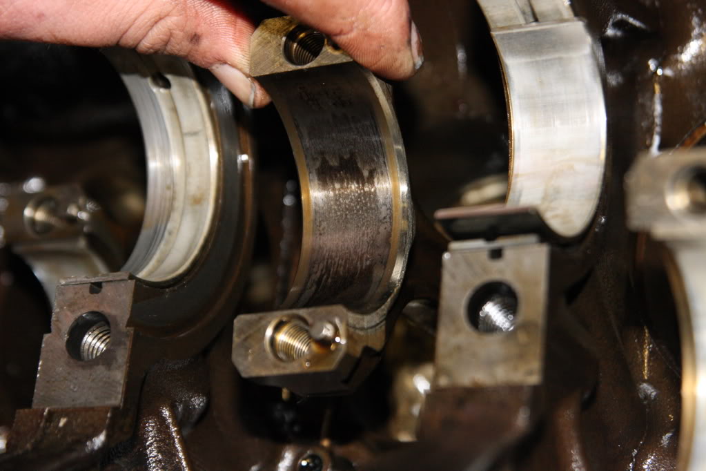

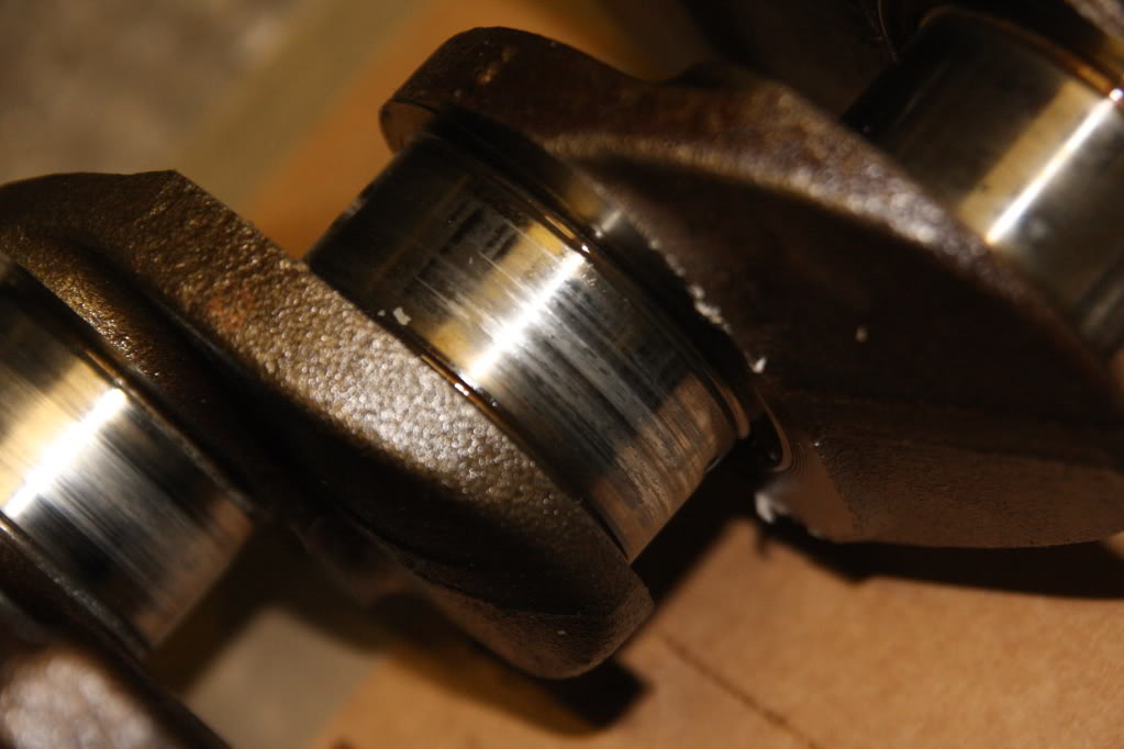

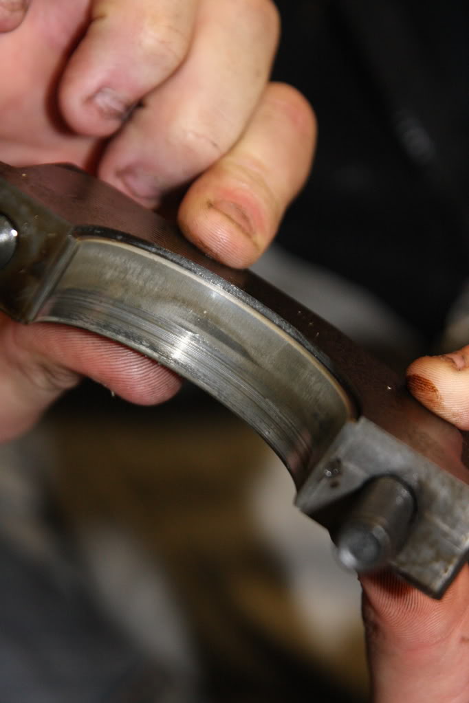

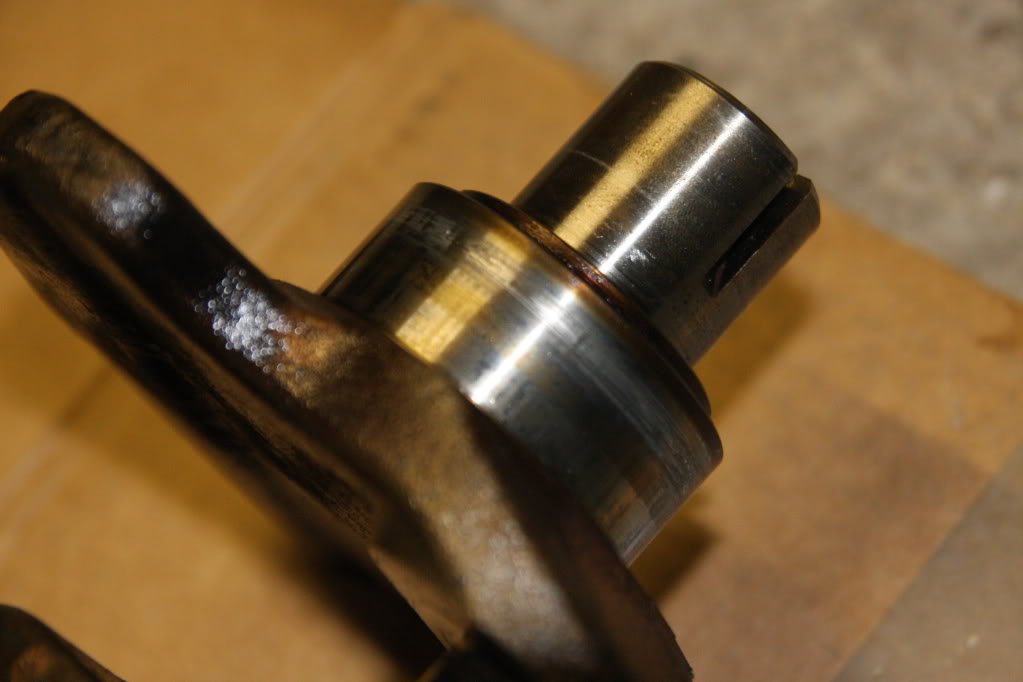

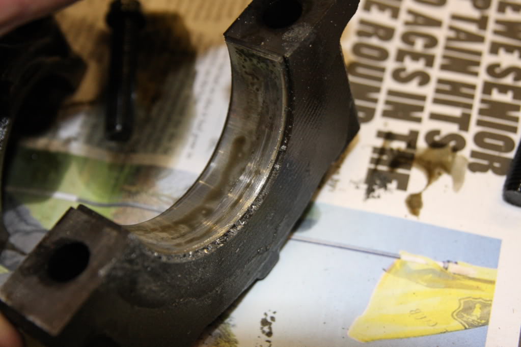

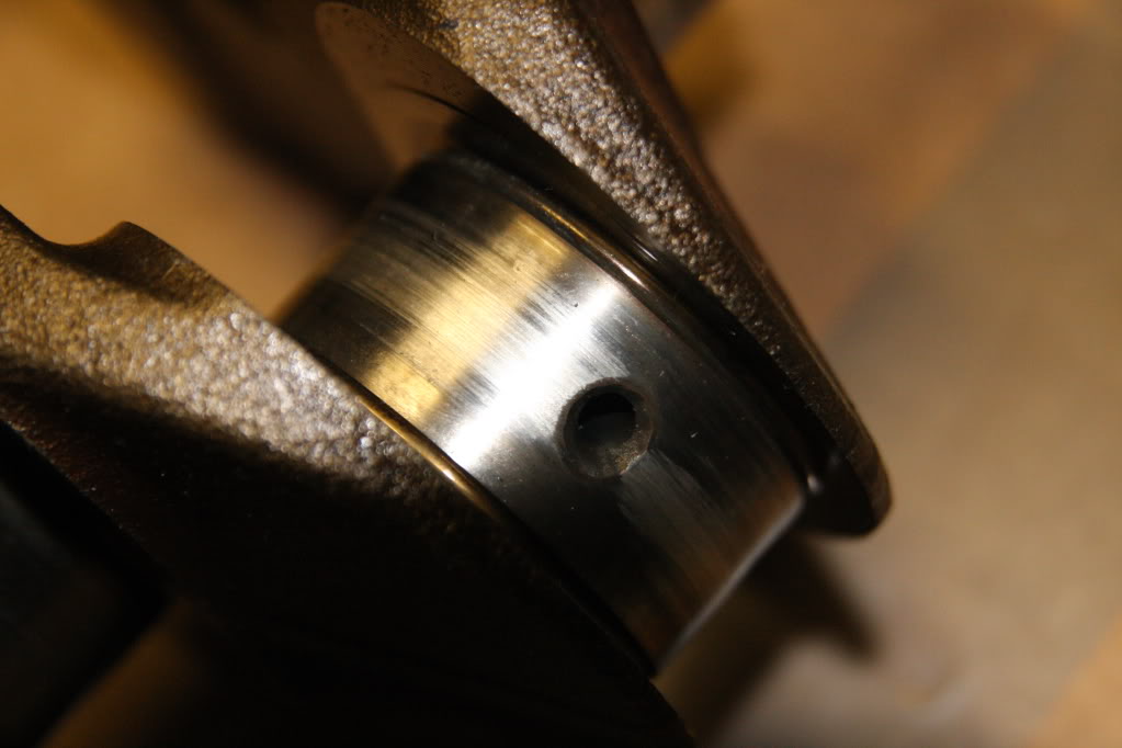

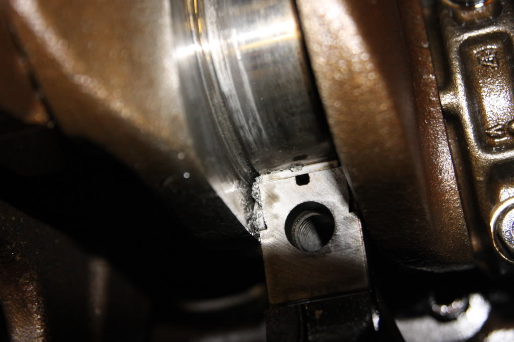

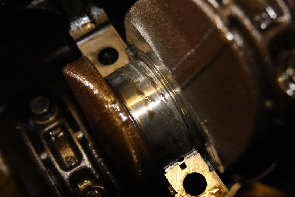

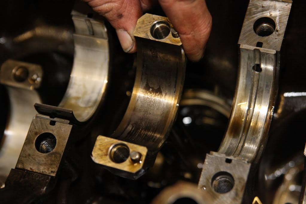

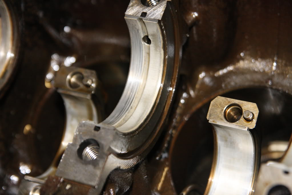

but anyway....took bearing number 2 + 3 off the crank....il let the pictures do the talking...
And number 3, no marks whatsoever?
  LY 182
yep spun bigend thats what i thought,,,
rod will be nackered (will need bore gauging and poss reclaiming)
(they take a layer off the flat surface of the main cap, then rebore the journal)
crank grinding then oversize bearings,, and thats if you can find them,, which i couldnt

the big ends are the ones going onto the block arent they, the rod bearing was spun, not the big end........
the bearings were still in place on the crank-to-block, just scored, they hadnt spun....

nope, bigends are the *big ends* of the con rods,,, small ends are the piston gudeon pin.
main bearings are the ones that hold the crank to the block
ahhh right....well i took the shell/bearing out of the rod and it was the same as the rest, not scored/marked in any way, its just the internal (crank) side of the bearing....

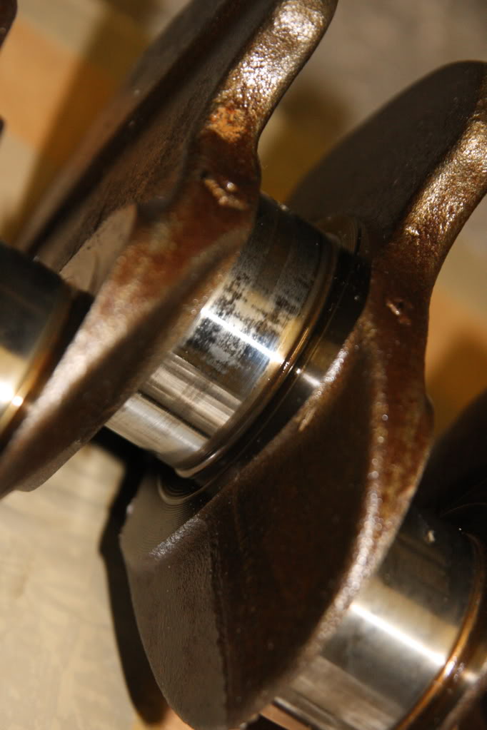

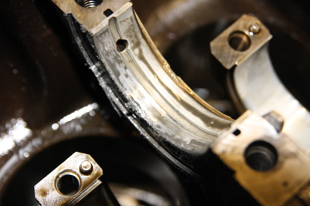

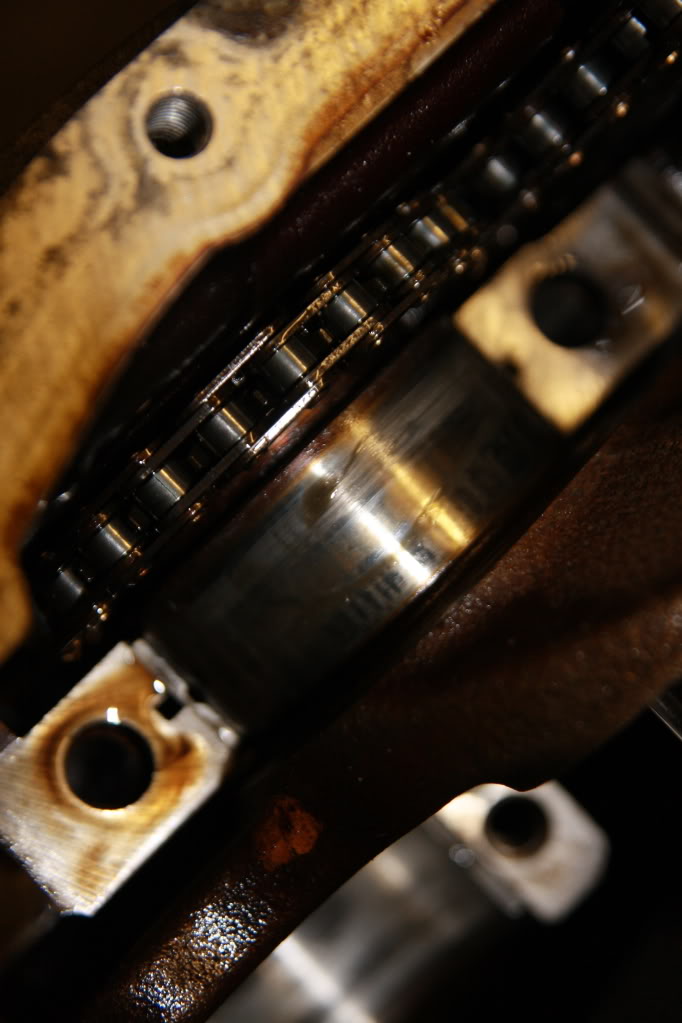

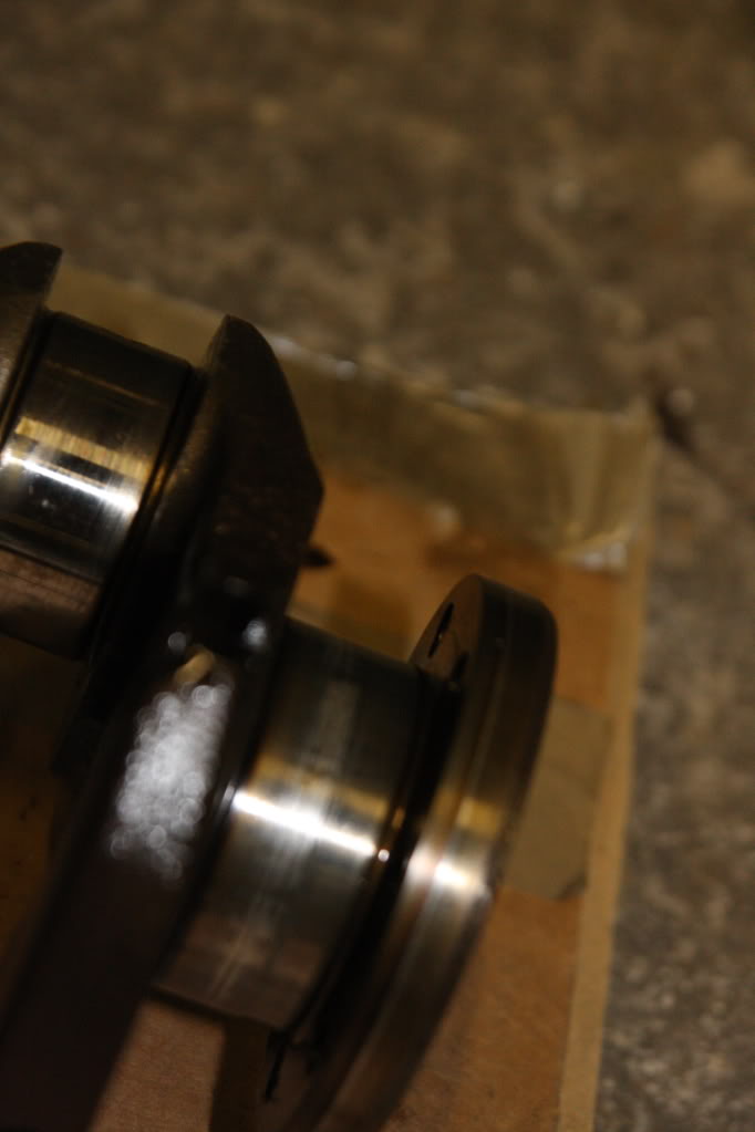

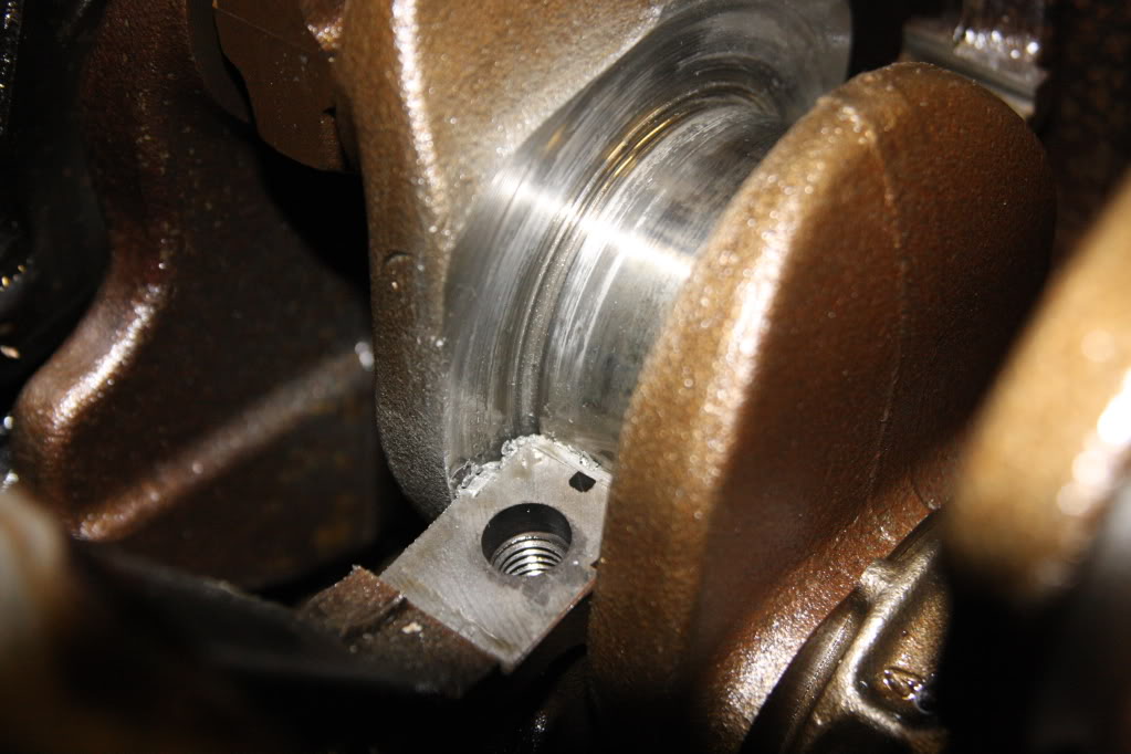

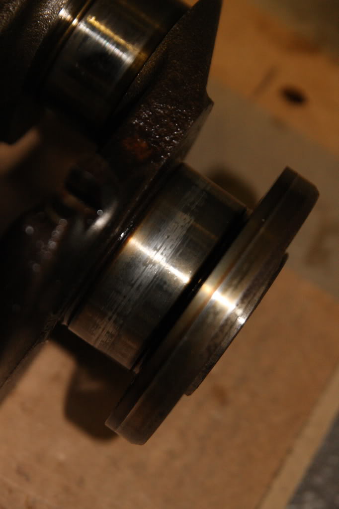

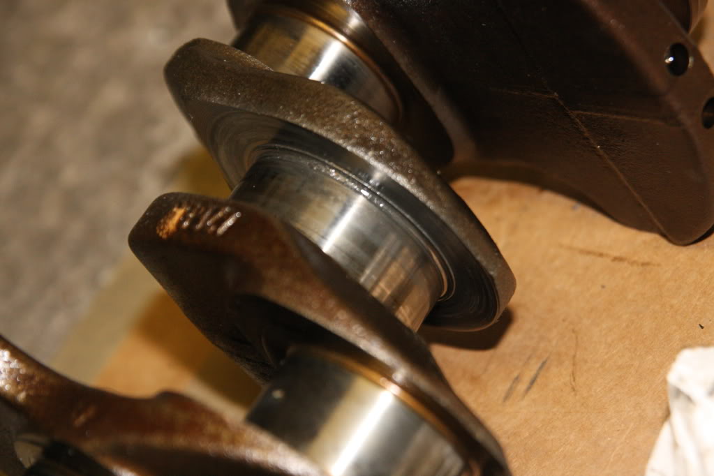

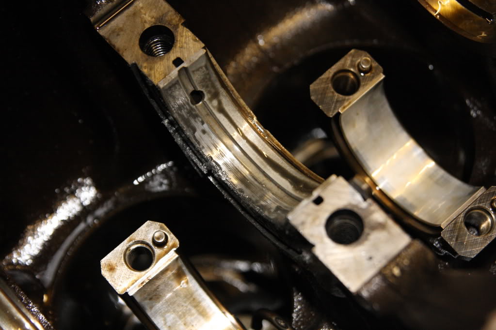

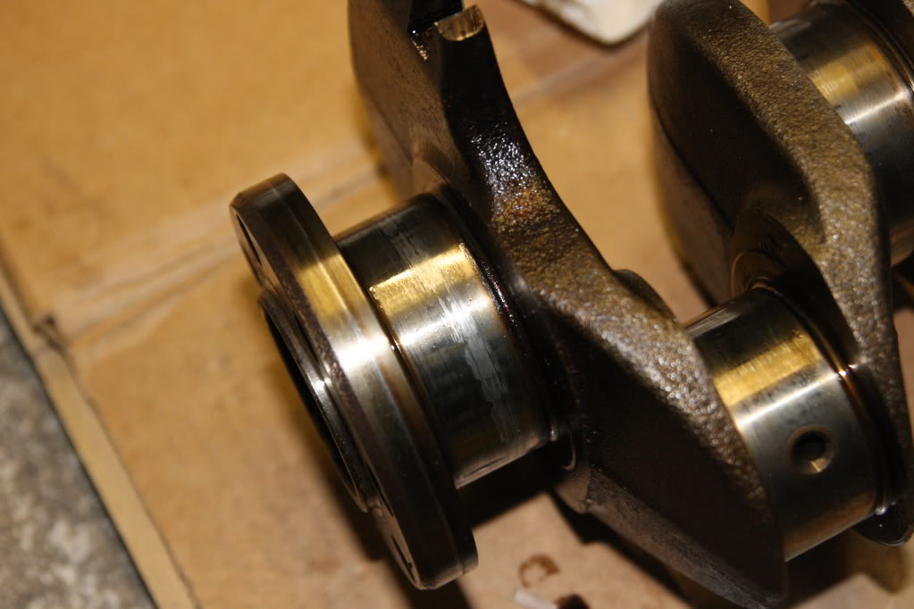

the crank is now out, more scoring and i think the problem has been revealed....pics uploading now

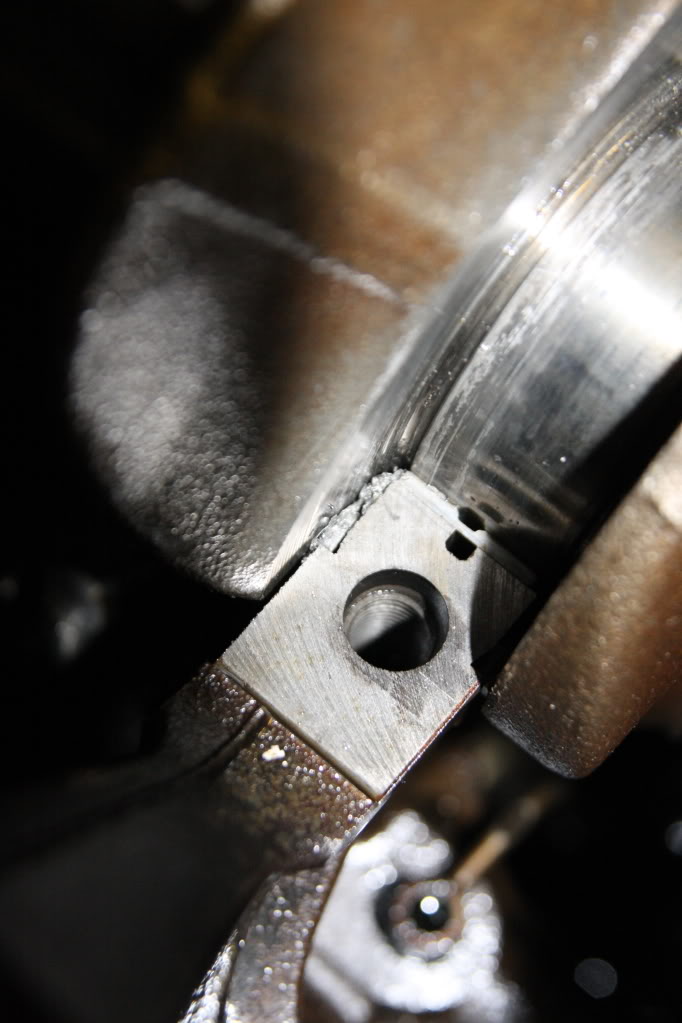

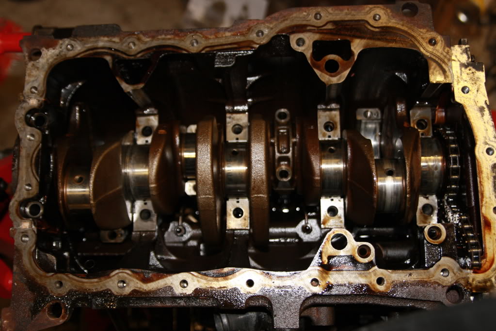

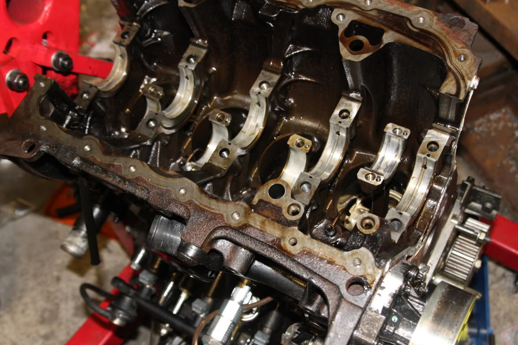

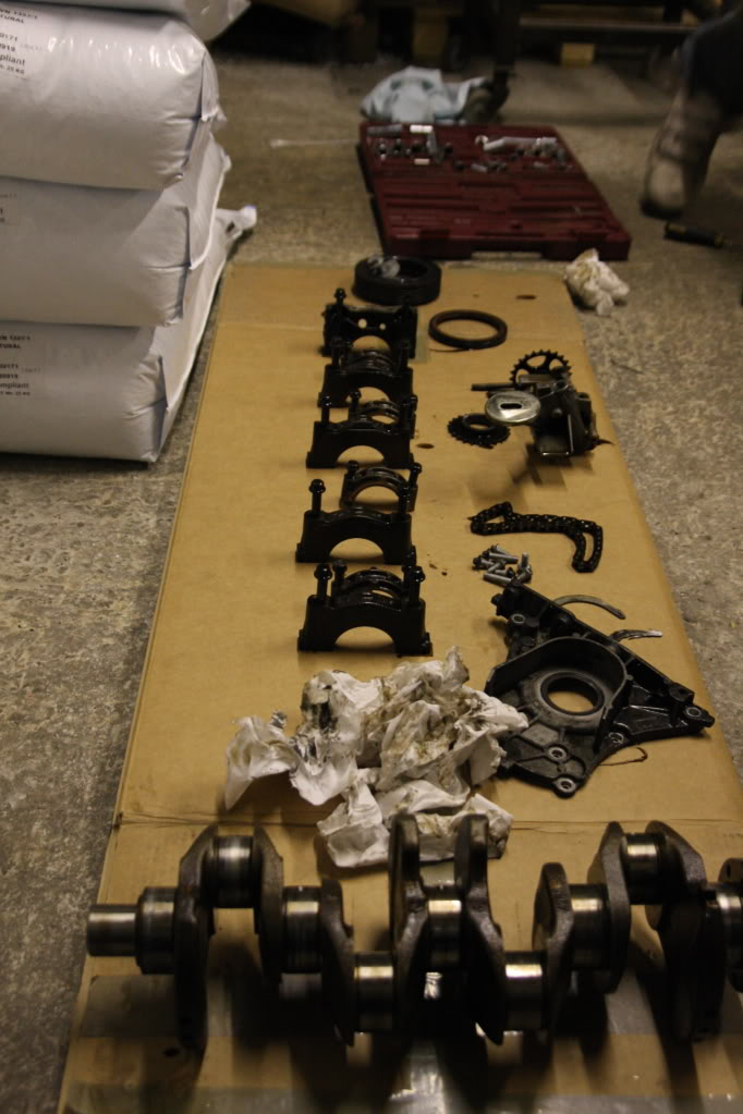

Right....all bearings and oil pump removed...
Crank scoring...
Crank removed...

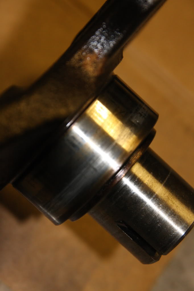

The crank itself...
The main cap's for the crank...
Now the rods with the shells removed...

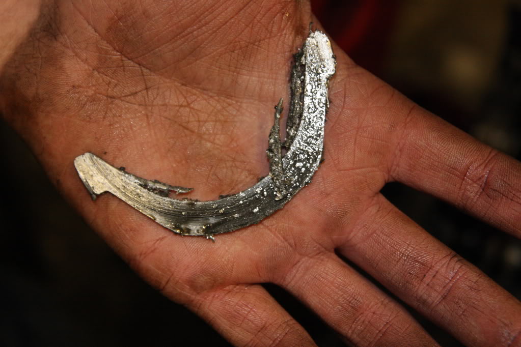

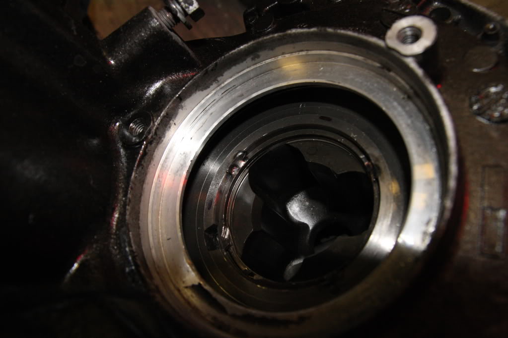

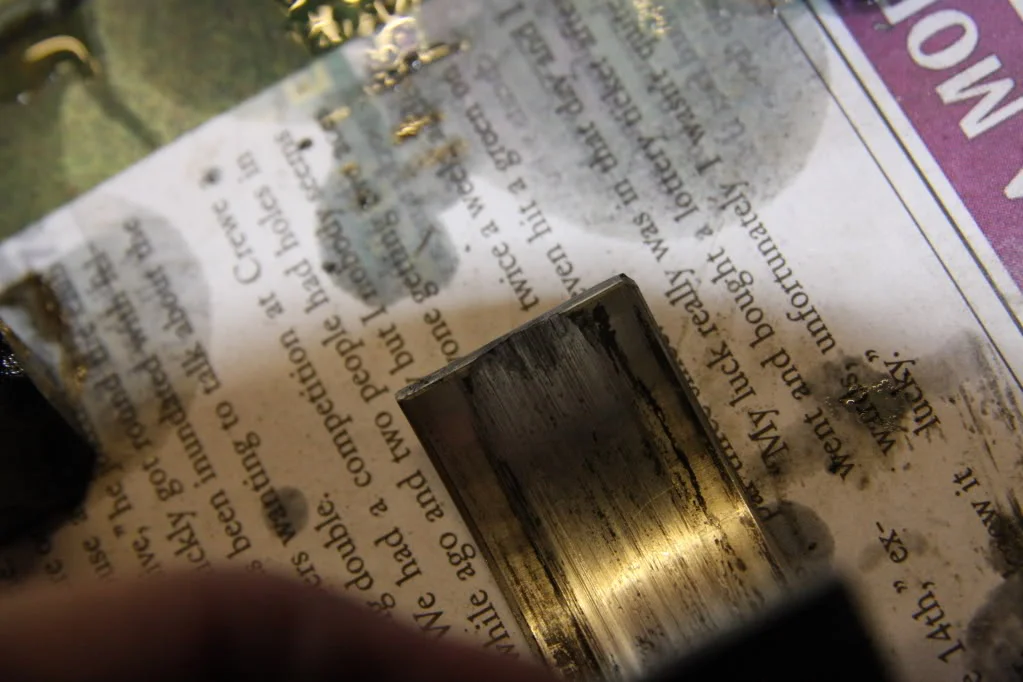

Maybe the culprit....thrust bearing falling to bits?
All the crap...
And finally a pic of the finished manifold and downpipe :)

That thrust bearing is shagged! You could get a second hand crank but the rods and shells wont have the right tolerances. Yeah, it'd work but it wont be long before its back out again. Send the crank and rods to a machine shop and get them to face it and fit new shells as you'll need oversized ones. Do it properly, do it once.....
