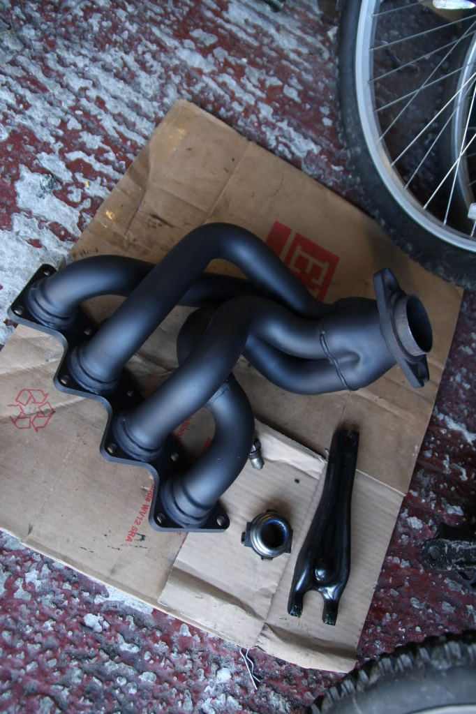

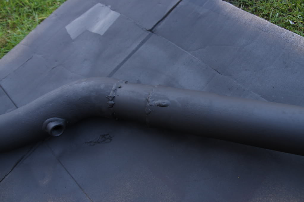

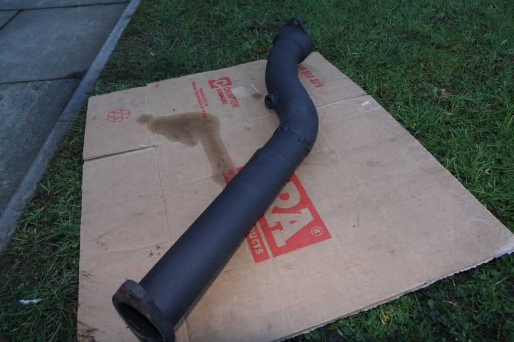

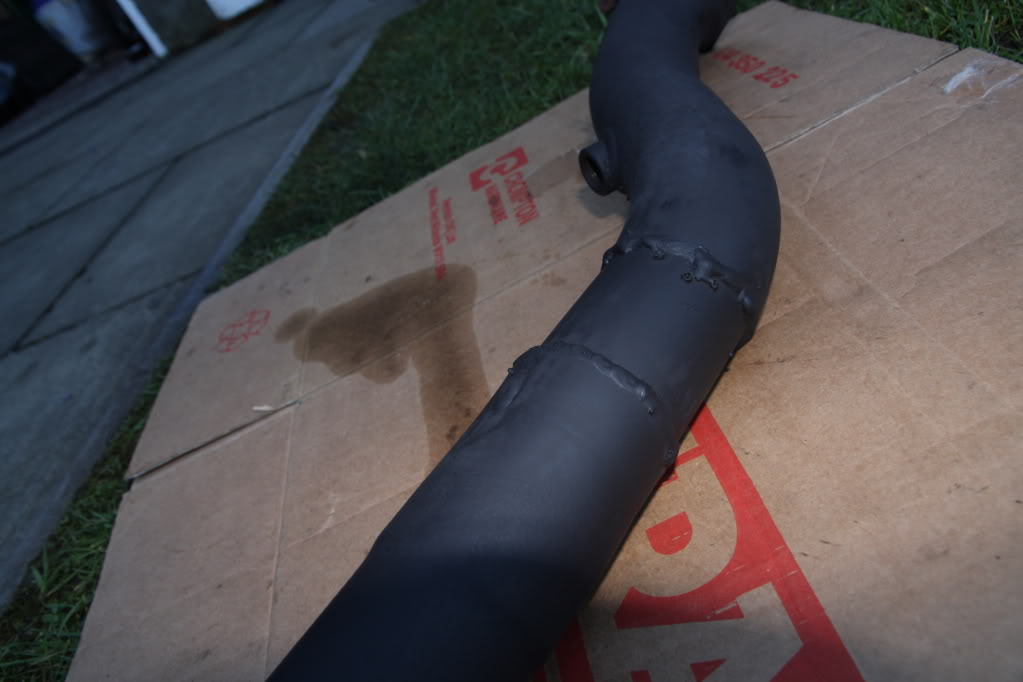

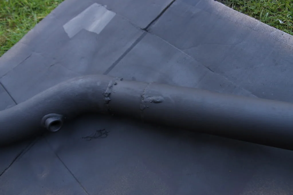

After fitting the downpipe and setting the length when the engine was in, I had the 'adjustable' bit welded up...Then I painted it with high temp paint, along with the manifold itself too...
Also dropped the gearbox off to get the circlip welded into place...hence why the fork and release bearing are in that pic...

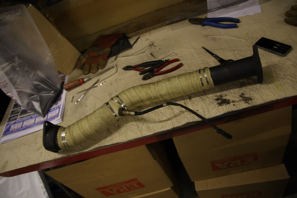

I had some exhaust wrap left over from when I did the williams manifold and downpipe for the F7R, so decided to wrap the downpipe with that, and Im going to get some more to do the manifold itself too. Once i had wrapped it, i realised there wasnt enough to do the complete downpipe, lol...so going to have to add a short bit when I get some more to do the manifold...

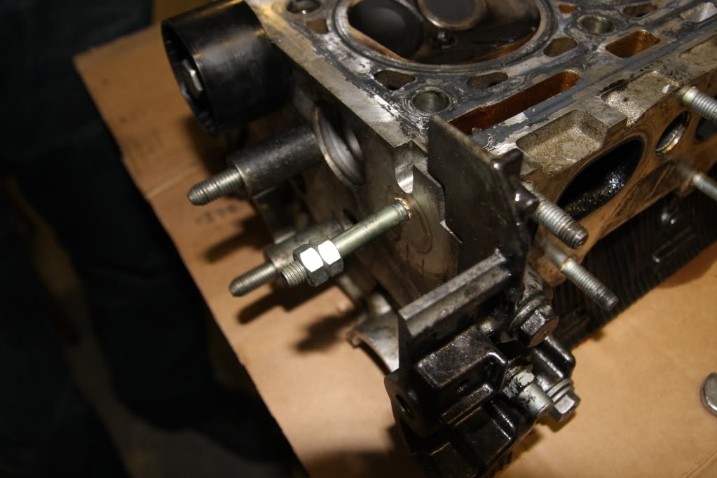

Next, went back to the factory to get the head off the engine...yet more fun. Didnt have the cam locking tool to get the pullies off, so improvised with the old cambelt, a bit of force and a few people. Cracked the exhaust pulley off after a few attempts, and then removed the cam cover with the inlet cam/pulley still 'attached' to it, such a GAY design. Gona have to get that pulley buzzed off tommorow.

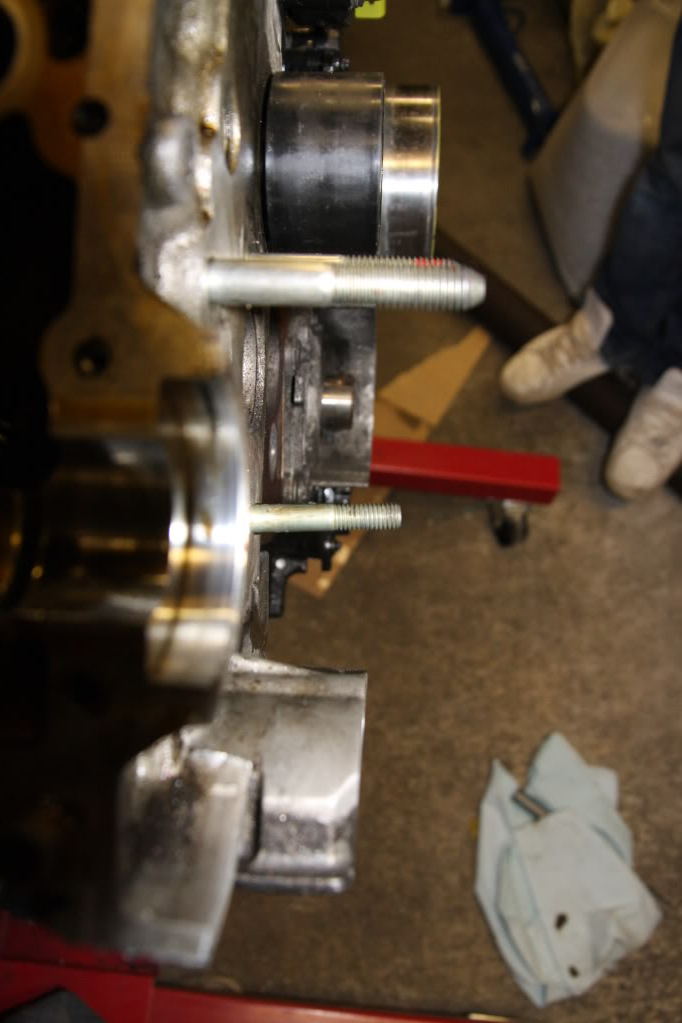

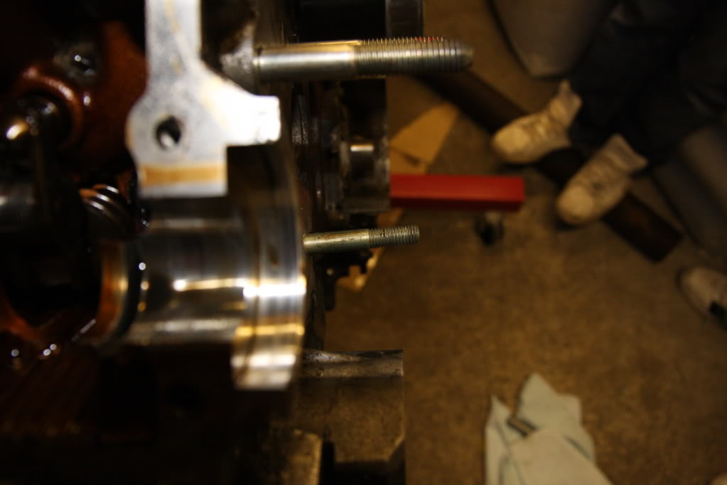

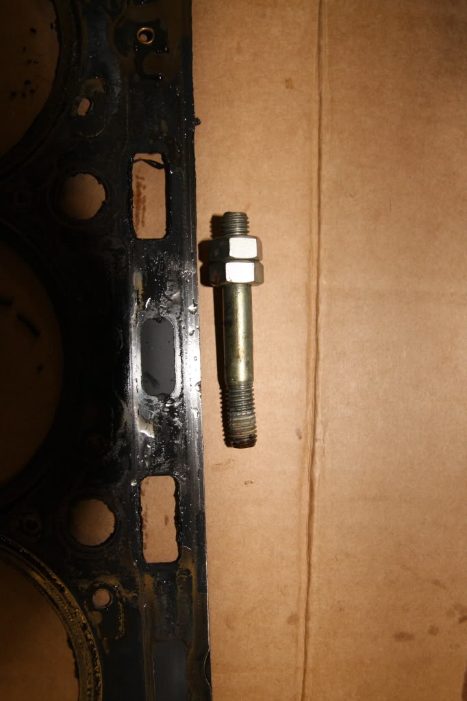

Anyway, looking around, noticed a problem...one of the studs had bent...think it was when we had the cambelt in place round the exhaust cam using it to get the pulley off :(
Anyway, Matteh to the rescue with the part number for a new one, off to renault tommorow...meh.

should change your name to 'Issues' mate. Just wondering, why did you paint the manifold only to wrap it? Is it really easy to do the heat wrapping?
Re: Mk1 Hybrid Project
lol, issues indeed.
I painted it so its a clean surface for the wrap to go over, I was told by a few people its recommended to do so, so if water gets into the wrap when its on the car, and its sat in the wrap, it dosent start rusting the exhaust inside....
Wrap is pretty easy....wet it, start at one end, make sure you keep it tight, then use stainless ties. When it dries it gets tighter...Then i spray it with some silicone heat wrap sealant to keep all the crap out (double precaution)

doing the timing with the tools, well im not, someone who has timed them up before is...
Just wanted to get the head off, so had to improvise.

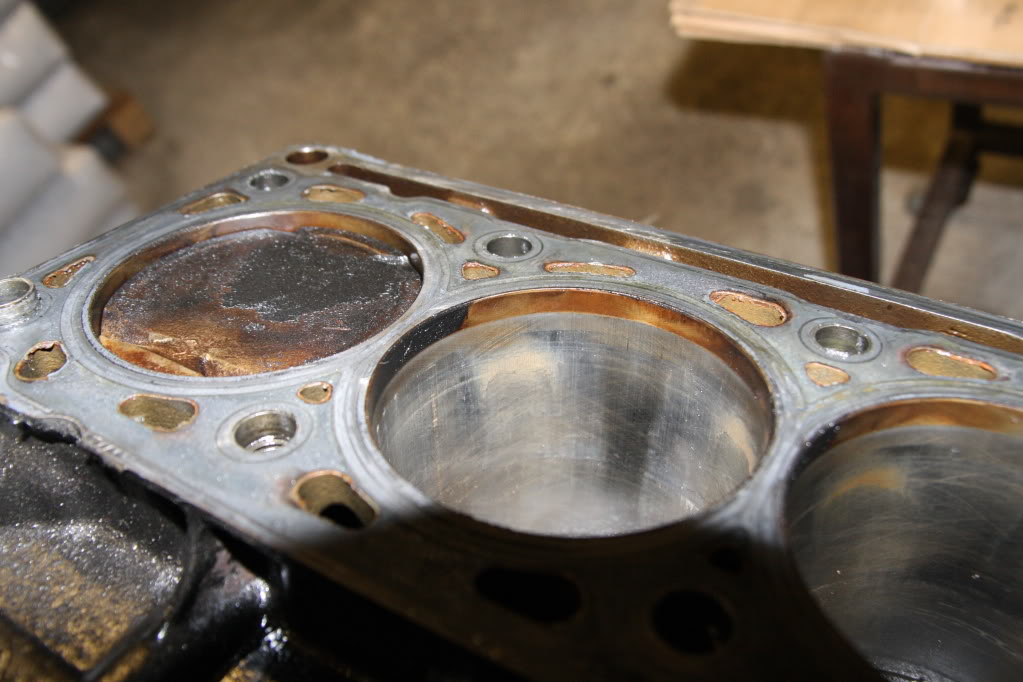

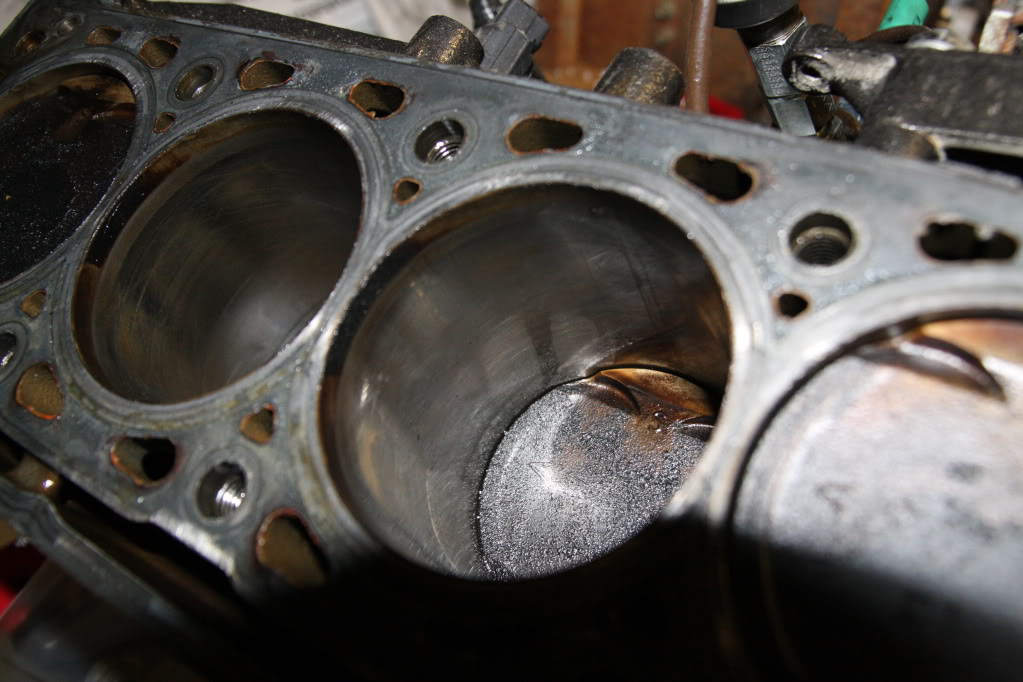

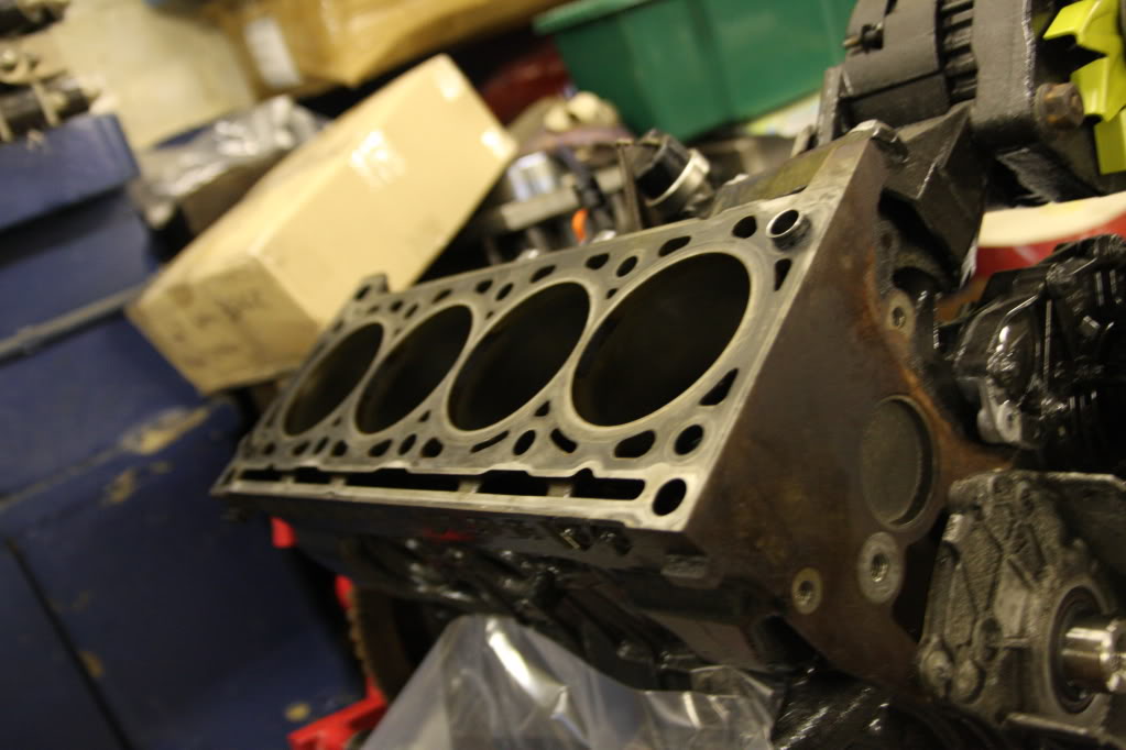

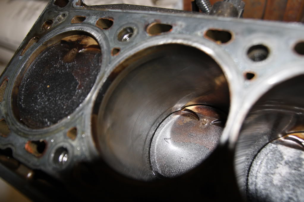

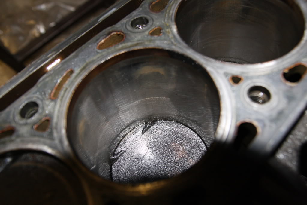

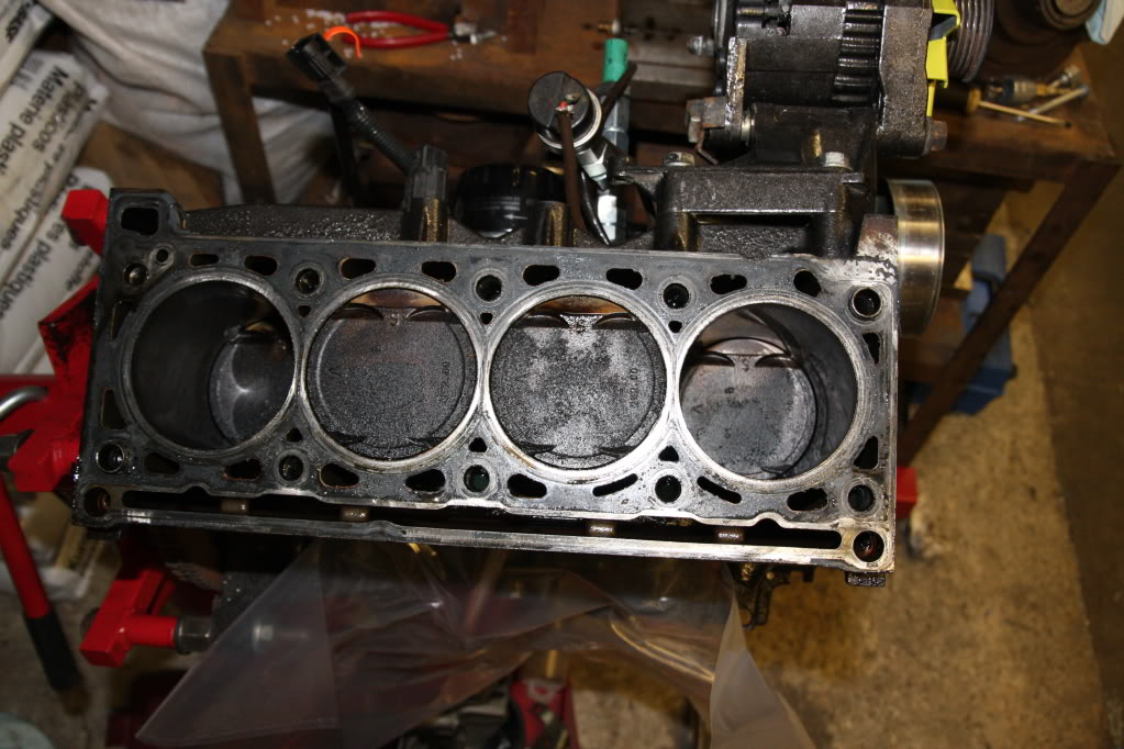

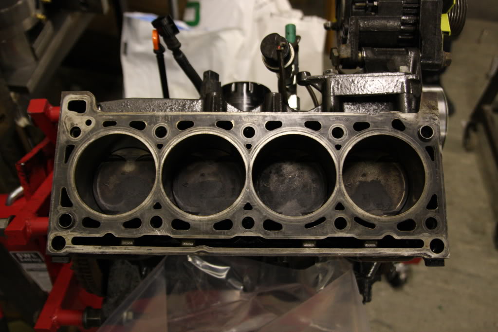

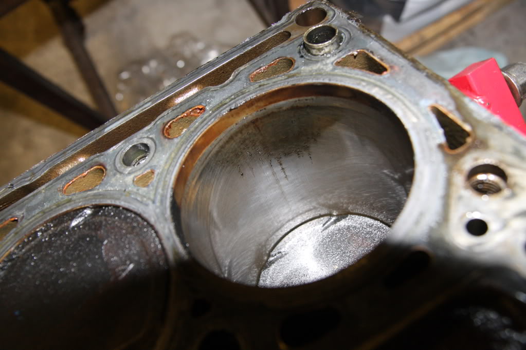

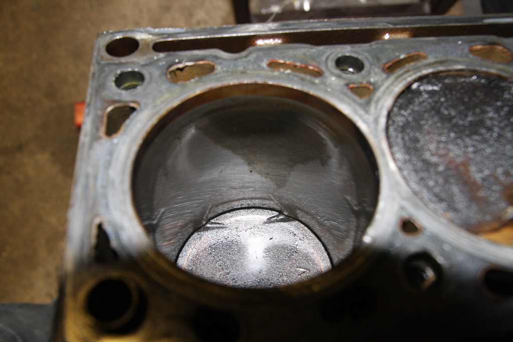

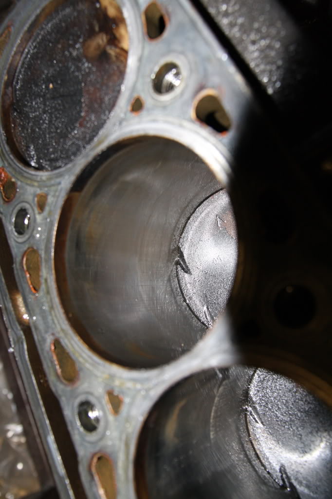

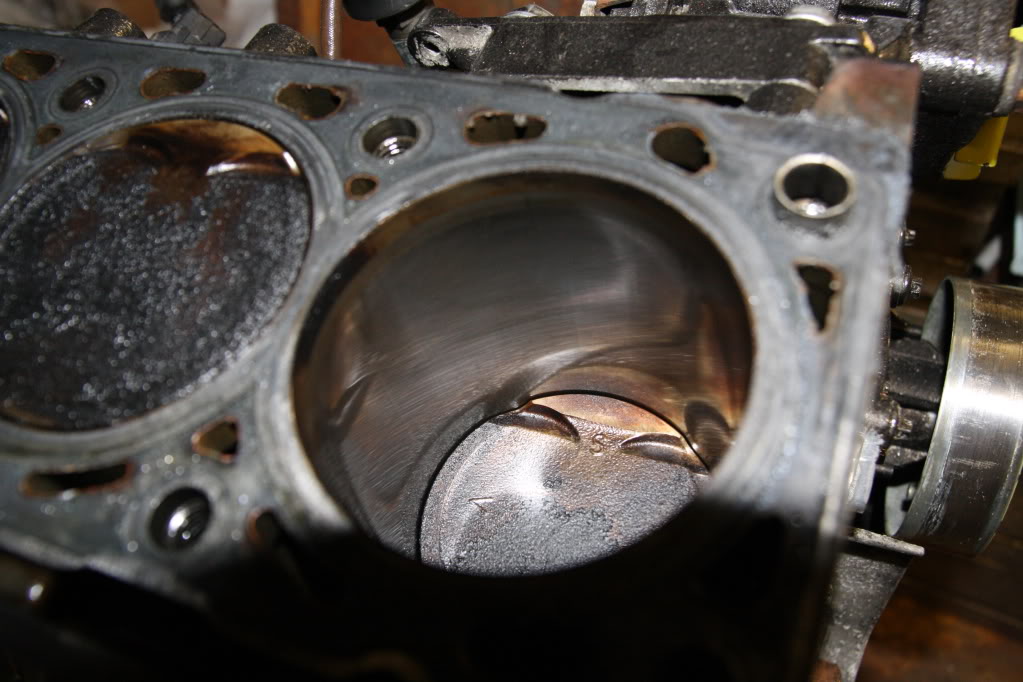

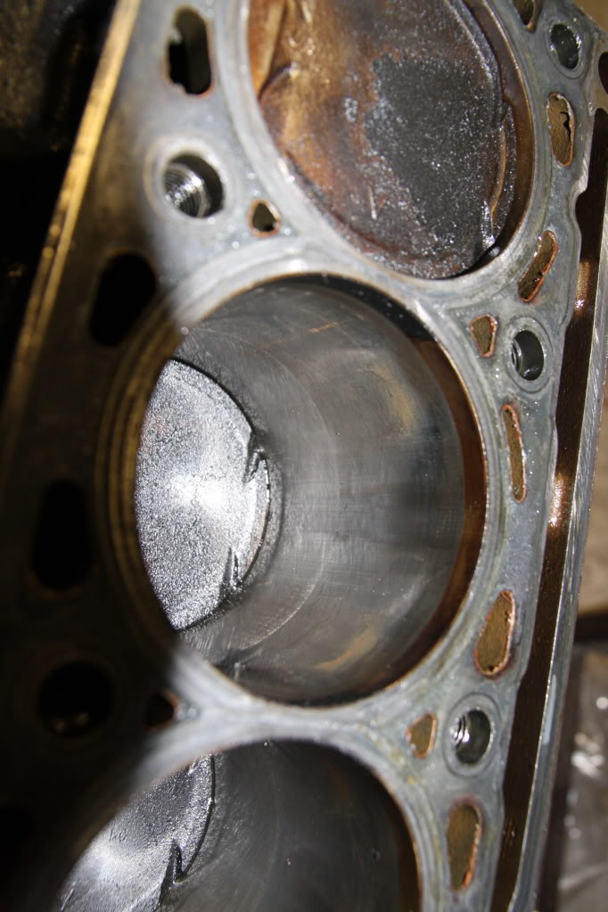

Heads off, turned it over by hand...seems OK. Got some pics of the bores, do they look ok?

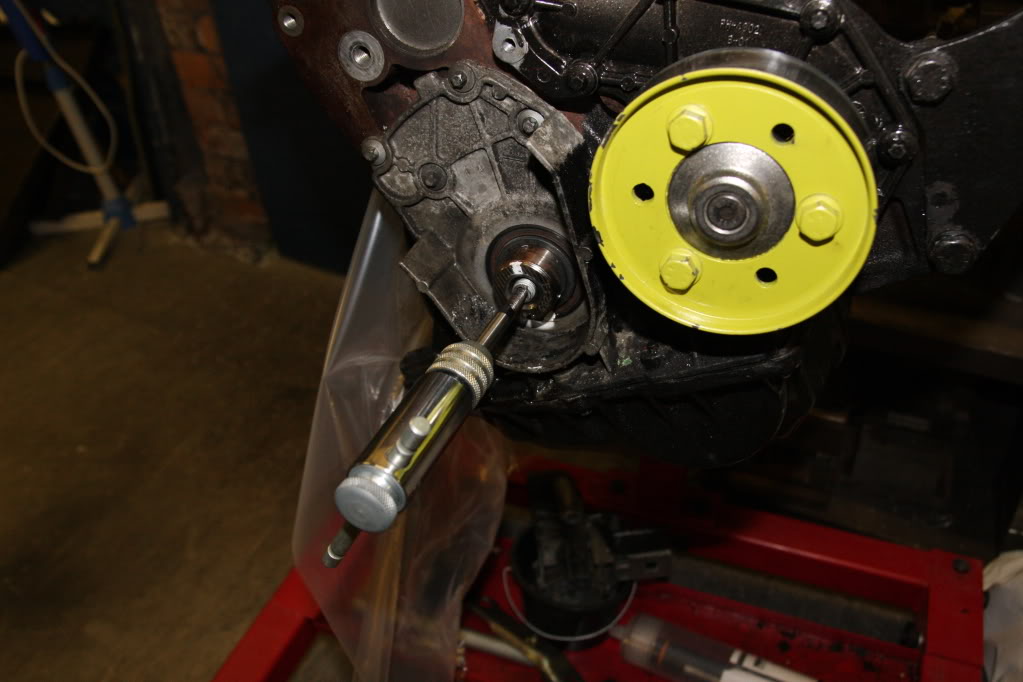

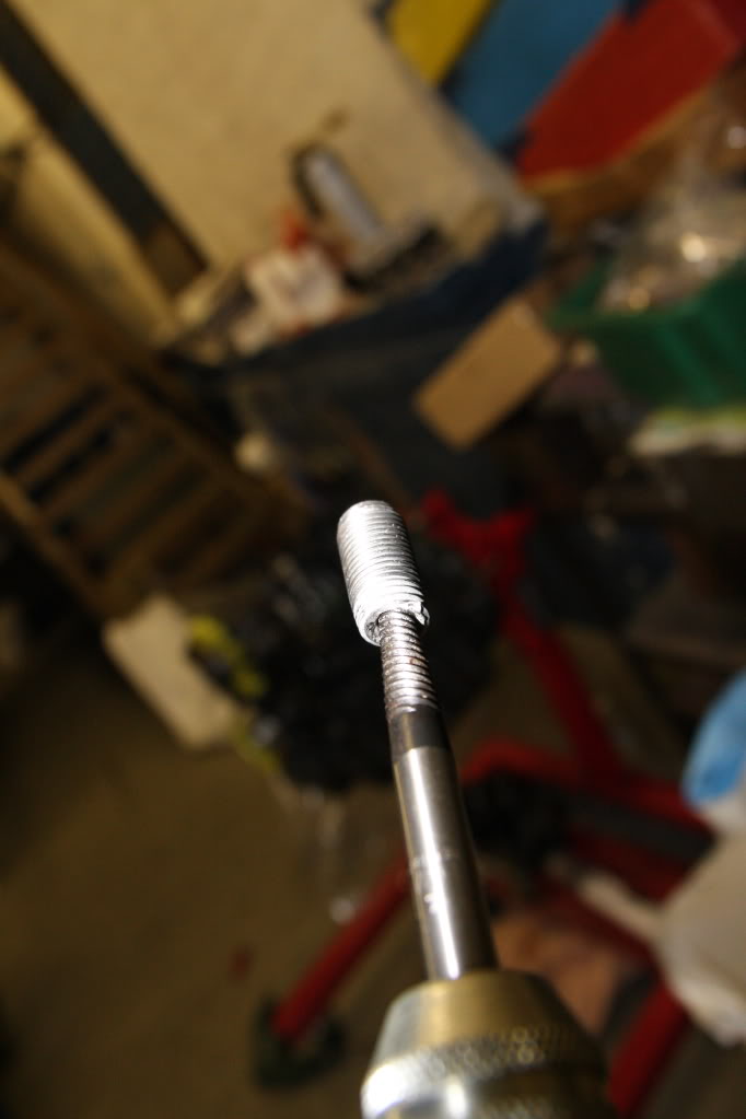

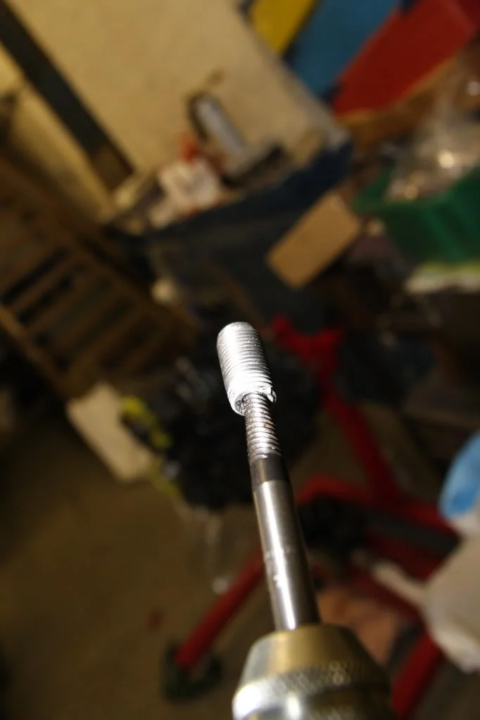

Drilled pilot hole on the snapped crank bolt, then bigger hole, then used winstons thread extractors which failed....Got some heavy duty extractors and it came out pretty easily :)
Next up, the bent stud...

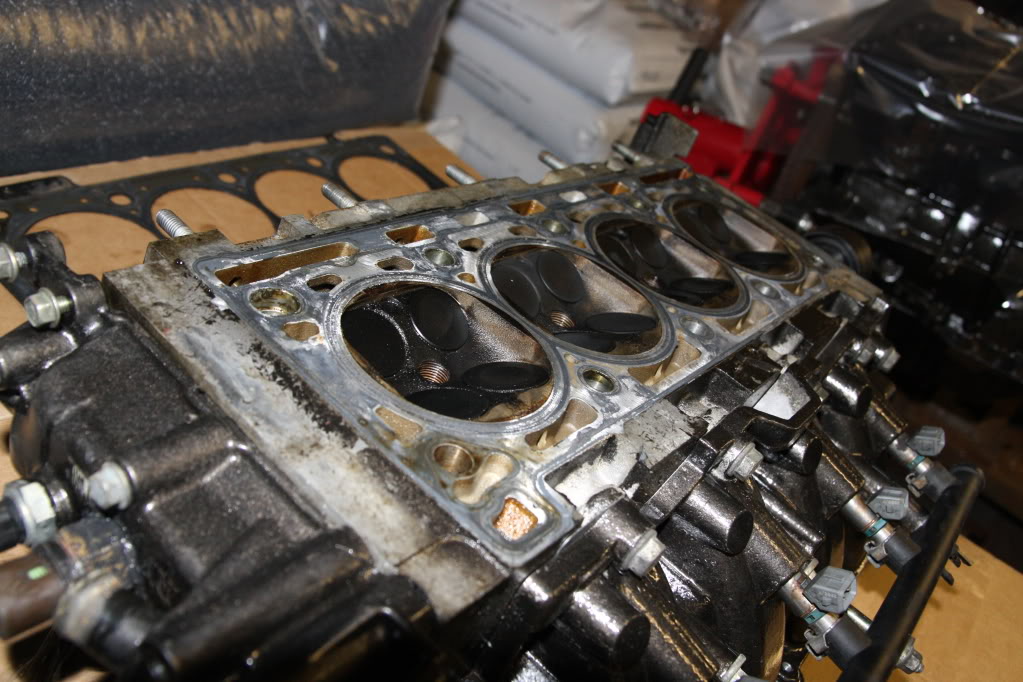

Sorted....then cleaned up the head and the block....

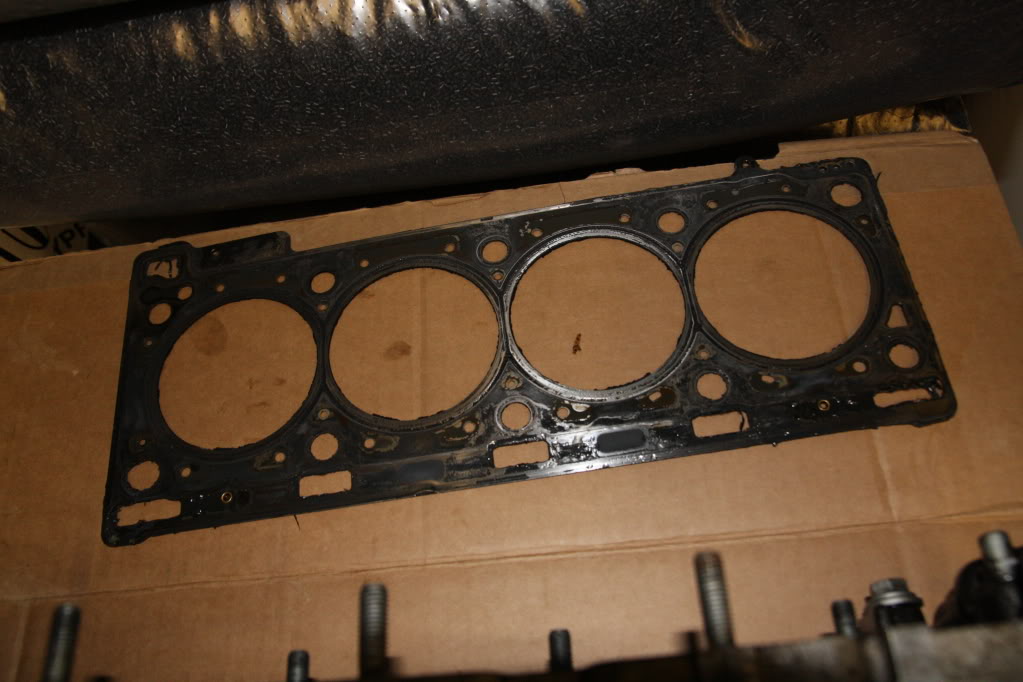

Also picked up new cambelt, new headgasket, etc....

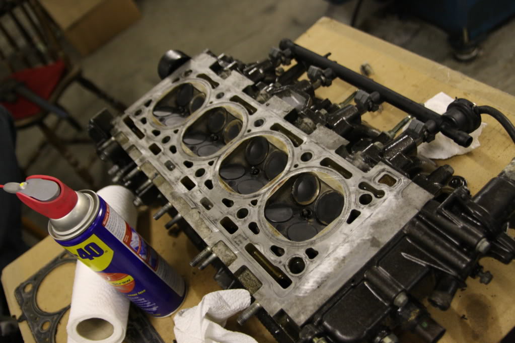

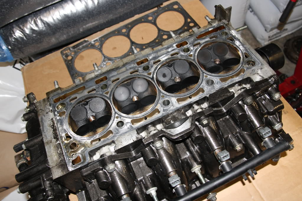

have done with a steel rule. cant see any light though/gaps at all in any direction, even down the gaps between the bores....
None of the white spirit had gone from the bowls when I got back...valves must be reet...
Dont know if to get it skimmed or not if its flat...mehhhh
