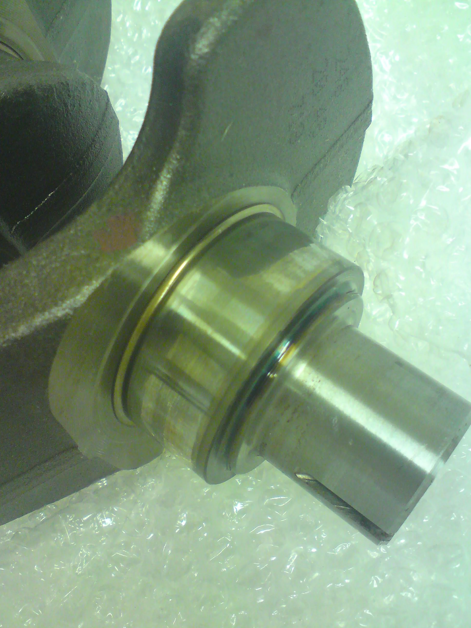

That thrust bearing is shagged! You could get a second hand crank but the rods and shells wont have the right tolerances. Yeah, it'd work but it wont be long before its back out again. Send the crank and rods to a machine shop and get them to face it and fit new shells as you'll need oversized ones. Do it properly, do it once.....
What could have caused that thrust bearing to go like that in the first place though?
Re: Mk1 Hybrid Project
Its for end float so they dont usually wear unless there is play in the main shells or a massive in-balance in the crank. He's cracked the sump and realised pretty quick when the oil lights come on and switched it off. Dry of oil, spun a bearing. I would think the thrust bearing is related to BE failure, not a seperate issue. Personally I'd get it all sent to a machine shop as second hand engines with no history are always gonna be a nightmare....

That crank looks like it might get away with a polish if the thrust face is ok (only bit i can't see) Strange failure though

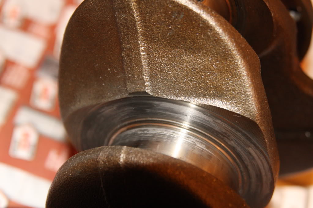

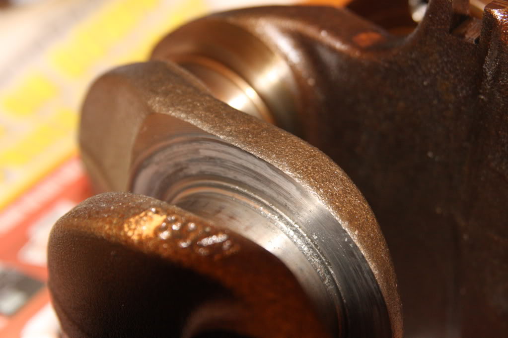

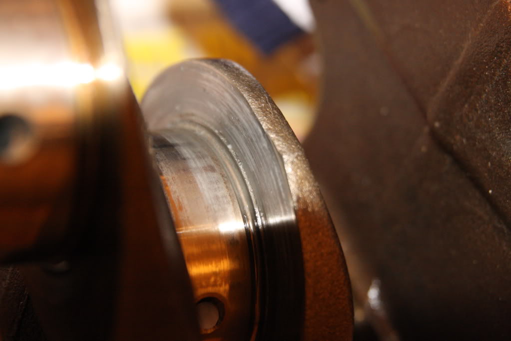

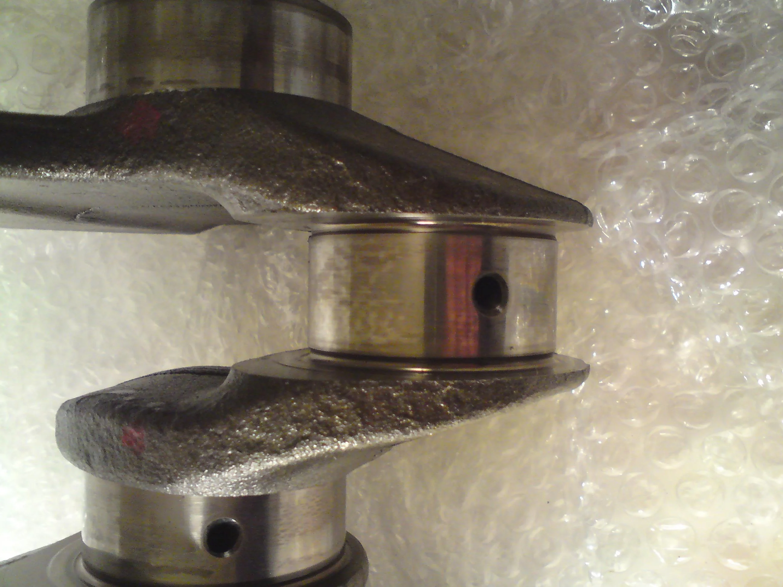

Pics of thrust bearing face (this is the side that was where the bearing had worn (along with lots of metal shavings, flywheel side one)
seen a LOT worse than that. would need machining but I wouldn't scrap that crank straight off. Be aware that the block will be full of swarf in all the oil ways, and the pump will probably be shafted too. cams ok?

a bearing failure like that means a FULL rebuild to me not just a repair job, so you're looking at a strip down and have everything properly cleaned first.
Oil pump, you can check clearances and look for scoring, but I'd go new once it's had bearing swarf through it whatever TBH
Exactly, full rebuild! Get the crank ground/faced with new bearings IMO. Always bettr than using mis-matched crank/rods.

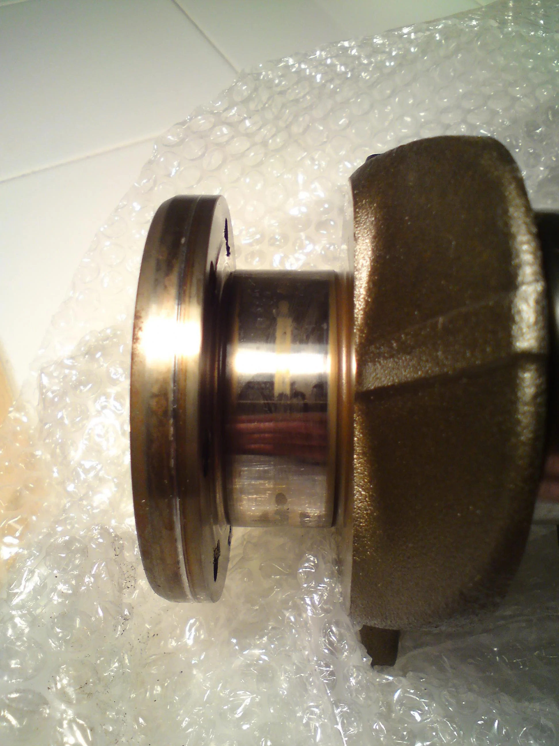

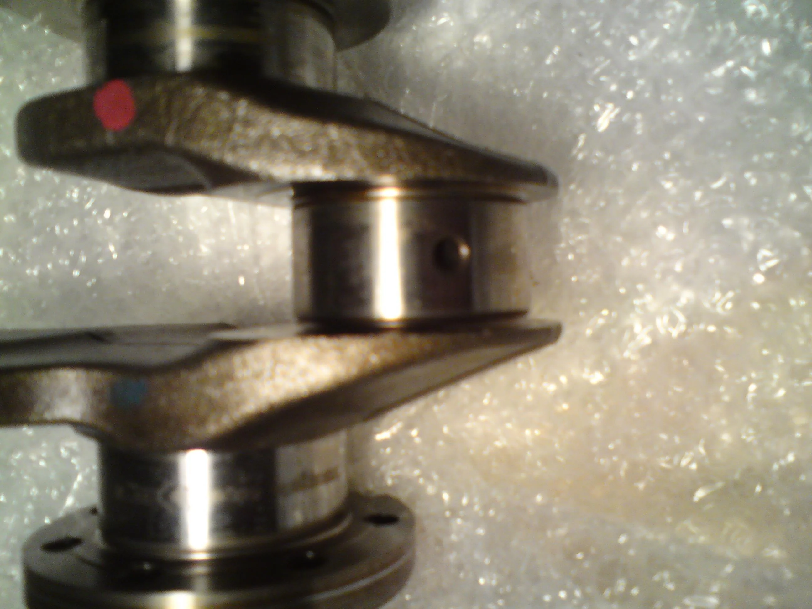

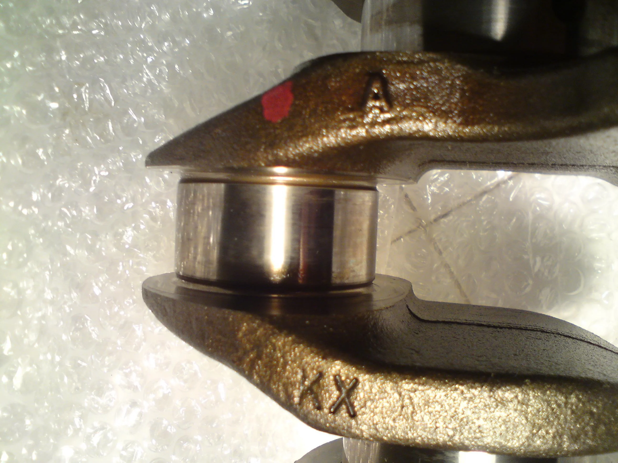

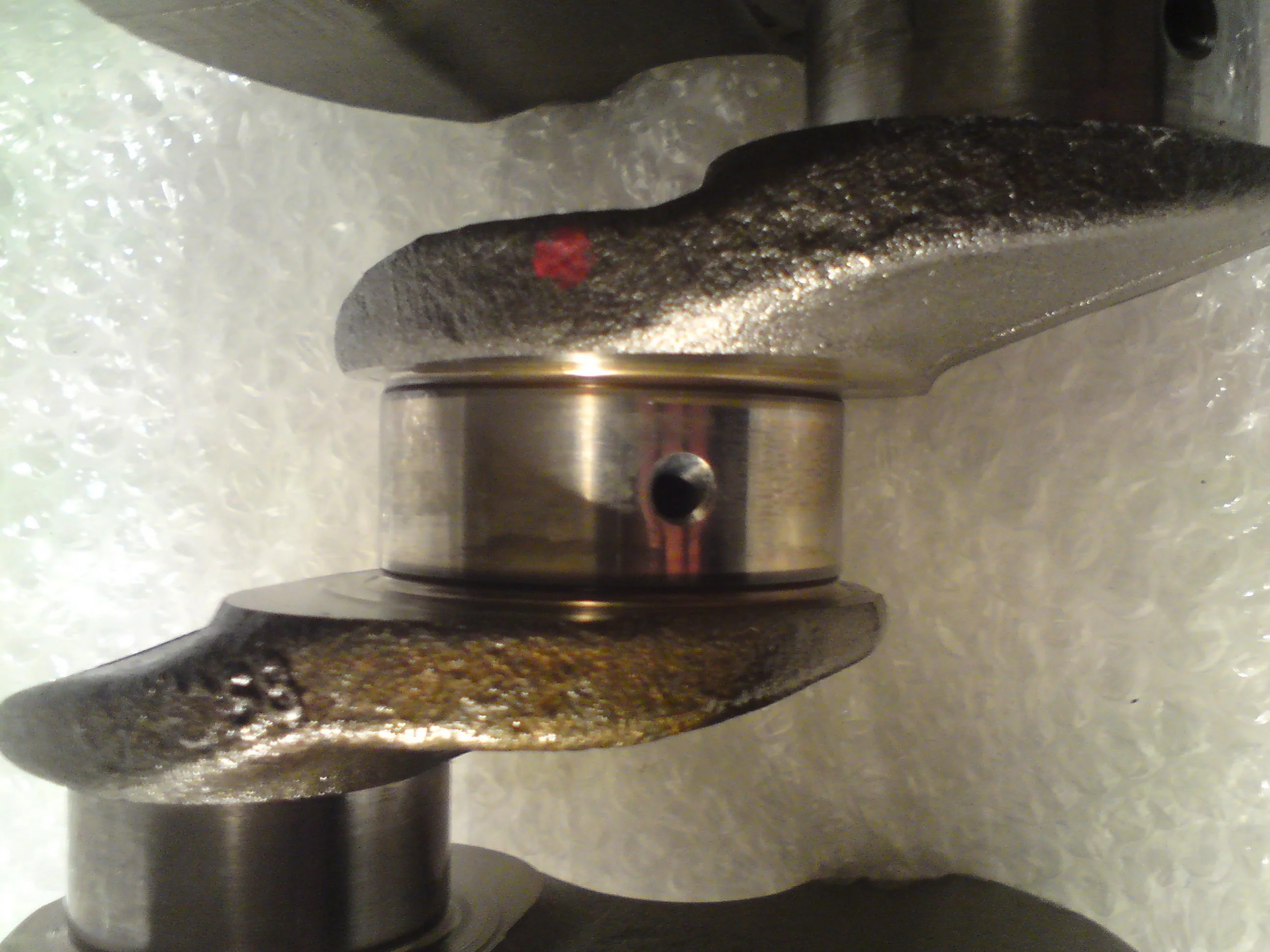

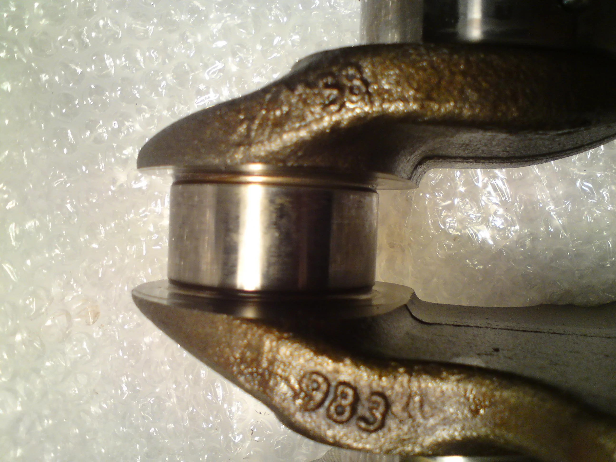

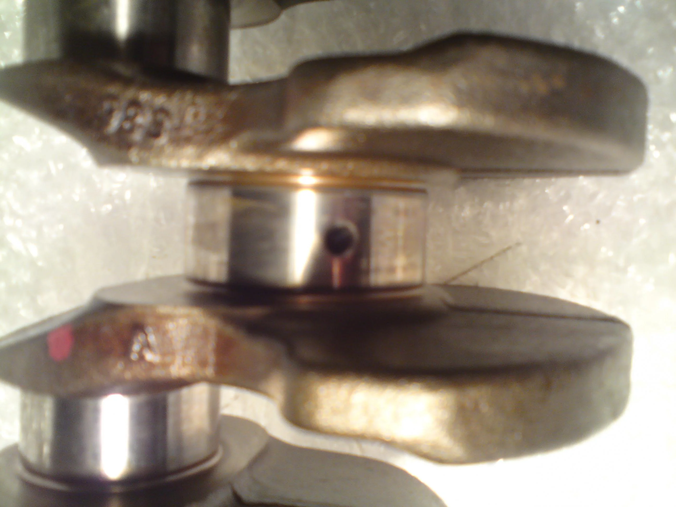

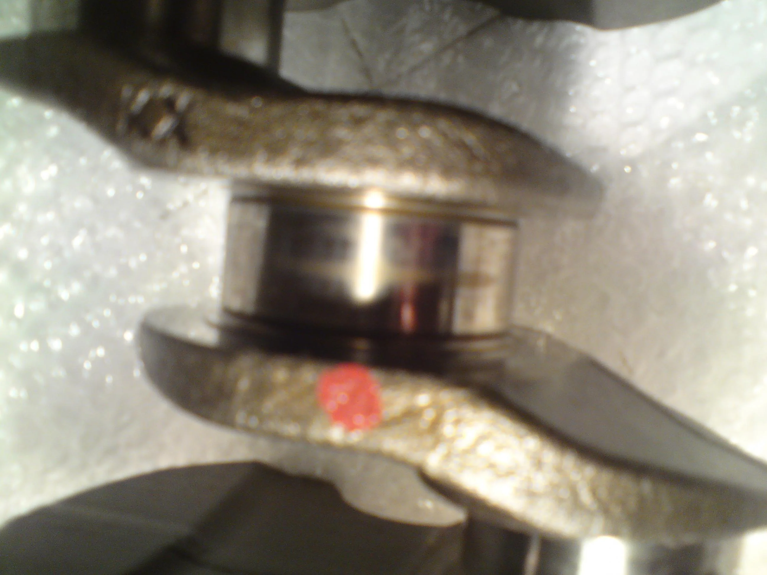

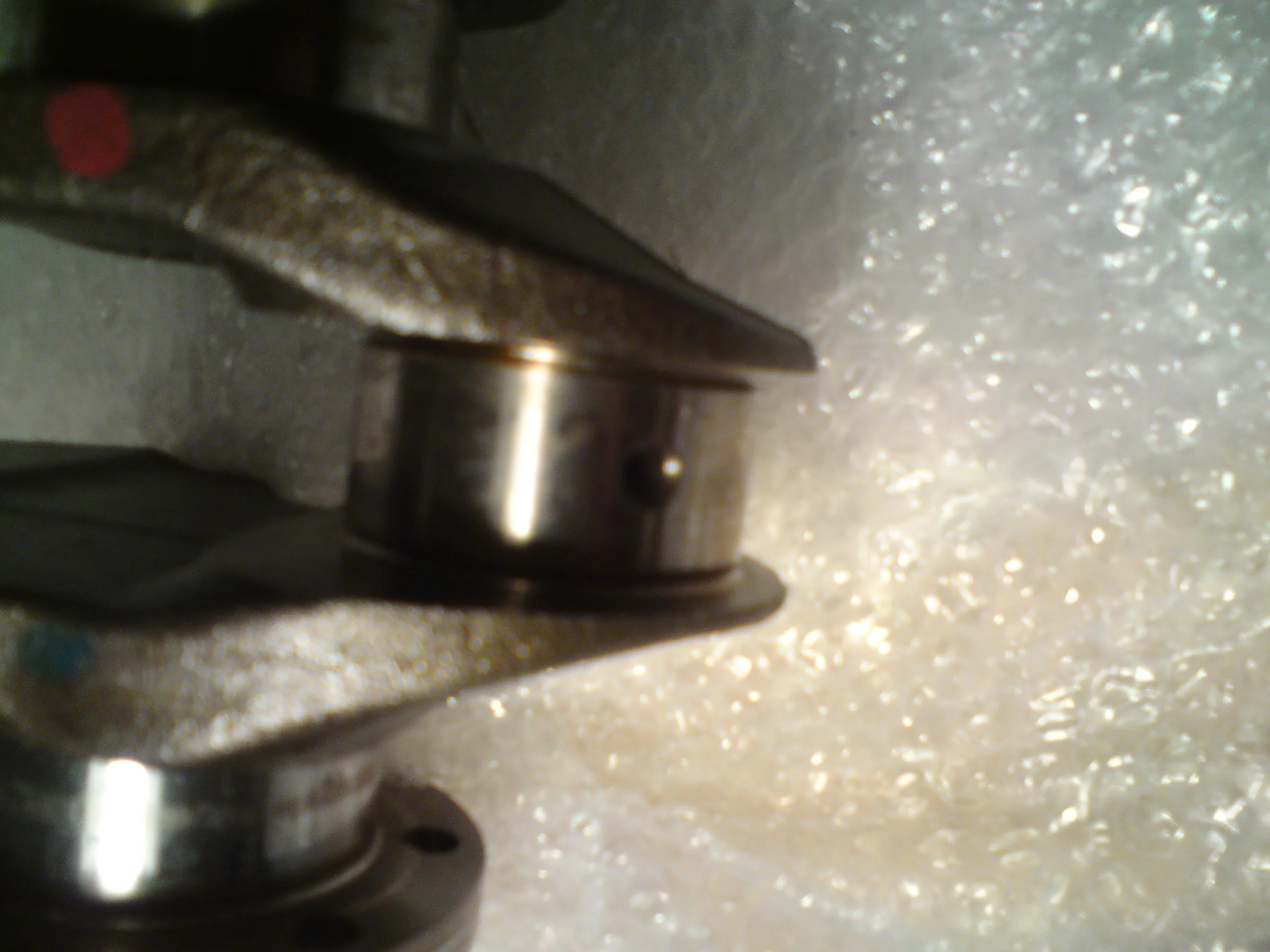

^^ yea aslong as you put new bearings in i dont see a prob. Here you go Jord some pics, bit crap there off my phone. If i can get hold of a large micrometer tomorrow il get the dimensions of the journals.

Theres a pic of all the big ends and mains.

Basically had a day of research today....been to the engine place that BRUN mentioned in this thread, very helpful, said the crank should be 99.99% fine being just polished, there is no major scoring he says...
