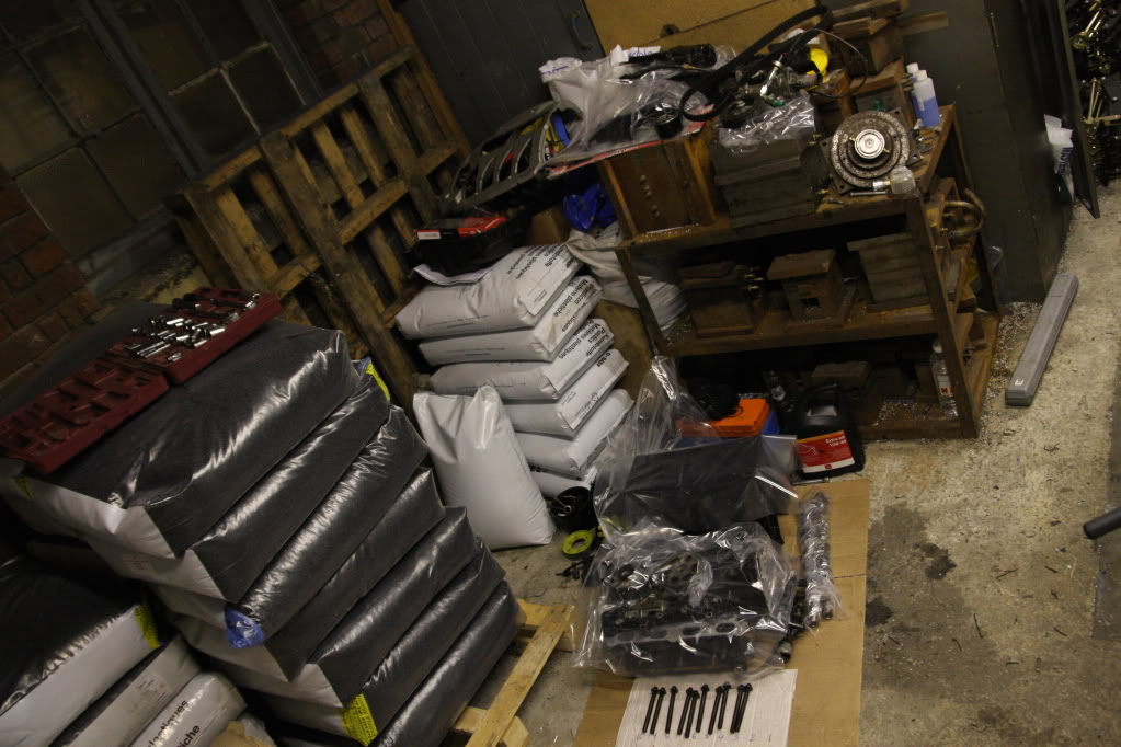

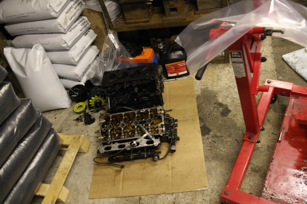

Few bits from today, took the head off, block apart, all off the stand etc....Either way, weather its getting rebuilt or replacement BE it had to come apart....

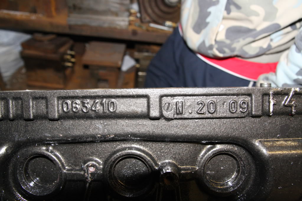

And one last thing, Is this my engine fabrication/block number? If so, im going to check if the reg is it associated with matches the 172 that the seller owned. If it does, hes obviously ran his dry, bought a replacement unit, and flogged the fucked one on (to me)..

Ok, dosent match, 063410 is the engine i have (if thats the engine number in the pic)
...Which leads me to believe that this engine was originally in the guys car, hes fooked it then bought a replacement, and sold this one...
Martin, can you search for the engine number, to bring up a reg?

dunno what the 063410 number is, but my engine number is in the form that brun says C00XXXX
:edit: just looked at my spare crankcase and it has 063410 stamped on it too, so it can't be the number

Mate the engine numbers are on a little metal tag normally by the oil filter area.
May have been removed?
