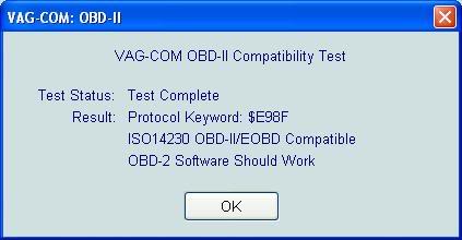

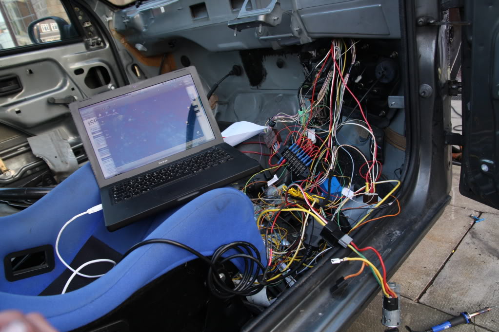

As said....got something working today, it is indeed OBD II and the RSTuner unit....
Ignore the dirty Mac screen, the heatshield rattle, and the absolute mess of wiring...lol

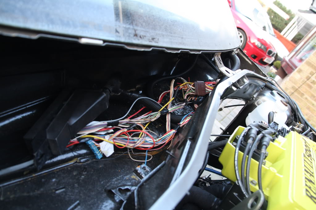

All my wiring is now in the scuttle panel, and comes through above the pedal box...more on this soon, as its 99% mess at the moment!

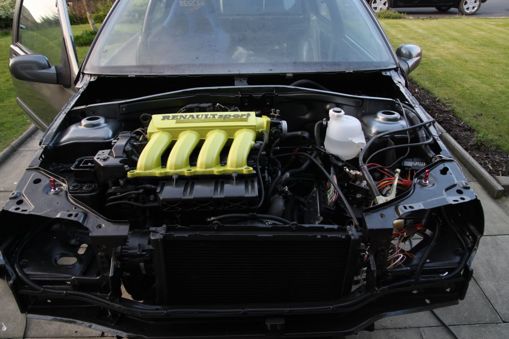

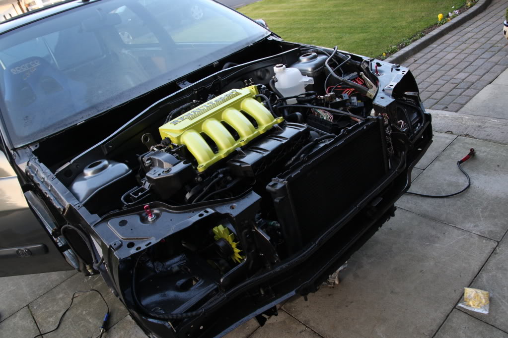

And the bay...

not vag (audi/volkswagen/etc), its just OBD2 that ive wired into the loom ive been making...plugged the RSTuner unit into it, and it worked :)
