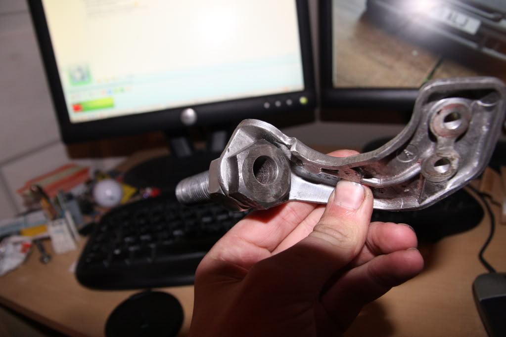

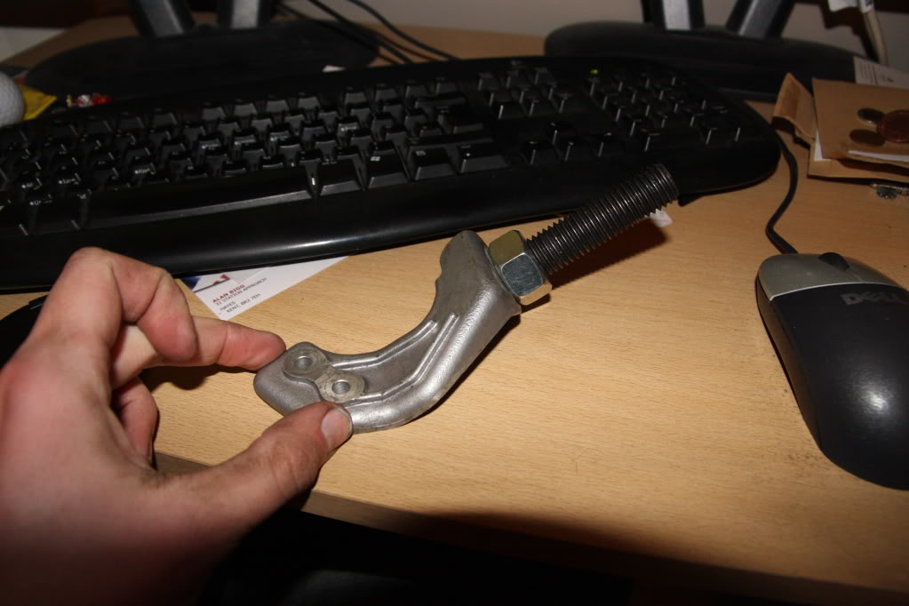

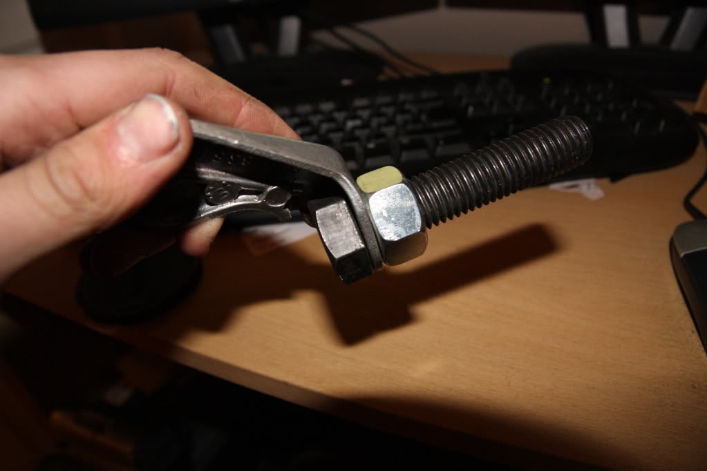

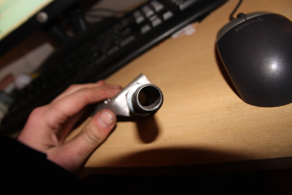

Also, there is a slight issue with using the valver throttle cable on the 172 engine, its a bit too slack. I decided to make a spacer that would fit onto the standard throttle cable mount...
Take 1 x M18 bolt, then take a 12mm drill bit to it on the milling machine (12mm is the diamater of the cable housing at the end of the valver cable)...
Then enlarge the hole on the standard throttle cable mount to 18mm, put the bolt through, and secure with a nut...
Just needs a thin black nut for it now, the chunky one is just temporary :p
Throttle cable housing slots perfectly into the end, and is now extended by 2/3 inches, meaning the cable is nice and tight. Can also be adjusted as usual with the circlip it has... :cool:

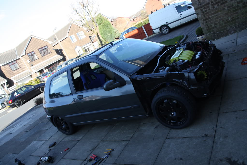

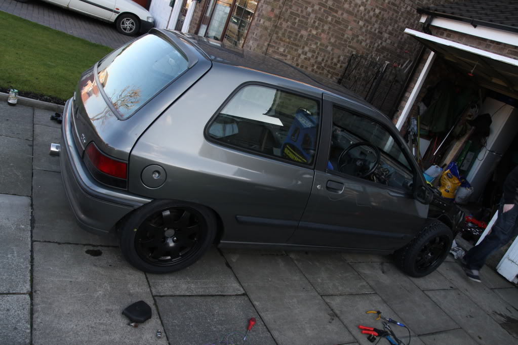

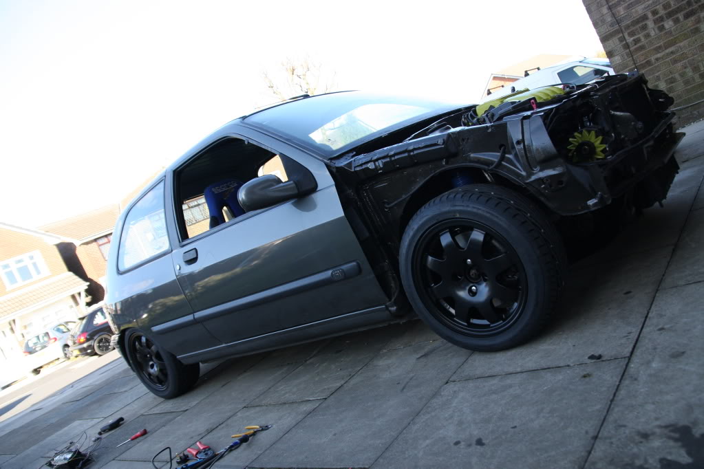

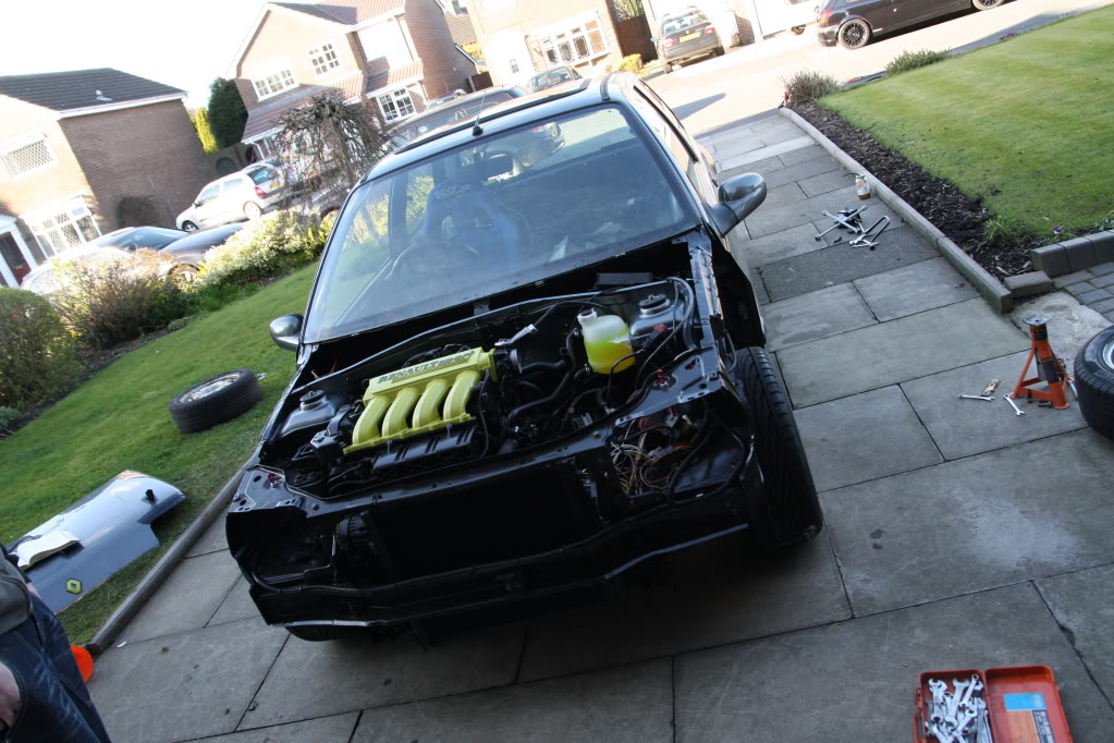

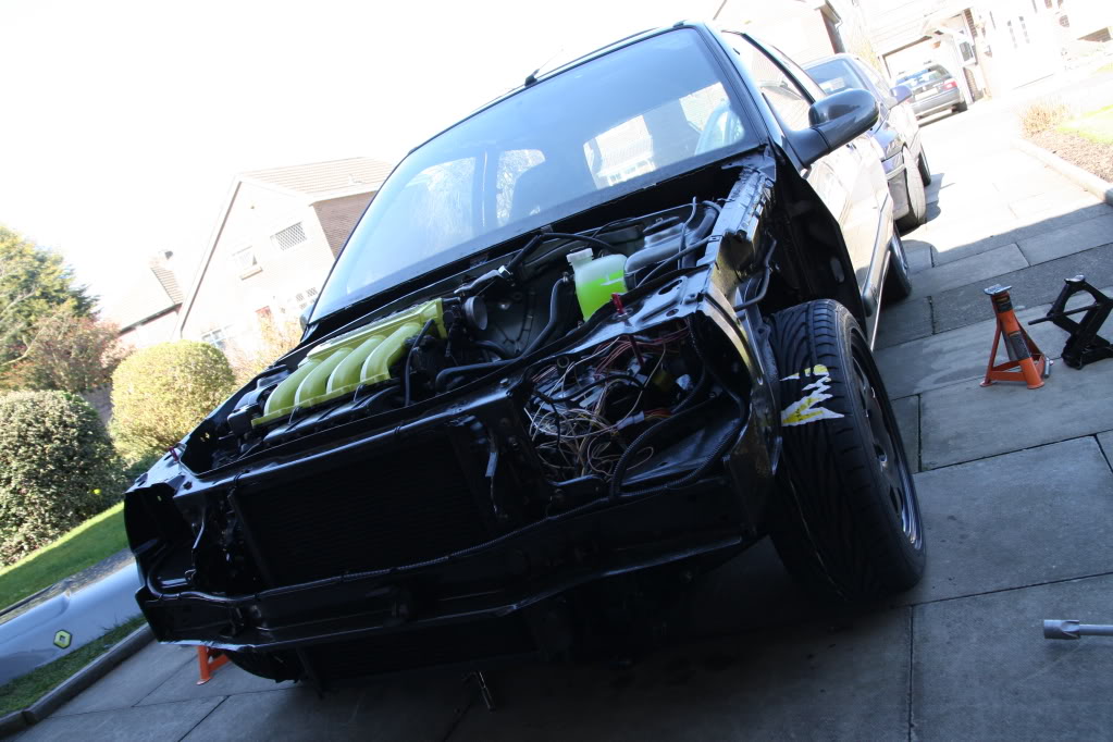

well more problems today, but as expected tbh......few pics first...

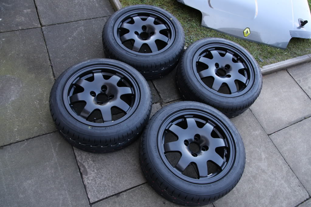

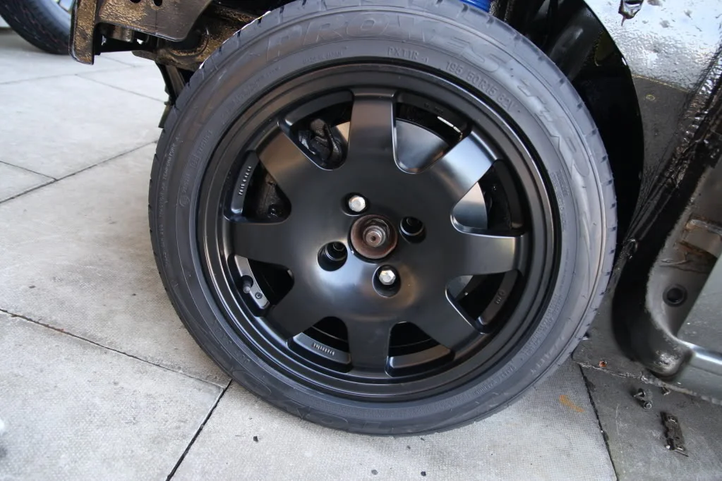

wheels back from powdercoating, 4x new t1-r's

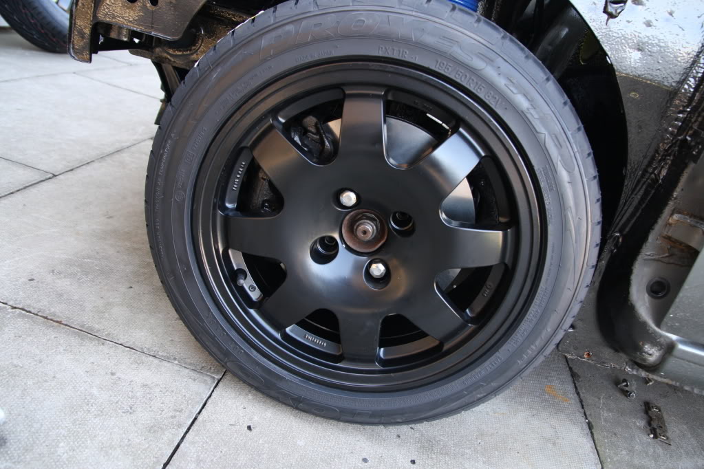

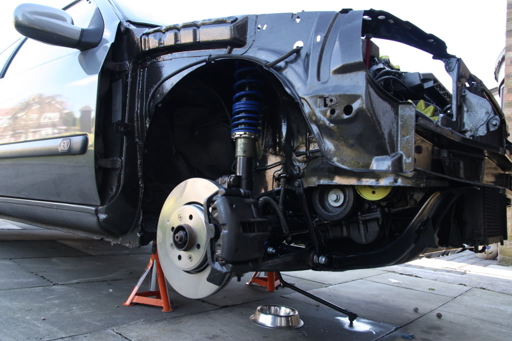

New front disks fitted...
Lowered back onto the front wheels for the first time in months...
New disks and fresh calipers behind fresh wheel...

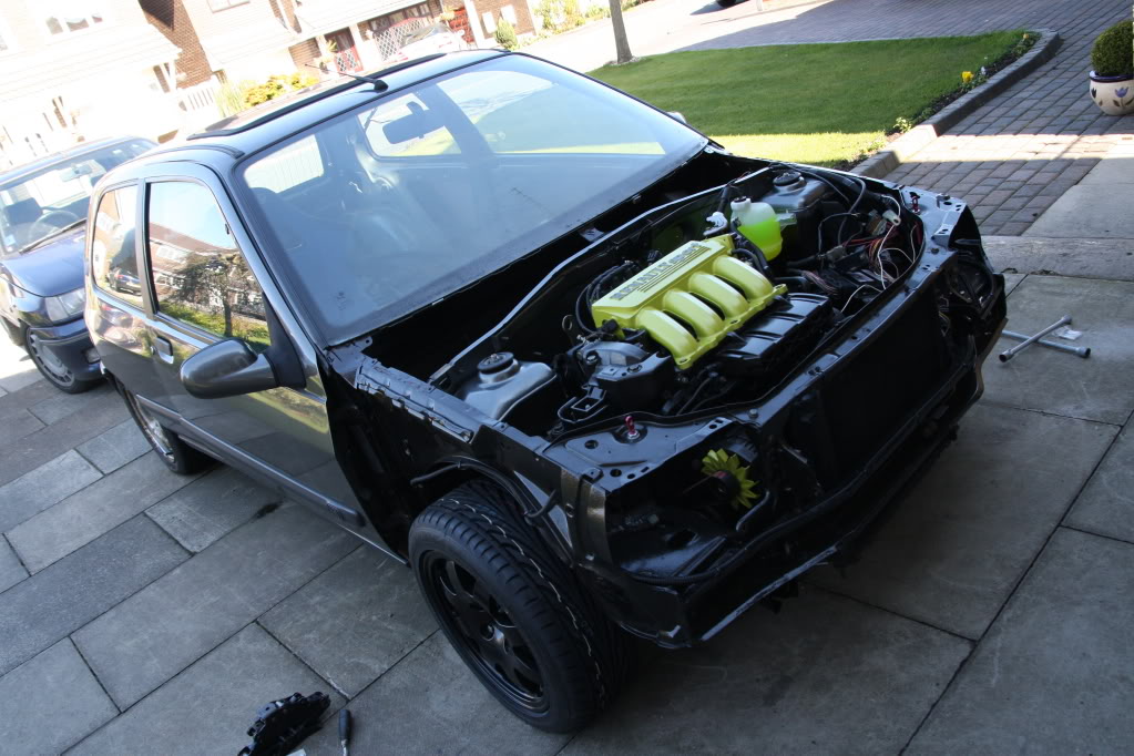

All four wheels back on...

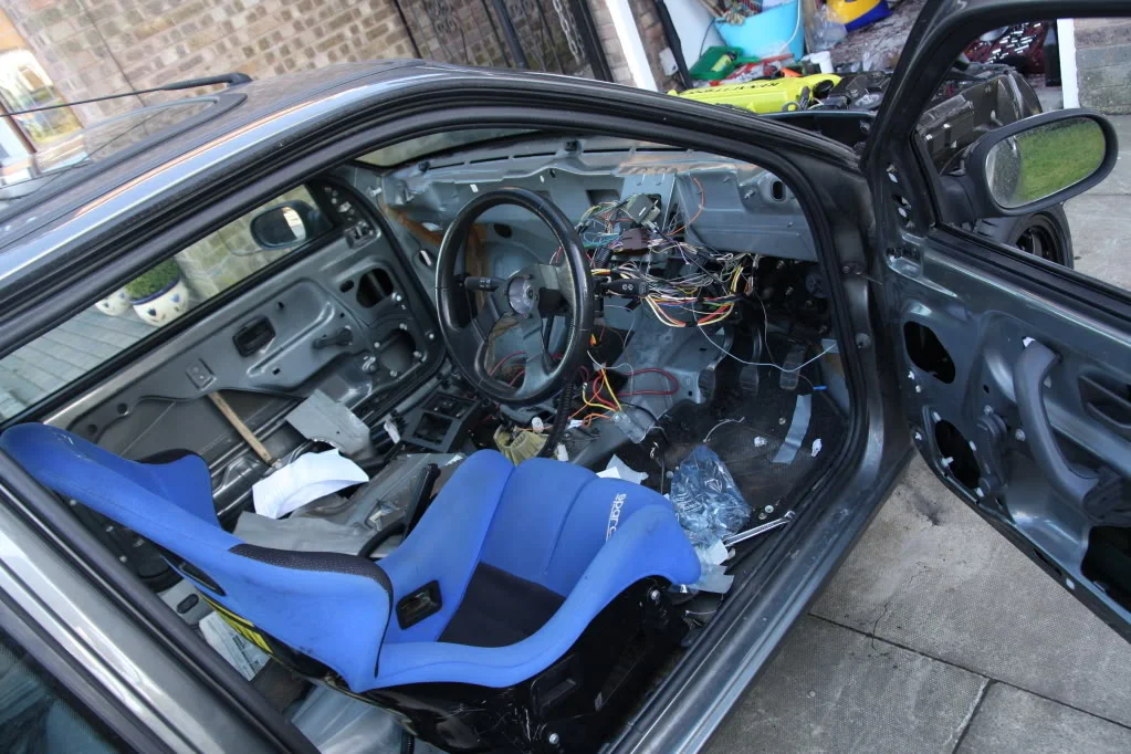

Nice view of inside...not even began looking at that yet...
And one last one...
