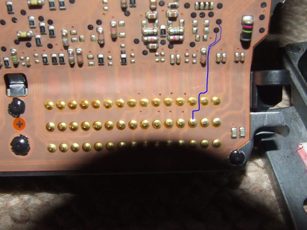

it dosent split into two i dont think, it just gets smaller and its the right hand one looking at it in that direction, the one next to it on the left comes from that resistor
  Bumder With A Buffer
Re: Mk1 172 Hybrid Track Car Project
Ah right ok well if it dont and your still having trouble getting the wire to stay on that track... connect up to the little pad furthest up if you can (as you look at this picture)
what are those little pads?
I was going to connect it to that originally but didnt want to damage it by doing so...

On a normal PCB they would be called Via's. Its a way of getting a signal from one side of the board to the other easily. But it could also be a test point... they put these on pcb's sometimes.
interesting.....im guessing it being a test point would be a good idea, every track seems to have one at some point.......doubt they would make every track go from one side to another.....
plus, there is nothing before that, so if it does come off il solder it to that :)
Going to try it around lunchtime, hopefully itl fire into life!!

Aye there would be a good idea... just make sure to tape the wire down or something so you dont pull the test point off! that'd be bad!

No idea....got a few options....Im unsure of this soldering to track business, as its never going to be a 'strong joint' imo.
I either pay someone to repair it.... £xx?, then get paul to flash it to standard £75+VAT.....and hopefully it may work...
I cant see it being cheap to repair it with it being so small tbh, especially considering ive attempted to do it also....
OR....I get another ECU, £60-70, then get it flashed to reset immo code by paul £75+VAT.....then fit my emulator to the 3 pins as they should be, and the PCB wont be cut.....so an un-damaged ECU...
So unsure of what to do!! Pretty pissed off tbh.

Im just unsure of what to do due to the fact that if its soldered to the track, and it comes off at some point, il be back to where I am....
If the ECU clinic hadnt cut the track id be laughing now as the emulator would be soldered perfectly to the 3 pins....and it probably would be working

give him a shout, show him the problem, after fitting the strap it's normal to glue the wire in place, or use something like non-corrosive silicon (the stuff that you don't pull a face when you sniff it.)

Well it dosent matter, i just fixed it somehow LOL
I risked what richy22 suggested (didnt really want to) and soldered it to one of the testing points, then taped it into place....
Plugged it in, and boom......first time :)

yeh thats what i mean, im almost sure he (paul) cuts the track to 58, and solders the connection to the emulator directly to the immobiliser connection (on the ecu side), maybe so that if you are running key etc it doesnt try to send 2 signals to ecu for the immobiliser?

richy....its soldered and taped part way down the wire to hold it in place. it seems a pretty strong joint, alot stronger than the track attempt. is there anything i can put over the soldered part to strengthen it? sealer/glue etc?!

Well i technically soldered it to the track still, not the ECU immob unit itself ;) but yeah, ok you were right :rasp:

RE your solder repair... My option would be to try and trace where that track goes from that test point... if it runs to an IC then solder there as it will be a lot stronger.
How thick is the wire you soldered on?
Glue might be ok but then if it doesn't stick it ain't going to do anything... Plus you might run the risk of IF the glue came off youd pull the track and pad up.
Obviously im just speculating here as I cant physically see the track etc etc.. just trying to cover all your options.
On a side note if you cant get anyone to repair it send it to me and il do iit in a few mins and send it back to ya... offers there if you want it :)
Would a coat of glue help absorb vibrations, as once the ecu is put back together there should be not contact from other moving parts and only vibrations which could cause problems
