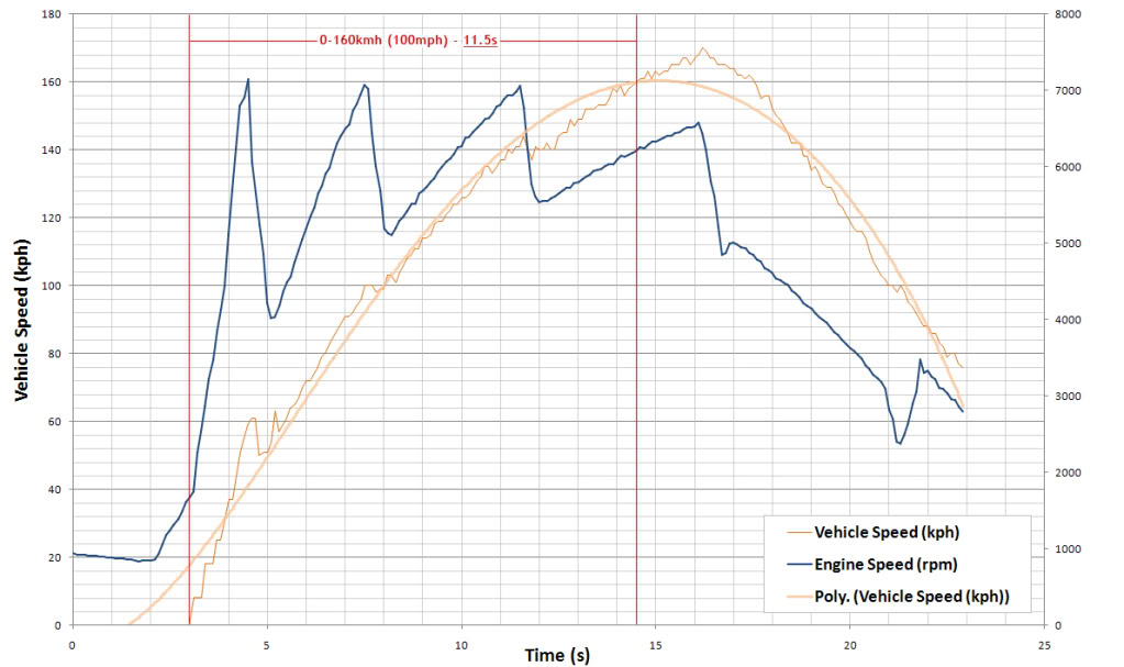

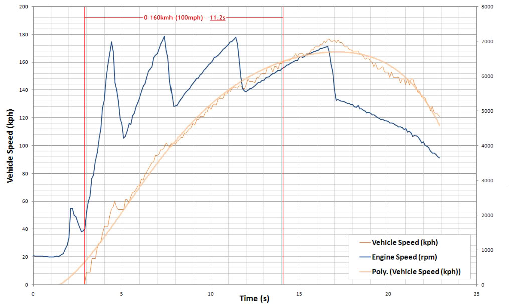

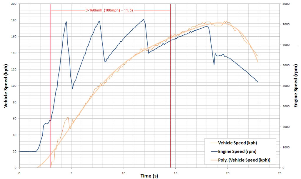

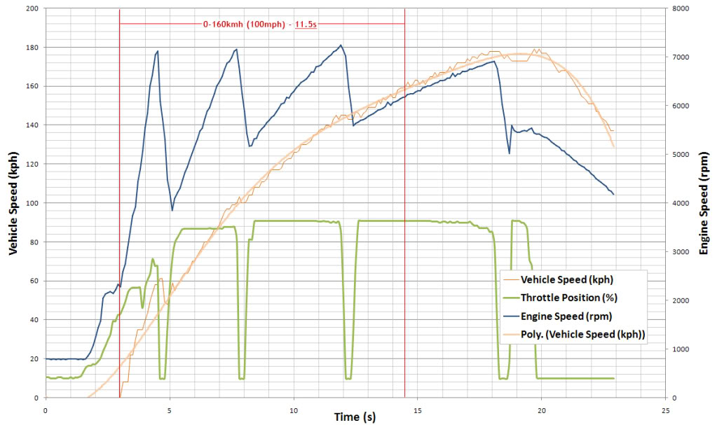

0-100mph Run 1 - 11.5sec

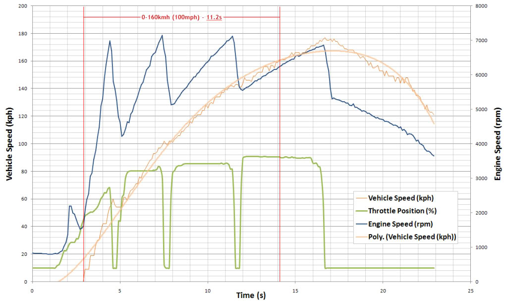

0-100mph Run 2 - 11.2sec

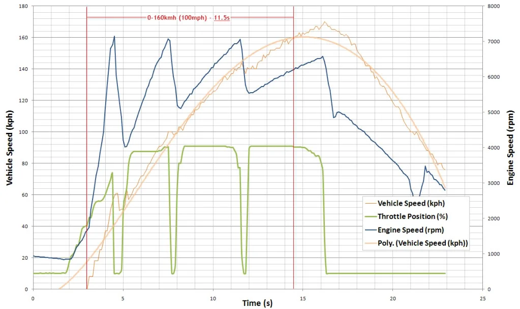

0-100mph Run 3 - 11.5sec
0-100mph Average (11.5,11.2,11.5) - 11.4sec
You can clearly see on all 3 graphs before the 5sec marker the speed increase rapidly where the wheels are spinning in 1st :boring:
As discussed this may or may not be accurate and was just an test with more data to compare to when the limiter was sub 6k :)

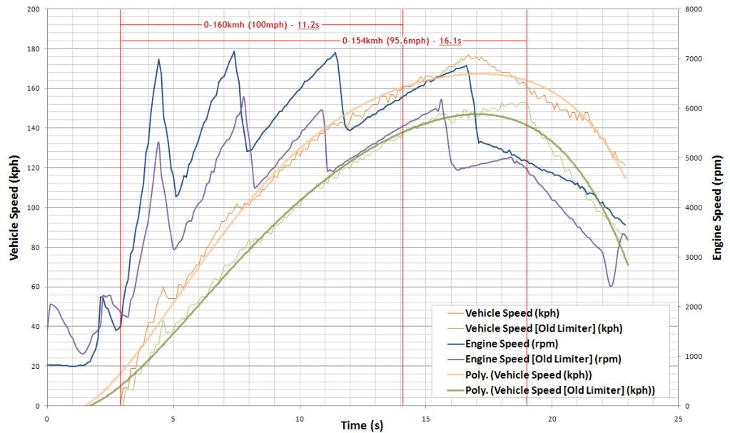

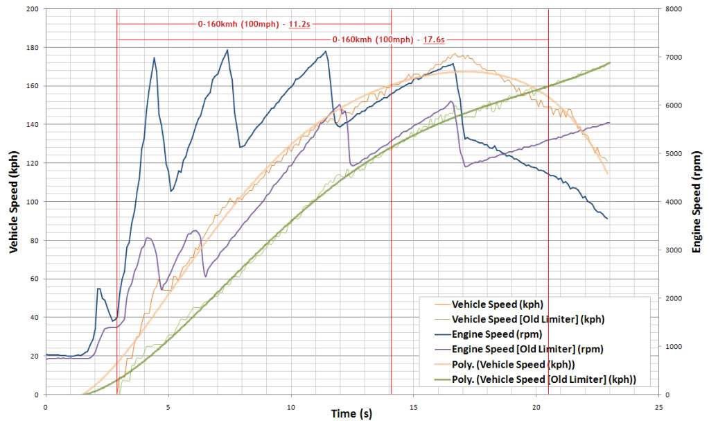

And a few other interesting ones, the fastest 0-100mph time (11.2) plotted against two old logs from when the 1.4 map was on :)

i dont understand why its recording such quick times:S a Lamborghini Gallardo does 0-100 in 11.0 sec and thats 500bhp. i surpose it does show it has improved tho which is the main thing:approve:
Re: Mk1 172 Hybrid Track Car Project
i may have more power, but 130 kgs is not to be sniffed at, equivelent of about an extra 30bhp
that still leaves you with 30bhp odd more which will put you into the 13's;)
what is your best qtr mile time?
It's not doing 11 second 0-100, there will be at least a 5% speedo error, but even so it will be quick. how much does the lambo weigh tho? a 200 bhp caterham 7 will piss all over a lambo to 100, because it only weighs 400 kgs! i recon f0xy's is a lot lighter than he recons!

the start is iffy too, looks to be lag on the speed signal, I think you really start where rpm drops about 1 sec before you see the wheels move. You need TPS at the same time to be sure.
I have the TPS data too, 2 second job to overlay onto those...
The start is where the revs shoot up at the same time as the speed, which then drops again.....wheelspin

the revs shoot up and drop when you change gear. You certainly have spin in first, and some slip in 2nd. The bit I'm talking about before the wheelspeed is where the revs increase as you open the throttle, then drop as the clutch engages. Assuming it's not just you blipping the throttle before the start... Since the revs drop it means the engine must be under load, if there is load there muct be movement. It looks like the speed signal isn't great around 0mph, you can see this in the way that the speed increases in steps as you move away - lowest speed it can measure looks like 8mph, next step ~16mph, then ~20mph
it's surprising how well the 1.4 map looks to work, the man difference seems to be the lack of revs.
well explained, although I do tend to give it a few revs before pulling away...

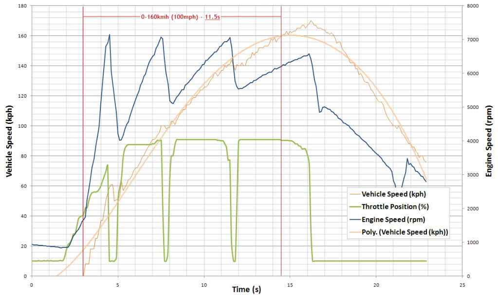

Il post up the same three graphs with throttle position overlaid shortly so we can see

Run 1 - Inc Throttle Position
Run 2 - Inc Throttle Position
Run 3 - Inc Throttle Position

on run two its clear to see you are nt using full throttle in gears 2+3 explain???
not backing off as such just not going full throttle straight away as it just spins up in 2nd mid range....
Throttle position never goes past 90% on the logs, so 90% has to be full throttle IMO. I know this because the RStuner performance analyzer only starts 'sampling' live data when you hit full throttle, then when you completely let off and it gets back to its 'idle throttle position' sampling stops....and draws you a graph...
So if i wasnt hitting full throttle, that feature wouldnt work....
Although, its hard to explain what the throttle pedal is like on this.... Like on a Mk2 you can push it nearly to the floor to that little 'stop' that there is, on mine, full throttle is halfway down the pedal travel, so its more sensitive so to speak....So if i try to ram the pedal down, it pulls pretty hard on the plastic guide for the cable....dont want to go breaking that!

Glad to see it's revvin now. Last time i looked at this thread it wouldnt rev past 5k? What was the fix?
11.2 to 100 is very impressive!
The problem was the ECU had been flashed with a 1.4 8v calibration file + software.....the engine in question has a 6k limiter, so it explained it.....
We think this was done by the ECU clinic when they 'decoded it' to remove the immobiliser, think they wrote the wrong files back onto the ECU! I flashed the ECU with the 172 software, and the car wouldnt run for a week due to the immobilser coming back on (ECU Clinic only do a software de-code, not hardware.....so any time its mapped or flashed the immobiliser comes back, fooking s**te!)
I ended up getting an immobiliser emulator, soldered it to the ECU inside, and it worked perfectly. Running the 172 Ph1 Grp N map on it now from fastchip/RSTuner/etc.
