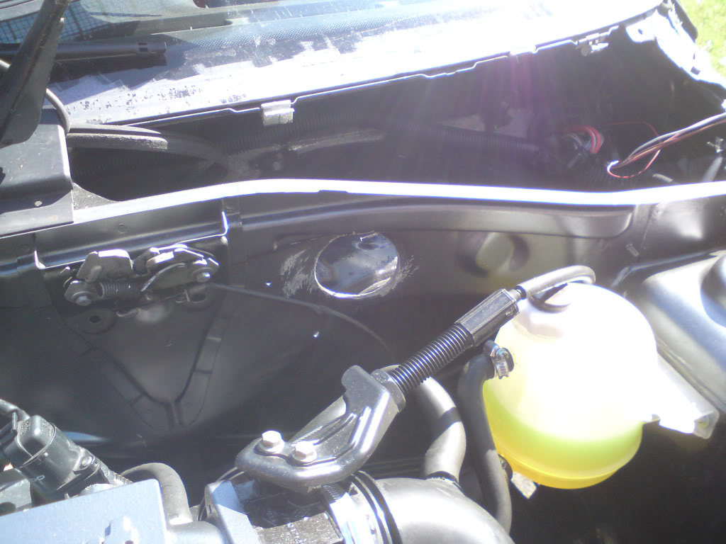

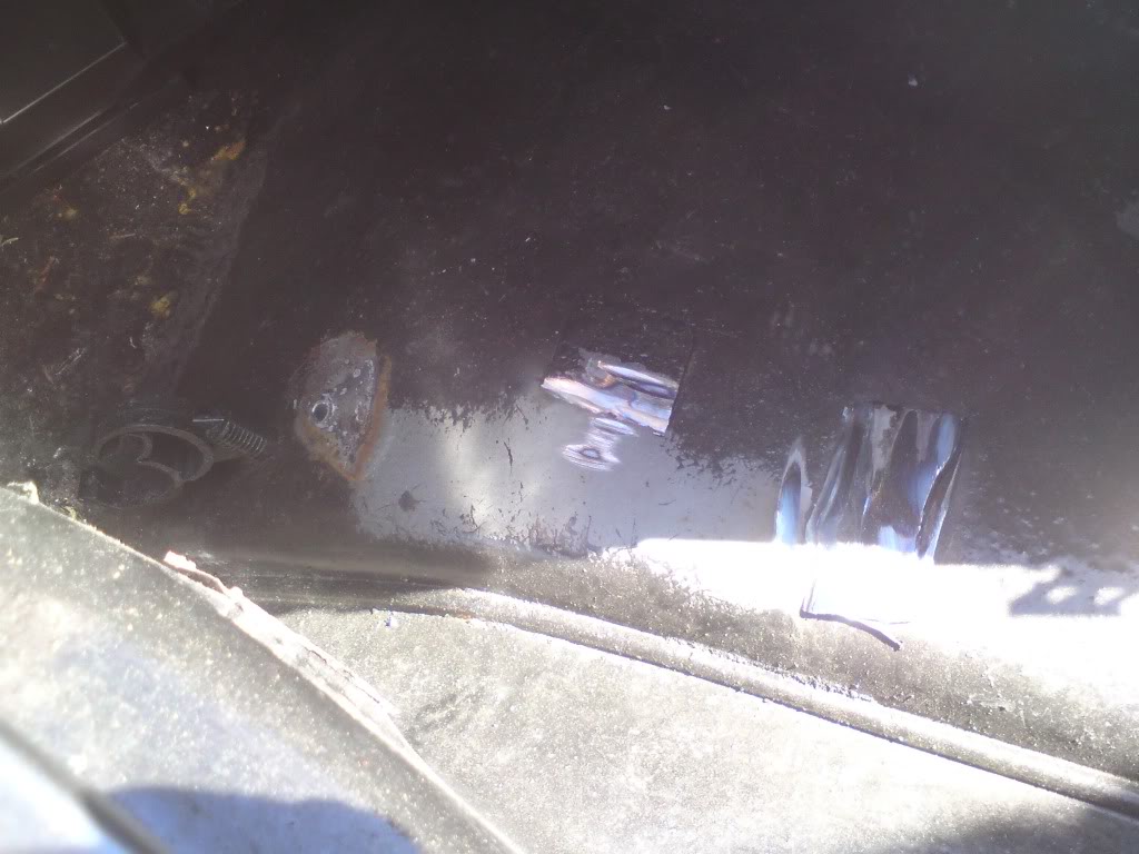

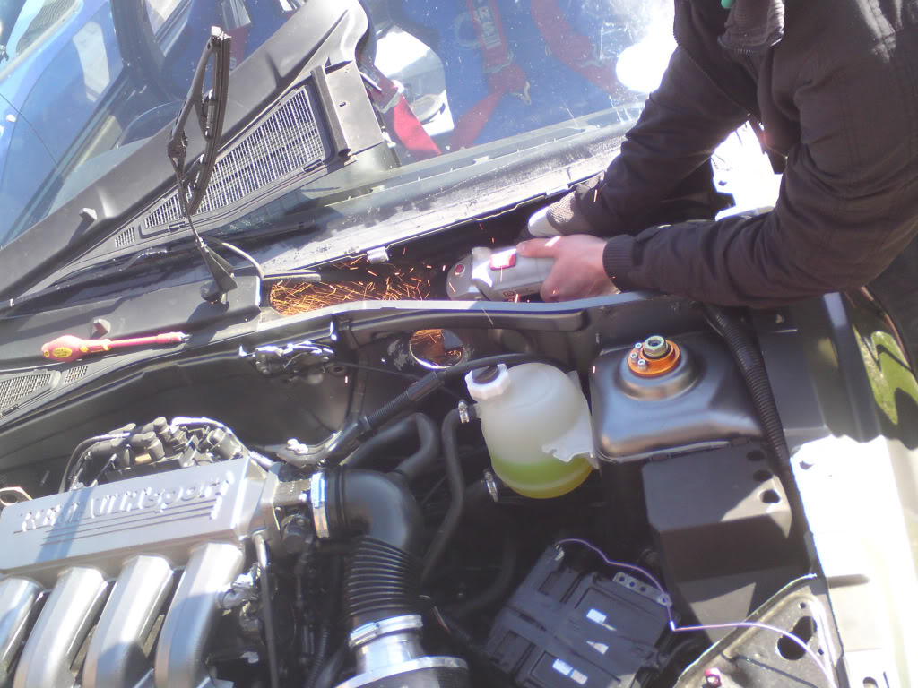

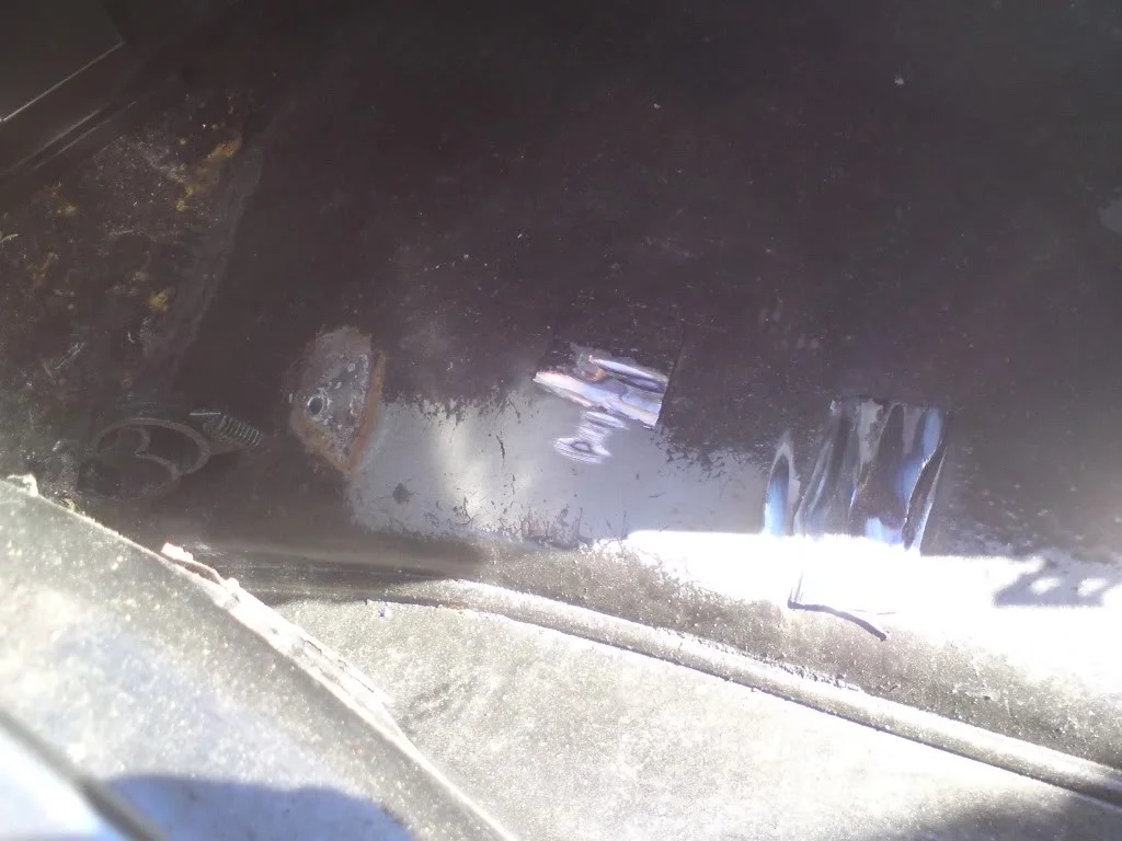

...few here from when we were doing the preperation for it....75mm hole cut in the bulkhead, there was also a bracket behind where the hole was cut (for the Aux fusebox)....we ground that off, then smoothed it and painted today to prevent rust etc..Bulkhead needs respraying around that area where the holesaw slipped, but be reet for now!
Bracket gone...
The elbow will be rotated, linked upto another 90* elbow, then open filter in the scuttle panel area.... The filter is a Pipercross sausage filter from a TVR Chimera, lol.

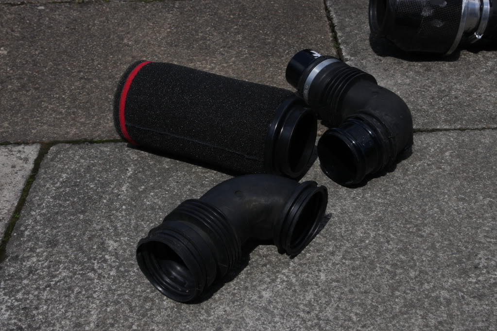

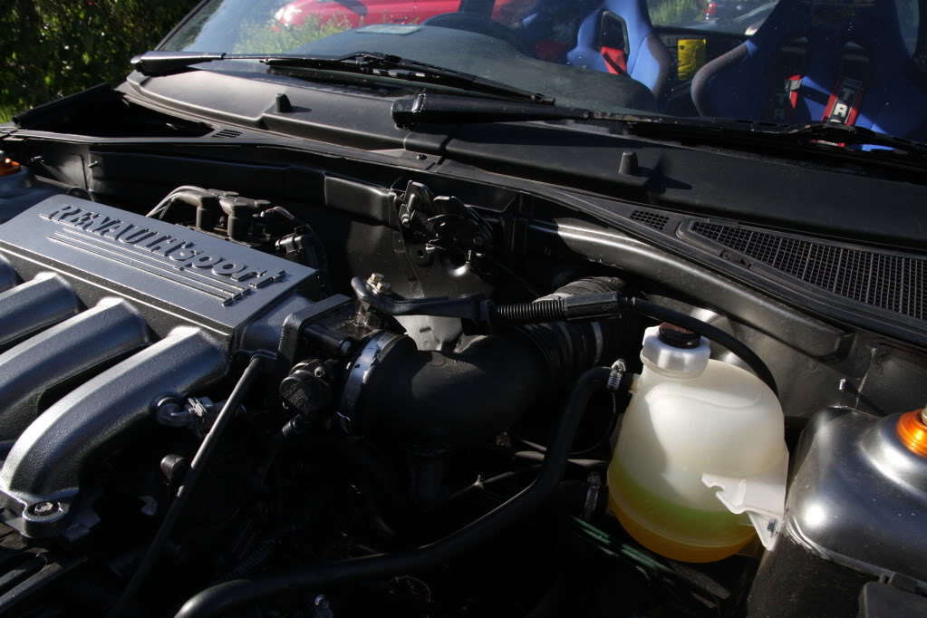

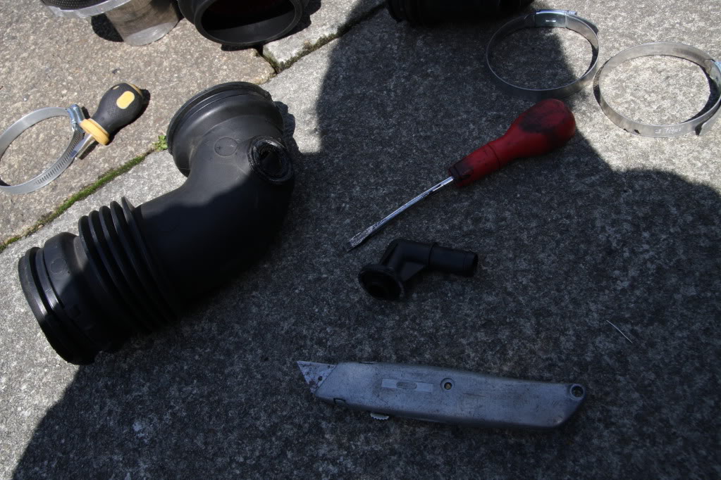

Scuttle Induction Pics...
Two 1*2 (Ph2) elbows... And a TVR Pipercross Filter

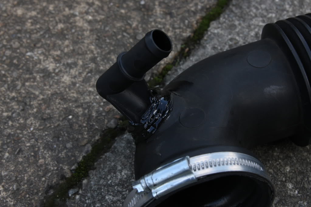

One problem was the hole for the ICV (ph1), usually a crankcase breather on (Ph2s), was pointing in the wrong direction for what I needed....Removed the connector...
Set it to where I wanted, sealed it back into place with tigerseal...
Got two plastic couplers to join the elbows together, and the elbow to the filter...

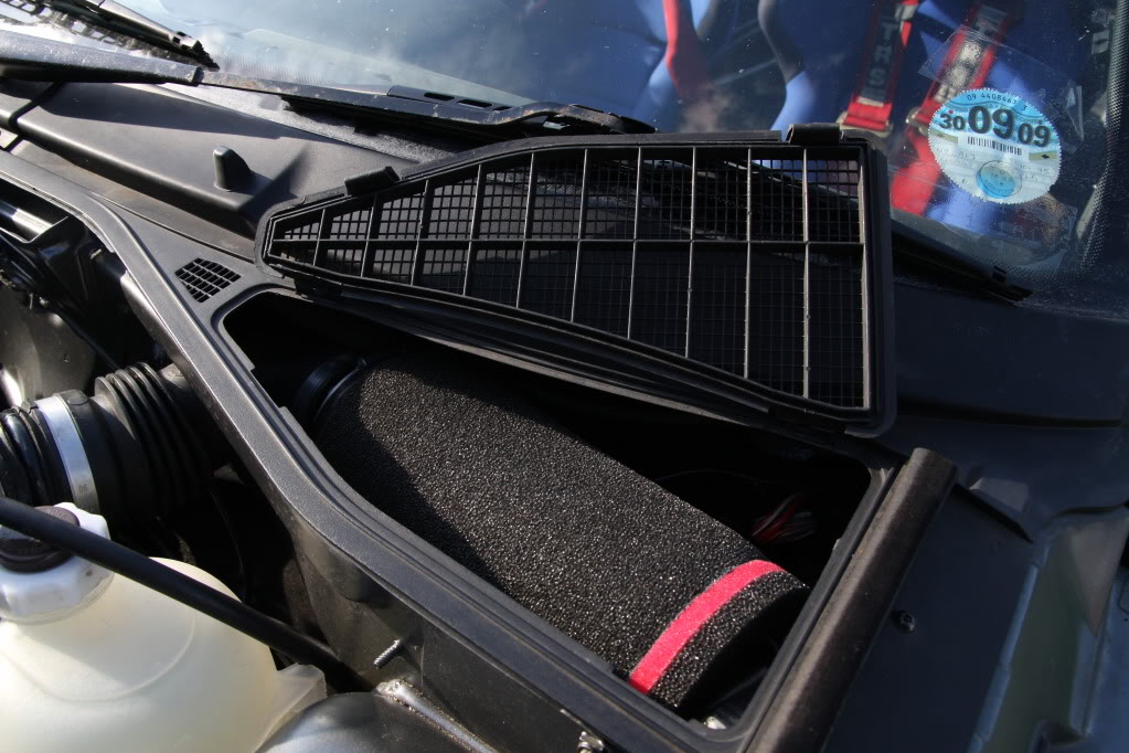

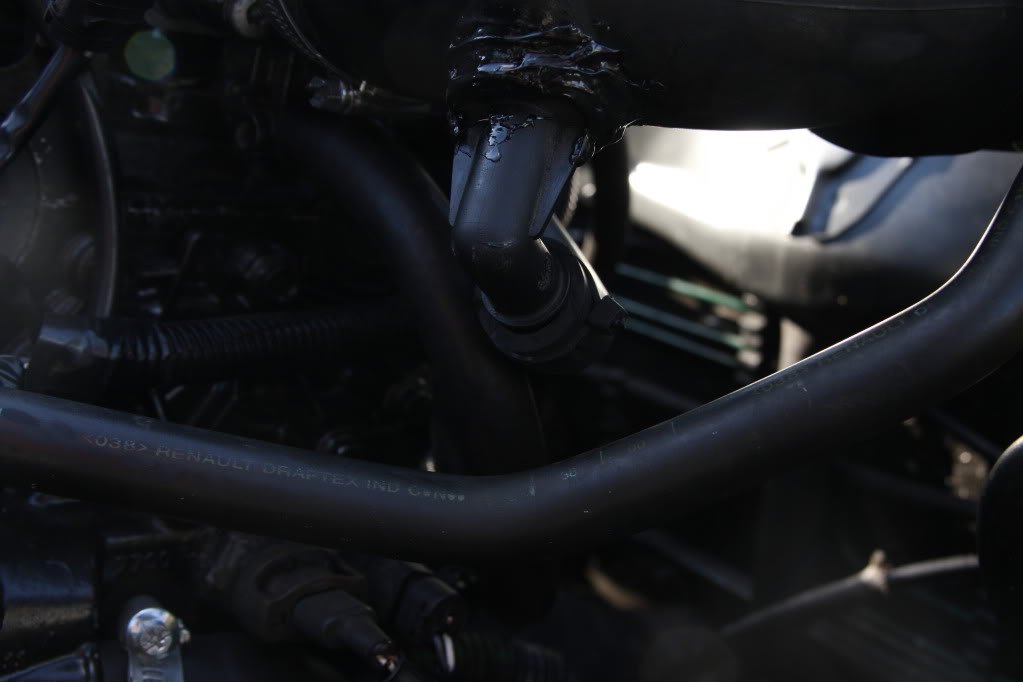

All fitted^, you can see the pipe/connector is now in the right position for the ICV...

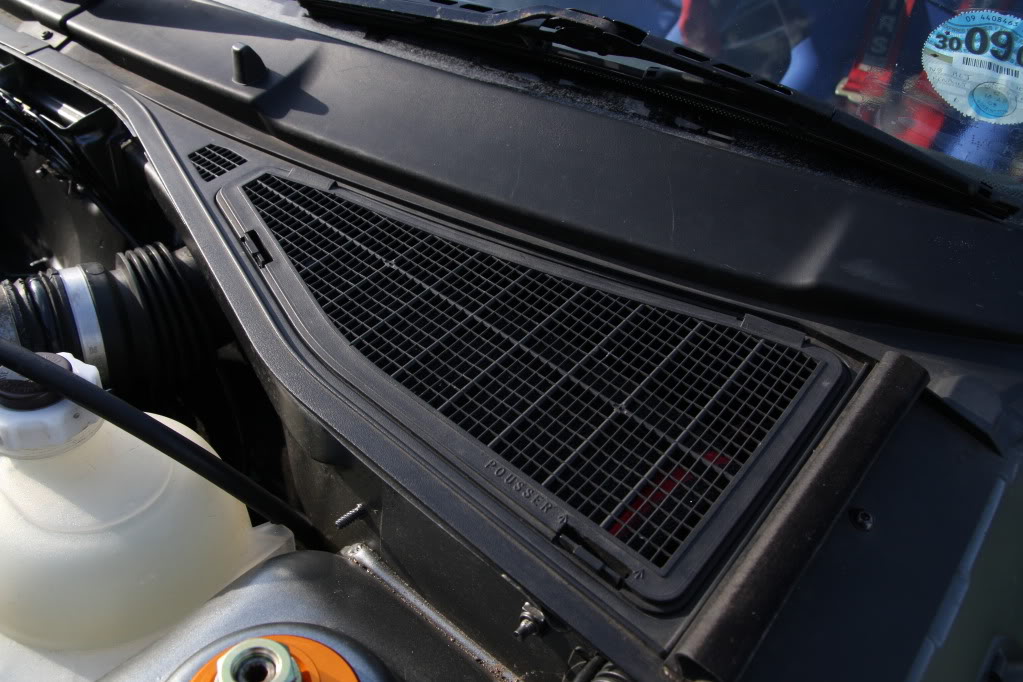

And how it looks with scuttle panel re-fitted...

nah, i should have got a pic of the scuttle panel, but where the filter is joined to the elbow its at the highest point, from there the scuttle panel structure slopes downwards away from the car to the wing (to drain water)....so technically the filter is 'floating'

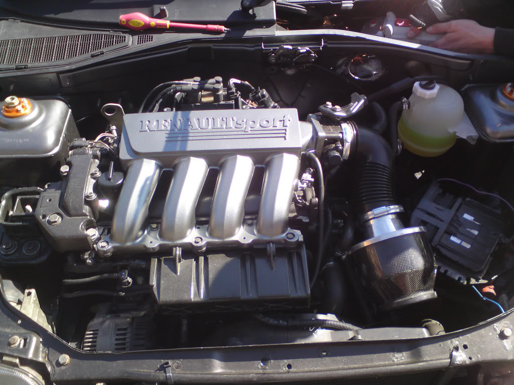

Needed to get the filter out of the bay, gets stupidly hot with everything alot closer together, rad/block etc....
