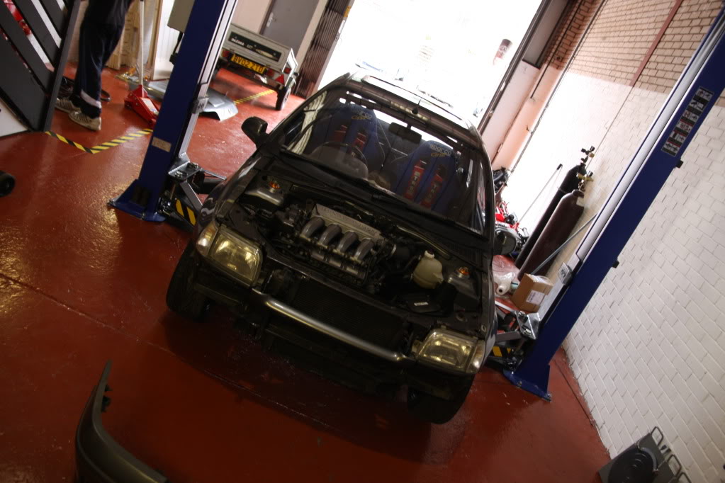

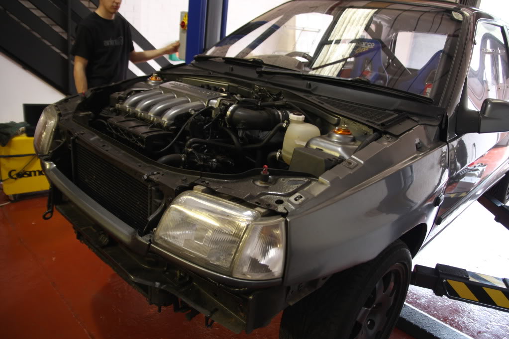

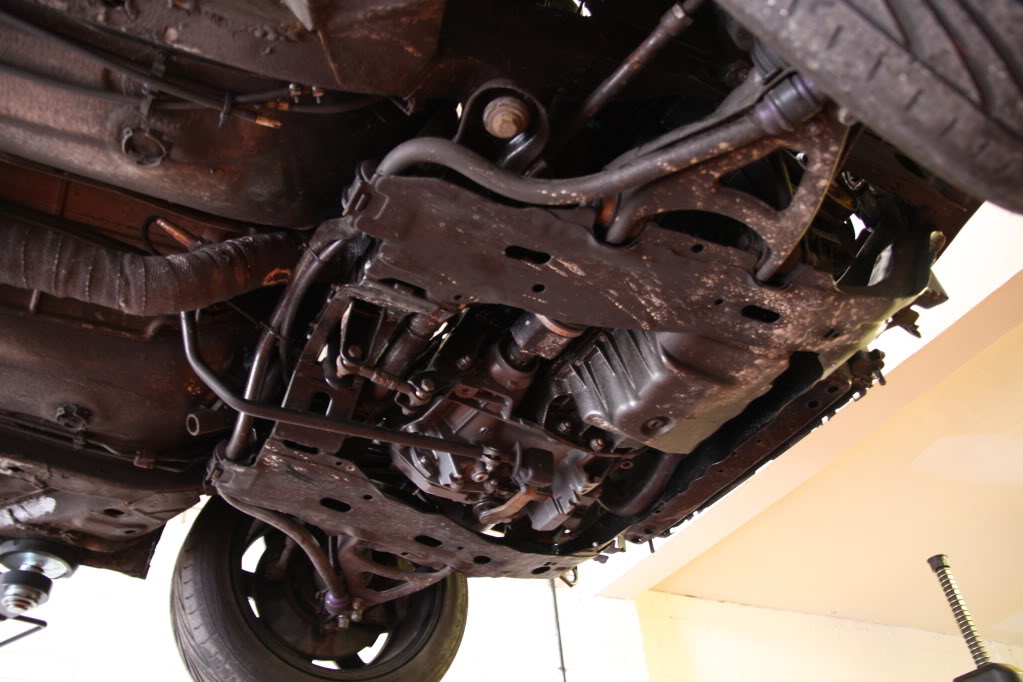

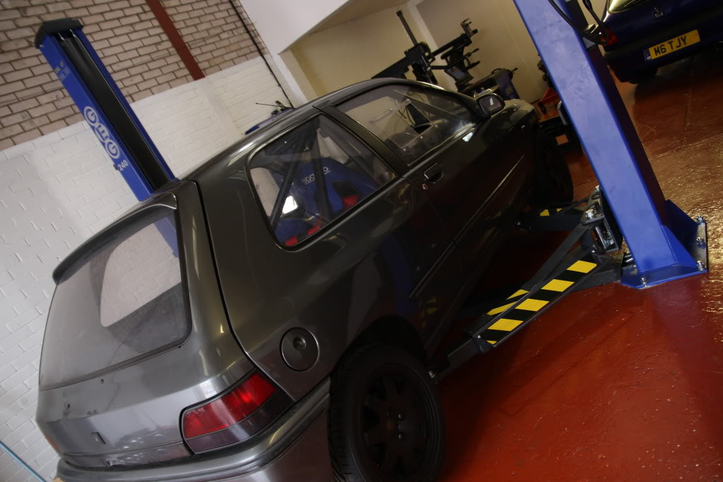

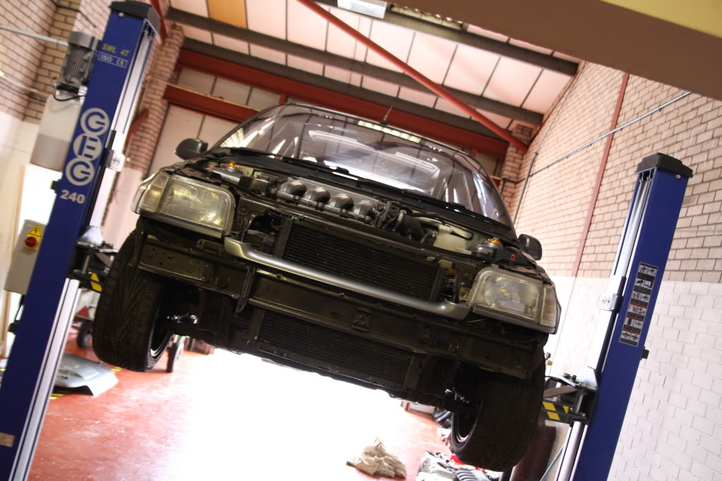

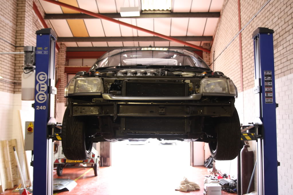

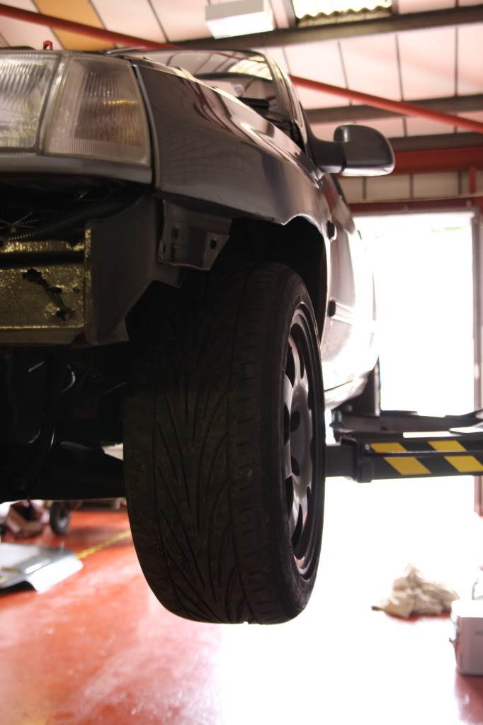

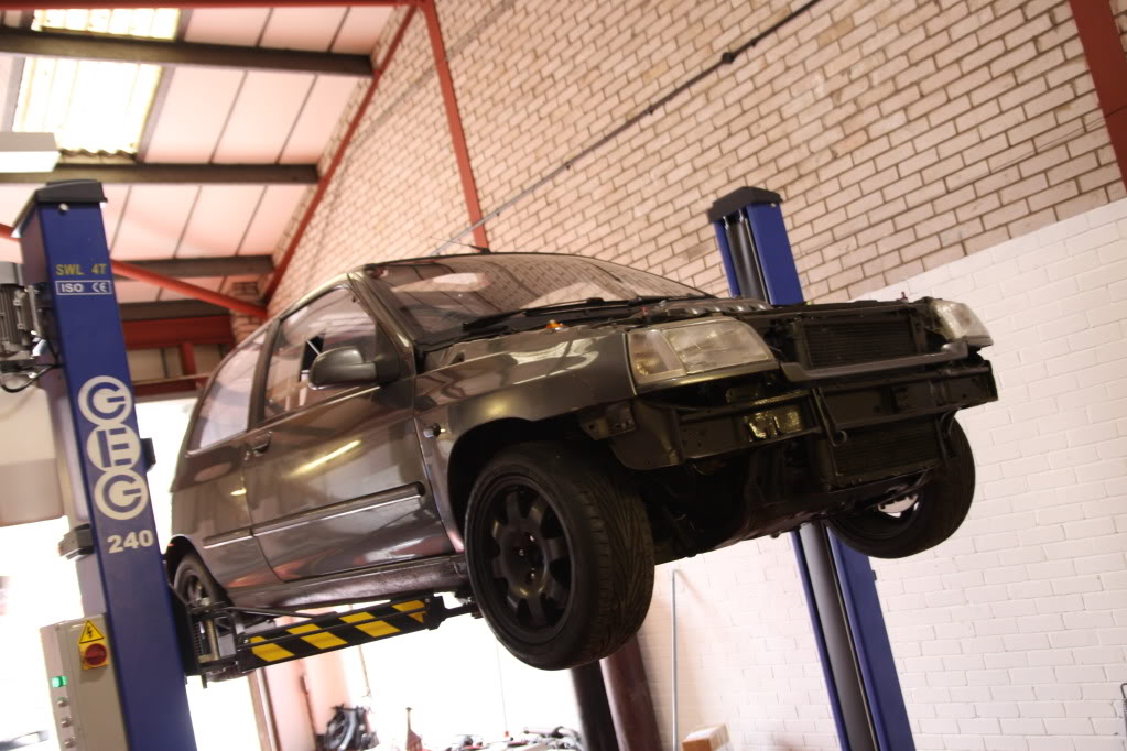

Had a drive down to NW Performance ;) and spent a day there today, got the car up on the ramps to check it over, found out what my knocking on the steering was (balljoint-to-hub bolt was loose), and tightened up a few other bolts that had somehow worked loose (subframe worryingly)....
Wideeeeeeeetrack :)

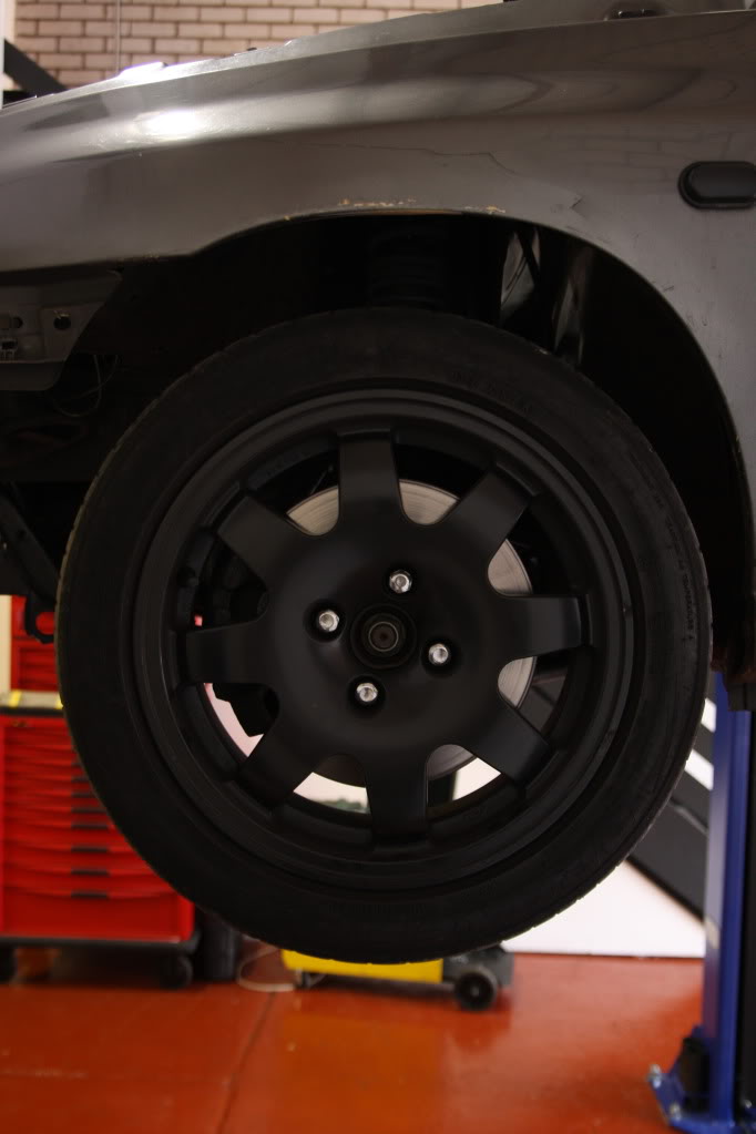

Someone asked for a pic of the 172 brakes behind a Williams wheel...
And one from underneath...
Done a few bits and bobs over the past few days, will post an update later this week!
Re: Mk1 172 Hybrid Track Car Project
Nah, not bothered.
Im pretty much sure something on the 172 widetrack dosent fit correctly (few mm's out maybe), and putting forces on bolts that they shouldnt be getting.
Going to replace all the subframe bolts with locktite in the next week or two, along with a few others, then spanner check the whole lot.
