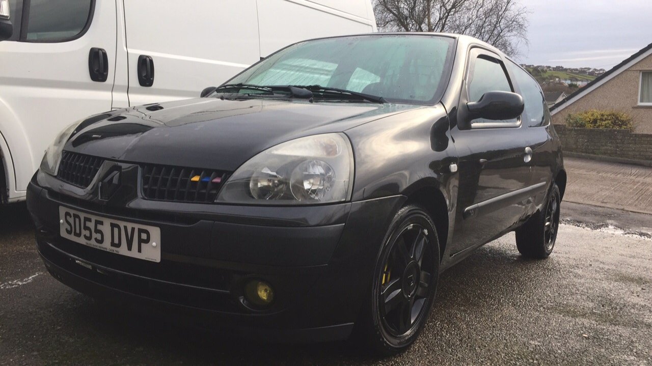

Hi guys, about to lower my Mk2 Clio Extreme, just looking for suggestions on what lowering springs I should buy eg. 40mm or 60mm, which brand to choose, what looks best, what rides best and if there are any major drawbacks to using 60mm over 40mm etc. as you can see from the photo the wheel gap is ginormous.....

You may need shorter shocks if going with 60mm as it'll be riding near the bump stops on standard shocks, therefore 40mm IMO would be best.

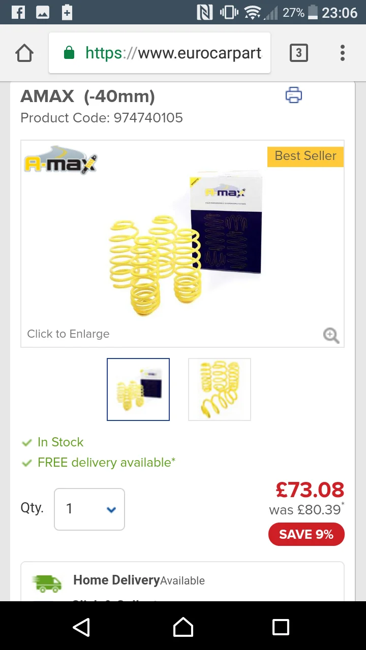

thanks, will probably buy 40mm based on this as i cant afford new shocks atm, plus my town is riddled with speedbumps :(
