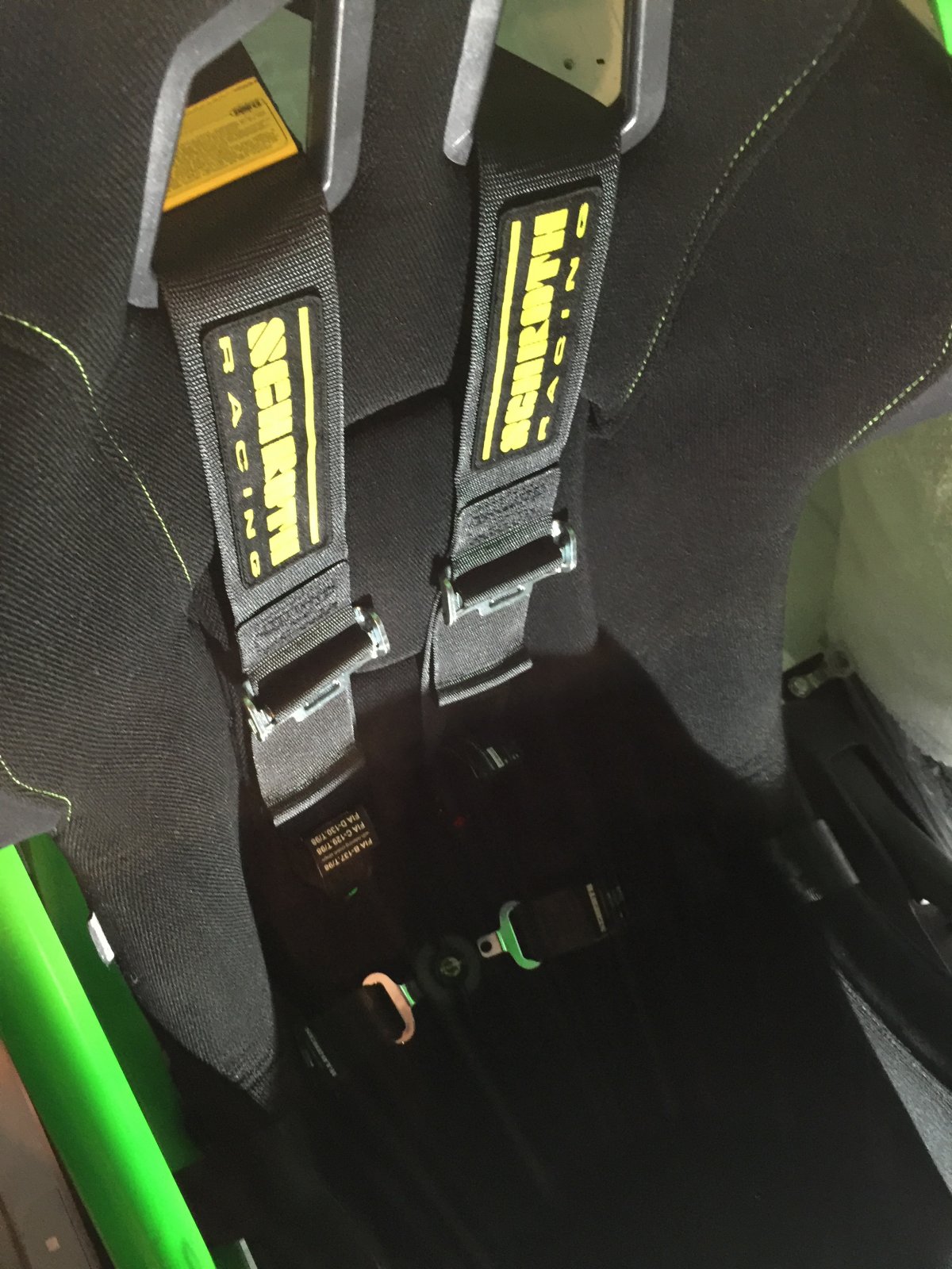

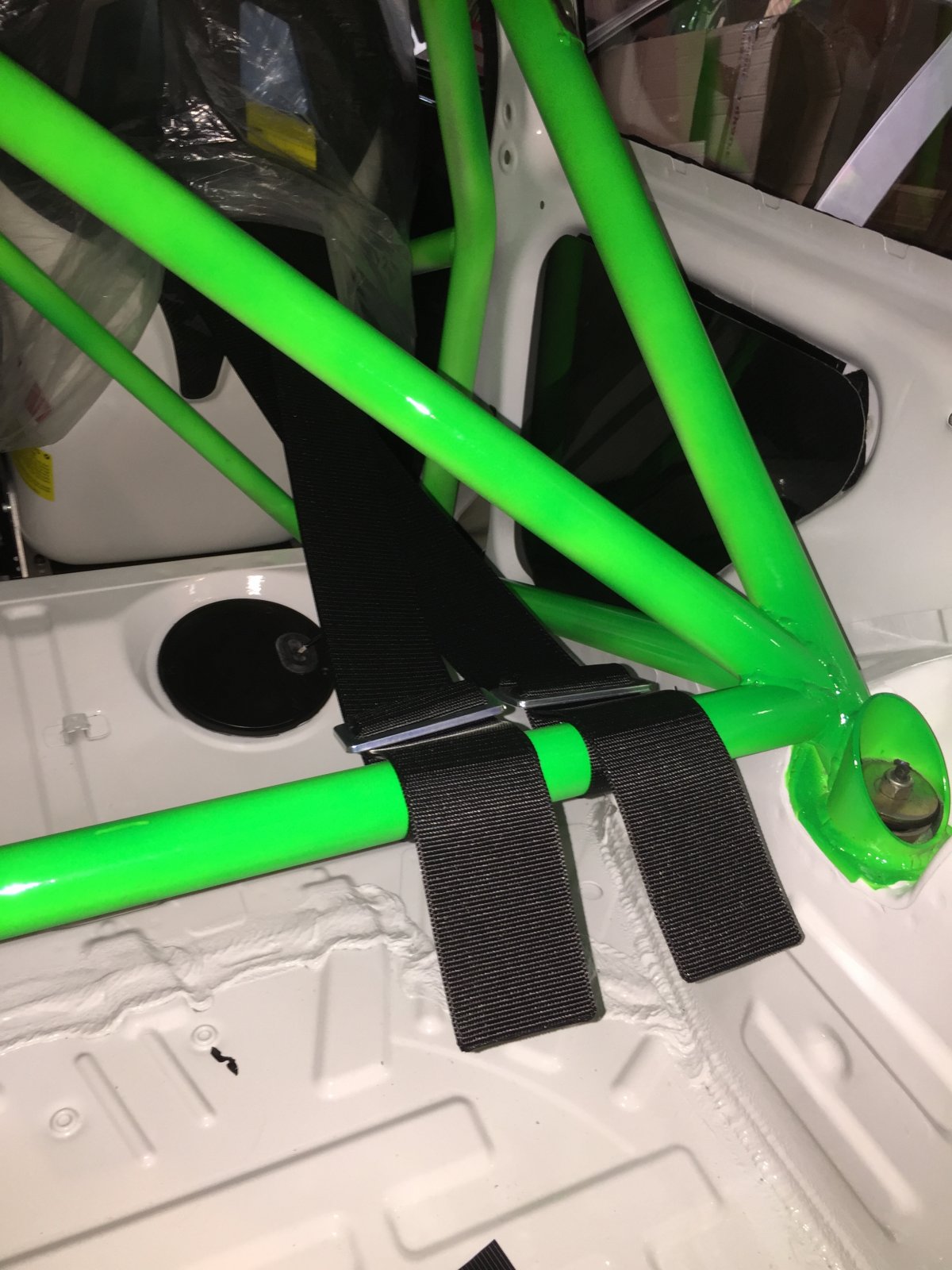

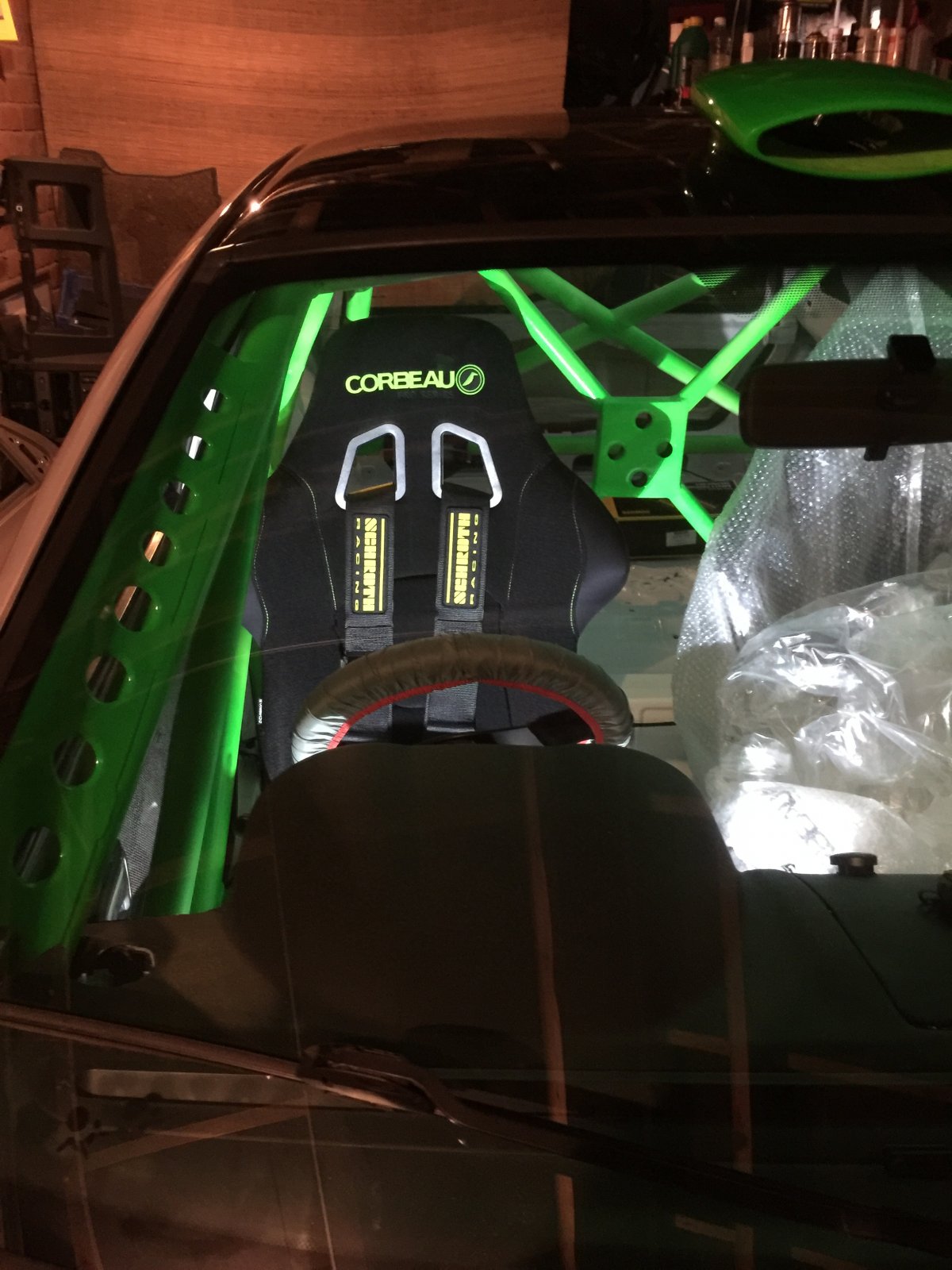

Finally I have managed to get the drivers side harness fitted it been a week of getting frushed with it and spending money on different parts they are in and look great. I have the other set coming on Monday so will fit them the week after next as I am at Le Mans next week :) and then just trying to sort insurance for the car and we are all good to go :)
Here are some pictures of the harnesses fitted

With those harness, do the shoulder straps wrap round a cage ? And.. Did you use the schroth brackets both sides on the seat subframe ?

Yes matey they wrap round the rear part of the cage (looks like a strut brace but is part of the cage) I will get some closer pictures of the strap round the back and the brackets.

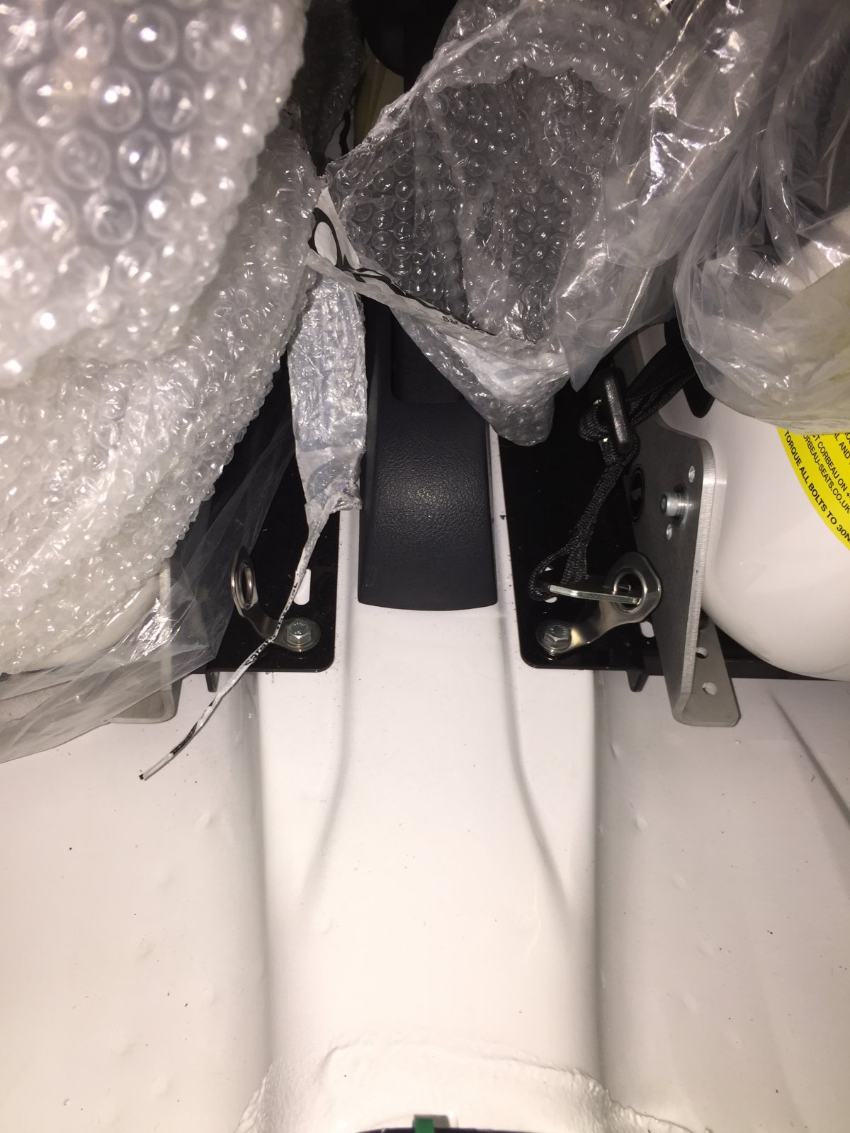

And yes mate I ended up using the schroth B23a snap brackets because the space I had the eye bolts wouldn't work. I was told by MSAR I believe they are called these snap brackets are safer than the eye bolts. Again I will get some picture to show where I have bolted them. Really good brackets to be fair and can be bent to suit the car and angles :)

Nice one Ben that's good to know..I do have a harness bar and pictures would be great.

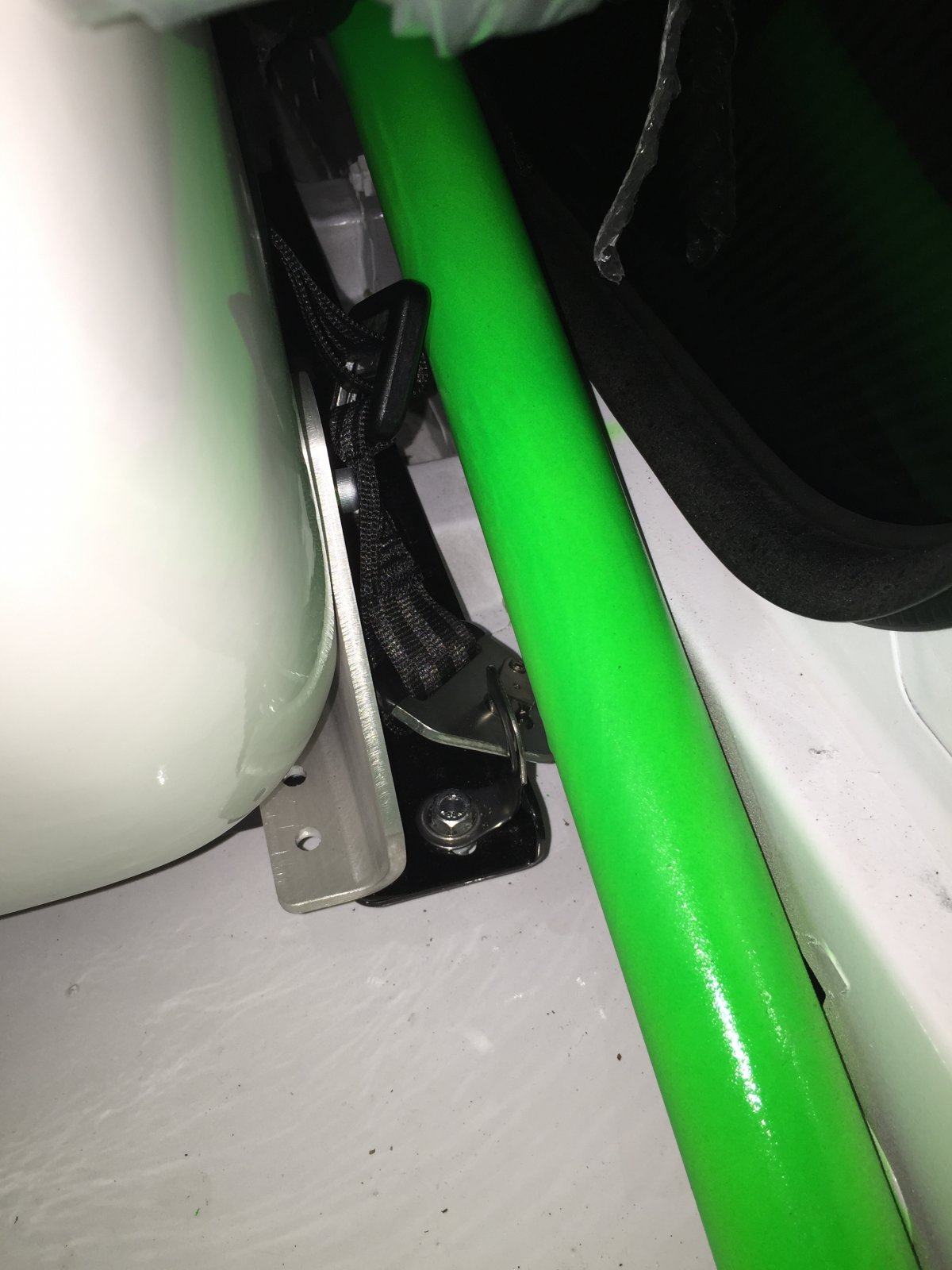

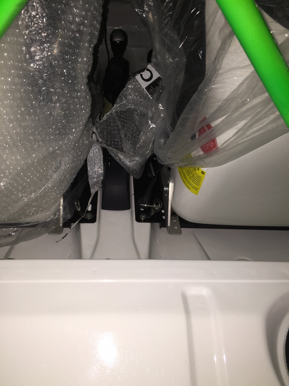

I took some pictures as soon as I got home :)
Yes that's the subframes I use there are brilliant drops the seat down perfect nice and low and well built. Yes if i was going to do it again I would use these snap brackets there are so much easier to use and look smart as well.
The centre brackets are bolted down with the subframe
The picture isn't brilliant for the outer one because I had no room to get my camera in because of the roll cage but this might give you an idea how it sits in the subframe
I hope this helps matey :)
I took some pictures as soon as I got home :smile:
I hope this helps matey :smile:
That's great Ben :up: didn't mean for you to get on it straight away :up::up:
Many thanks
Aren't the harness points meant to be on their own and not on a seat bolt?
I am pretty sure they are ok to be used with a seat bolt (subframe) I would never bolt a seat belt bolt to the seat I am pretty sure you are not allowed to do that. These brackets are designed to be used for tight spaces and to be bolted down with other components. Porsche use these a lot in there cars when the come with harnesses.
I did double check with a motorsport place and they said it was ok to do as long as the bolts are strong enough

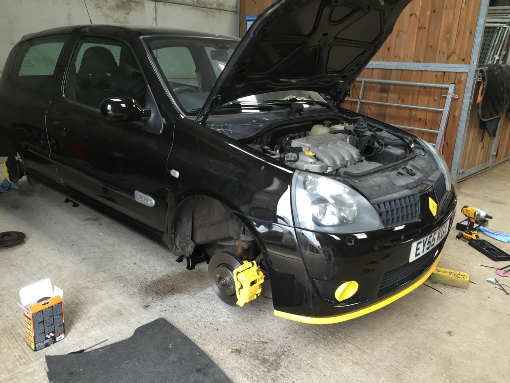

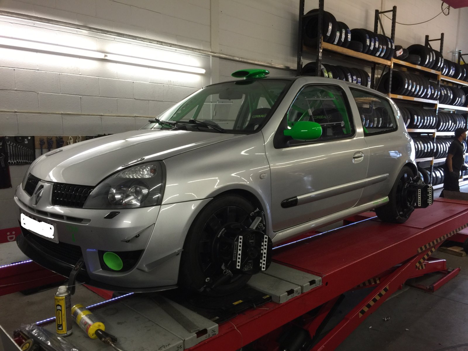

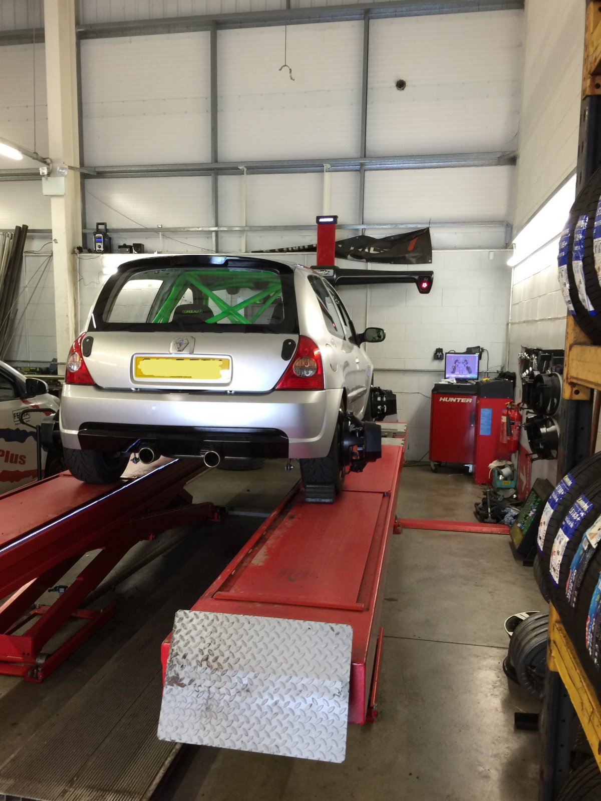

Finally got the old gal on the road had it MOTed and got the geo sorted want to change it to be more aggressive on the camber I think, it's set to about -2 degrees want more like -2.5-/3 degrees
However really enjoying the car nothing has broken on me yet or fell off (touch wood) just need to get the thing booked onto a track day (need to confirm which one)

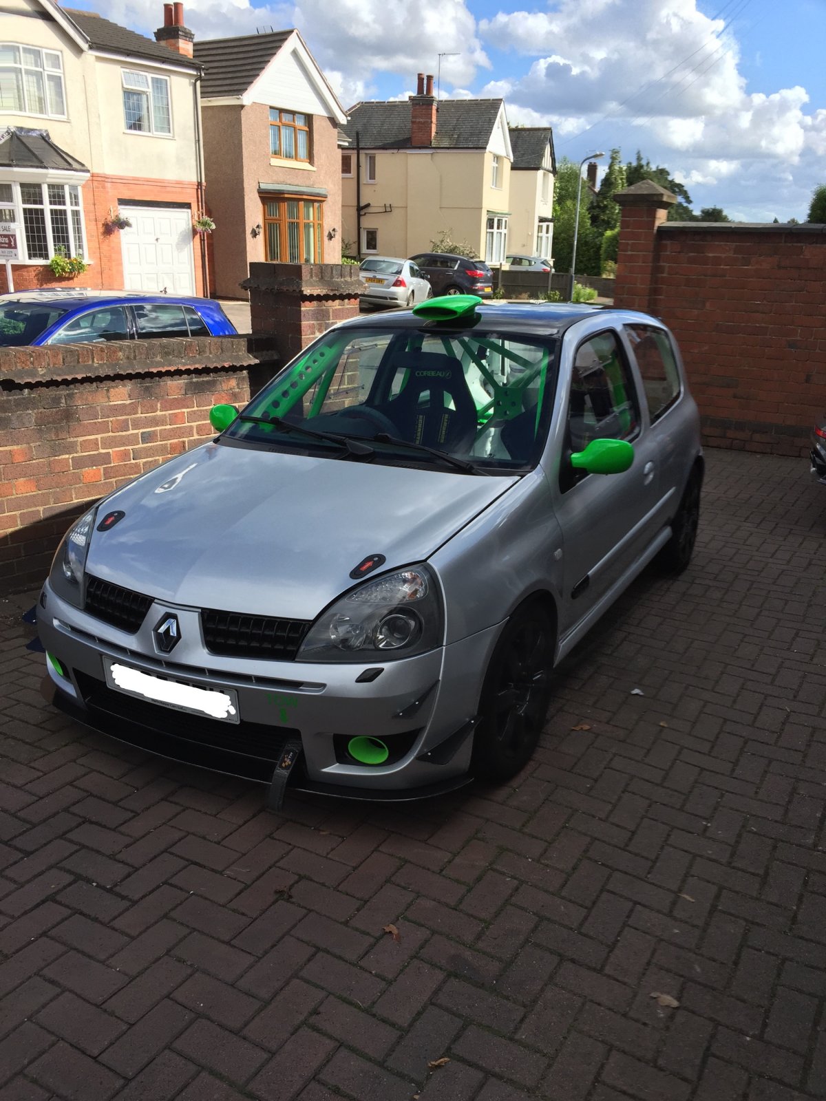

Also got the car cleaned and it has come up really well :)

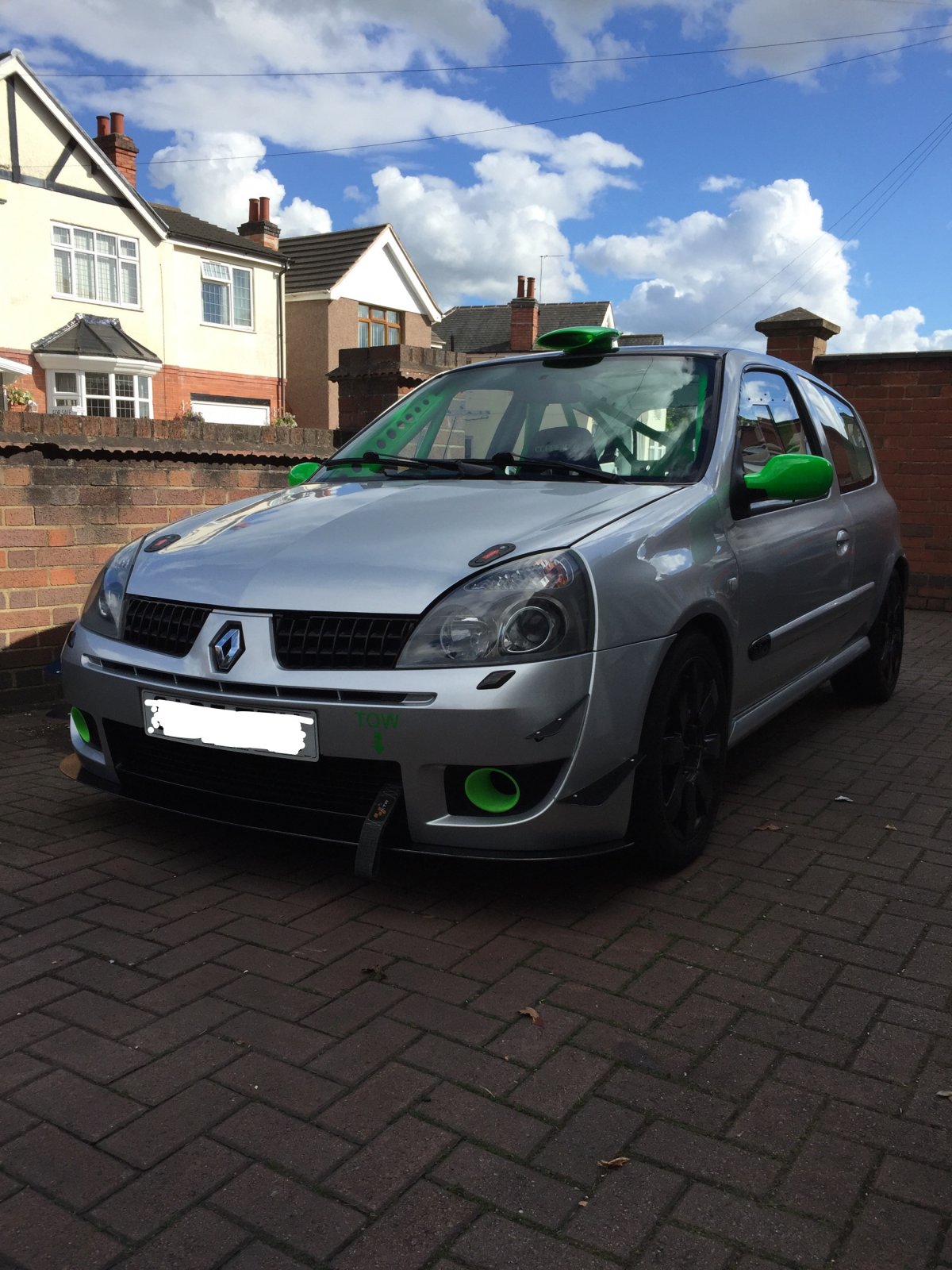

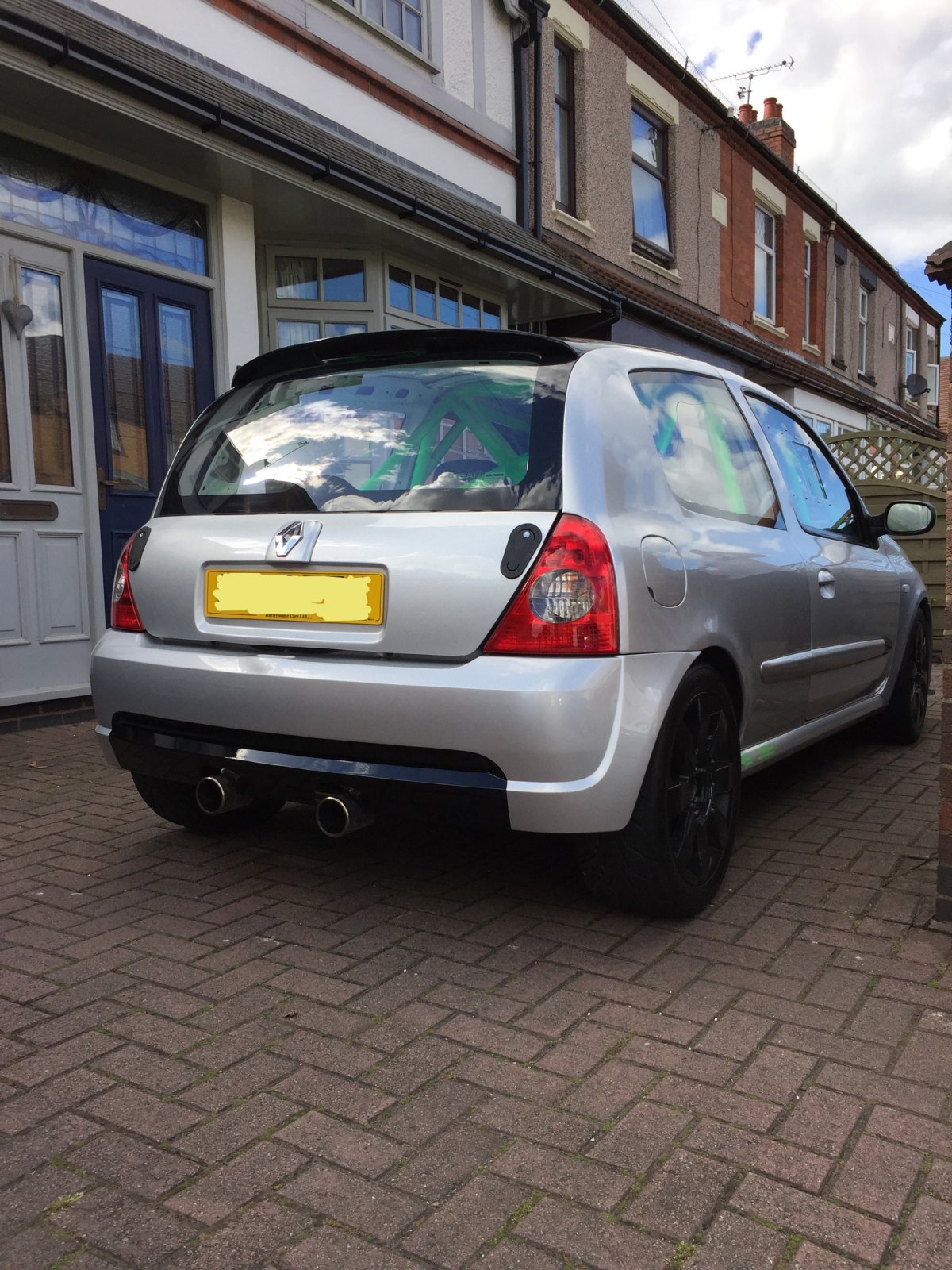

Some pictures of the car clean now

I am going to say stage one of the build is complete we have the majority of the big stuff done now I can do track days and other bits like go to shows with it but this doesn't mean the mods will stop I still have many more plans for this car they just won't happen as fast as stage one but I really want to make this a super super track weapon and maybe one day put it on slicks and go racing :)

This looks bloody incredible. My fav track car on here!!
Thank you very much mate I really appreciate that still deciding whether or not to have stickers on the side make it like a racing car (but tasteful stickers) maybe even BB Motorsport make my own sponsor haha

What about having the grill in anthracite ?
The car looks smart I like the yellow and black combo, maybe you could have the mirrors in yellow as well :smile:
I really like the white combo from how mine has come out I think with a yellow cage would look really good. As well in bright sun the yellow will reflect and tint the white interior and that would look good.
Are you going to keep the heater matrix and fans ?
The poly Windows do get hot because they don't have a tint in them like glass does but once you are driving they don't get silly hot.
Feel like im hijacking your thread here :P yeah the mirrors are going yellow and the grill will go anthracite when i get round to those bits. just want to get it track ready and get it out before "summer" goes again. Ive jumped on the group buy for some carbon fibre door cards so need to look into the poly windows a bit more and do it all at once. I havent really looked into the whole heater system, I need to find a good guide to removing the whole dash (i can only find the top of it) so i can have a good look and see what needs doing.
Feel like im hijacking your thread here :tongueout: yeah the mirrors are going yellow and the grill will go anthracite when i get round to those bits. just want to get it track ready and get it out before "summer" goes again. Ive jumped on the group buy for some carbon fibre door cards so need to look into the poly windows a bit more and do it all at once. I havent really looked into the whole heater system, I need to find a good guide to removing the whole dash (i can only find the top of it) so i can have a good look and see what needs doing.
It's all good mate haha :) that will look good mate nice and bright
