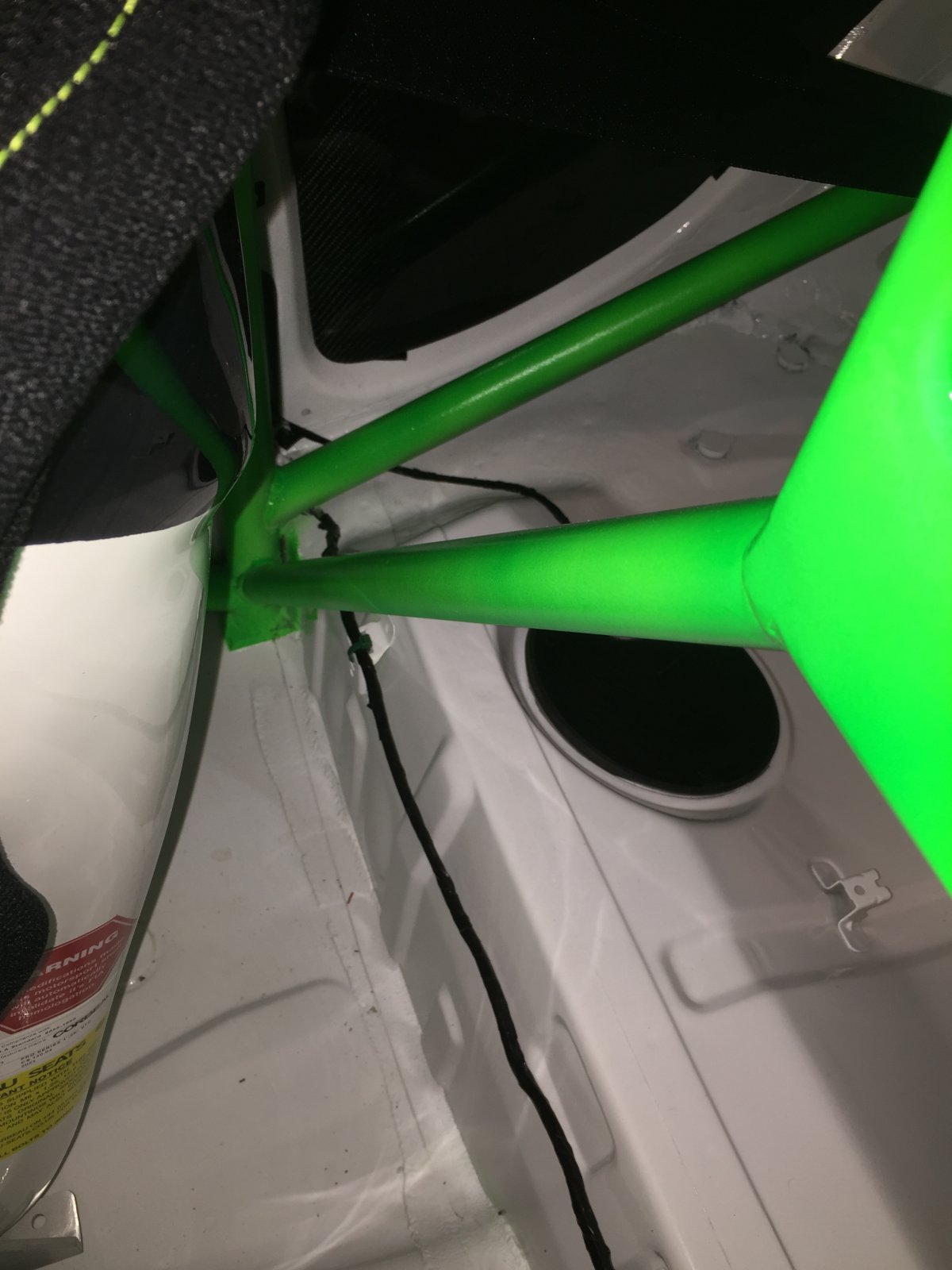

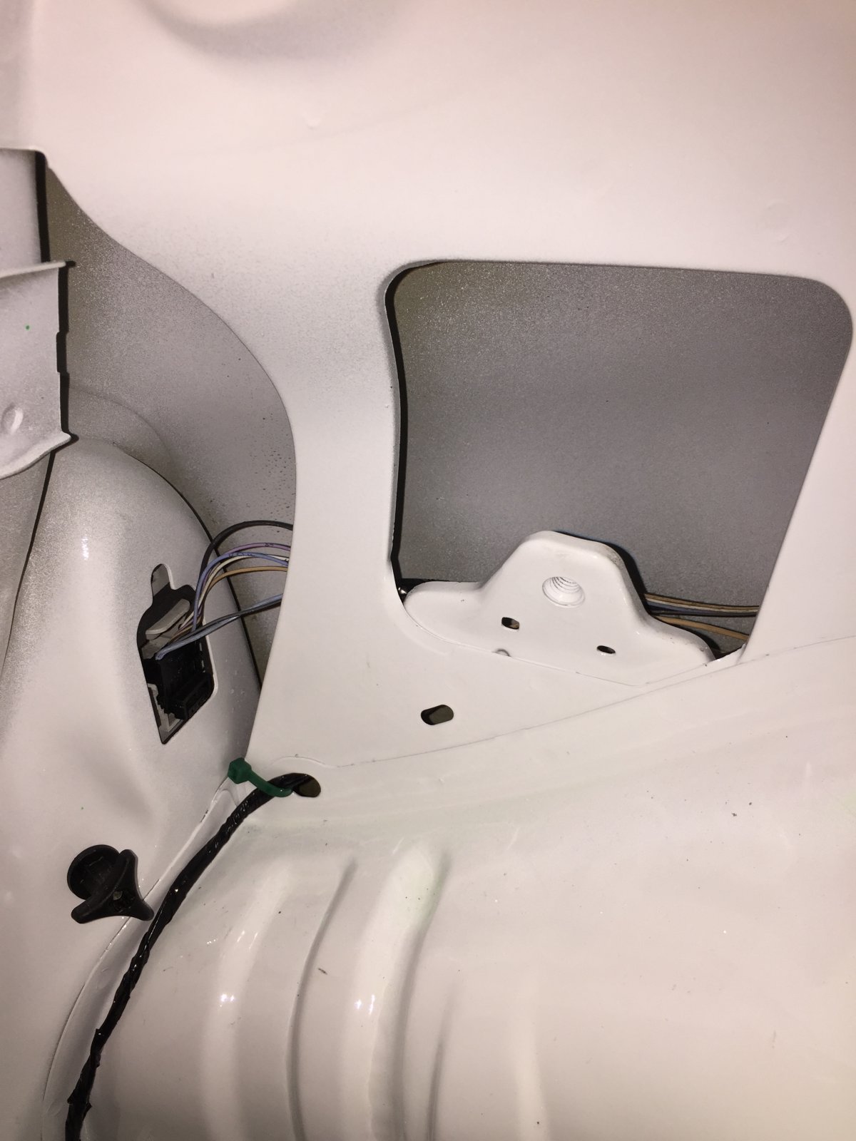

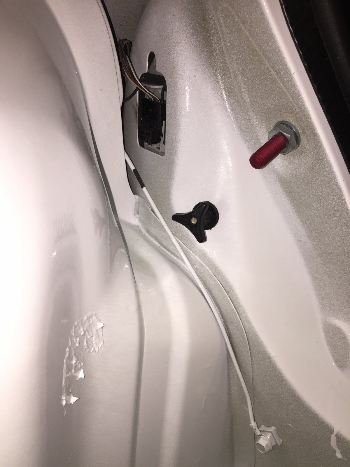

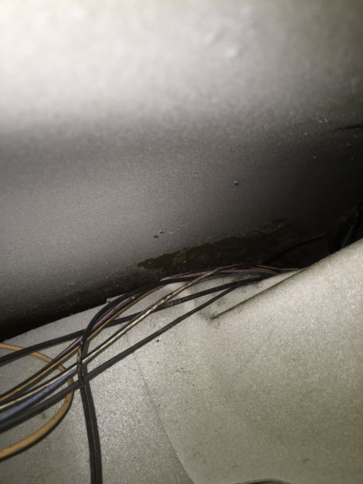

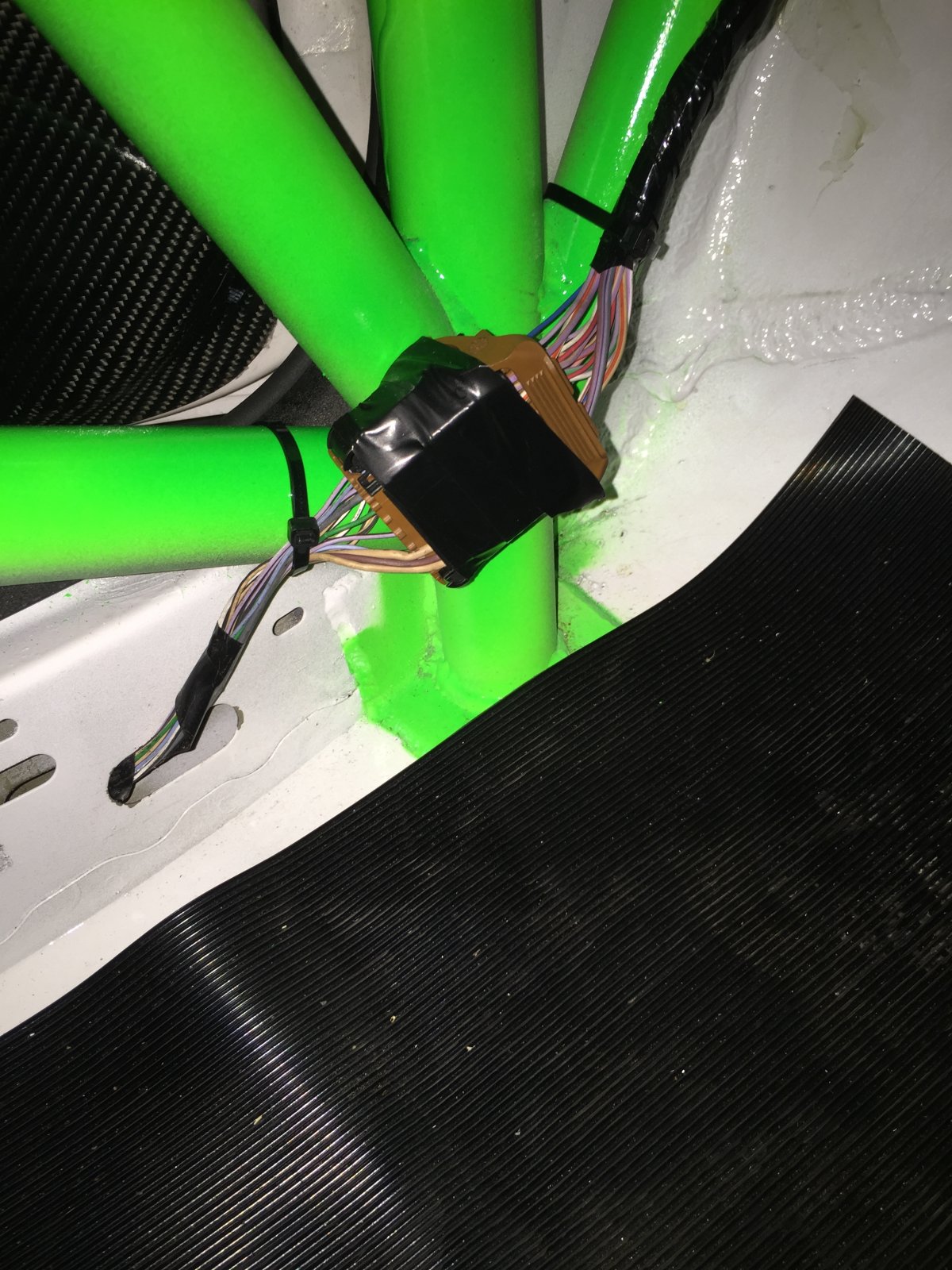

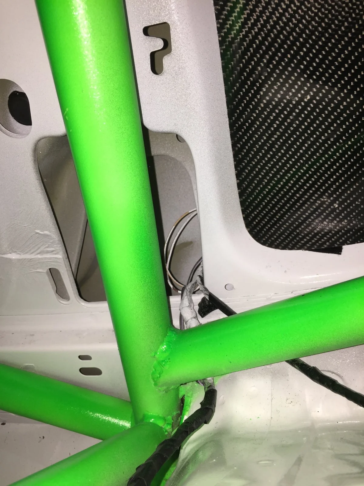

Here some pictures of how I have rooted the wires I am still working on the wires so some of it looks a bit messy but gives you an idea
Wires at the rear lights and the cable to the number plate light. (Right hand side)
Earth point for the lights (left hand side)
Cables go over the rear wheel arch. Bit messy but not seen but will be tidied up :)

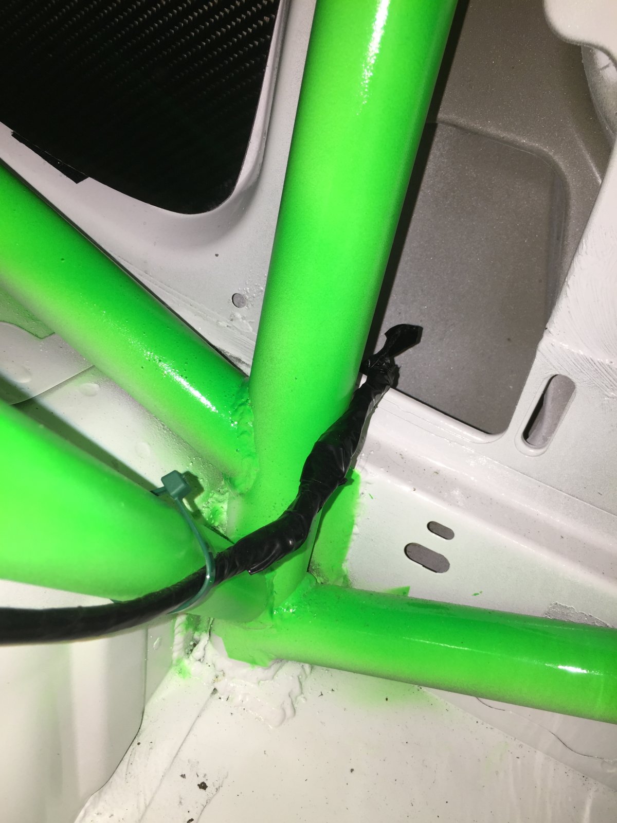

Not a great picture but this is the wires behind the rear door cars (black line on the right hand side)
Across the rear of the seats wrapped in insulation tape and to the fuel pump bit of zip tieing in green of course lol
  Clio 220 PH2
This is where the cable splits for the lights and the fuel pump
Crossed over to the other side where next it will run through the sill this is where we had to cut the wires
This where it exists the sill and connects to the multi plug

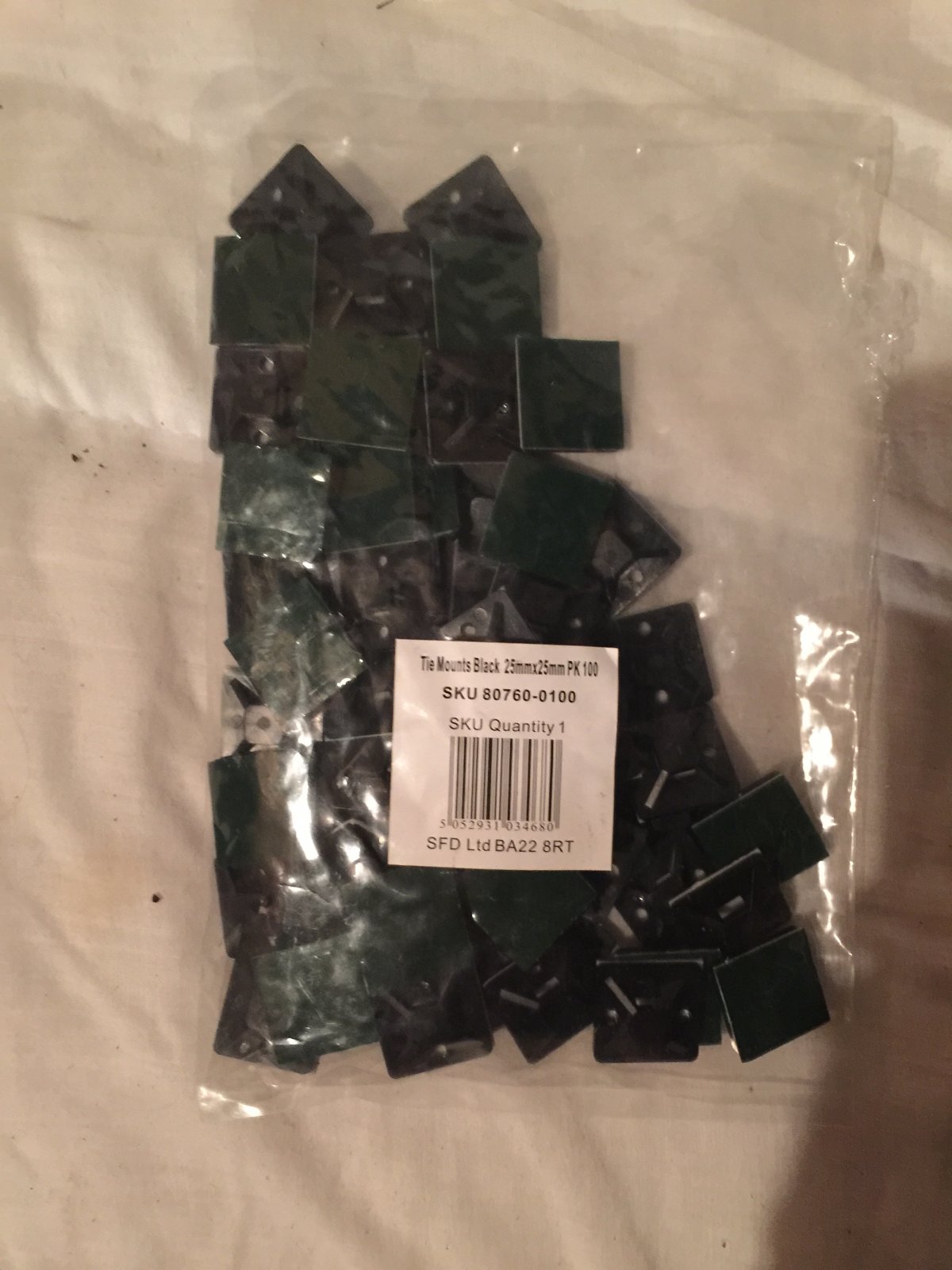

And these are the sticky pads I have used to keep it neat behind the panels

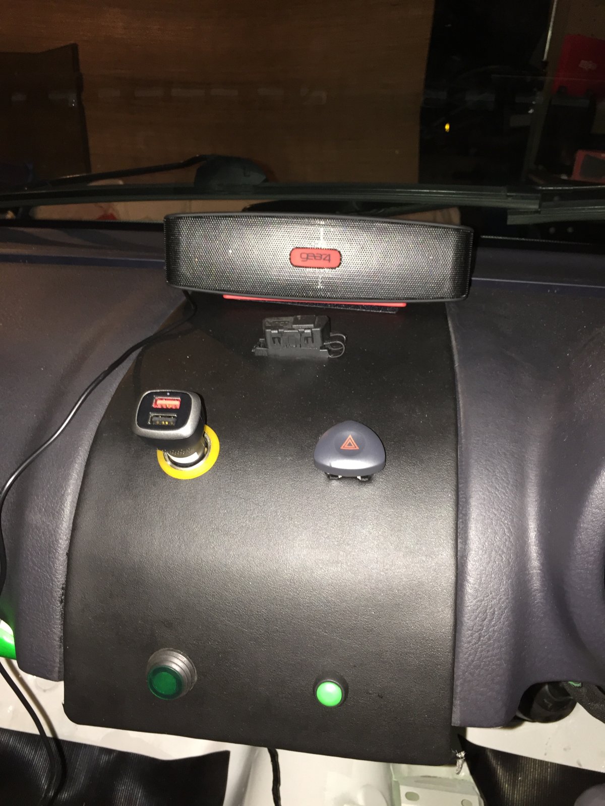

Finally got round to fitting my radio and also has a hands free setting on it as well :) all the mods on this track car haha
The only down side is at 70mph I can not here the radio haha the joys of a loud exhaust and stripped interior
I have Velcroed it to the dash so when I get to the track I can remove it and go even faster :)

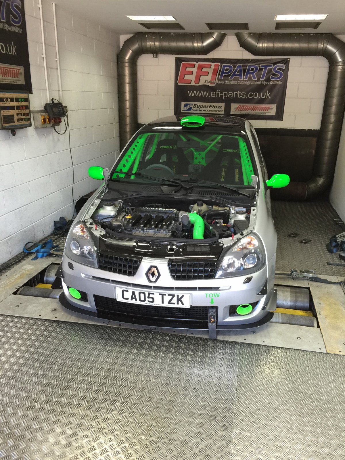

Little update

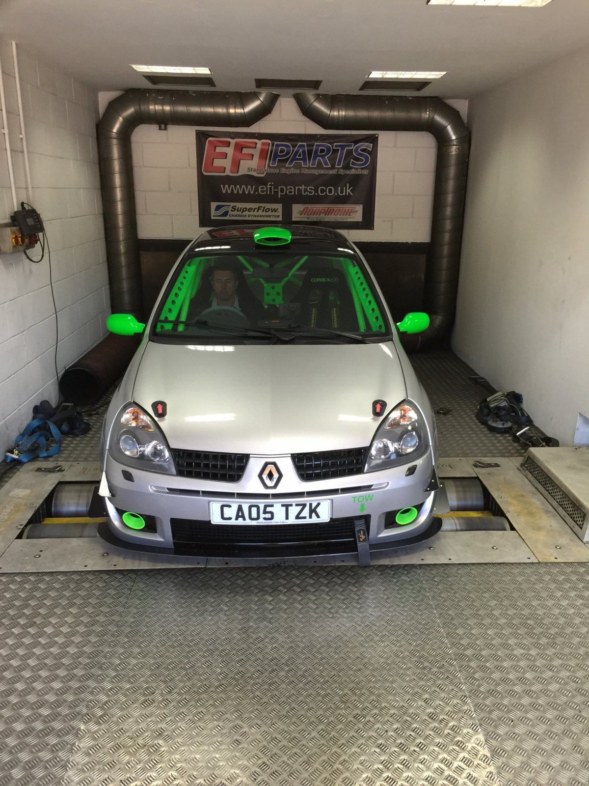

The car went down to EFI on Monday to get a remap done to make sure the car is running sweet with the mods I have done. While I was in the area me and my friend popped to demon tweeks to get a new visor for my helmet and a fire extinguisher for the car (hopefully never need to use it) I will be fitting it Wednesday so I will get some pictures once fitted plus a new sun strip as well.
Here's a picture of the car on the dyno
Had to run the car with no bonnet just to keep it cool normally you have to have the bonnet up but being fibre glass it might of broke with the fan lol
Massive thank you to Chris at EFI he is a star I would highly recommend him if you are thinking of getting a remap spot on
The car with no map on made 182bhp (just the mods I have done) and then after Chris did his magic it now is running 188.3bhp which I am over the moon with :)

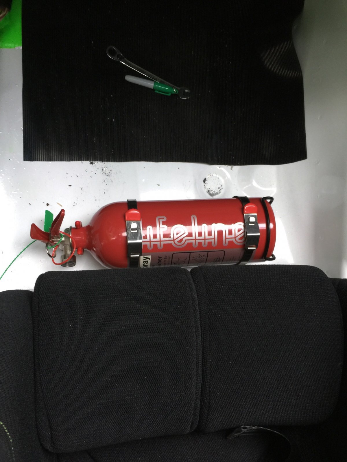

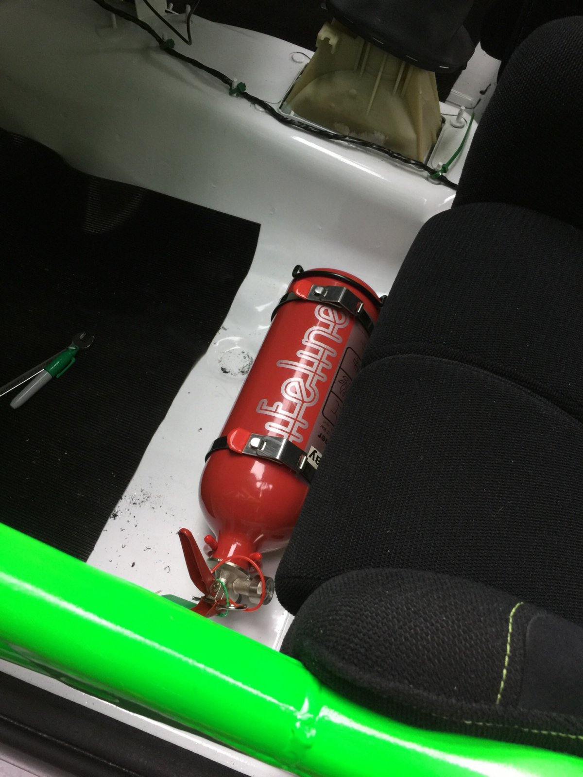

Managed last night to fit my fire extinguisher and my sun strip ready for my track day tomorrow which I can not wait for :) I will try and get some videos and upload to YouTube for you to have a look at
Here are some pictures of the sun strip and fire extinguisher
Just missed the brake lines with the drill which was nice :)
I think it looks nice on the car and really does help with the sun very happy with it

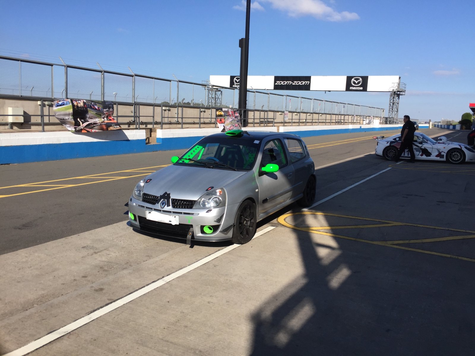

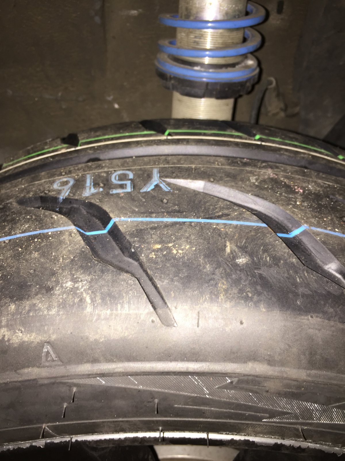

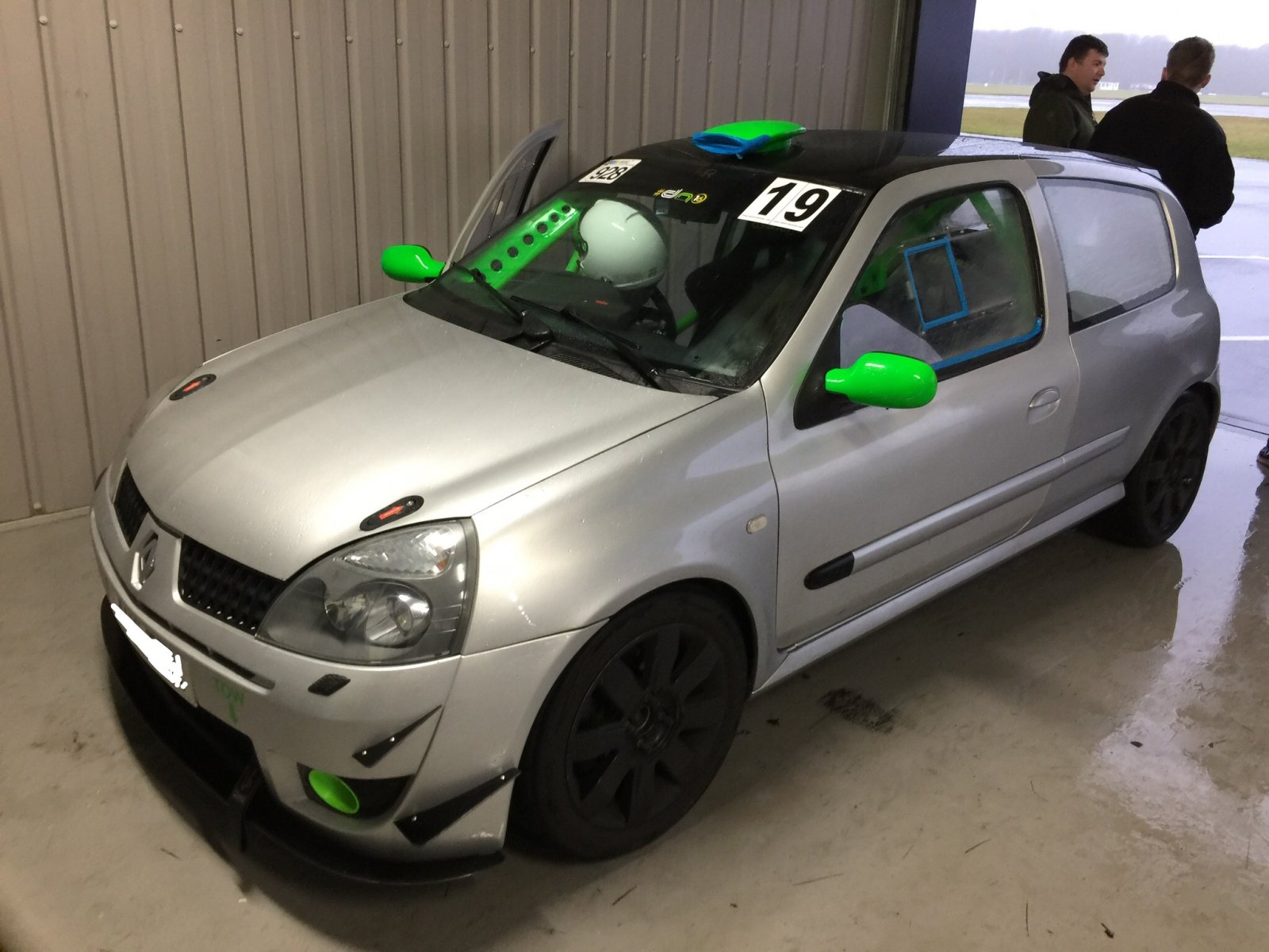

Had a brilliant day at donington on Friday the car was a massive improvement over the last track day it's night and day better than before I am so happy with it. However it didn't come without war wounds I managed to get a stone chip on the windscreen and the bonnet started to break at the front so we had to use the trusty duck tape haha

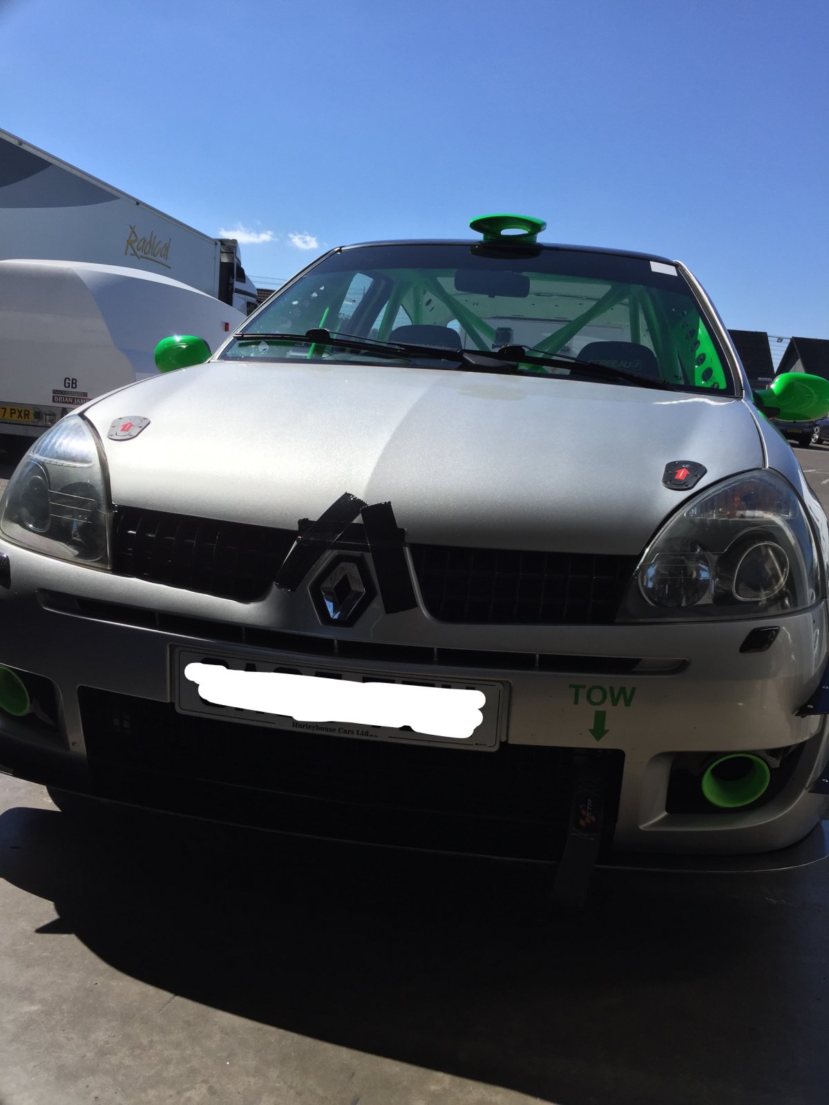

How the car started in the morning
An hour and 47 minutes into the track day the duck tape came out lol
And the little chip hard to see but it's there
It's just above my phone in this picture

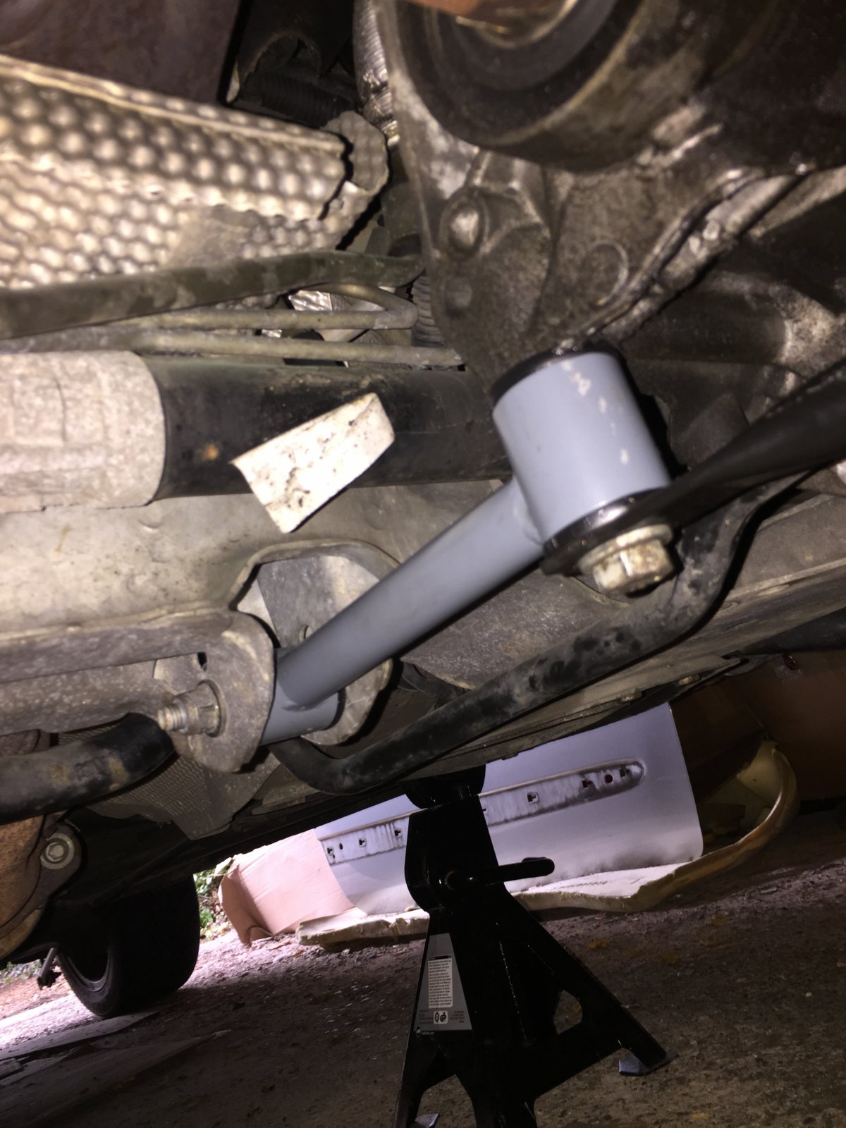

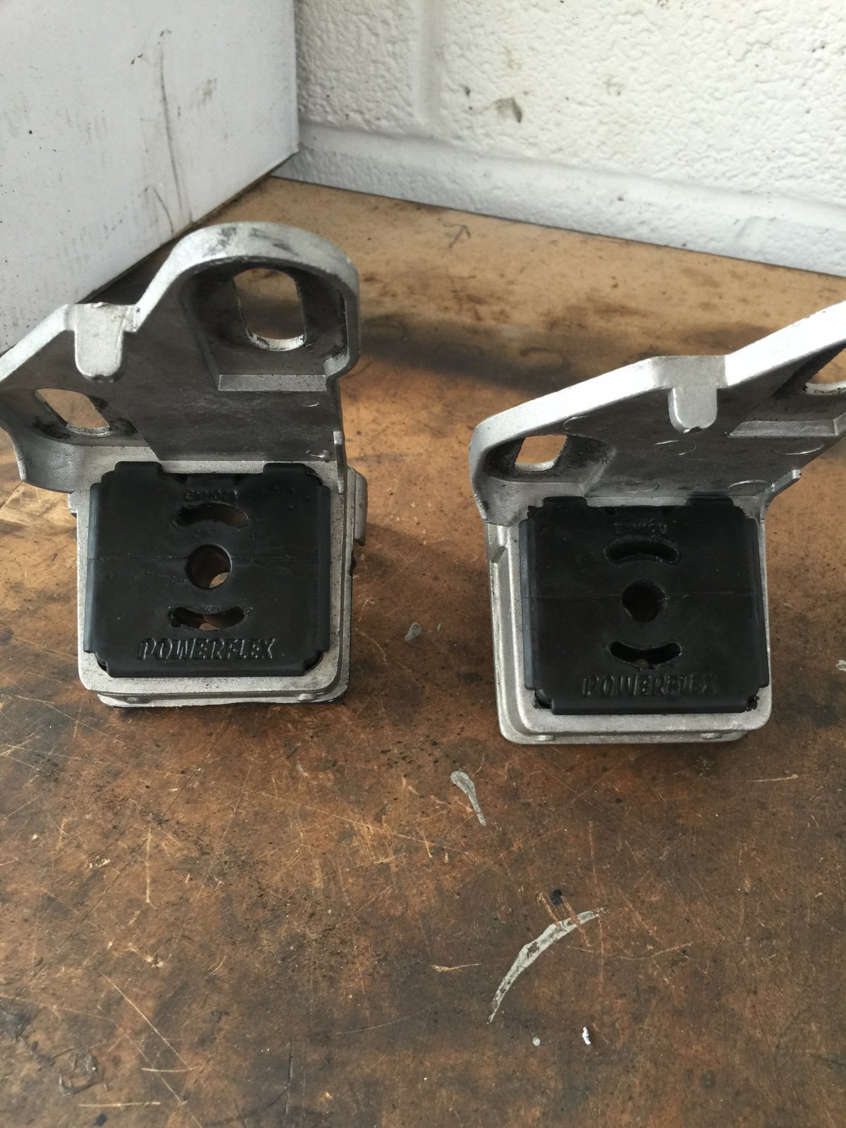

Been a little bit quiet on the old Clio front lately but the old gal has had some new mods done to it :)

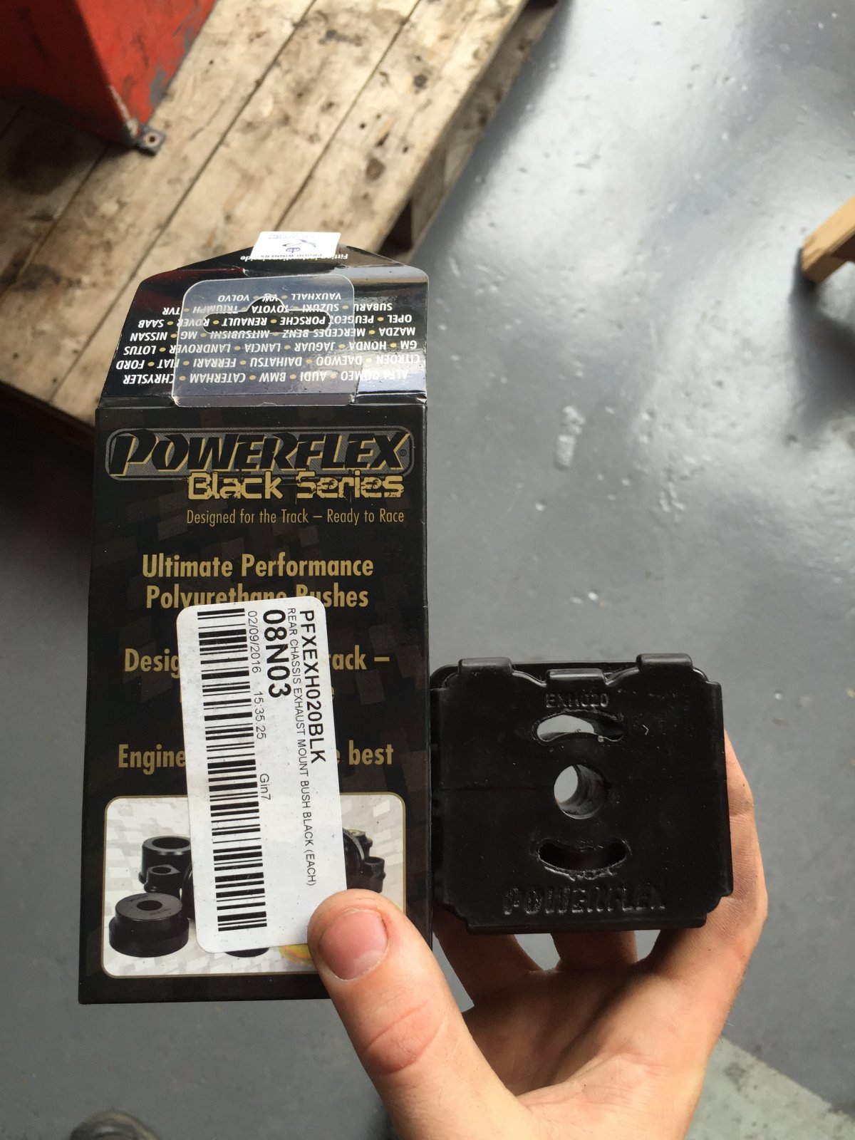

I have gone through a set of rear exhaust mounts in less than a year so I thought I would make myself the uprated powerflex black edition bushes to make sure the exhaust doesn't keep melting my bumper
Here a picture of them
Shiny and new bushes

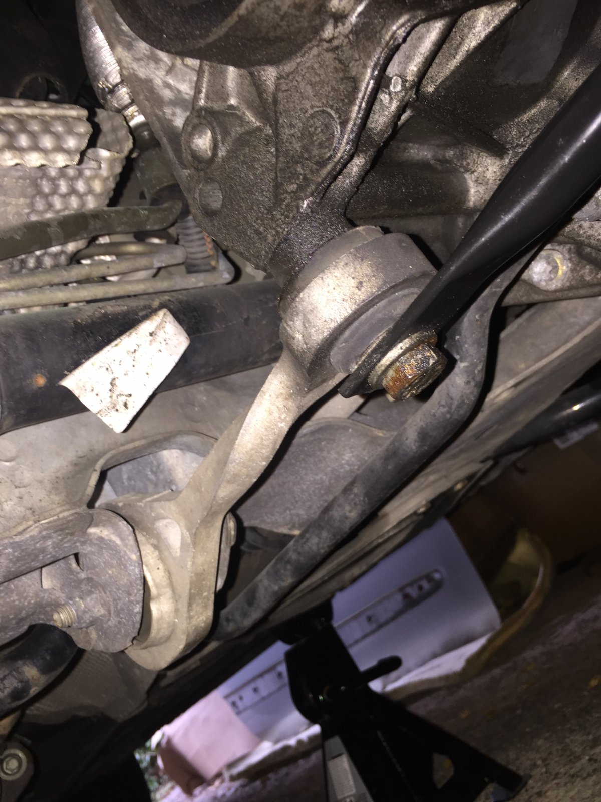

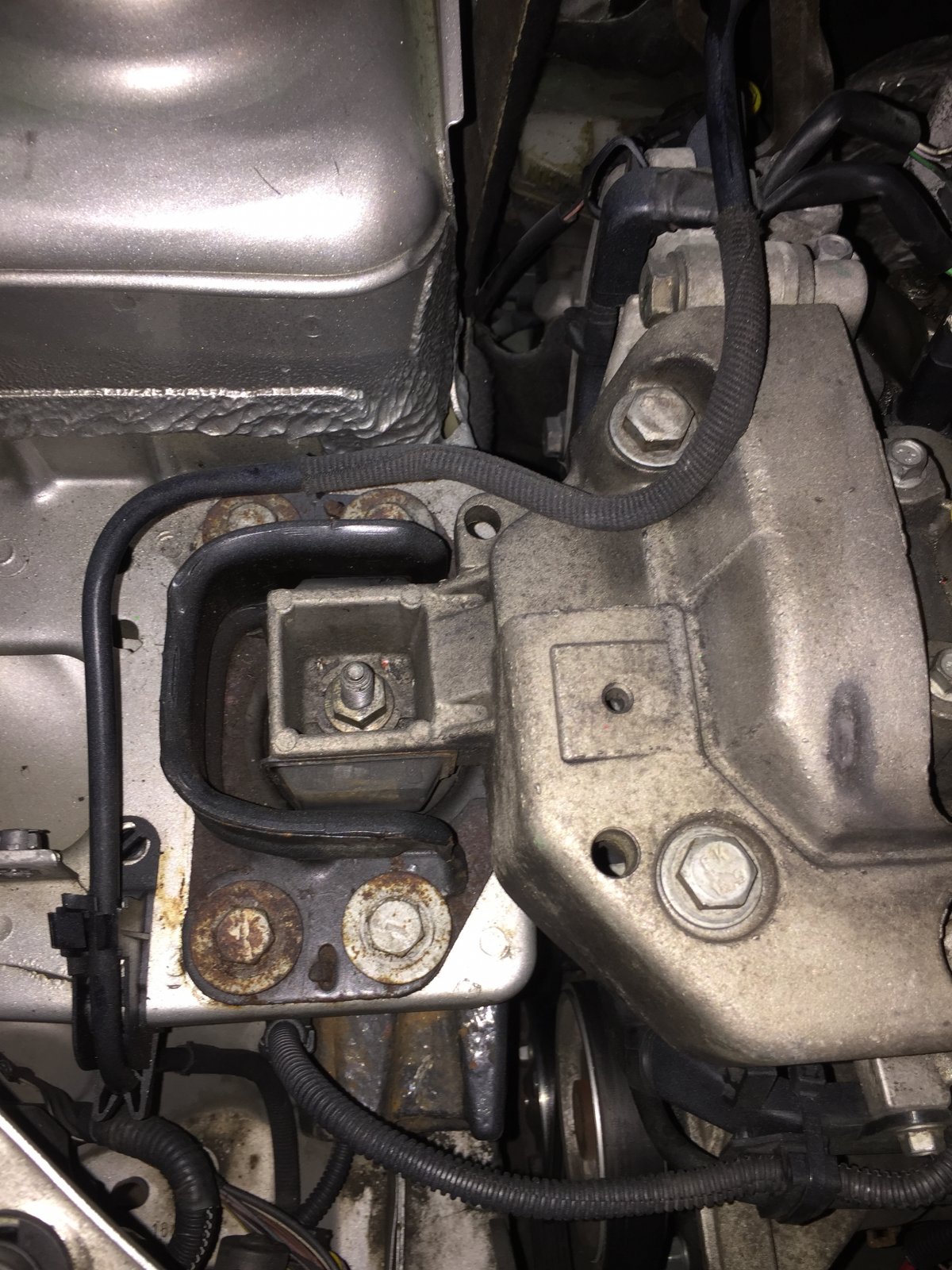

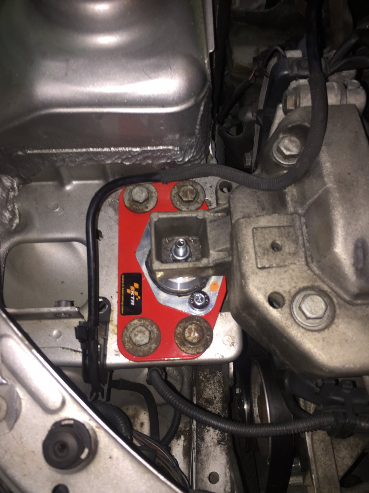

Also while I was upgrading the mount I would do the engine mounts and stabiliser bar as well because the engine is rocking and the exhaust manifold is hitting the subframe
Old
New
Did the gearbox mount as well but I forgot to take a picture of it sorry all
But here's a picture of the engine mount
Old
New

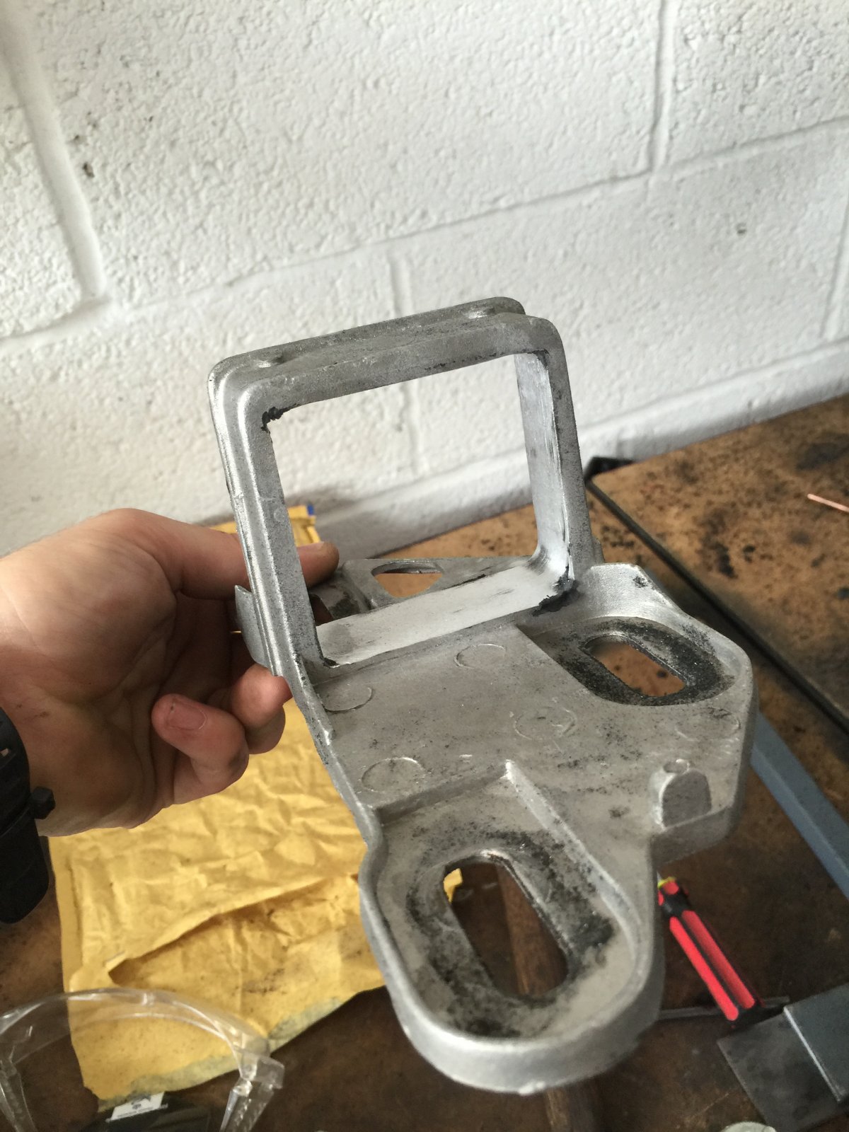

I also took the metal block that sits under the engine mount as well ( that weights a lot)
Made a massive difference to the car once it was all fitted feel really solid and complete. It almost feels like the car and engine are one

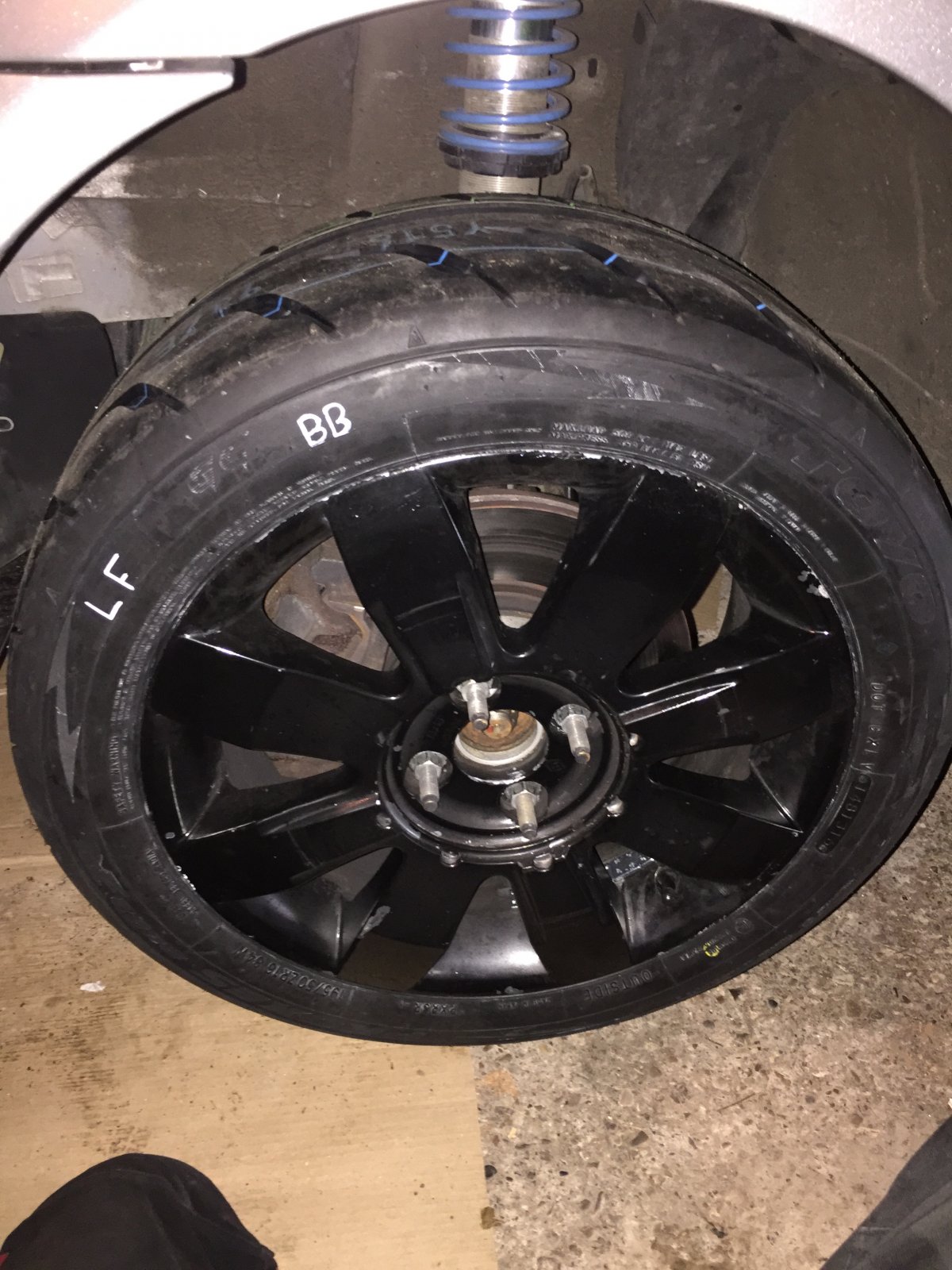

Another small update to be added I had to buy new front tyres for the Clio as donington pretty much finished them off for road driving they will do another track day but as I have a big old drive to Germany soon the best and safest bet was to put new fronts on. I went for in the end the toyo R888Rs as I have only good things to say about toyo track tyres so stuck with what I know. Just a few pictures of the new rubber fitted :)
Looking forward to testing these out see how much different they are to the standard 888s the next update will be getting the car finished for the ring :)

Looks mint. Does that mean another aerocatch for the centre of the bonnet? Or some of those elastic quick release things? :smile:
Whats the process for removing that big chunk of metal, and does it actually serve a purpose? I remember reading about it a while ago but never got around to it. Will be putting black powerflex engine mounts in mine soon so may as well do it while I'm at it.
  Clio 220 PH2
Thanks mate :) I think I need to come up with a solution for the bonnet rather than duck tape lol I need to keep a clean look I am not sure if lowing the height of the bonnet will help but an aero catch is a possibility
How I did it was lift the engine up remove the engine mount completely and there's one bolt that holds that big block thing in, remove that and lift it out and then refit the engine mount and job done. It hasn't effected my car a part from saving some more weight :) I see no reason for that block to be there
Best time when you are doing the engine mount mate just get rid of that block :)
