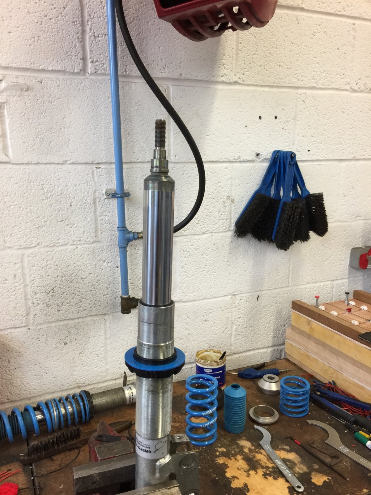

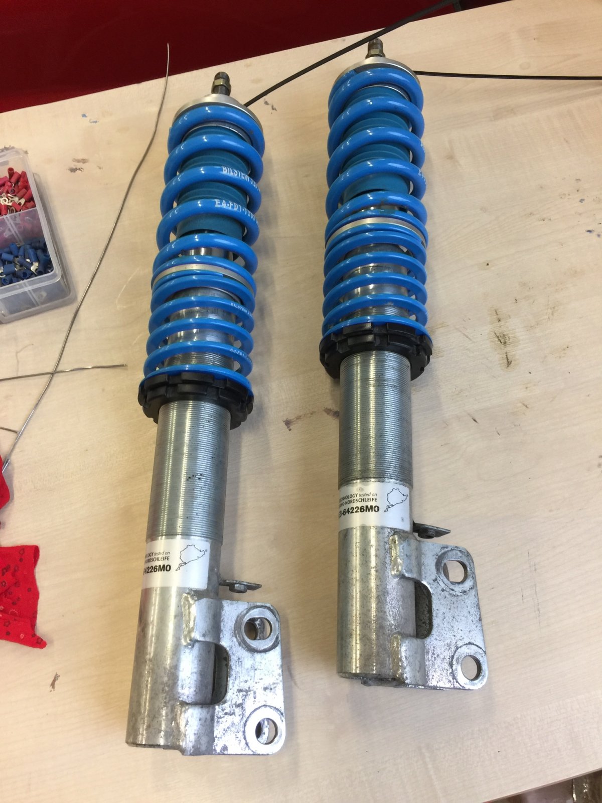

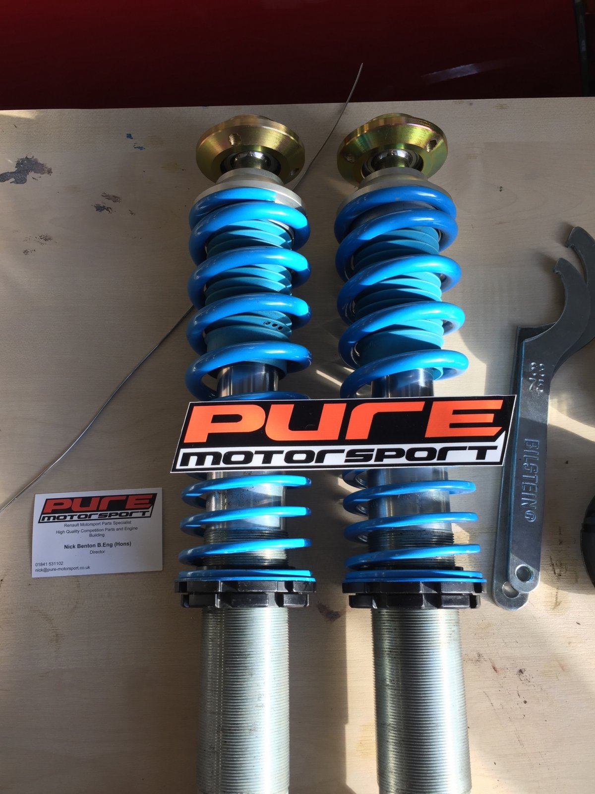

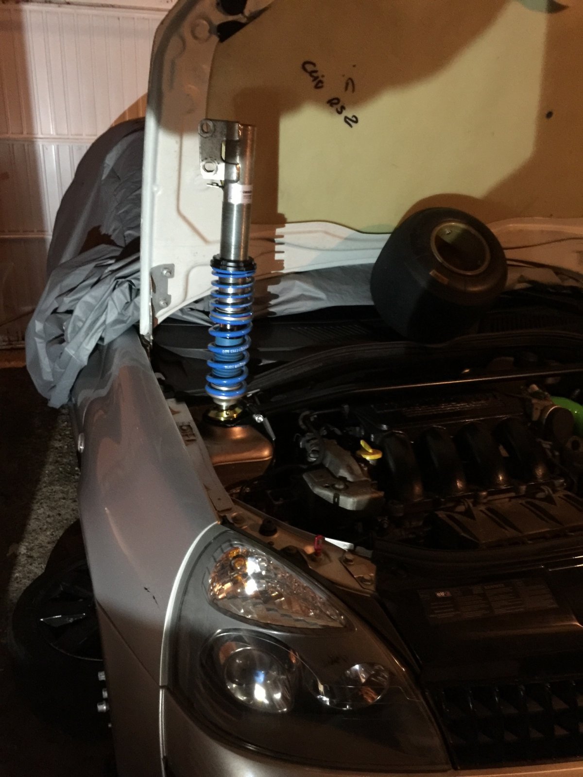

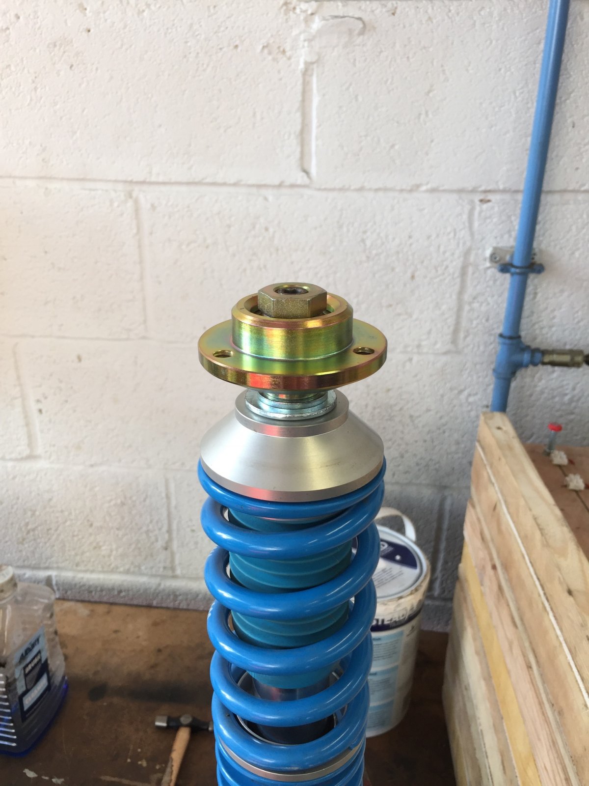

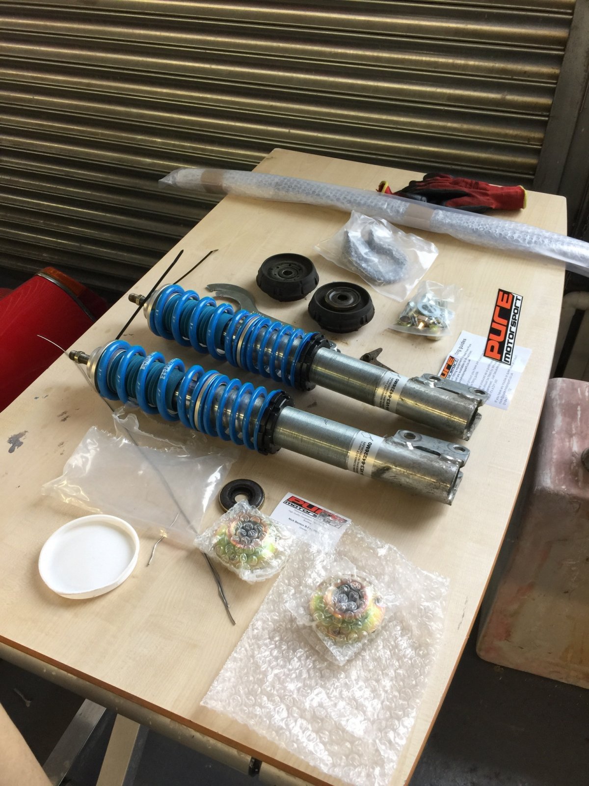

Just a small update got some new shiny bits for the car and also did some cleaning of the suspension.
Stripped the B14s down and made sure everything was deseized and cleaned correctly. After Bedford the suspension has dirt and muck in them so a good clean was required before Bedford again on the 4th March :)
Few pictures of the suspension

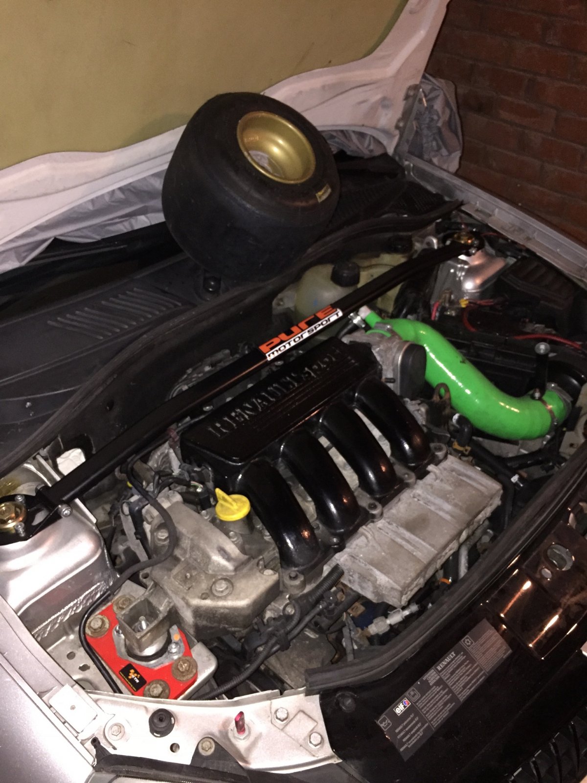

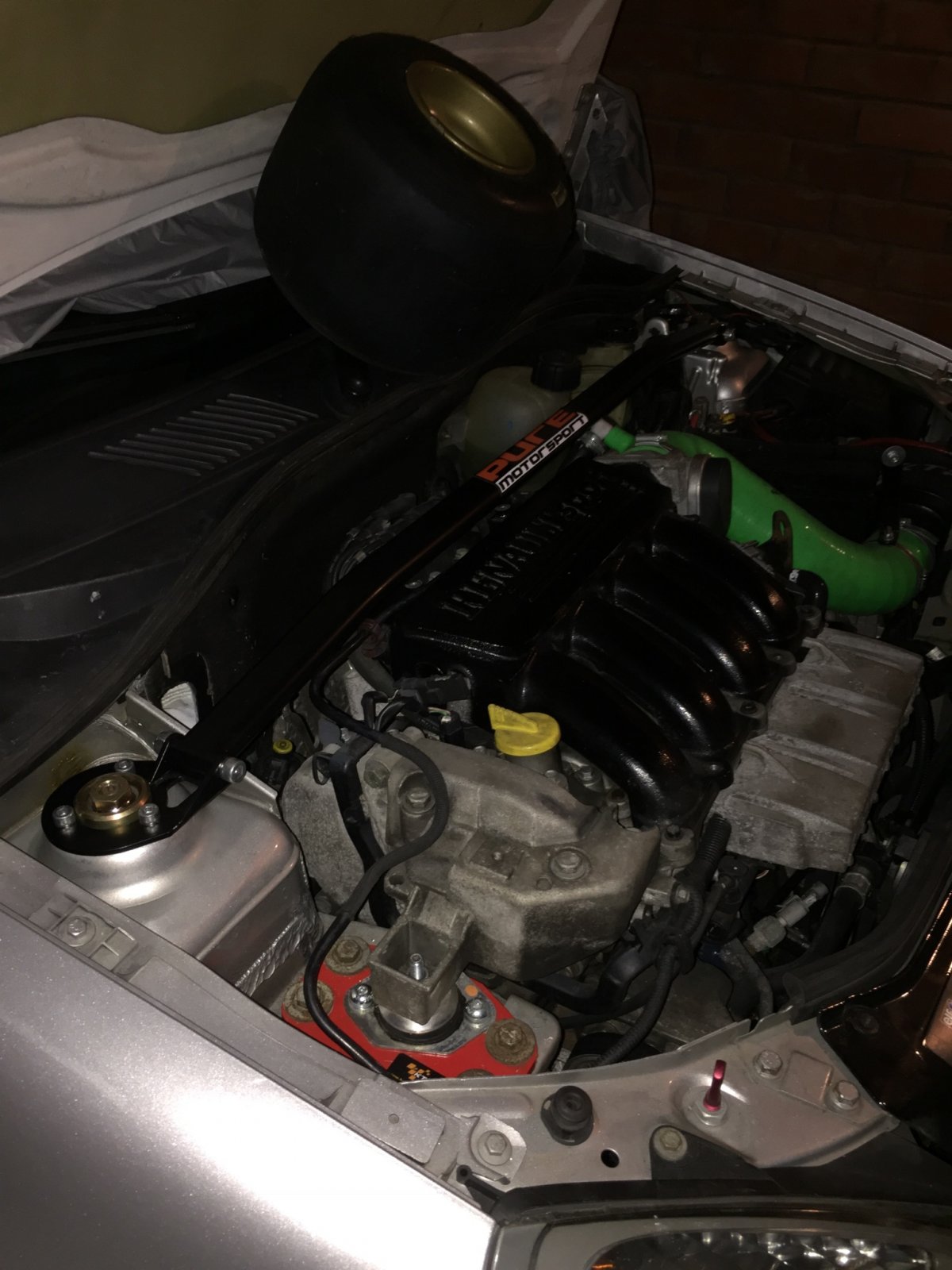

I also got myself some PMS solid top mounts and PMS strut brace, such a nice bit of kit I am really impressed with the quality and the fit. All I had to do is grind a bit out the suspension turret because the hole was not perfectly round for some reason not sure if anyone else has had this ? But all is sorted now :)
Something doesn't look right here haha
And a picture with it all fitted :) can not wait until I can test these out properly roll on Bedford on the 4th March
  Clio 172 Merc ML55
I had to do exactly the same when I fitted my pms set up, massive improvement over standard top mounts though aren't they :)

I had to do exactly the same when I fitted my pms set up, massive improvement over standard top mounts though aren't they :smile:

At least I am not the only one lol I don't know why the standard holes are egg shaped or at least mine were

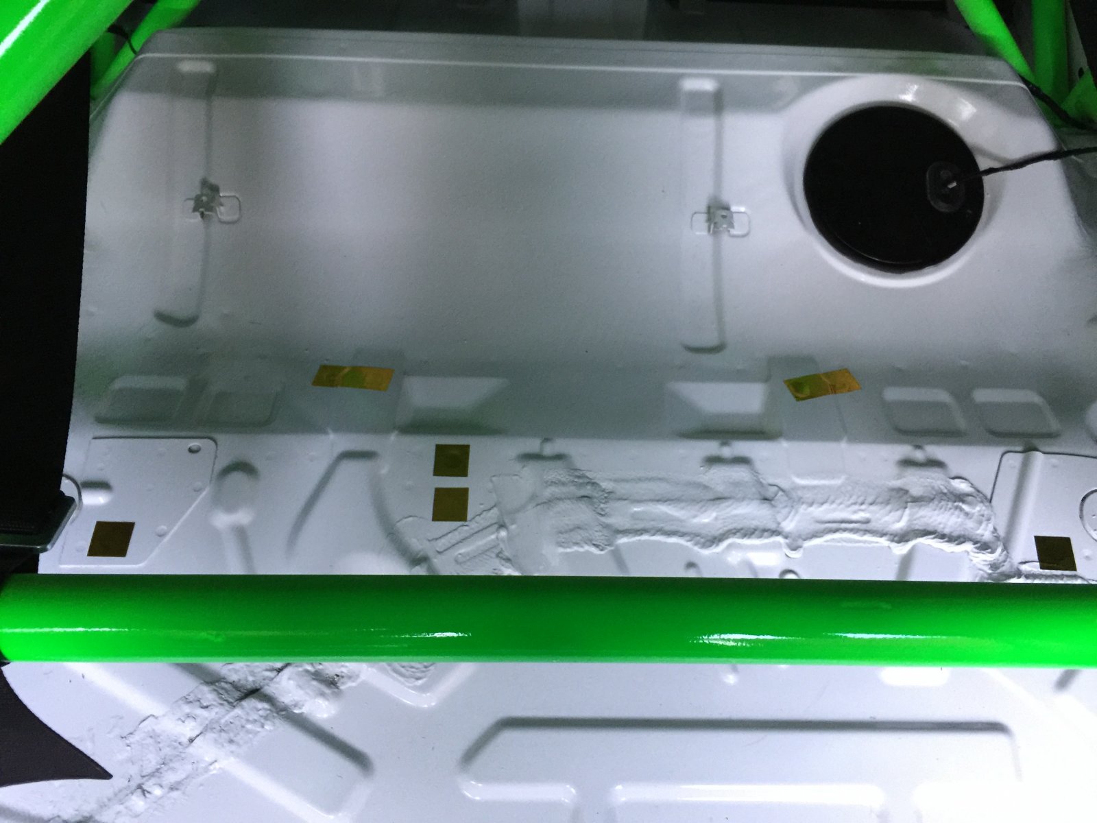

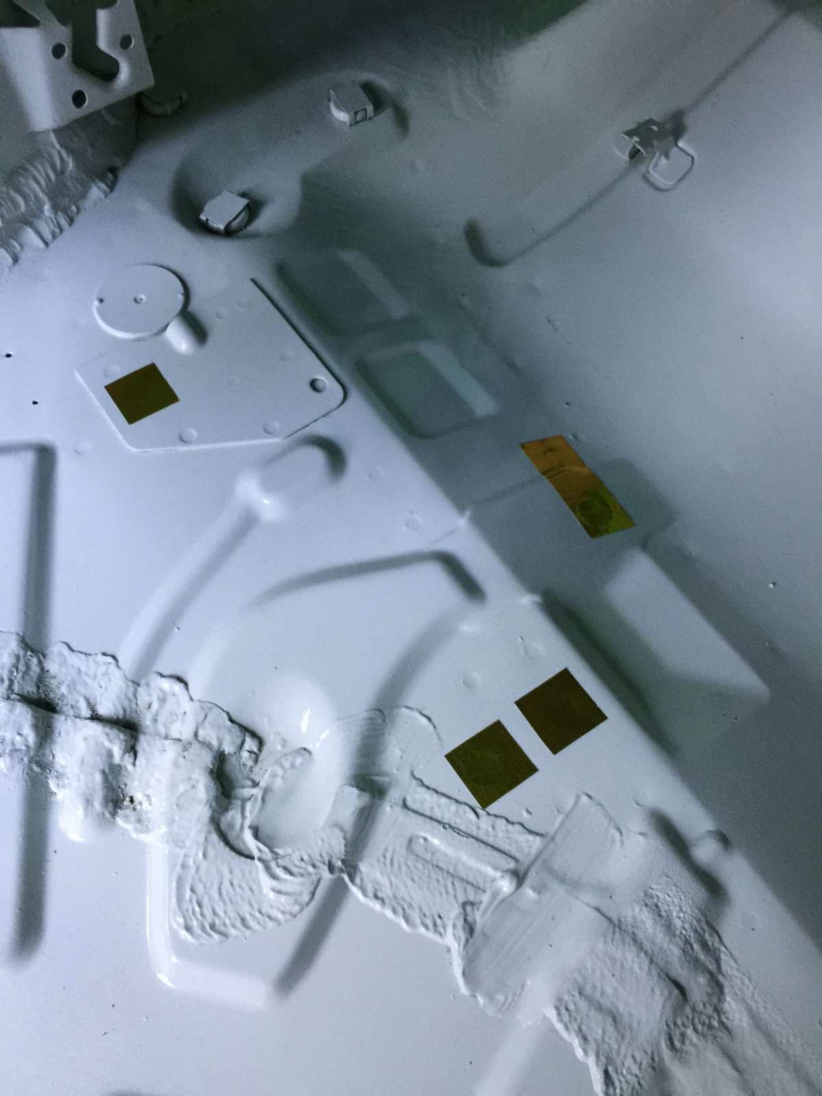

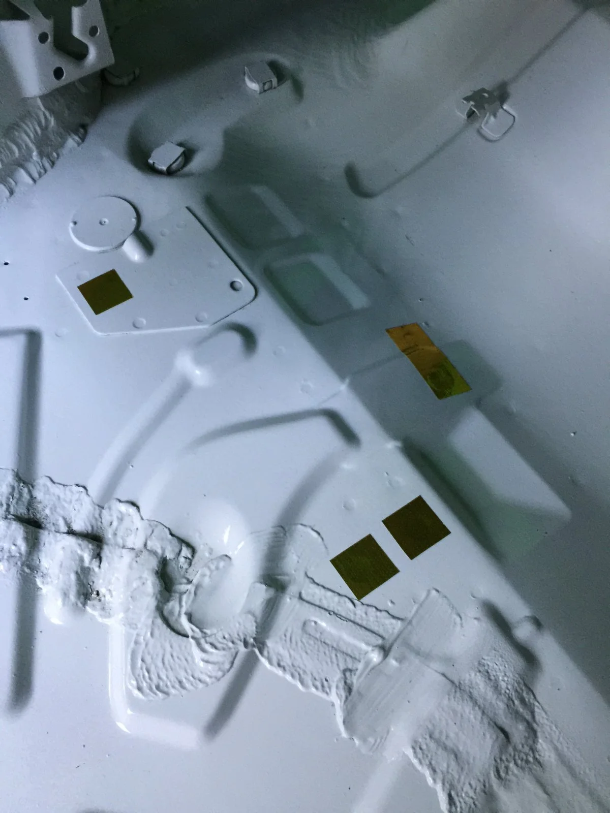

Also I have got myself some gold reflective heat tap/stickers to have under the bonnet and in the back of the car to cover the holes where the rear seat bolts used to be, looks smart :) here's a picture
Sorry for the bad pictures

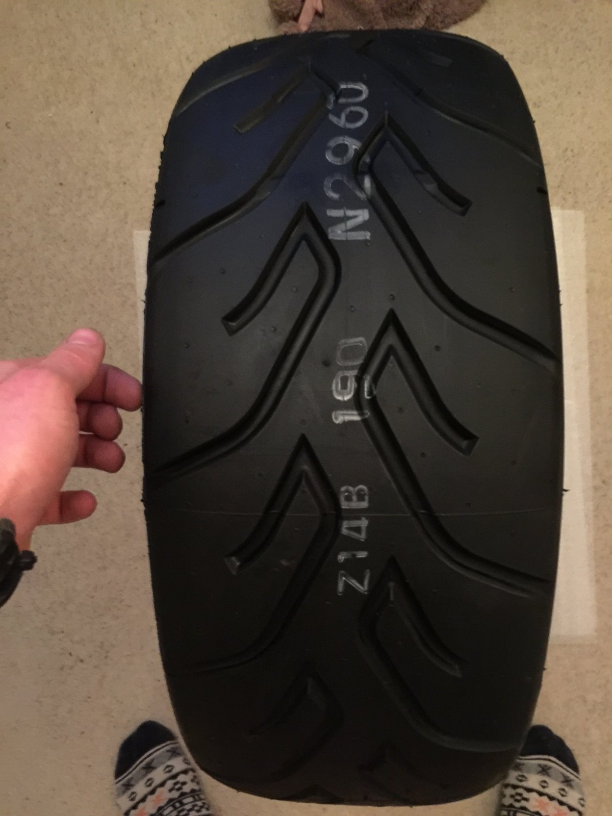

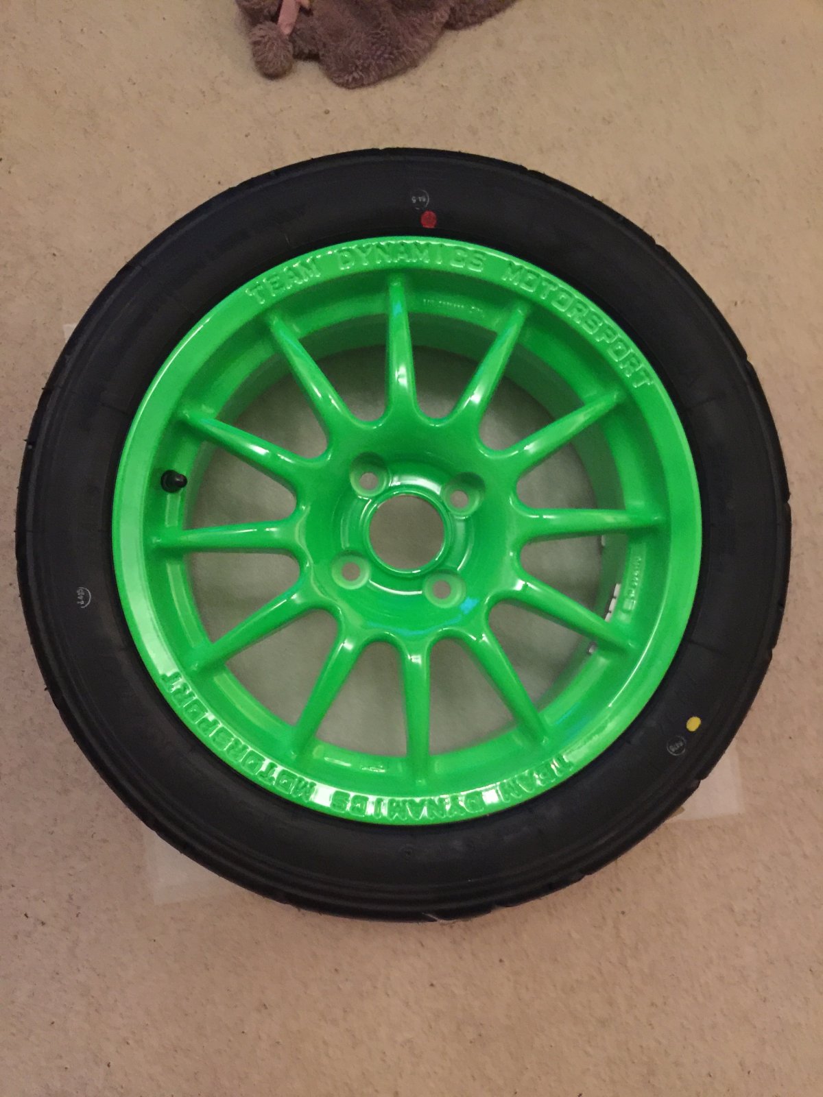

I managed to get the wheels and tyres just before the track day. I have bought custom painted 15" team dynamics, spec are- 7j all round front ET is 20 and the rear is ET 35 and the tyres are 195/50/15s and they are A048s
Some pictures

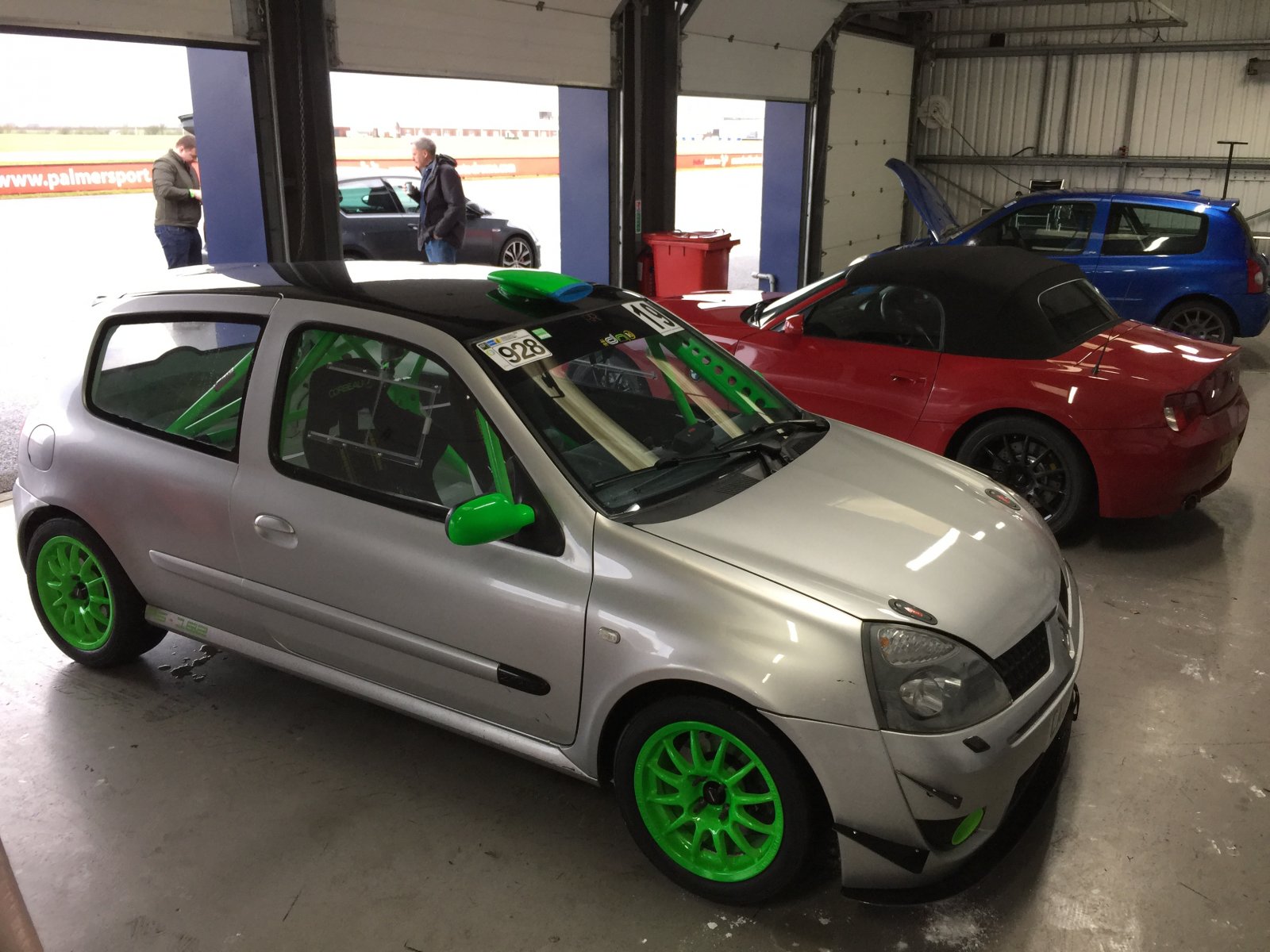

Saturday track day update :smile:

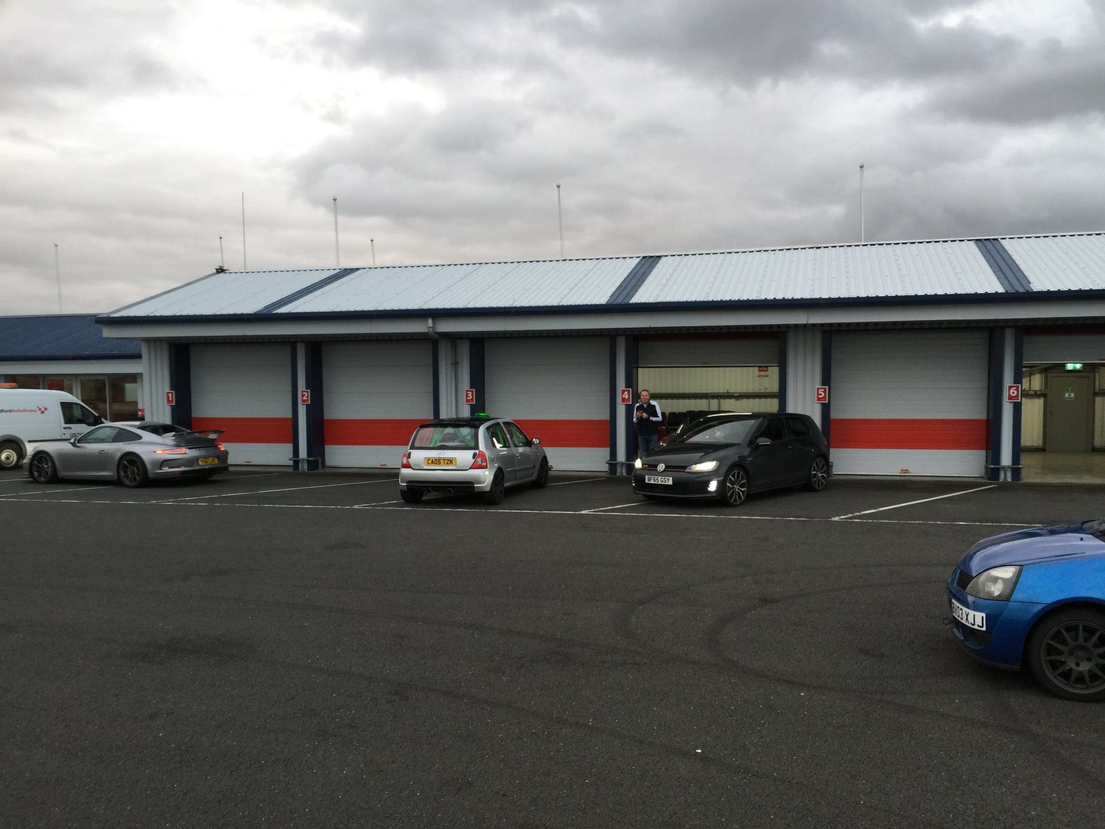

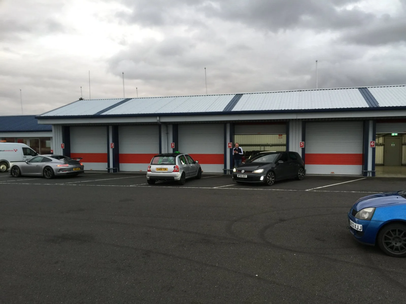

We went to Bedford to do the GT circuit layout for the first outing of the car for 2017. A group of use decided to go myself my dad my mate his dad and another friend with a blue 172 cup and we met @chris-foci and Dave when we got there.
Cars were
My 182
My dads Z4M
My mates MK7 Golf GTI
My mates dad's GT3
And finally a 172 cup
It was touch and go with the weather but it came through in the end having a full day of dry weather. First off I managed to trap my finger in the car door which wasn't a great start (perfect racing driver excuse) haha :smile: got there and straight away got the new wheels on
Pictures-
Ignore the door colour haha

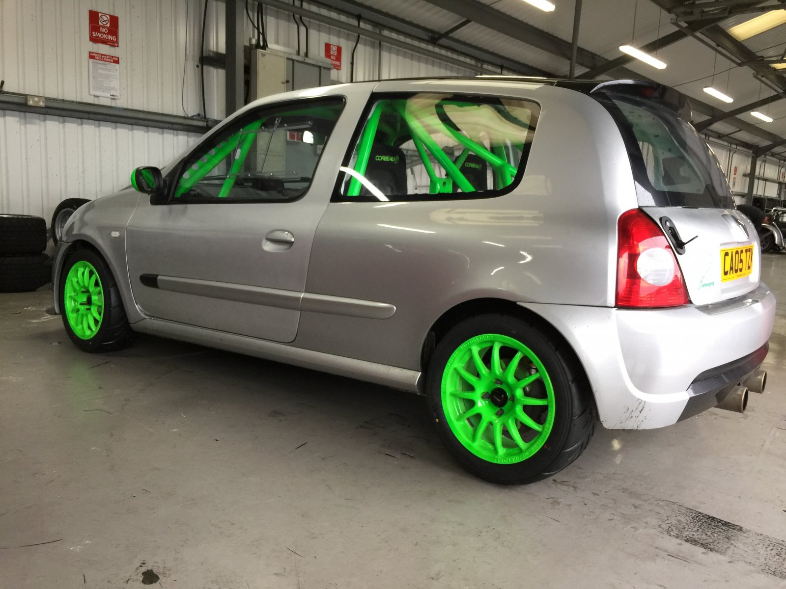

Bit of a group shot. Love how the wheels have come out really finishes the car off well.
The car handled super all day and not putting a foot wrong, the tyres and set up have really transformed the car and was keeping up with much more powerful cars and was good fun racing my mate
I can not wait for the next track day I love this car :smile:
Only time the car let me down was me trying to brake wayyyyyy to late and had to use the escape road but that was me more than the car whoops
We had a great day :smile:
Final picture of the group before we left for home

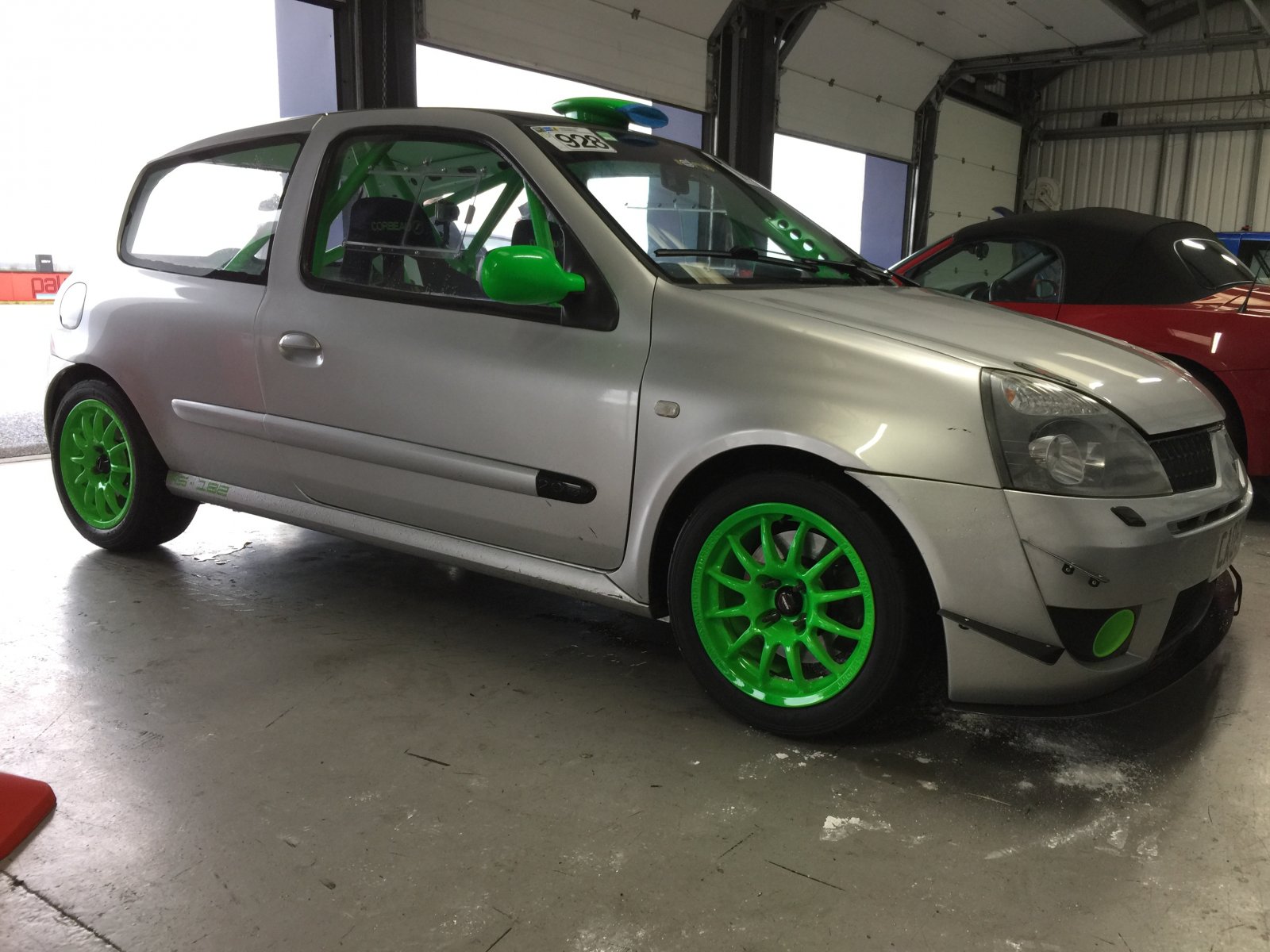

Well I used to run the standard 16s with a spacer so the track width is still the same but for me it feels much better than standard and it looks better in my opinion, also I had to clear the coil over because I am running -3 degrees and standard et the tyre would rub on the coil over
I had no rubbing all day they were fine my 16s used to rub under hard cornering in the inner arch but these don't

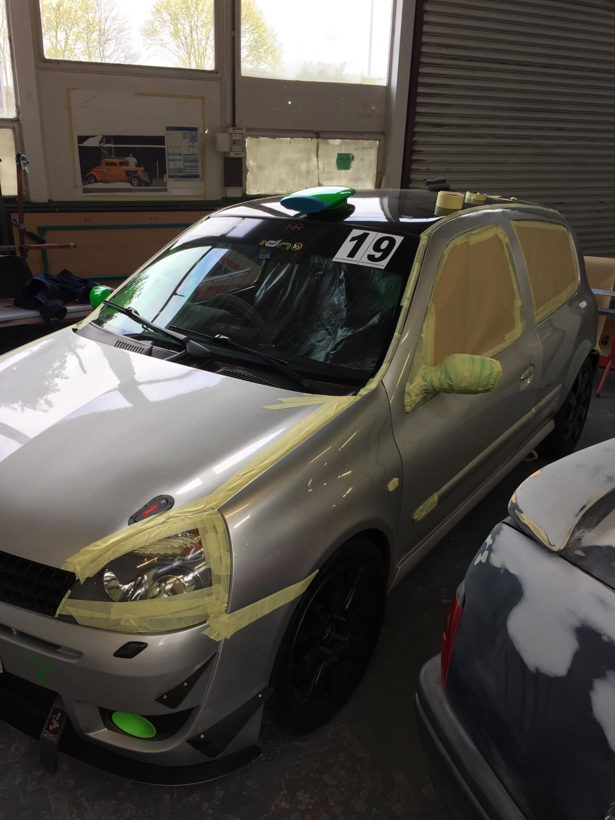

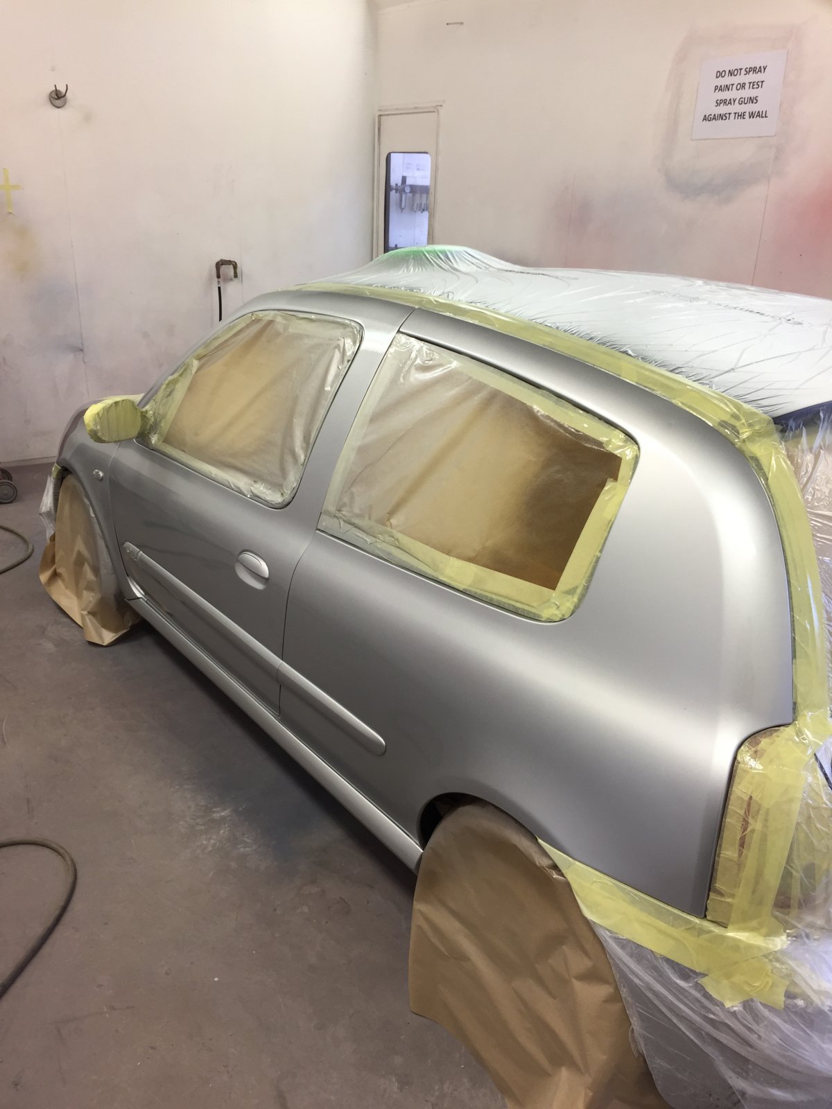

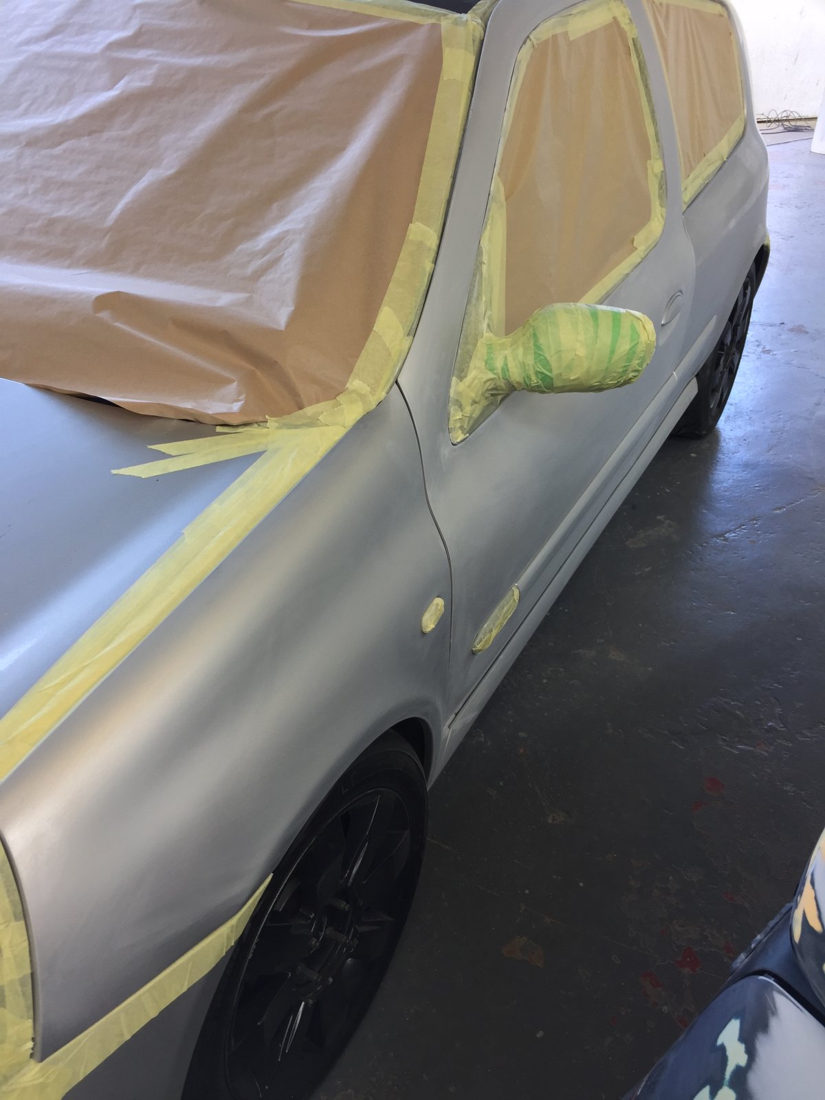

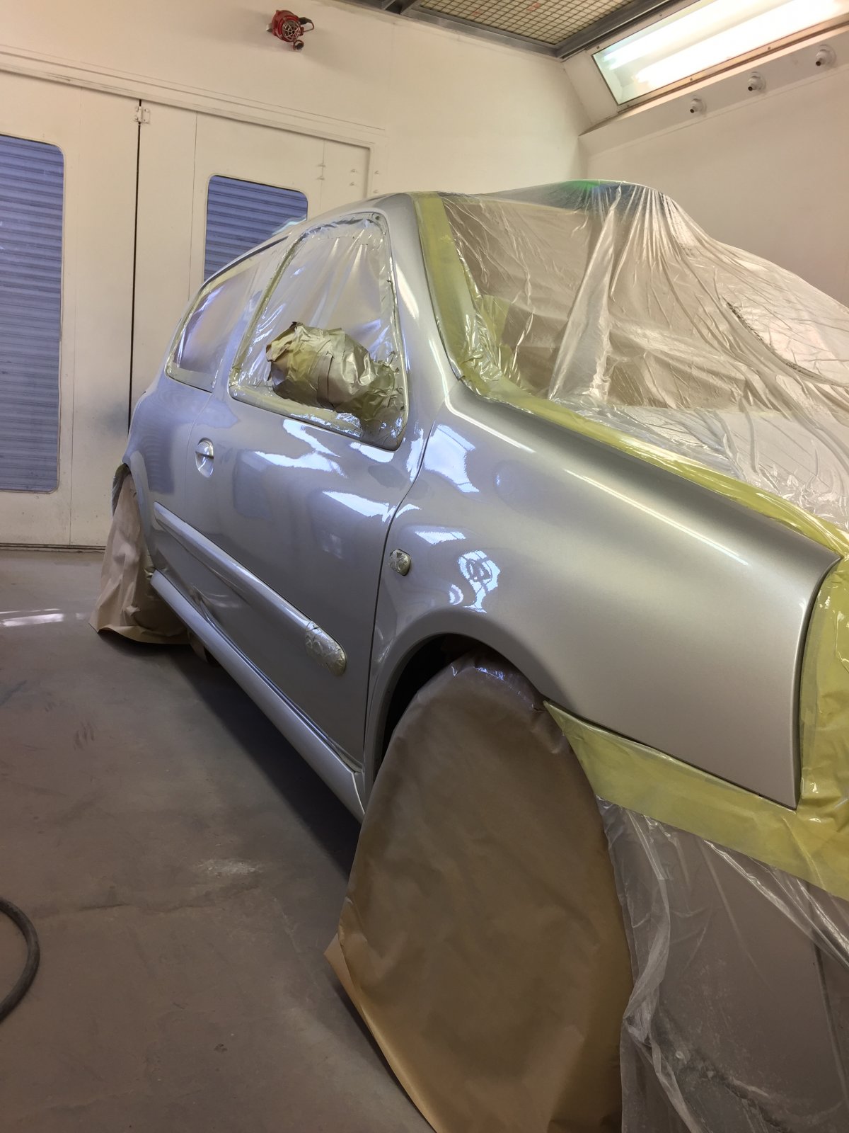

Small update I have finally managed to get the doors to match the rest of the car this has been bugging me since fitting them. Now I can take pictures of the car with confidence it's looks good :)
Some pictures
You can see the poor colour match before we start
The prep work shows the problems under the paint a lot of orange peel causing the colour to change
Now with some fresh paint

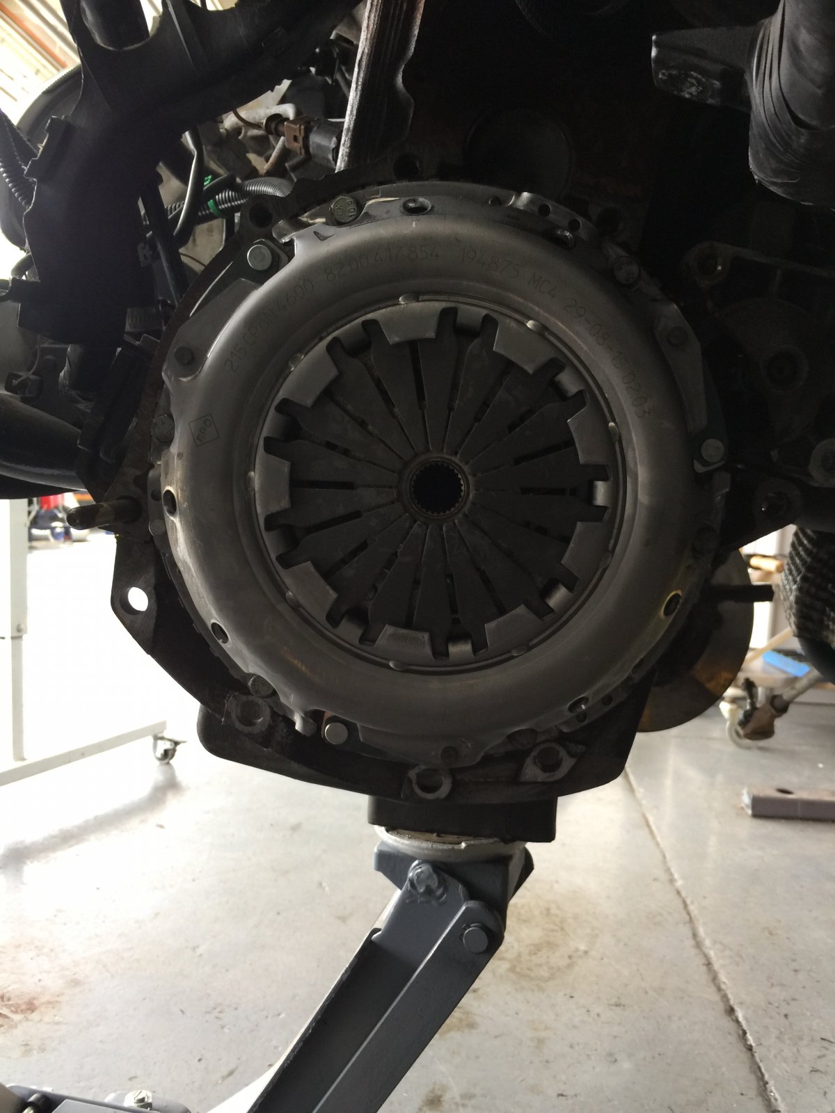

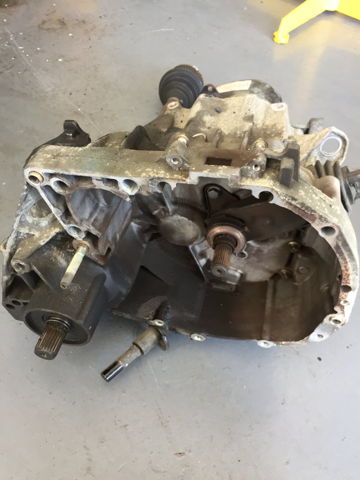

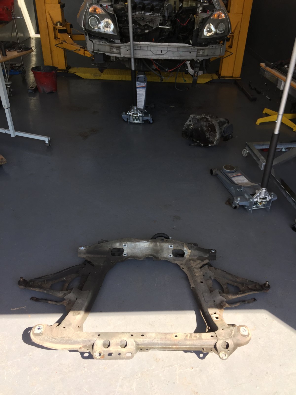

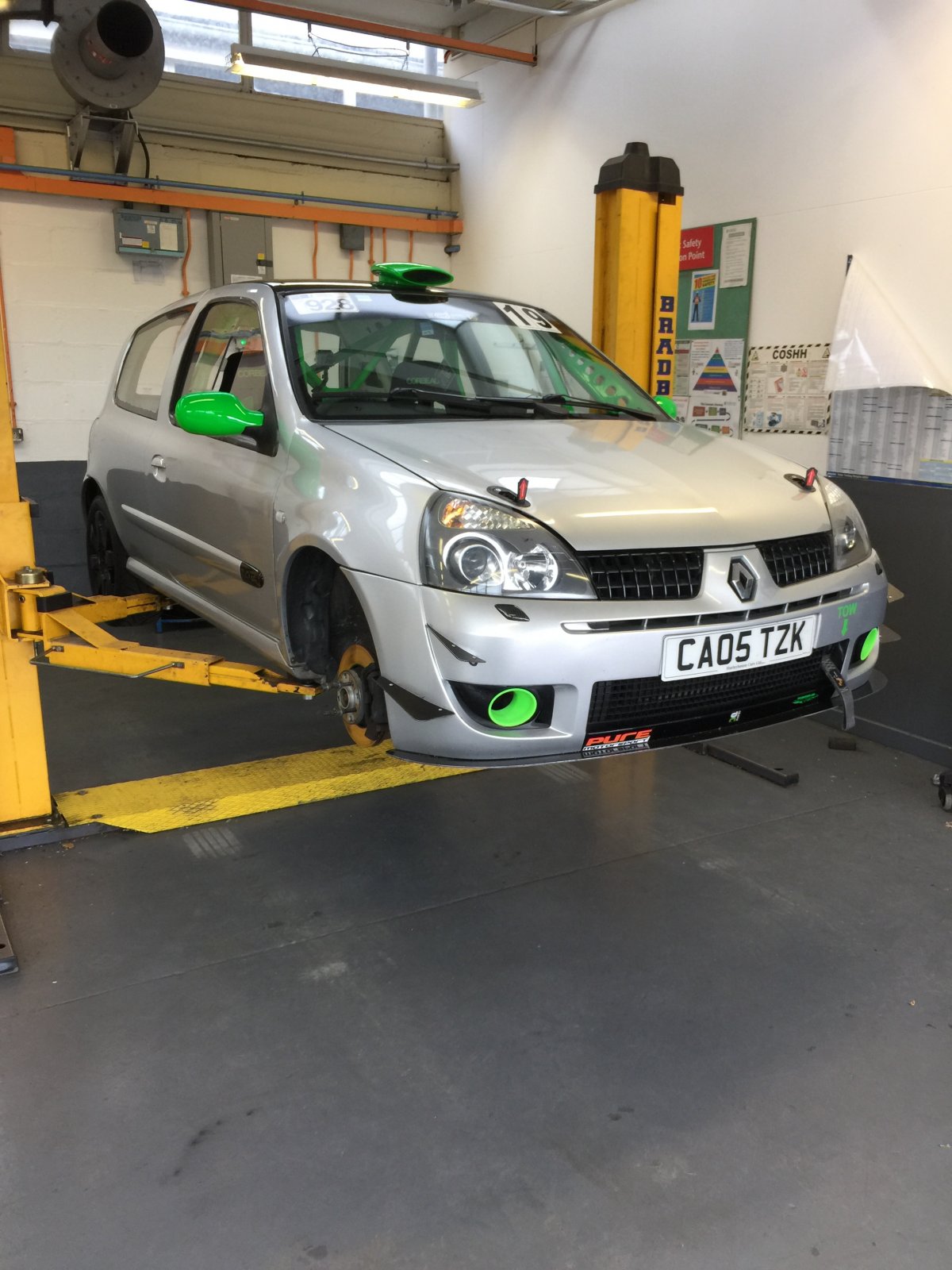

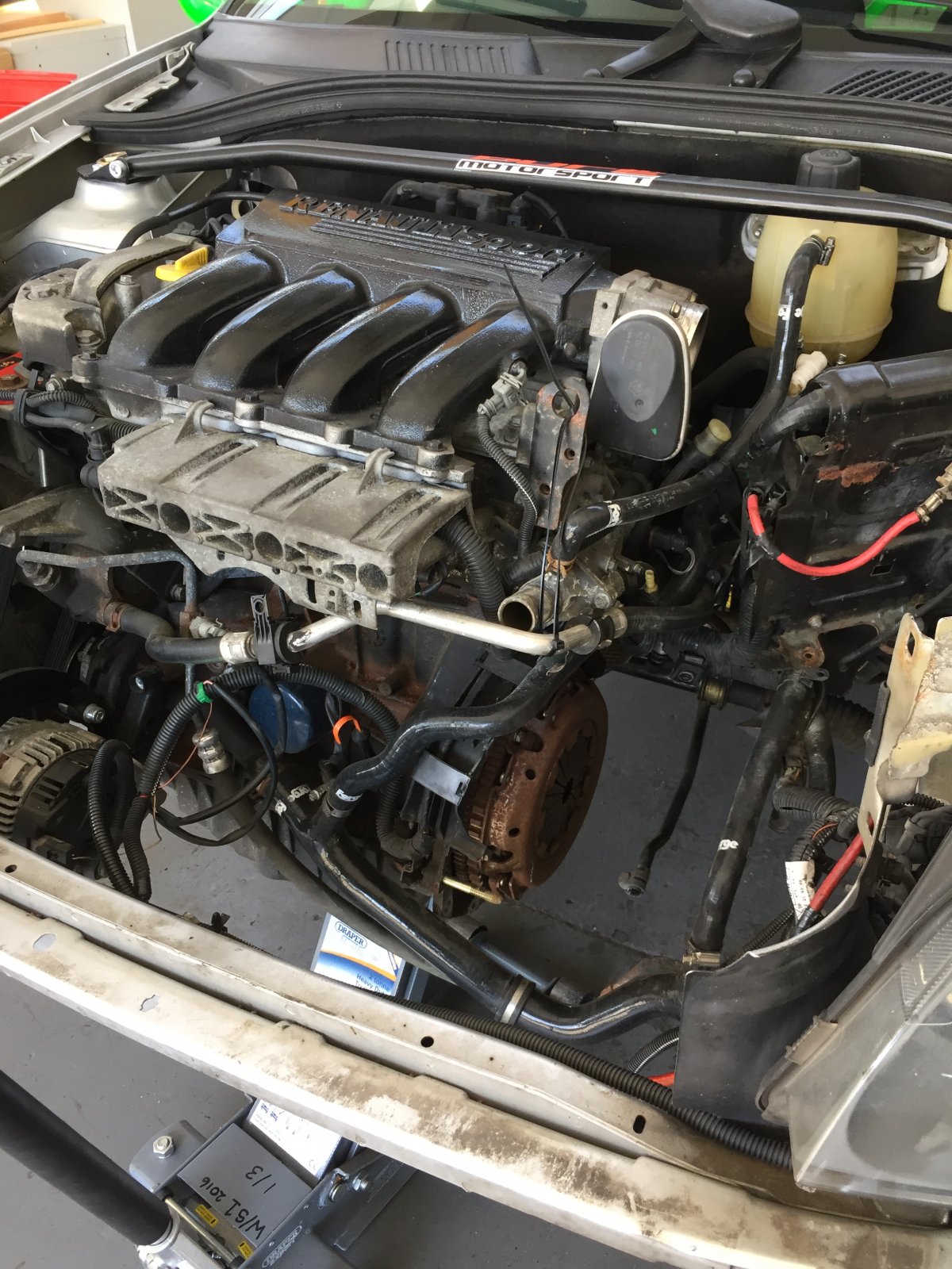

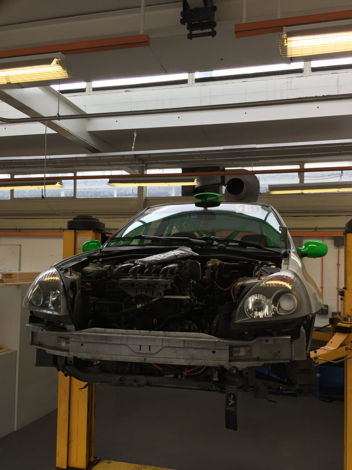

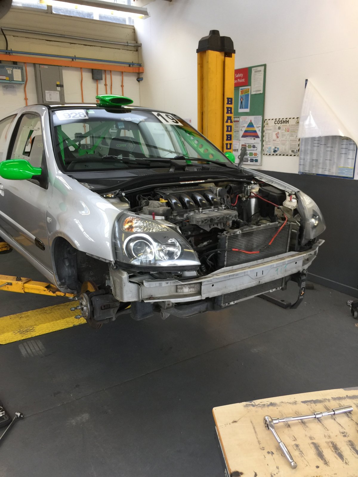

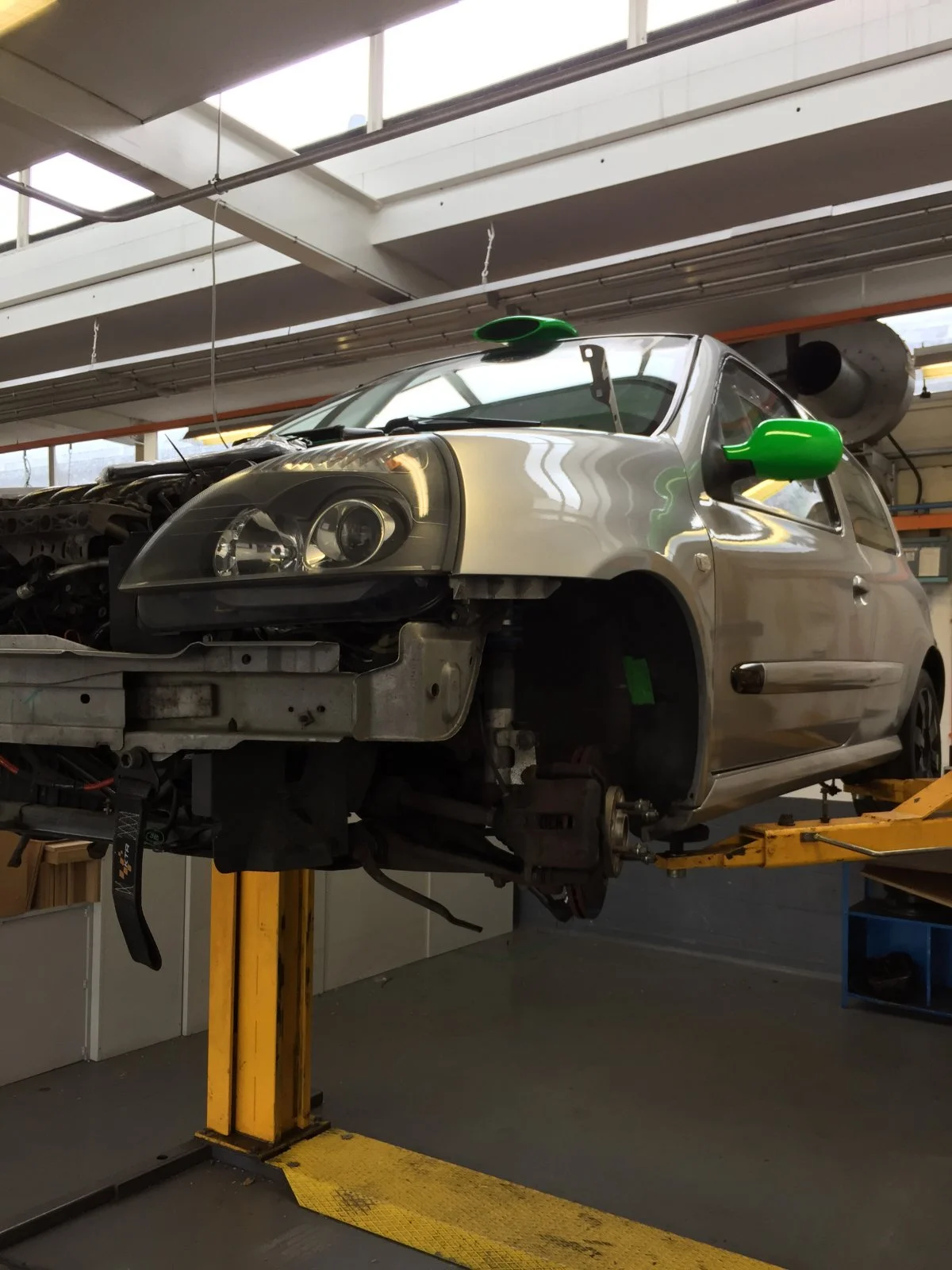

Nothing really exciting has been happening on the car lately just been enjoying driving it but it has however had a new clutch I wasn't happy with the last one it felt like it was starting to slip and the release bearing had seen better days so a new one was purchased :) I went with the standard Valeo clutch because I have heard good things about them.
Some pictures of the job we decided to take the rad out, front panel, bumper, bonnet, subframe, the rack off the subframe to save messing around with that
I am glad I took the rad out the anti freeze had gone dirty with black bits in there so that was flushed through and fresh stuff put in
Health and safety box ticked with the jack on the engine haha (yes it has a soft pad so it wouldn't damage the sump)
Something missing here
Success!!!!!!!!!
And the new clutches fitted
More playing to come :)
