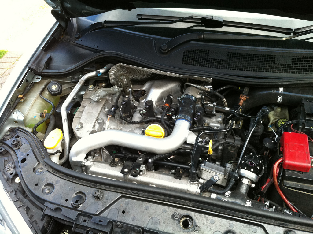

Fitted the actuator this afternoon ready for a trip oop norf tomorrow morning. 113 miles of boost free driving until its setup with the map coming up :(.
Also changed the stock rubber hoses for silicone ones as I had some lying around and it fitted better due to the better flexibility of the stuff.

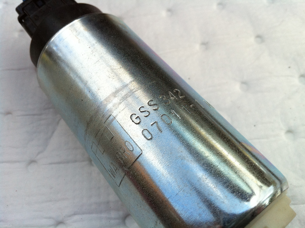

Yup still on standard injectors, I decided the decat wasn't an option a while back. If I only had to do the job once maybe but its just too much effort and hassle for the gain for me, if only it were under the car like everything else it'd be long gone by now :(.
Anywho it was the fuel pump in the end, so i've now got the only megane with a walbro pump fitted. With the standard pump the car was adding fuel trim to make up which was maxing the injectors out by about 3.5-4k :eek:. And then going towards the leaner end of things above that as they couldn't keep up, nothing damaging but it was towards 12.5:1 when the map tries to keep it around 11.5:1.
Graphs are after a good few runs especially the post mapping ones so the temps have dropped the figures down a bit but the first run was 279, Paul was surprised that it still had a cat in at that. Figures didn't change with the pump but as you can see its keeping the AFR much more consistent now with the injector duty lower in the mid range and it can go higher in the top end now as the fuel is there for them to inject!
Also now having a revised map i'm finding it a lot better in general use, the cold start lumpiness has gone and the revised throttle map is much smoother to use.

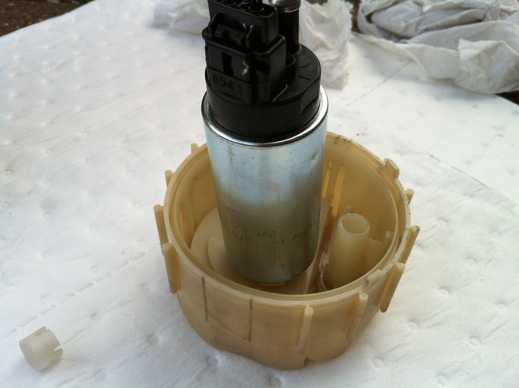

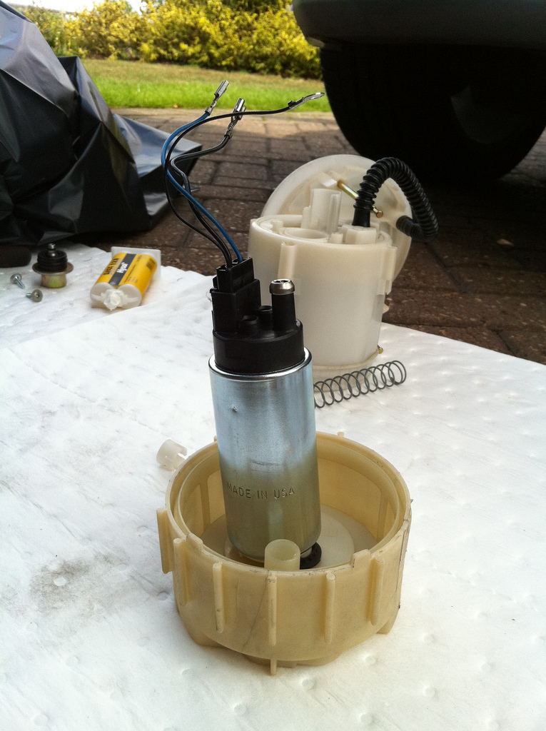

BUT, this isn't an easy mod like every other car in the world that people fit the walbro 255 pump to unfortuantely. I was booked in for 10am and didn't leave until around 3pm with paul well sick of the sight of my car :eek:. Renault in their wisdom make the fuel pump/sensor assembly very difficult to remove with breaking parts and then to make it worse the actual fuel pump they use whilst being the same shape and same electrical connection and petrol connections as the walbro make it about 10mm shorter :mad:. So the pump assembly won't go back together with one fitted :mad::mad::mad::mad:, so we have to shorten the outlet on the pump to get it to fit which is a bit annoying and difficult to do unfortuantely. I think pauls words were you're the only person every having on of these lol.
But not Paul's fault and he definetly didn't think it was going to be that much of a saga either :eek:, didn't even charge me for the 4 or so hours him and specky were working on it. Total Legend!
But the result is it all works fine, the only "problem" I have with it is the walbro is more noisey than the standard pump and I can hear it running outside the car on idle. But hey ho it'll do for the time being. The only other option is a full new renault pump at £200+ :(, which is exactly the same one they fit to a 1.4!

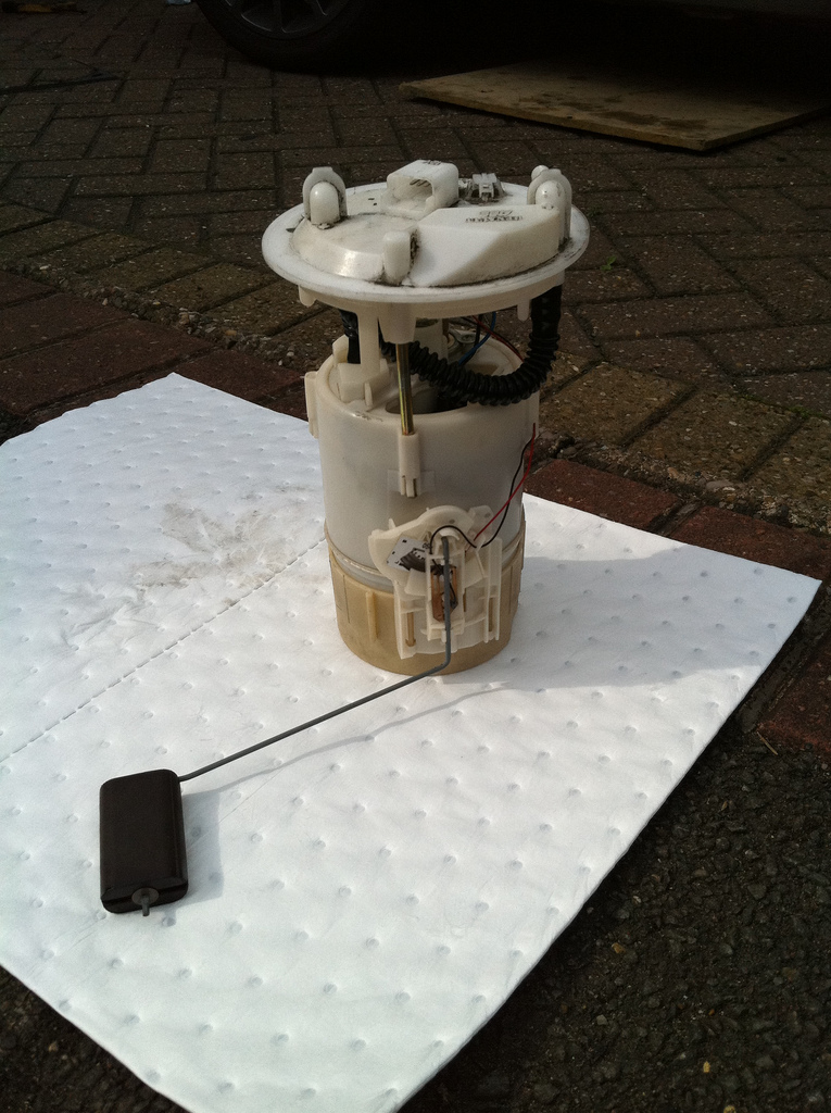

Righto few picture and bits and bobs to sort. Had a problem with the fuel gauge not working above 2/3 after having the walbro fitted at rstuning, was down to the sender being clipped on in the wrong position and not having a full sweep of travel. So let the tank run right down to fumes them fished the pump/sender unit out again.
Stuck it back in with the sender where I thought it should be, went and brimmed it and got it reading a full tank again :D. Damn petrol fumes give me a bad head though :dead:.

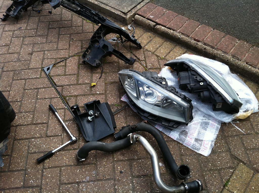

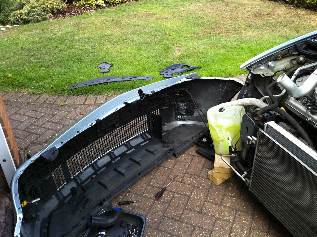

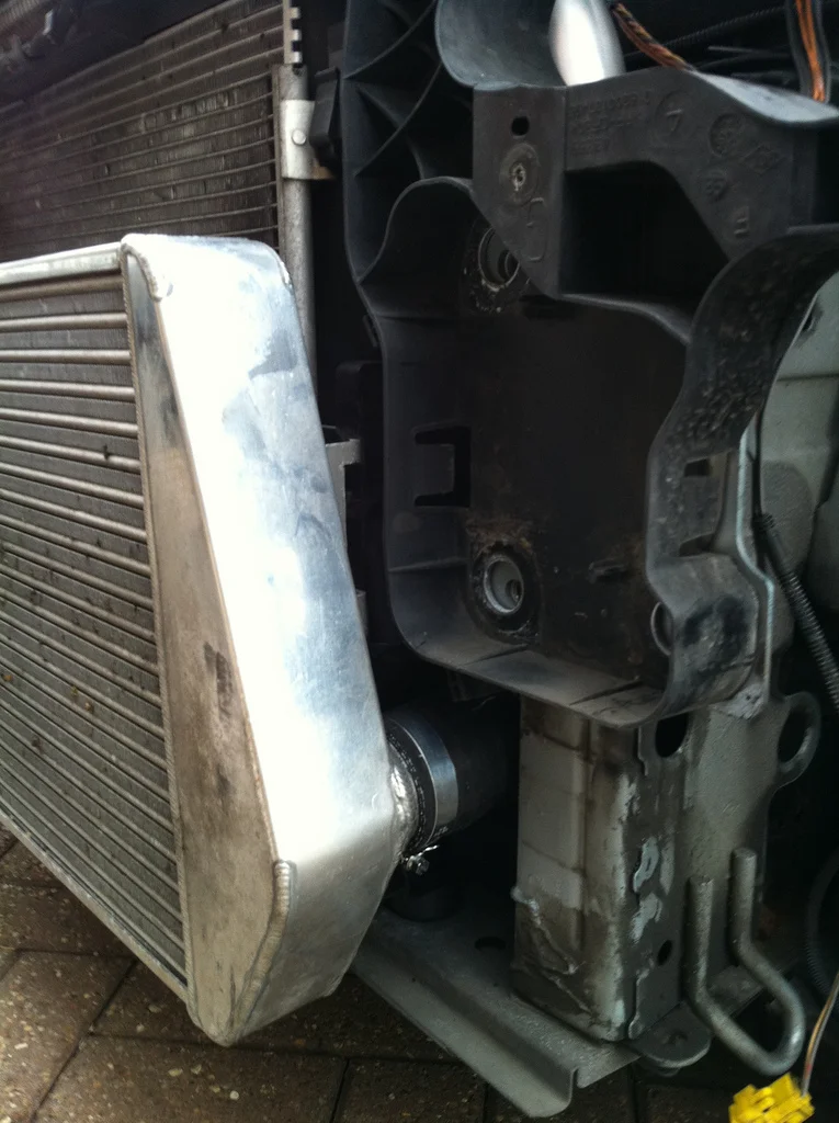

Next up I had the k-tec hard pipe kit i'd been umming and arring about for ages to fit to got to it. As usual a million things had to come off :dapprove:.

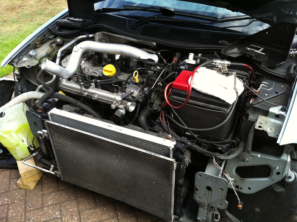

Front end off and old pipes/hoses removed.

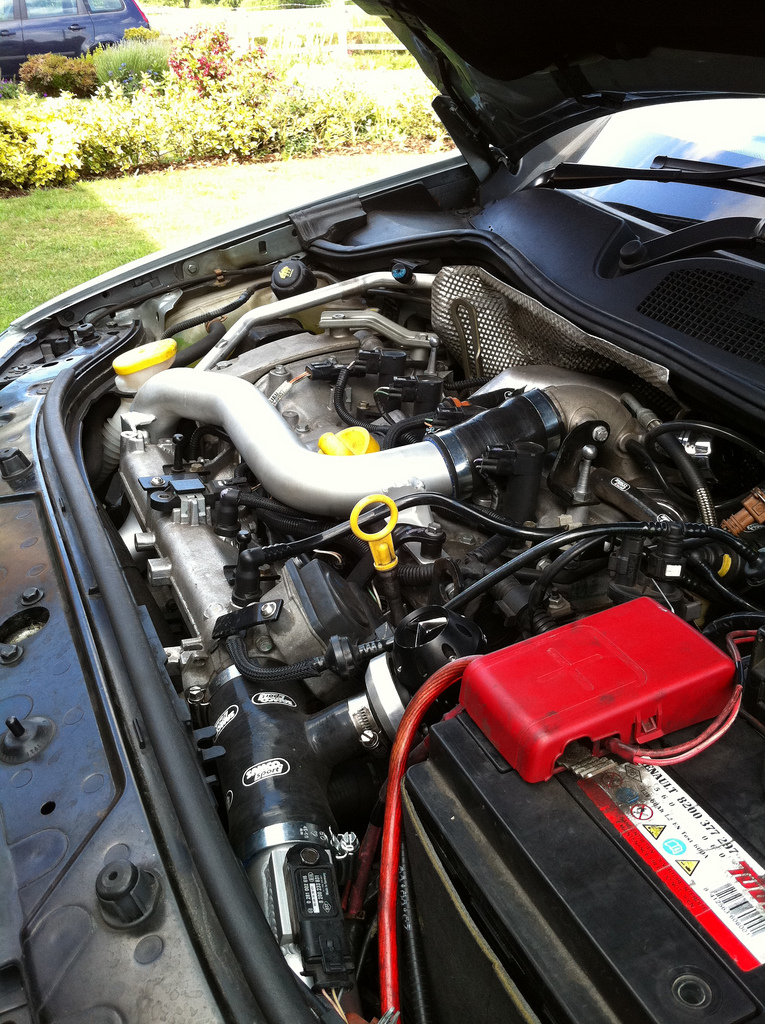

However, as I feared and the trend became it wasn't going to be completely plain sailing. Was a bit pissed off as this point as I don't expect to spend almost £300 and get this.
:mad:
Still, a bit of bracket adjusting and hacking the joiners up it fitted ok in the end. Still, not what I expect for the money.

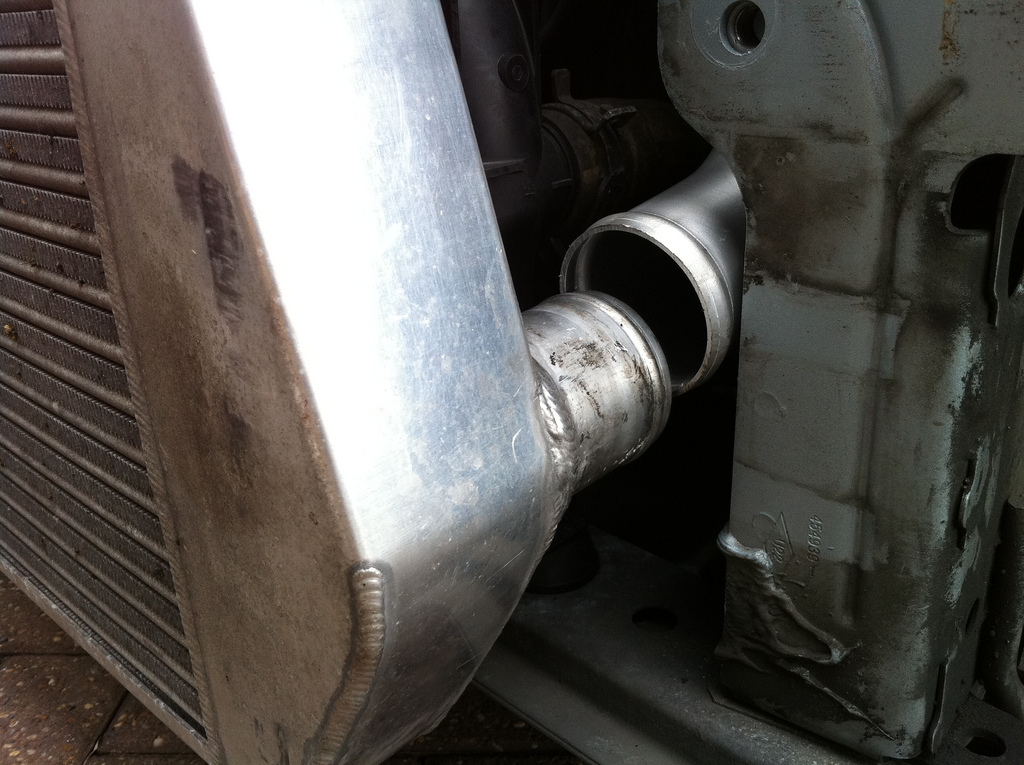

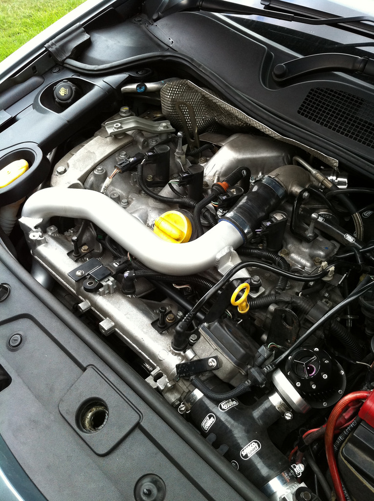

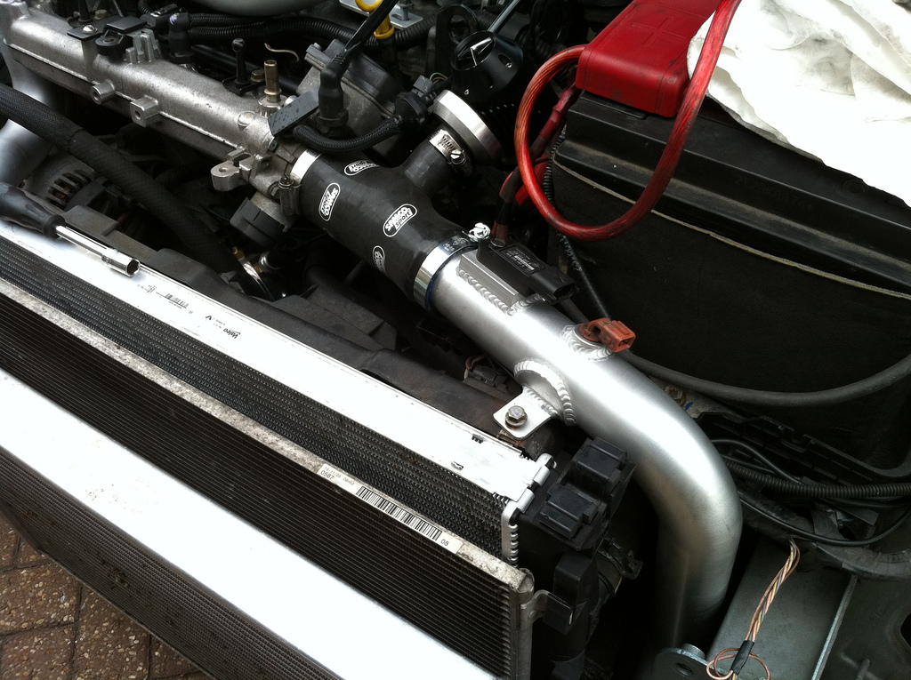

Then got the top pipe fitted too, again not a straightforward fit and i'm not perfectly happy with the exit where it joins the intercooler yet either. See how it goes at this point though.
All in all whilst i'm partially happy with them and they look nice I won't be recommending them to anyone any time soon. If it weren't for the joiners I had from the radtec hardpipe theres no way in hell i'd have been able to fit them.
Plus for £300 I don't expect to the having to cut the joiners myself or bend brackets to the right shape. But ce la vie.

On another note, do not fit a walbro pump to a 225 with the oem power feed.
£340 later she'll be reet.
Kicking myself I should've picked up on it when the fuse blew, took the fuse and the UPC board this time. Lesson learnt, i've been the unknowning test donkey and its bit me.
Bet the OEM pump motor takes a lot less current than the walbro does, will be testing it when I get the new one.

edit: Forgot to add no one buy a ktec hard pipe kit, it doesnt fit and will rub on everything and crack welds. Best £300 I ever got refunded.
