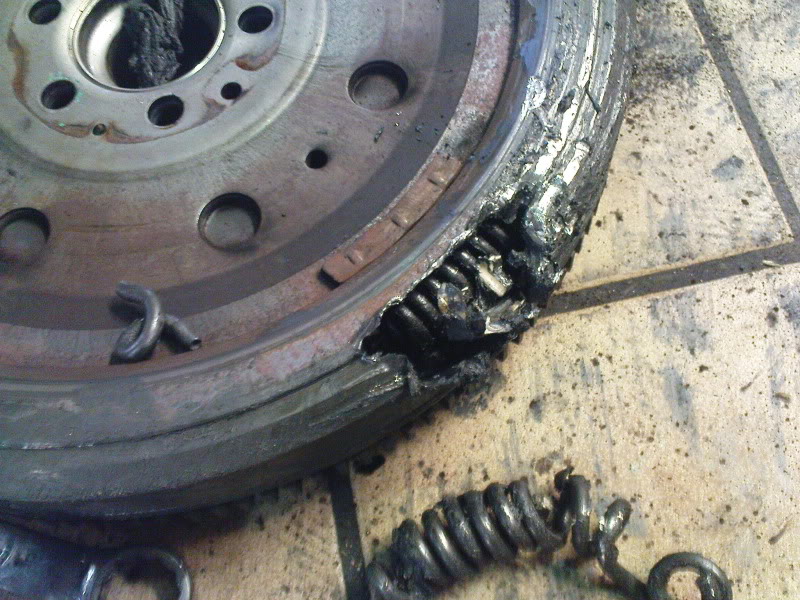

Then all was going so well until on the way home from said meet the clutch decided its had enough at life and started to slip :(, 52k on it and its been mapped since 28k so its possibly just worn out and hopefully not just not up to the job of handling the extra torque from the map as there aren't any uprated direct fit replacements avaliable either!
The biggest stinger is that due to the megane using a dual mass flywheel setup that'll probably need replacing too at a cost of £400 :dead:, add up the clutch and other bits and pieces that might as well be changed and its touching £800 parts alone!
Oh well gonna get the box pulled out monday/tuesday hopefully and will assess what needs changing then :dapprove:.
In a lot of ways despite the cost i'd rather it'd be the flywheel thats caused this as its been slightly ticking for a while now and at least i'd know the clutch can handle the 310ft.lb as i've got to refit a standard one unfortunately.
Oh well won't know until the box is off so roll on tuesday! Will update when I know :eek:.

Then got to it and pulled the box to see the damage.
Yep definetly something missing.
Ah ha this maybe?
Hmm could fit a decat in here nicely though whilst its all off???? :evil:
Then took the clutch and flywheel off.
Can see where the crank seals been weeping, going to change that whilst its all off I think.
These solid mounts aren't all they've cracked up to be though ;).
Well the result of it all is the actual clutch looks fine about half worn on the friction plate looking at it and the auto adjuster on the pressure plate seems to agree with me as its about half way through its travel of adjustment. Can see witness marks on the fly and pressure plate where its deffo been slipping though.
The flywheel on the other hand its far beyond its best, no damping at all in the anti-clockwise (engine direction) and its got a few mm side to side play in it too, which i'm guessing things that spin at engine speed should have lol!
So looking at the best part of £800 parts bill woooo hooo :(. Oh well best get ordering then I guess. Might have to slip a cheeky decat in there too maybe, cloud silver lining at all that ;).

This is unfortunately why :(
After removing it all the clutch looks ok tbf but the dual mass flywheel is fuuuuuuuuuuuucked so hoping thats the cause of the slipping and a new standard clutch will be up to the job as no one makes an uprated yet.

Its actually barring the hydraulic clutch pretty much exactly the same tbh, probs a bit easier than when I pulled the box out of my 1.6 (twice! but thats another story). More room once the subframes out the way anyway from what I remember.
Ah thats a bit poo mate, well im not suprised the flywheels fooked, VW's do it all the time lol, we had one explode the springs clean out of it, iv got a pic somewhere il dig it out
  BMW M135i
Yeh everything i've read about dmfs doesn't proove them to be the most pro-longitivity thing in the world. Mine doesn't really damp in either direction you can easily move it by hand and its got a few mm side to side play in it too. Thats one a one stop trip to the wheely bin I think!
Yeh i've heard the horror stories when they let go be good to see, i'm surprised mine wasn't causing more problems than it did tbh considering the condition. The play in it being the most worrying considering it does engine rpm.

New shiney non floaty flywheel :D.
vs :dead:
Erm which ones is the new one again ;)
So got the flywheel degreased, fitted and bolts torqued up.
