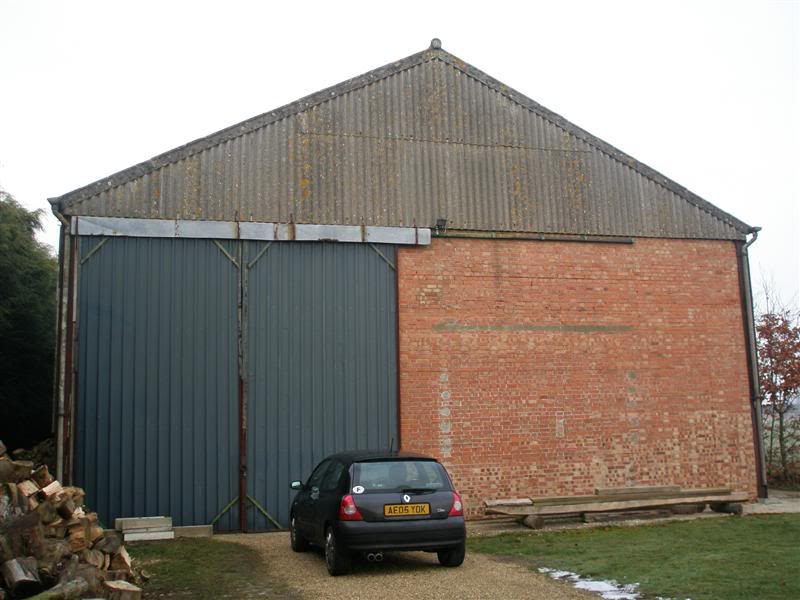

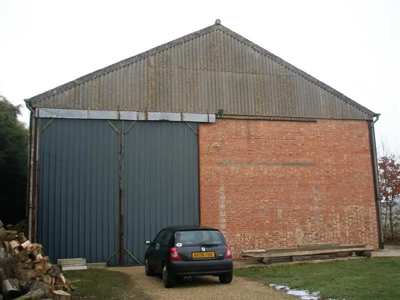

re. garage, i wish it was mine, its just the corner of a barn im renting. but yer its huge

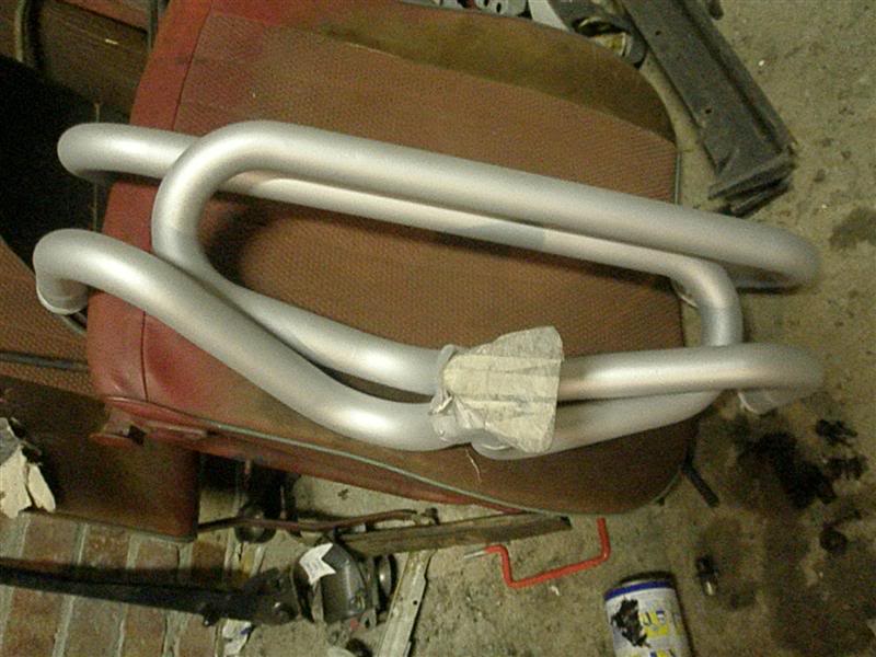

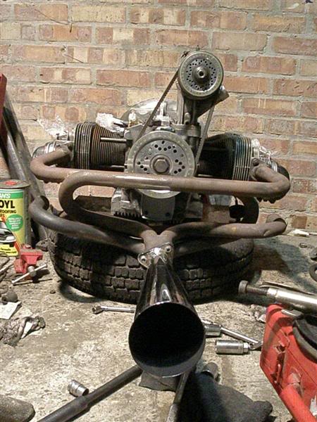

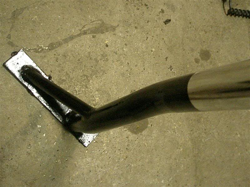

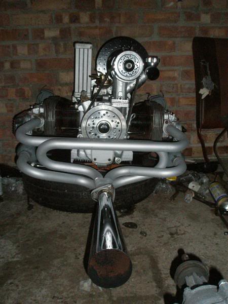

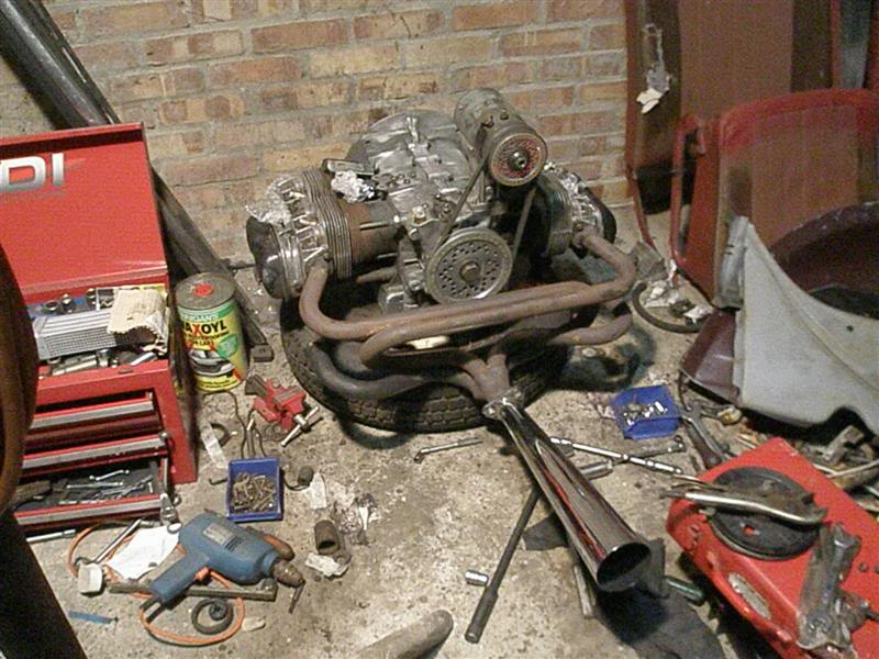

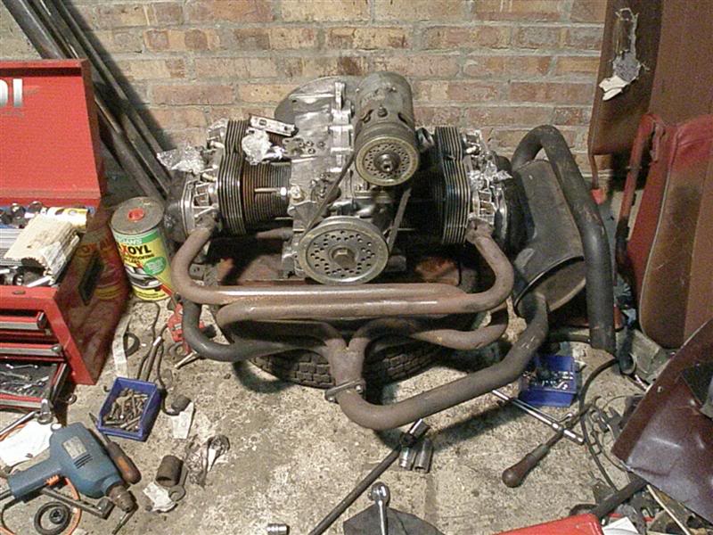

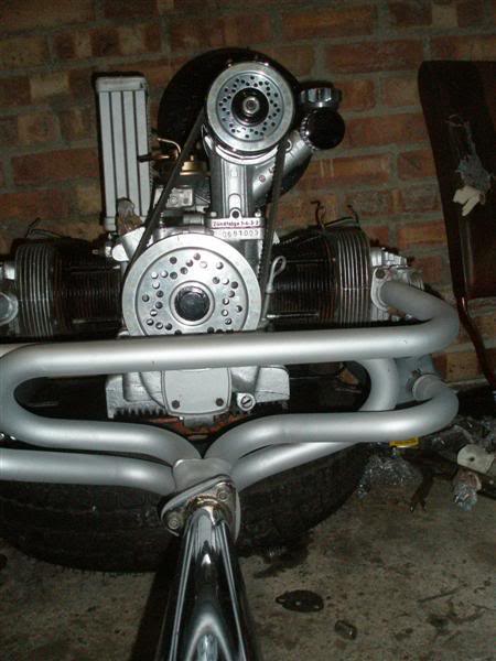

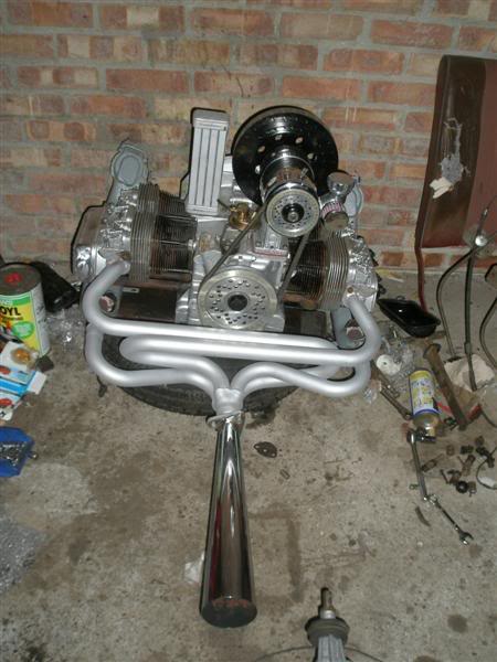

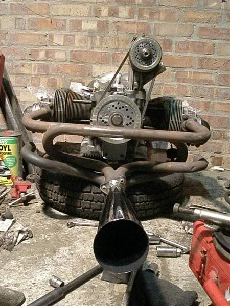

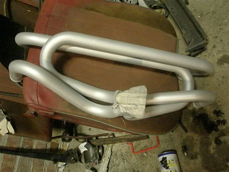

Picked up a few bits at slough and test fitted along with the bugpack header and tuck-away exhaust

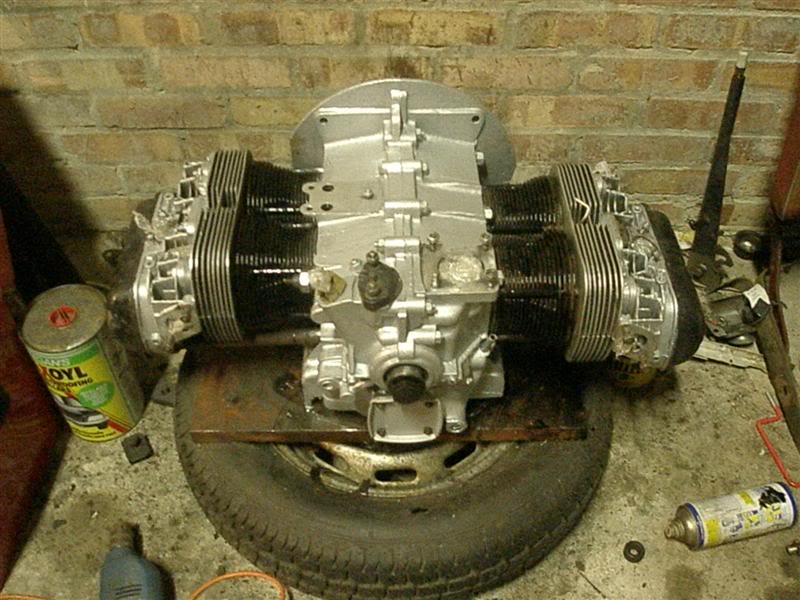

Engine is halfway through being cleaned up.

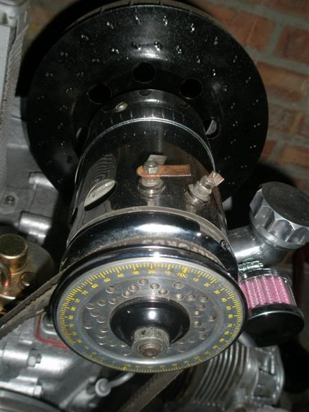

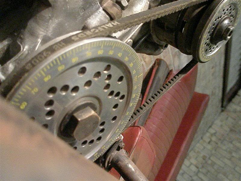

Tastey billet cam pulley's and Stinger
Also proped up the road legal tuck away exhaust, voila

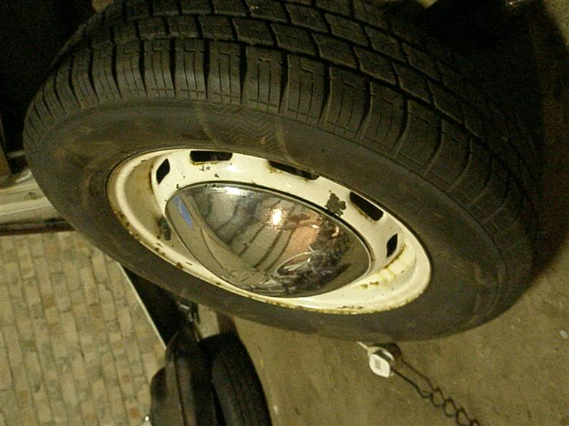

erm what else... These chrome domed hubcaps, will look good with lo pros

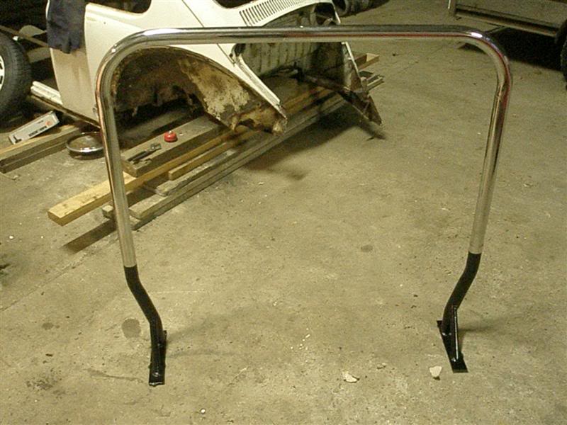

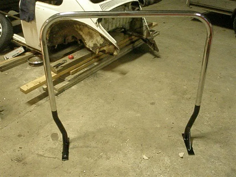

Also had this rollover bar shipped in and painted up the feet

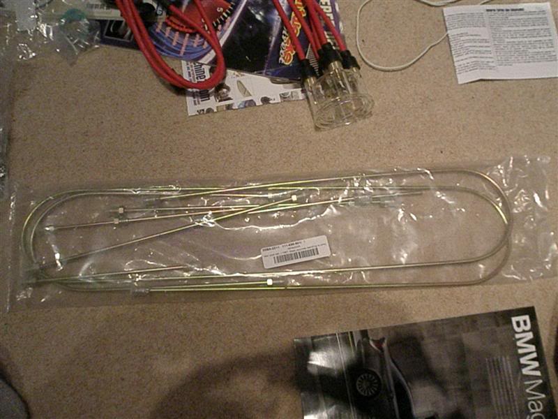

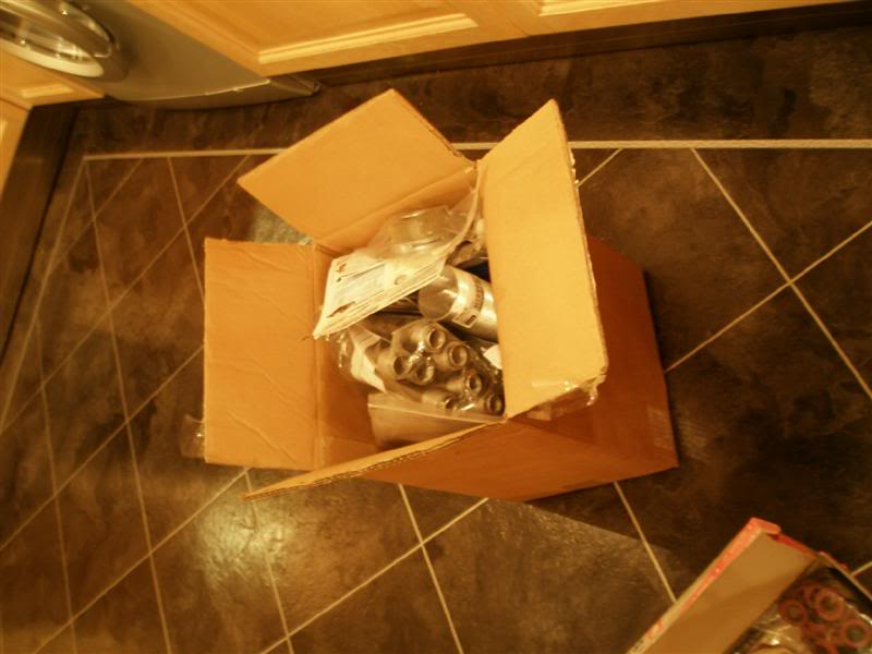

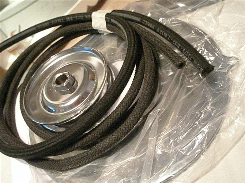

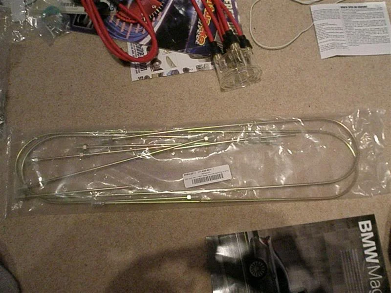

New brake lines

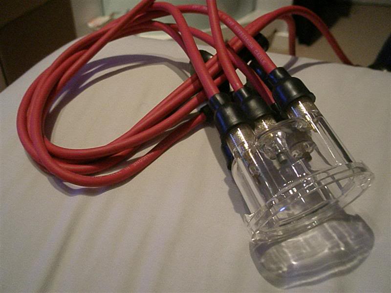

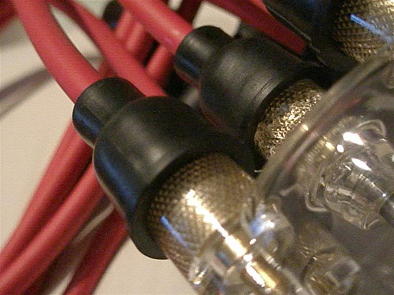

Empi red ht leads and clear distributer cap

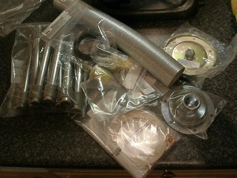

New fuel lines, chrome backing plate and generator pulley

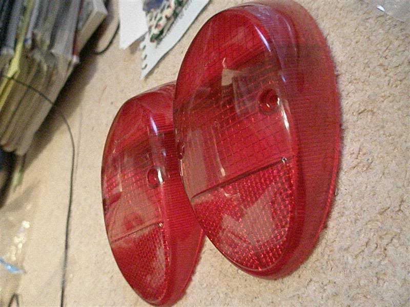

US spec all red lens'

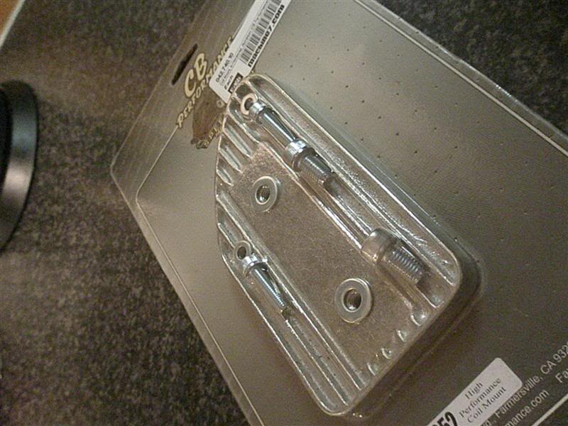

Service stuff, this should get the 42 year old engine purring again

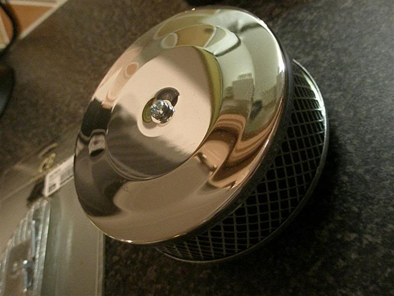

New air filter and coil mount

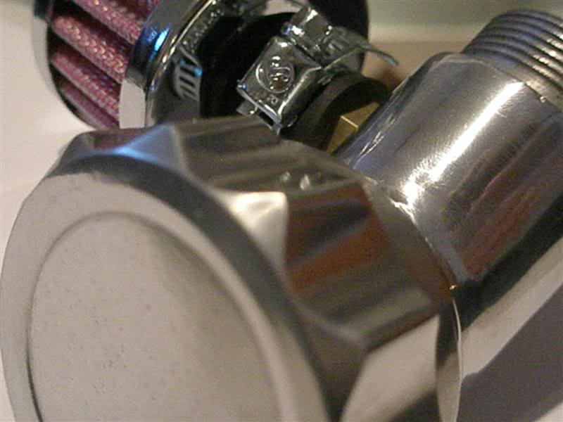

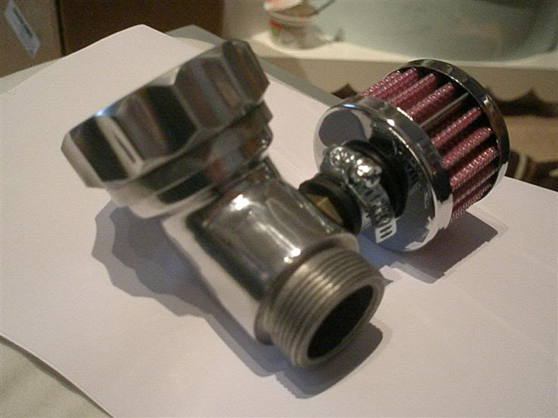

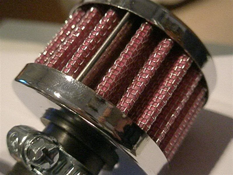

Oh and this rather tastey billet oil filler and breather

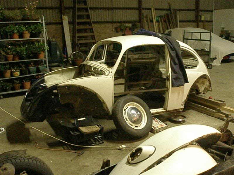

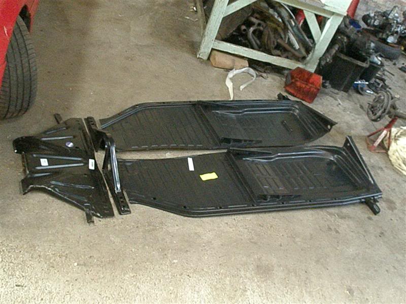

Yesturday all the chassis parts turned up, the top of the framehead will need to be adapted from lhd to rhd

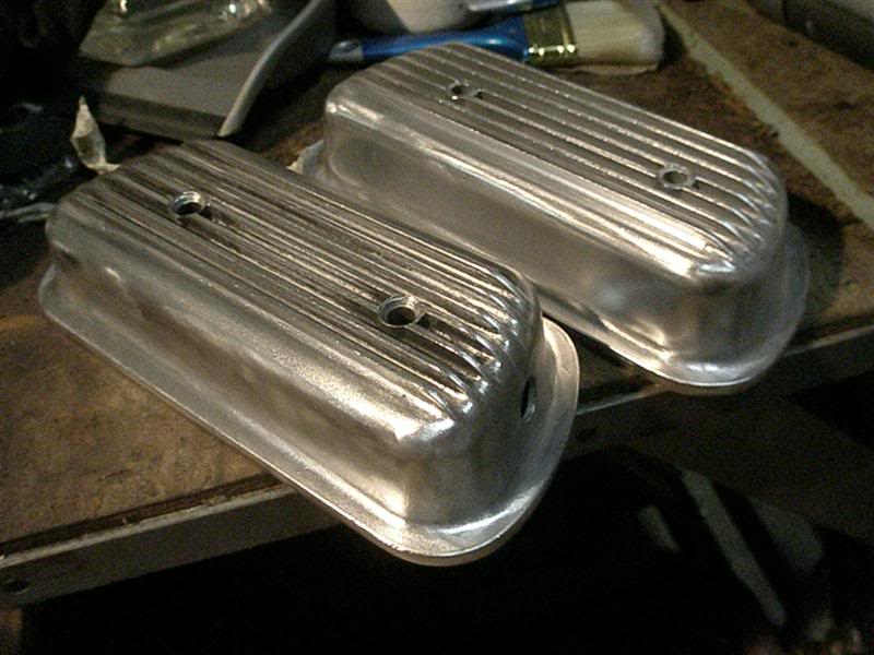

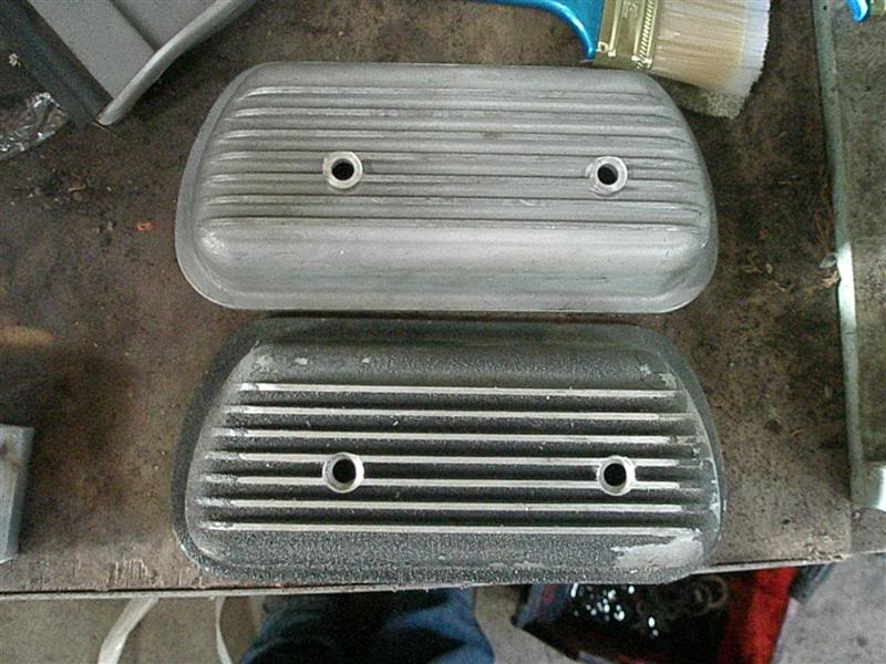

Also recieved some old dirty rocker covers which i cleaned up a bit with a wire brush, came out pretty well i think

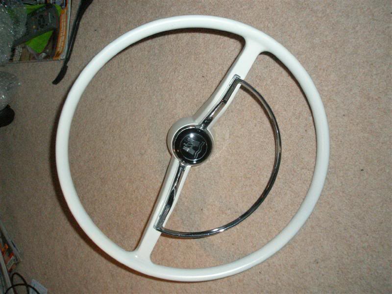

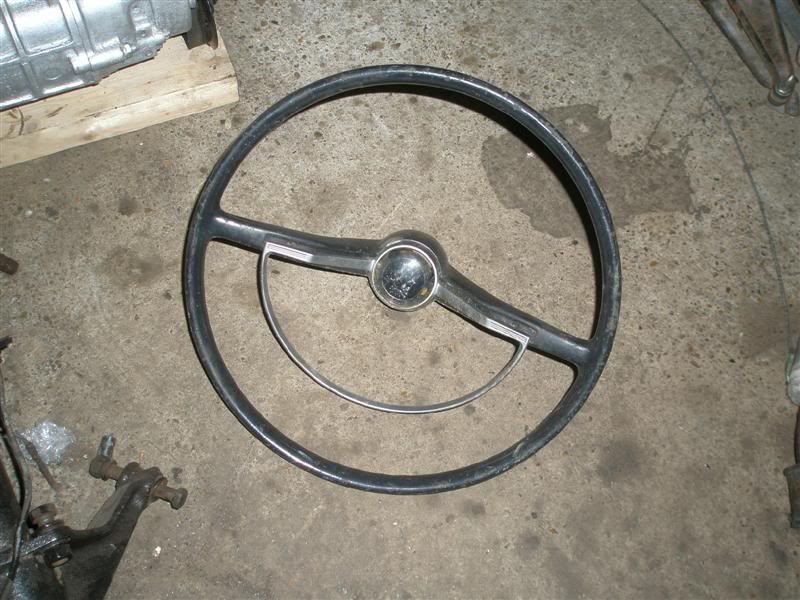

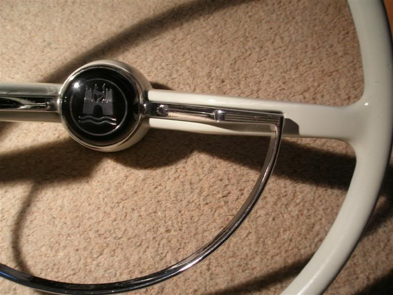

Still waiting on a few bits before i can get the pans in and body work sorted so had an idea with the steering wheel...originally black with chunks out of it and a rusty D ring
so thought i'd give it a few coats of ivory white, and some thick laquer. Quality is really good, gonna have a go at the colomn, ind stalk, shifter and handbrake tomorrow

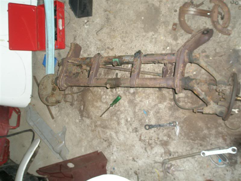

Got a bit more done today, was meant to be at college but got bored and started to strip the front beam ready for narrowing, (-4")
Flicked through the history and saw that the beam was changed in 1999 for this adjustable beam - allowing me to lower the front and saving more welding

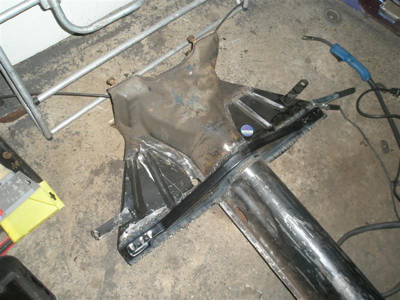

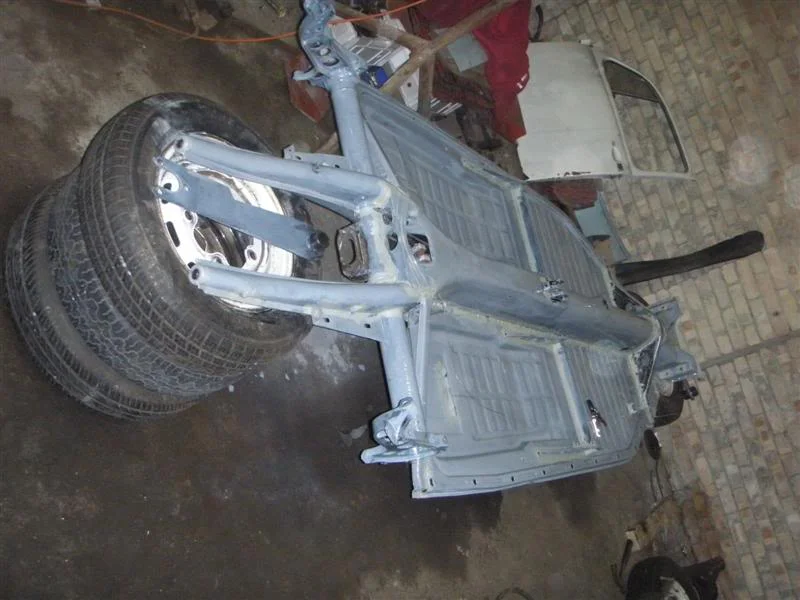

Got all of the framehead welded together now so is very nearly ready for new floor pans, will get rid of the paint and rust on the chassis before paint aswell

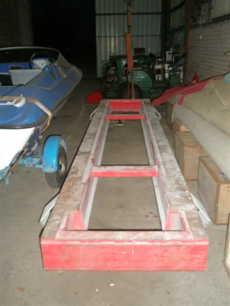

Was also given permission to use this beast, its a car jig made from rsj's. must weigh around 2 tons

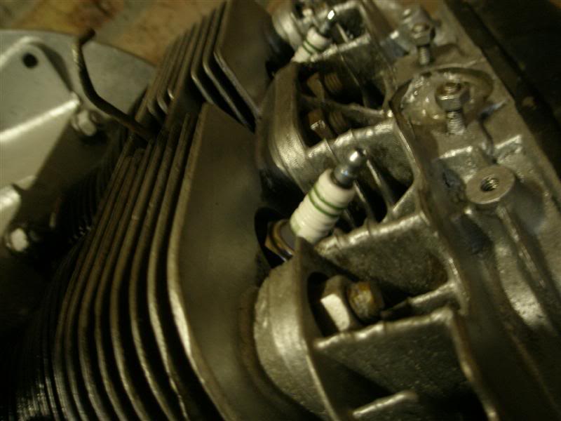

Wanted to get my engine back on track aswell so fitted a few parts that ive painted up to see how it looks

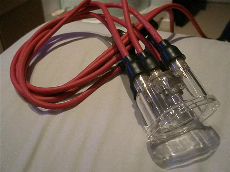

New sparks
in love with the engine atm :D

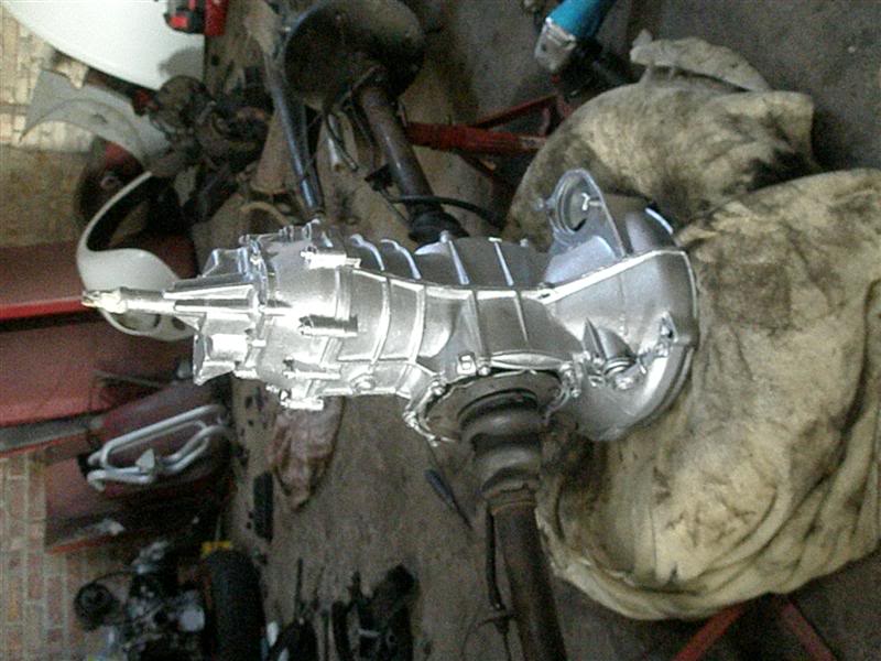

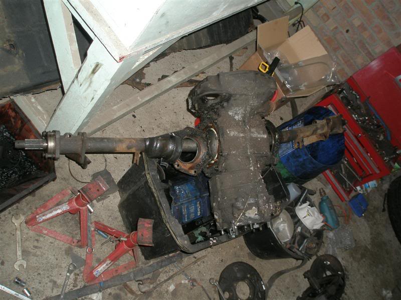

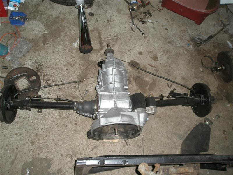

Gearbox and brakes are done now aswell, this is the knacked original box - sounded like a tunnel boring machine when in neutral
New one, painted up to match the engine, new gaitors etc

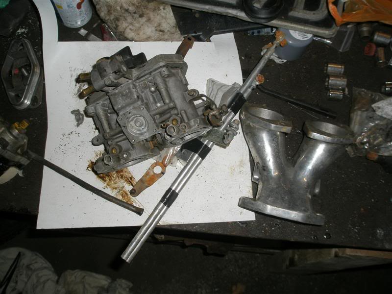

Weber IDF 36 Carb - in bits need to rebuild it

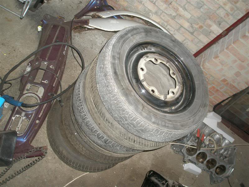

And these are the wheels i picked up - 4x smooth steels with all clips intact
Picked the job lot up for £85 and the wheels £10, amazing find seems as the carb build up would go for 150£ ish. think i know what i'll be doing tomorrow

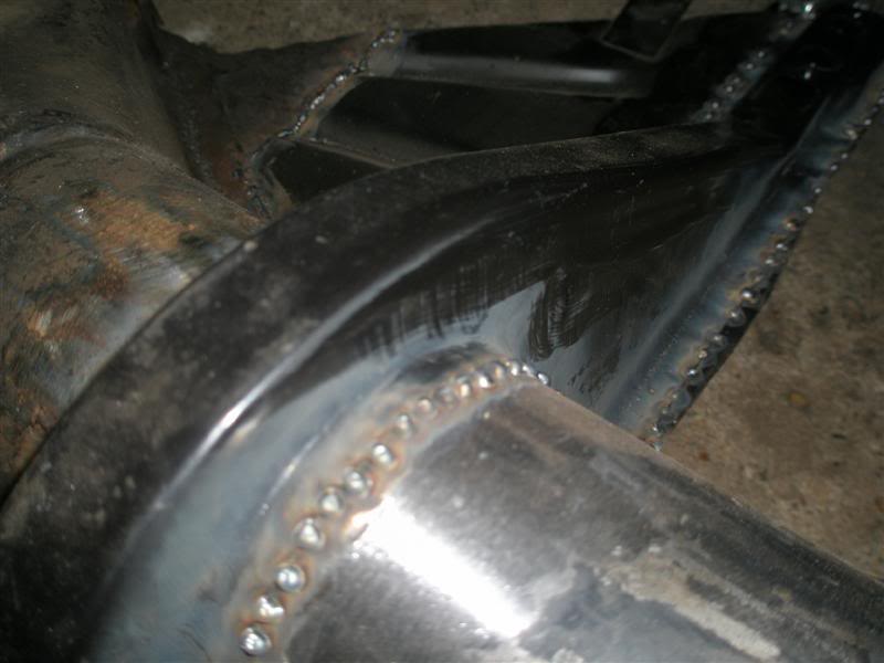

My welder hasnt been turning up recently so managed to drag him round to teach be how to do it myself
so heres the results
Not bad if i say so myself, pans are tacked in, framehead is all seam welded

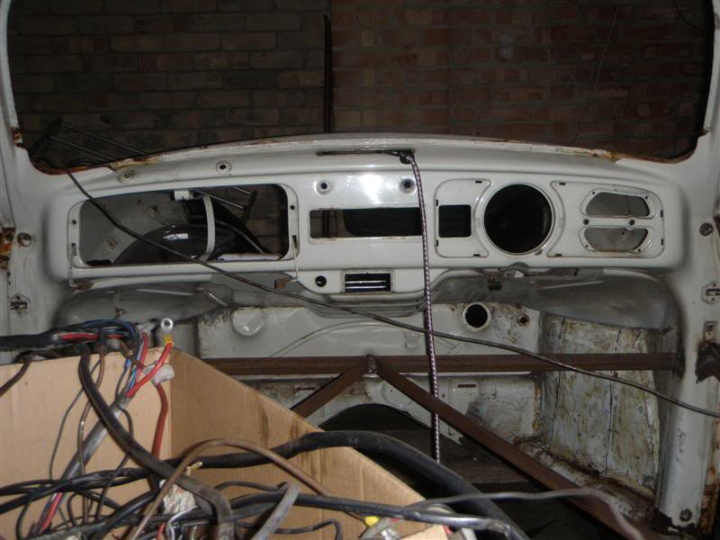

Heres the orig dash , was thinking i'd do something different but not radical
Ideas - Weld up ashtray, move ignition over, battery cut off on the left, toggle switched in the middle
Smooth over grab handles and dash vent

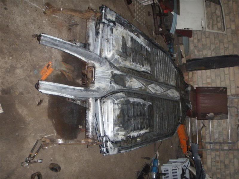

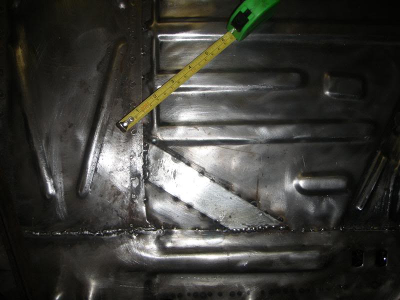

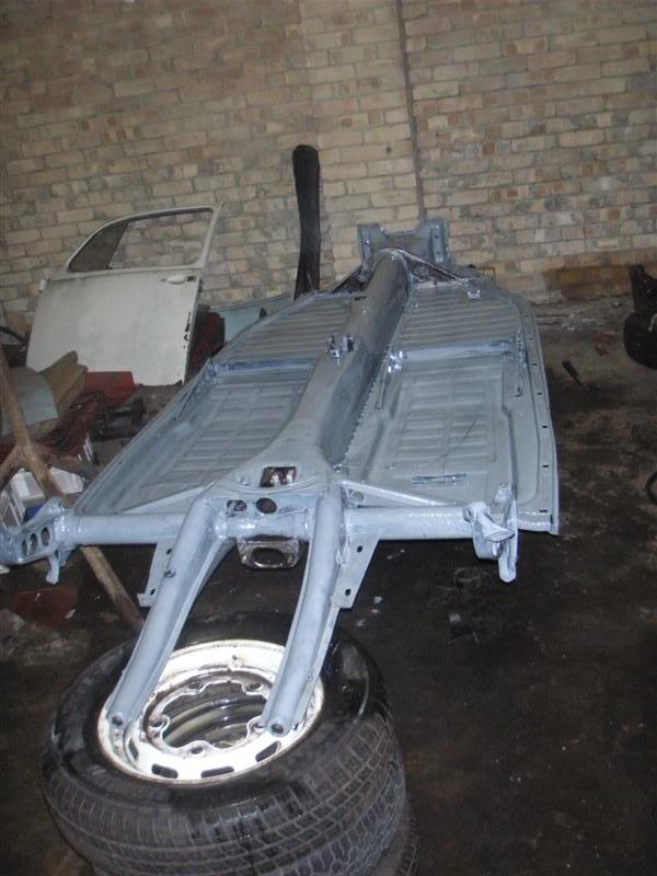

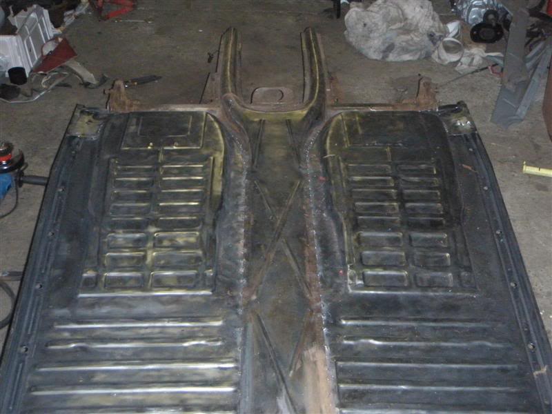

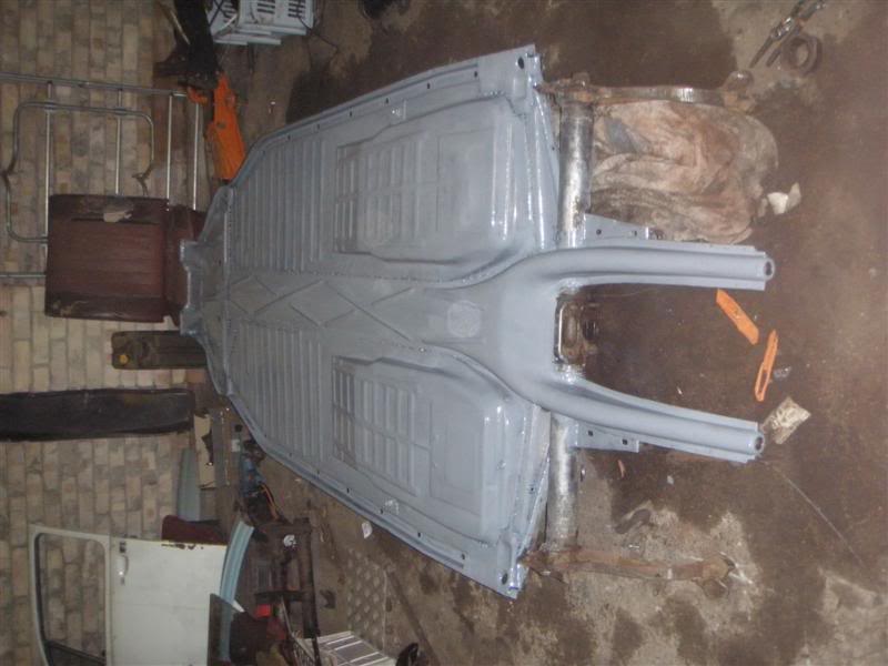

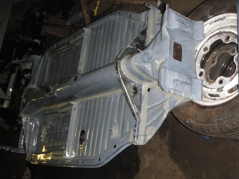

Been working on the pan for a while, getting rid of all rust, paint etc

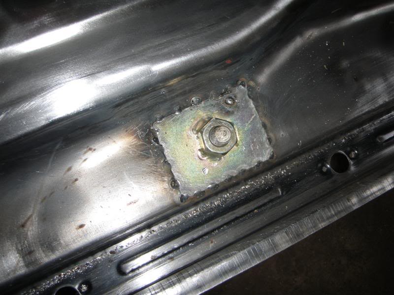

Welded in seat belt mounts and pedal assembly mount
Quite pleased with the pan now so moved onto painting the bottom side first:
Striped down the chassis to bare metal, brushed down with a stiff brush then degreased using builders 'sugar soap'.
wiped down using 17p white face cloths from tesco :), until dry then lashed on the POR15 metal ready with a paint brush and left on for about 2 hours - important to keep it wet
turns out like this
then drain off the metal ready and get the hose on it, or in my case a hooge jerry can. then obviously towell dried
Then POR15 gray undercoat, very important to use gloves as it will stain your hands for a week or so
used one little tin on the bottom:
that pretty much it for now, will be doing the other side soon. Then its UPOL grey stripe seam sealer and POR15 black chassis coat

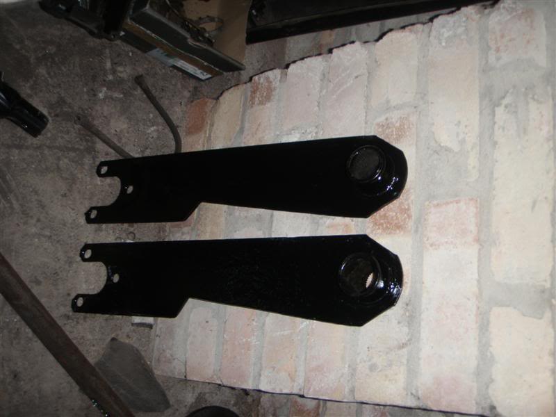

Right, Flipped the chassis over now and been grinding away rust, paint and smoothing over welds ready for some more POR15

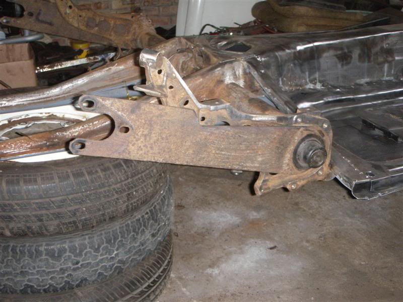

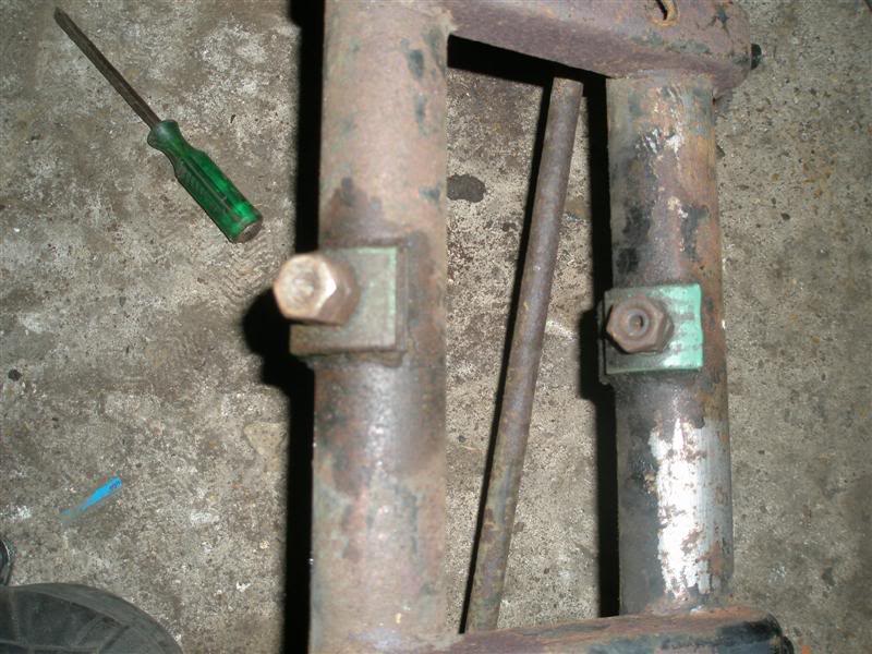

But took some time out to notch my springplates using KCW's tech thread, allows for better suspension travel when it's lowered a couple of notches in the back

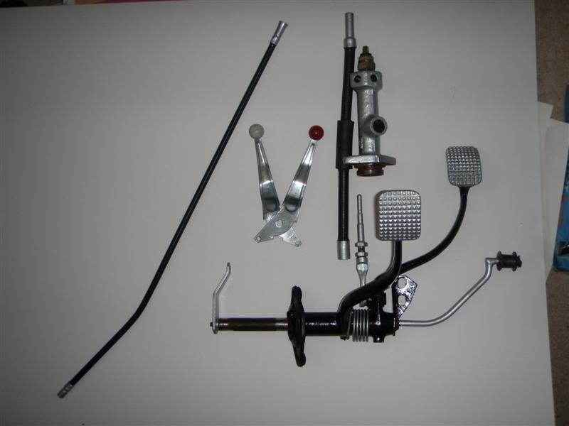

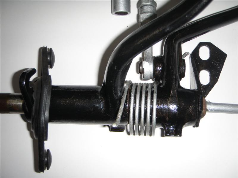

Also managed to attack the pedal cluster, master cylinder etc with a spot of hammerite - actually really iimpressed with how they came out

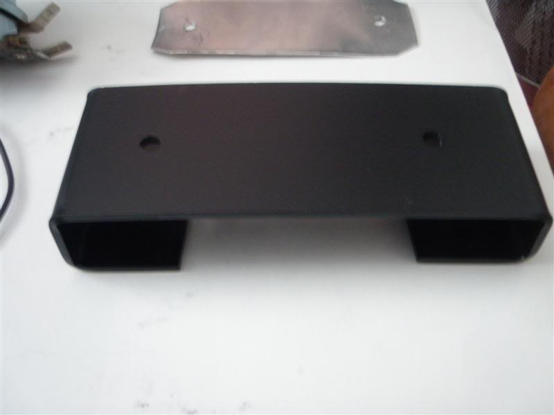

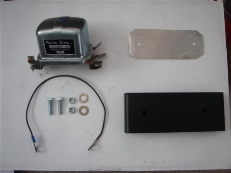

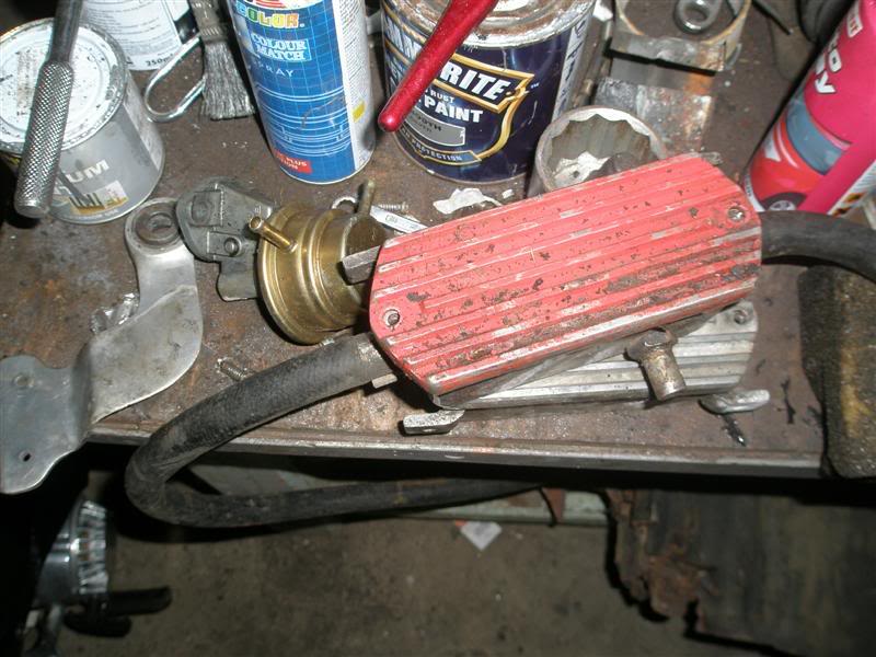

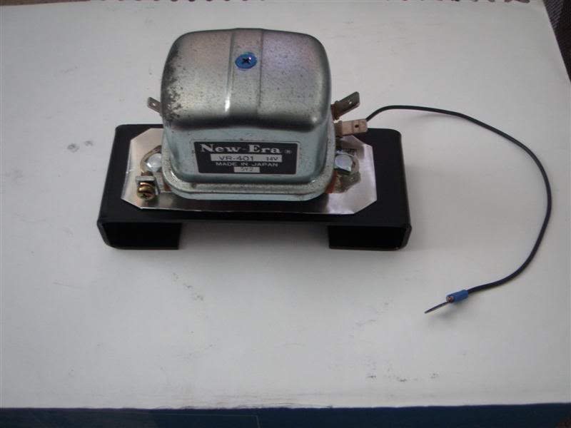

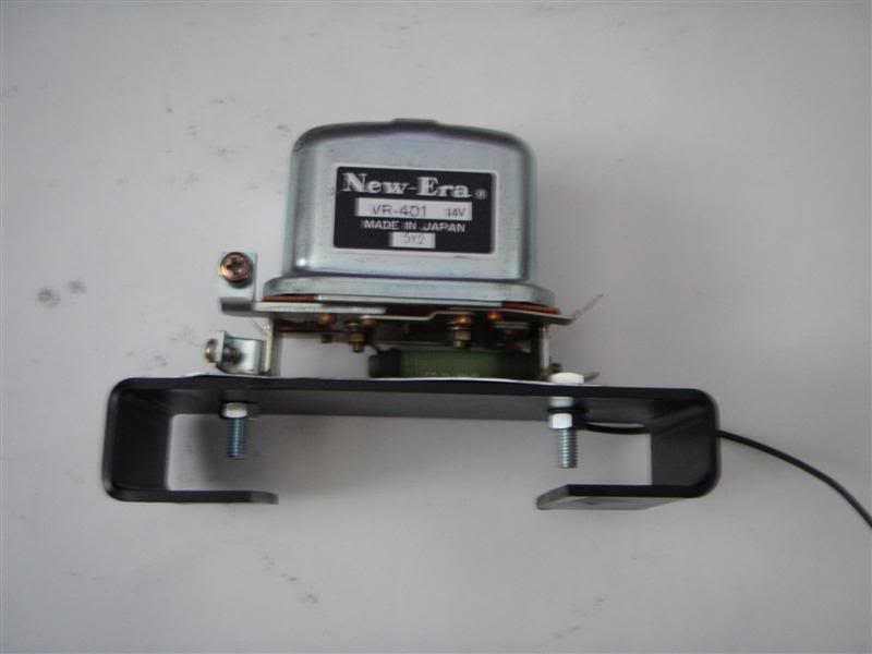

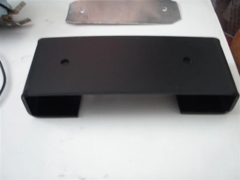

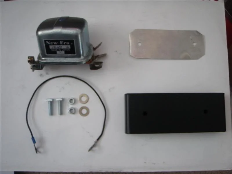

On the original pan the voltage regulator was screwed into the floor, didnt really want to do this so knocked a little something up using genuine college materials :D
Whats needed:
Hardware
Strip of aluminium to connect points
Wire to connect to neg earth
Strip of plastic drilled and bent into shape using a strip heater
Coat of satin black
Bash it together
looks mint imo, cant wait to get the pan fully painted and sealered and start bolting stuff down

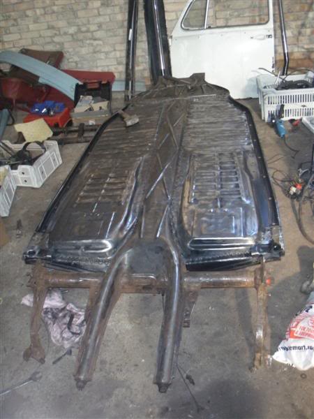

Was down the barn all day friday untill 2.30am preping the topside for paint and getting the master cylinder hole drilled
left it looking like this
Will paint the framehead hat and gearbox mount when i finnish cleaning them up, need to weld up the hole on the LH side of the hat - realised i didnt have any spare steel

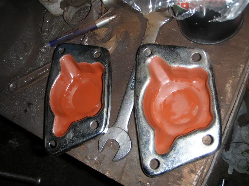

Thought i'd give the insides of the torsion bar covers a coat of red lead to stop the rusting too much
Then saturday, my mate came over to flip the pan and get seam sealer on both sides

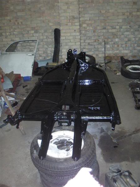

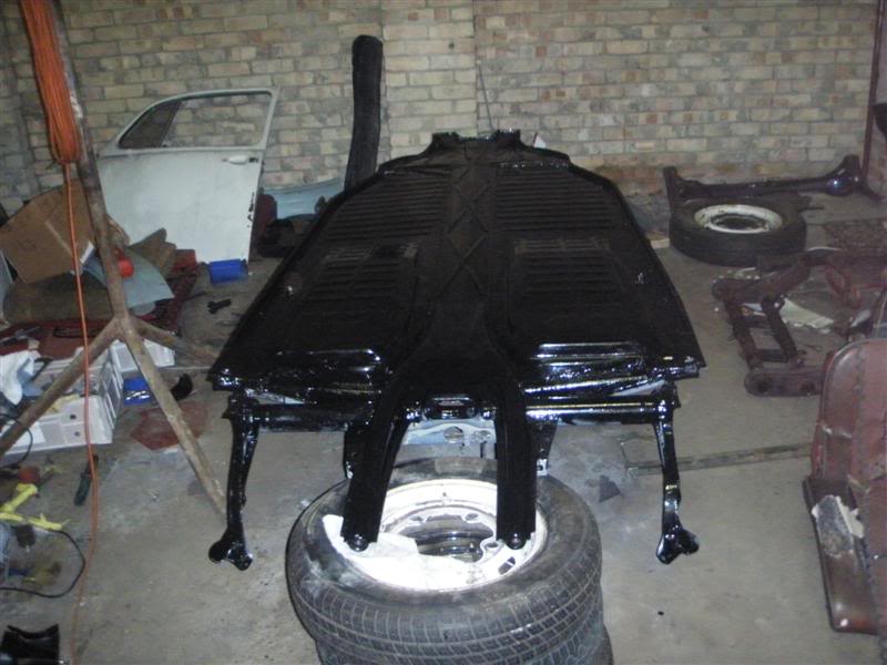

Right, tonight got the black paint on, will probably be continuing with it tomorrow aswell

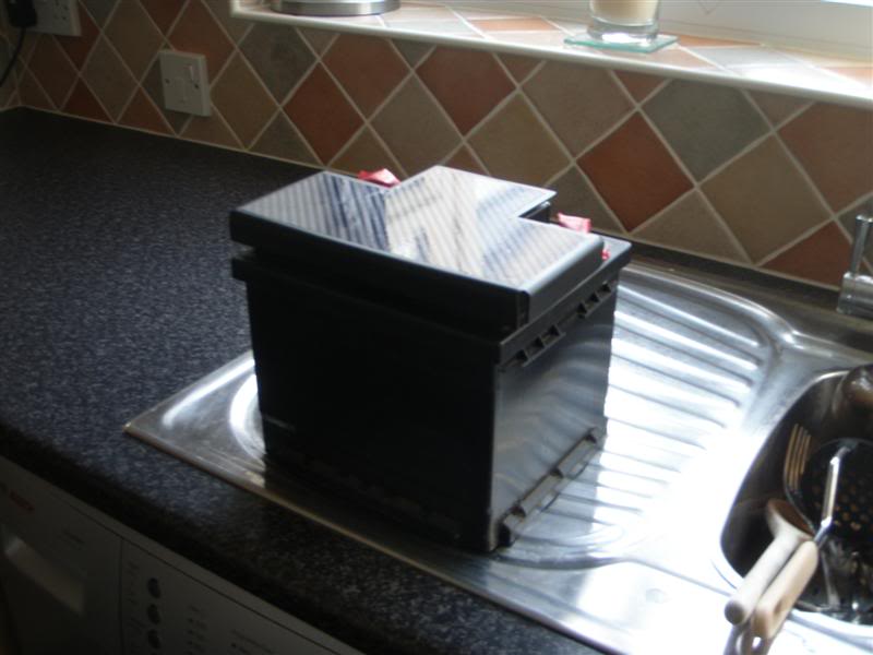

Also managed to knock up this moulded plastic battery cover, sprayed matt black with carbon vinyl

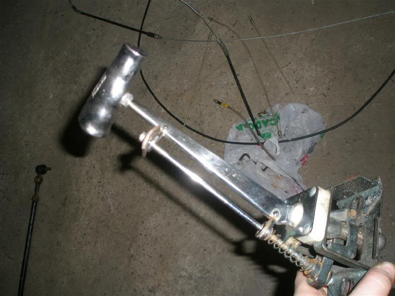

finally had a go at making a crazy shifter in a spare 10 mins, over twice the height of the orig, jus for laughs :)
welcome to 2.30am

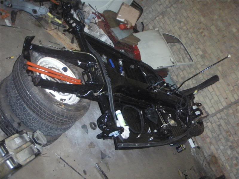

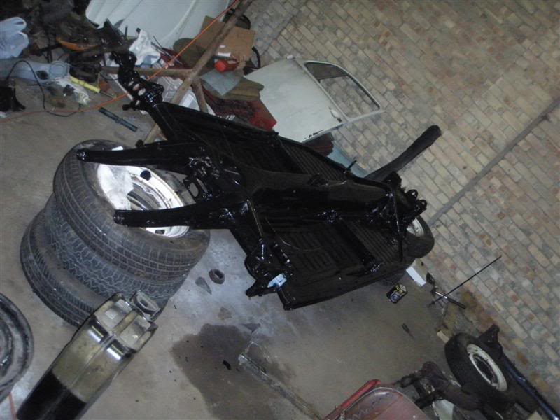

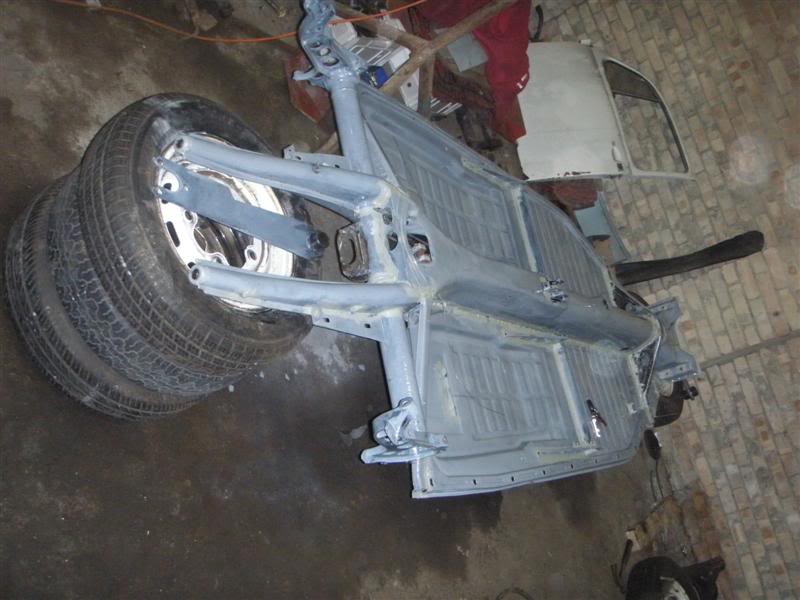

havent updated in a while so heres the latest
Final coat of paint (missed a few bits :P)

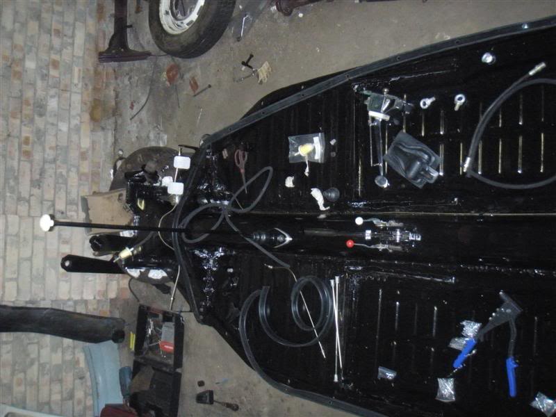

Been cracking on with installation for a while aswell

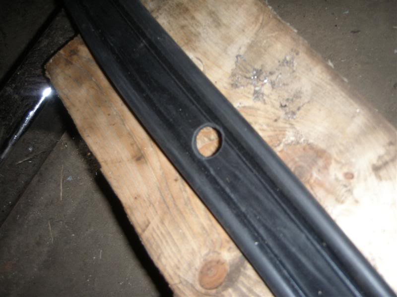

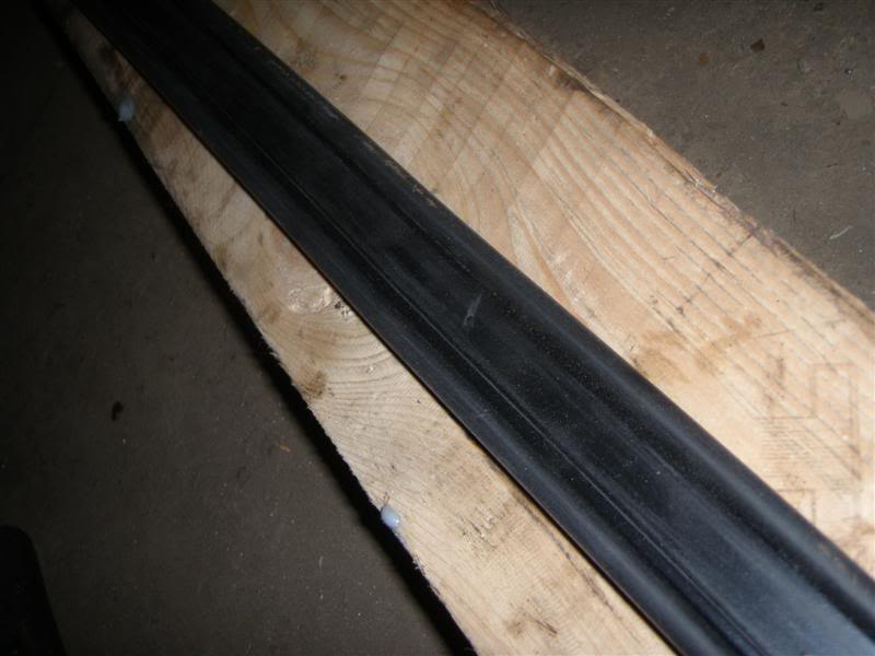

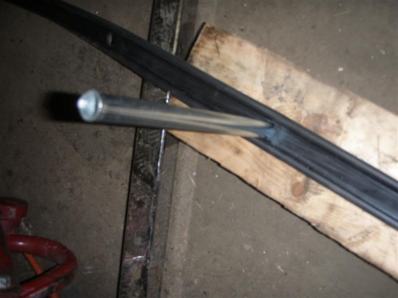

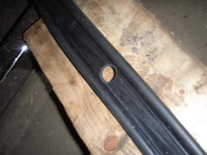

All brake lines are in, and chassis seals are ready to be bonded down
heres how i cut the holes, as drilling rubber is difficult i found there tubes in my room and decided to make use of them ;)
you actually get alot of chassis seal, more than you should need anyway...

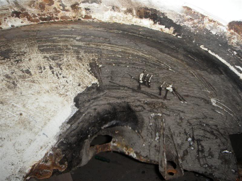

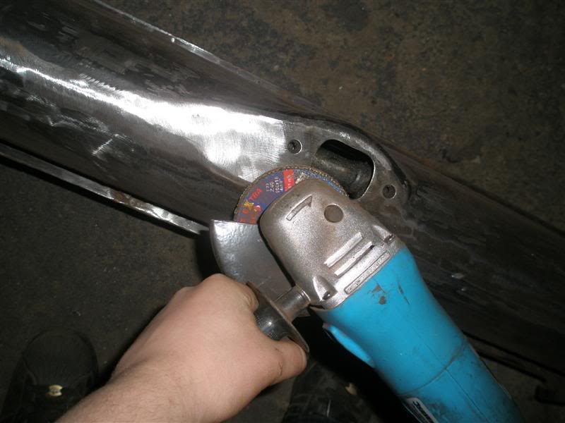

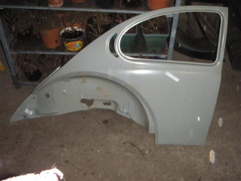

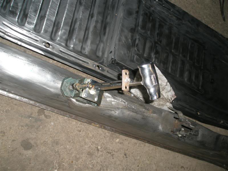

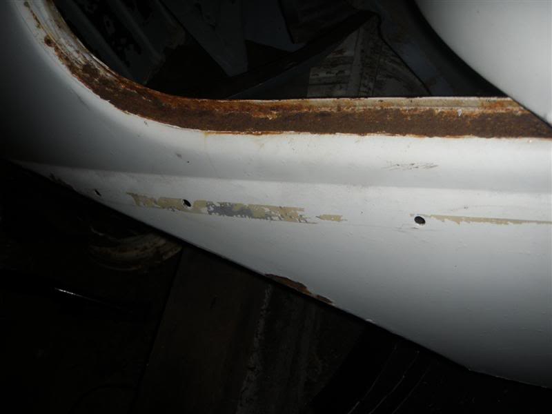

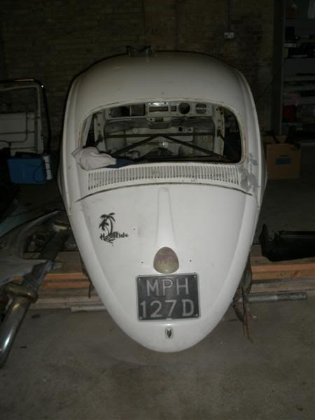

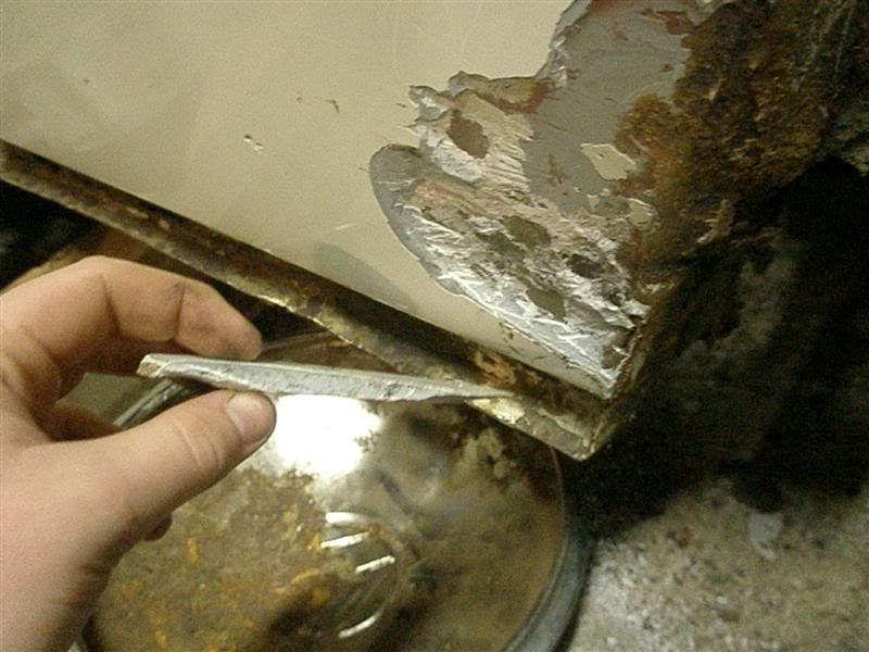

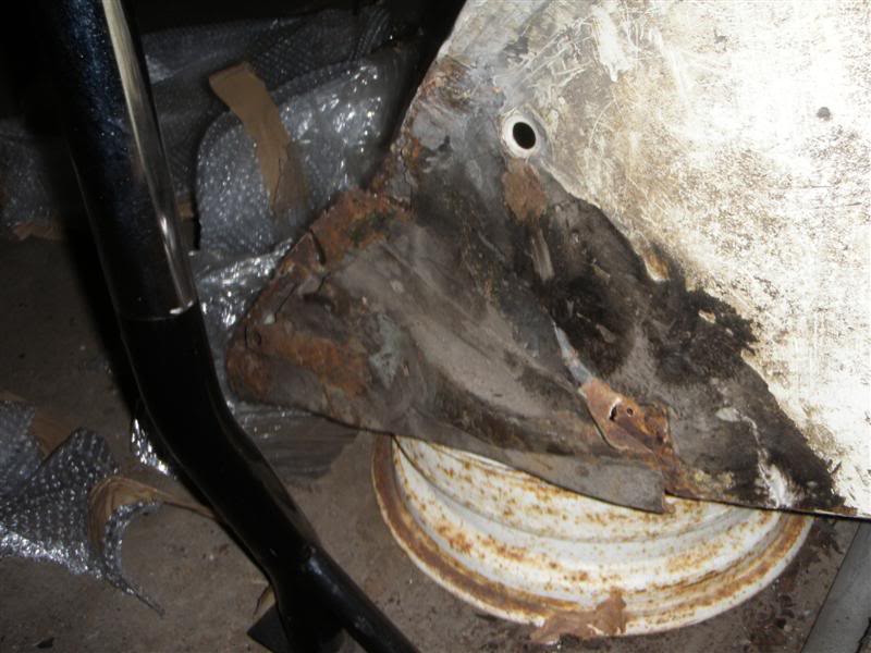

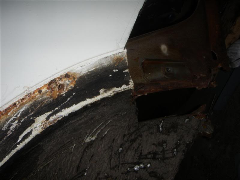

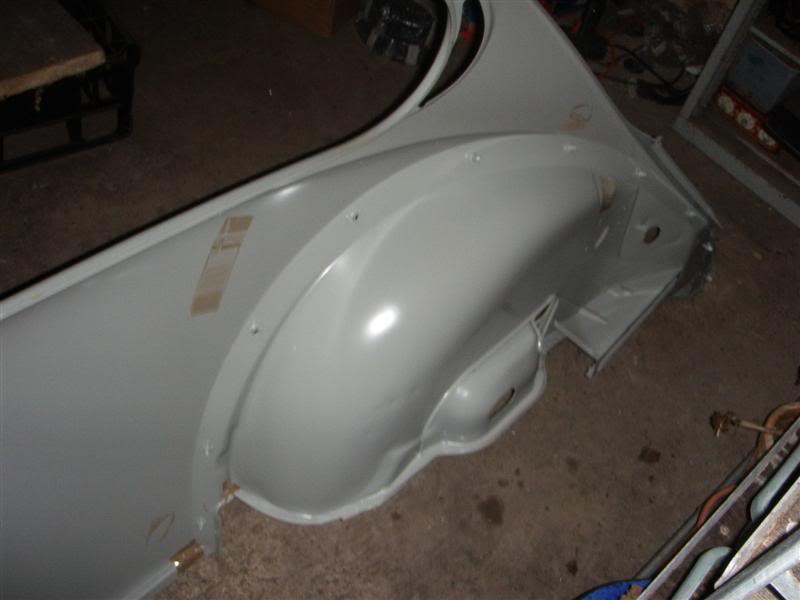

Heres a step in the right direction: basically the rear quarter needs 6x seperate panels - rear lower quarter, inner arch, outer arch, frame panel, bumper mounts and wing bolt line
so to save time, money and finish i picked up this
not an ounce of rust, just need the other one now...
