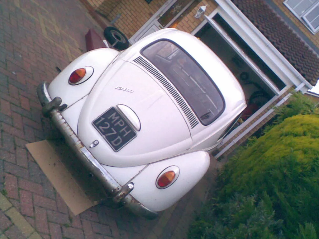

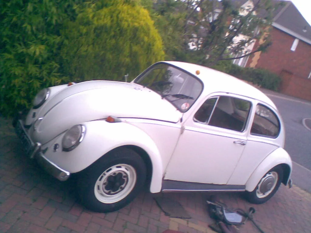

Heres my new baby...

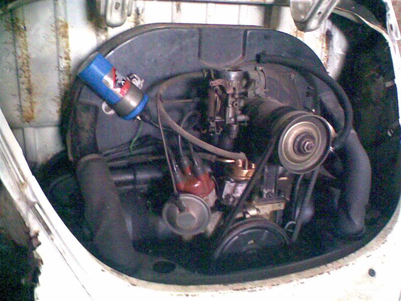

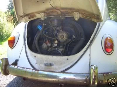

66' Bug, Everything is original only modification is to 12v.
It has its problems, gearbox knackered, interior ripped, oh and RUST
It did come with a extra gearbox and quite a lot of spares inc repair panels.

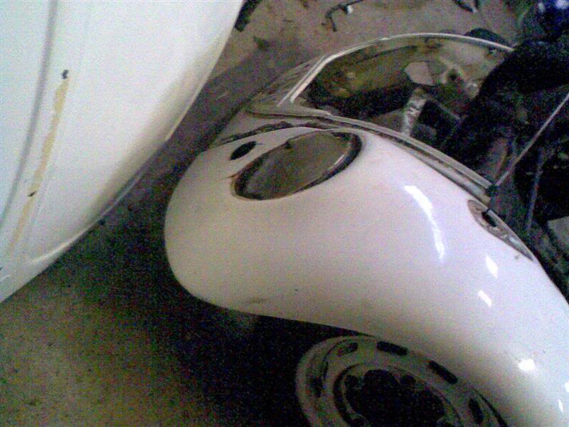

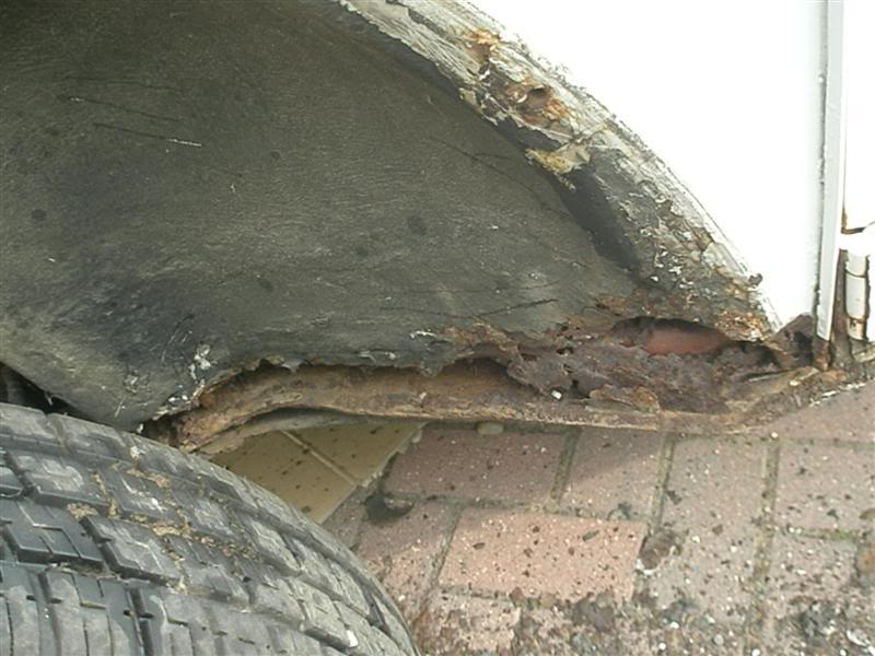

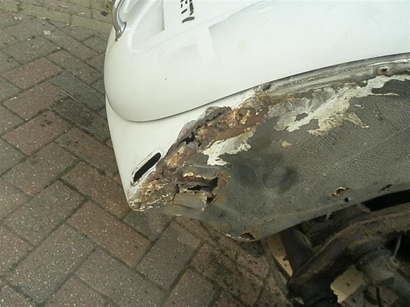

Its going to be a lot of work, just started inspecting it and there are a few odd bits. Rust holes in the usual places and in some places there is fibreglass wacked over rust holes lol
do love the plate though 'MPH' :)
plan to get her solid, fully welded up and slammed with a narrowed front beam

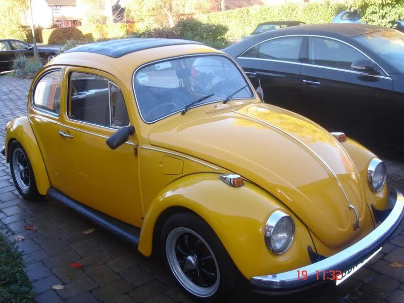

loving these, not long did an audio install in one, Had to convert the fucker to 12v first. Had a very nice system in it.
ITs just came back from Kingfisher customs i believe now, Runing a very fast 2.4 turbo engine and pretty much brand new underneath, Will be mag featured when its 100% complete.

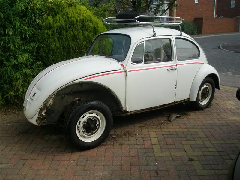

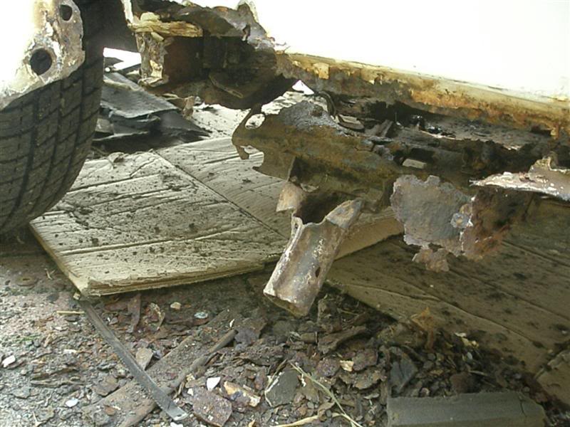

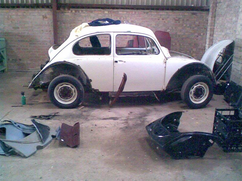

Turns out its not as solid as i once thought

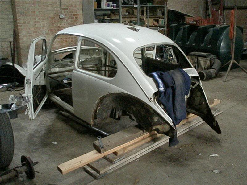

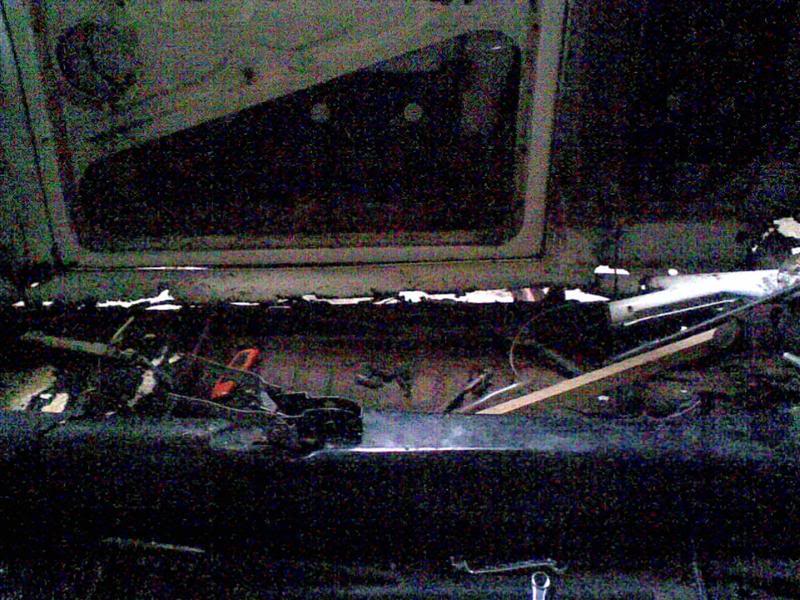

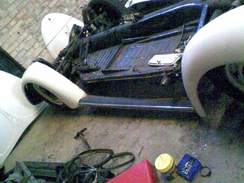

Arrived an untouched stocker, apart from 12v conv. Now interior is out, wings are off, trim is off etc. Need to rent a garage so i can split chassis from body.
My rides 8)

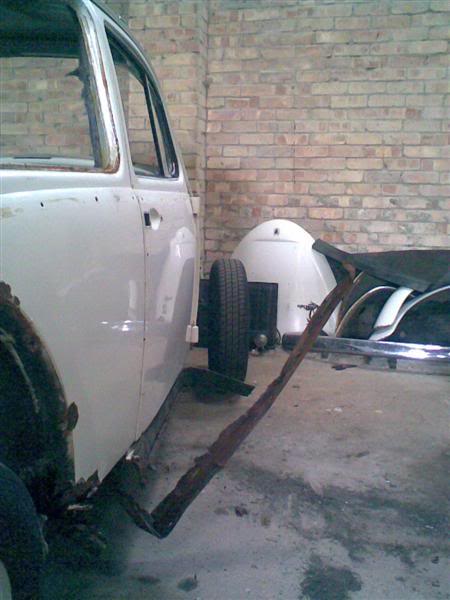

Rear drivers jacking point completely gone :(

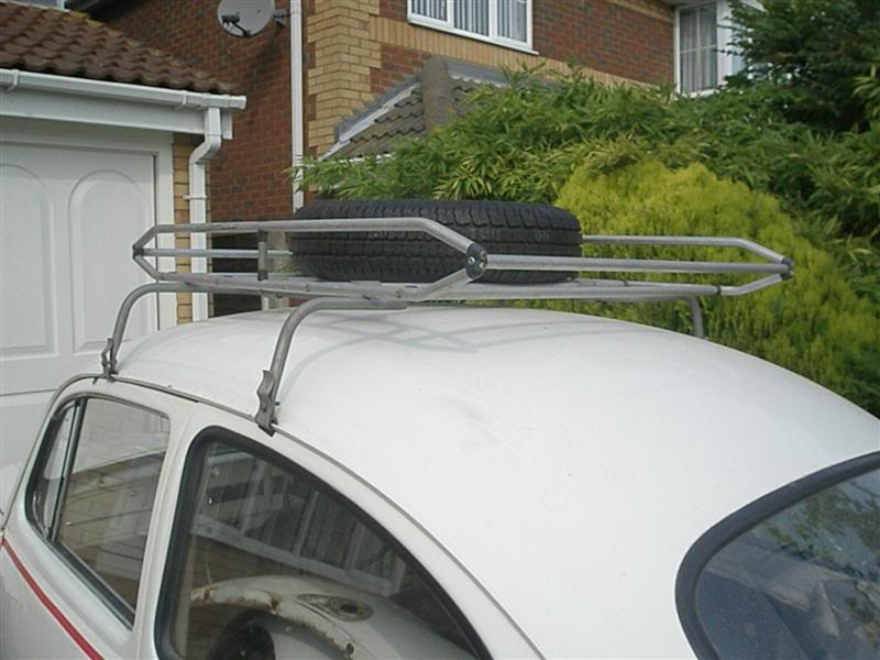

But i did pick up this desmo roof rack from a car boot for £6 :) , bit early for cosmetics but it keeps me motivated lol

Its the usual rust on these but there are plenty of repair panels available

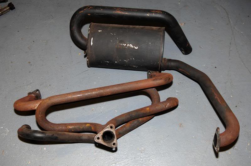

Fat Boy tuckaway exhaust and header
Still need to get the heater channels as you arent meant to see the inner channel in the air like this lol

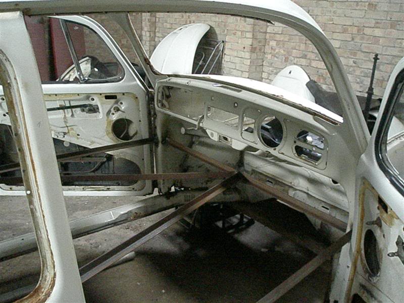

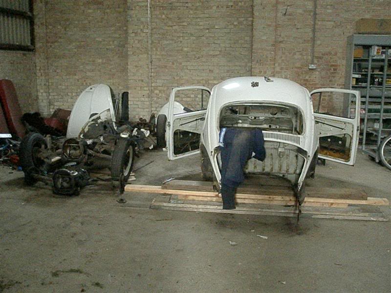

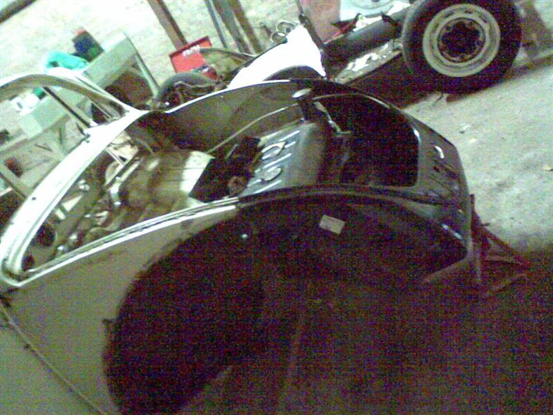

Body is off the chassis, and recently been round the country picking up more pannels inc windscreen corners, dash for a mate, heater channels, crossmembers, rear 1/4 panel
Firstly braced the body up to stop it warping when lifted

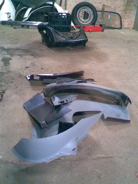

Got the front clip tacked in place aswell, although repro panels are shocking
Couldn't resist putting the old panels together

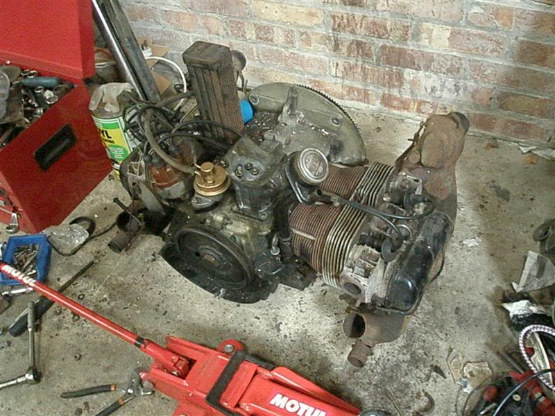

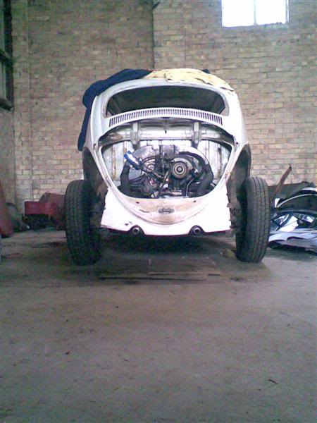

Whizzy little 1300 engine out and already striped down a bit
