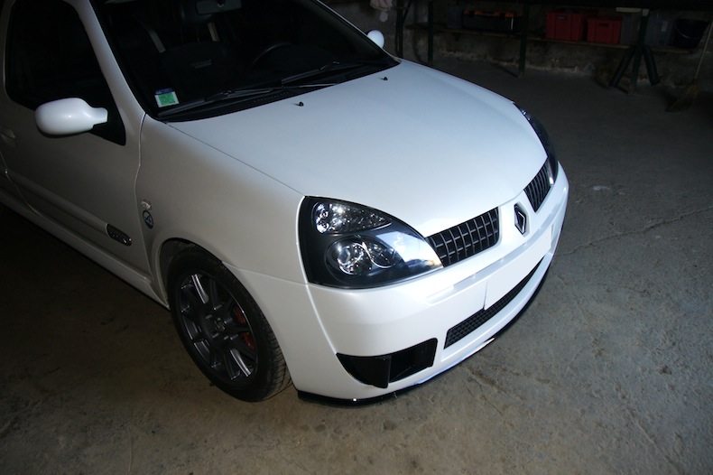

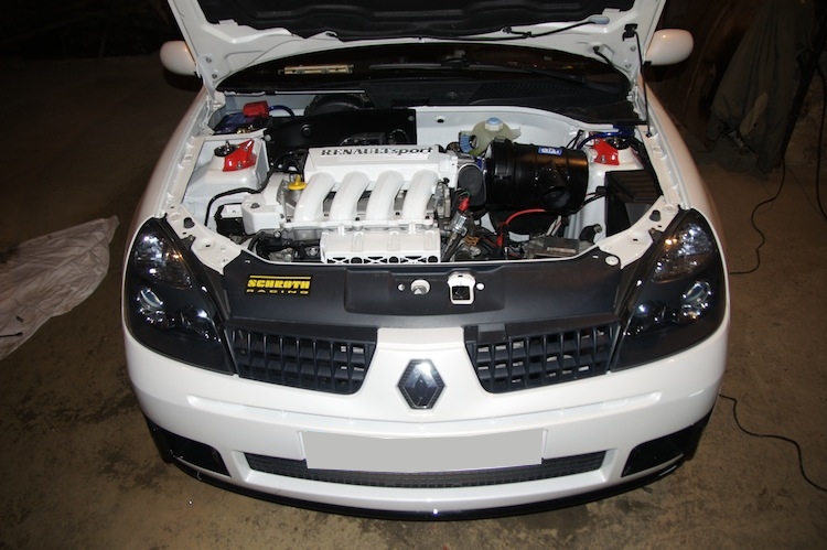

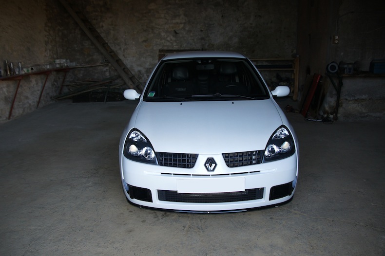

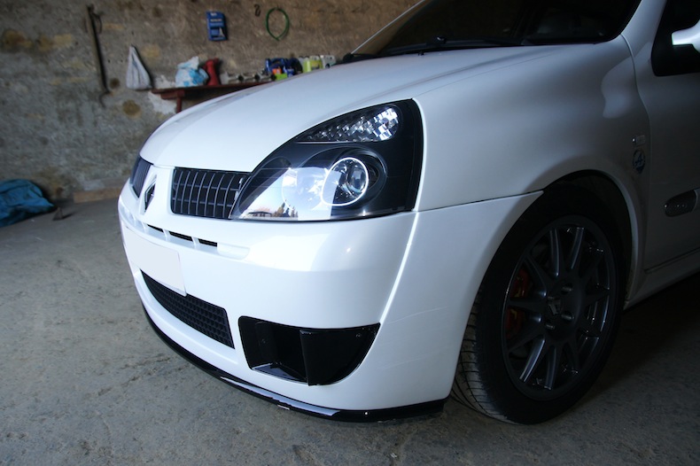

My French Clio 182 "White Pearl"....

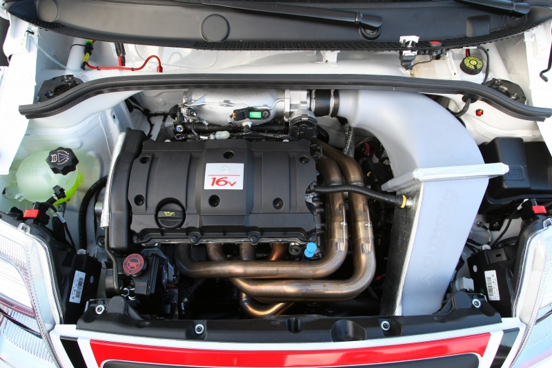

  Clio 182 White CUP
thank you everyone :eek:
Awesome, is that a 6 speed box?
It a gear shift of Megane RS ;)

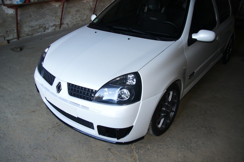

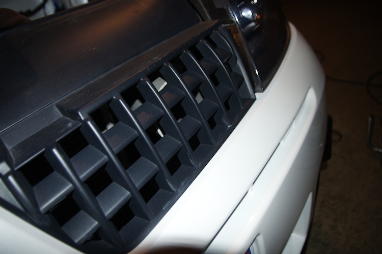

This is very nice, I like what you've done with the "diffuser look" on the rear bumper - the cup foglight ducts look excellent in black against the white body too!
thank you, it's true that it gives a more aggressive racer
Thinking of getting my 182 done now :p Sorry for pinching your idea... (
No problem: on the contrary, I am proud that my idea as you like :D :approve:
Is your vinyl wrap or paint?
is painted glossy black Megane RS :cool:

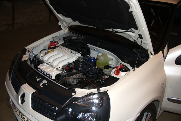

  Clio 182 White CUP

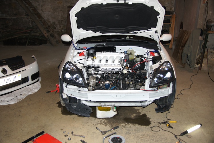

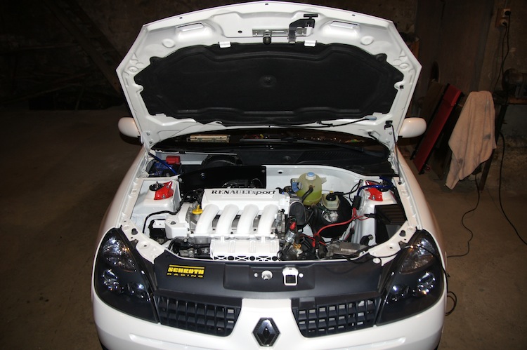

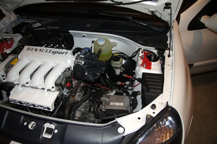

Hello,

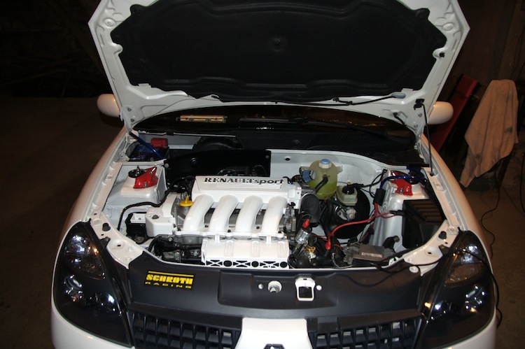

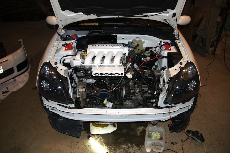

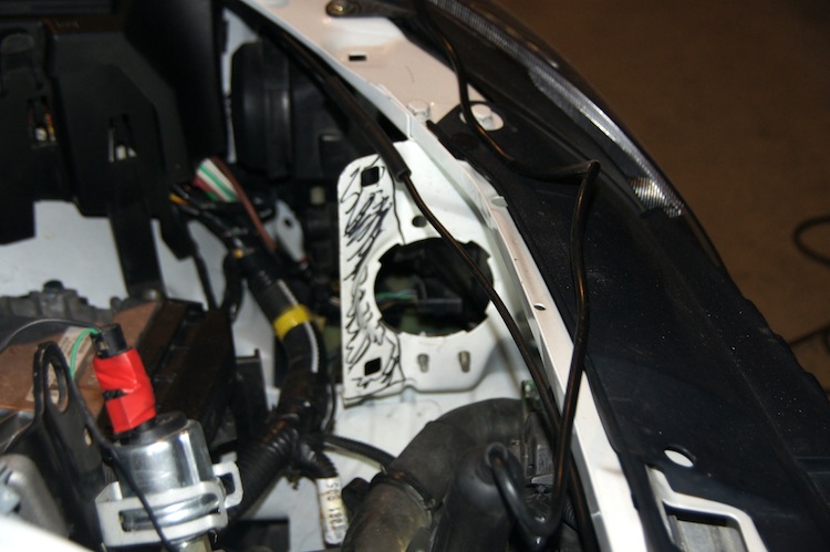

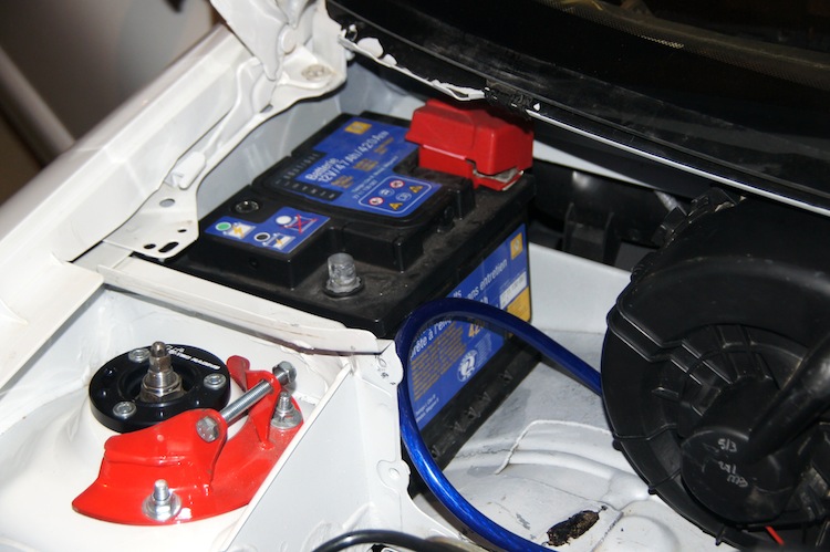

Some more news:

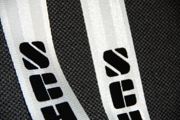

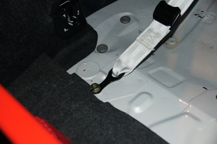

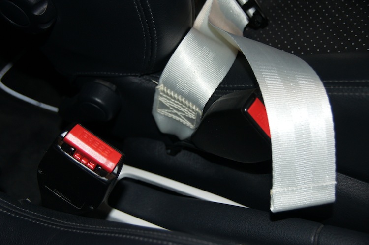

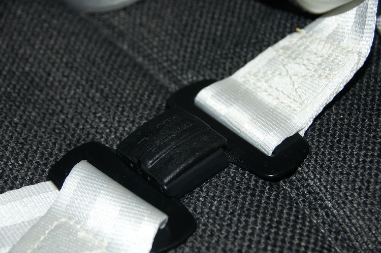

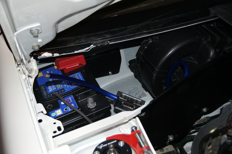

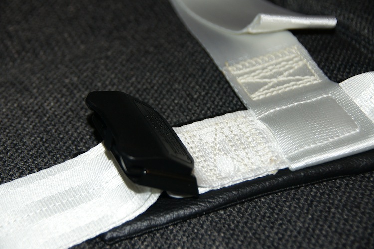

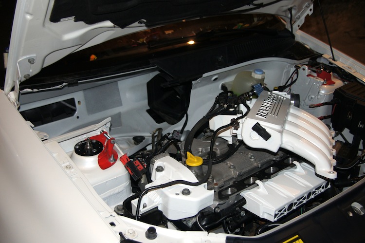

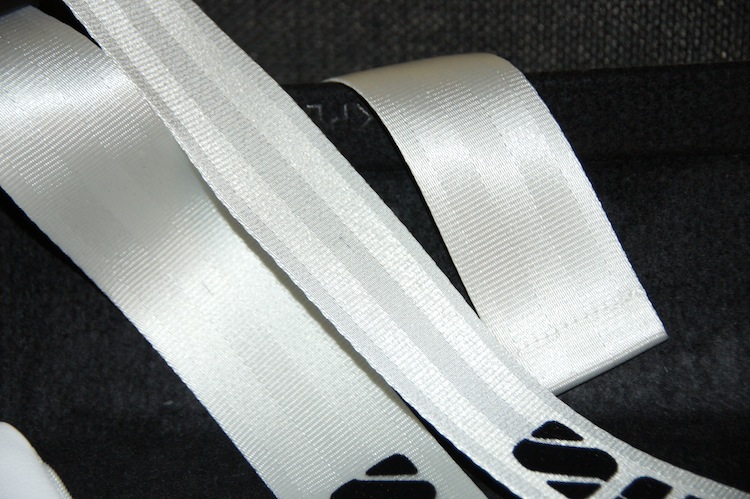

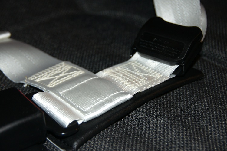

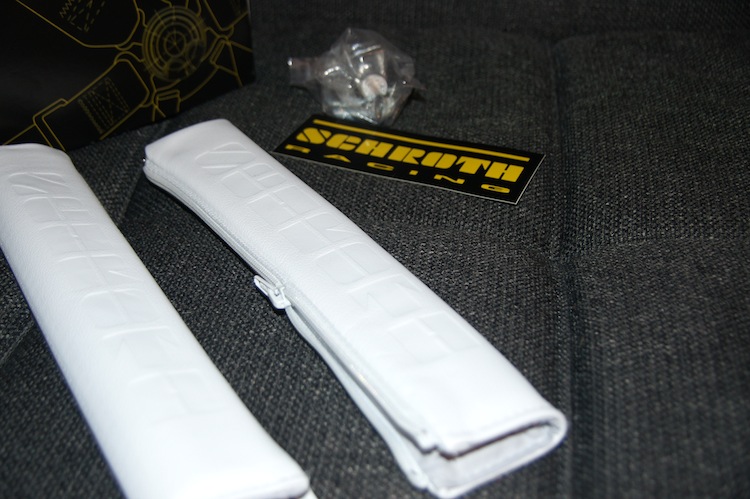

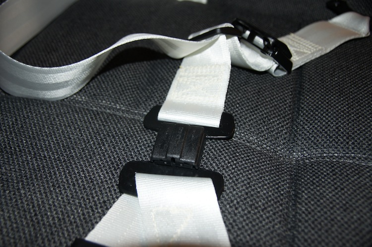

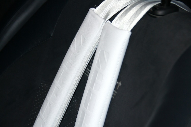

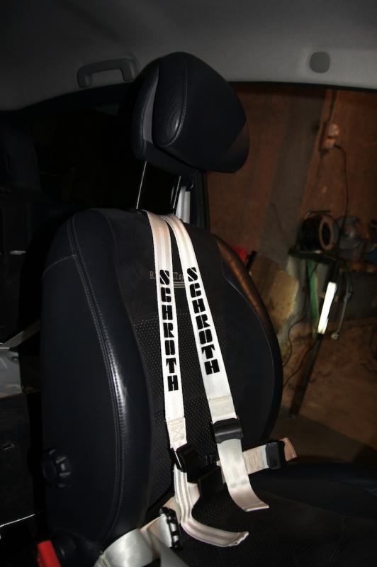

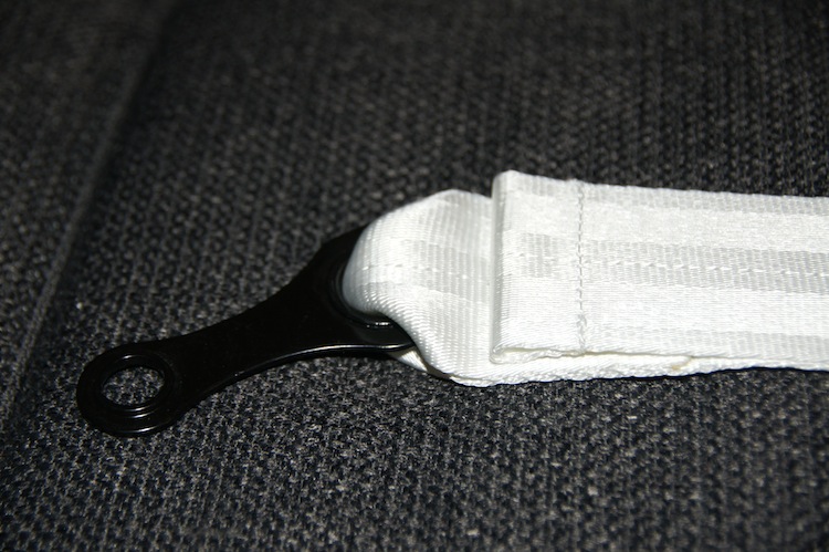

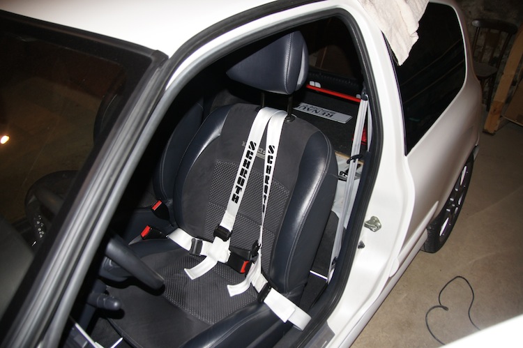

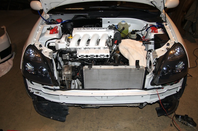

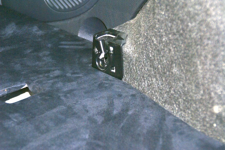

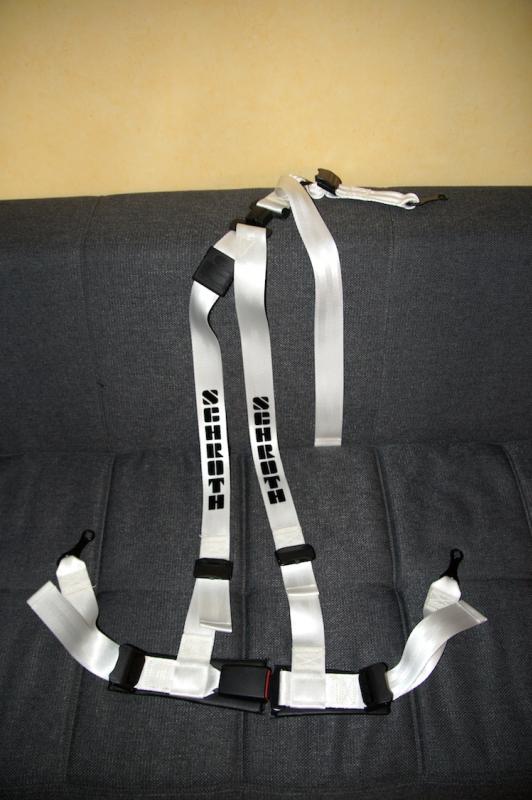

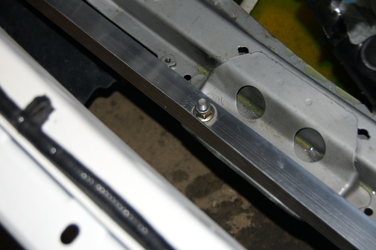

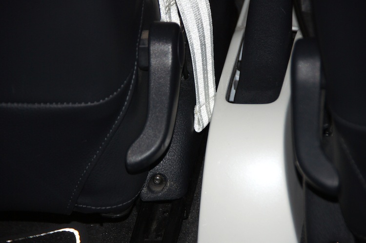

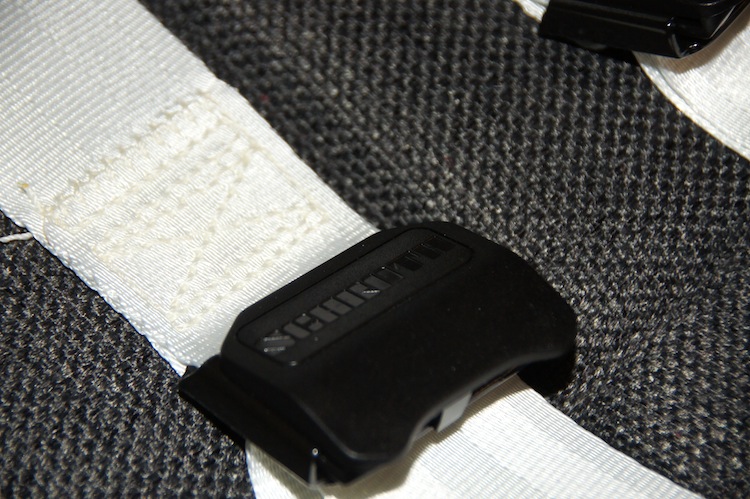

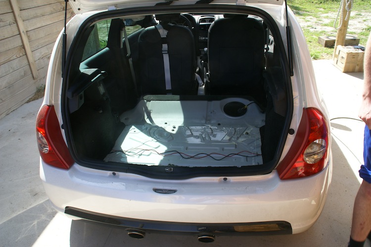

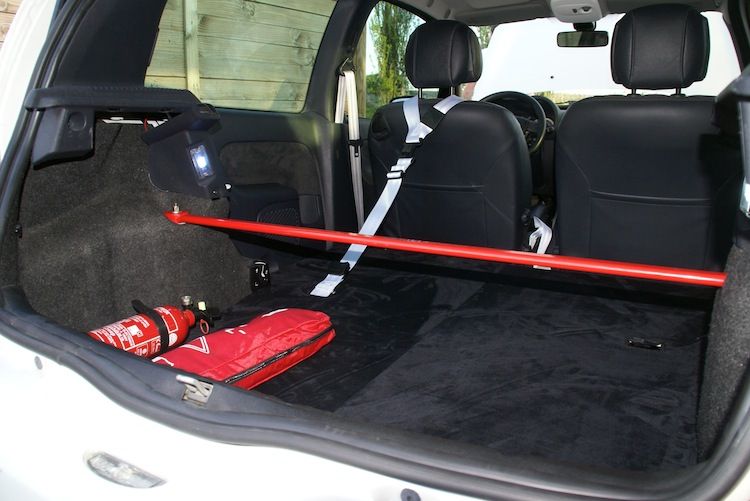

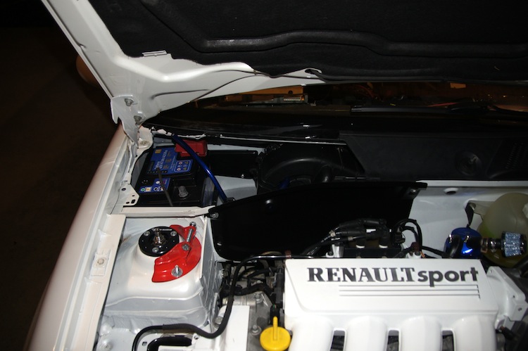

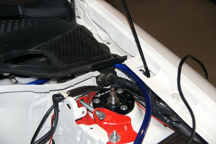

- Mounting point harnesses 3 "White Tiger Rallye 3 " from Schroth.

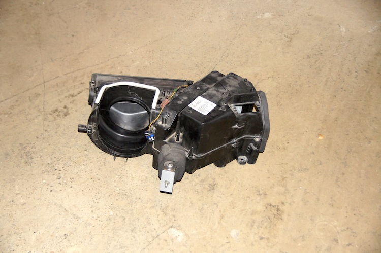

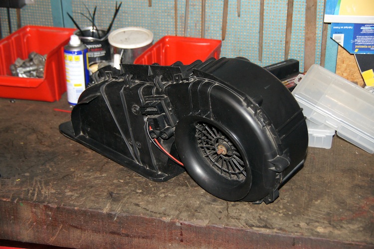

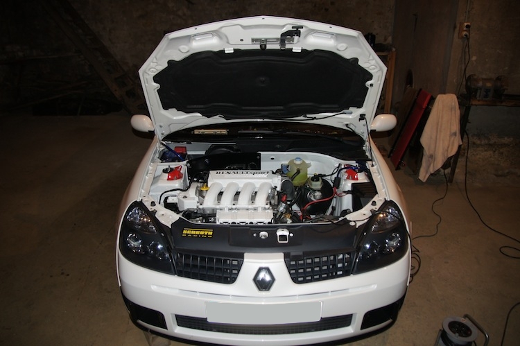

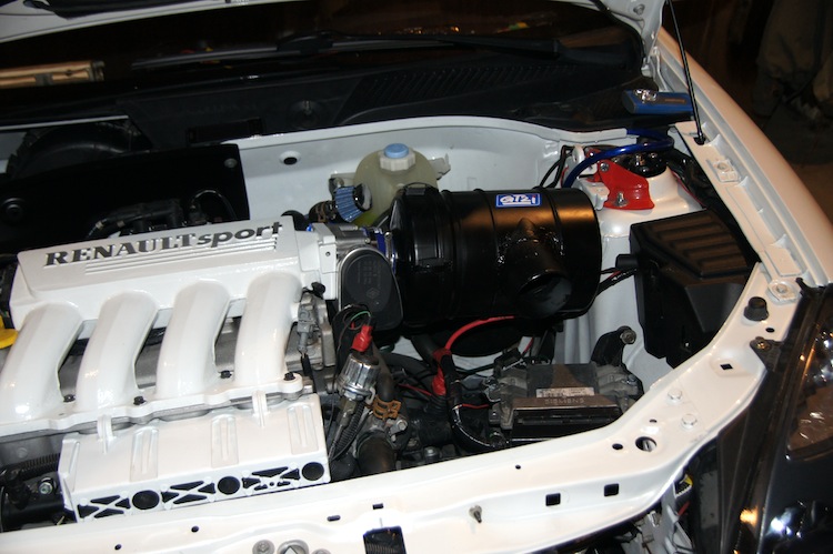

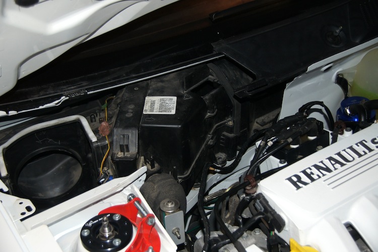

- Replacement of the ventilation system of origin with that of the Clio Cup.

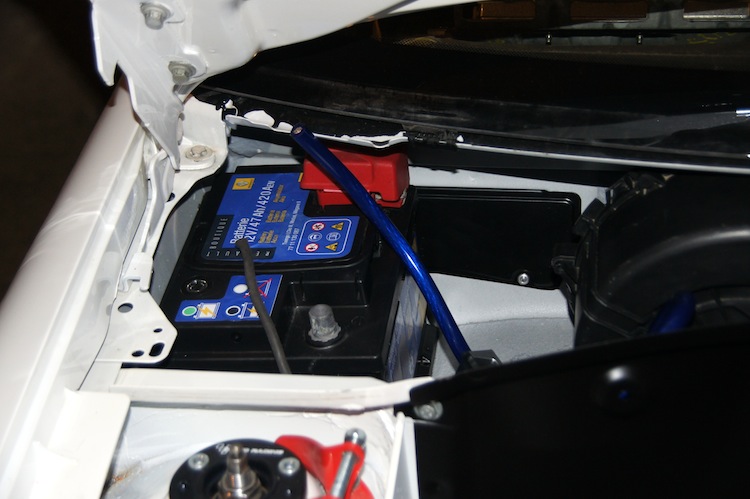

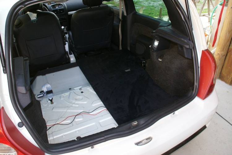

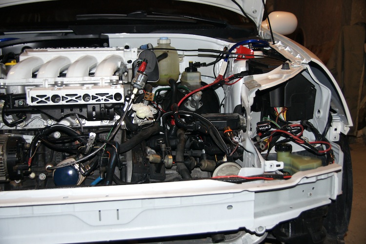

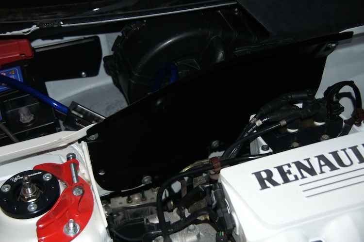

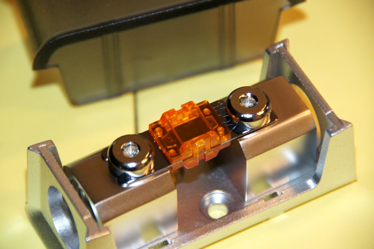

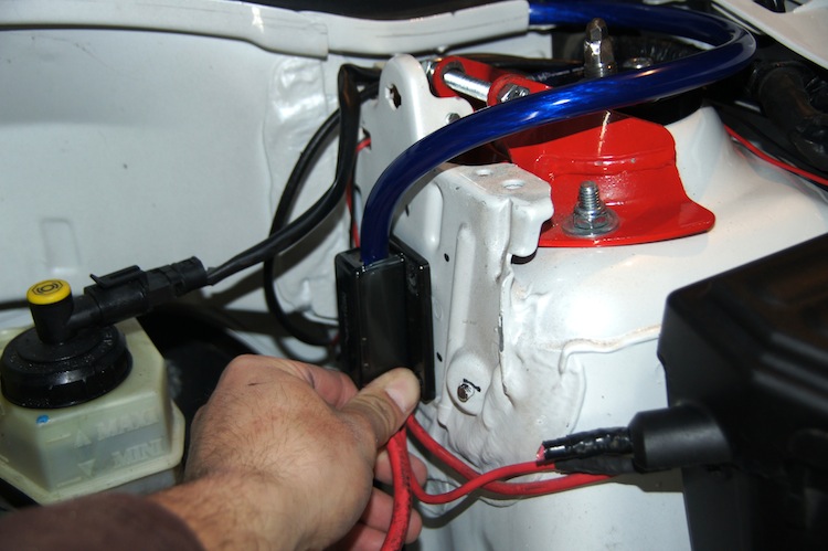

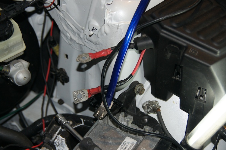

- Battery orgine moved to the Bay of windshield.

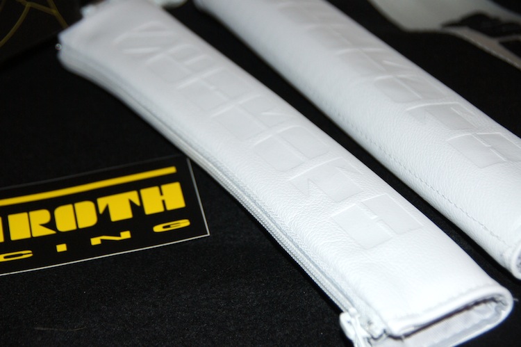

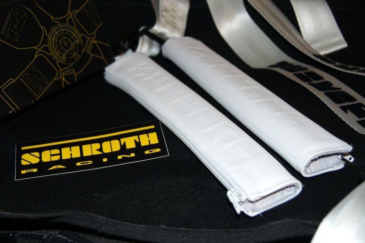

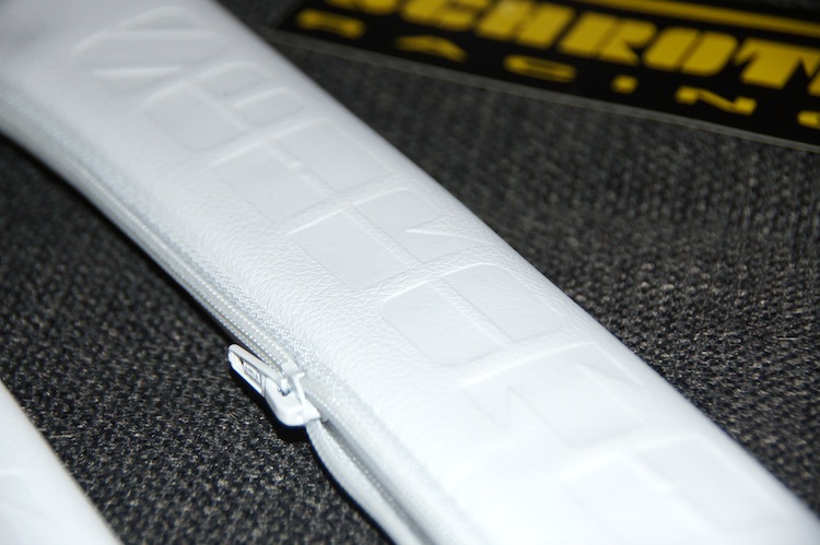

Les fourreaux...en cuirs blanc...tout simplement sublime :cool: :cool:
In my Clio 182...."magnifique"...

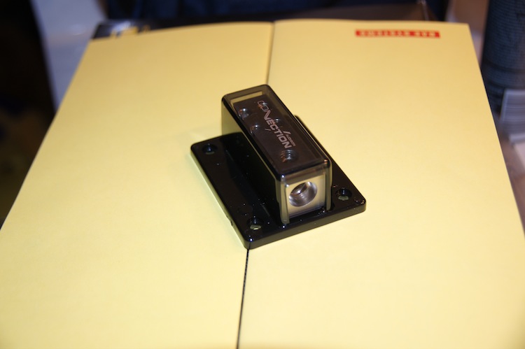

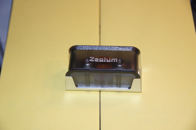

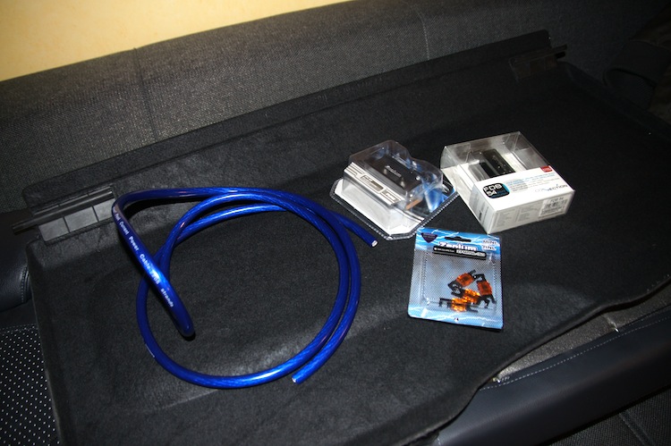

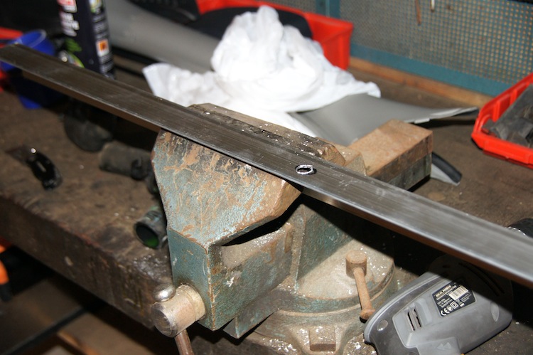

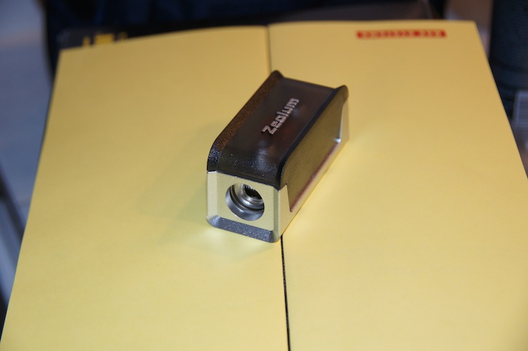

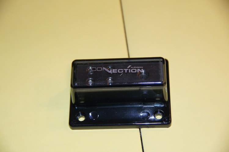

Some parts for battery deport :

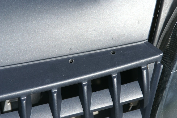

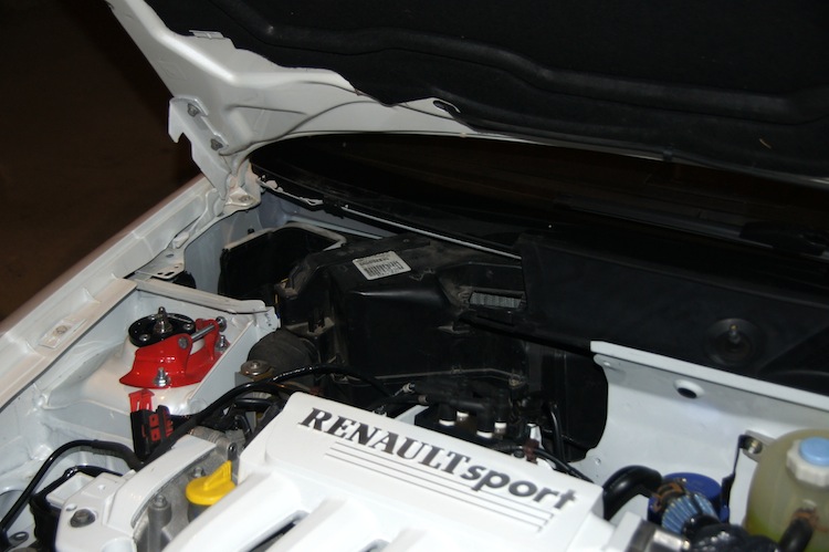

Block ventilation "basic" :

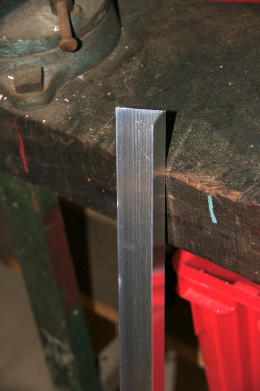

And attack the work ...
Instead of won :
Suite :

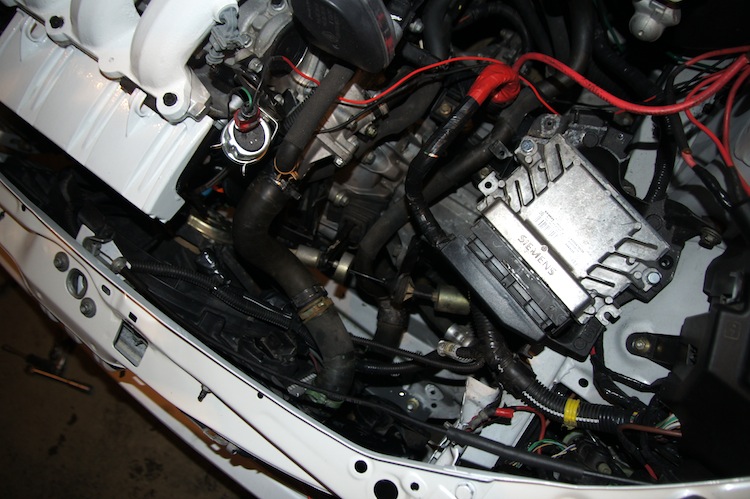

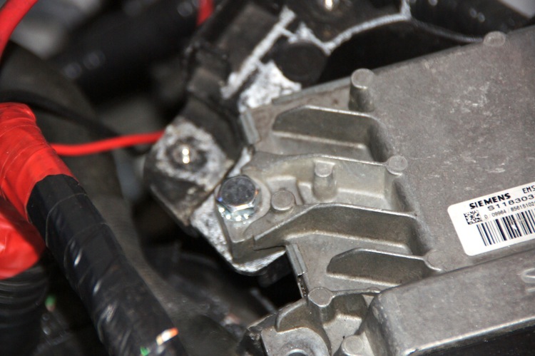

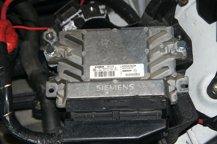

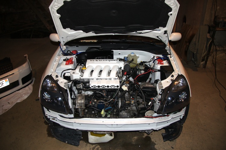

Fixing The Engine Management System :
And we admire the work:

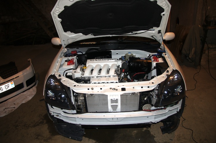

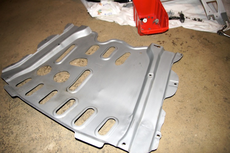

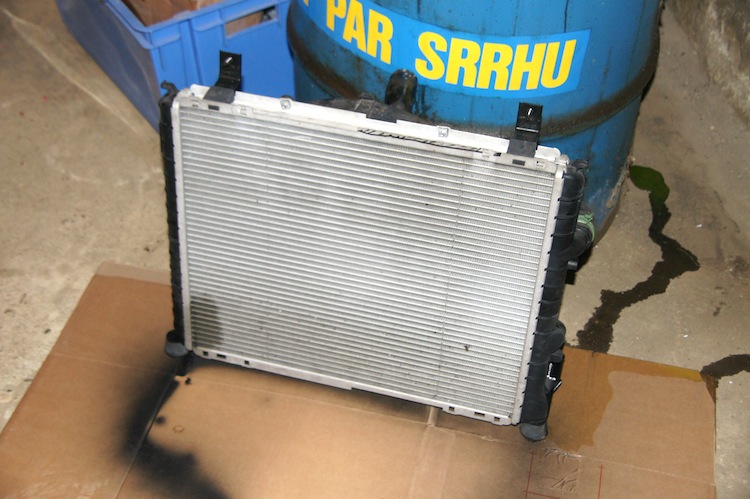

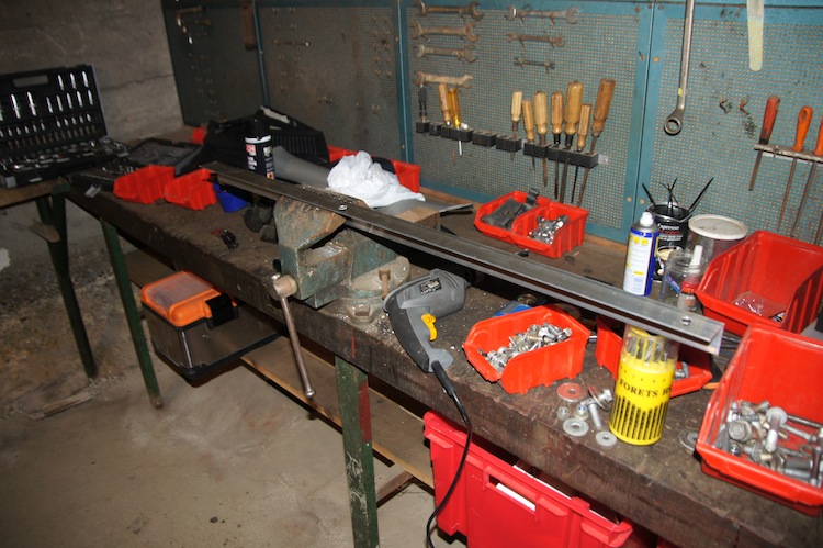

And if not, will also be of sheet metal cutting and removal of radiator tomorrow ...
Stay tuned ... :approve:

never seen a battery placed there before, looks amazing, ive read the whole thread and its awesome work. well done :)

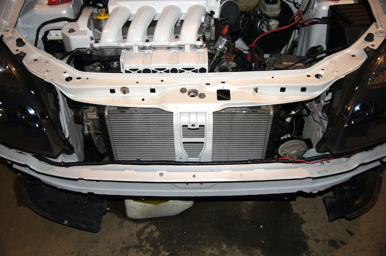

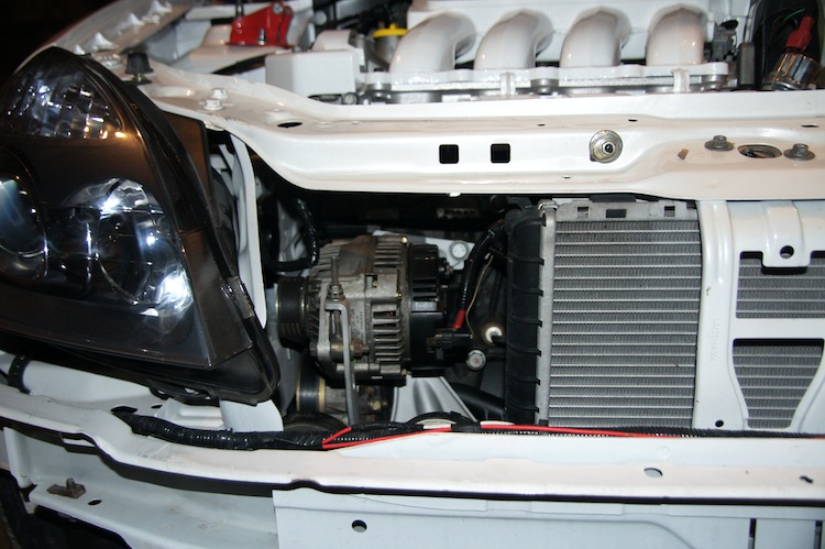

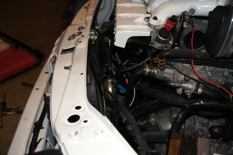

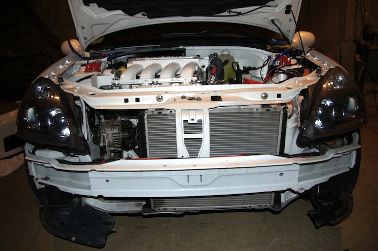

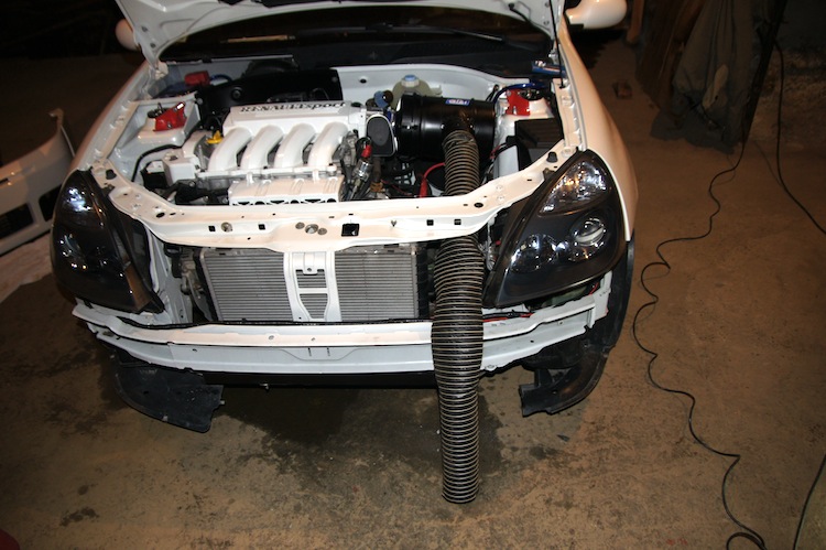

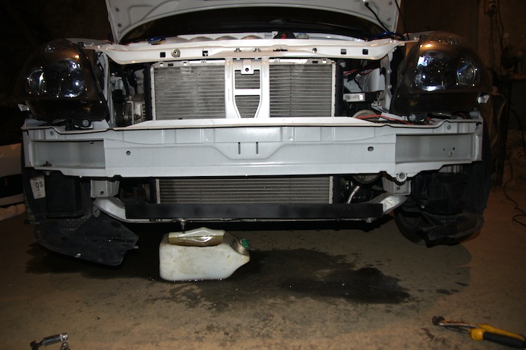

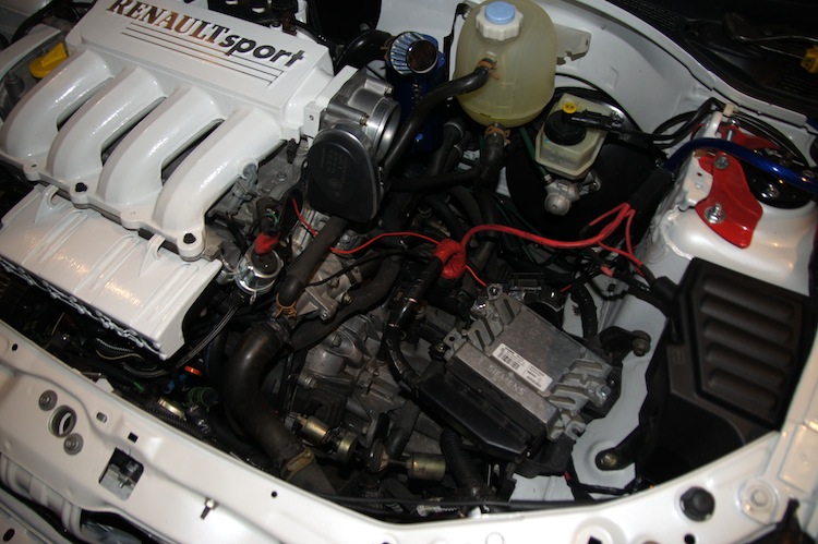

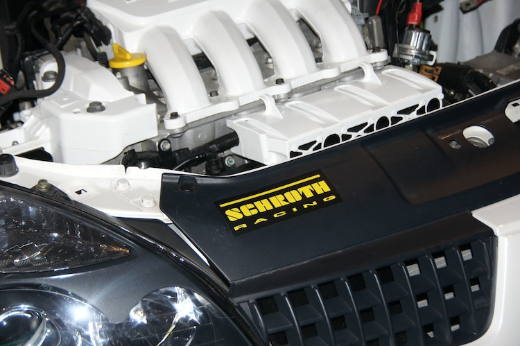

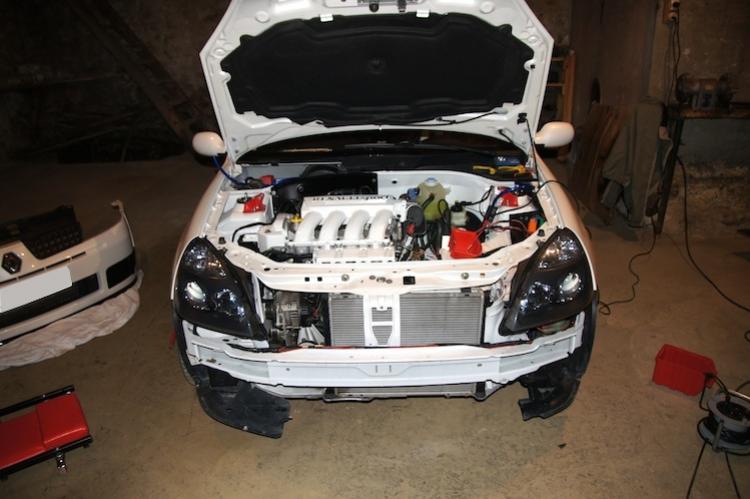

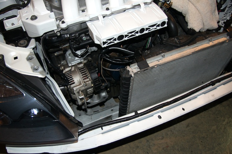

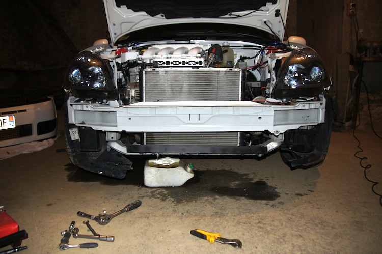

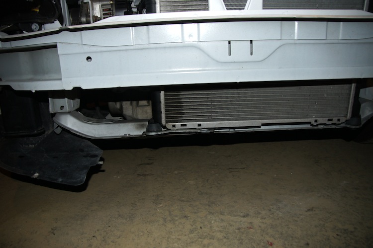

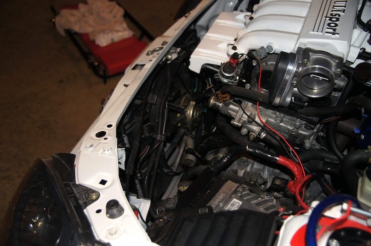

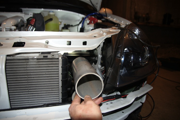

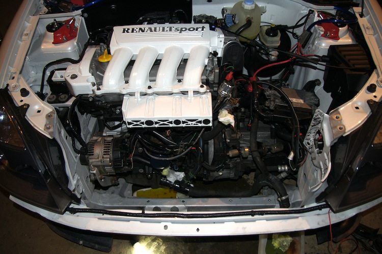

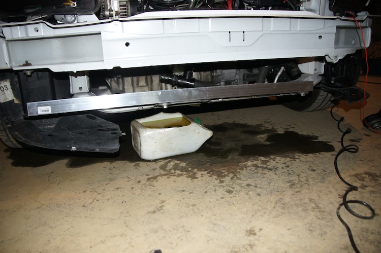

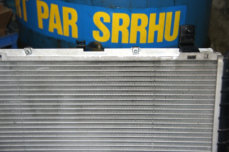

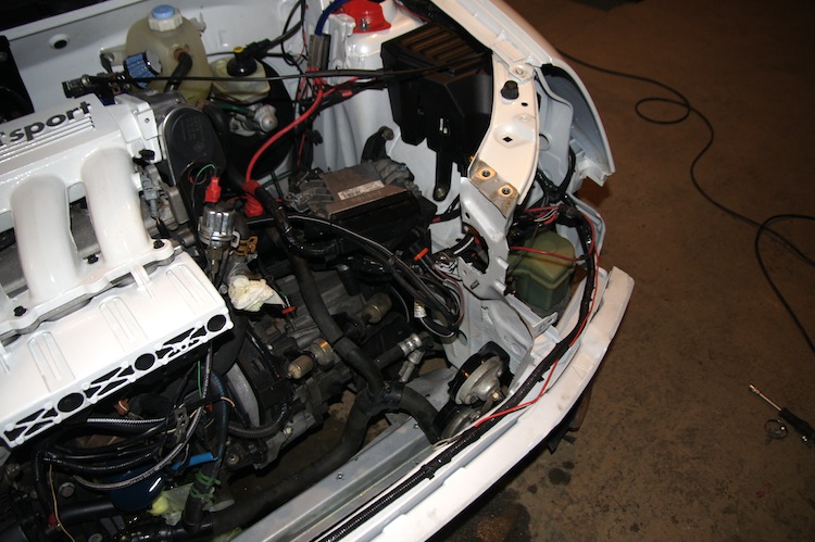

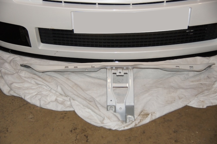

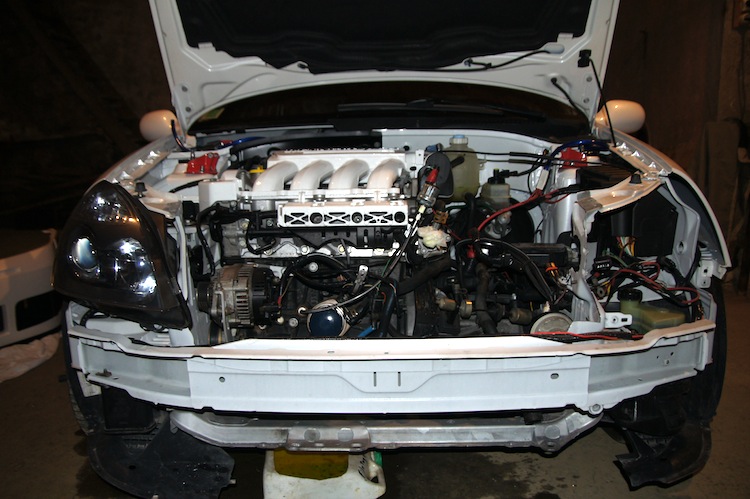

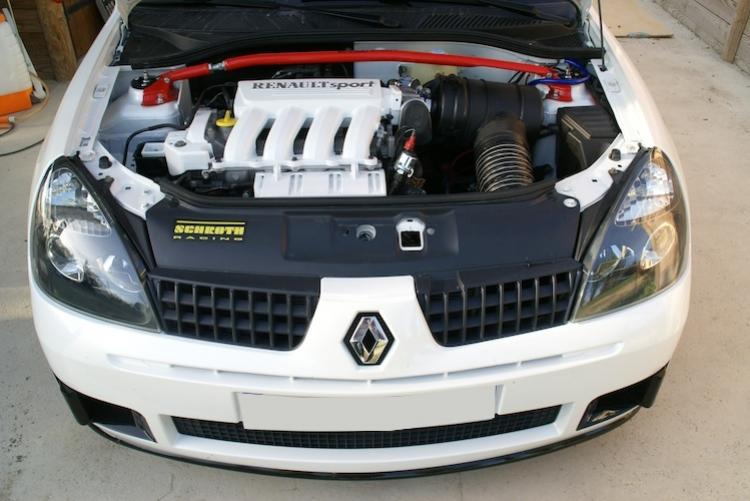

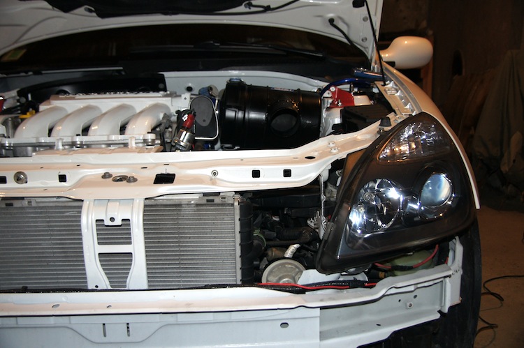

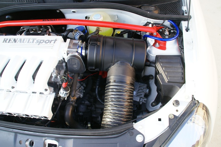

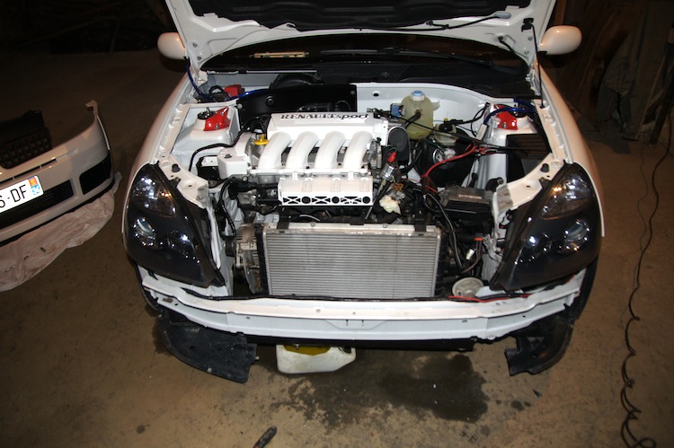

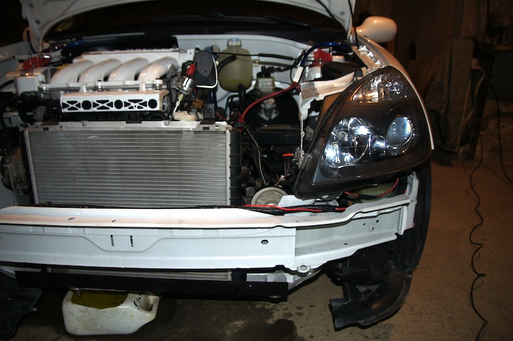

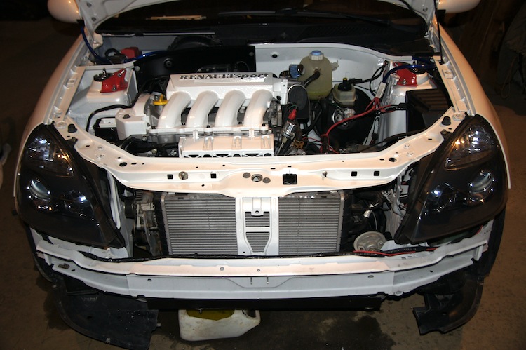

For some time I'm working on a new admission for my Clio 182: I am looking for something direct, without loss.

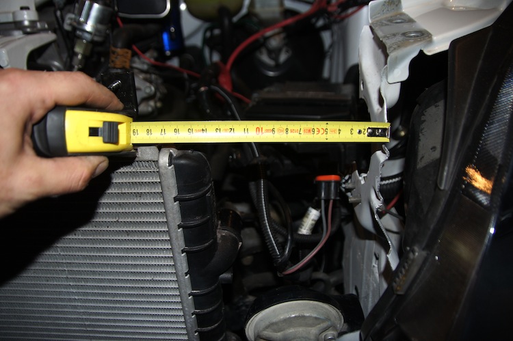

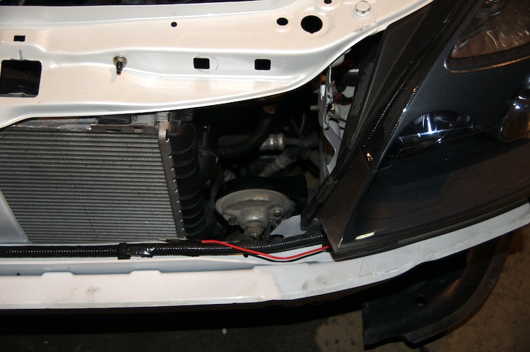

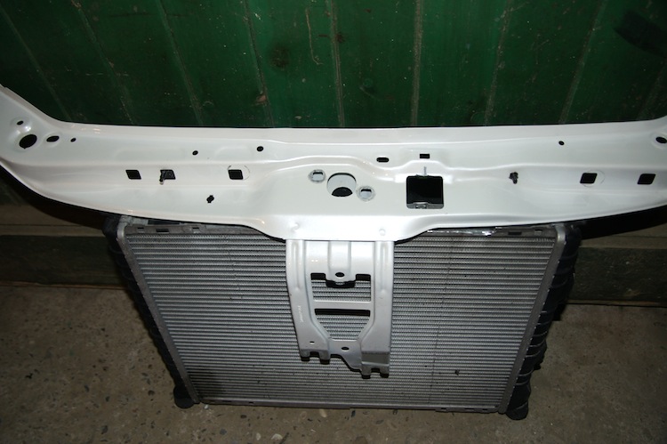

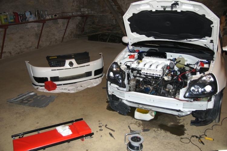

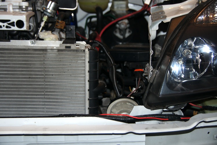

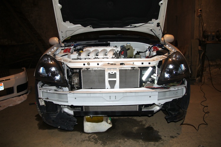

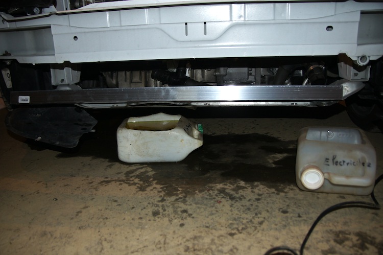

So I thought to move my radiator with my setup Cup.

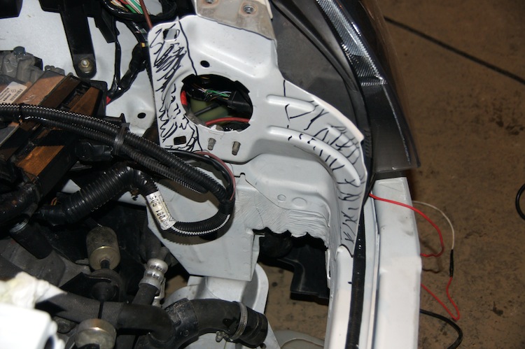

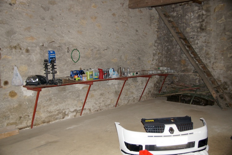

Here are pictures of the clip 182 before the change, note that there is almost no room to see anything and he'll have to move the horn ...
This is where he will have to work ...
And all available space on this side ...

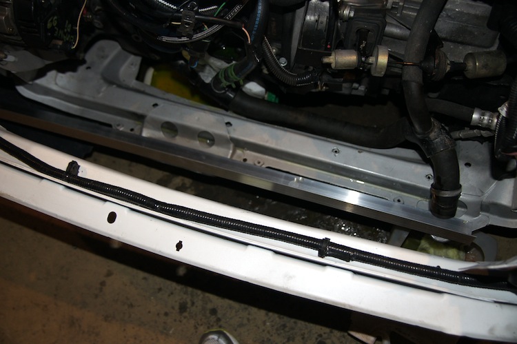

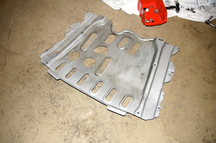

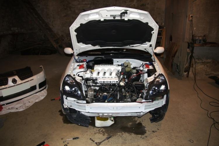

Photos of commencement :
Photos of work in order :

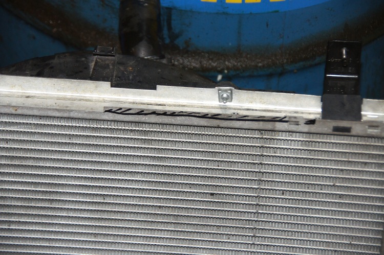

Before :
After :
Photos bonus :

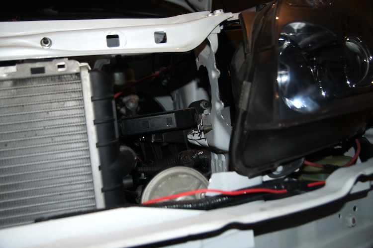

Displacement of the horn :
Before...
After...

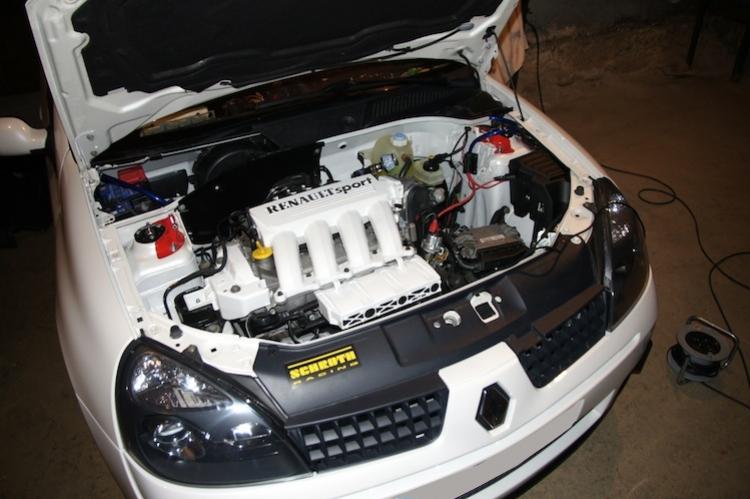

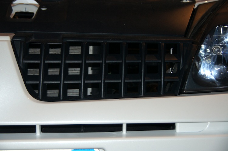

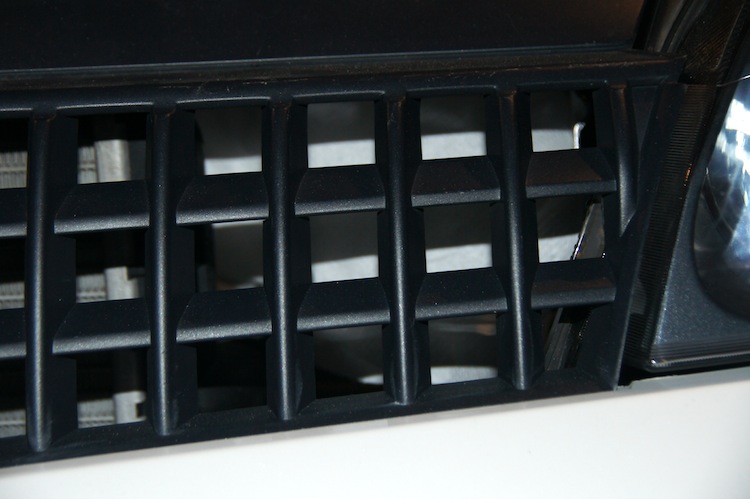

With the lighthouse, you realize the gain won :

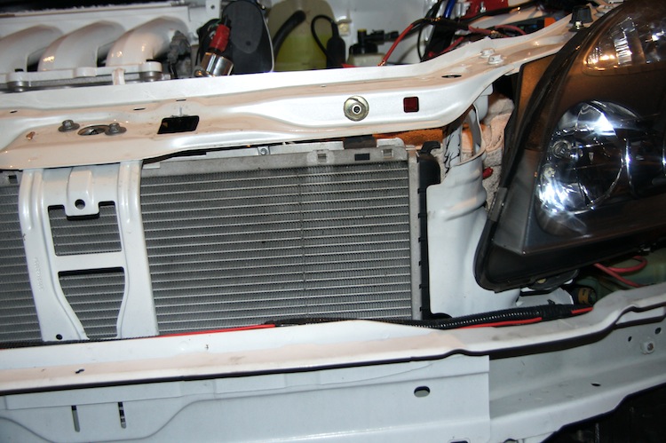

The end :
And the air space won ... simply magical and nickel intake air therefore :
Reassembly :
The horn goes by without worry :

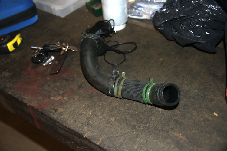

It amends the upper radiator hose :

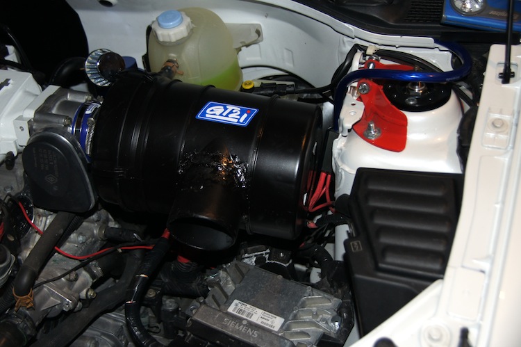

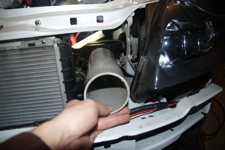

Test with a small PVC tube 80mm .... which seems ridiculous !!!!
Test with a box of admission R21 Turbo :
Reassembly of the front bumper :
Always this pathetic PVC pipe ... you describe the space saved ...
For summary :
Before :
After...

A unique project because I am the first to implement such changes on a Clio 182.
Hoping you like it ... :D

No problem, I still plan to optimize my case for admission of R21 Turbo with a larger supply of fresh air ... and other tips and more! :cool:

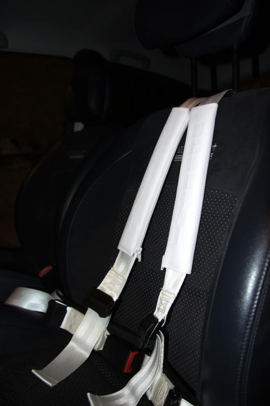

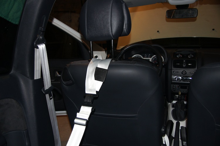

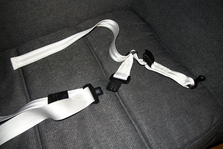

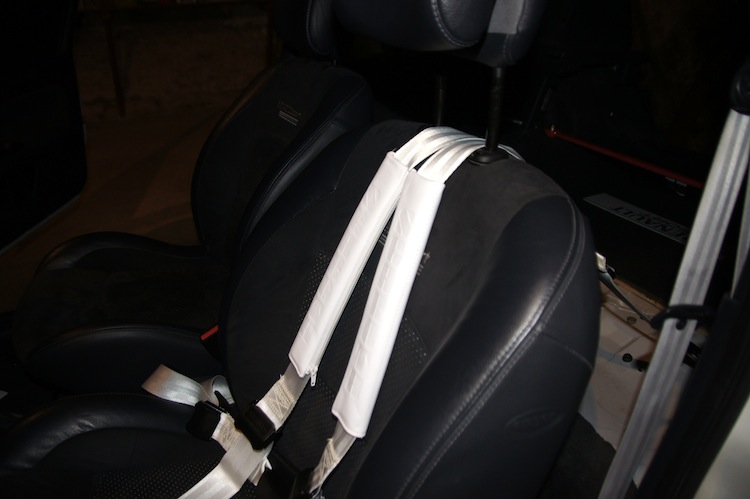

One thing though. Not sure if it's been mentioned already but that harness setup is lethal. Any decent impact and they will cut your head off. I'm not joking.
  Clio 182 White CUP
Construit avec amour
Brilliant work and ideas you've used :)
Built with love yes...:eek:
Nice work, sure if I tried that I would forget where all the parts go and end up with a pile of parts lol
the best project, with the best result looks superb well done
Amazing thread. Fantastic looking car.
Thank you,
Indeed, it is dangerous: the harness on the sides go now! :S
Fair play for sorting the harnesses out. They would really have done you some serious harm as they were.
You NEED a set of R27 Recaros in that car. It would finish it off, and make it way more hardcore. Plus they are much better suited to fitting harnesses. DO IT!1 :D

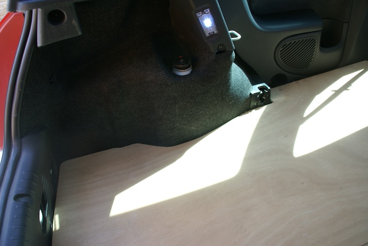

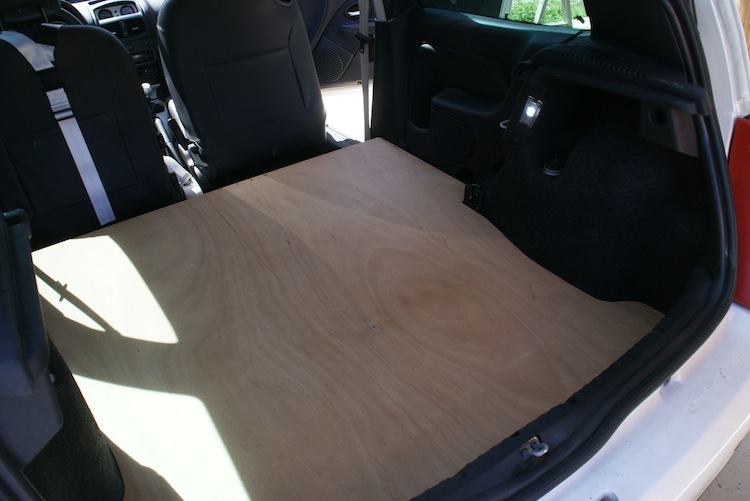

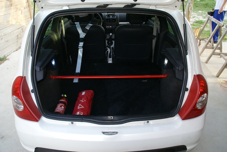

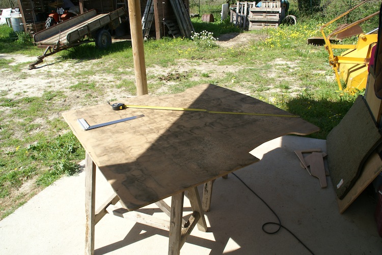

News :

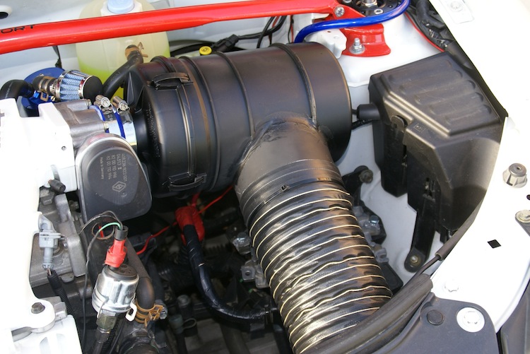

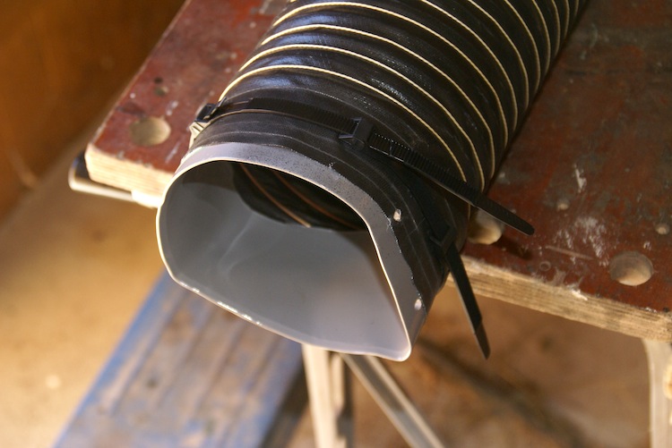

Admission of new R21 with an input of 125 mm to 100 mm in diameter for an admission of R21 Turbo:

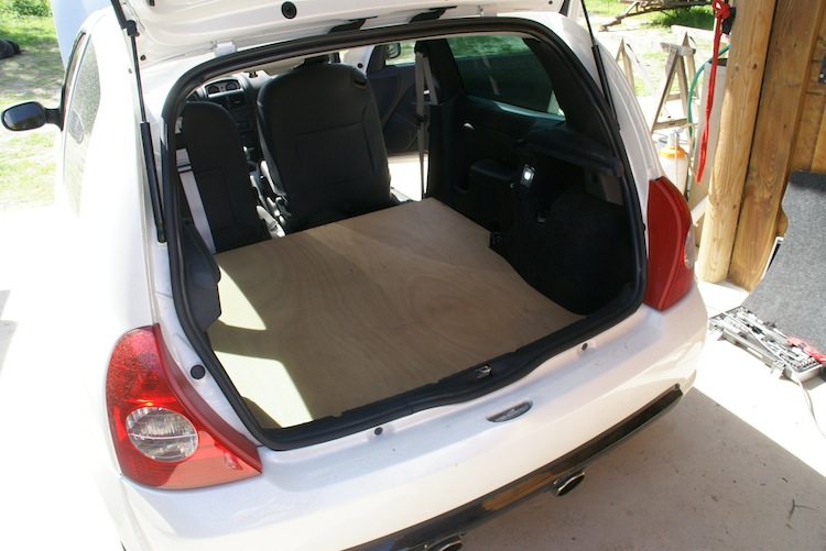

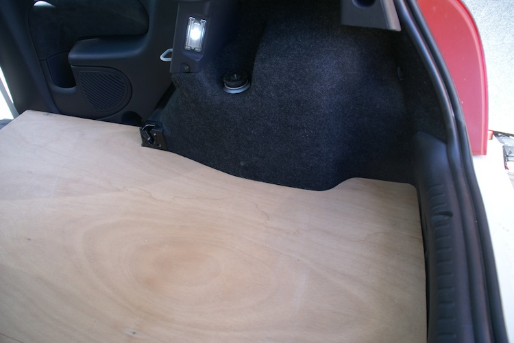

Et manufacture of a flat floor covered with dark gray Alcantara :
