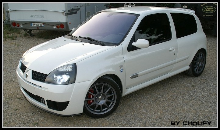

My French Clio 182 "White Pearl"....

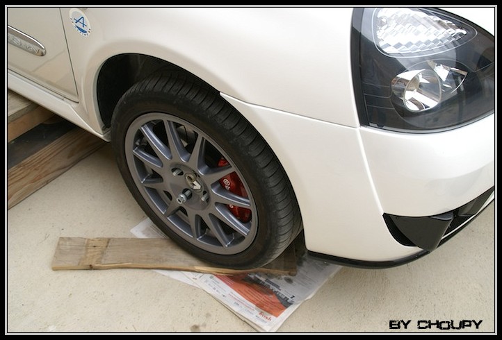

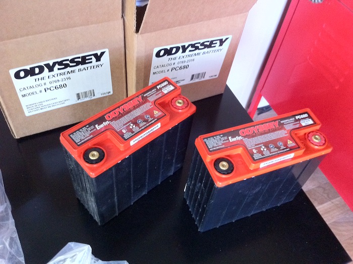

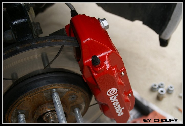

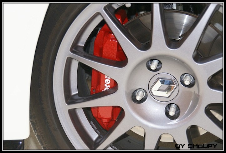

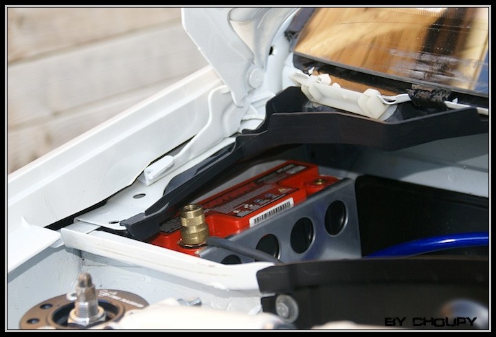

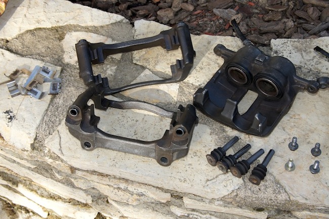

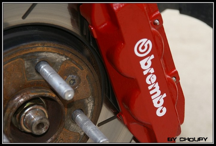

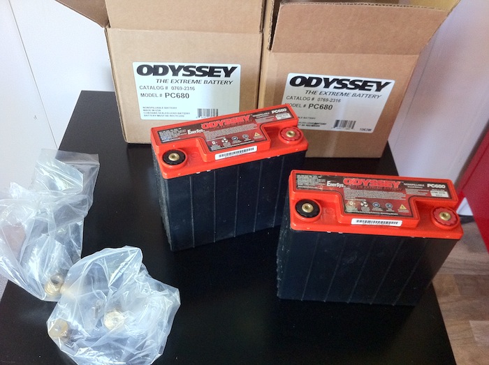

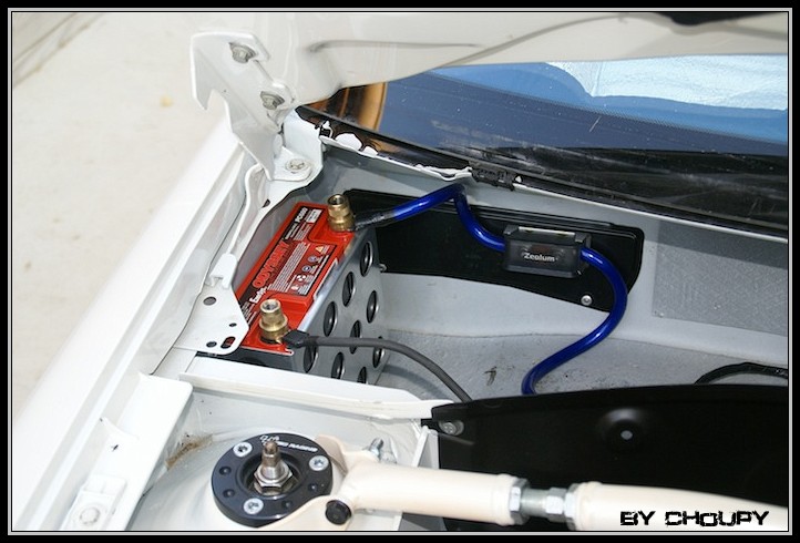

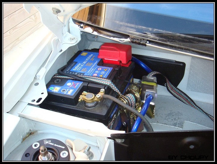

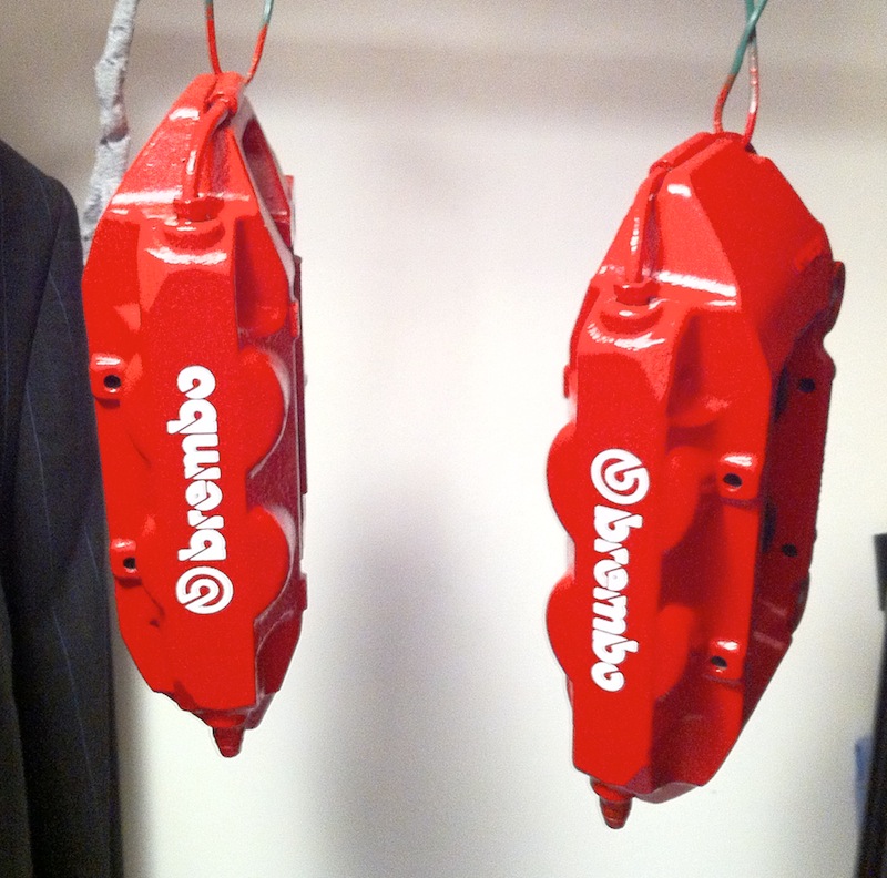

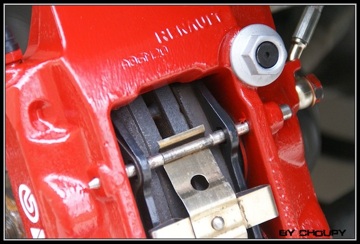

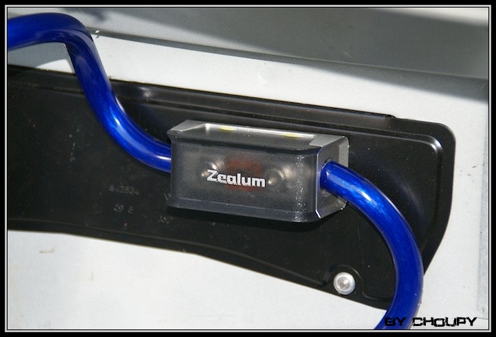

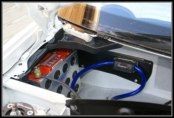

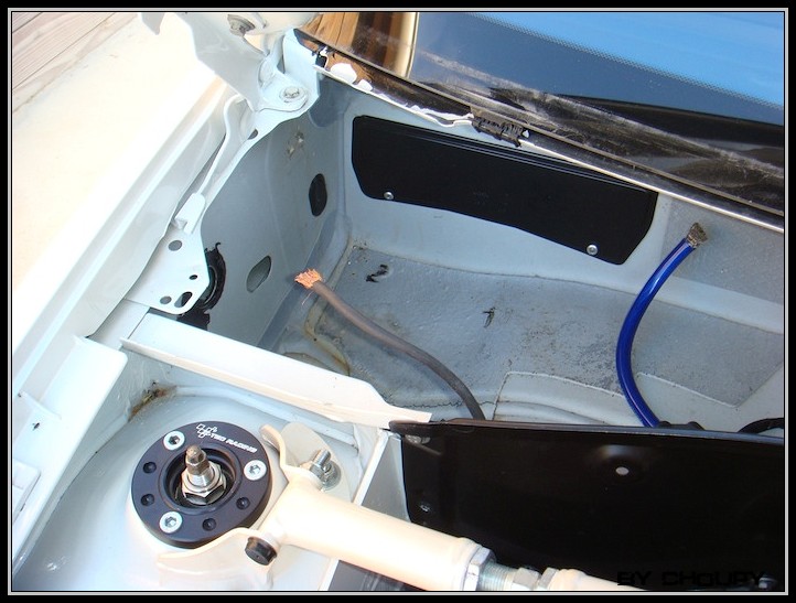

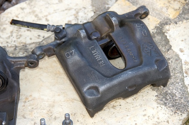

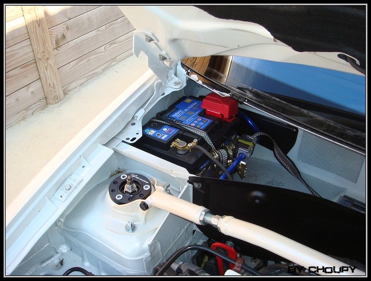

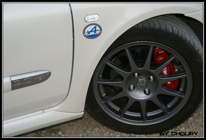

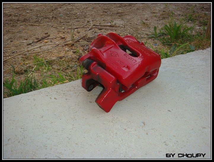

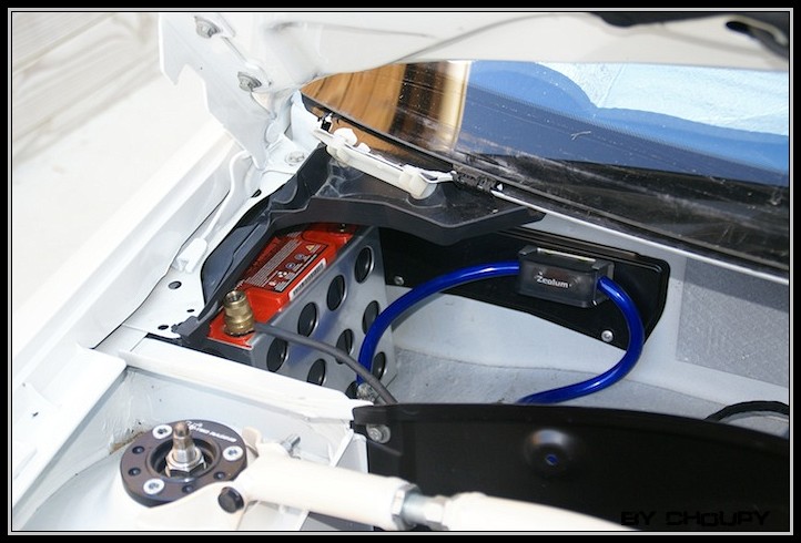

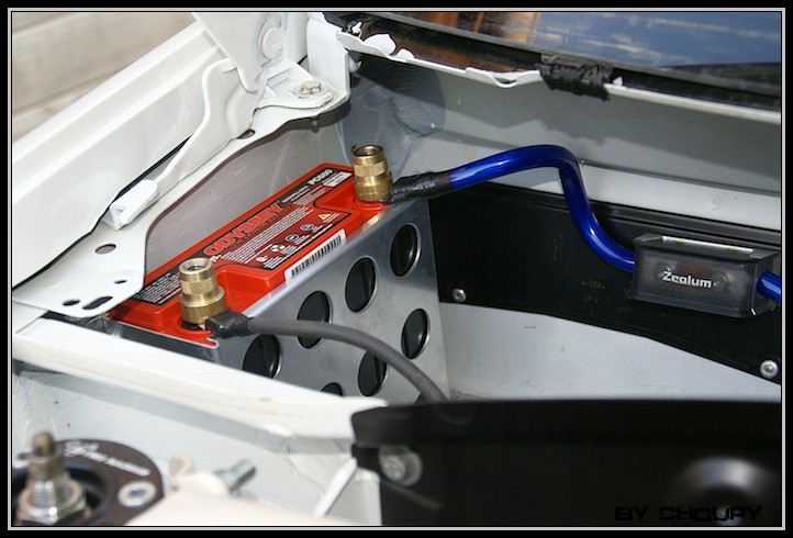

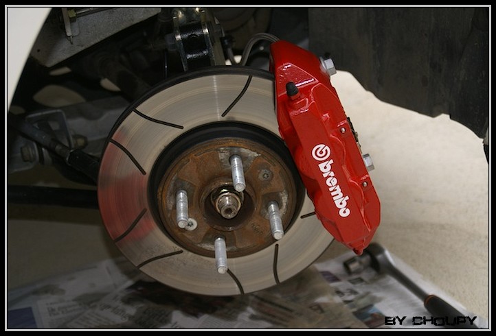

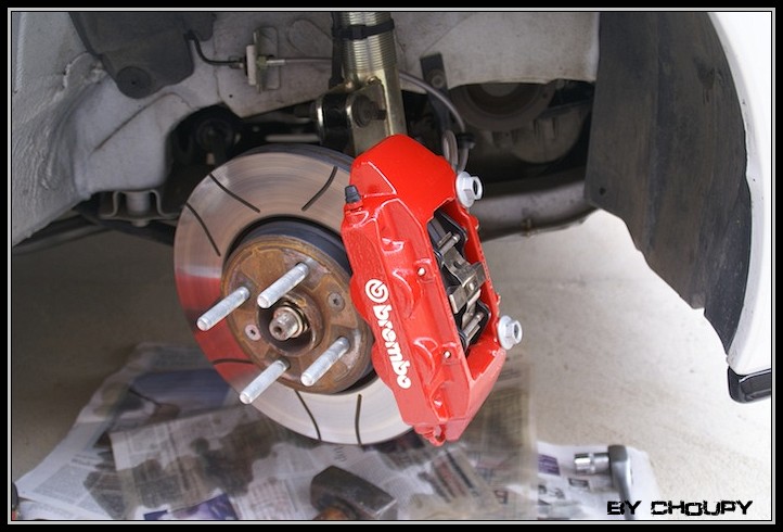

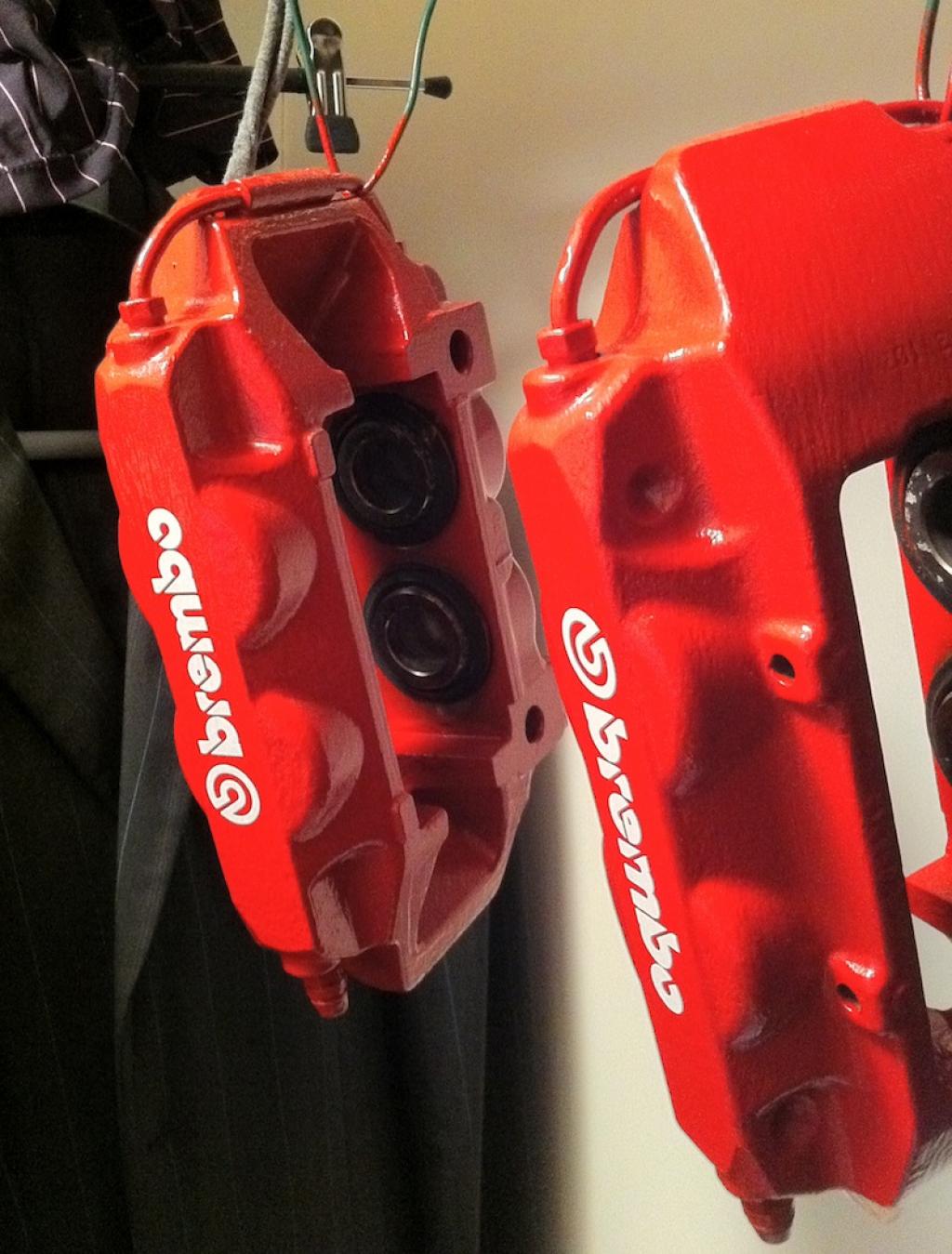

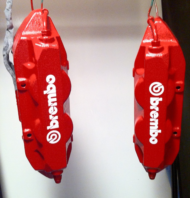

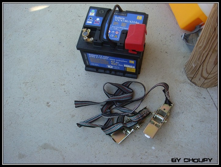

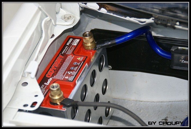

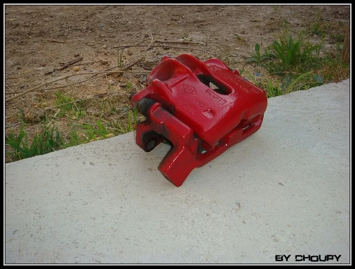

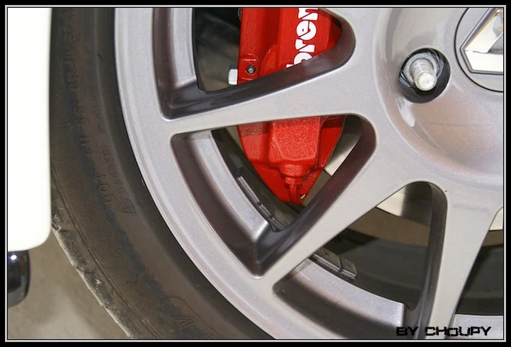

2 batteries? Brembo's came up really well, where'd you pick up the calipers and brackets?

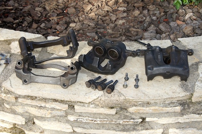

There is a battery to a friend!

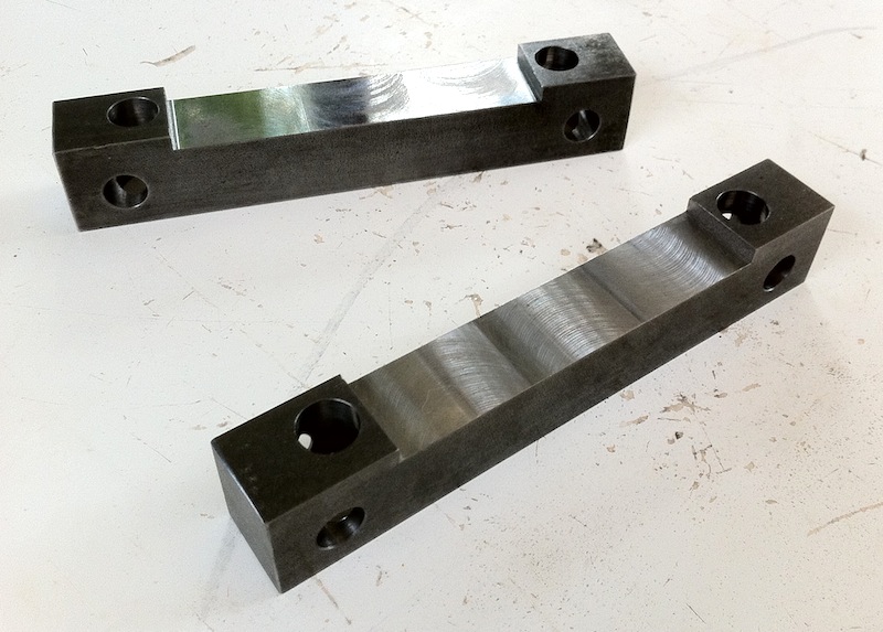

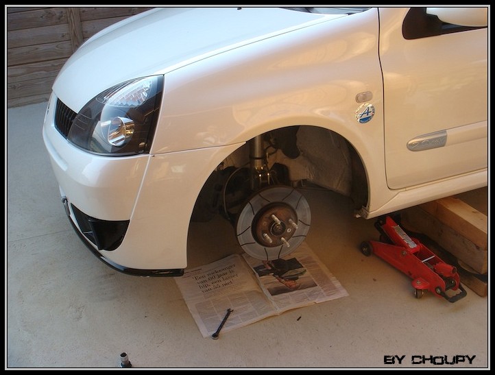

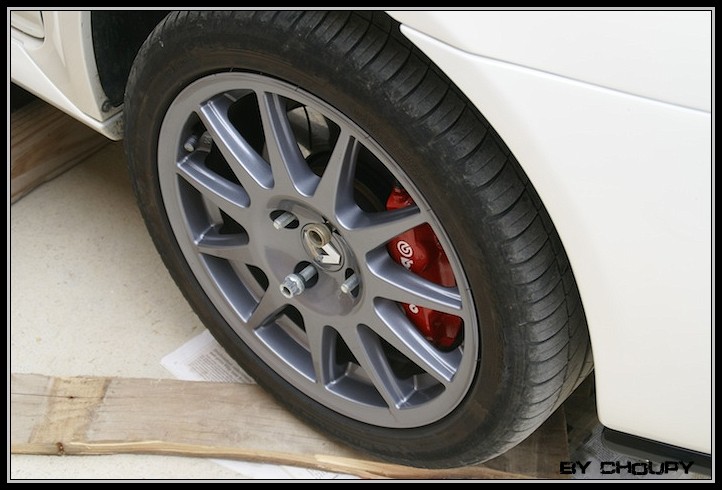

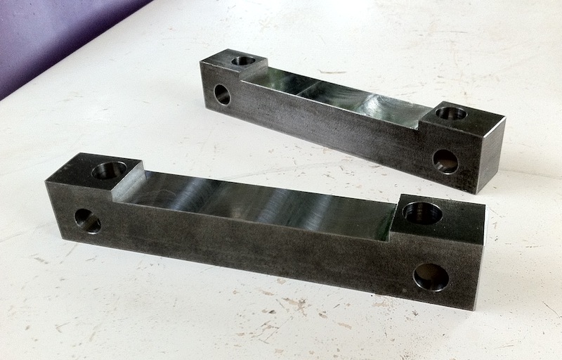

Concerning brake calipers, they come from a CLIO 197: they were machined from 5mm at their feet to be able to mount with 280mm brake discs. Just like the Clio R3!!
Cleat mounting, I have to keep doing custom discs and 280mm to mount wheels 15 "for my output circuits. ;)

Looks fantastic, but is the colour matching on the door/rear or is your camera struggling to with the pearlescent?
Anyway, great project. You should be proud of that achievement!
  Clio 182 White CUP
Thank you, there are unfortunately a lack of color (due to lack of budget as I am still a student ...).
I will do a complete painting before long promised.

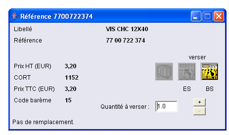

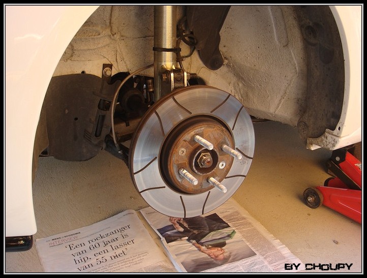

Why have you used studs rather than bolts?
I do not understand your question ...
Which mount?

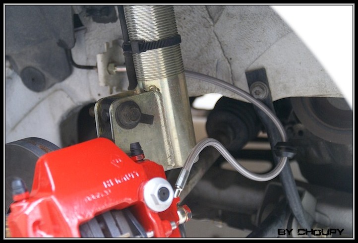

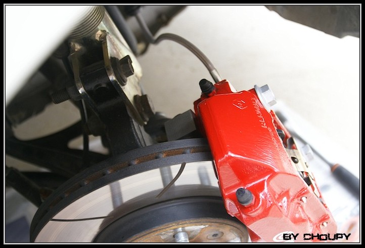

Future changes:
- Dual-piston caliper,
- Front brake disc 300mm (280mm original)
- Disc Brake with 240mm rear big bearing integrated
All with 100% Renault parts. The choice of disk size and diameter of the rear piston is made ​​according to the new front brakes ... while keeping the ratio of front / rear braking!

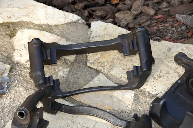

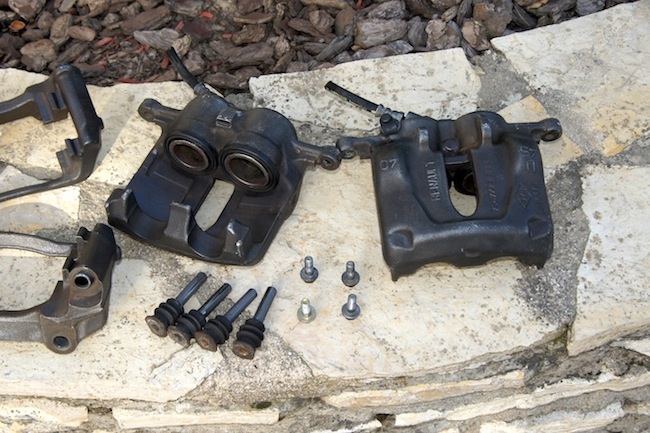

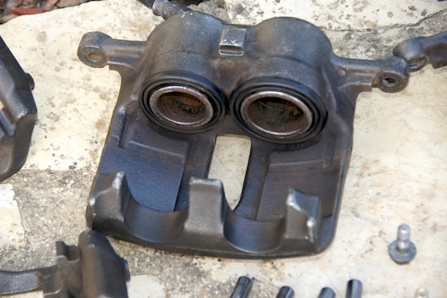

what are these brake parts off, and do you have part numbers?

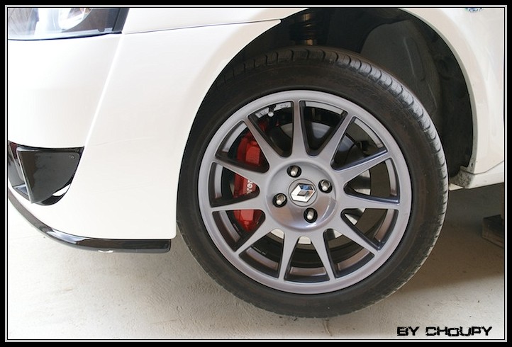

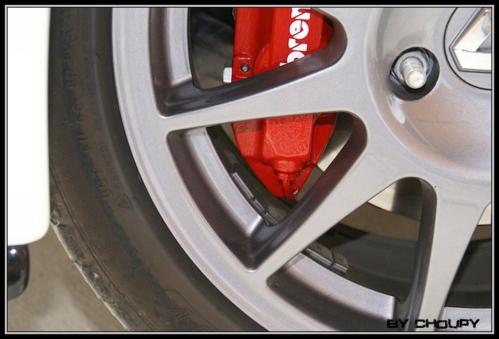

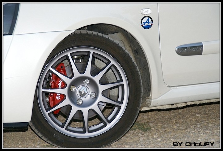

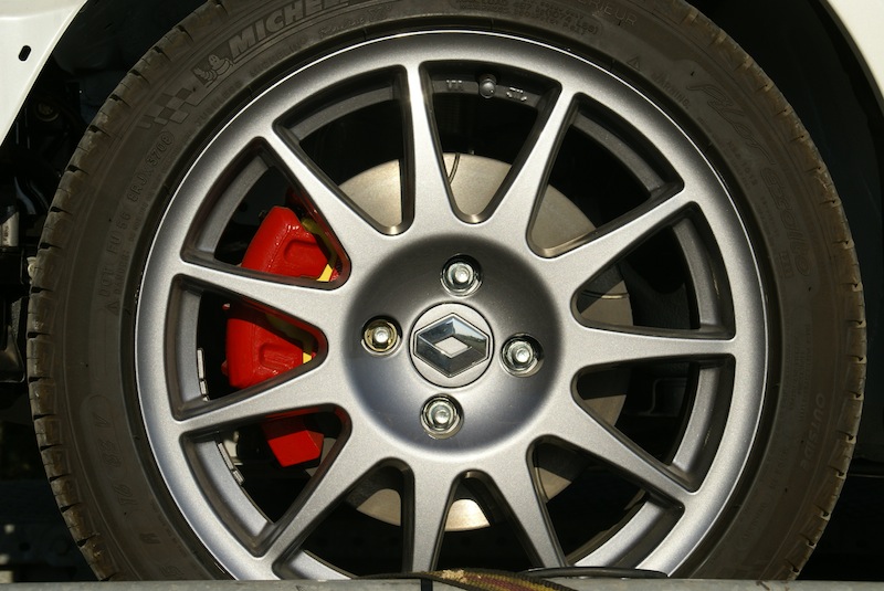

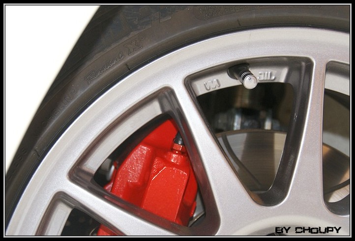

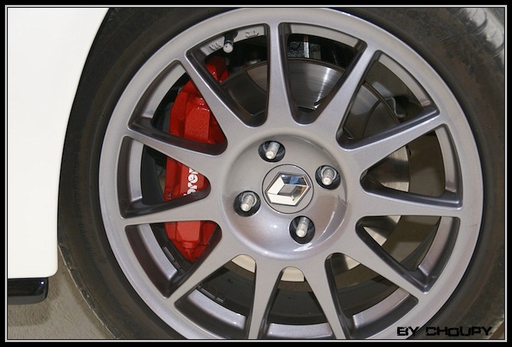

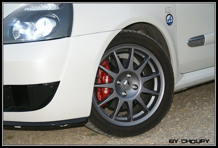

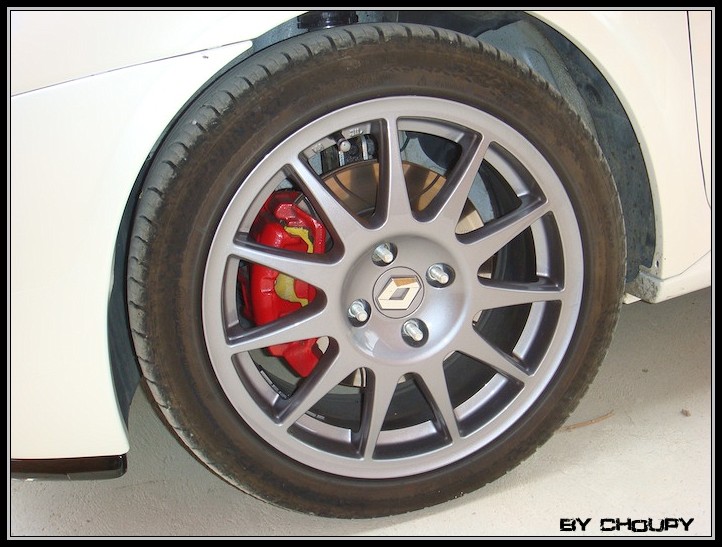

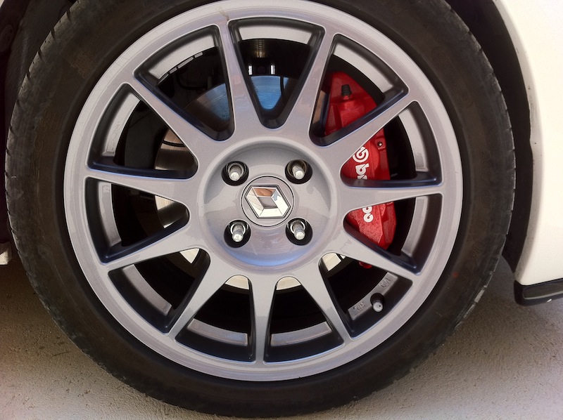

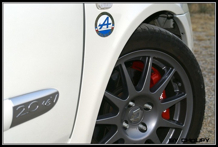

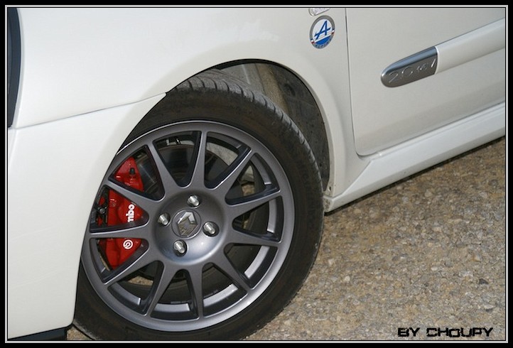

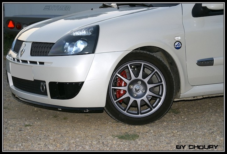

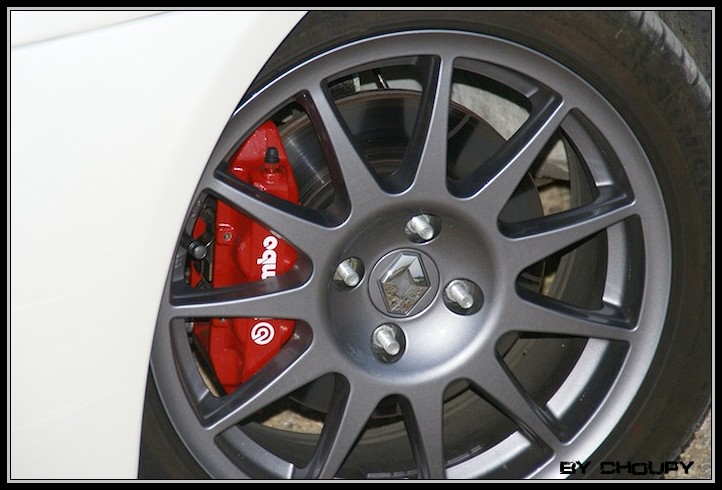

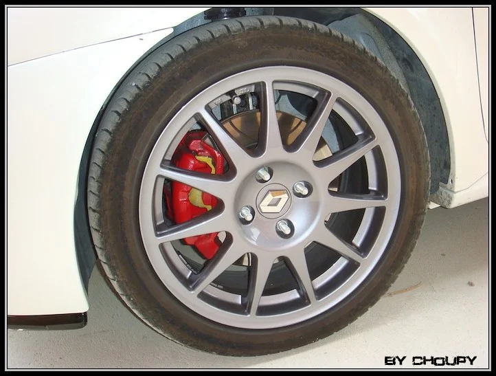

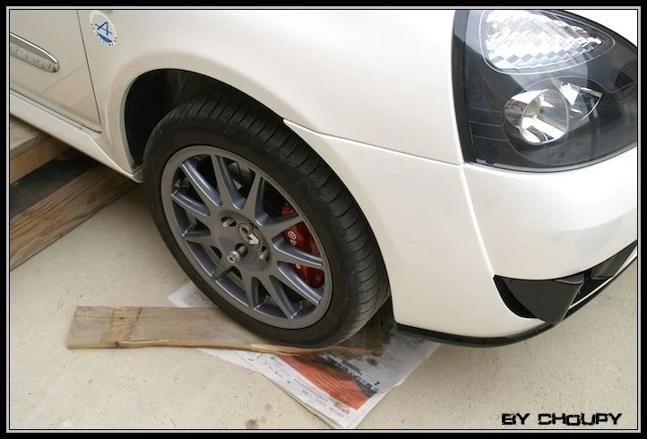

Are you running spacers on the hubs so the wheels will clear the brembo calipers?
What 15" wheels are you using that fit over the front brakes?
Awesome car :)
I have no wheel chock: for this assembly, you need wheels with "ET" (offset) up to 37.
The rims I have are SPEEDLINE Clio GrN (identical to Turini) with an offset less which allows me to do the installation without putting shims and without changing my rims.
With this arrangement, it is easy to mount wheels 15 "ET35 with a maximum and no inside edge.
Those calipers are Renault Espace III 2.2 Dt ;)
