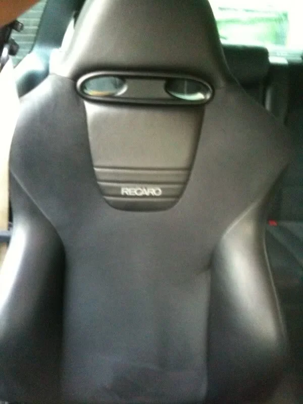

so then on clio sport i started learning so picked up some recaro's, got a 3/4 plate and was fairly happy but then had to sell it due to getting a house of my own.

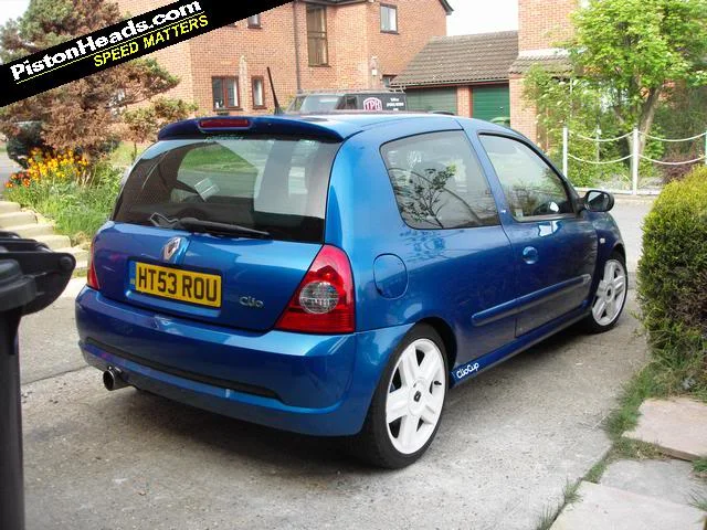

pics of 182

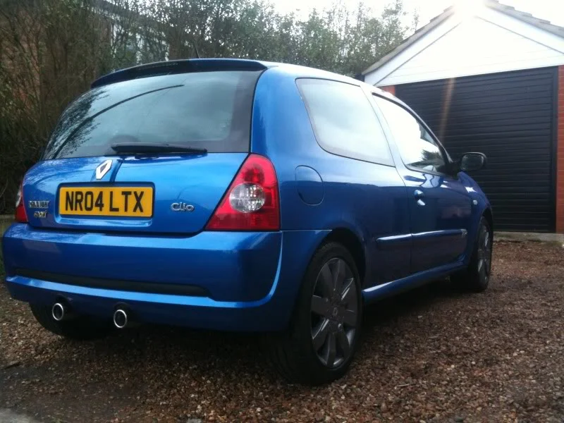

so now been in my house over a year and saved a bit of money, i don't need a car for work as i have a van, and the Mrs has a car too, so this is just purely going to be a Toy for track days/fast road driving, so i knew it had to be a ph1 172 or a 172 cup.

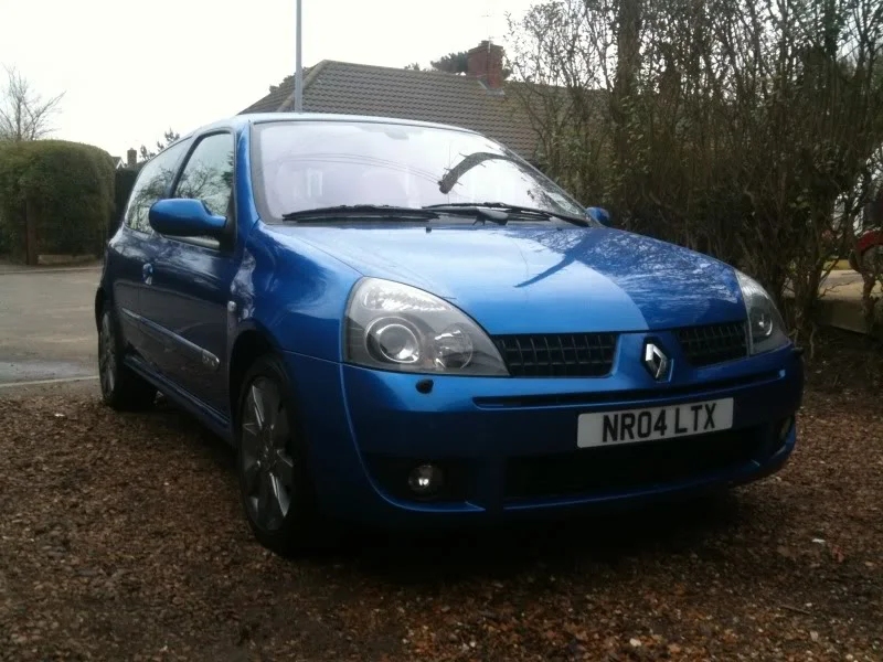

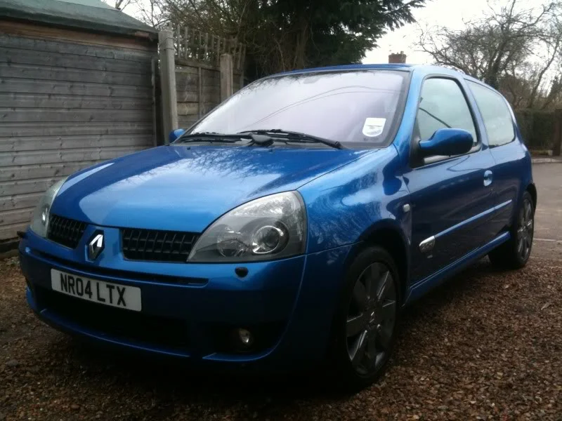

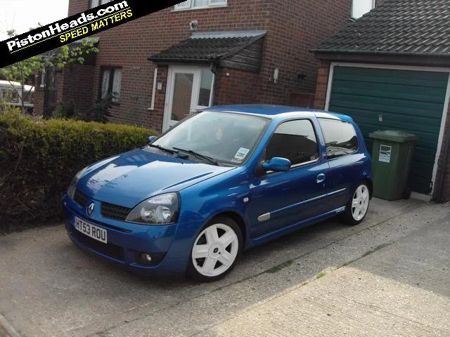

so after looking around at some bad examples i found this which seemed ideal, and it was local :)
the splitter :nono:
i saw past the ugly wheels and bodged splitter to the good bits:
-JMS cambelt recently
-JMS remap
-4x new toyo t1r's
-New ferado disks and pads in every corner
-piper cat back exhaust
-apex -30mm springs

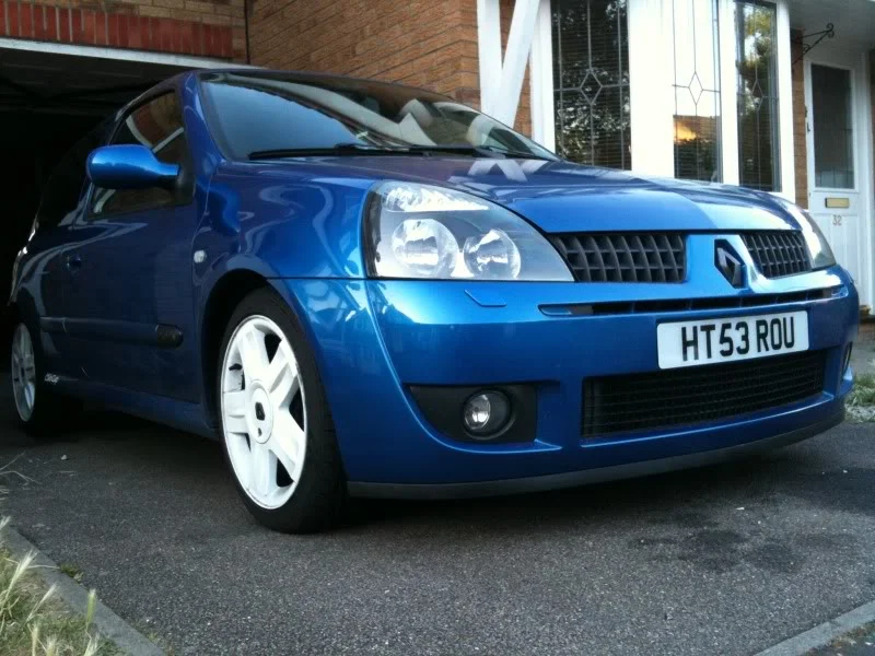

so after getting it, with the peanuts i had left i started getting it back looking good. first job was 3/4 plate and skoda splitter.

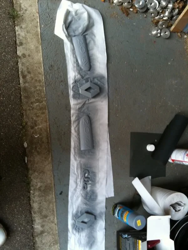

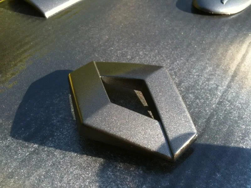

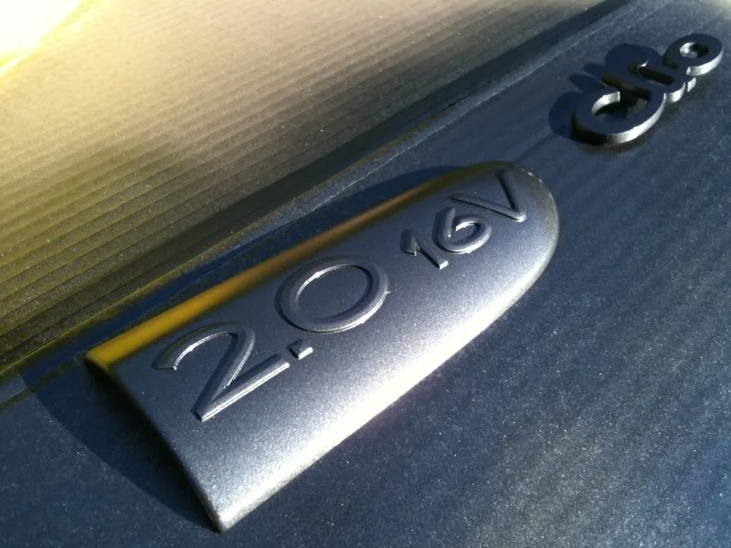

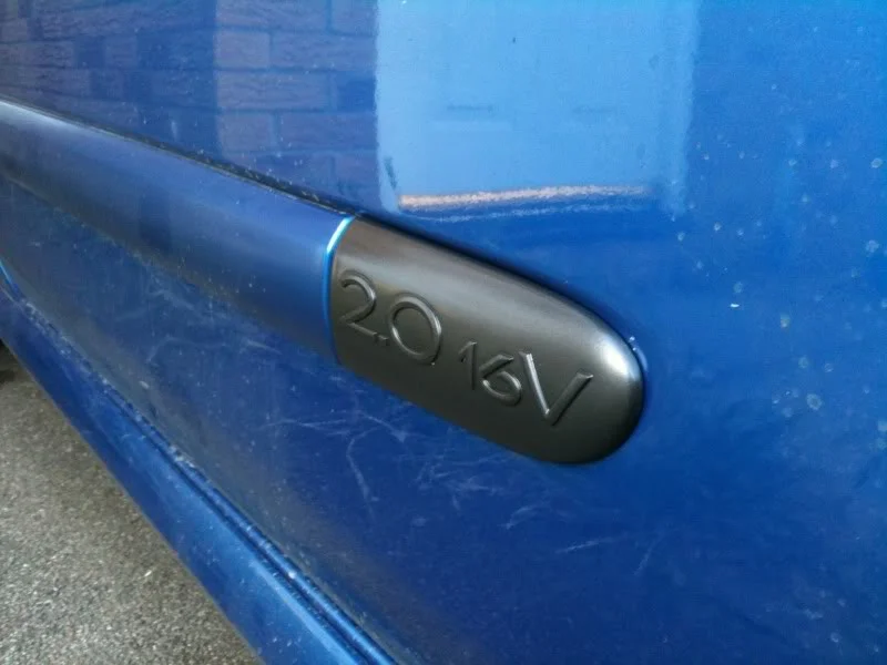

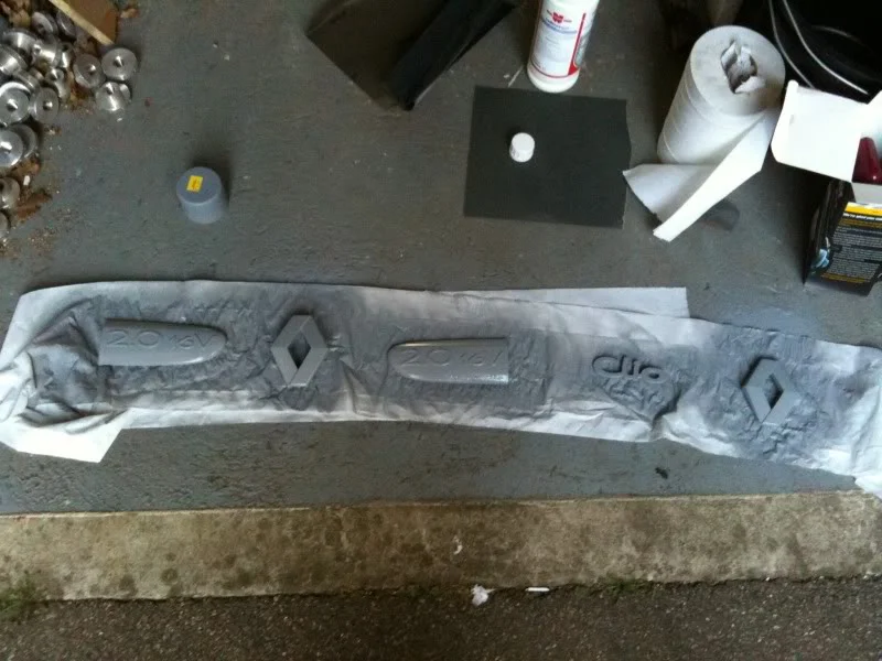

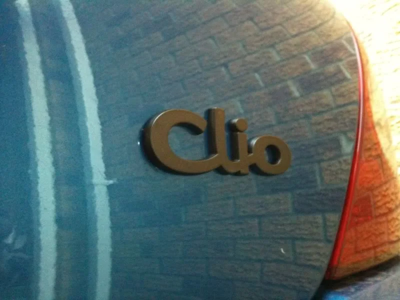

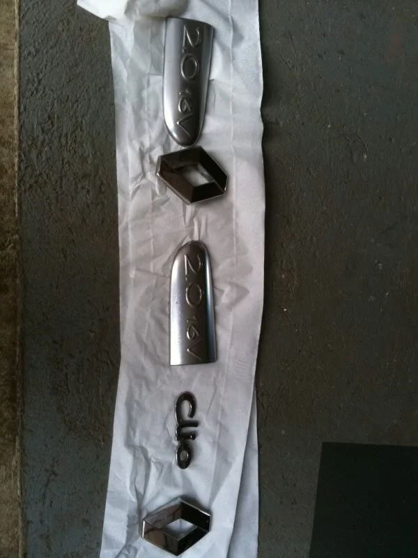

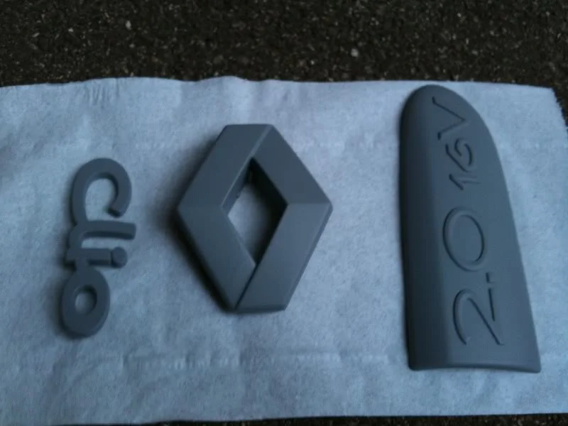

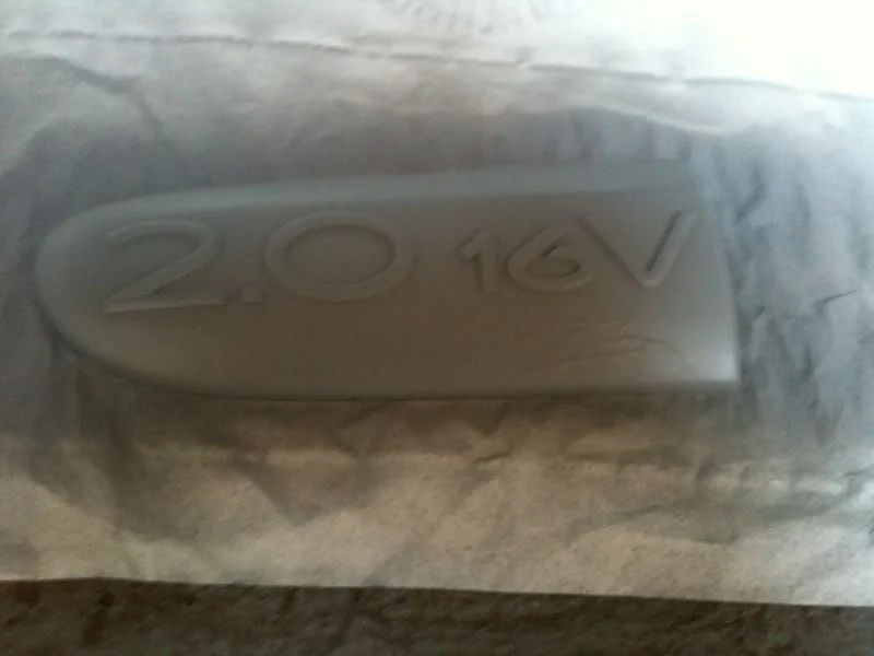

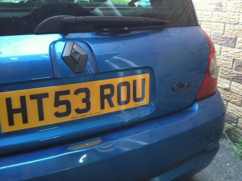

so one weekend i got bored, and decided to take a rattle can to the badges and bullets, came out really well, took alot of prep work as old ones had bubbled up badly. please ignore how dirty the car is :eek:

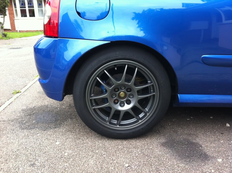

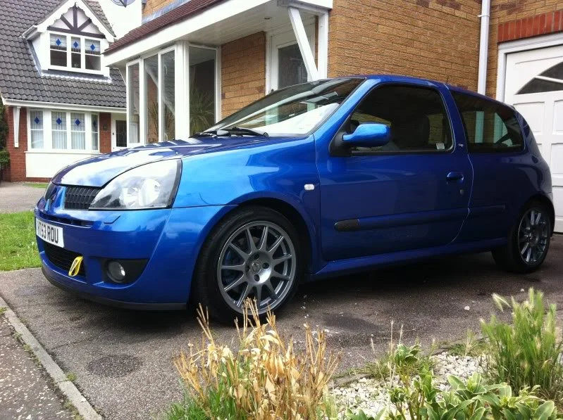

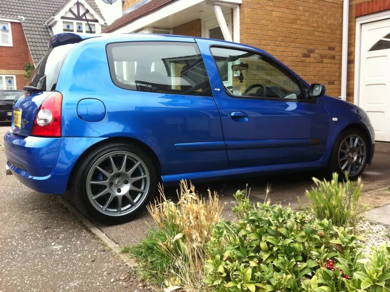

so in the mean time i picked up a rough looking set of turini's so while they were being refurbed i had it RR at APT in lenwade to see what the power was to start with. the results were poor to be honest, as it was recently seviced with a JMS remap it made 158bhp. but i later found out from a few people that APT give a very low reading. so looked forward to getting it on another set of rollers.

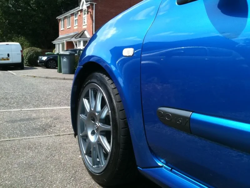

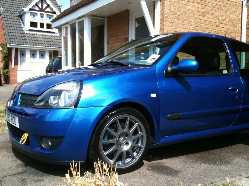

i then got my turini's back, had the t1r's put on off my ph2 rims and the car was looking right, i also added a TRS tow strap, not to sure on it now if i'm honest, would prefer a Si Tow eye.

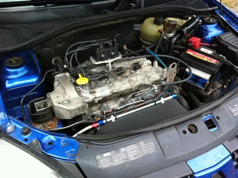

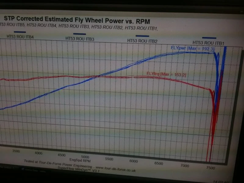

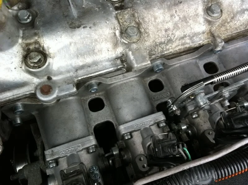

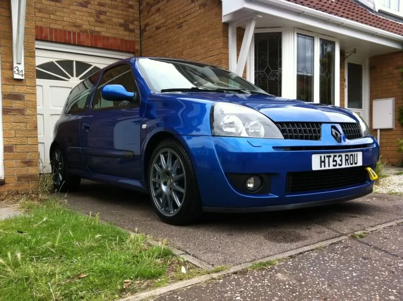

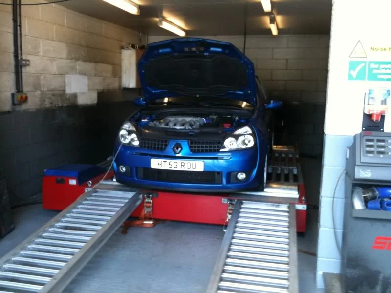

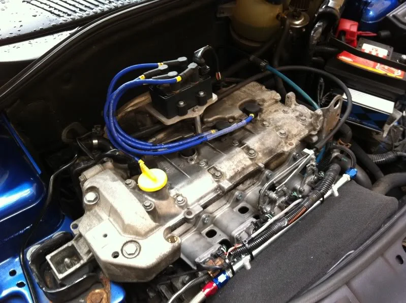

i then managed to get hold of a set of Jenveys & Omex 600 second hand so i decided to to have them fitted at TDF dropped the car off 2 weeks ago.
Matt had a few problems with the kit, trumpets were wrong diameter, fuel rail wouldn't fit, air filter was sh*gged, and loom was a bodge job to say the least so this held matt up by a week in getting my car done waiting for parts.

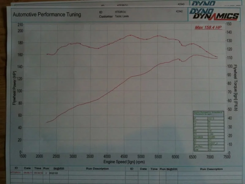

but i got it back today, made 168bhp standard and 192.3 yesterday :)

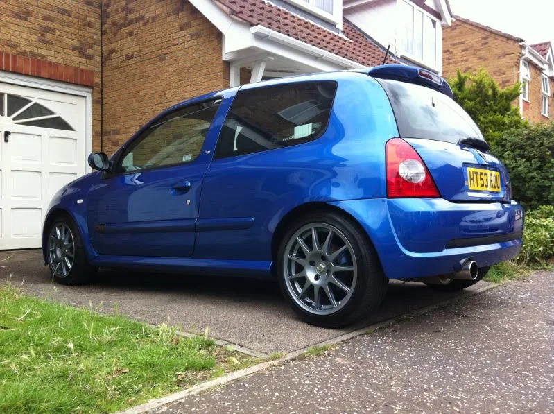

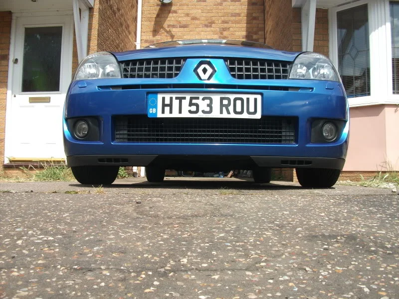

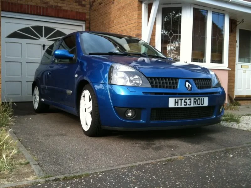

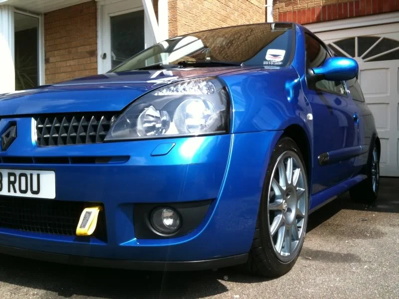

and here are the pictures of how its sitting today :)
hopefully this weekend i should be removing fog lights and arch lines for brake disk cooling, and i also have a universal Powerflex exhaust mount i want to fit in my existing bracket as my rubbers have gone, but thats weather dependant.

Looking much better now, ITB's give a much nicer drive over the standard FBW.
Do you know what size trumpets your running? They must be shorter than 90mm for you to keep your organal bonnet catch.
  Trafic 140dci
thanks they are only short stubby ones, will be removing slam panel when i get a new bonnet and putting aerocatch's on then, but as i said before my bonnet is in need of replacement, so will wait for now

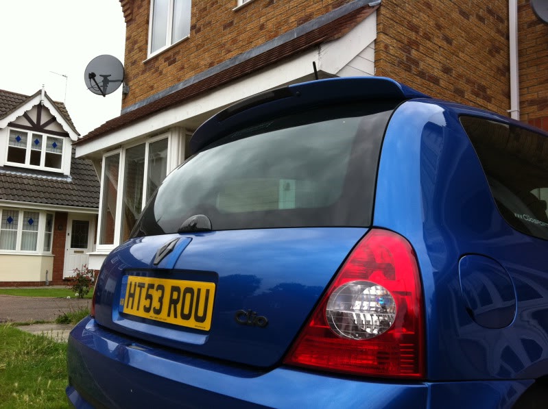

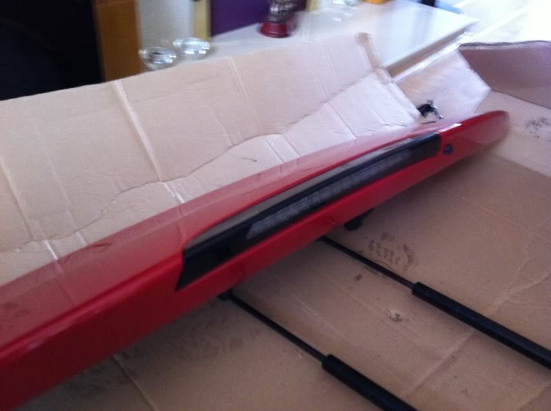

well as some of you may/ may not of seen i've picked up a trophy spoiler and it arrived today, quick little picture before it gets sent off to the Spray Shack after a very good quote :)

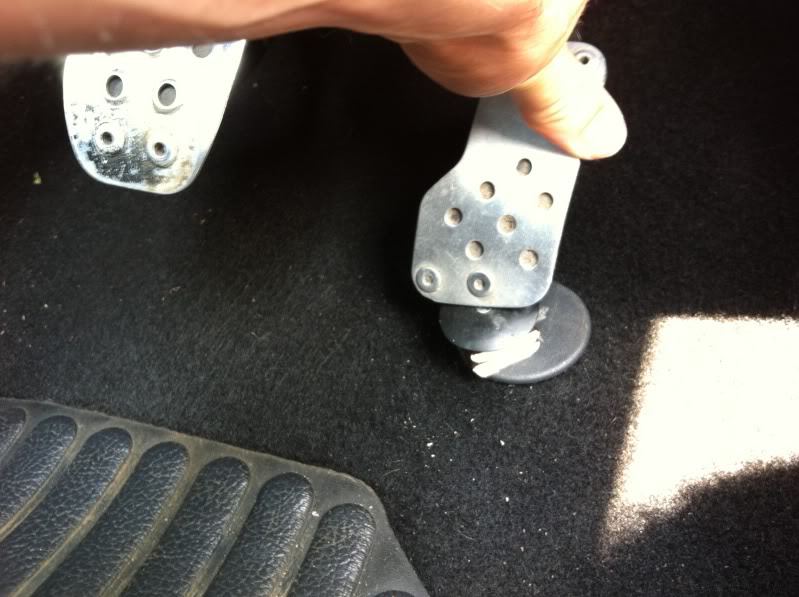

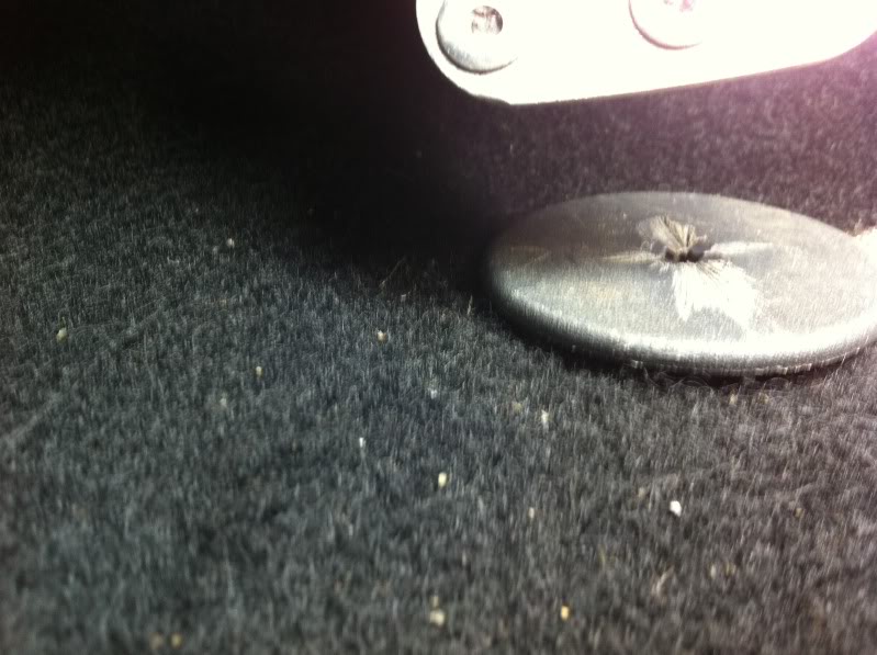

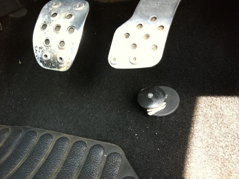

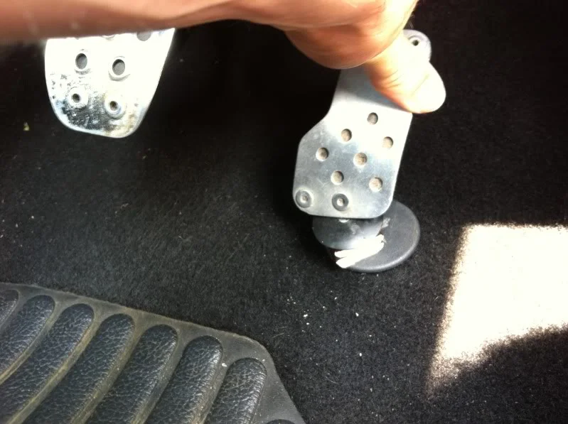

been using the Jenveys for nearly 2 weeks, and loving them, although one day i had a little bit to much lead in my right foot, and managed to pull the cable out of the solderless nipple :eek: so i came up with a little bodge to stop me pressing too hard on the throttle peddle and pulling the cable out again, just a few bits of plastic trim and a rubber grommet i had left over from removing my arch liners... will do until i can get a Jenvey throttle cable on with a soldered nipple on ITB end, now i can press the throttle peddle as hard as i like and it won't pull the cable out of the nipple.

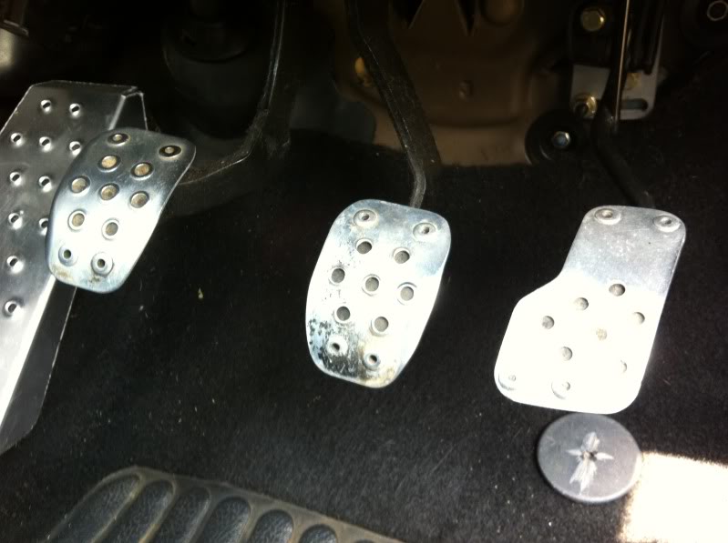

this is how i have my peddle setup and like it like this

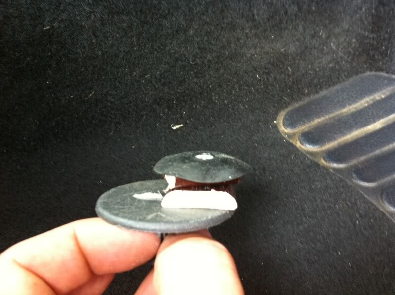

as you can see in the second photo, before i come up with my bodge, there was quite abit of space between the throttle peddle and the floor, when open at fulll throttle.
my homemade bodge, took all of 2 mins :)
fitted in place
and working
i then adjusted the throttle cable by only a few mm to make sure that the bodies where fully open when on full throttle resting on new restrictor

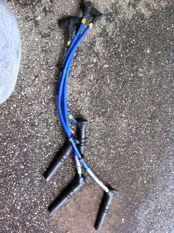

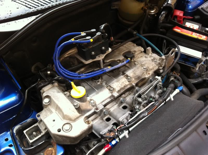

i've also bought a set of blue Magnecore HT lead off DannyR which should hopefully arrive today, will add pictures when they do.

you realise that you've basically just removed the "step" part of the accelator travel. It will go to the floor. There is a cut off point which is used for the speed limiter cancellation. Or was that your intention?
Car looks nice though mate :D Think I may have seen it while I was down at Matts.
  Trafic 140dci
i don't quite know what you mean, the way my throttle cable was set up, when it was full throttle there was a space between the restrictor on the floor and the peddle, so when i was driving a bit too hard i pressed down so hard i pulled the cable out of the nipple in the ITB's if you get me
so this is just a bodge to stop me doing it again, i have set it up so that once it hits my home made restrictor its still full throttle if you get me?
or have i done something i shouldn't of (i'm no mechanic!) lol
He won't have speed limiter/cruise control as his is a cup mate
  Trafic 140dci
oh is that what he meant? its also a custom cable throttle for the ITB's which is why it didn't go to floor in first place, it could of done, but i like the accelerator being same level as brake :)

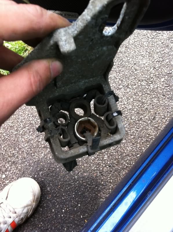

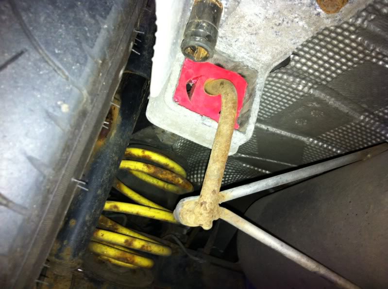

typical clio my exhaust hanger had fell apart, but one of the previous owners done a bodge on it, so didn't bother repairing it for ages but with a track day tomoro i thought i'd better sort it out
before
after, powerflex universal exhaust mount (i did take my socket out in the end lol)

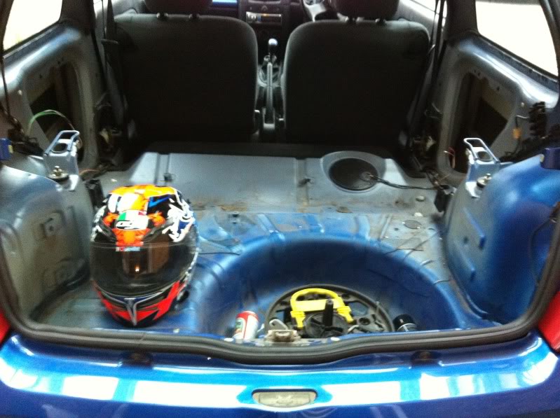

as mentioned its my first track day tomoro (first of many!) so thought i'd do whats supposed to be the best value for money mod
yes thats right stripped the car of what wasn't needed, (the whole rear to be precise) left the tool kit in, as i can use it if needs be tomoro
for anyone wondering the whole rear interior is forsale, and the oz f1's (as of when the spigots rings arrive) so pm me if your interested, saves me making an add on here

Go carefull dude, not the best idea to strip it out before your first track day - the weight distribution will have changed greatly, and it may handle different - go carefull :)
  Trafic 140dci
i here what your saying, but if i've never driven it round a track at all it doesn't really matter as i will be learning the car to start with anyway if that makes sense, anyway now off to snetterton :D going early as i cant wait so will watch the Novice session for now :)
  53 Clio's & counting
I mean all the fast road driving you have done, you will be used to the car and how it moves around as it is, now it is stripped it will behave differently - a mate found this out when he stripped his bare and smashed his mint Saxo VTS on his first lap at Castle Combe :(
