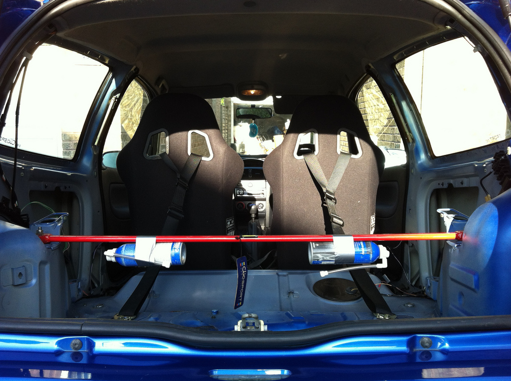

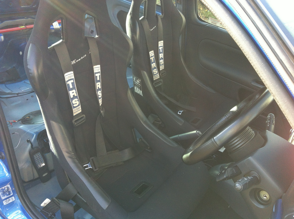

Only had time to fit my seats this weekend, rear strut brace (done it even tho it's standard suspension as its only 2 bolts lol), and fitted my new rear bumper, well it's second hand and needs a repray, but isnt recessed so I'm happy. Haven't got time to get the other stuff in as been working away and moving house.
Love the seats, couldn't believe the weight of the standard seats compared to there, pulled some more carpet, insulation and other bits out whilst there was no seats in.

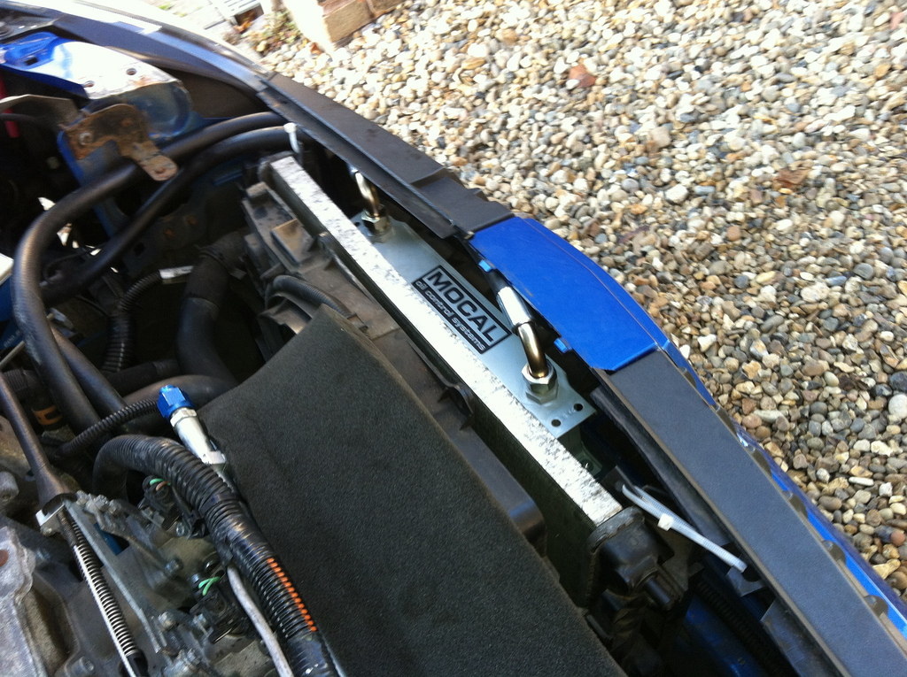

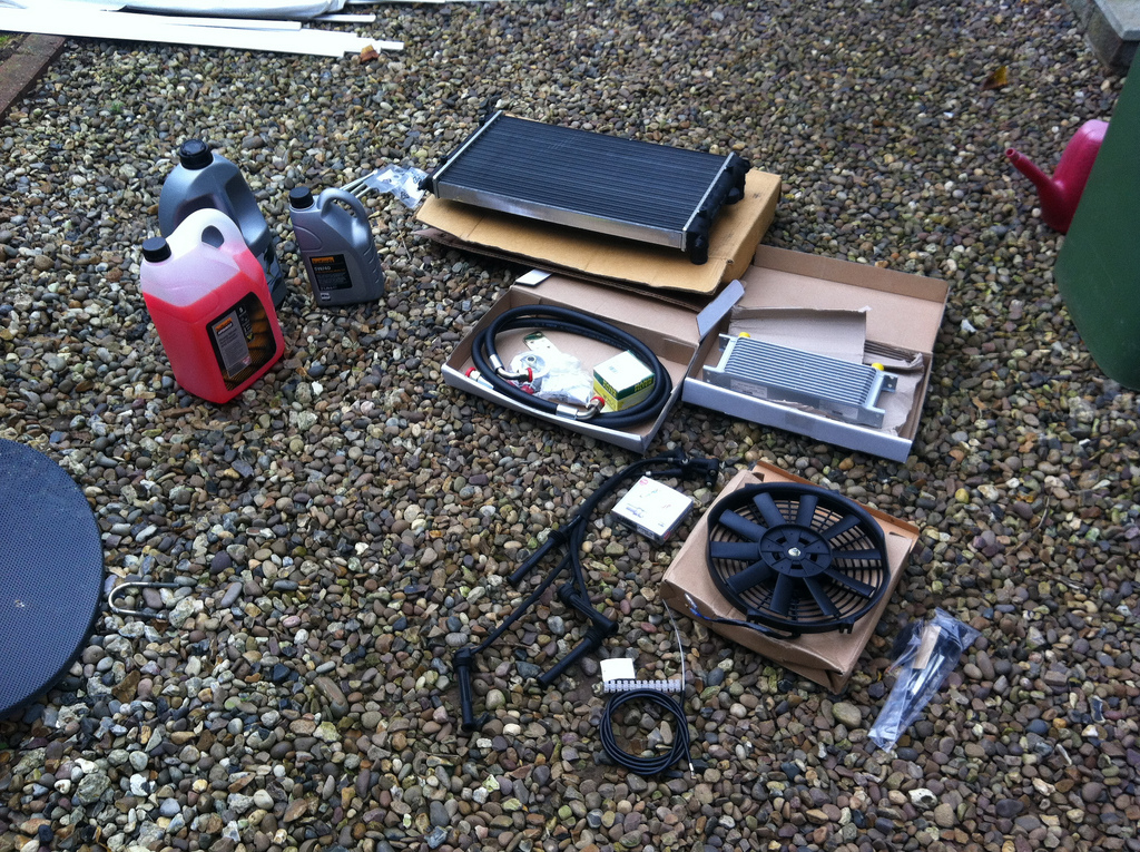

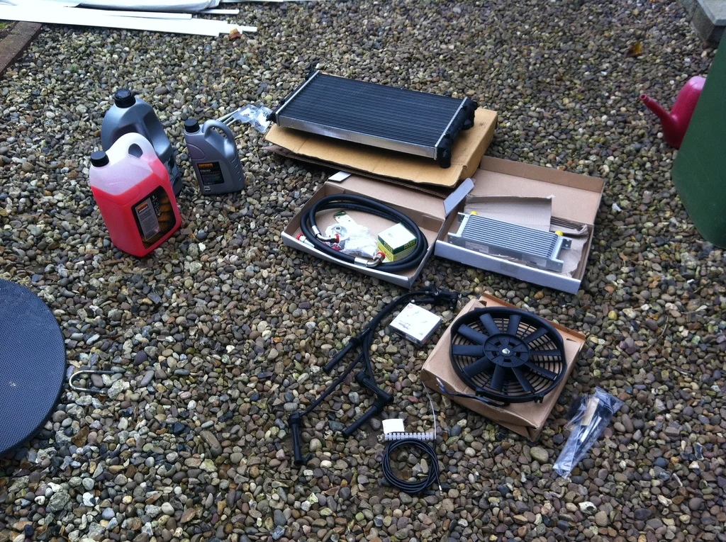

this consisted of (oil, plugs, oil filter, New Magnecore 8.5mm red leads) cleaned my throttle bodies (a little bit of oil residue built up in them) and fitted a Mocal oil cooler. and a Genuine Jenvey throttle cable that doesn't use a bleedless nipple, i was also going to fit a small rad and fan, but i'm missing a bung, so maybe next week :)
so anyway, here the picture of everything when i started:

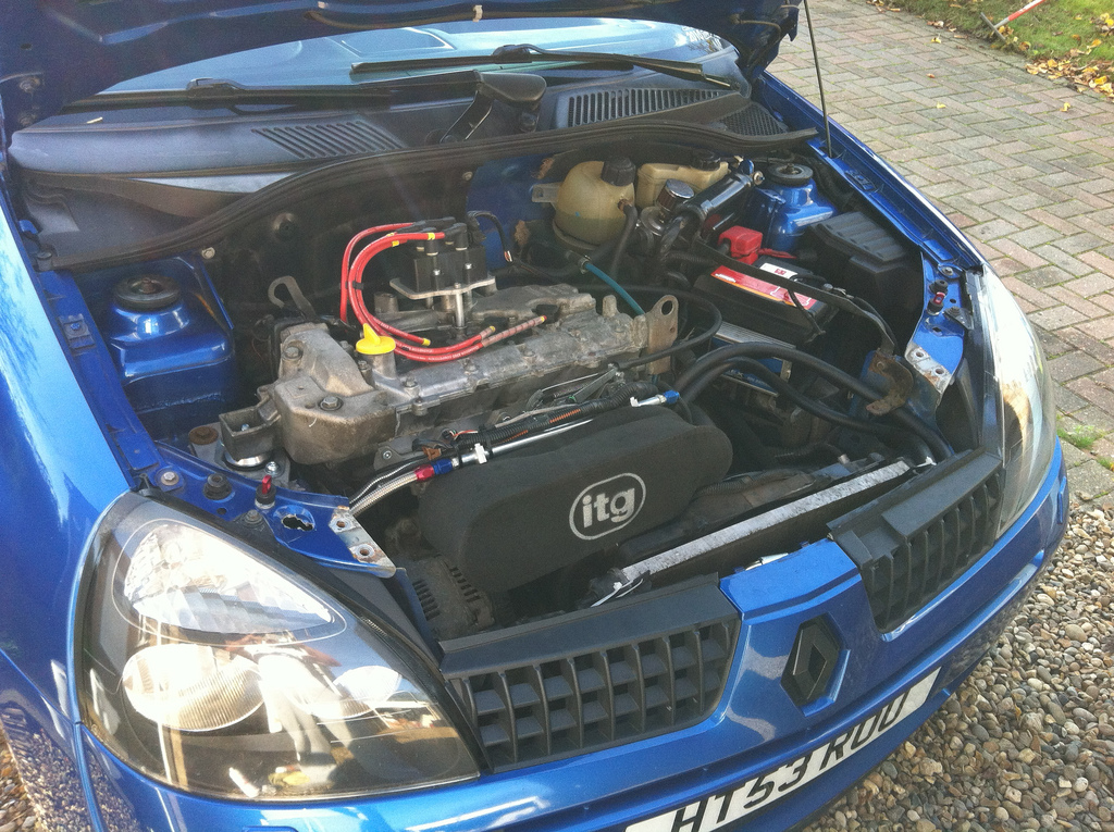

My car before:

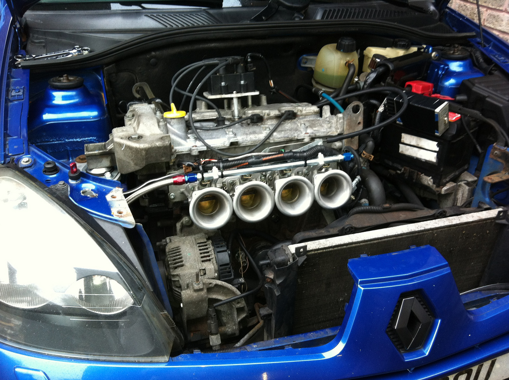

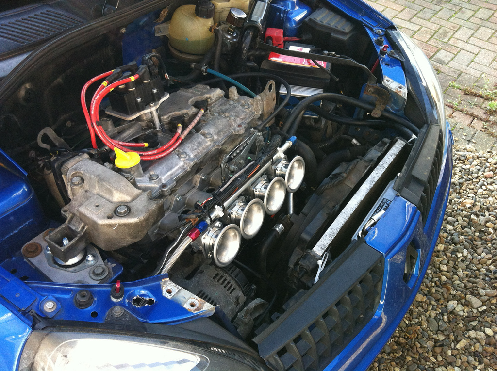

Slam panel removed, air filter removed to clean ITB's and for access to oil filter:

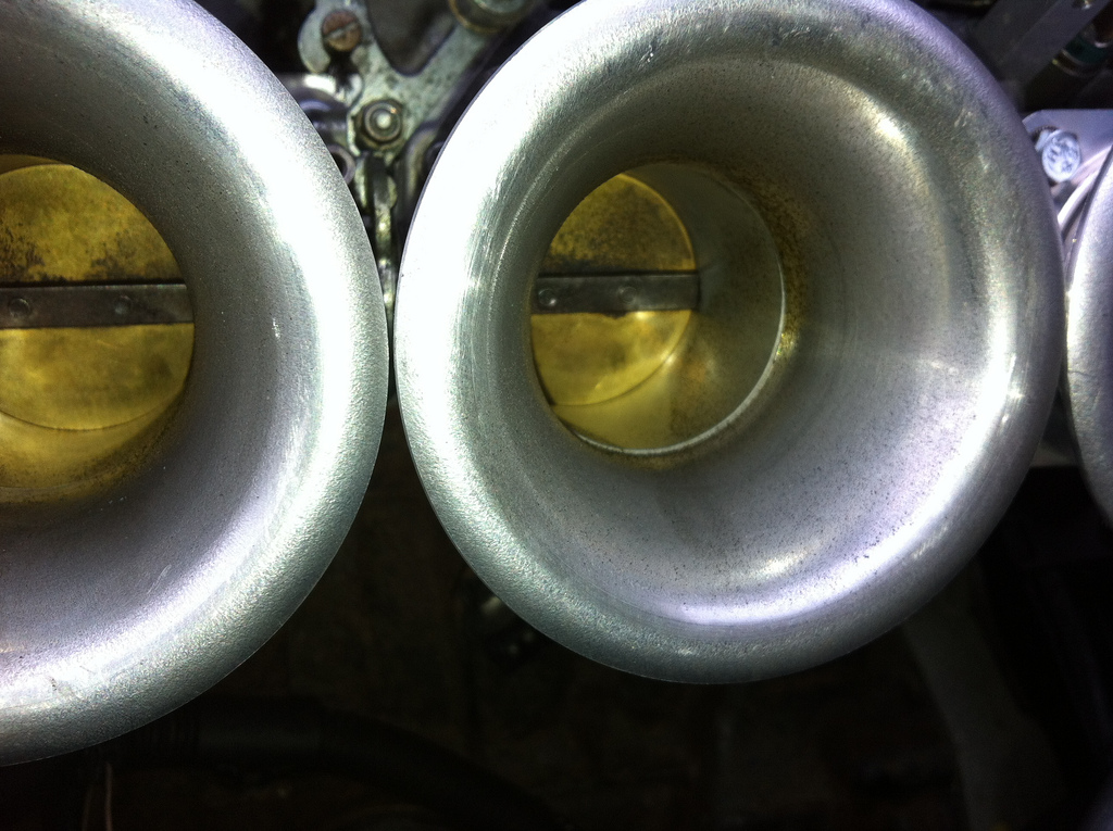

Dirty trumpets:

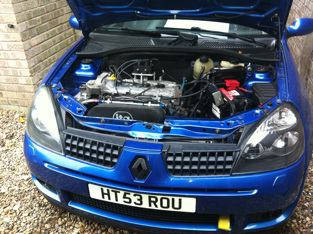

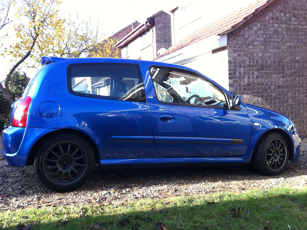

car started first time, run's better than ever now, and here's the pictures from the next day :) you'll also notice solid engine mount, ecu has been stuck back on properly my new cobra seats and rear strut brace which is very handy for the tyre foam :)

Looking good mate but you REALLY need to ditch those short trumpets and put some 90mm ones on - will be restricting power loads
Also the trumpet isn't lined up with the throttle body on your photo
I've just fitted the polo rad - gives LOADS more room I'm dead pleased with it. I'll update my progress blog later with some pics :D

these came with my itb's but at the time of getting them fitted, funds didnt allow for that. will be going for 90mm trumpets and an air filter with a solid back plate at some point (waiting untill i get it cammed so i can get it all mapped afterwards)

still running spot on, done probably 20 miles today, not a single problem :D

60mm trumpets are optimal with the KTR direct to head bodies on a standard engine
